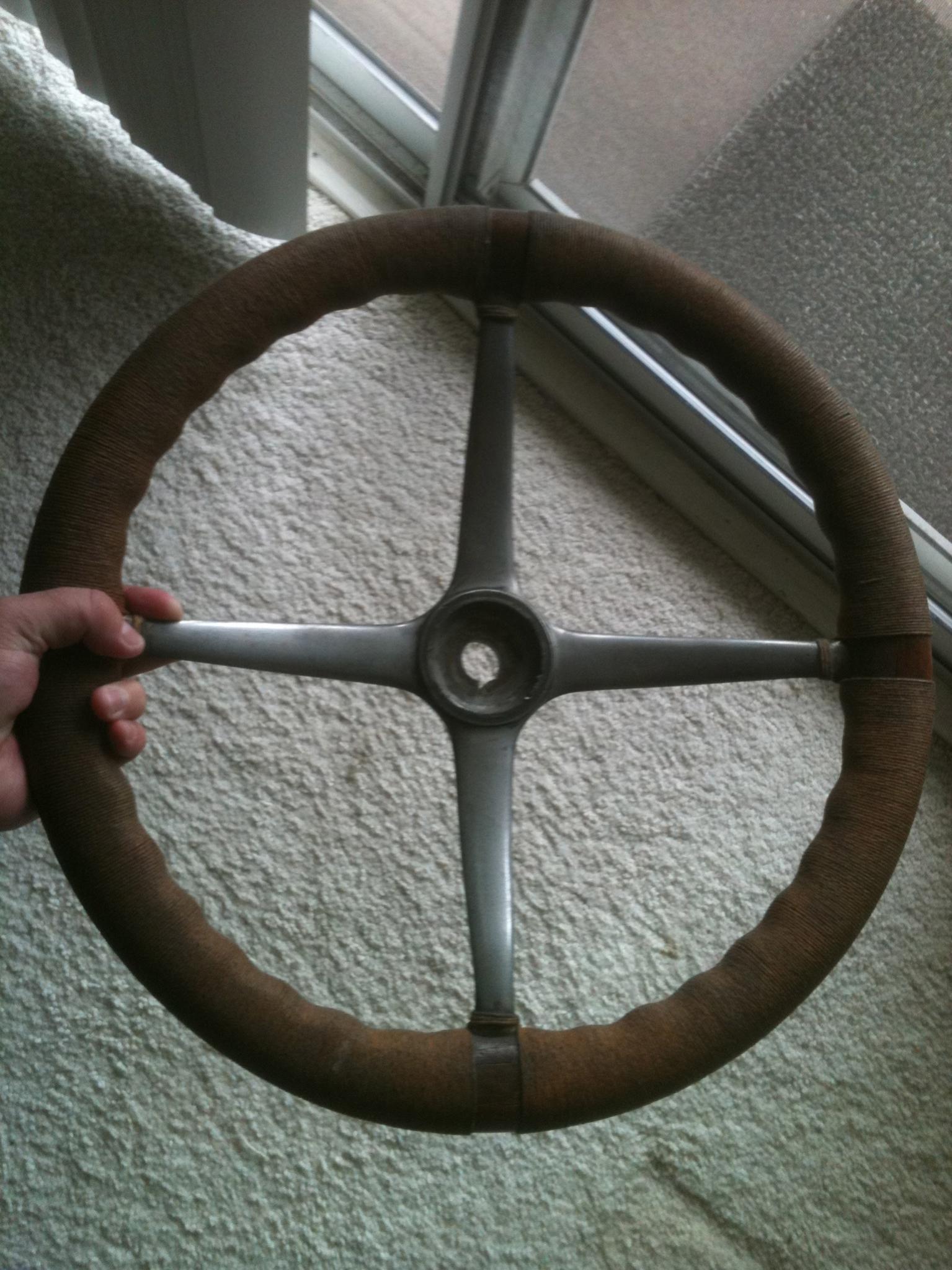

    rather fond of this...almost big enough for your car. 19" od, 16 1/4" id. took half a case of corona to make.
  3. yonahrr
    Joined: Feb 27, 2010
    Posts: 1,348
    yonahrr
    I have a wheel almost just like that one. Love the cord! I contacted a wheel guy who will make me a dandy wheel out of walnut for $135 which is a pretty good price but Don has indicated he wants to make one. That could mean trouble.

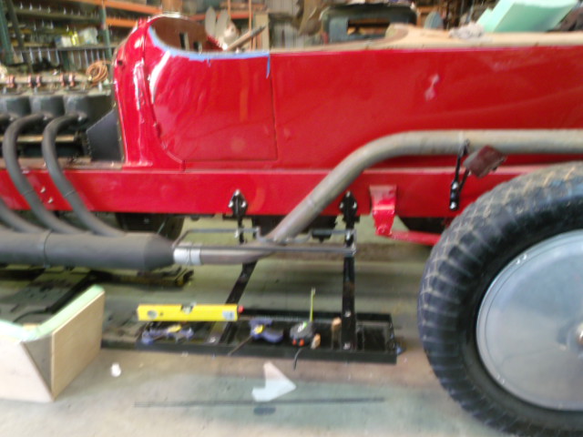

    One small step for...

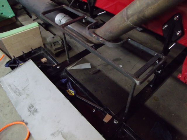

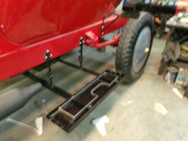

    I figure if I'm going to drive the speedster I better be able to get into the driver's seat. That means putting on the running board even if there's no fenders. Somehow I had everything on and fitted before dismantling things for painting. But now after painting--nothing seems to fit. The paint has distorted the frame and body. It's the only answer. With the running boards on I'll have to finish the intermediate step. The intermediate step on the driver's side is going to be my champagne cooler. Nice! I'll get to that later. For now one step will do. The sign guy promises the instrument panel will be done in a couple of days. From the thumbnails the photos looked like they really ****ed, I think I bumped the settings. Better tomorrow. Bad, bad pics!

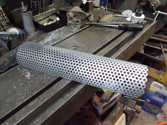

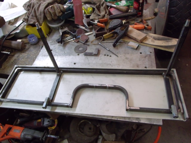

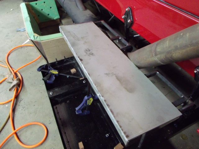

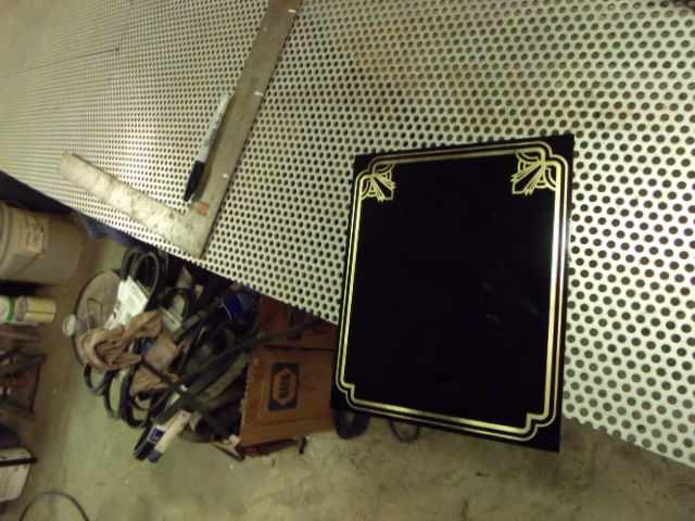

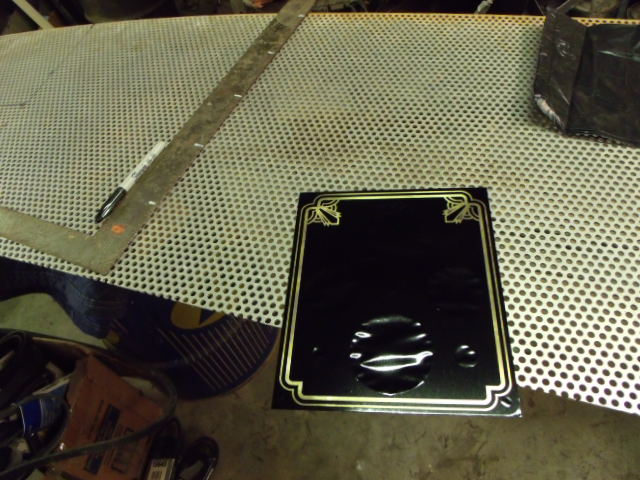

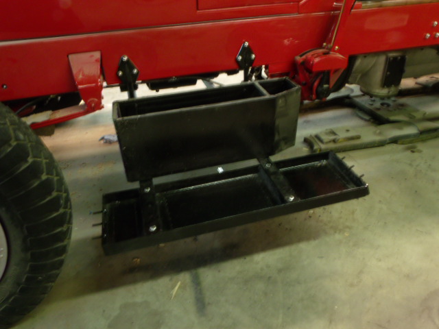

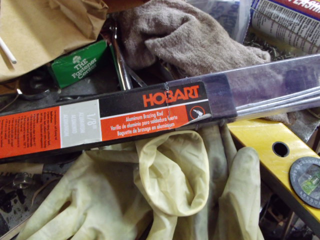

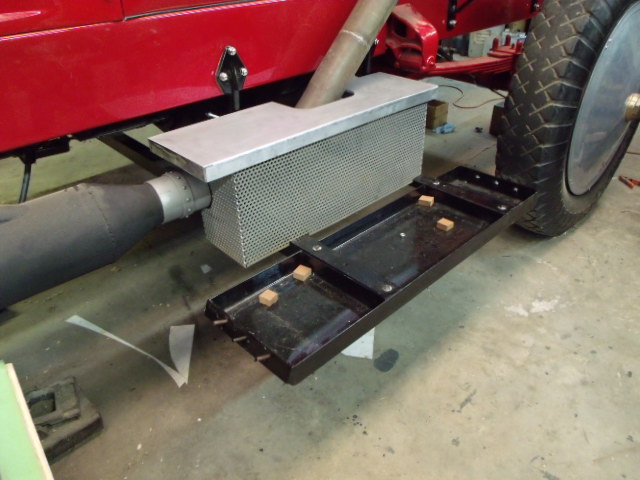

    I stopped by the sign guy--that's Michael at Mountain Country Signs--and he had my instrument panel ready. He really did a nice job. The designs might be a little over the top but you have to have a little something for the ladies. I'll have to do some experimenting with the nitric acid before I put any on my instrument panel. BTW, that perforated metal is going to be the heat shield on the exhaust. Next I put some supports on the second step then cut out a piece of .25 aluminum to go on top. I wanted a shoebox type lid even though there's nothing to open. There's really no strength involved so I figured what-the-hell who needs TIG or Heliarc. I thought I might try some of that low temperature aluminum brazing rod you see guys sell at the car flea markets. I bought some Hobart rods at Tractor Supply. I flows on real nice and bonds good and strong. It's actually more like soldering than brazing. We'll see what it looks like whe I clean up the weld tomorrow.

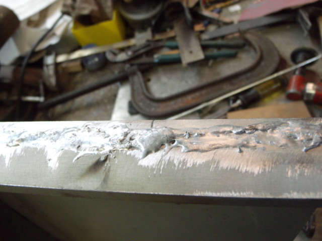

    No wait, I didn't mean to say that. What I meant to say was: Low temperature aluminum welding rod isn't aluminum it's zinc! I just found that out. That's why you can use it to weld carburetor float bowls and die cast stuff. Zinc! Schmink! Who cares? It's still got an incredibly high strength and you don't need a TIG unit. Oh, yeah, it's only mostly zinc--with a smattering of other metals thrown in. You do have to grind a bit. And hey, how many people can weld and make it look like whipped cream? Now picture that step with a SEAGRAVE script on one end and the Seagrave logo on the other. Now picture the perforated heat shield in place. Now picture... Enough with the picturing already. I'm getting a headache.

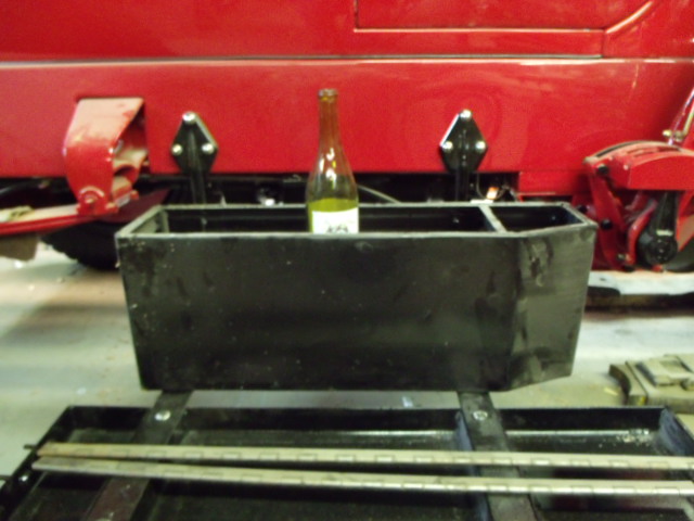

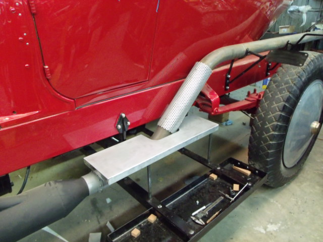

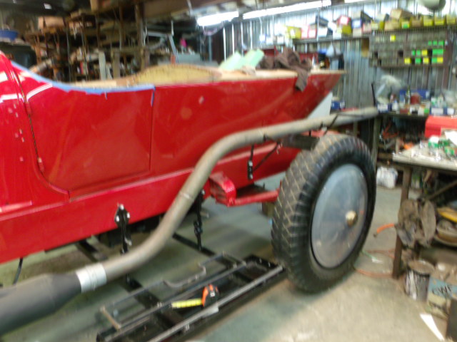

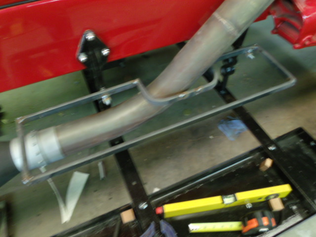

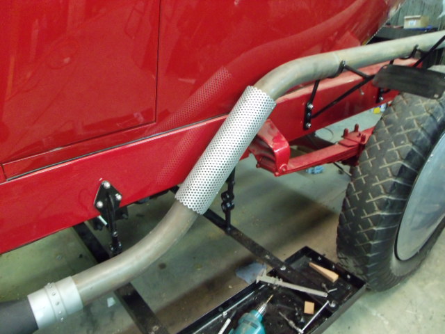

    I spent half the day bending and fitting the perforated shield under the step and when it was done I stepped back and took a look. That thing was UGLY! It looked like some kind of RF shield in the back an old tube radio. I ripped it out. So I got to thinking. The other side has a wine cooler. I'm going to insulate it with cork and line it with galvanized tin to look like an old ice box. I've even got a br*** builders plate from an old ice box. This side has the exhaust pipe running through it. Mmmm. Heat. Then it hit me. PIZZA OVEN! I can build a box with a door and cook pizza while I drive! Rolls owners have those fancy picnic boxes with plate and cups and Grey Poupon and stuff, but I'll have cold beer (or Chablis) and hot pizza. Hot damn!
    Jerry

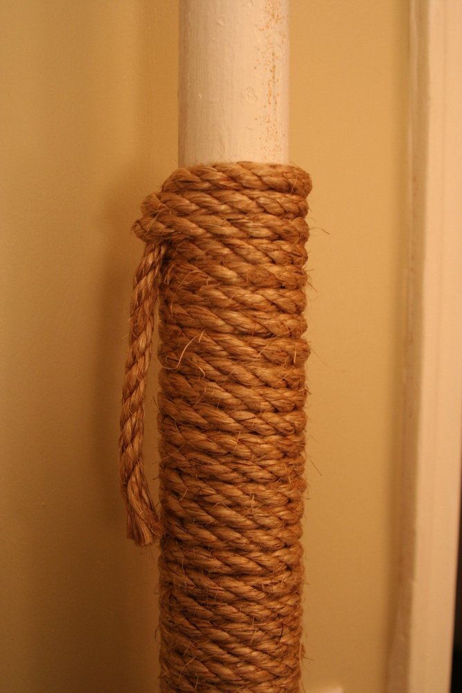

    It might cut into the Pizza business but have you thought of lagging the pipe with rope ( fireproof stove door seal type)? This is often used on steam pipes in steamboats. The picture below shows the method but it is on household hot water pipes - could not find a good picture of a steam pipe.

    I worry that without that shield your paint will blister near the exhaust? Maybe only 1/4 cir***ference on the body side for that shield? I doubt anyone knows how hot that pipe will get on this motor

    Jack, I was going to wrap the pipes with 1" flat wrap but I like the look of rope. I'll check it out.
