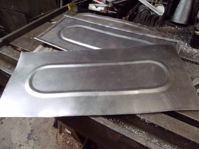

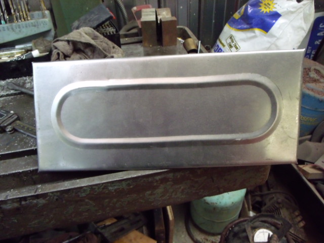

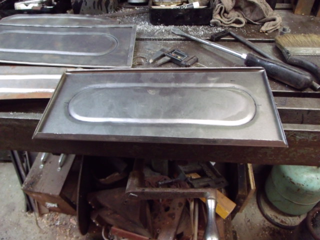

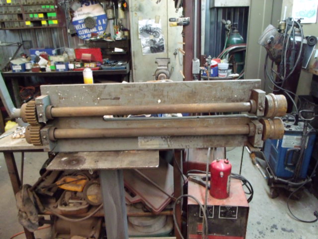

    I dragged out the old bead roller from under the drill press. I bought it about 20 years ago when I thought I'd be using it every day. I think I've used it once before today. After practicing on some s**** I drew a design (what do you call that thing?) and rolled it out. Not bad. (Pay no attention to that failure in the background. You see I took my eye off the pattern I drew. DON"T DO THAT!) I folded the edges and there was the door to my pizza oven. The kids are off from school this week but maybe I can sneak away and make the rest of the oven.
    Jerry

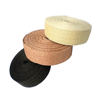

    It's a wrap!
    I couldn't find any round exhaust wrap. Besides, as I think about it, I don't think it will fit in the space I've allowed in the hood opening. So here's the choice in wraps: White, Black or Tan. What shall it be? As I see it. Black looks ***y but modern. Tan looks vintage but maybe a little like an ace bandage. White looks cool and clean but will probably get dirty quick. Any input?
    Jerry
  7. fireplace gaskets are a woven fibergl*** ... I found some at a hardware store .. also appliance maintanence men may have a door seal rope from ovens?
    why is the bead out rather than in?

    Black will conduct heat better. Black & red are good together.

    Jerry,
    McMaster-Carr has lots of rope seal material but if you are going to wrap the whole system it will be costly. I thought you were just going to wrap the pipe where it will try to burn you by the door. http://www.mcmaster.com/#rope-seals/=pj7quy
    The white tape wrap will soon go a little dark but in a good way. The tan does look like the result of a sprain. The black will stay clean but will radiate more heat than the white - kind of like pushing & pulling at the same time??
    Give the crab dip a few more days & it probably would do the job if spread on in a thin layer!

    And there it is--all different kinds. But I can't afford those prices. I'm going to wrap it from the engine to the muffler and from the muffler up the bend to the straight-a-way. I think the pipe's a little close to the bodywork in those places. I guess black is it. I tried 2" and it was a little hard to wrap. I was thinking about 1". Is there a trick? Do you wet the stuff?
    Jerry

    I think you have to pee on it.

    Jerry,
    WEAR LATEX GLOVES! Soak the roll in water for about 10 minutes, wrap it a tight as you can, overlap about 1/2 the width - a little more on the bends, tie the ends with fine wire.. 2" wrap is easier to work with.
    There is a good video on wrapping motorcycle pipes - http://www.youtube.com/watch?v=SQRcvjmGoaA

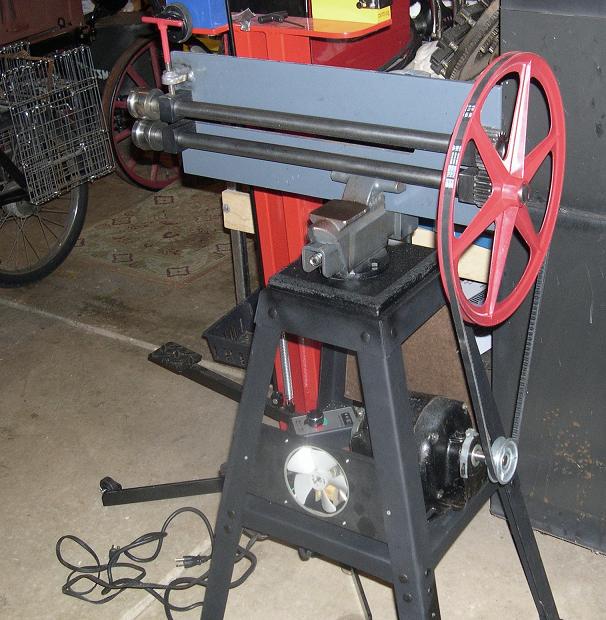

    YOUR BEAD ROLLER
    I built a motorized, foot-pedal version from that same basic bead roller you have. Judging by the rust, I use mine a little more often but rusty or polished, they get the job done.
    Jimmy
  15. yonahrr
    Joined: Feb 27, 2010
    Posts: 1,348
    yonahrr
    I like what you've done. It's real hard to turn that crank and guide your work at the same time. I was going to build a large hand wheel. Where did you get the motor and foot control?
    Jerry

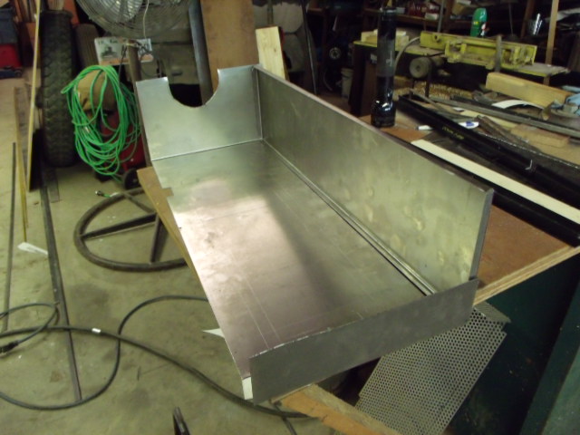

    I sneaked away for a few hours and bent up the front and bottom to the pizza oven. My door's a little small but so-be-it I ain't makin another one. It'll have to be pizza by the slice. I'm looking for a small antique oven temp gauge to go in the door. I saw one on an old camp oven. There's an NOS one on ebay but I ain't paying $45.00 for a tiny little thing like that.

  17. JIMSPSYCLESHOP
    Joined: Mar 26, 2012
    Posts: 56
    JIMSPSYCLESHOP
    Jerry,
    All three items came from Harbor Freight and I used the ole' 20% off coupons making for an inexpensive 'power roller'. Even the stand was their el cheapo grinder stand. Actually the old general purpose electric motor had a centrifugal start up clutch that wasn't working too well for the very slow speeds needed so I bought a very 'torguey' HF drill and used that. Combined with a HF speed controller and foot pedal it works like a charm. Attached is a photo of the power drill upgrade.
    It beats having to keep calling my wife out to the workshop to have her turn my crank (double entendre)? The cooling fan (from an old AMPEX reel-to-reel tape machine) seen in the photo is not necessary. Originally, I was worried about the previous high speed electric motor overheating forced to run at such low rpm (the drill never gets hot).

    When I wrapped my pipes, I soaked the wrap in water and pulled it really tight. When it dries, it shrinks a bit and looks really nice. You can paint it with high temp paint, if it gets too dirty.
    Doug

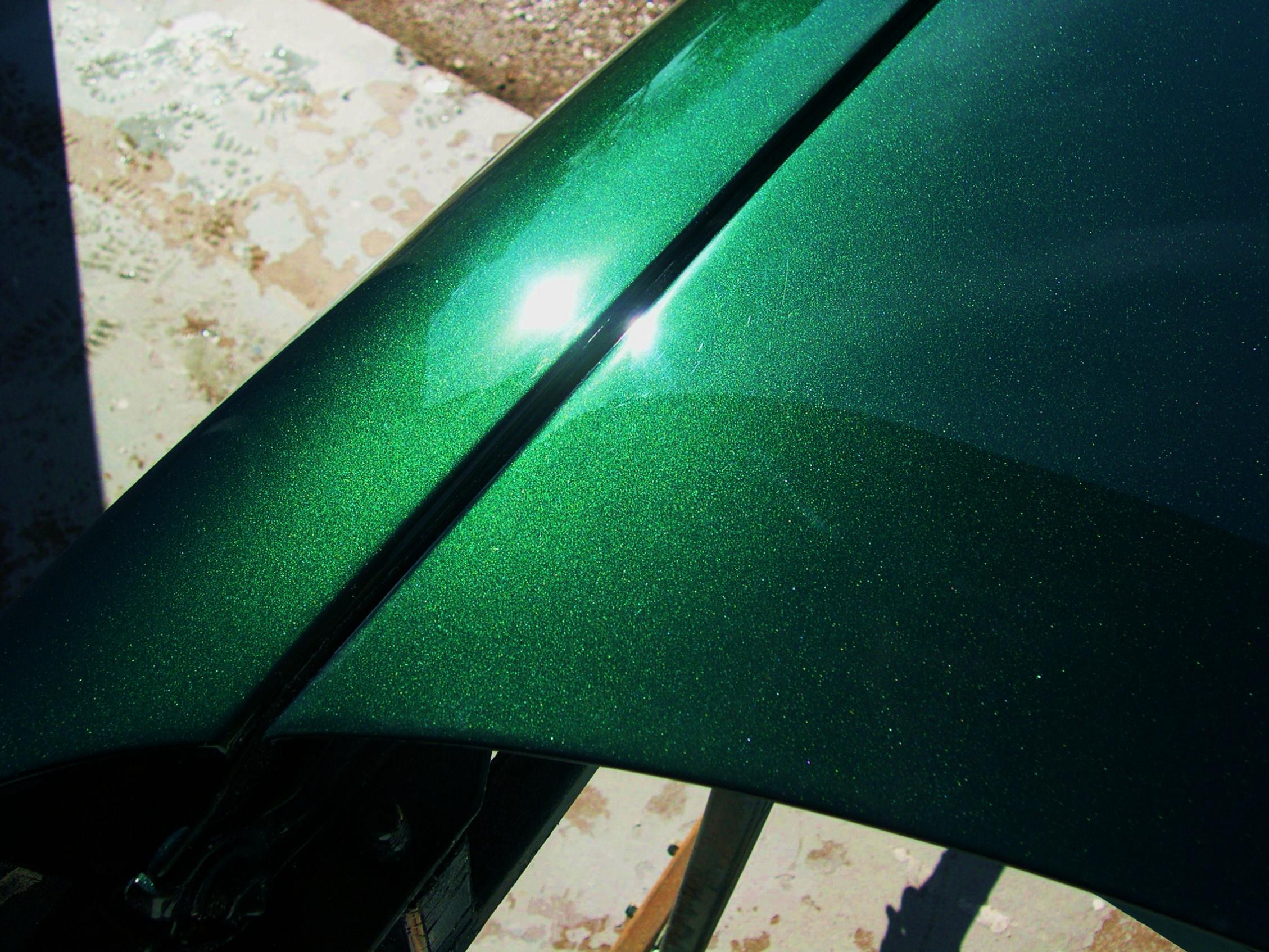

    P.S. Just to prove us old farts can continue to learn new tricks, just before the holiday, I took second place in a state auto body painting compe***ion. Considering I've never painted professionally in my 63 years, I was pretty surprised to place at all let alone beat out a gaggle of 20/20 visioned, steady handed young people.

    Nope, all contestants had to use the same front clip of a Chevy S-10 pickup (2 fenders & hood actually) . Pearl metallic-gold BRG with 5 clear coats is not something that I'd want to see on my Speedster but they liked it.
    I should give some credit to the local college that allowed me to use a new 80K spray booth, $700.00 Iwata spray gun and all PPG paint products. If I do a paint job in my own work shop; I just become another mortal with a ****py compressor, window fans, furnace filters and ersatz plastic sheet spray booth complete with those tiny black gnats that always show up for a paint job.

    Black. Apply soaking wet, stretching the heck out of it. Secure the ends with a couple of turns of safety wire - you can hide the twisty behind - the safety wire mostly disappears into the wrap and looks better than a hose clamp. Start the motor and let the water boil off, shrinking the wrap in place. Then hit is with a dusting of spray header paint to seal the fuzz and protect from fraying.
    The tan might work also - can you find tan or clear header paint?
    I would stay away from the white because it will always look funky no matter how hard you try.

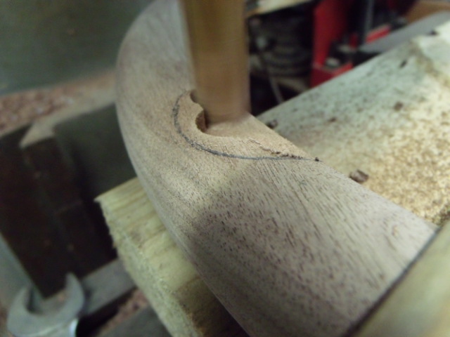

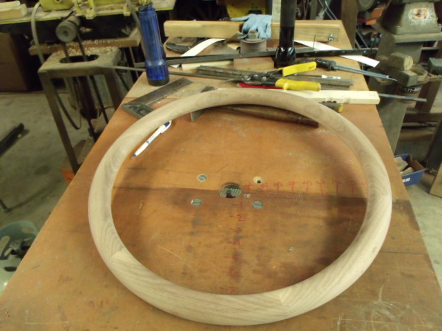

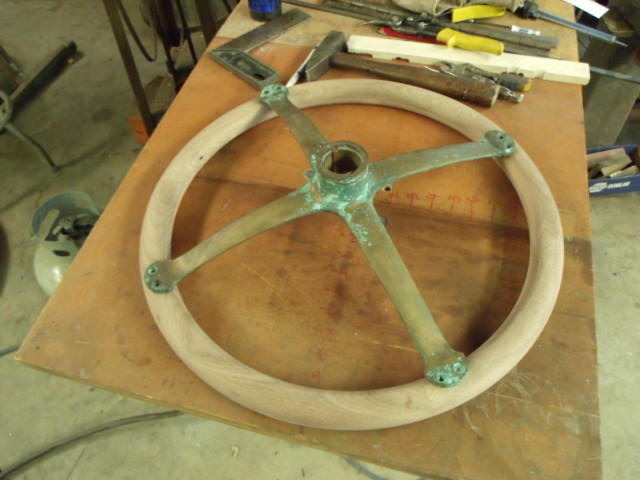

    Big wheel keep on turning.
    Did I say big? I meant HU****US!
    Jerry

    yonahrr
    I'm thinking oil finish. Boiled linseed or Tru-oil? Someone suggested tung oil. Any ideas?
    Jerry
