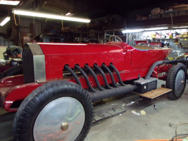

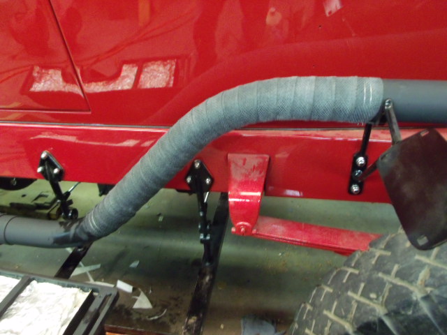

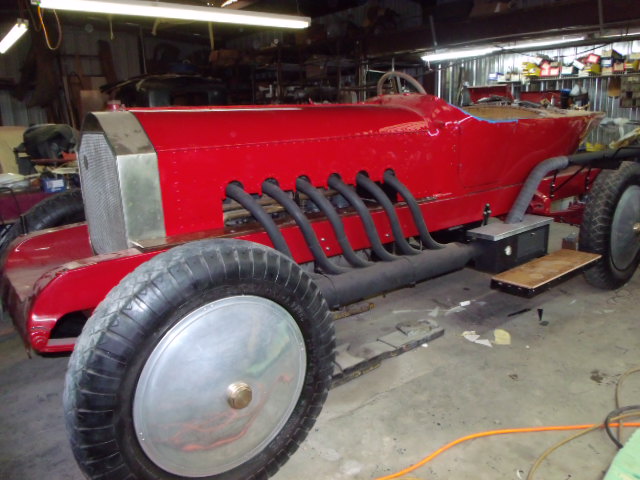

    Had time to stop in the shop for about an hour. That was enough to wrap the exhaust and install the oven. I was going to put that aluminum guard over the exhaust but it looked out of time. I'll make something more period but later on. Next job--put a hinge on the running board cover. I think the bad pics are because the light is really low at the shop in the winter. The shutter speed varies between 1/10 and 1/30. I doubt there's any way to get a good hand held pic at those speeds. Even the flash is little help. I'm bringing a flood light.
    Jerry

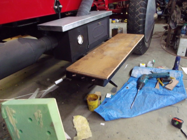

  6. yonahrr
    Joined: Feb 27, 2010
    Posts: 1,348
    yonahrr
    Even worse pictures!

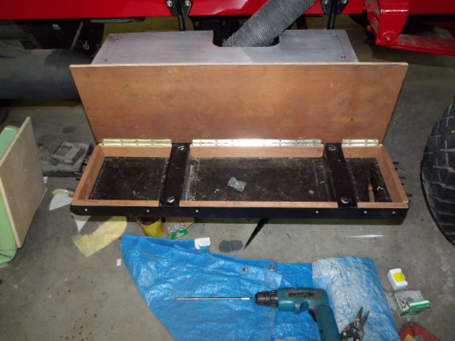

    Forgot my camera and had to use the cell phone. That's why there's only two. I wanted to spare you the torture. I got the wood fastened to the running board tool box then drilled and installed the hinge. I know the hinge is a little short but it was the piece left over from the hood and that's as long as it is! Some wise guy will lift the running board up and ask, "Why is the hinge so short?" At that point I'll say, "Hey, isn't that oven cool?" Actually I'll say, "Shut up ya big dope!" I can't trim the top of the tool box until I fasten the walnut on the front edge of the running board and I can't fasten the walnut on until I put on the fenders. It's a vicious cycle! So maybe I'll hang on a fender just to see.
    Jerry

  8. Jack Innes
    Joined: Nov 26, 2010
    Posts: 178
    Jack Innes
    Jerry, The hinge is not too short. It was designed not to be visible from the ends of the lid so the gap looks uniform from all visible angles. You probably just missed that on the AutoCAD drawings, thank goodness the CNC hinge shrinker caught it!

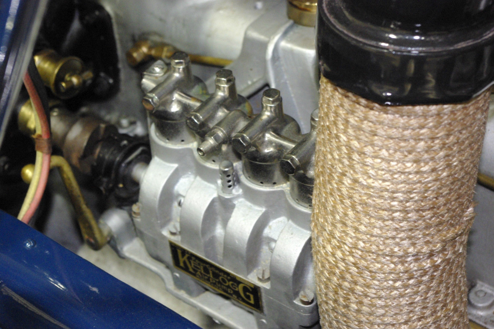

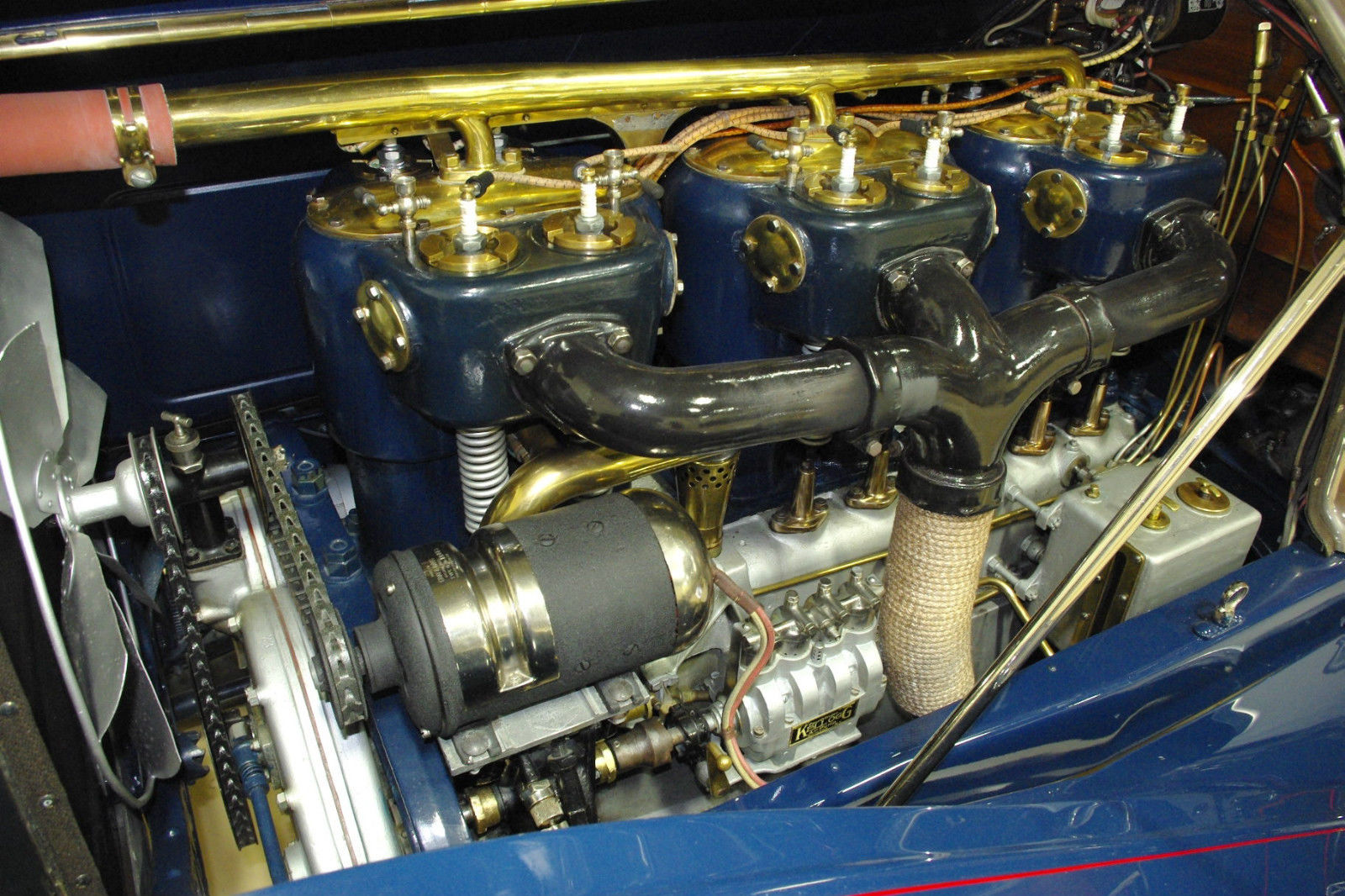

    Pipe wrap; A little late but here is what rope lagging looks like on a puny 577.5 cid Peerless engine.
  12. captainjunk#2
    Joined: Mar 13, 2008
    Posts: 4,420
    captainjunk#2
    that peerless engine is a work of art its gorgeous

    Why didn't I see that hood hinge was too big! The whole cover was tilted. No matter. Luckily I had nice stainless hinge that worked perfectly. I'll have to get another for the other side tomorrow. It would sure be nice if I could get a whole day in the shop. Anyway the running board cover is on. I'd like to get the dash in now. Maybe tomorrow I can sneak away.

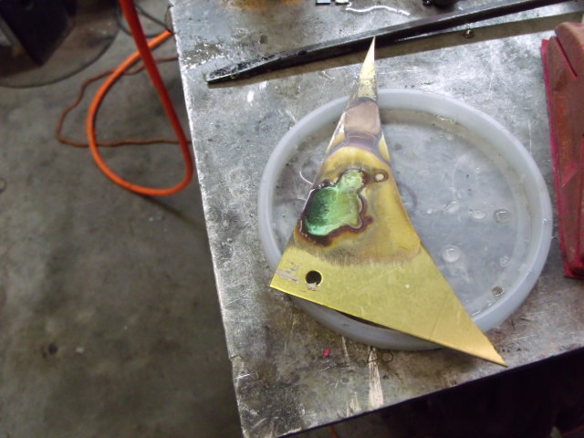

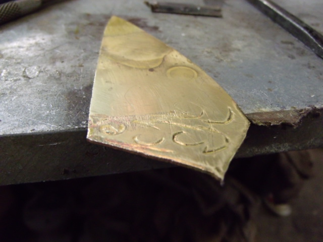

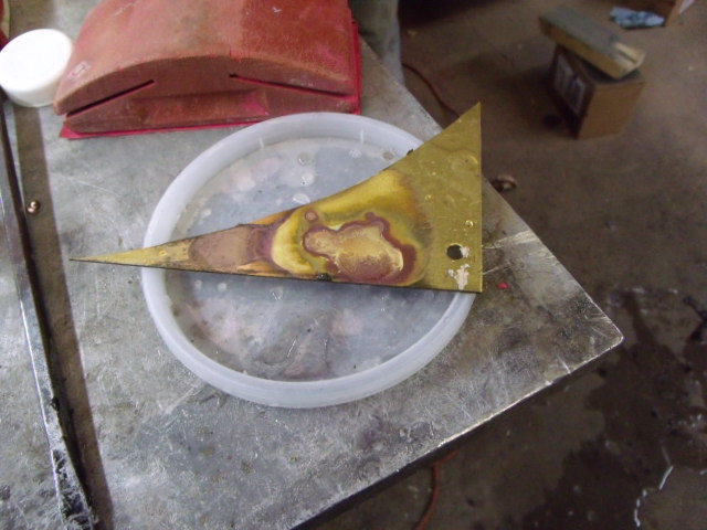

    Just my humble opinion, but the bite in the pix from such a harsh solution looks pretty drastic. I ***ume you wanted to achieve a design that almost loos engraved? You may want to look at this transfer/ br*** etching method:
    Even if you don't want to try iron on toner transfer and want to scratch the image through a ground, at least consider the etchant I suggest. I've used it myself in a shop that used it forever, it works.
    http://www.instructables.com/id/Make-pictures-with-Acid-Etching/?ALLSTEPS
    CHEAP SOURCE FOR: Dry Concentrate Etchant (Ferric Chloride)
    This is what I used in the past to make some fancy floral patterns on some antique door knob side plates.
    http://www.jameco.com/webapp/wcs/st...storeId=10001&catalogId=10001&productId=70201
    ETCHING GROUND
    Good source for brush on ground 'ASPHALTUM'
    I worked in a plate etching & lithography stone print studio in the 70's.
    I know of nothing better for protecting, stop etch or grounding a plate surface .
    These guys sell ferric chloride also but I'm not sure if they carry the shipping/storage friendly dry version.
    http://www.takachpress.com/servlet/the-342/Graphic-Chemical-Senefelder's-Liquid/Detail
    To apply you stand your plate up vertically and using a flat, straight edge 2-3 inch brush you swipe the surface; top - center & near bottom in brisk non-stop motions letting gravity do the work and you walk away from it until its dry. Sort of the way Henry had his boys paint the panels on A Model T.
    * The ground may be thinner at the top but if it's completely covered it's still good. You can always flip the plate around 180 (after it dries) and repeat if you want a more pretty solid black surface. You can draw on the dry stuff or gently rub/transfer a pencil drawing with tracing paper too.
    Jimmy

    I found that web site a while back and tried all that stuff. I couldn't make any of it work. But then I'm just a simple caveman. I couldn't make ferric chloride work very well either. Too slow. I more of a down and dirty burn it out quick with lots of low voltage amps. It brings out the Dr. Frankenstein in me. :)
    Jerry

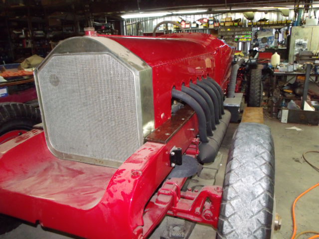

    Yes, children today we put on the hood. It was awesome! A confluence of fate brought together a conjunction of people: Me, Neil the Daring Scotsman, David the Other Daring Scotsman and Keith the Appalachian Mountain Man. With a great shout we heaved the mighty metal hood into place. (Let me know if I'm getting too melodramatic here.) I wish every one of you could have been there but there was barely enough room in my tiny shop for us to shuffle sideways carrying the hood aloft like a virgin to the volcano's rim. After it was in place we took off our hats and stood in awe for 4 maybe 5 seconds. Here's the amazing thing. Are you ready? The hood fit! No, I mean it actually fit! Top. Bottom. And both sides. Nothing else on the speedster fit after being put together then taken apart for painting except the hood. Folks around here are calling it: THE CHRISTMAS MIRACLE!! I took pictures with my fancy new Galaxy S3 phone but they refuse to come out of the phone and into the computer. My resident expert says it's because I use a Linux operating system. (Oh how I hate those pesky viruses.) But we'll work that out. Luckily, I took some extras with my old (but hated) GEX500
    Jerry
