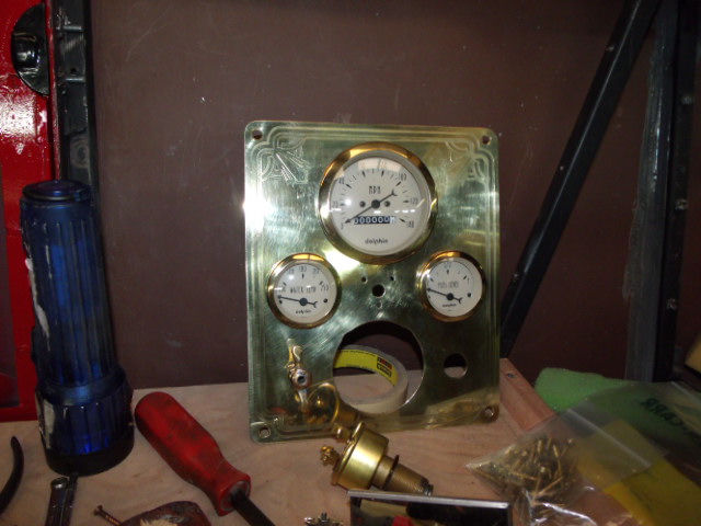

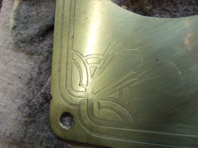

    Electricity vs Br***
    Got out the RootKill and battery acid and water, mixed it in a tub and dropped in the instrument panel. I started out with 6 volts but got impatient and upped it to 12 since the heater ran out of gas and the shop got cold. Lots of bubbles and frothy copper built up on the electrode (negative.) (I would say anode or cathode but I don't know one from the other.) The panel was positive. It was hard to see how much was eaten out but I kept taking the panel out and checking. After an hour I quit. I could have left it in a little more. I was going to paint the design with waterproof ink but after looking at it I'm thinking maybe it will be more subtle it I'll just leave it the way it is. (And easier to polish too.) What do you think? I also came across this stuff called Pebeco Porcelaine 150 China Paint that you use like a magic marker but you fire in the oven at 300 degrees. You can use it on china or metal. I bought a stick. $5.00 What the hell! I threw in a pic of the hood up just for fun. Well I had two pics (from the Galaxy S3) of the panel in the solution with the electrodes around it but they won't up load. I had trouble before if the .JPG is in lower case but that's not it. You'll have to imagine it.

    Hey how about this?[​IMG]
  4. lahti35
    Joined: May 23, 2004
    Posts: 248
    lahti35
    Br*** plate turned out nice!

    The car looks very imposing with the hood on, and the br*** turned out fantastic.

    Wow, it looks fantastic. I couldn't quite picture it in my head, but seeing it all together brings in home. Great job.

    I am partial to the br*** plate with no contrast, but that's me.
    How did you apply the 'stencil' to the br***? Really nice design.

    Michael over at Mountain Country Signs next door to my shop is very patient with me. I give him a design and he cleans it up, makes a vinyl cutout and sticks it on the br***. There might be better systems but this one works for me. That one was very intricate.

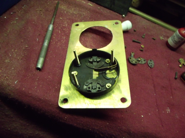

    Electric
    I just had time to day to start work on the light switch and half of that was finding the plastic bag with all the bits and pieces in it. Hey, but it's a start!

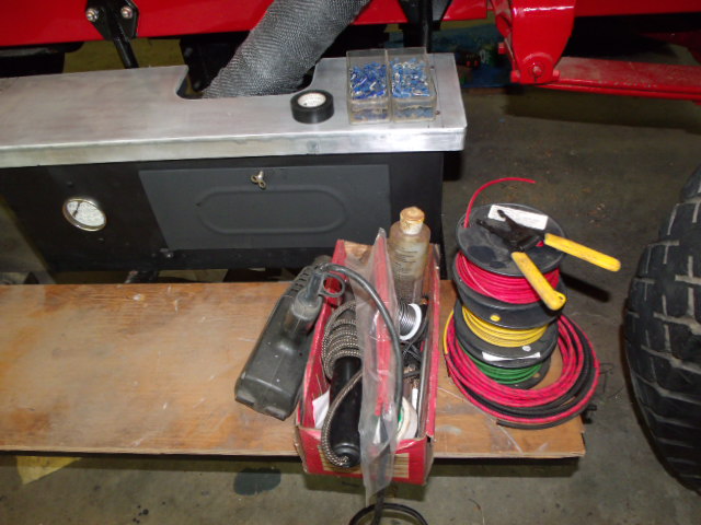

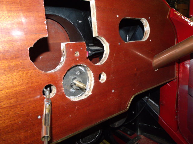

    Let's get wired!
    Or wored as they say in these here parts. When I first moved to North GA 33 years ago I was intrigued that fire was pronounced "far". If "fire" was "far" then how did one say, "The barn is "far" away." "The barn is over yonder," was the reply. We'll go into "roach bug", "hose pipe" and "hind catcher" another day.
    I got the light switch plate together which required tweaking the contacts and soldering and other stuff then I started on the instrument panel. That also required tweaking or maybe twerking if I knew exactly what that was. It would have been nice to have the panel all put together and then just install it but it's going to be like working on a 1968 Mercedes 230's heater controls were you have to reach your fingers way up inside there and do the impossible. All my wire (period, of course) and solder (period--none of that lead free ****) and tools (not so period) are ready and ready.
    Jerry
