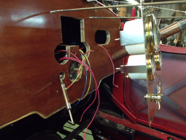

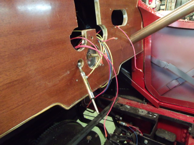

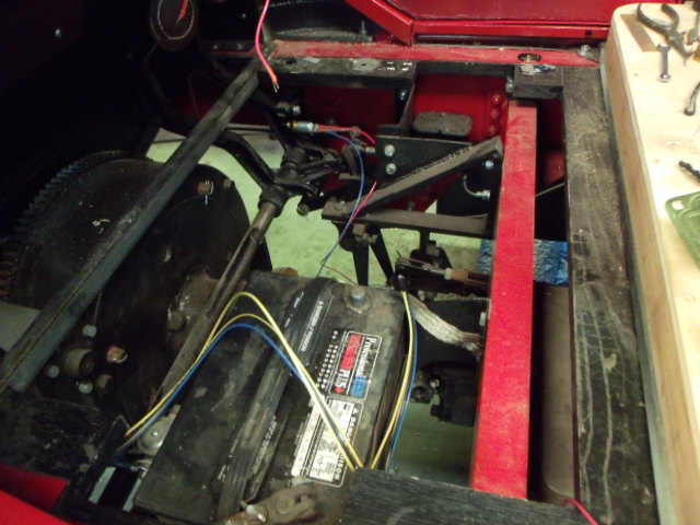

    While scavenging the hidden deserts of Azakon-dar I found an ancient text, possibly Rosicrucian or Babylonian or Egyptolucian, but it was based on a much older text--Denisovan or even Homohabalon. It depicted in cryptic code the key to automotive wiring. I copied it as best I could before it dissolved into dust--you see I had neglected to take proper precautions before opening the tomb. But then, I was being chased by Hadan and his bandits. That's another story....
    Luckily, I saved the copy of the text because I needed it today. All I did was cut wire, twist off those little plastic ferrels, solder and heat shrink. I know it wasn't very "period." But I don't want the wiring to come apart under the intense shaking of the mighty 1000cid power plant. I'm saving all the "period" wiring for were it will be seen. I know, I know--but you won't tell will you? If you do, I'll send for Hadan and his bandits.

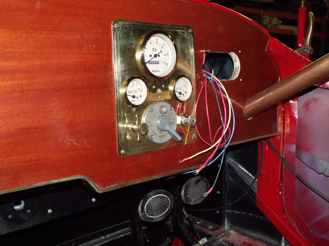

    So, I'm little slow, but you must have coated the entire piece with wax, then carved out your pattern, then into the etching bath? That's great, the finished panel (in a later post) looks fantastic. Nice job with the layout, it's really neat, a nice touch and makes the dash look "authentic".

    Brian, I took the panel to the sign shop. He cut out the pattern I gave him on his sign cutter in vinyl and stuck it to the panel. I put wax on the back of the panel to keep the solution from eating the back. After I etched the panel I pulled off the sign vinyl and s****ed off the wax. Voila! It's hard to put all that down in words. If it's still unclear I'll try again. :)

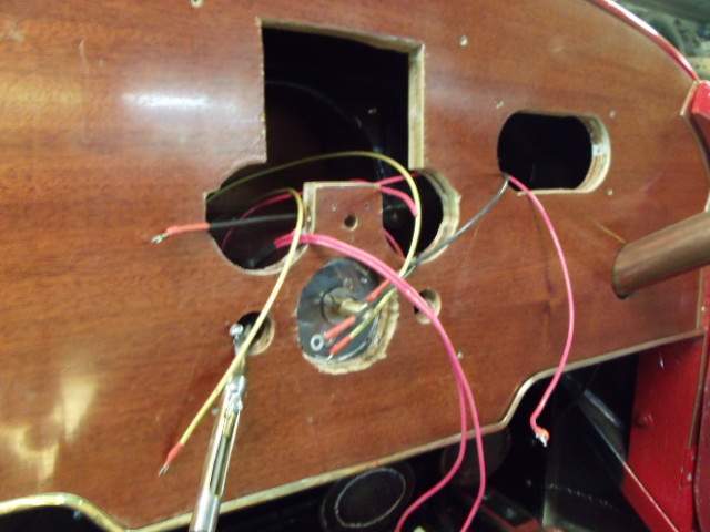

    It was so cold I had to wait until about 12 to work in the shop. Then it was more wiring. I think all the short wires are run. Next is hooking up the instrument panel and light switches. I still have to run some long wires for the lights and fuel pump. But that'll be later. I also ordered a terminal block from O'Reilly's to make it easier to wire up the lights and fuel pump when the time comes. Hey, you like my hanging instrument panel? I figured it would be less h***le when it comes to screwing things up--I mean screwing things on.
    Jerry

    I did get the instrument panel wired and in, although I broke the ignition switch--what a piece of ****! I had to buy another. Is everything made in China? I'd like to find an good old USA key switch but so far it's eluded me. I still have to dechrome the little gauge illuminator light in the center. Anyway, we're getting close to a crank up and crank up means a drive. Whoo Hoo!

    I kinda hate to say it, but those gauges look out of context in the beautiful dash panel. How about having them refaced? A buddy of mine laid out graphics and printed new vinyl face for the Harley Davidson speedo I used in my '36 that matched the original face. They're easy to take apart, and just plop the new overlay on the modern face. Black and white the more period graphics would look much, much more appropriate. But, everybody's a critic…

    I searched a long time for gauges for the speedster. On my REO speedster I used an ***ortment of vintage gauges but I didn't want to do that on the Seagrave. I gave new faces a lot of thought. The problem is I don't see any way to take these gauges apart unless you bend up the bezel. Now I've done that on other gauges with soft aluminum bezels but I hate to mess these up. I might try it after the speedster is up and running. I've got an extra oil pressure gauge I can experiment on. If someone knows the secret of Dolphin bezel removal p*** it on.
