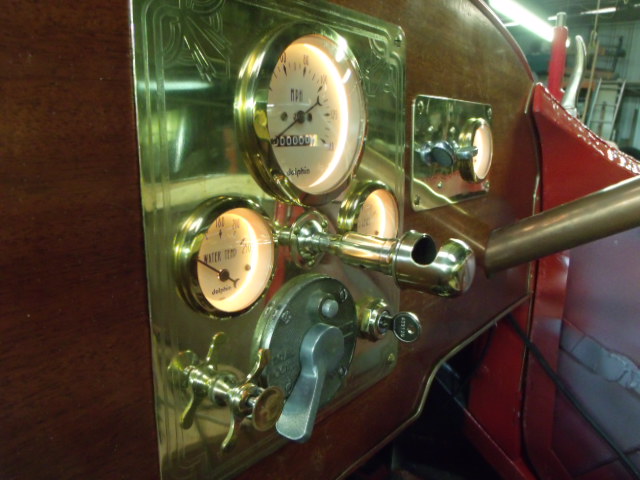

    Instruments
    How did things that make music, things that show what's happening inside a machine and things that you operate on a human body with all get the same name?
    So the instrument panel is in and everything works. I know, I know the wiring looks like a traveling monk did it but I really intended to do all the wiring with the entire dash board out. But I just didn't have the heart the rip it out after I got it all in. There was no way to do a neat job working through a those holes. Beside, does electricity really care if the wires are neat and orderly? Hey, remember those old TV's of the 60's before they had printed circuits and that mess of wiring and solder inside the ch***is? How did those things ever work? I think I'm going to put a red light in the old br*** dash light just for the hell of it. Now, besides the headlights and taillights, which I'm going to ignore for now, there's just the fuel pump and fuel gauge wires to hook up.
    Jerry

    Hey, I don't see any messy wires, so they must not exist. I'm pretty sure it's neat and orderly behind those gauges.
  12. 64 DODGE 440
    Joined: Sep 2, 2006
    Posts: 4,434
    64 DODGE 440
    from so cal
    Really liking that br*** panel Jerry. The red light is a good idea, it protects your night vision and you know that you want to be able to see well at night so you don't run into a Yak when you are flying down the back roads of Upper ****olia.

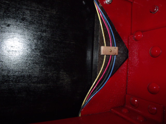

    Today a friendly Frenchman came to my shop. He looked the speedster over and asked my how long I'd been working on it. Three and a half years or so I told him. He smiled politely and said: "Tu et un ane." Those Frenchmen a nice bunch.
    The wiring is done for the time being although it needs a little tidying up. I spent too much time making some wire holders because I couldn't stand the plastic clips. It would have looked better if I didn't use the plastic wires. If someone doesn't like it I'll tell them: "Tu et un ane."
