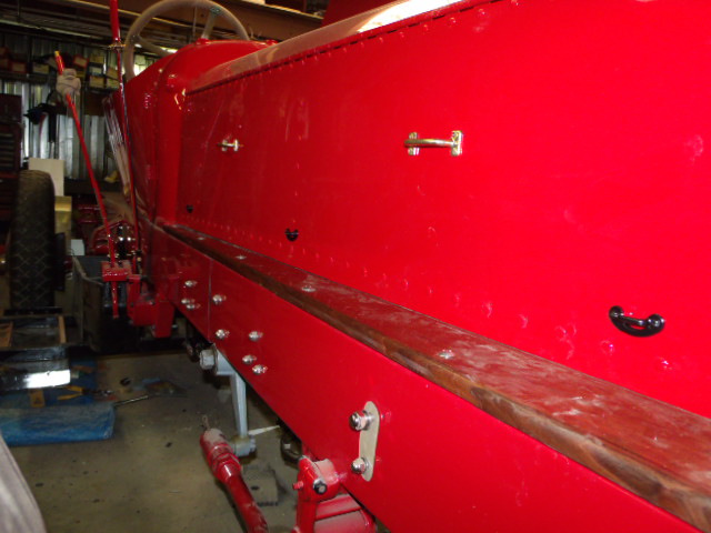

  28. yonahrr
    Joined: Feb 27, 2010
    Posts: 1,348
    yonahrr
    Hold on there!
    I had to take off the hood shelf on the right side and sand the underside because the hood was a little too close. Then there was all this careful measurement, then careful drilling, then careful screwing. So one side has the hold downs on it. Now the exhaust side is a different story. I was a little hesitant about installing the piece under the pipes because I know it's going to get scratched all to hell when I latch the hood down on it. So I'm going to make a subs***ute piece for the time being out of an angle just to latch the hood down.
    Jerry
