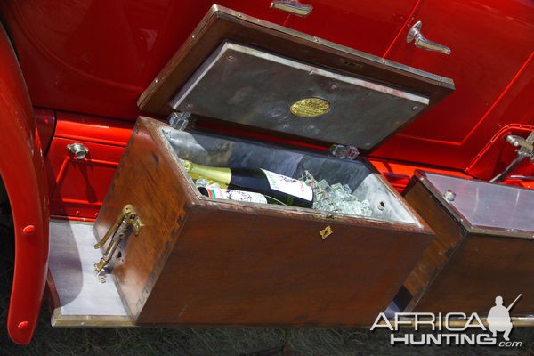

    I got my ice box box from Don and the top wasn't quite square so I got out an enormous piece of sandpaper I'd bought years ago and started rubbing back and forth. After about 30 minutes the top was flat. Believe it or not I once resurfaced a head this way. I'd heard that in England they used grinding compound and a plate of gl*** to resurface heads. I used a large sheet of sandpaper and a flat surface. It worked but took forever! When I tried the box on the speedster I realized I got the dimensions wrong. I told Don 7 5/8" high and it should have been 10" high. I think I was high when I told him. Now I have to add 2 1/4" Nice! I called Ken the upholsterer and left a message. I'm waiting.

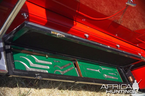

    Hey, I gotta do something while I wait for the upholsterer! Ken (the upholsterer) is coming tomorrow at 9:00 for a consult. I hope he says everything is good. Meanwhile, I'd like to finish the driver's running board. You can see the concept I'm going for in the pictures. I've got the basic thing done on the p***enger side. The interior will be lined with felt so I need some wood in there to glue to and hold the hinges and latches. Each piece has to be hand fitted because the angle has fillets and there are welds that get in the way. When the car is finished (when will that be?) I'll spend my idle time snooping around flea markets for interesting tools to cut out precise places for in the running board tool boxes. Or maybe that's where I'll have a complete cooking kit with knives, forks ladles, wisks, pots, pans ****es.... Or maybe a Thompson submachine gun and a couple of .45 semi autos.

  20. Jack Innes
    Joined: Nov 26, 2010
    Posts: 178
    Jack Innes
    Jerry,
    There is a RR Ghost around this area that was built for some Arab Warlord in the teens. It has similar running board boxes with fitted compartments to hold elephant guns & ***ociated ammo etc.
  21. nitrobrother
    Joined: Dec 24, 2004
    Posts: 4,379
    nitrobrother
    Do you have some stainless planned for the inside of ice box? Or did you size it for one of those throw-away styrofoam ice chests from WalMart? :)

    I'm looking for some vintage galvanized sheet metal with the really big flakes on it to make the inside out of. Maybe some old roofing would do.
  23. nitrobrother
    Posts: 4,379
    nitrobrother
    OK, hope that works out for you. Maybe get some that's pretty much oxidized and covered in bird poop.
  24. Ned Ludd
    Joined: May 15, 2009
    Posts: 5,589
    Ned Ludd
    I love running-board boxes. One doesn't see enough of them these days.
    If the '31 ever starts happening again I want boxes behind the front wheels, about as far back as the A-pillars. I had the idea to twin-turbocharge the engine and hide the turbos in the boxes.
    Voisin liked to fit huge luggage lockers in that position. French coachbuilders Million Guiet had a style that had running boards "carved" out of full-length pontoons, with either lockers on spare wells in the forward part. Less imaginative iterations of the running-board box idea could be seen on many quality cars of the Vintage era and directly after.
