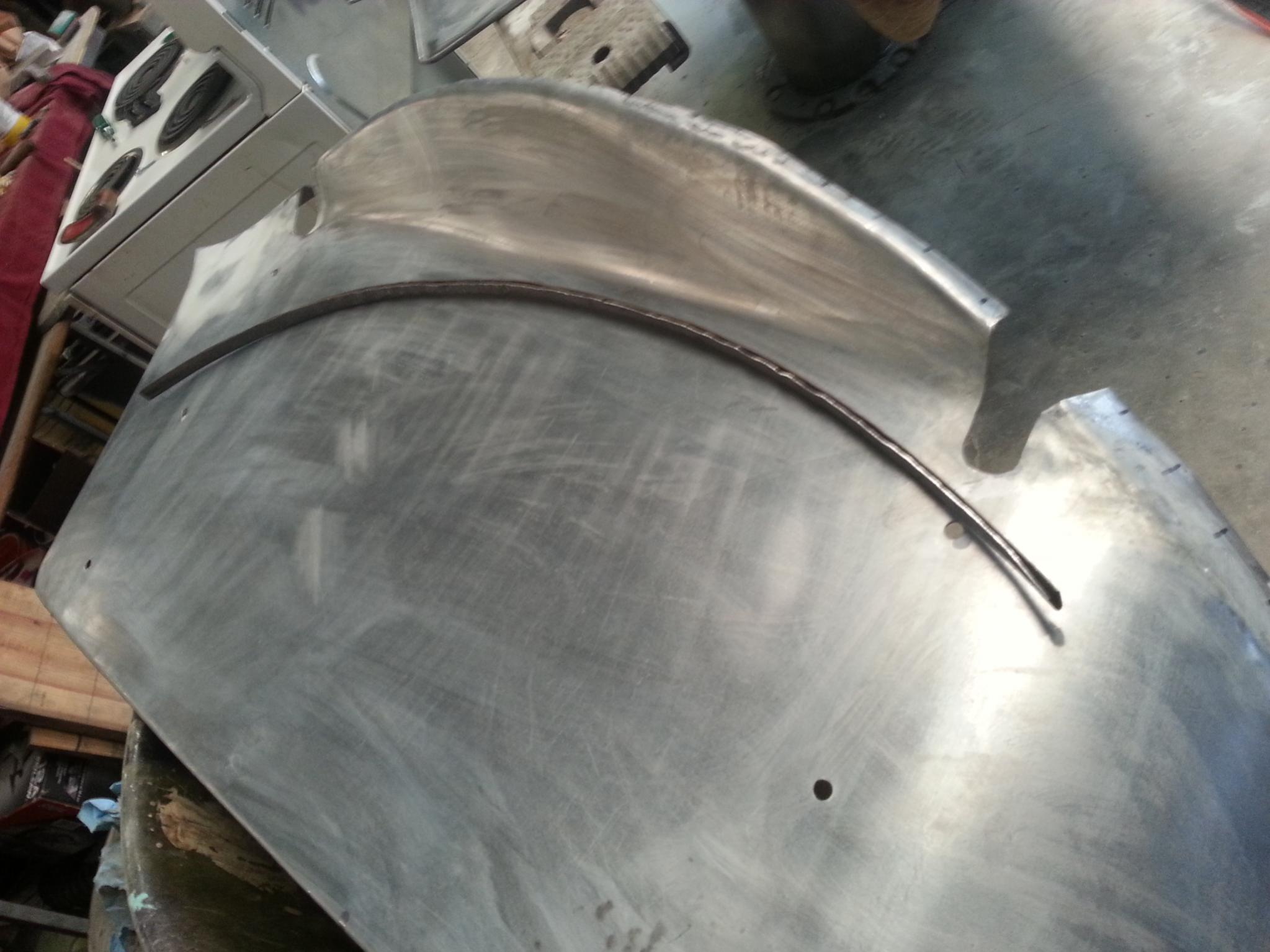

    No word from Ken. The fenders are pretty much done but the weather has not co-operated so no primer. (I spray outside) I forgot about the rear inner fenders so I dragged them out today. After a day of work the bondo is about done but I didn't like the raw edge that goes under the rear fenders proper so I experimented and made up a trim piece. It came out kind of nice so I think I'll add it to the other inner fender as well.

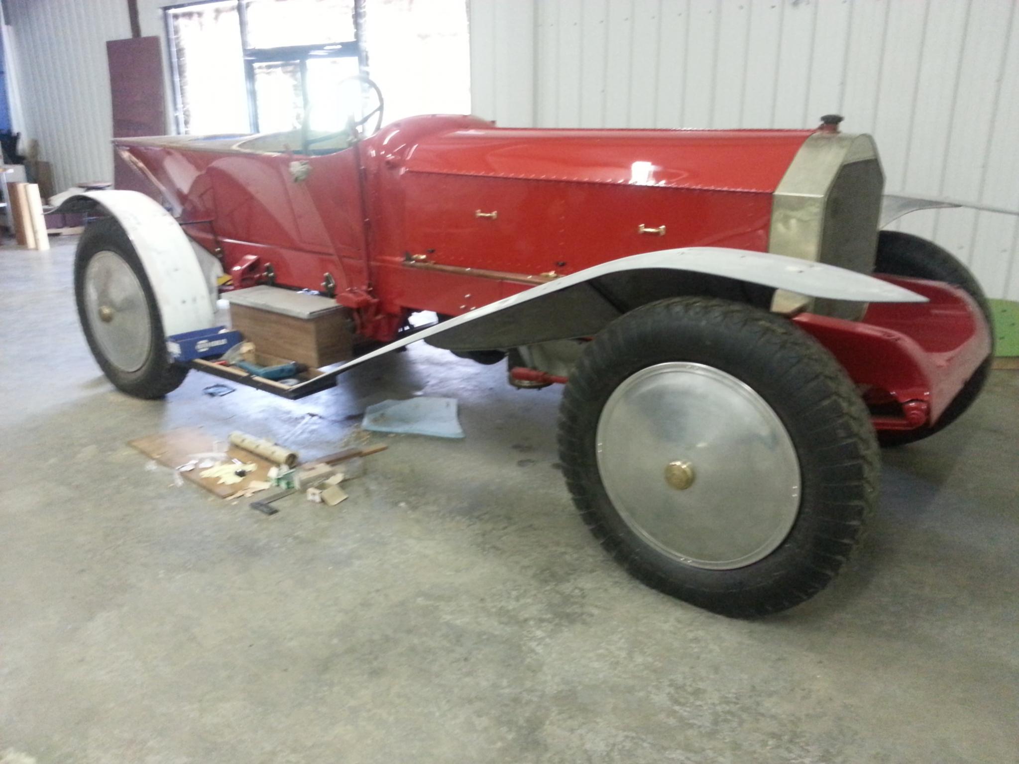

    Rear Fenders

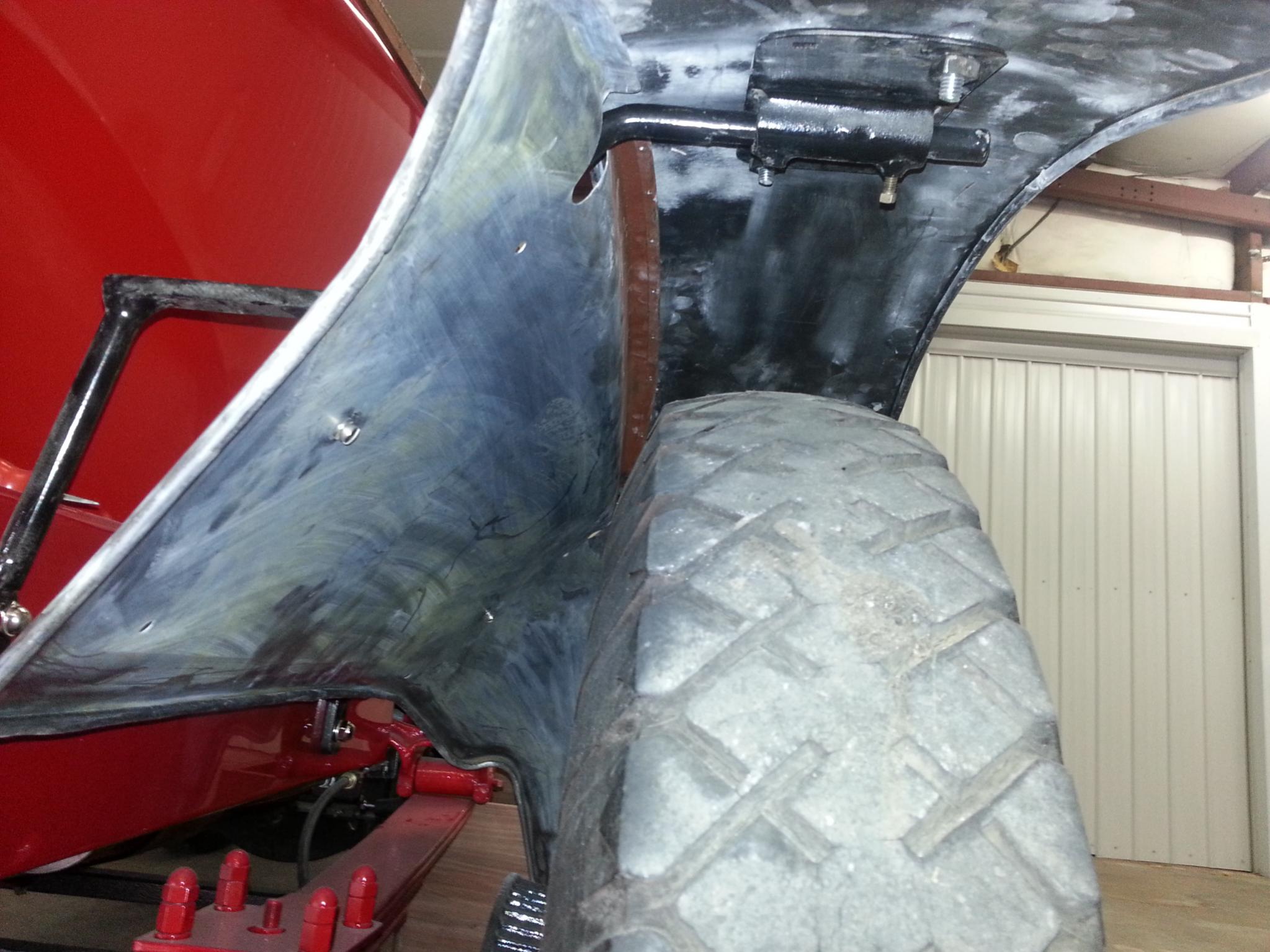

    So 95% of the body work on the rear fenders is done and I took them down to where the car is stashed to make a final fit. The right side went on real easy and looked pretty good but the left was a little screwy. Why this happens I'm not sure. I had everything fitted and aligned, then I took it off and set it aside for the winter. Suddenly the metal warped ever so slightly and the bolt holes lost their alignment. You can see the problem in the last picture. So do I elongate some holes? Or cut off the plate that supports the fender and reweld it in a different place? Well, tomorrow I'll get to the bottom if it. Unless the wife has a big day planned!

    Can you loosen (a lot) all the fender bolts and get them all started? If it fit last year it should fit this year, right?
  5. carriage bolts must have been tapered off center when fit and now are not in the same index

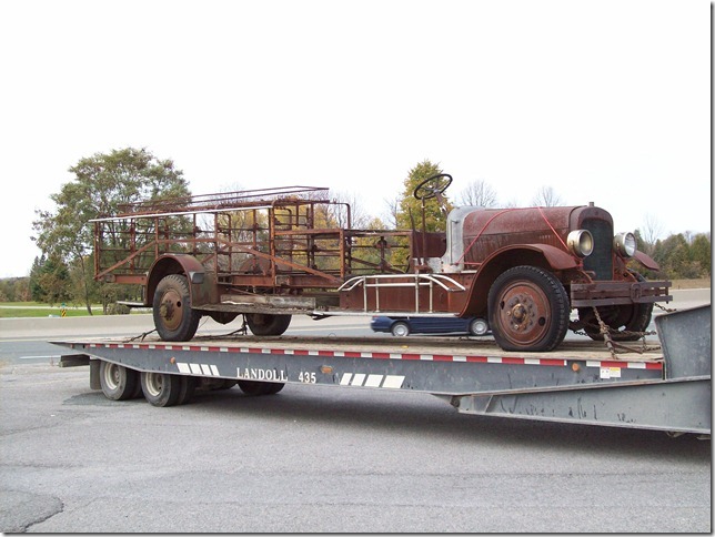

    Great idea! This Seagrave is still available;

    Yeah, that would be a bit too much I'm afraid.

    Jon the machinist borrowed my Trooper to drive while his truck was in the paint shop so I coerced him into welding up the top to the ice box. I was sanding down the weld when the belt on my belt sander exploded. It was only about 20 years old. So I moved on to the fenders which was more important anyway. I finished putting the binding on the raw edge of the rear inner fenders. Making the binding was a challenge. First I cut a strip then folded it in half. Then I put a broken band saw blade inside of it and ran it through the English Wheel. The band saw blade came right out and I had a neat u shaped piece. To bend it I put the blade back inside. The first one I drilled holes to spot weld in but that didn't work so good so I just tacked the edge. If the weather warms and the wind dies, I'll prime everything and do the final spotting.

    Anyhow, that Seagrave would need a second driver to get the rear wheels around a corner. LOL

    I don't know I am seeing a giant Seagrave flat bed to haul the Giant Seagrave speedster around with.

    I am afraid the point is being missed; you see you take the giant Seagrave hook & ladder truck, shorten it, lower the cowl & hood, overhaul the 1013 cid engine, whip up a boat tail body & fenders & a few other things -------------- well, just go back to post no. 1 on Jerry's build & you will see how to do it.
    No giant flatbed - drive it!
