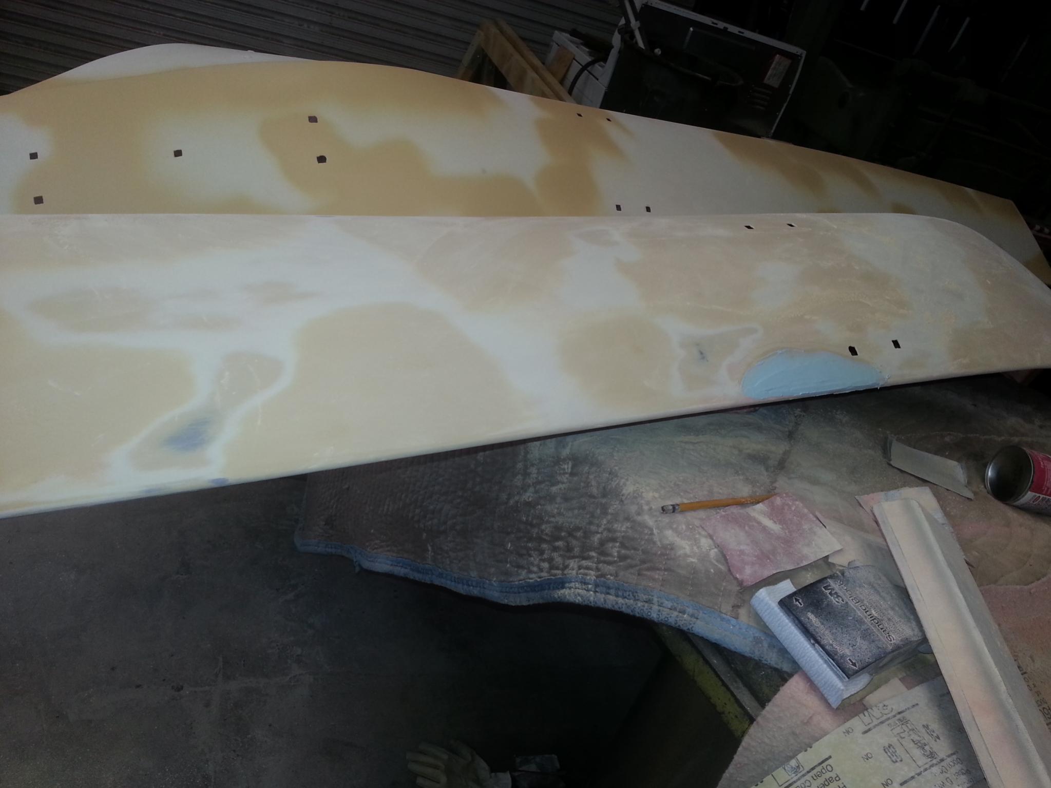

    I finally got the rear fender aprons ready to primer. Well, they're not really ready but if I waited until they were ready it would be next year. There's still a lot of nicks etc but I'll take care of them one at a time. I mean, how else can you do it? I used some pink paint left over from my daughter's pinewood derby car to dust on the primer. Tomorrow the blocking begins again.
    Jerry

    Guide coat for sanding.

    I use small pieces of tape when I block sanding to show me where the imperfections are that I have to go back to and fix again. makes it easier then looking it over and over. but just so this comment isn't total of track, I hear plaid covers a lot?!

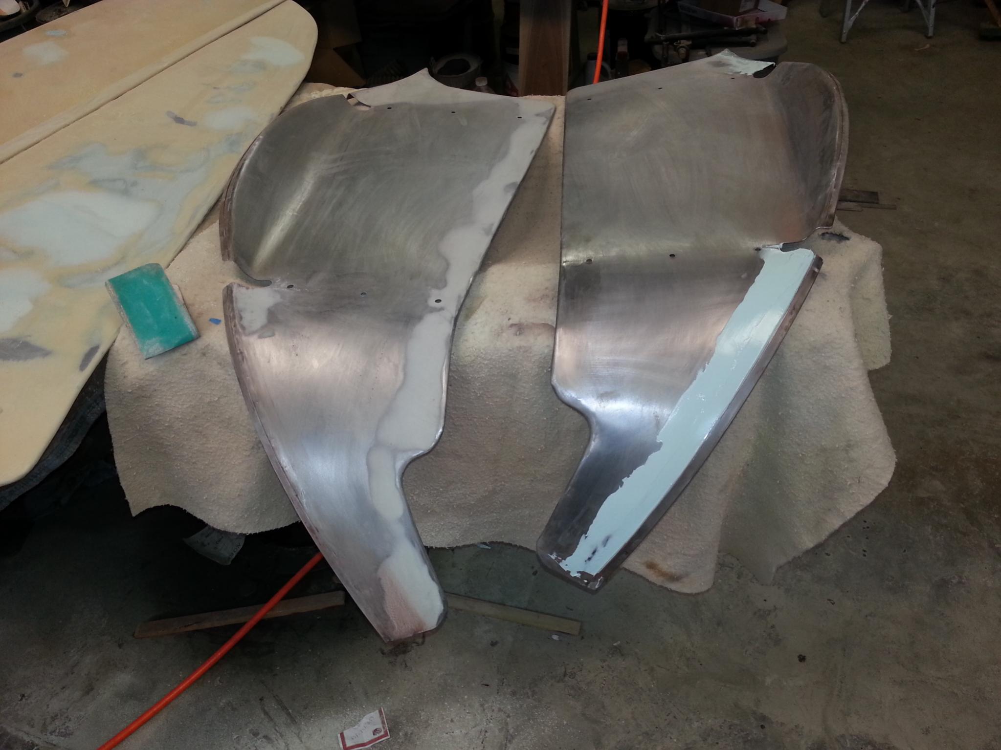

    When I had my shop about 15 years ago, there was this mechanic who worked for me. He was a real good diagnostician. He'd smoke his pipe and think over engine problems. Anyway, he hated the beach--said he couldn't stand getting sand in his crack. Today I had a similar problem. I had to sand my crack--the crack between the fender apron and the fender. Tough to get right down deep in there between the cheeks so to speak. I finally wrapped a piece of 400 around a knife blade and worked it back and forth. Hey, that might be a cure for hemorrhoids!

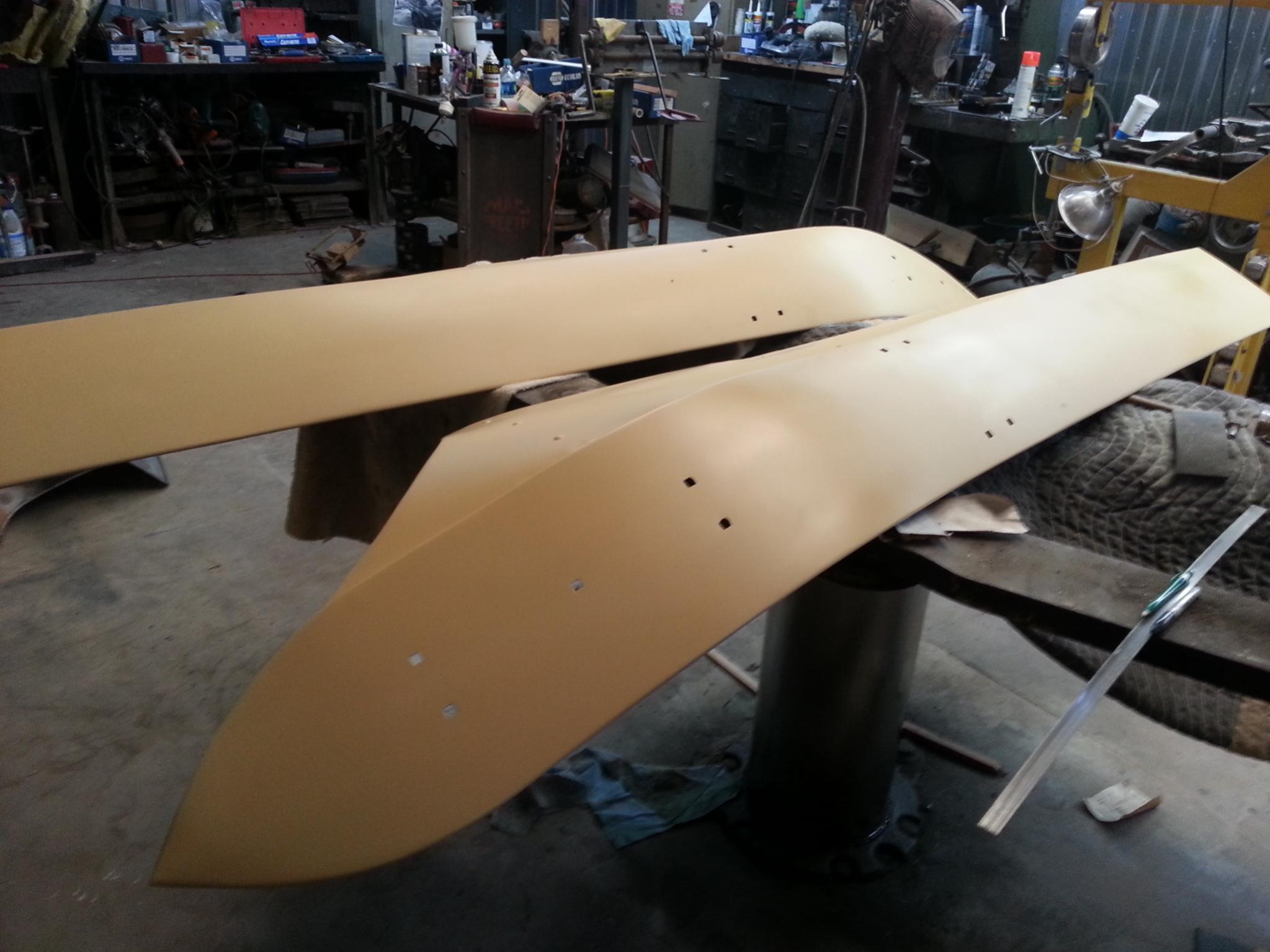

    Got a call from my mother in law last evening. Her garage was on fire. That was interesting. There were no cars in it but the building was damaged heavily. Nice to have insurance. Otherwise, I began work on the rear fenders filling and priming. I couldn't do this for a living. We're getting close. I'm looking for another upholsterer since I haven't heard from Ken.

    I finally got in touch with Bruce and he said bring the fenders by. Great! I'm tired of sanding anyway. To celebrate I worked on the ice box lid. I had to grind off the welds but that didn't work so well so I machined them off with the milling machine. Then I got out the lowly, disgusting, hated belt sander for the final touch. I still need to polish but the the hard work is done. Tonight I ordered an aluminum piano hinge.
