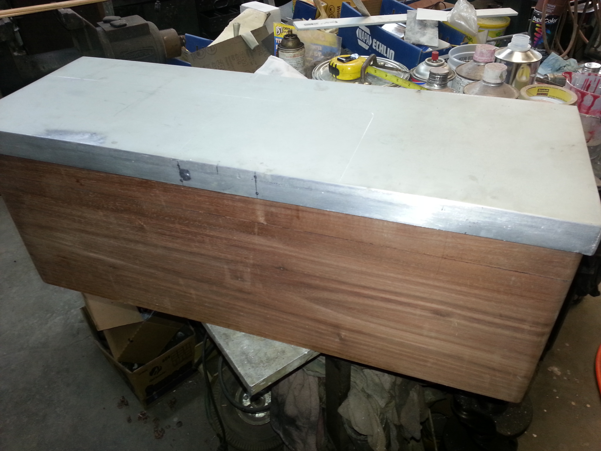

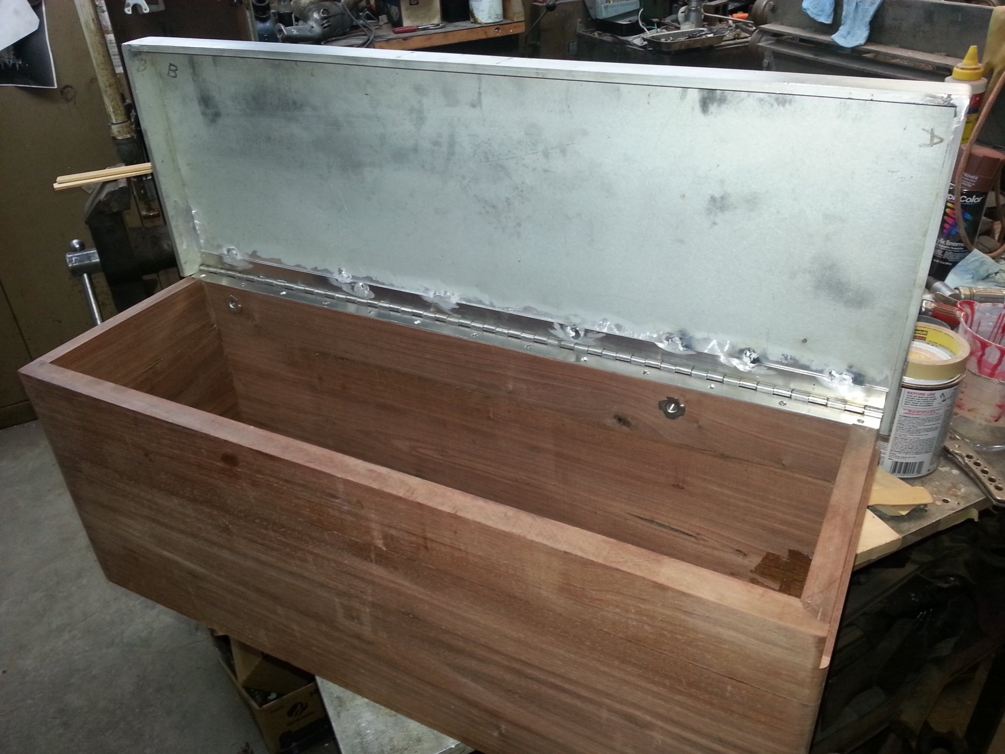

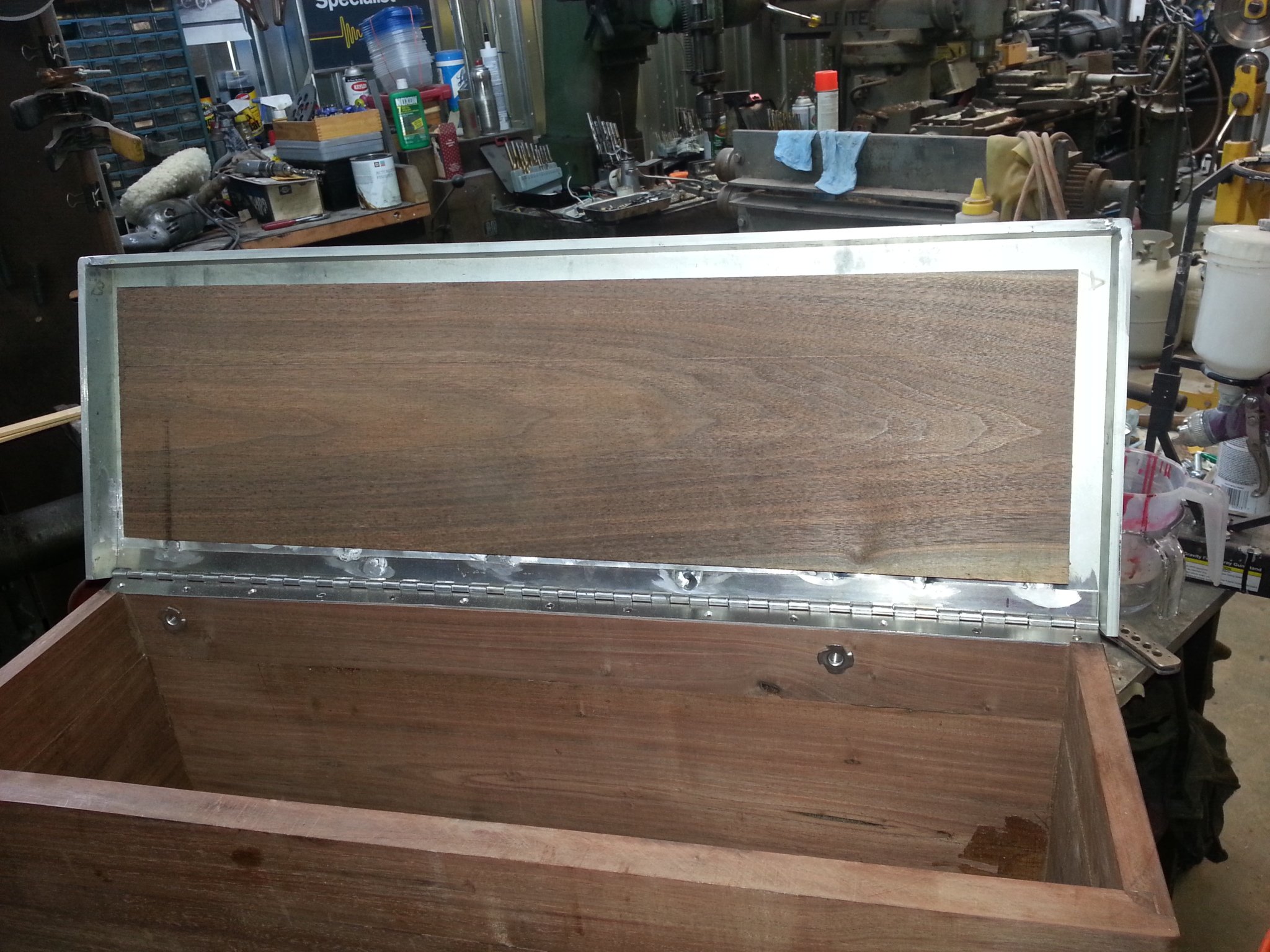

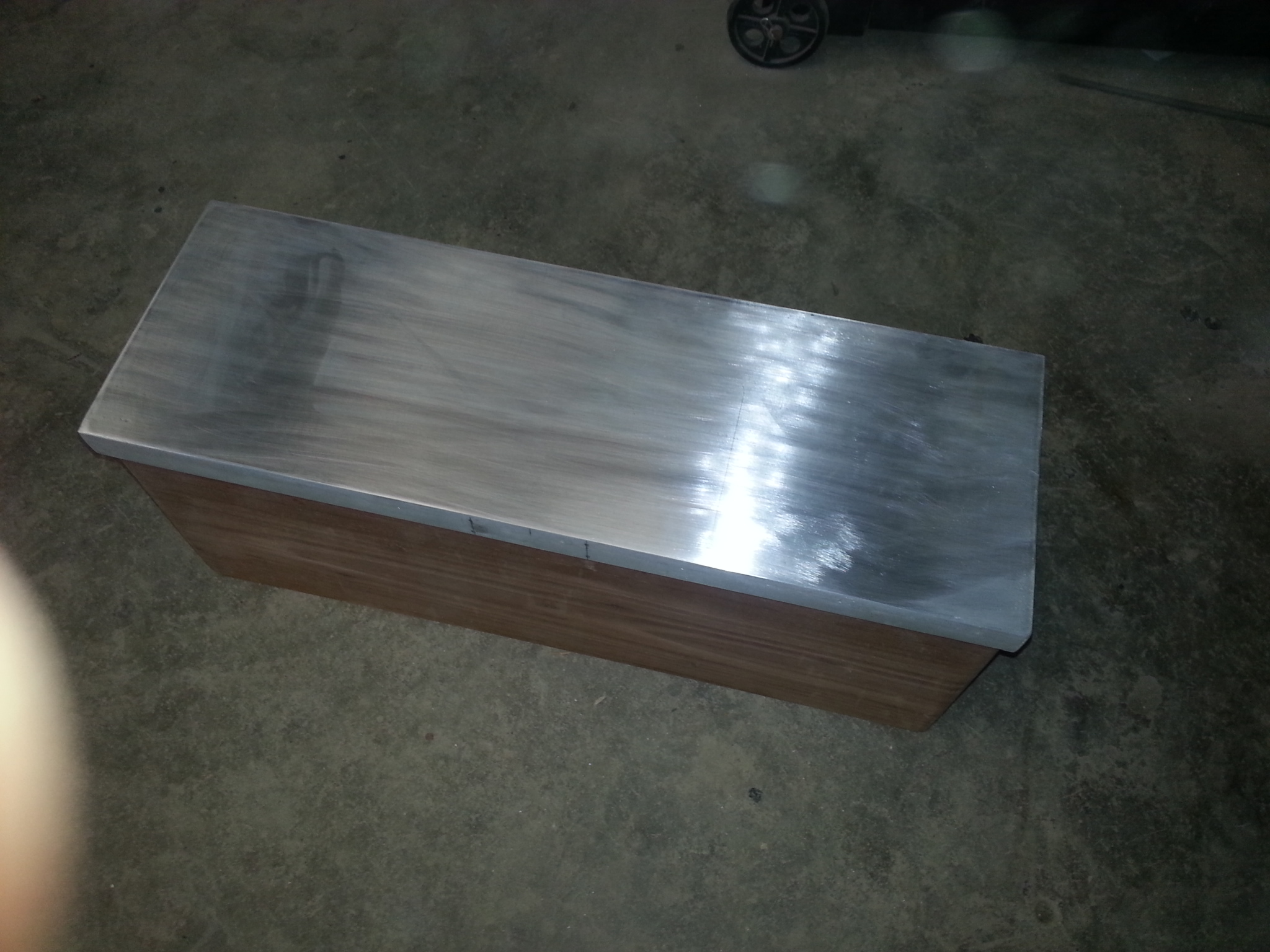

    Sounds kind of empty. Is anybody there? I'm trying out the new picture set up. I forgot where I was so here I am now. The icebox has a lid and I'm going to spray some clear on it. The fenders are at the bodyshop and I need an upholsterer. Once the fenders are on all I'll have is a bunch of little stuff. Of course little stuff can be fun.

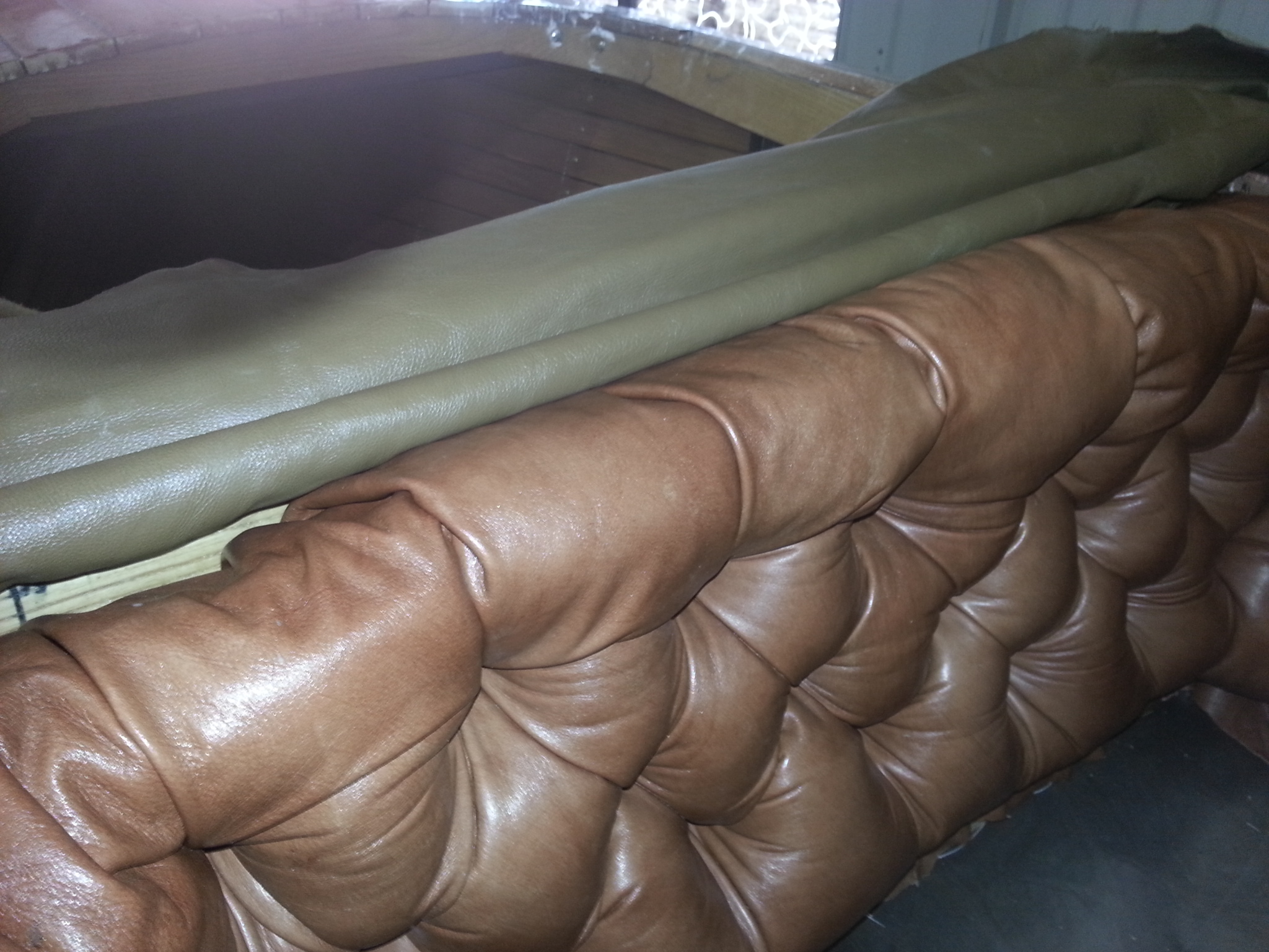

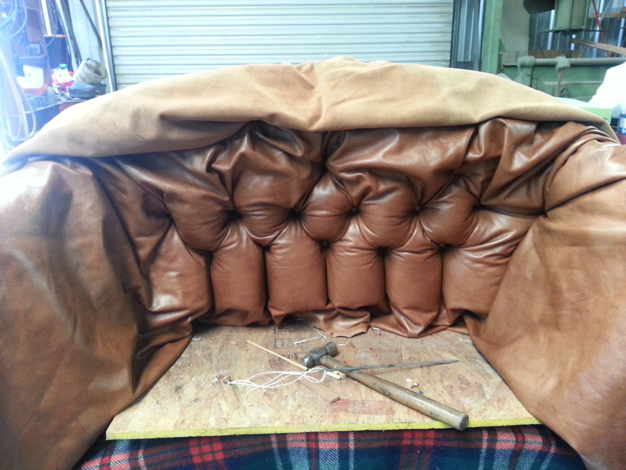

    Okay, so I can't find an upholsterer. I'm back to doing it myself. I discovered that if I used this nice soft leather I have I can damn near make the ****on tufting by just pushing in the leather and working it in the holes. Take a look. I'm going to do the whole seat without even making the first hole. Then if it looks good, I'll make holes and add ****ons. Hey, it sounds good. What else do I have to do while my fenders get painted?

  7. The upholstry looks good!
    I enjoyed the movie of your life, though six hours long was too much.
    Plus they shouldn't have picked Pee Wee Herman to play you, otherwise I liked it.
    I'm can't wait to see this beast done, I just hope I live long enough!
    Keep us posted!

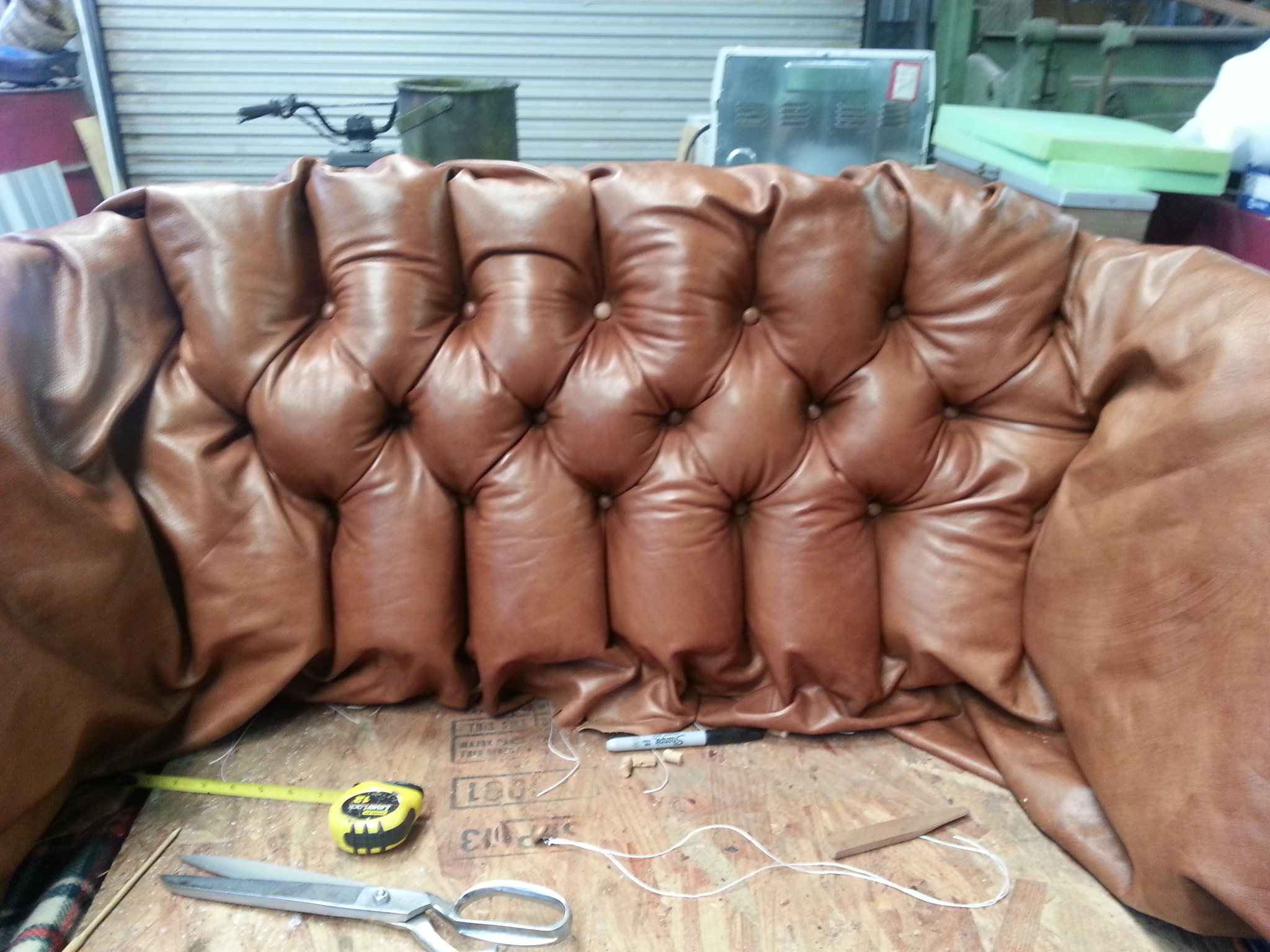

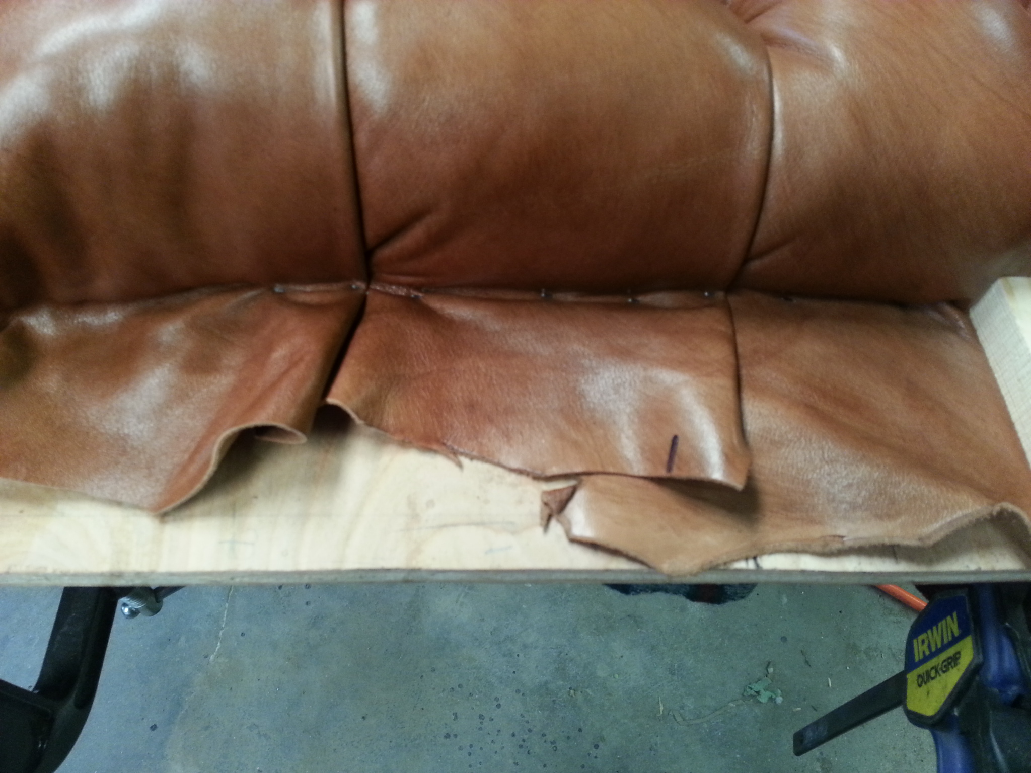

    I layed (laid?) out my matting and stuffed some green fiber under it between the holes. Then I spread out the leather and began to poke it into the holes. As I was trying to get up enough nerve to drive a needle through the leather I remembered I didn't have enough ****ons so I went back to ****on making. I got my ****on making stuff a Hershey a number of years ago. The leather is kind of thick but I think I've got the hang of it now. After about 3 hours I had 18 ****ons. A pro could do better but the thickness of the leather slowed me down. I need around 35 ****ons. The pictures came out in backwards order so start at the bottom.

  11. SUPPLE LEATHER ..... POPPING ****ONS ...WORKING IN THE HOLES ... WHY NOT USE THE SAME LEATHER the retired upholsterer here said just now loudly ....when viewing the pix she said wiggle the finished ****ons they will come apart if not held together now

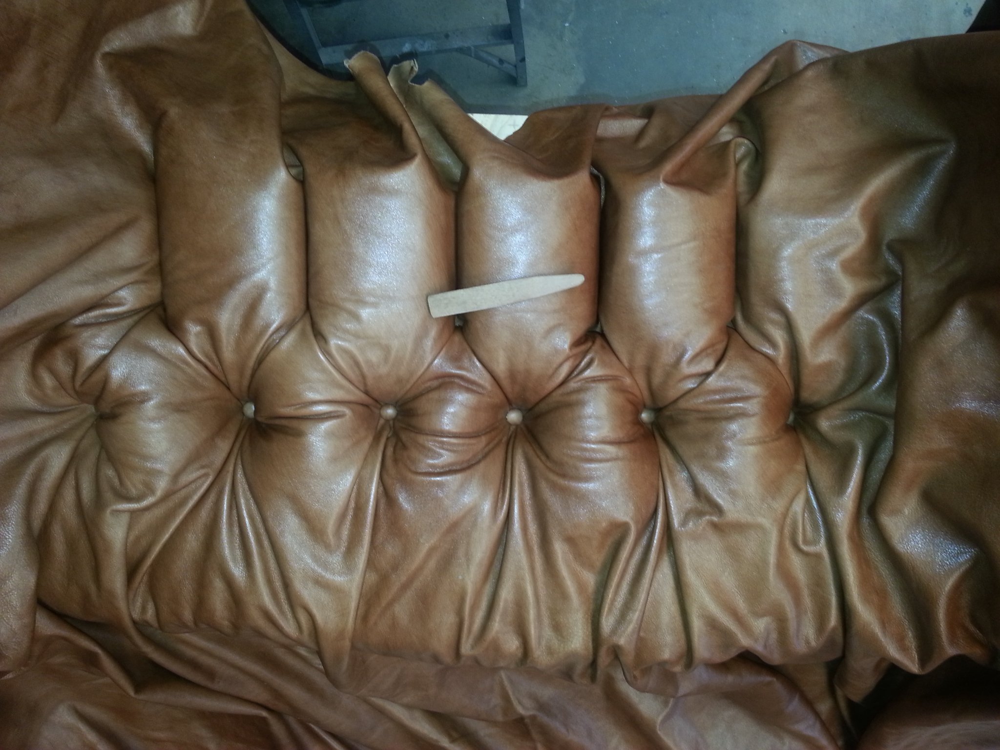

    If knew what I was doing I'd have this seat done. Kudos to guys who can really do this stuff. There's a video on youtube of a guy ****on tufting a high end couch. He's like a machine, poking his needle, tying off his ****ons, stapling off the leather. Wow! My diamonds aren't so straight but then I'm not done pulling and tugging and stapling. I haven't even stapled the strings in the back because I'm afraid I might have to adjust them here and there. The real upholsterers are laughing. Hey, I'm saving $500 so I can live with a few flaws--okay a bunch of flaws. Only tall people will be able to see into the ****pit anyway. The sides of the seat will be the challenge. That's tomorrow.

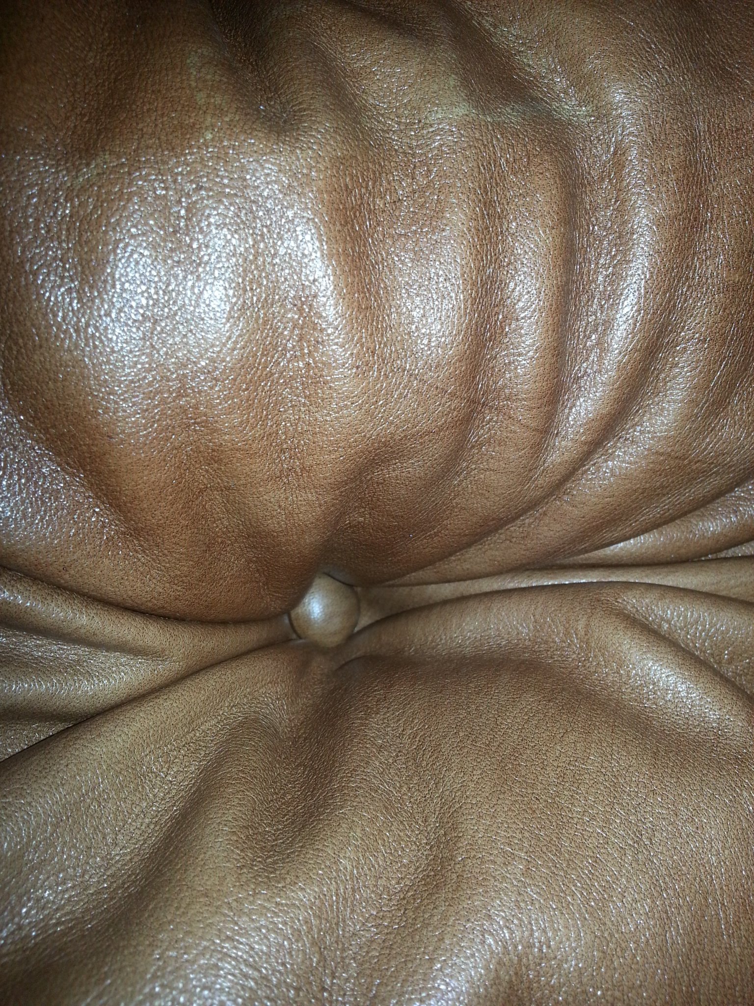

    It's been a busy but I've been able to sneak into the shop and work a few hours. Most of the time I just stare at the seat or maybe measure or draw lines on the foam. As you can see, I get the lines wrong and have to fill in my holes. After I get up enough nerve I poke a hole in the leather and push through a ****on. It averages about one ****on an hour. The leather is coming up a little short on the right side but I've got a plan for that. Turning the corner is the hardest part. The diamonds are no where near as perfect as I'd like but when I staple up the top and bottom I think I can hide a lot of sins but pulling this way and that. Let's hope so.

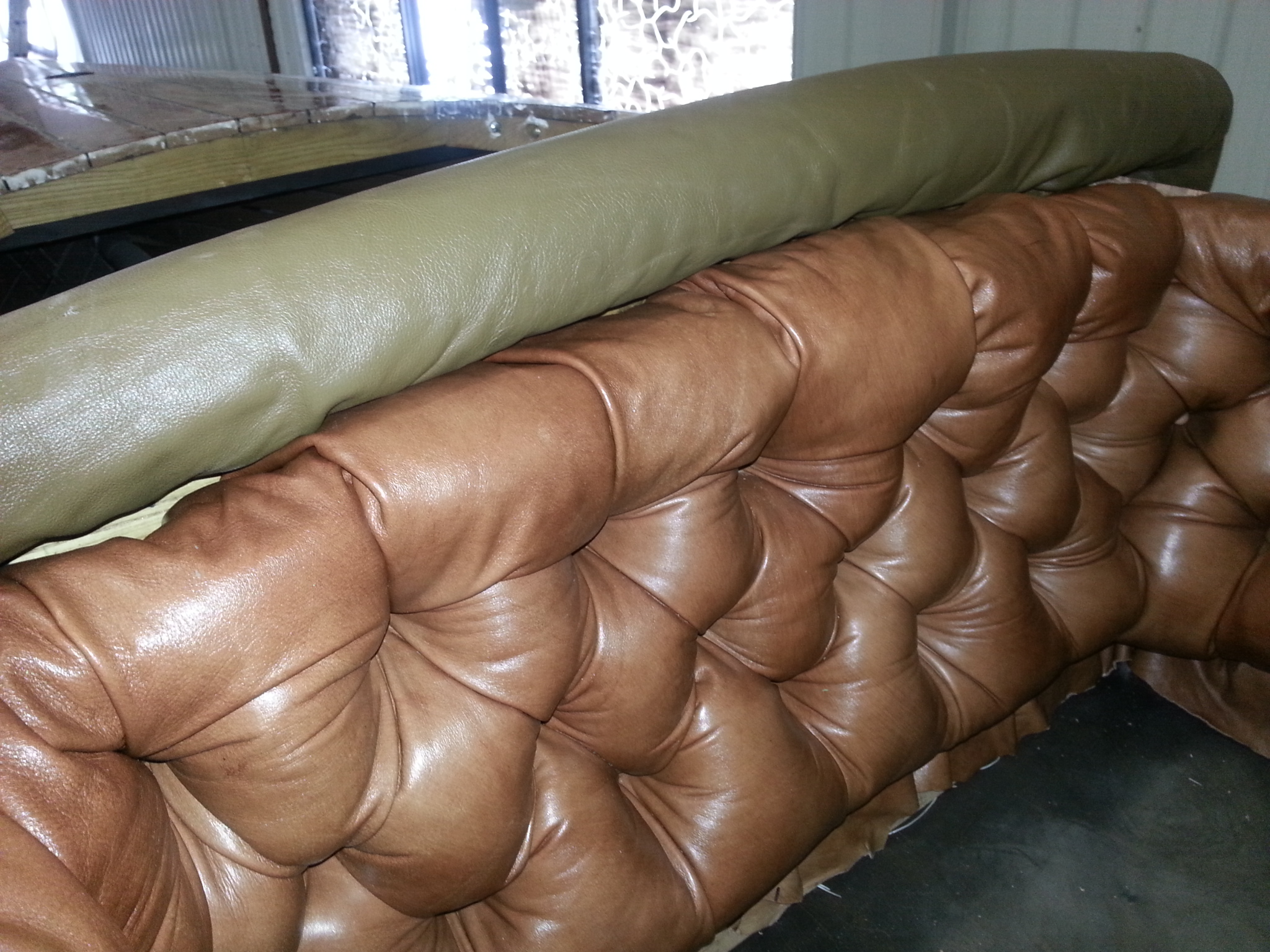

    I stapled down the bottom of the seat then took it over and set it in the Seagrave. There is one big problem. (Notice how there are always problems.)
    I'd really like to use only the medium brown hide for all the leather work. That means that beside the main seat, the seat bottom, the roll around the ****pit and the door panels all have to come from one hide. If I can't get it from that one hide, I'll have to highlight with leather from the different colored hide IMG_20140530_134623.jpg IMG_20140530_134527.jpg IMG_20140531_150629.jpg IMG_20140531_150728.jpg . It won't be bad but it will complicate the situation and tax my creative powers which are already barely functioning. So I stuck in the seat and checked the fit of the seat bottom plywood. Then I played with the roll around the top. I laid the other colored leather up there just to see what it would look like. You can give me your feedback. I haven't stapled the top of the seat in place so it looks funky. I can't do that until I know what I'm doing with the roll above it.

  27. stay seated until all movement ceases...
    the excess from your back cushion should be enough for your roll .. another color /or fabric(vinyl) can be sewn to it to do the pulling and stretching and be hidden or cut off after securing....and if vertical seams are needed in the roll ..so be it... evenly spaced or put where the back flows into the sides will look fine cows are only so big use up all the hide s****s that matches and the use of other colors in areas tha are not facing outward .... oils and liquids(blood) spilled can help blend colors...... your local old time shoe repair store can match colors for you.. if they can match colors in womens shoes to match gowns ...a few shades of brown no problem ...
    in my my opinion do only the seat back, bottom, back roll... in the same color .like a piece of furniture its separate .. the doors and the rest should be aluminum- metal -wood with a fabric pocket(if any)its a door dammit!
