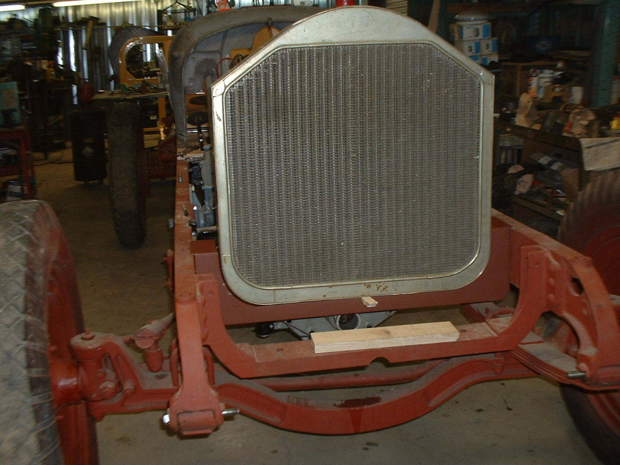

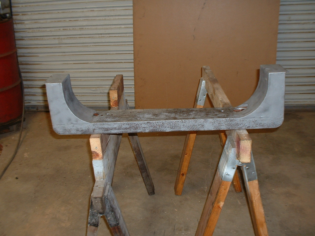

    Radiator
    I spent all day working on the crossmember to support the new radiator--cutting 3/16 metal on the bandsaw, welding it and grinding it. The first two processes are all right but the grinding is hell! After doing all I could stand I bead basted the thing and sprayed it with metal prep. It'll need a little bondo to make give it that cast iron look. I want that radiator in position because that means I can start working on the hood. The hinges have just arrived courtesy of Redneck Trailer Supply. $10 each. I thought they were a bargain. Think of how good it will feel to sit in the seat and gaze out over that 5 foot hood.

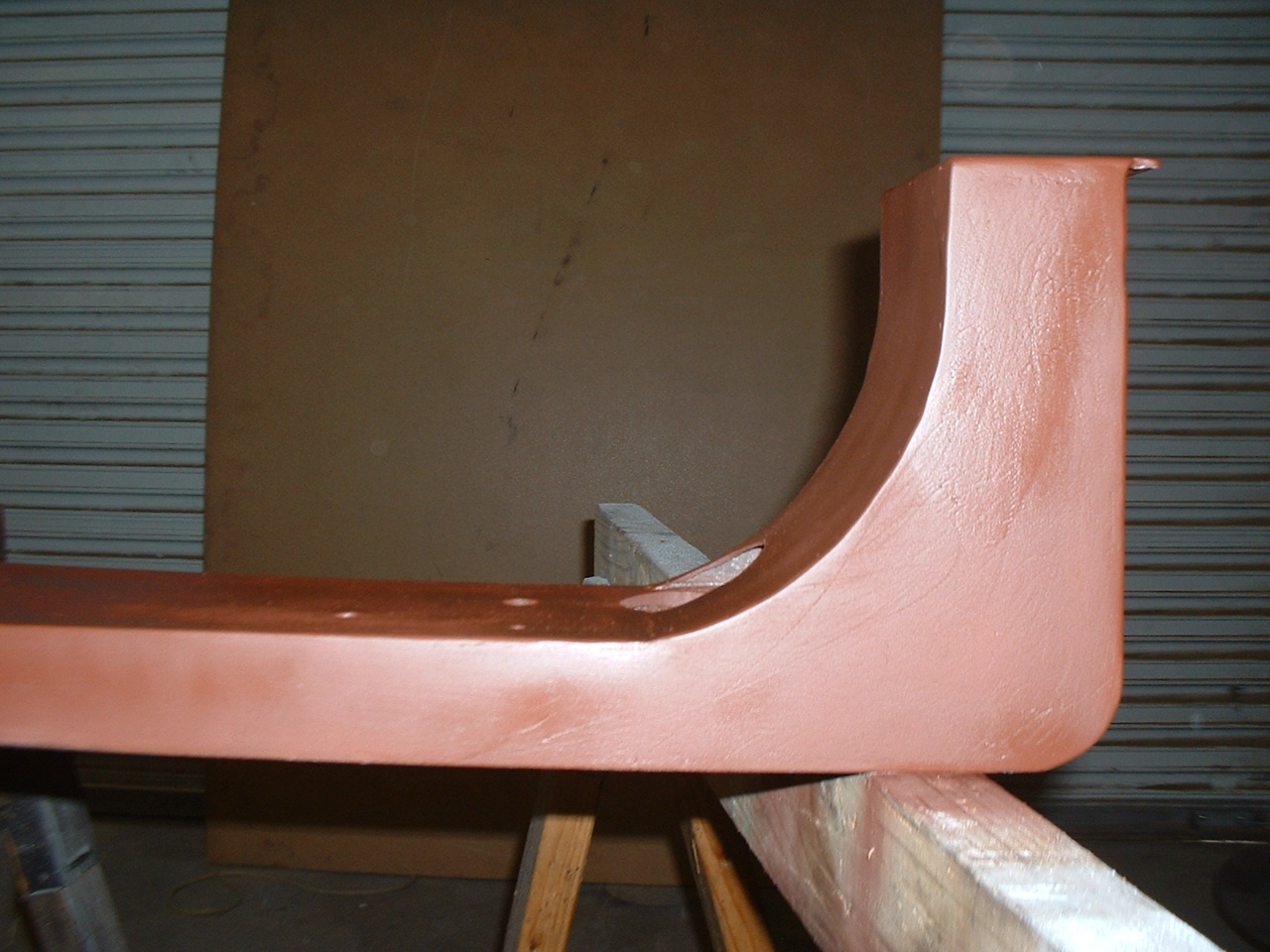

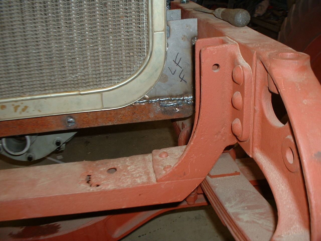

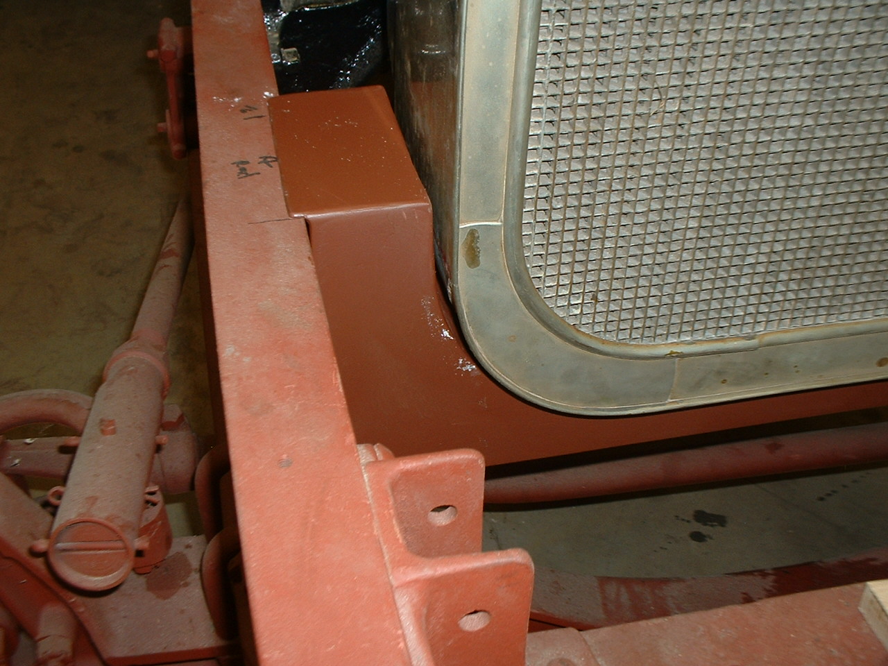

    Bondo
    The rodders friend. I bondoed up the radiator support then coated it with my old friend Bull's Eye Shellac. After some red primer, I mounted it in the ch***is. The radiator fit into it perfectly and the measurements from the cowl were perfect. Next, I'll drag out some metal and try to cut out the upper hood pieces.

    Jerry, do you use the shellac to seal the bondo?
  9. yonahrr
    Joined: Feb 27, 2010
    Posts: 1,348
    yonahrr
    You bet. The shellac seals the bondo and eliminates that line between the bondo and the steel. I love that stuff.

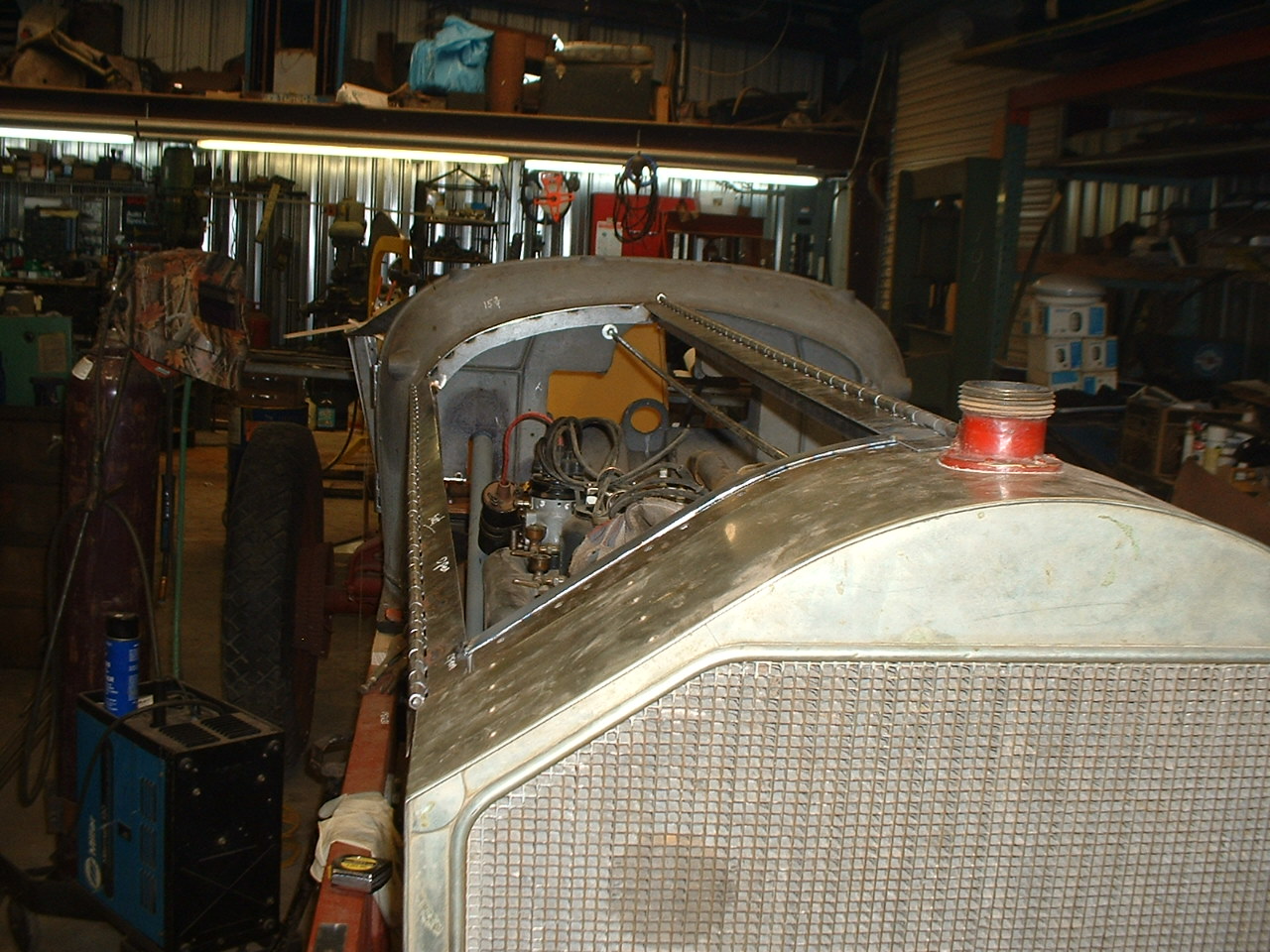

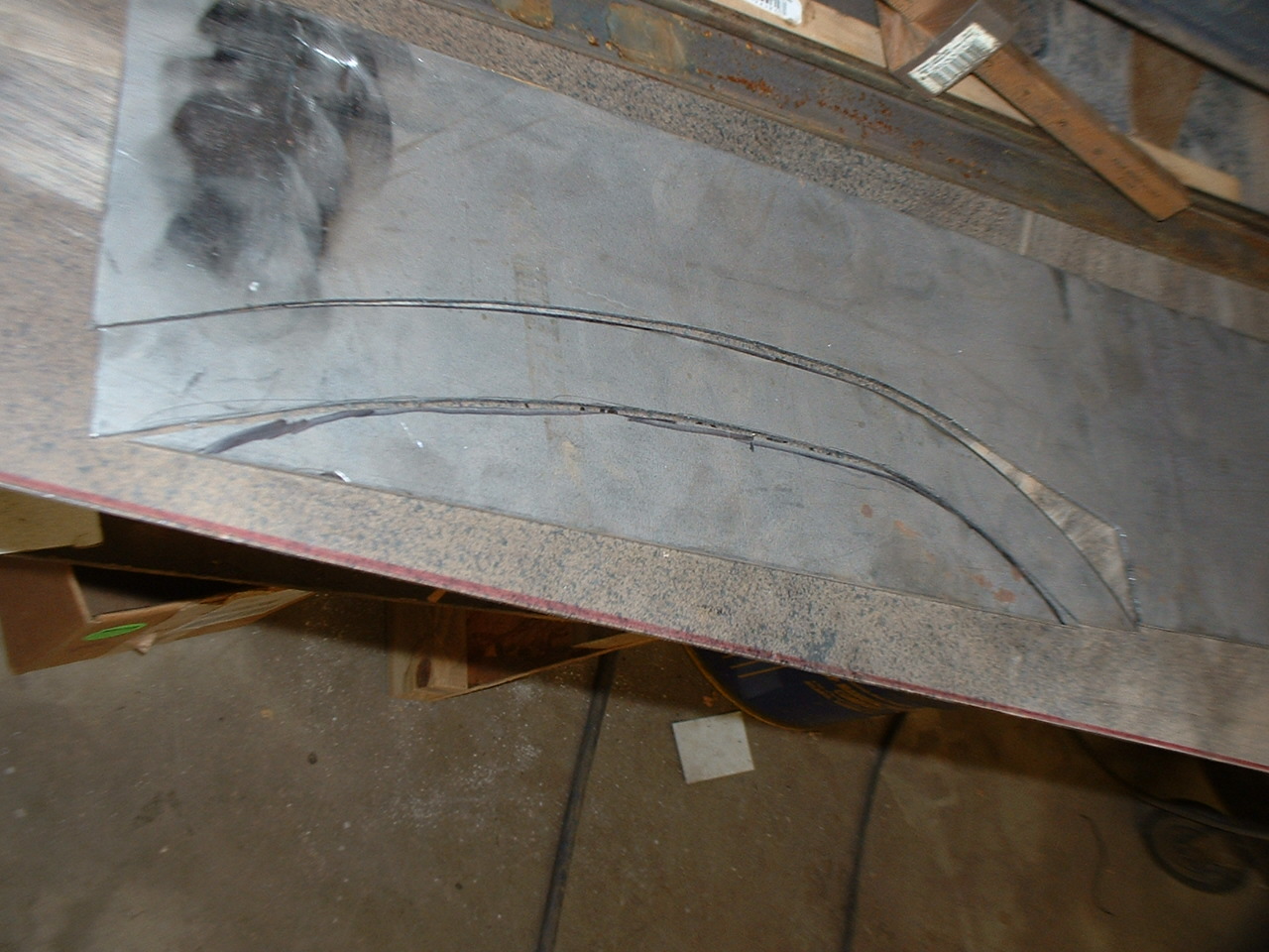

    Hood
    After thinking about how I was going to fashion the hood for a few days I realized it'd be better if I just jumped in and cobbled something together. The problem is the hood has two different curves, one for the radiator and one for the cowl. For a normal sized car I'd use my roll but it's only 42 inches long and therefore useless on a 66 inch hood. My buddy Don says I should take it to a shop he knows and have it bent on the press brake. It's a thought but I fear the brake will leave creases in the metal. Being a jump in with both feet kind of guy I thought I'd try curving the metal on my Chinese English Wheel. If you buy one of these from Harbor Freight be prepared to beef the thing up. Out of the box they are too flexible. You can see the pretty mods mine required. I've never used the wheel much so after a few minutes of see saw action I learned that while an inexperienced operator like me can certainly curve a piece of metal you run the risk of leaving lines in it and the curve may come out uneven. But since I used a piece of s**** I wasn't too disappointed. I also learned that the hinge line on the side of the hood is aesthetically very important. In most cars the hood fold is aligned with the car's beltline. But I made my practice hood to align with the cowl's original hinge point. An hour's contemplation told me the hinge line was a little too high. After fiddling with strings, sticks and a tape measure I picked a hinge point somewhat lower. Now I have to find someone with a big enough roll to do my 66 inch hood.
    Jerry

    I just learned something.

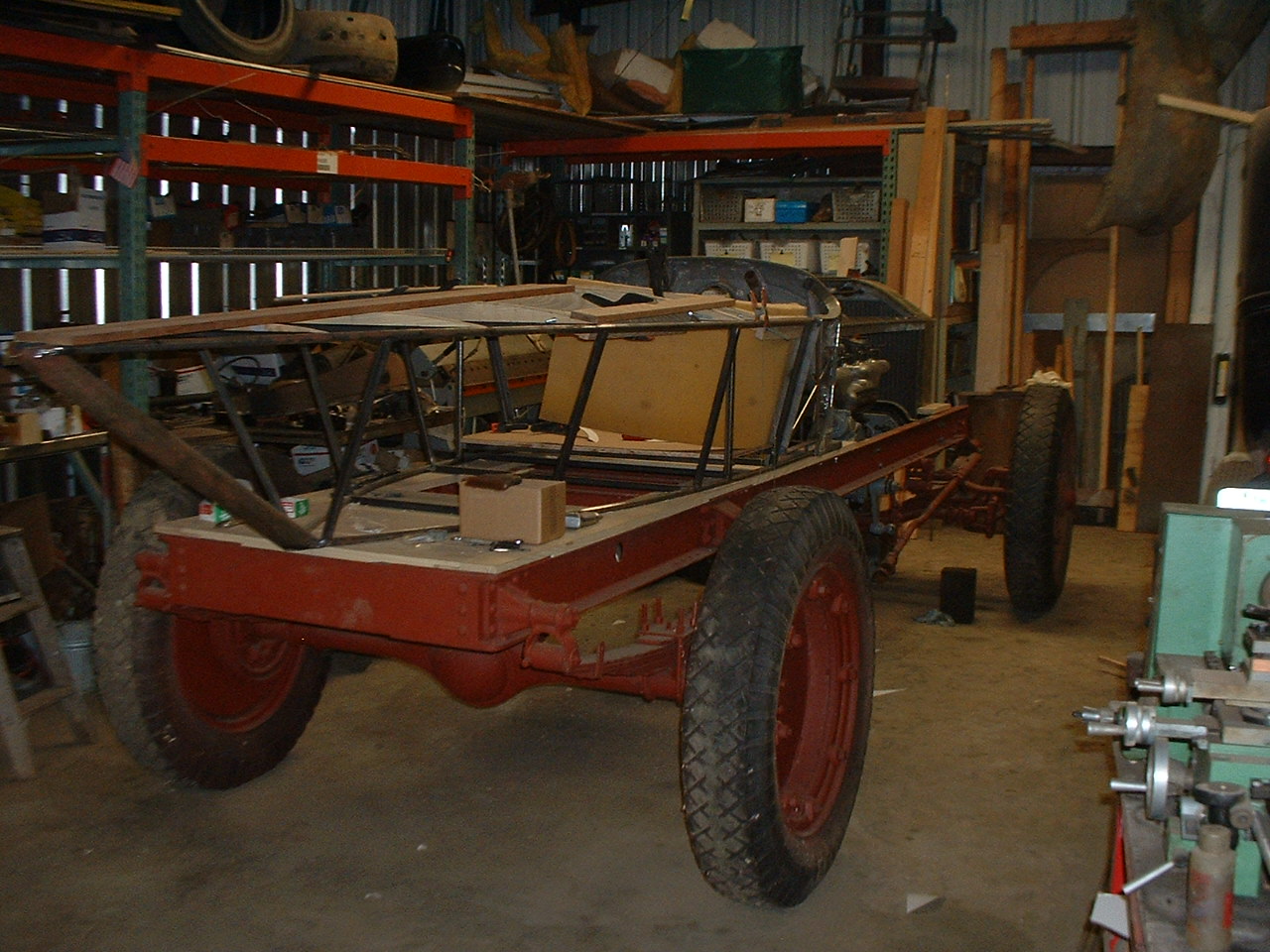

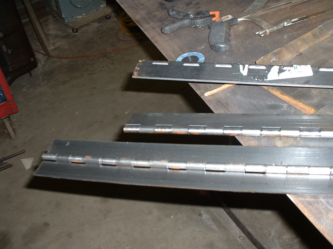

    Hood
    Okay, so sometimes I'm slow to figure things out. I tried to make a hood using 16 gauge metal and the stuff was just too thick for me to work with. After some thought I realized that if I made a framework for the hood I could used 20 or 22 gauge metal it would just about fall in place. Plus I could rivet it in and that would look cool. After some careful measurement I made a pattern each end of the hood then fired up the bandsaw and cut them out. On top of the curves I added some flat stock that I bent in place on the vice and welded that into position. I welded each end piece onto the hinges that I had already added a stiffener to so they wouldn't sag from their enormous length.
    Jerry
    <input id="gwProxy" type="hidden"><!--Session data--><input onclick="jsCall();" id="jsProxy" type="hidden">

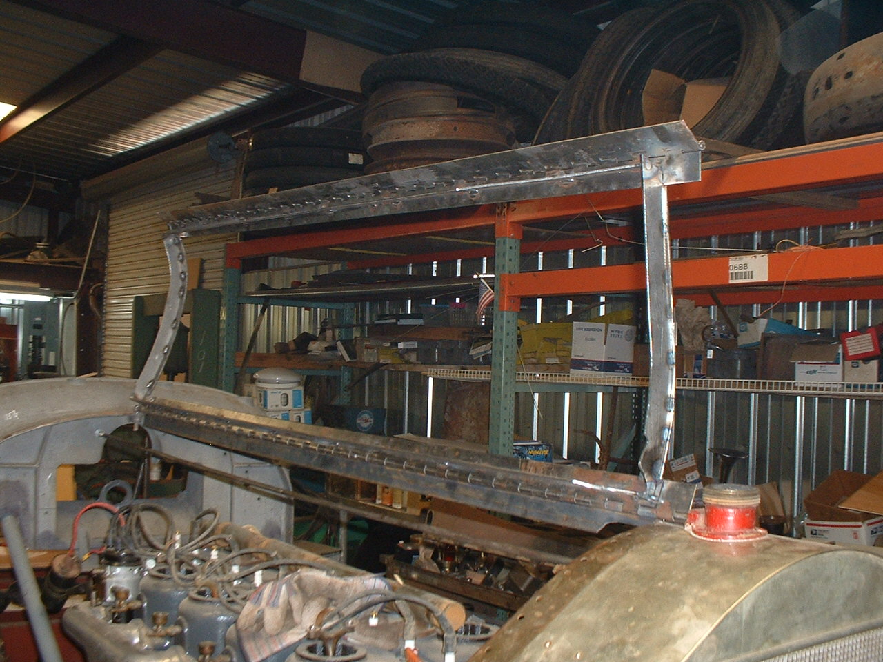

    Hood
    I tacked everything in place and it all worked quite nicely. One thing I learned is that when you weld a hinge 65 inches long it's going to curve on you. The first one I welded up bowed and I had to carefully tweak it back into position with the press. On the second hinge I pulled it down about 3/8" with a vice before I welded it. It sprung back perfectly. You can see the tacked together hood brace in the picture. I may add a second cross piece in the middle of the hood. We'll see how the sheet metal lays.

    Good lord! I can actually see this thing beginning to take shape. And to be honest about it, I'm a little bit frightened. :eek:
    But it's a good kind of frightened! :D
  26. captainjunk#2
    Joined: Mar 13, 2008
    Posts: 4,420
    captainjunk#2
    wow i like the hood frame and hinges , you have a good eye for creating a roadster from scratch great build thread
