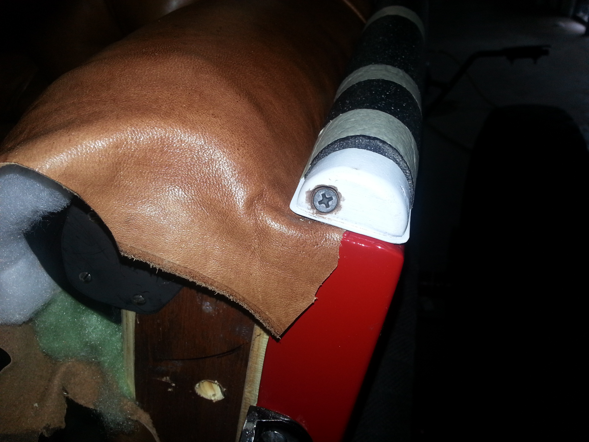

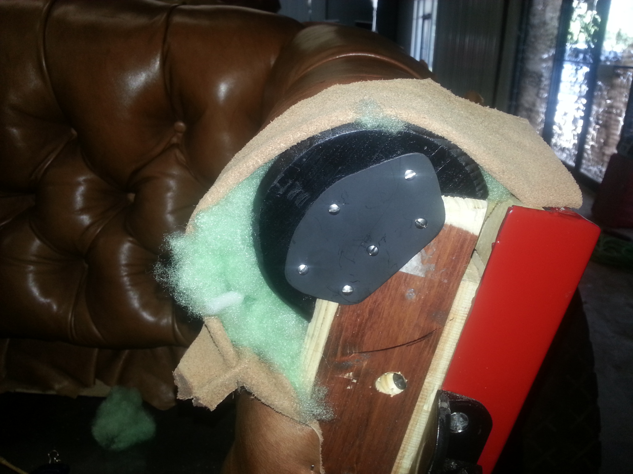

    If I have the nerve to get out the scissors and cut off the leather hanging over the back of the seat. I had to slack off the tension on the top row of ****ons. I also had to glue on some more foam--and round over the wood on the deck. This learning stuff is over rated. I also added the sides. I'll staple the leather to these wood pieces then add a leather covered metal trim piece to the front. The last picture is maybe a little close to what final product might look like, sort of, possibly, if it comes out kinda of close. Like Monty's comfy chair. Let's see--what else? I'll be at the flea market Sat. There is no belt take off on the flywheel. And then of course---- IMG_20140603_125830.jpg IMG_20140603_164746.jpg IMG_20140603_164759.jpg IMG_20140603_165304.jpg IMG_20140604_145306.jpg IMG_20140604_161436.jpg ---No one expects the Spanish Inquisition!!

    do not be afraid to staple a cord or wire along where your pulling then fold the excess back onto it self and staple again
    go ahead poke a hole in it with a forgotton pocketed screwdriver and get it over with..

    The roll inerts can be made from a hose, pipe insulaton , thick rope....the doors will take a beating fabric placement may be fragile near edges. THINK of where the wear will be........looking good for a Georgian ****on tucker. So Ken is no longer kneaded

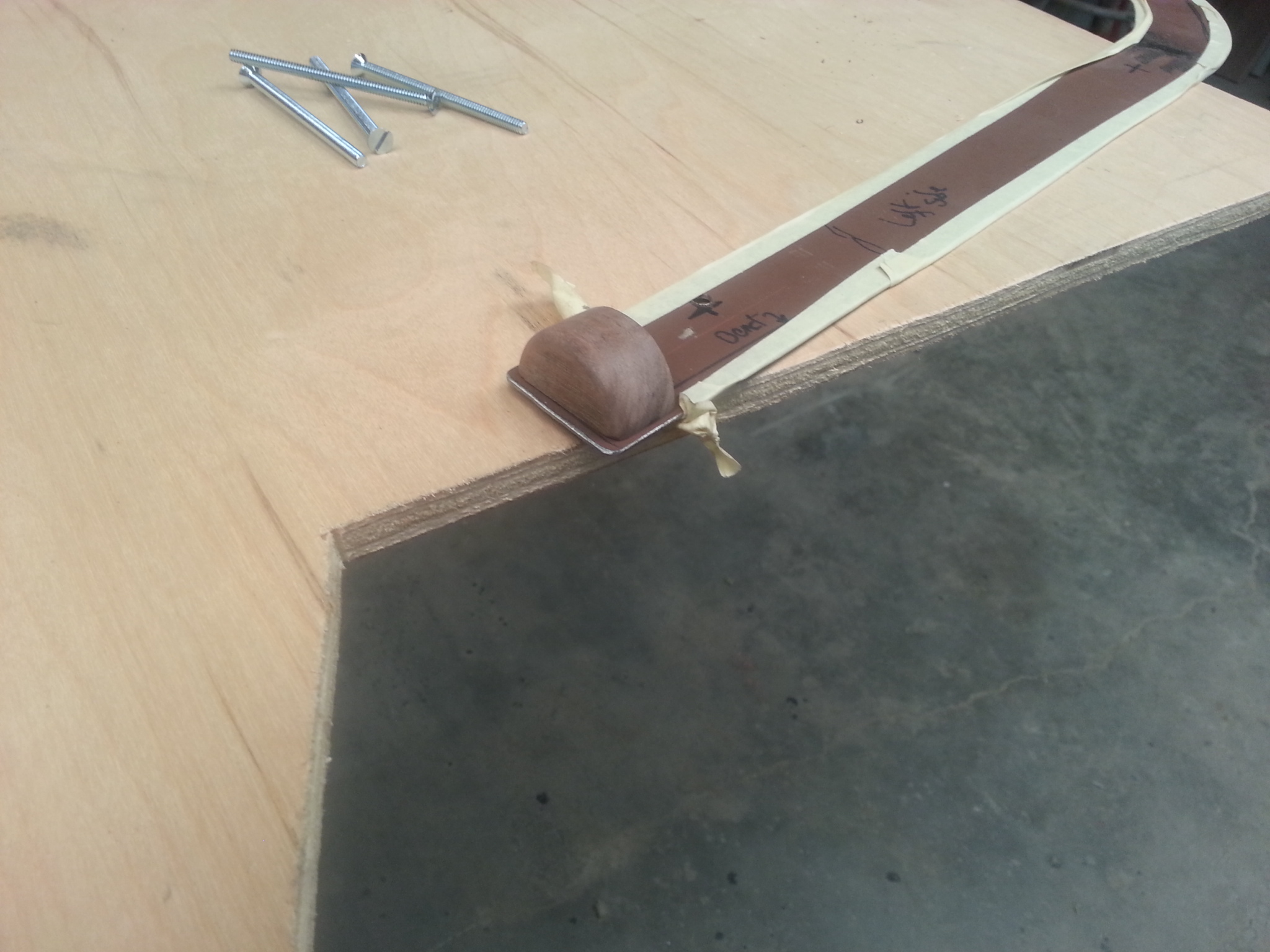

    Mostly today I drove back and forth between shops cutting and fitting pieces of wood for the arm rests. When I finally got them done I painted them. You're looking at the pics and thinking WTF?? You'll see how they fit in the next episode. While they were drying made a pattern for the door left panel. The right is pretty close to the left. Tomorrow, after I install the arm rest mod pieces I'm going to try and make a pipe insulation splitting device. I hope to use foam pipe insulation for the roll behind the seat. It's real hard to split it uniformly by hand. (I've tried.) I've got a vision for a simple device to split it. At the flea market I found a spare br*** gas cap for my 1914 REO speedster ($2.00) and a folding accessory rear p***enger windshield for my 1914 REO touring car ($40.00). But the neatest thing I saw was a 1943 complete US Army Signal Corps Field generator chest with tool kit, gas can, spare parts, instructions, generator, etc. $300.00 Cool!

    Electric carving knives or a band saw will cut foam with some accuracy...a hack saw blade /jigsaw-sawsall blade w/o a handle can work in tighter areas...carry on.. ..the cleverest G.B.T on the HAMB

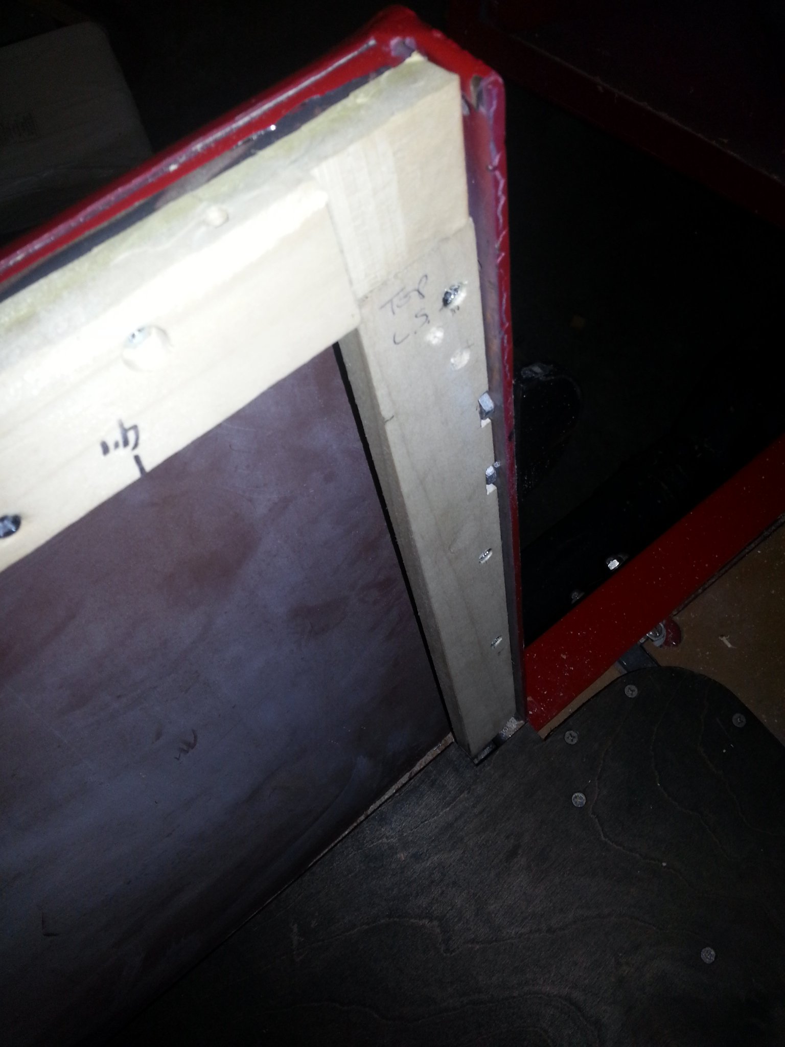

    My homemade insulation splitter worked but the insulation wanted to tear a little. The razor was band new so I'm not sure why it tore. Maybe it's ****. You can see how the arm rest piece fit in. I used a large tie wrap to staple through but I had to form it into the corners with a heat gun which I found made it a little brittle in places. The next thing is to figure out how to fasten the metal that will hold the foam roll down to the deck. After that I'll glue the foam roll to the metal and glue the leather to the roll. Good news: I think there will be plenty of leather for everything.

    That'll work easier if you wet the blade as you go. I've done this with rubber tube before & It does the same thing if dry.
    Generally, rubber and soft plastics cut cleaner and easier when wet.

    Probably cut cleaner if you had the blade angle set so that the tip followed the edge rather than leading the way.

    Oh, no kidding. The blade is angled wrong. It's forcing the plastic up against the wood as you pull, creating extra friction.

    Duh--blade angle!!

    But not for long. I changed the knife angle and the foam cut perfectly. Good work! Next I painted the steel and welded on some studs. I added some wooden pieces on the ends to have something to tack the leather too then temporarily taped on the foam. After that I went to see my buddy Chad at The Sign Shop. Chad has all kinds of neat stuff, and he gave me some
