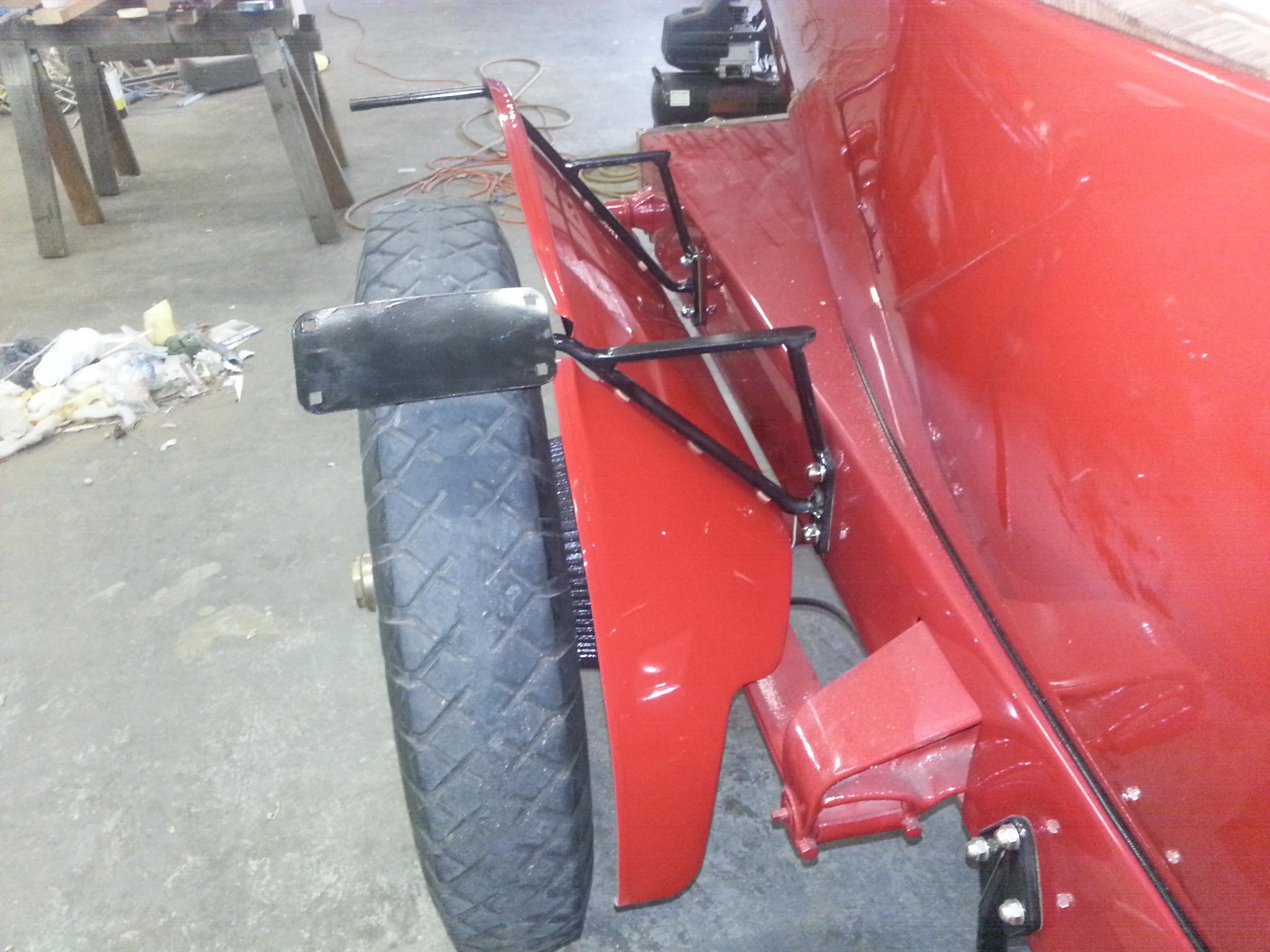

    I've been tinkering with the new box truck the last few days and it's finally ready to sell. My helper Kevin is painting the box today so I slipped away to install the rear fenders on the speedster. Of course halfway into it I got called away to fix an AC unit but that's another story. I didn't want the inner fenders to actually touch the fender supports because I figured the paint would just chip so I installed some leather washers between the two. I soaked the washers in oil because it seemed like the right think to do, and I always try to do the right thing. Well, almost always. Miraculously, all the screws lined up and fit. I just stuck one of the fenders on for effect. I think I'm going to squirt some black rubber caulk or black adhesive between the fender and the support just so there isn't any metal to metal contact. I'm also going to put some rubber caulk under the carriage bolts. Seems like the right thing. I had a missed call from Bruce tonight so I think the front fenders must be done too. This could be BIG!

    Jerry,
    I have used rubber sheeting like inner tube material between the fender brackets and the fenders on several installations. That is easier to reverse if you need to remove or adjust the fender. It would work under the fender bolts as well if you made the gasket slightly smaller in diameter so it does not squeeze out & show around the bolt.
    The fenders are looking great!!
    Jack

    I got to thinking about gluing the fenders in place. Maybe you're right, Jack. I ordered some rubber washers from McMaster Carr. They won't be here until Monday so I cut out the right side door panel and screwed it up. Luckily, Chad at The Sign Shop gave me another one. I didn't feel like starting on it so I cutout the bezels for the lock mechanism. I barely had them roughed in when Bruce called and said the front fenders were done. I zoomed over and picked them up before I had to pick my daughter up. They looked nice. Hey, Chad at The Sign Shop is thinking about buying the new box truck as a rolling sign and sometime delivery vehicle. I gave him a super price. The fender bill was almost twice what I anticipated! I need the money.

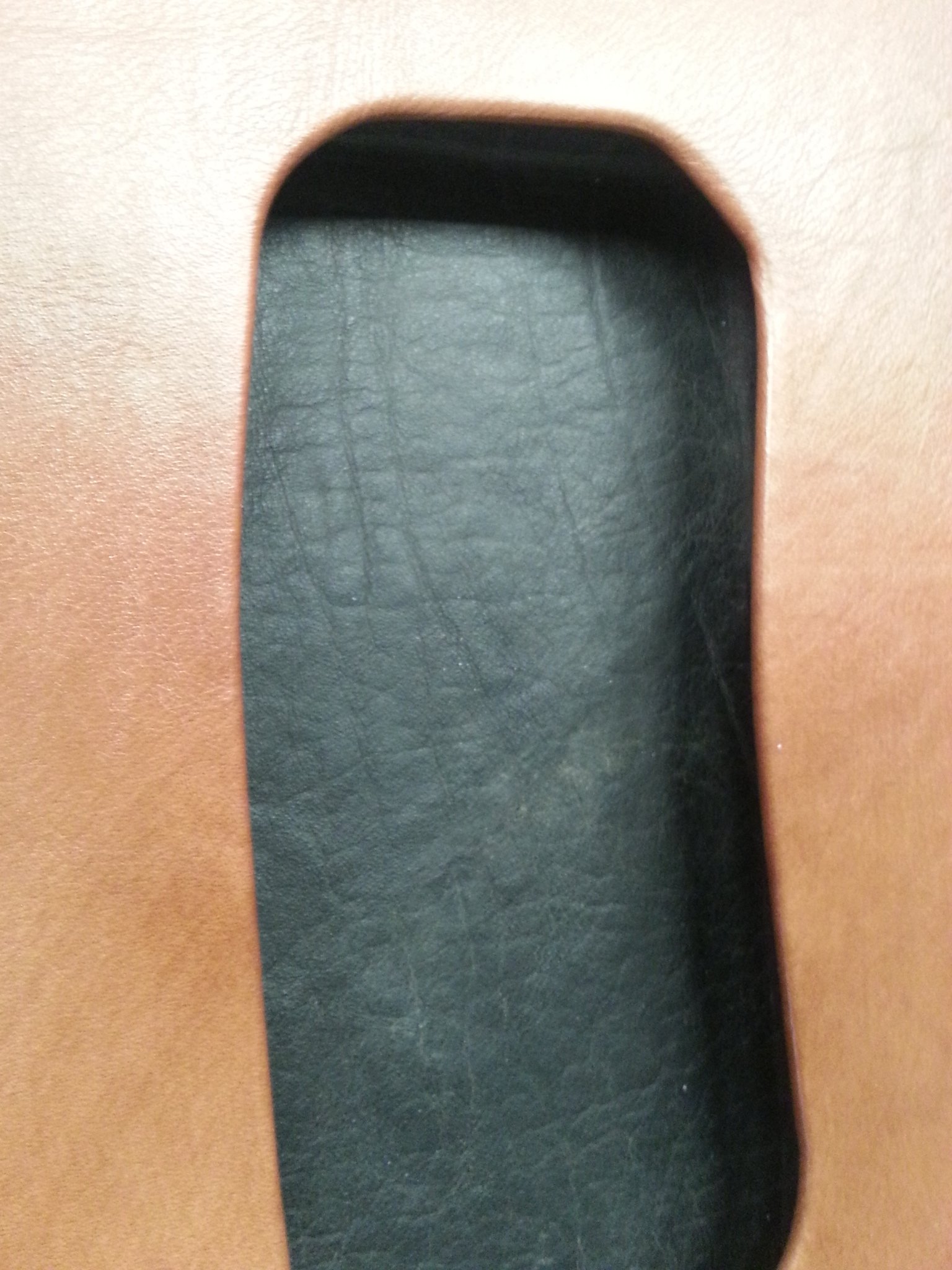

    yonahrr
    Door panels

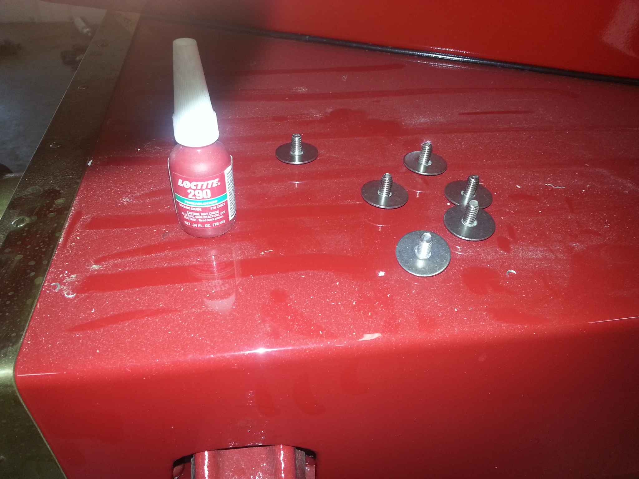

    The fenders have to wait until Monday evening when my rubber washers arrive so I worked on the door panels. The trick is guessing how much of a margin to leave for the leather. I think I've got it. I'm using 6-32 SS mounting screws with little finish SS washers. All I have is a bottom tap which feels like it's going to snap every time I use it. I ordered a tapered tap and that won't be in until Tuesday evening. So it's hurry up and wait. I guess I'll make up the pieces for the ends of the seat.

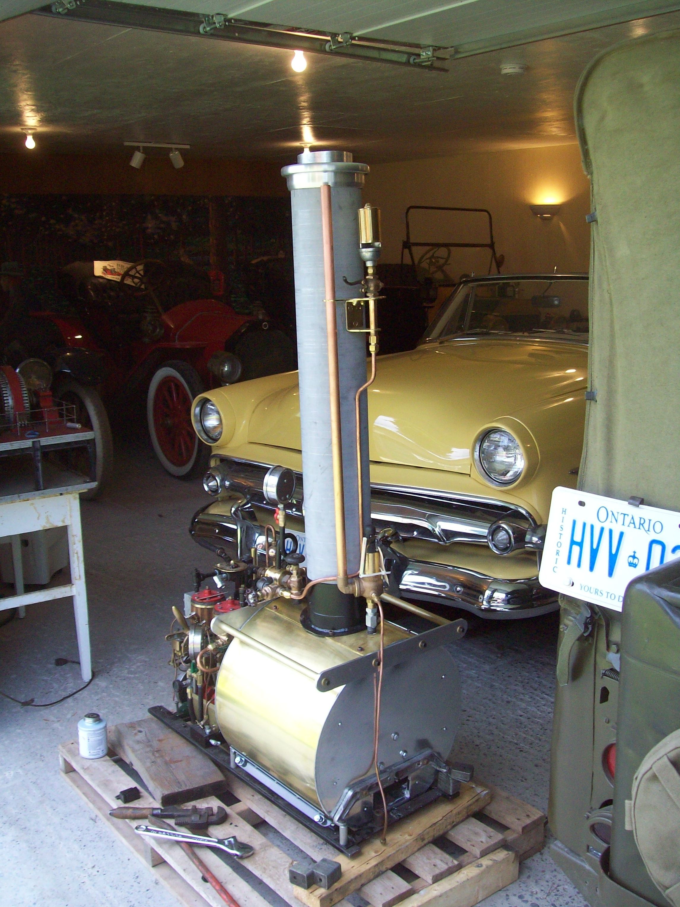

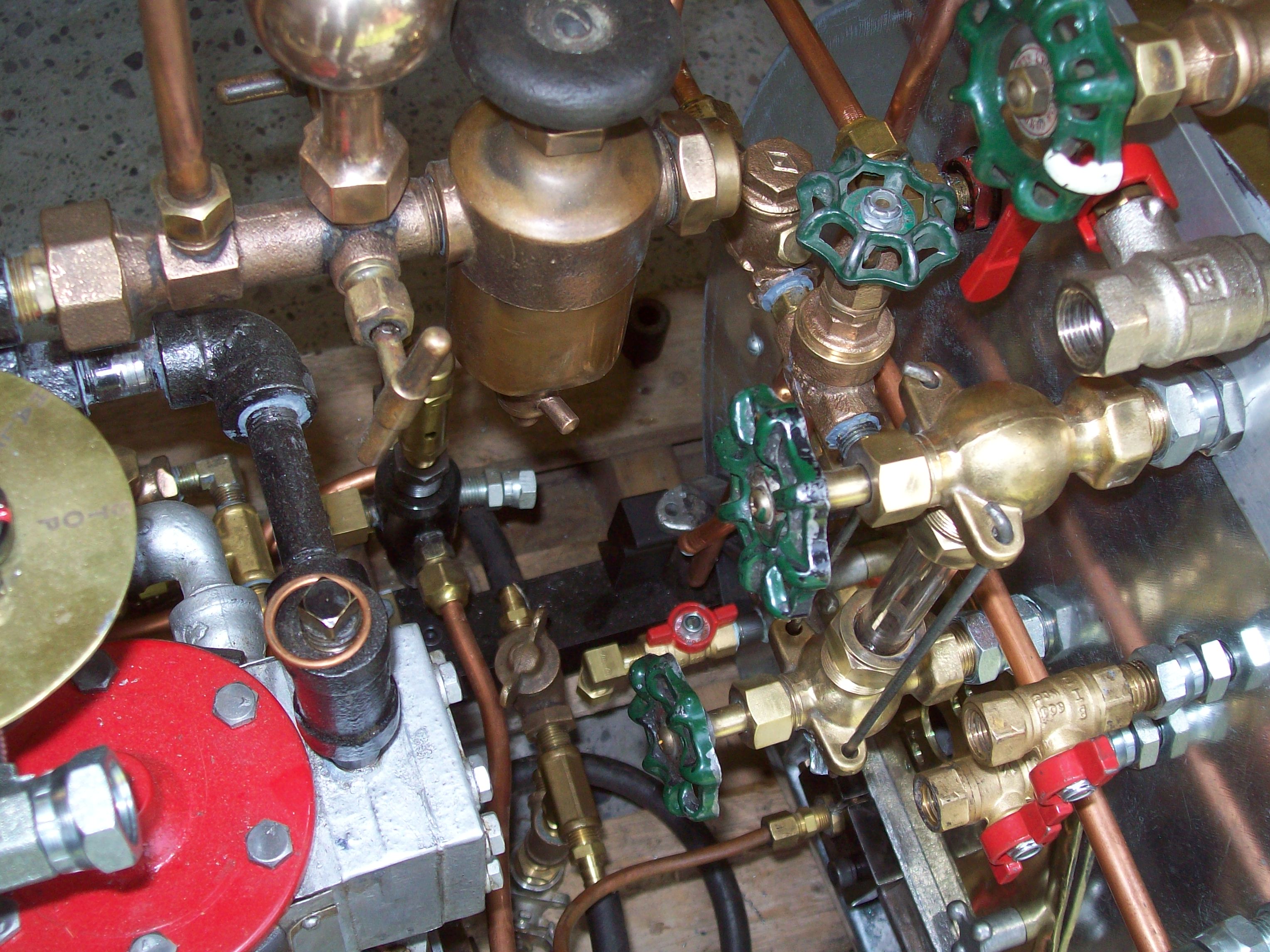

  17. Jack Innes
    Joined: Nov 26, 2010
    Posts: 178
    Jack Innes

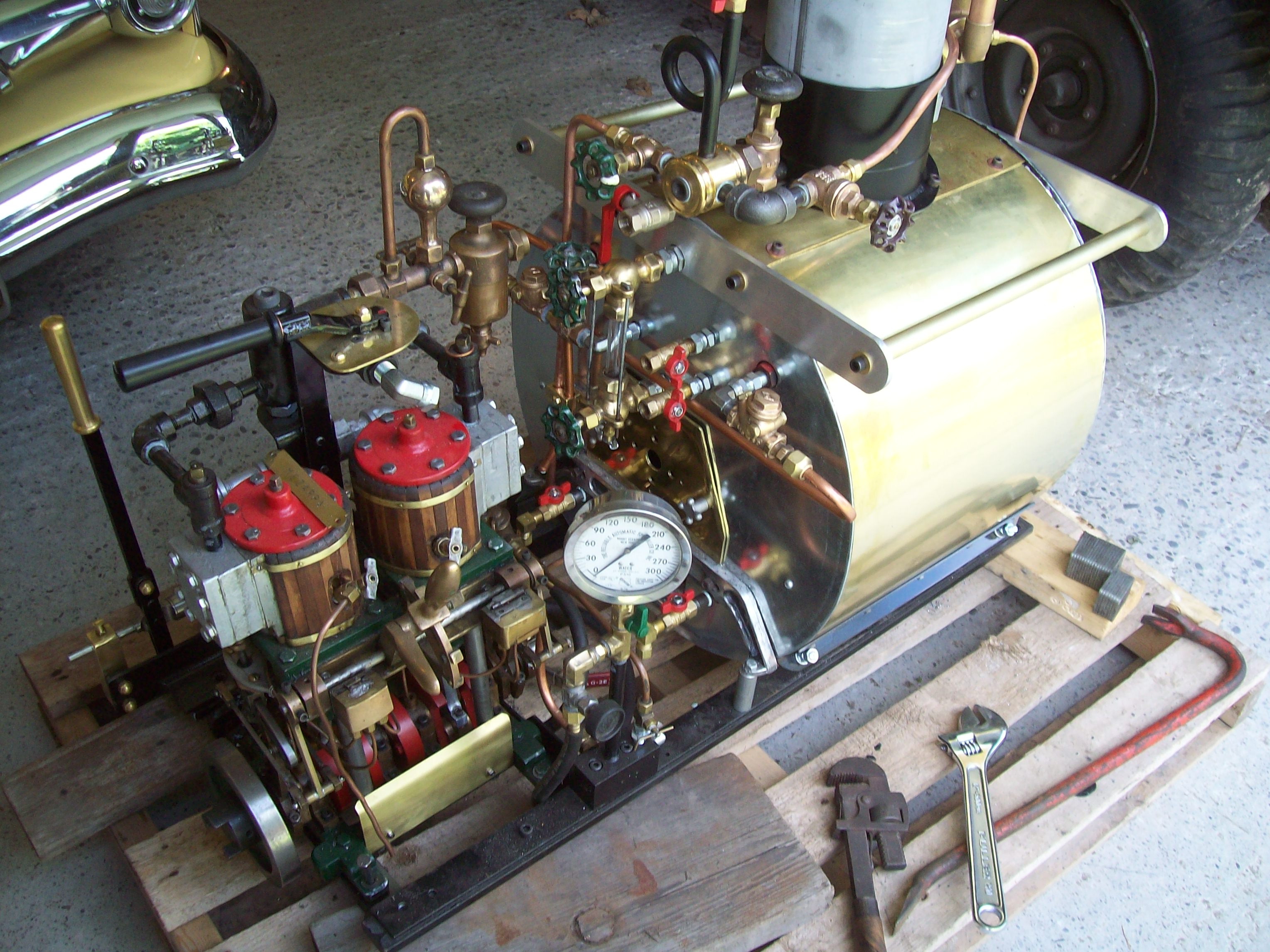

    Well, if you like polished br*** you are welcome to come over & polish some. This is now ready to go back into its steam launch. A typical tidy up job that turned into a complete rebuild.

  18. Ulu
    Joined: Feb 26, 2014
    Posts: 1,775
    Ulu
    from CenCal
    I hope you left out that copper o-ring on purpose....

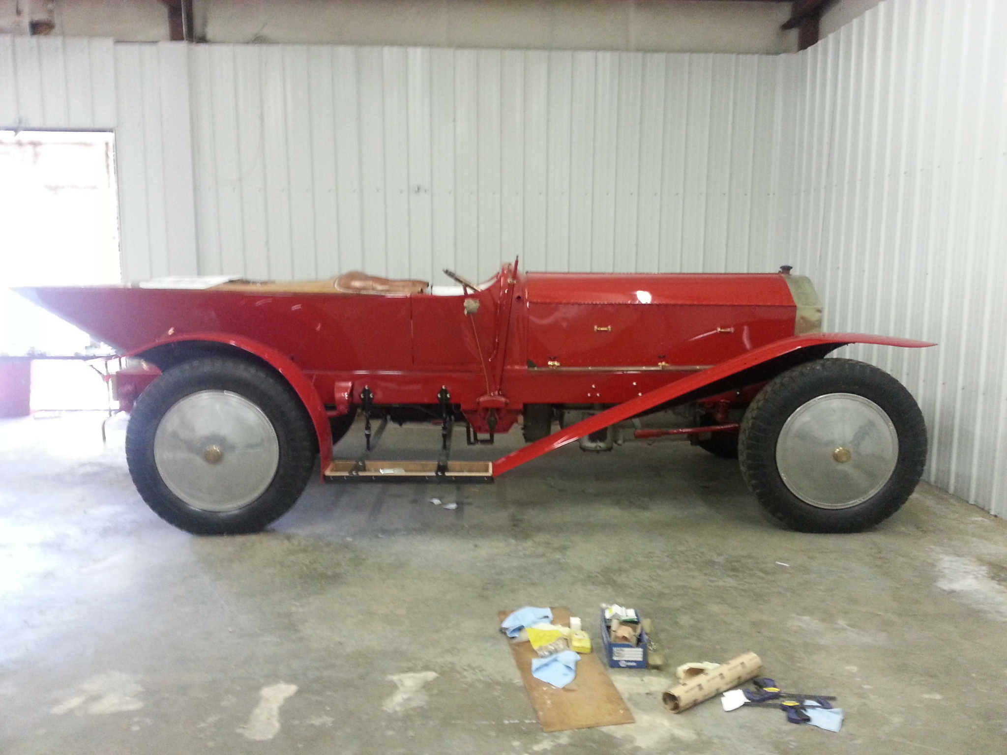

  21. yonahrr
    Joined: Feb 27, 2010
    Posts: 1,348
    yonahrr
    Yes, they're on!
    I knew fitting the fenders was going to be tricky and that I needed some expert help--a real engineer if you please. Everyone knows Scotland boasts some of the finest engineers in the civilized world. Not that all parts of of Scotland are civilized. If you've ever been to a certain pub in Dundee you know what I mean. Anyway, lucky for me my buddy Neil's brother, Donald (the engineer-green shirt IMG_20140624_163545.jpg IMG_20140624_163617.jpg IMG_20140624_163632.jpg IMG_20140624_120942.jpg IMG_20140624_121017.jpg IMG_20140624_121149.jpg ) was in town. He's been lurching here on this thread since the beginning and always suspected the Speedster was just a wee car. He finally had to come all the way from Fofar, Scotland to verify that the Speedster is indeed an awesome vehicle. He's given it his stamp of approval and even lent a hand installing the fenders.
    Damn, this build is getting to the final stages. Well, I could keep tinkering forever, but at some point you call the thing done. Fortunately for this thread, we're not there yet. We still exactly 127.6 items left to install. Then we'll be done. The bulk of the next project arrived today. Don't ask--all in due time, my pretty. While I wait for the seat and door panels, I'll work on the running boards and related stuff. I still haven't ordered the linoleum either.

  22. Squablow
    Joined: Apr 26, 2005
    Posts: 19,043
    Squablow
    Awesome to get some clean side shots of this thing, gives it some scale. The fenders look very appropriate for the car, they're just right.
