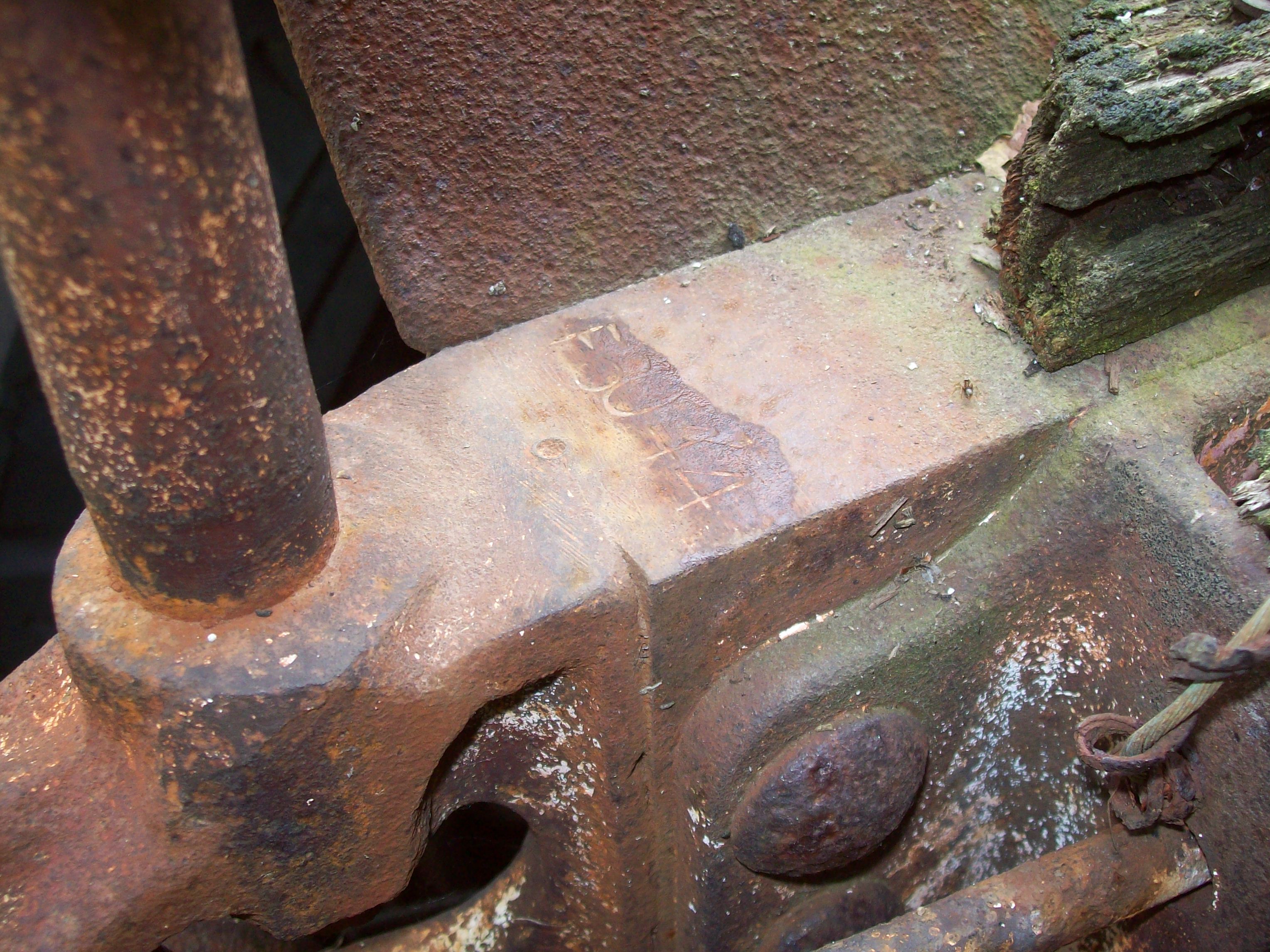

    Do you know where Seagrave stamped the vehicle id number on the frame? I cannot find it and need it badly.

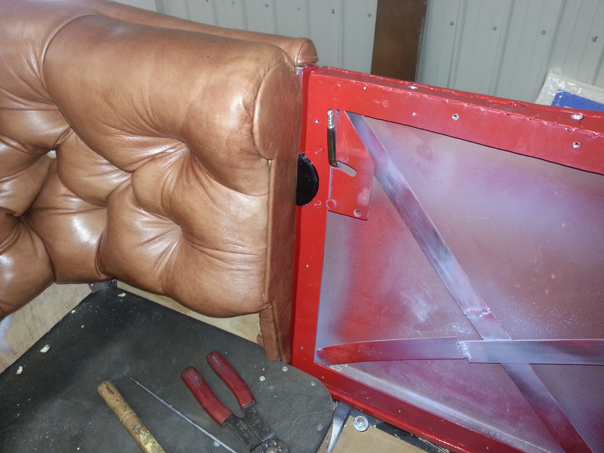

    I see your font size and raise you an Italics.

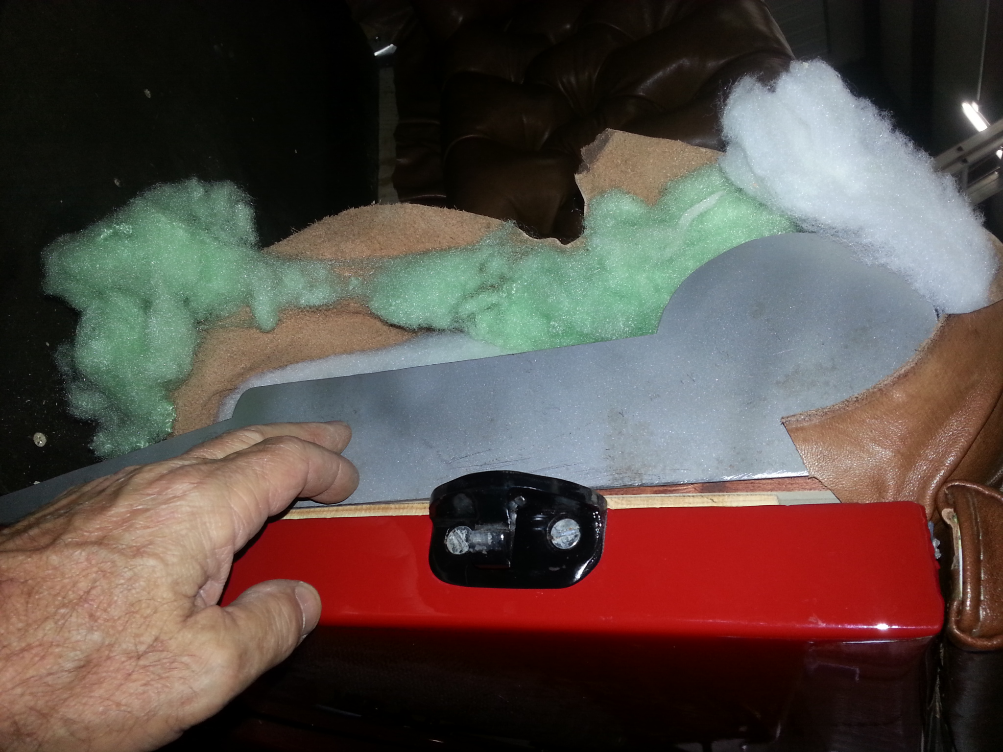

    I am no upholsterer. I'll be glad when this part is over. I made up the "cap" for the end of the seat and glued the leather on it. Now you'd think it'd be easy to tap it into place but no, it was a real pain in the ace. Anyway, it fit pretty good but if you look close you'll see a staple peeking out--Damn! Later, after the speedster is world famous and fortunes are heaped upon me by mesmerized admirers, I'll get the seat professionally upholstered.

    I don't think there is a number on the frame. There should be an id plate on the p***enger's side inside the cab on the firewall. If it's gone you will see the four screw holes about 3 inches apart. (convert to mm) Someone told me the ID number was also painted on the front of the axle and on the wood parts of the body. My body had no wood parts left. Hope this helps. Jerry

    Check the area on the frame near the right headlight bracket.

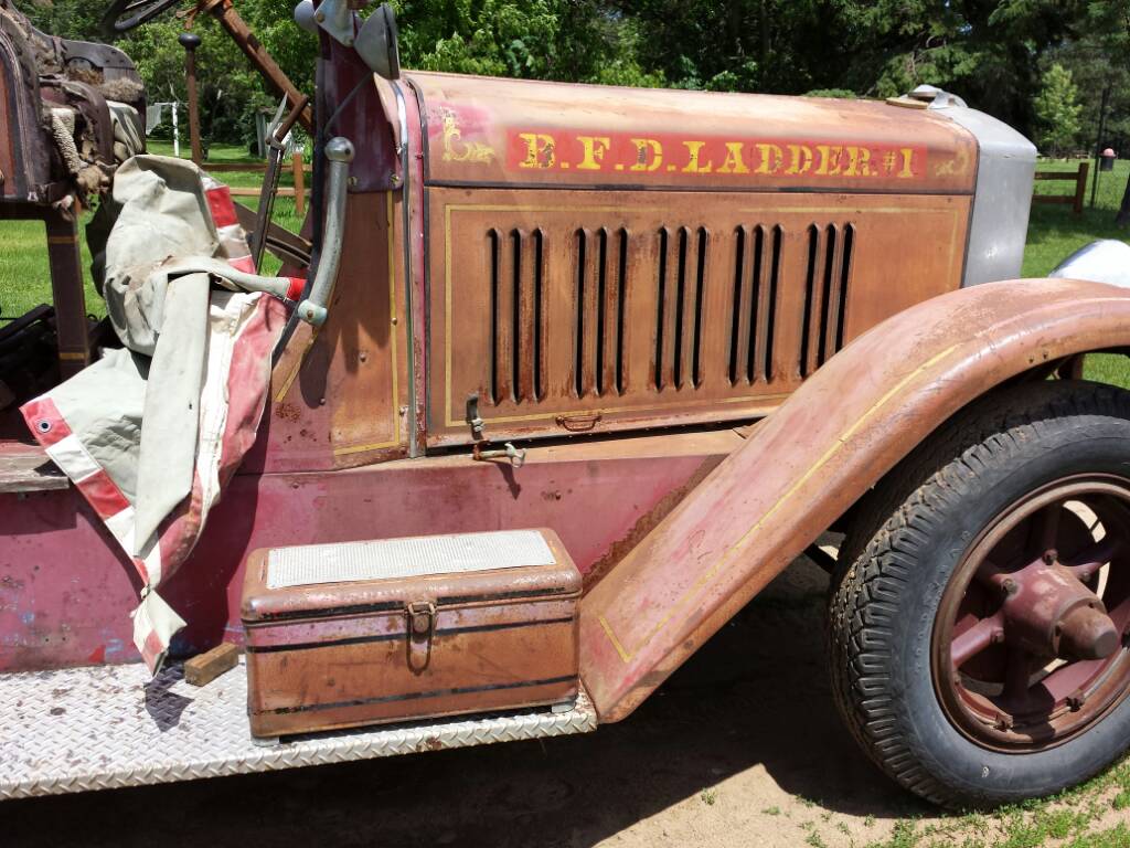

  9. Rah Rah Records

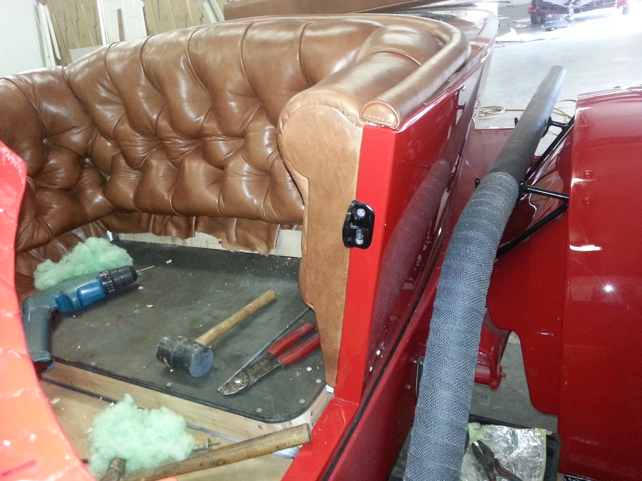

    Now you see it, now you don't.
    Getting ready for vacation and I just had time to stop in and fasten down the roll behind the seat. I also got rid of that pesky staple. It looks like there are three or four staples showing in the pic for some reason, but there's only one. 77 MPH in the speedster? Why that ain't nuthin! :)

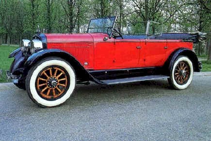

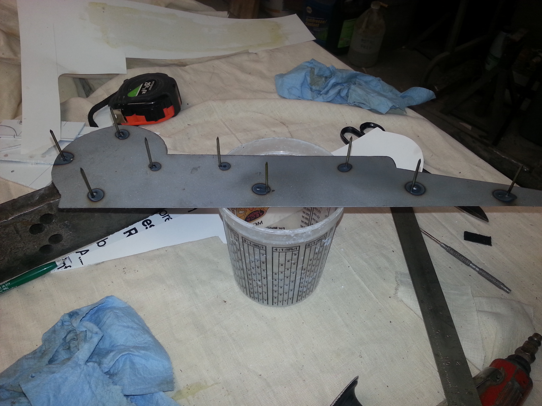

    Vacations are nice but I'd rather be in my shop.
    The voices in my head told me to work on the windscreen. It's the rear accessory windscreen for a touring car like in the last picture. I needed to widen it and shorten the wings. The shortened wings will provide the material to widen the windscreen. It took a lot of hammering and cajoling to get the ends out of the tubes. Good thing I'm a virtuoso of the air hammer. The air hammer is misunderstood tool. When used in the right hands it can be a delicate instrument. Too bad my hands are the wrong ones. Luckily, I got the screen apart. I trimmed back the wings, and this gave me a chance to use my favorite hot wrench--the Rego jeweler's torch. You can't buy these any more but I love mine. I prefer to use bailing wire for the rod. Some people say coat hanger is good. They are wrong! Coat hangers are like spring steel. They just curl up into nothing. Bailing wire is soft iron and welds perfectly. With the Rego you can weld sheet metal together with tiny beads and no distortion. I didn't try too hard to make a work of art on the windshield frame. I just had to stick the two pieces together because I needed to add 8 inches and individually I didn't have that much. More to come.
