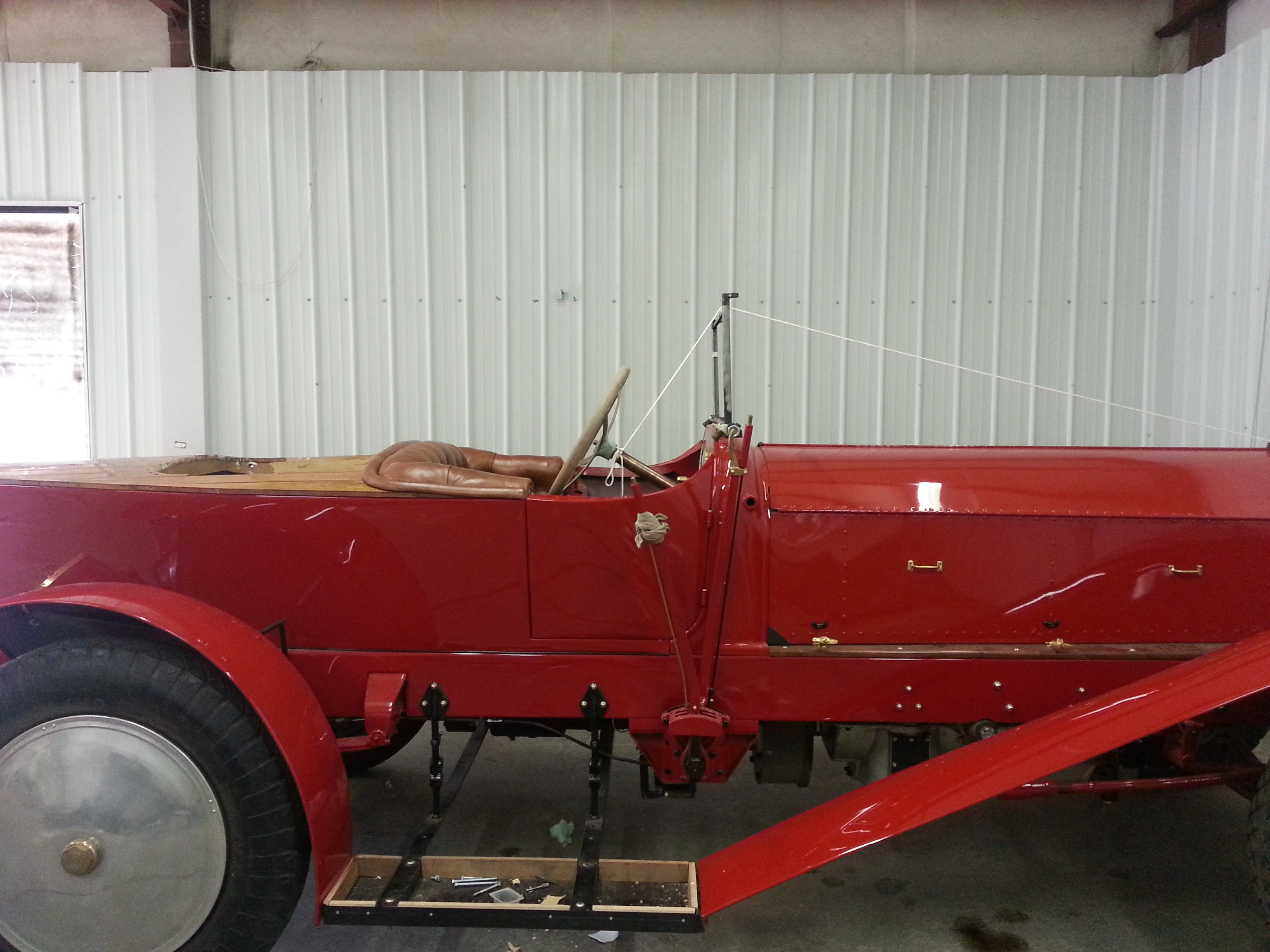

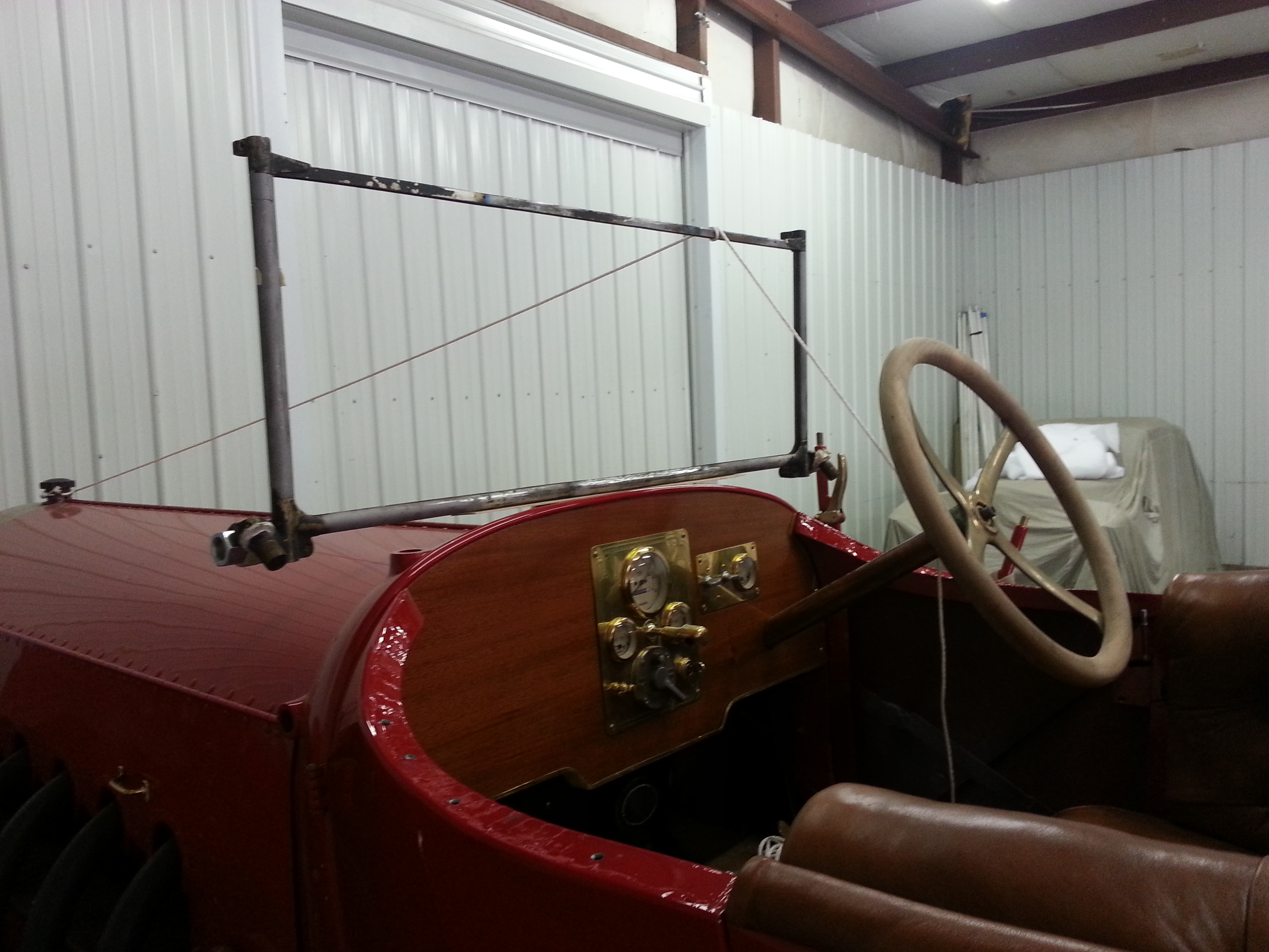

  7. yonahrr
    Joined: Feb 27, 2010
    Posts: 1,348
    yonahrr
    Why the windscreen?
    I have gotten several cards and letters asking:
    Dear Jerry, why are you working on the windscreen when you haven't finished the upholstery? (Hated, as it is :) )
    A very good question--with a very good answer. I have learned (through the years) that before finishing up a section of a project (say the upholstery) I should begin an adjoining section. By this method the two sections can be mated in harmony. If this is not done, then one section (the upholstery, for instance) might be finished only to find out there is a conflict with an adjoining section (the windscreen, for instance.) The fact is the leather roll on the dash needs to be fastened in the very place the windscreen will be bolted down to, and I don't want to find out later I can't bolt down the windscreen because I put the roll screws in the wrong place.
    I finished up widening the windscreen and stuck it in place. It looked a little too high and my eye level was low enough I could cut off about three inches. I know everyone wants something like Brookland's windscreens but they're really kind of useless, and I don't want to wear goggles when I drive the speedster. I've already got one of those cars. Remember the windscreen will tilt back, and there are wings on the sides.
    Jerry

    Anyone who thinks you are unbalanced should take a hard look at that string job.

  22. RMR&C
    Joined: Dec 26, 2009
    Posts: 6,556
    RMR&C
    from NW Montana
    Windshield looks good! I ***ume the bracket will get a lower leg for support?
    Should look fine after cleanup and paint......
  23. 64 DODGE 440
    Joined: Sep 2, 2006
    Posts: 4,436
    64 DODGE 440
    from so cal
    Just triangulate the bracket to the hole in the side of the cowl and change your nuts and it will look fine. Although I think the changing of your nuts may be slightly painful. :eek:

  24. gas pumper
    Joined: Aug 13, 2007
    Posts: 2,964
    gas pumper
    Yup, Hardware Harmony and it will be great!
  25. paperdog
    Joined: Mar 26, 2006
    Posts: 5,176
    paperdog
    The gl*** should be curved at the base and along the top...gl*** cutting is just like upholstery. ..Ez for Georgian ****on tucker extraordinaire
