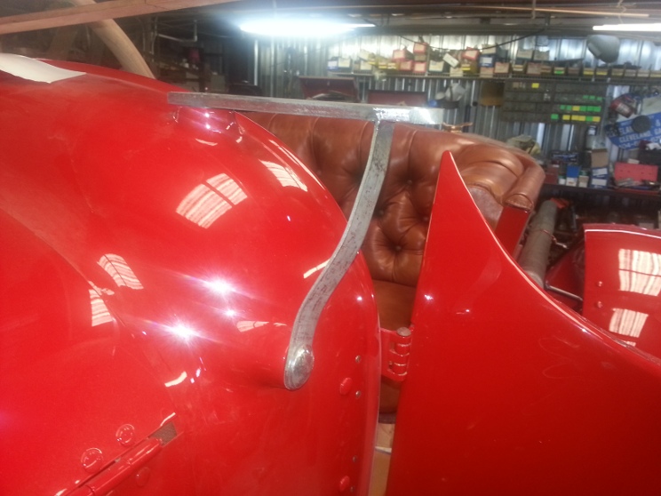

    The top of the windshield being straight does not bother me, but the bottom should be much closer ore body, and be curved to follow it. Otherwise dirt will blow in underneath it and get in your eyes.
    Or a seal of some sort between cowl and windshield frame.

    Perhaps a nice piece of wood to match the rear deck would look good there.

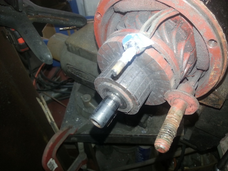

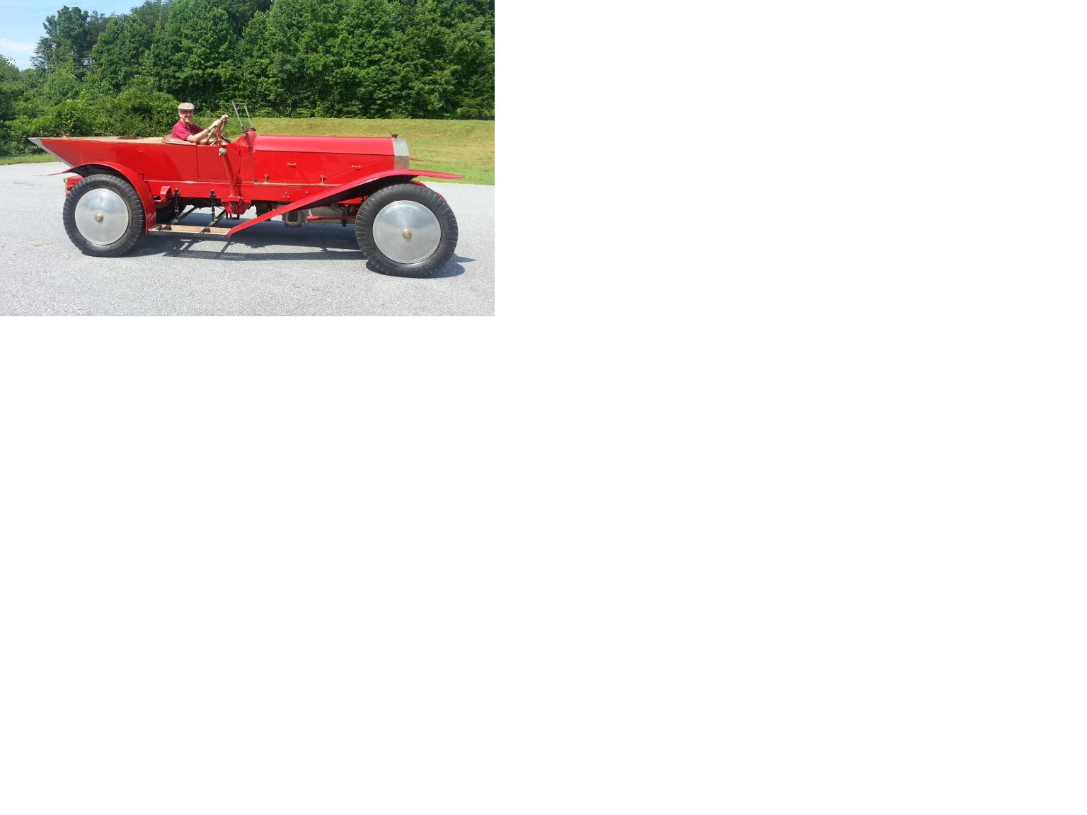

    I had the speedster running good. I really did. The day before, I charged up the battery and fired up the engine. I even adjusted the timing. Today, we arrived early ready to film the glorious trip to my shop. The engine ignited after priming and sounded good, but as I got the speedster just out the door, it started faltering and died. A quick examination showed that even though I had pushed in the choke, the ****erfly had not fully opened. I remedied that quickly, but when I went to restart, the starter would not turn the engine. I thought the battery was dead so I changed it out, but that was not the problem. One of the brushes was not making good contact. I had to get the rollback. Yes, I made a video but when I got home I could not find the proper cable. I found every other kind of cable, but not the right cable. As soon as I come up with the cable I'll post the video. Still, we made some neat photos and got to drive the thing a little. The bugs must be worked out. It's a normal process after sitting for umpteen years. I never did go through the starter. I know, I know! But it worked so well, I thought, what the hell. Okay, I've learned my lesson. Well, maybe not. :)
    Jerry
    Look closely at my hand in the last picture. A spider bit me. It's still puffed up.

    I made a piece to go under the exhaust pipe but I'm afraid it'll get all scratched up if I put it in. Maybe when all the bugs are worked out. I think the spring holding the brush against the commutator broke.

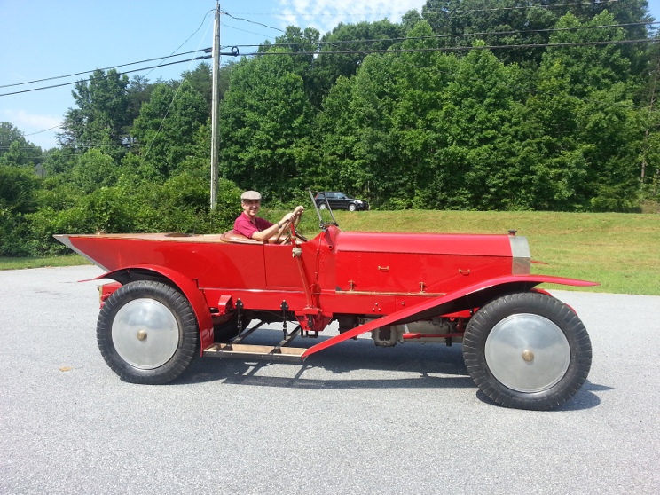

    The picture of you at the wheel (?)would not seem staged if you had had your hat on backwards .. which is the current fashion sheeese ????

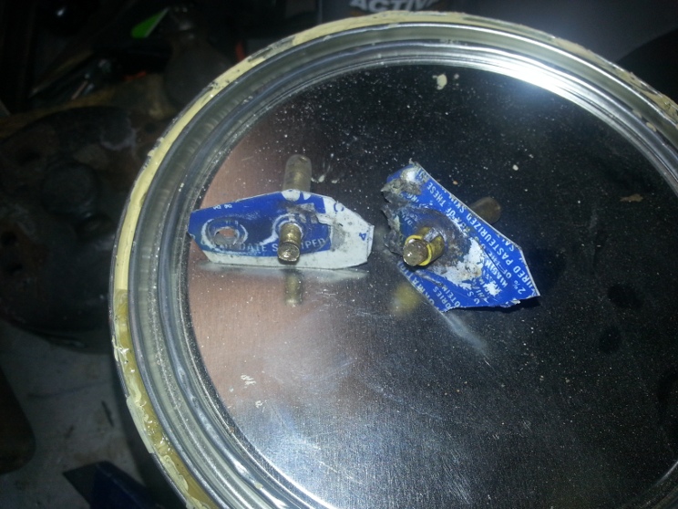

    I took the starter apart and discovered butchery. Someone made a nasty, nasty repair. Two of the brushes are grounded and two are insulated. Someone reinsulated the brush holder with something--nasty. The actual problem was that the nasty insulation was keeping the brush from coming in contact with the commutator and it was arcing. The springs were weak too. But there was no serious damage. I will fix it all.

    There's a video of a guy hand cranking an F6 engine on youtube. He makes it look easy. What do you mean"staged?"

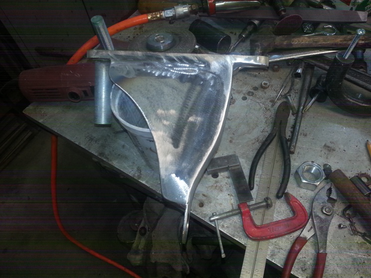

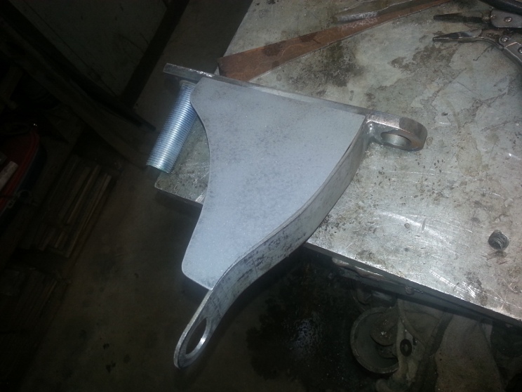

    Windshield mounts
    I worked on the windshield mounts too. They were kind of tedious but I got them basically done. All they need now is paint. Maybe I'll stop by the gl*** shop and order the gl***--yeah!

  15. A leather cover betwixt windscreen and cowl would be era-correct, and match the interior, too!!
    Further, this era's cars generally had leather wrapped springs (keeps the grease inside for a better ride, and it works, too), leather booties on tie rod ends, and other things made out of dead cow. Usually where you'd find rubber seals today, dead cow was used then.

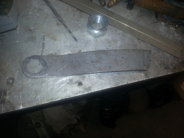

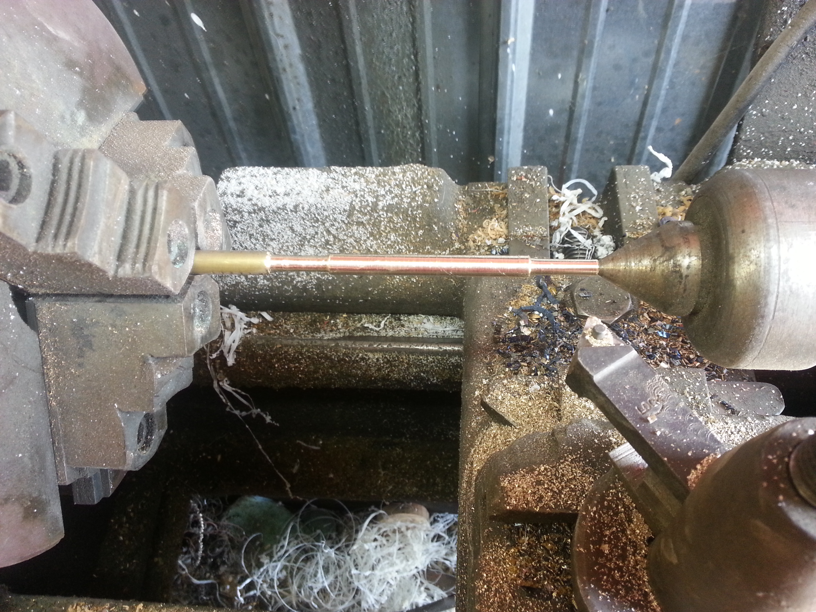

    Brush posts
    The starter brushes reside in these nifty br*** holders that pivot on posts that are riveted to the back plate of the starter. They've already been removed and reriveted once before (and butchered) so I don't think they'll stand another reriveting. I wanted to make a more servicable solution. The posts are 7mm which is interesting to find on a '23 American truck. I could have ordered a 7mm br*** rod but that would have taken time and cost $23 bucks plus shipping. It's more fun to make your own so I cut down some 5/16 rod I had laying around. Then I turned the ends down to about .2 something. I forget. Enough to thread them to 10-32. That way I can bolt the posts into position which makes them more removable. Thirty years from now some schmoe will be able to repair my butchery. Tomorrow, hopefully there'll be time to make up some insulators to isolate the posts and etc from the starter back plate.
