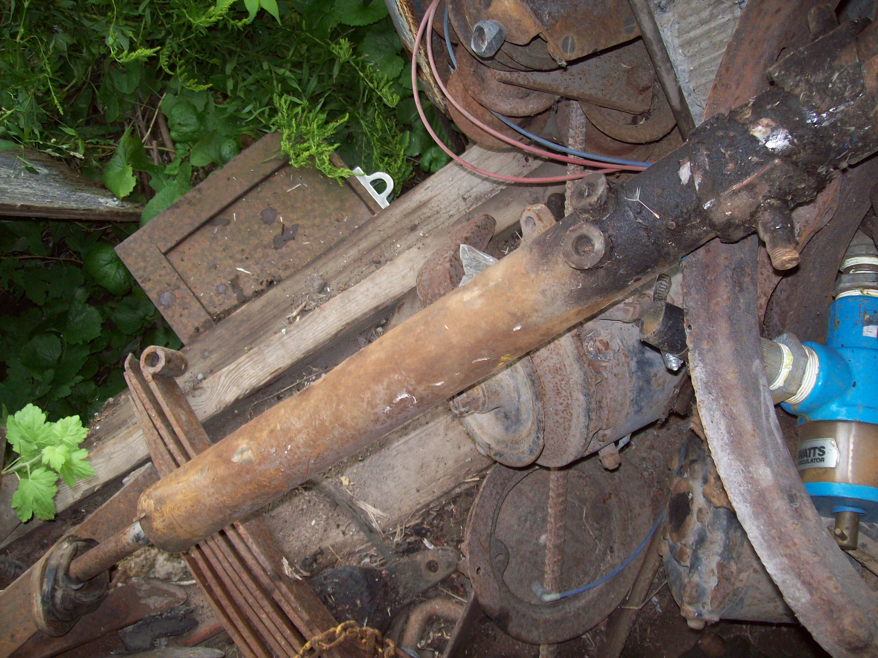

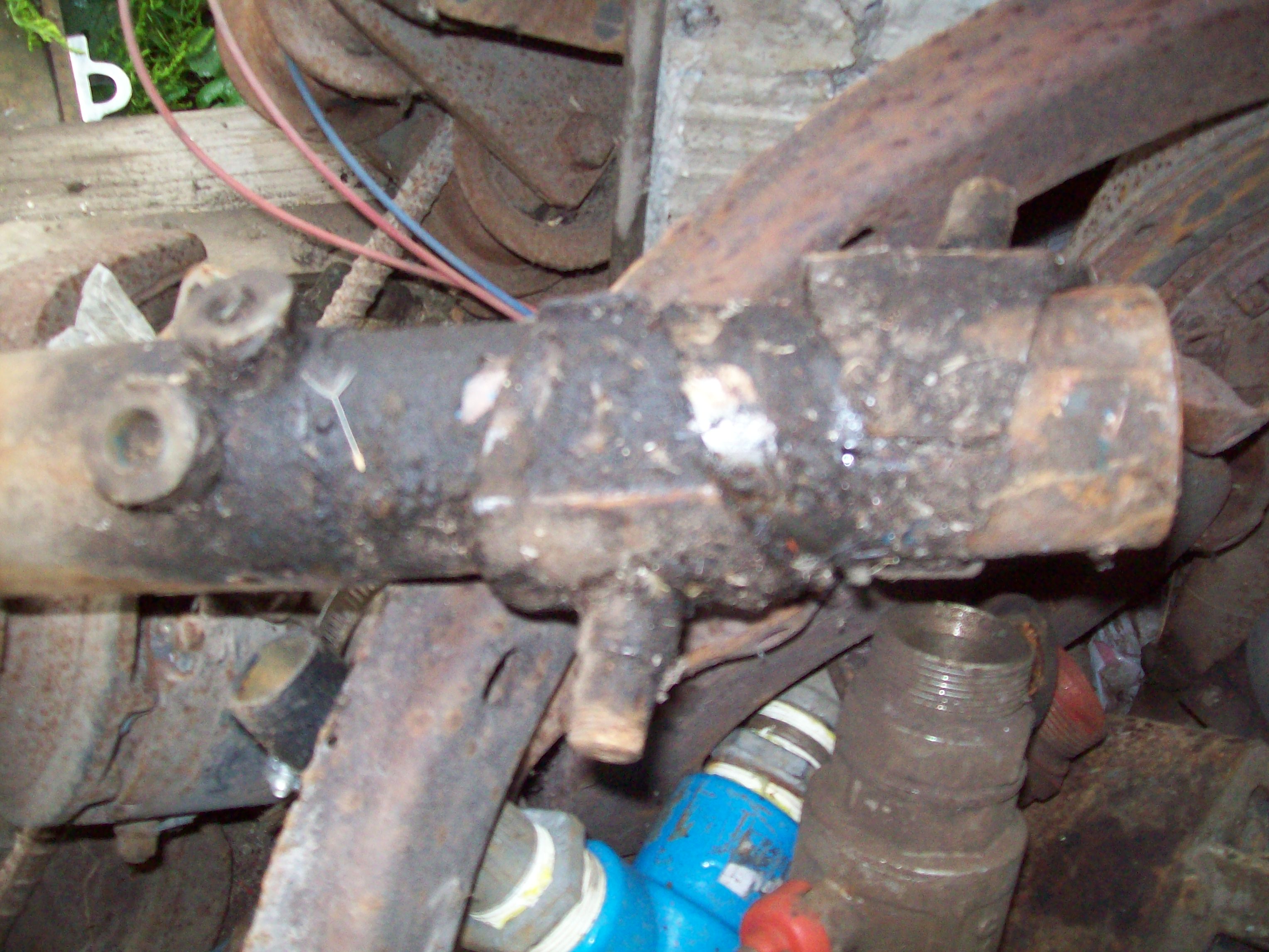

    Here is a power steering cylinder that I was going to install on my White half track but it never took place. It needs cleaning up but was a working unit. The valve ***embly would go in the tie rod or the drag link & the other end would fasten to the axle or the frame. You would need a pump & lines to make it work. It is yours if it would work for the Speedster. It is about 3 ft. long & could be mailed.
    Jack
