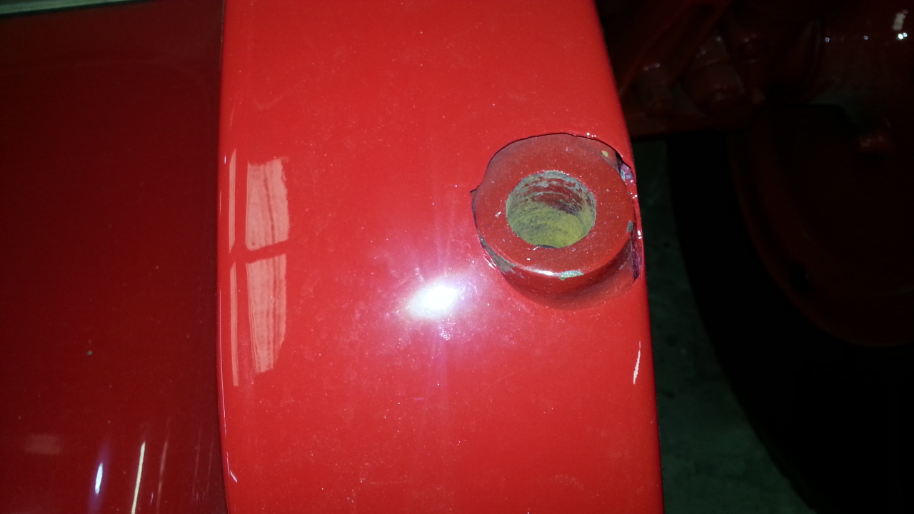

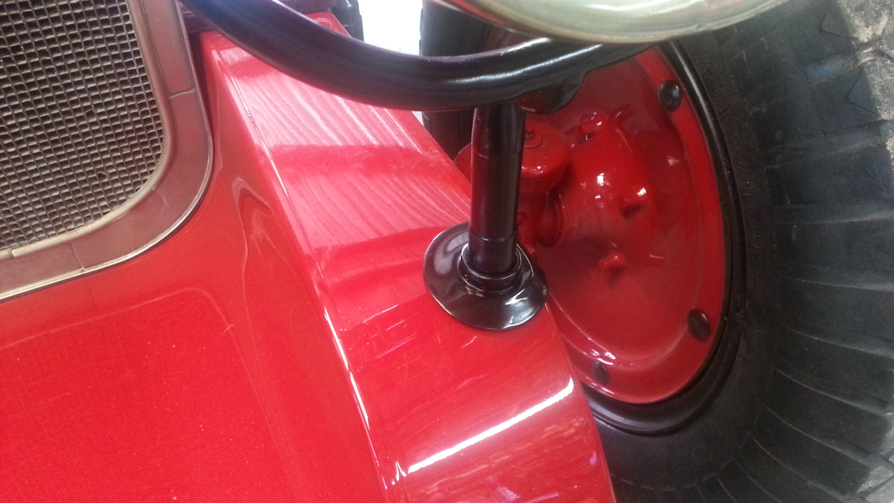

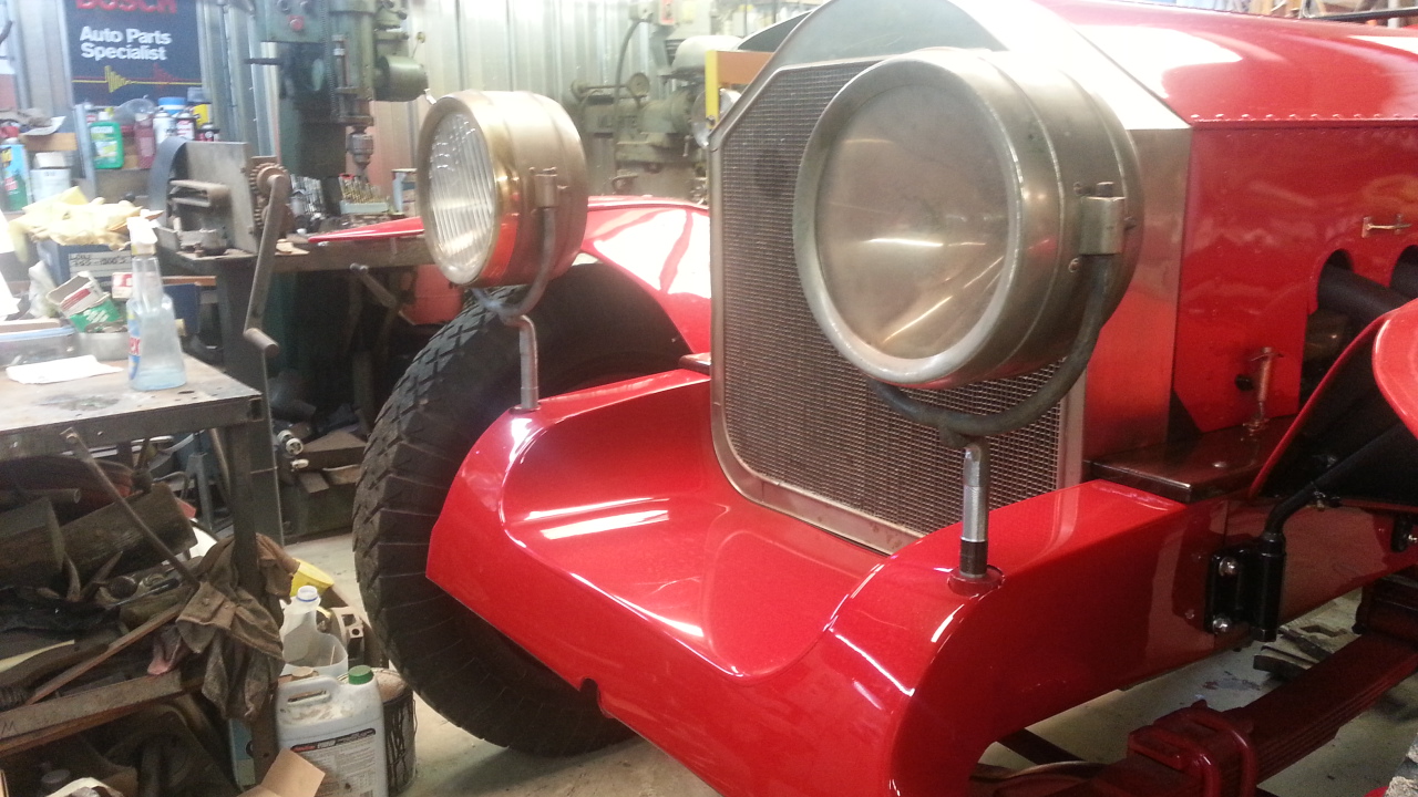

    The last few days I've been working on the headlight forks. I bought an old pair somewhere but they weren't the right width to fit my headlights. They didn't have the right bottoms either. I tapered some pipe I had and welded it to the forks. Then I heated and rounded the forks into the right width. The bodywork had some ugly holes so I had to make up a pair of escutcheons to hide the ugly. I love that word--escutcheon. I've only gotten to the priming stage.

    Today, I painted the headlight forks and escutcheons. Have I mentioned I like that word escutcheon? It's from the Latin word scutum for shield which is closely related to scortum meaning skin or hide which would be used to cover a shield. This, of course, is closely related to scrotum, something you should definitely cover and shield at all costs.
    Later, after I sanded off the worn out nickel plating off the headlights with 600 sandpaper and was buffing the br***, I should have used something covered in hide (like a glove) to shield my hand because the buffing wheel grabbed the headlight ring and slammed it into my hand rather smartly, cutting it in two places. The ring then flew into the concrete floor, hit the roof, ricocheted into the speedster and came to rest I knew not where.
    I cradled my hand, which suffers from a touch of arthritis, for about a minute fearing the condition of the ring and the paint on the speedster. When the pain subsided ( the cuts were minor) I found the ring under the workbench. Miraculously, it had suffered only minor scratches. Heaving a sigh of relief I moved on to the speedster's paint. Miraculously, it suffered even less--on a smudge of buffing compound. The gods of the gear are watching over me--or maybe the speedster.
    I didn't push my luck and only buffed the headlight enough to make a decent picture before leaving the shop. But before I closed the door I cut out three squares of br*** to be used for ID plates. Jack, one of them is yours. It'll be like the one in the picture
