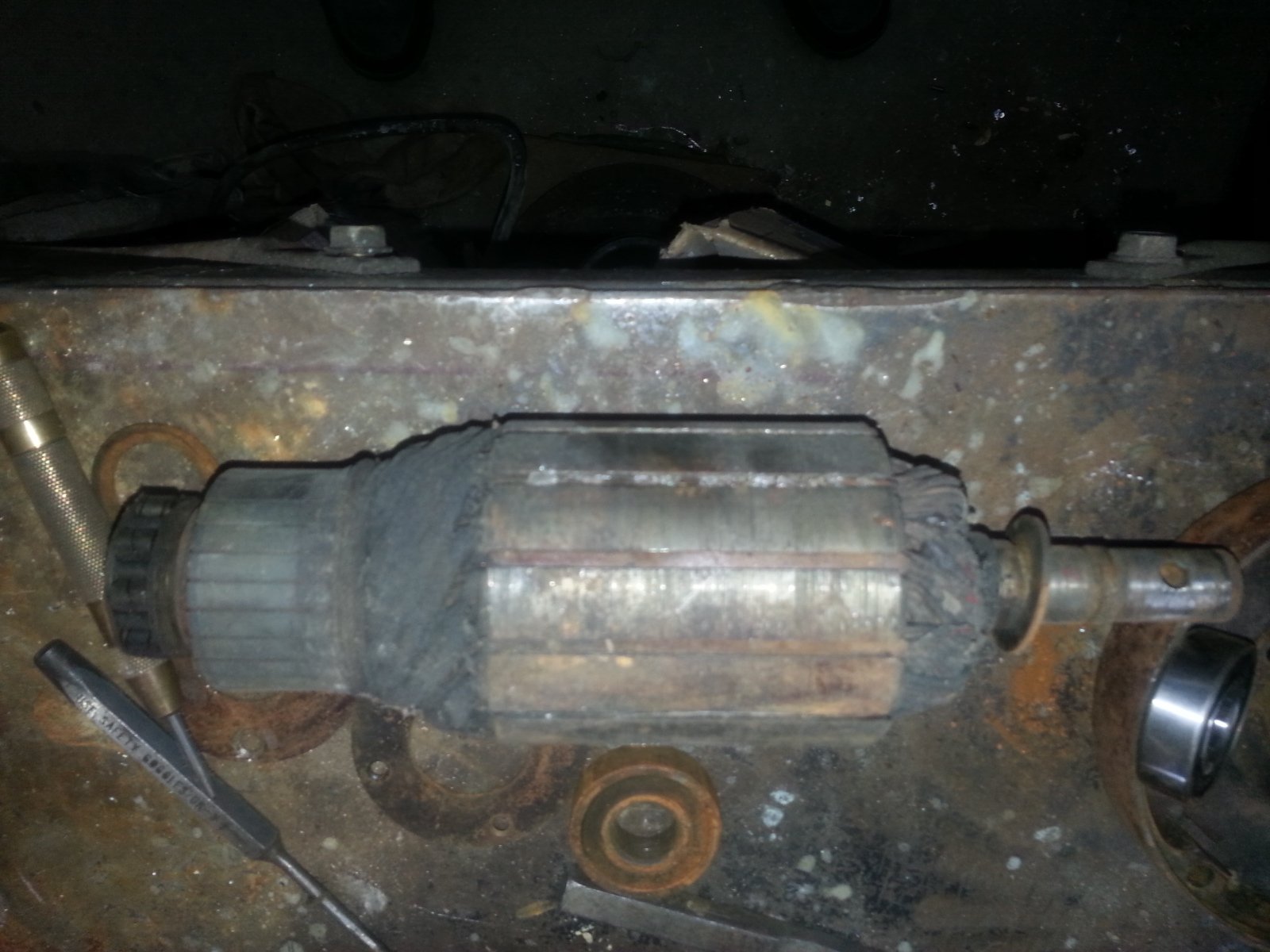

    I couldn't bring myself to drill holes in the paintwork, and the uprights aren't hollow so running the cable down the frame was a compromise. I did make up those nifty little clamps. :) That show is this weekend. I just piddled this weekend, but today I got out the generator--I've been running on the battery--and started cleaning it up. It's got three brushes which is kind of interesting. The third brush is adjustable, and the manual says you can adjust the charging rate by moving it. The actual brushes are shot as well as the little springs. I can replace one bearing with modern but the other might have to stay.
    Jerry

    With the third brush regulator the charging rate is set at some compromise. It's why back in the day if you were taking a long drive on the highway you would run with your headlights on - to keep from overcharging the battery.
    You will probably be good to go with the recommended setting, or hide an external regulator somewhere.

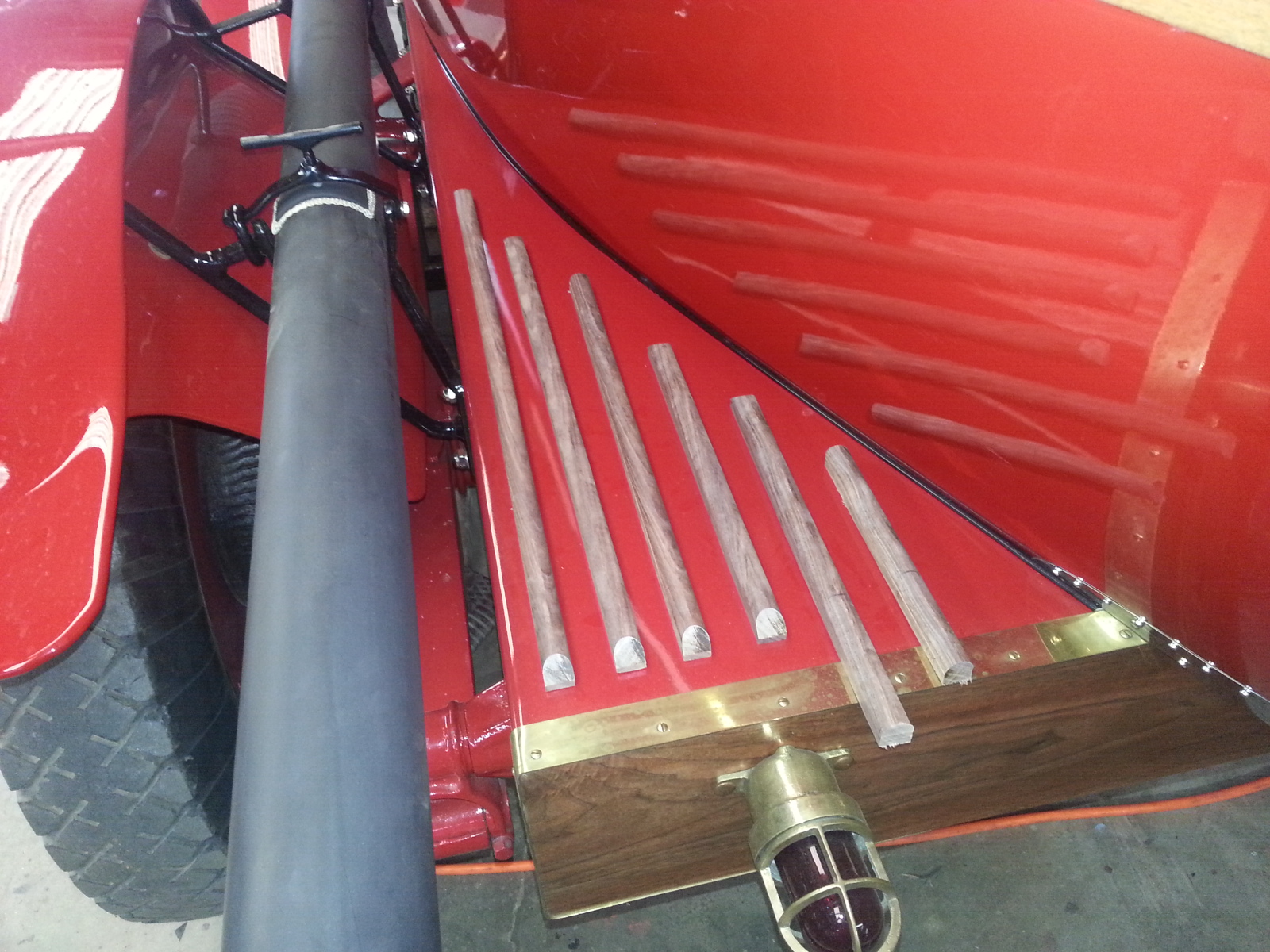

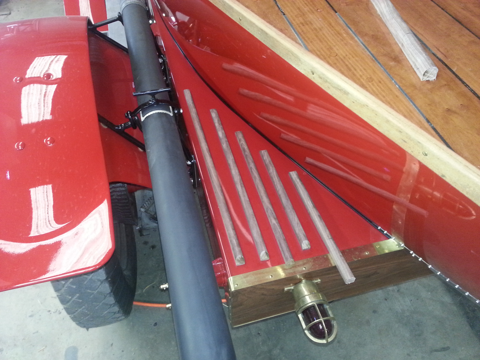

    I cleaned some more on the generator which wasn't too exciting so I went over to Don's and asked him to cut some wood for a little luggage rack I had planned over the right rear inner fender. He also cut me some wood for the two corners back by the boattail. I took the wood back to the shop and ran it through the router to round over the tops. Getting the spacing down on the pieces in the back is a little dicey since it involves aesthetics. I also made up two pieces of trim wood for the rear corner of the running boards. What else? Oh yeah. I took the ID plates over to Michael at the sign shop to make cutouts so I can electro-etch them. And--I got insurance on the speedster. With an ID plate I can get a tag and then it's out on the open road--legally!
    Jerry
  9. Dick Stevens
    Joined: Aug 7, 2012
    Posts: 4,248
    Dick Stevens
    Very good add on, but I think the front ends of the wood strips by the boattail should be contoured to match the boatail, to make them flow and actually look like they belong there.

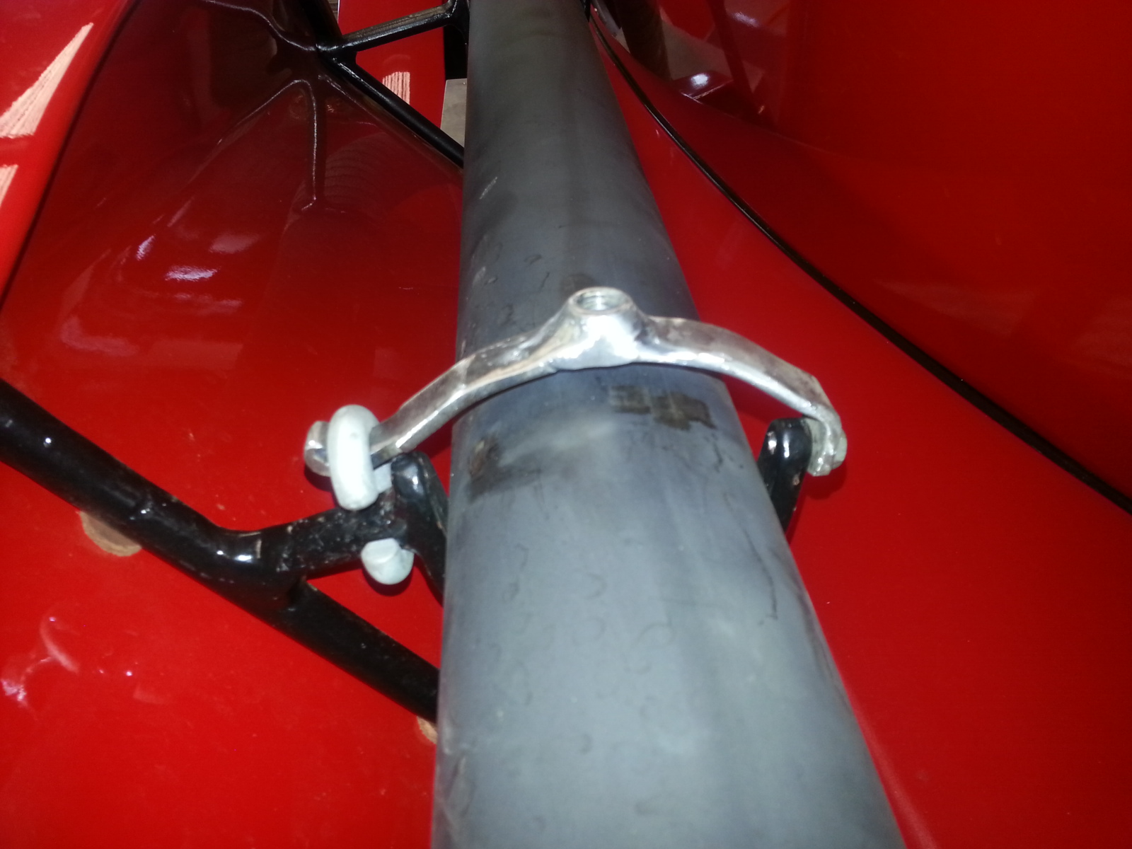

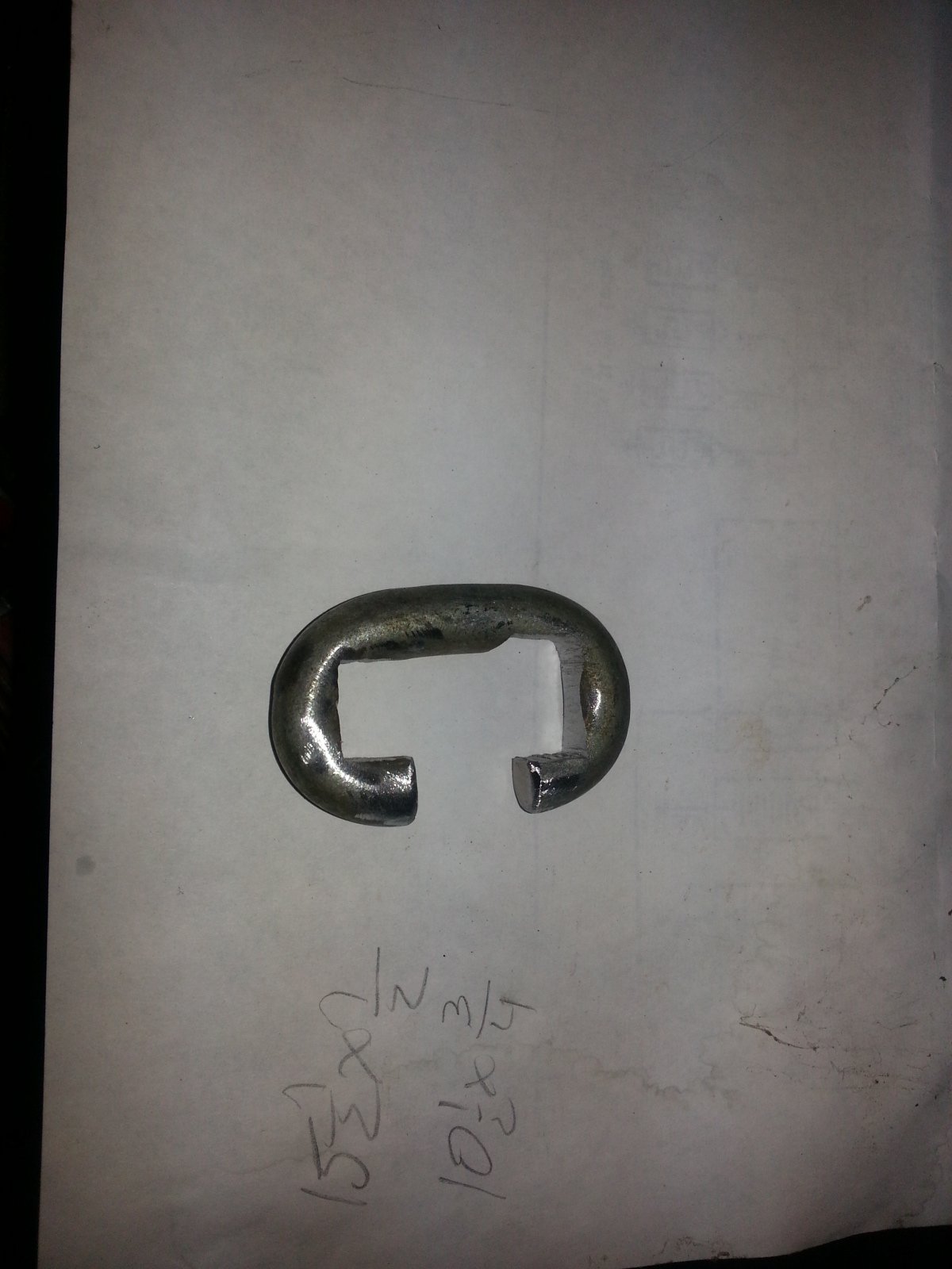

    I forgot that I also worked on the clamp that holds down the exhaust pipe. I'd been puzzling over this for a while but it finally came together. I started by doing a little bandsaw work on a chain link. The I bent up a piece of steel to hook into the link and go overtop of the pipe. I fastened the steel to the pipe bracket with a bolt. Next I drilled a hole in the steel and welded a nut to it. After that I made up a tee bolt. So as not to mar the exhaust pipe I bent a piece of flat stop to go between the bolt and the pipe. A square of "asbestos" made it look pretty. Everything was cleaned up and painted. I thought it looked weird and neat.
    Jerry

    You mean make the leading edge match the curve of the "hull/body"?

    from CenCal

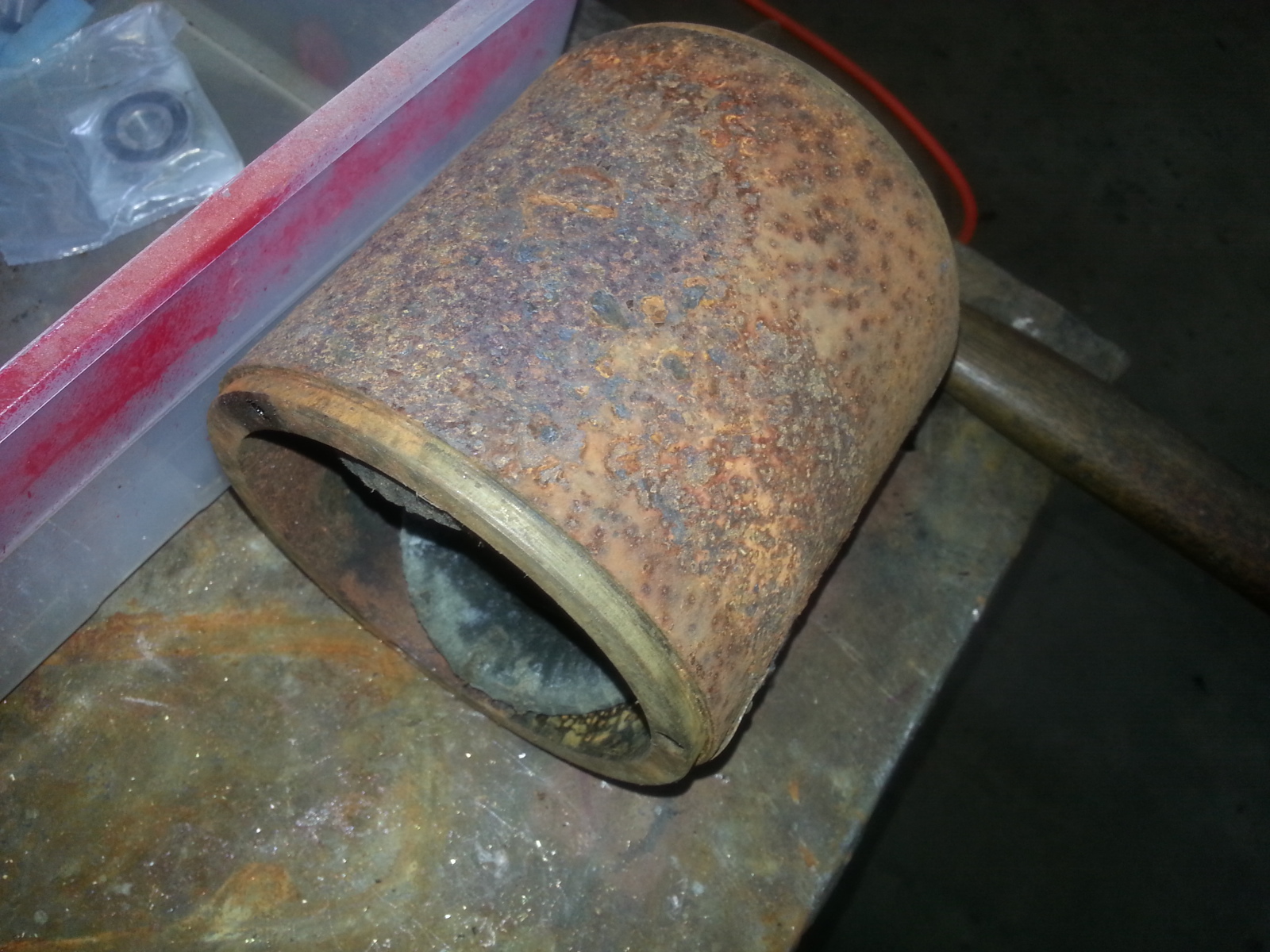

    Well muffler changes will go a lot faster now.
    What's with the bearing you can't change?

    yonahrr
    I could change it but it's not worth the trouble since the original bearing is in pretty good shape and there's little stress on it. In fact since the generator is gear driven through a coupling, and there's no side load on the bearings, they will virtually last forever. Most old generators only have a bearing on the pulley end anyway because of the side load. The rear gets by with a bushing. I've been reading up on three brush generators. I think I'm going to do away with the third brush and install a voltage regulator. The third brush was just a simple way to do without a voltage regulator--a system that apparently didn't work too well.
    Jerry

    I agree that the 3-brush setup is not as good as a regulator, and I already suggested a regulator. However, there is a way you can run the 3-brush if you wish.
    3-brush setups worked real well for constant load/constant rpm. Set it and forget it. As electrical loads and motor rpm vary more widely, the 3-brush setup starts to fall apart since the best you can do is set for the best compromise.
    Your Seagrave does not have a very wide rpm band and your electrical loads are pretty straightforward. Ignition, lights and replace the extra you used to crank her up.
    If you set the 3-brush to, say 3 to 5 amps charging at cruise rpm and with the lights on, you will be good to go. Perhaps a Battery Tender between drive sessions - you'll probably be using one anyway - and a decent battery.

    I guess I'll try to get the generator humming and see how the 3 brush system works. Poured babbitt is not the big mystery it appears to be. You can probably handle it. Or maybe you could solder in a bronze bushing. You'd have to rig a dummy shaft through and through to align the bushing. I'm going to test the luggage rack and exhaust handle in my wind tunnel before the final fitting. Hey, tomorrow is Caffeine and Octane. I washed the speedster and the rollback is positioned just outside the garage door. Despite a really trying day, if I can get up early enough I'm going.

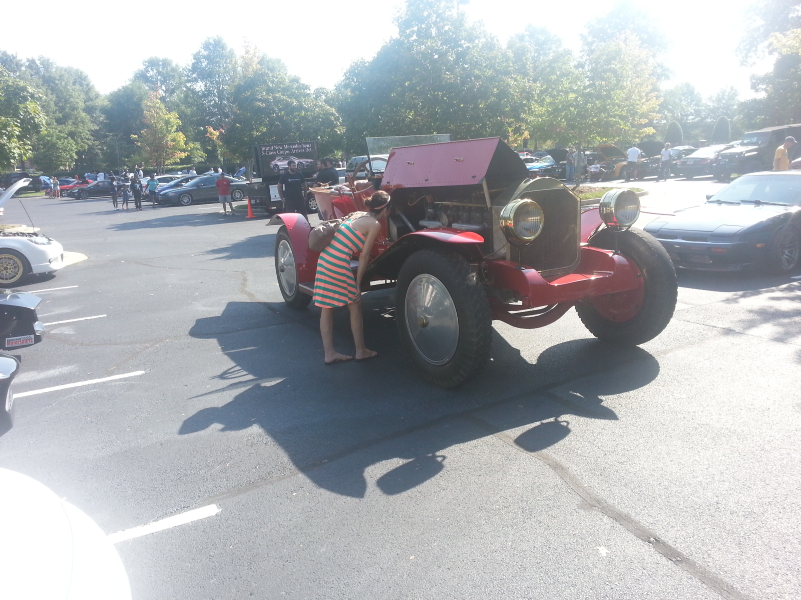

    Caffeine
    Got up early and Neil and I loaded the speedster and drove down to Caffeine and Octane. We got there about 7:30 and the place was already packed. Luckily we found a parking spot for the rollback and unloaded the speedster. There was no room to park in the parking lot so I just parked in the middle of one of the rows. The crowds loved the Seagrave. I got all the usual questions, the most often being: What kind of engine is it? Not sure how to answer that since it's so broad. We stayed until about 11:30. Mike Thies of Global Wheels Events said he was going to do a blog about the car so I sent him a bunch of info. Another guy said he was going to get it invited to Amelia Island. Ha, ha. That costs big money! We were having so much fun I forgot to take any pictures until the crowds started to dissipate. Anyway we had fun.

    Interesting to see it with people next to it. That thing is huge!
