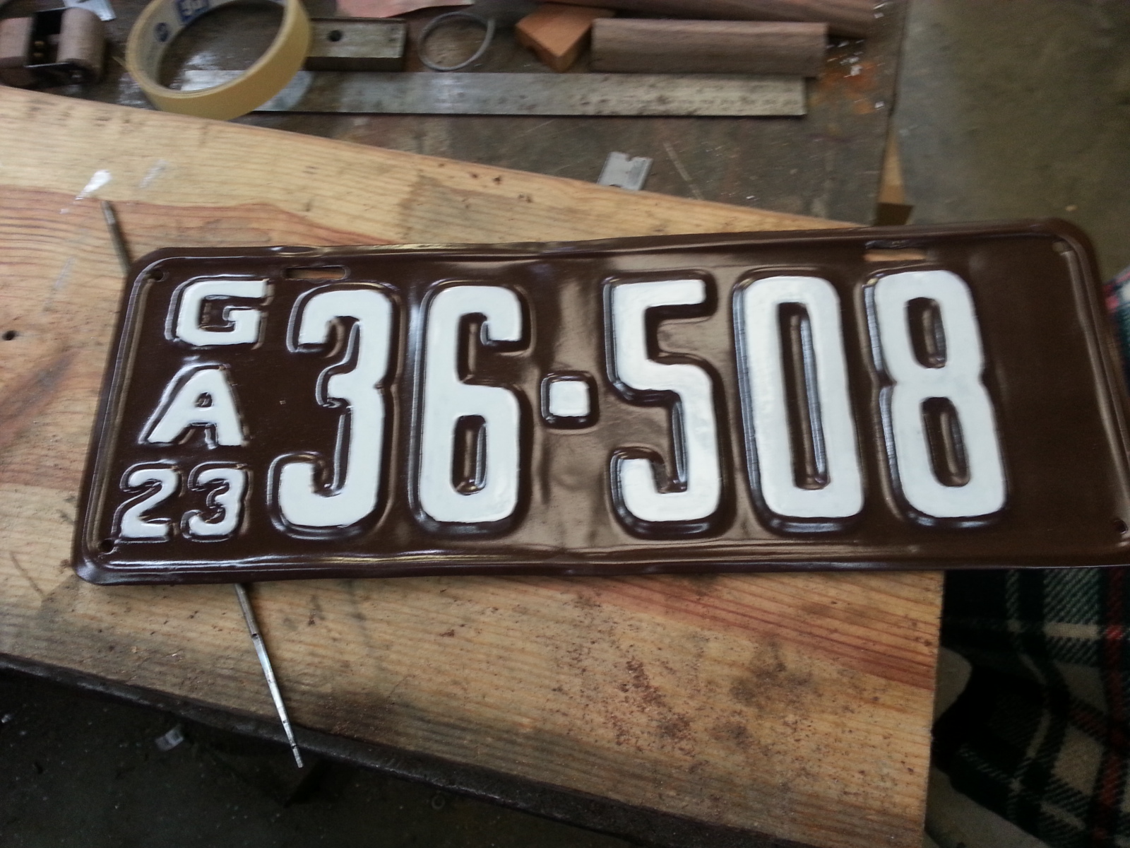

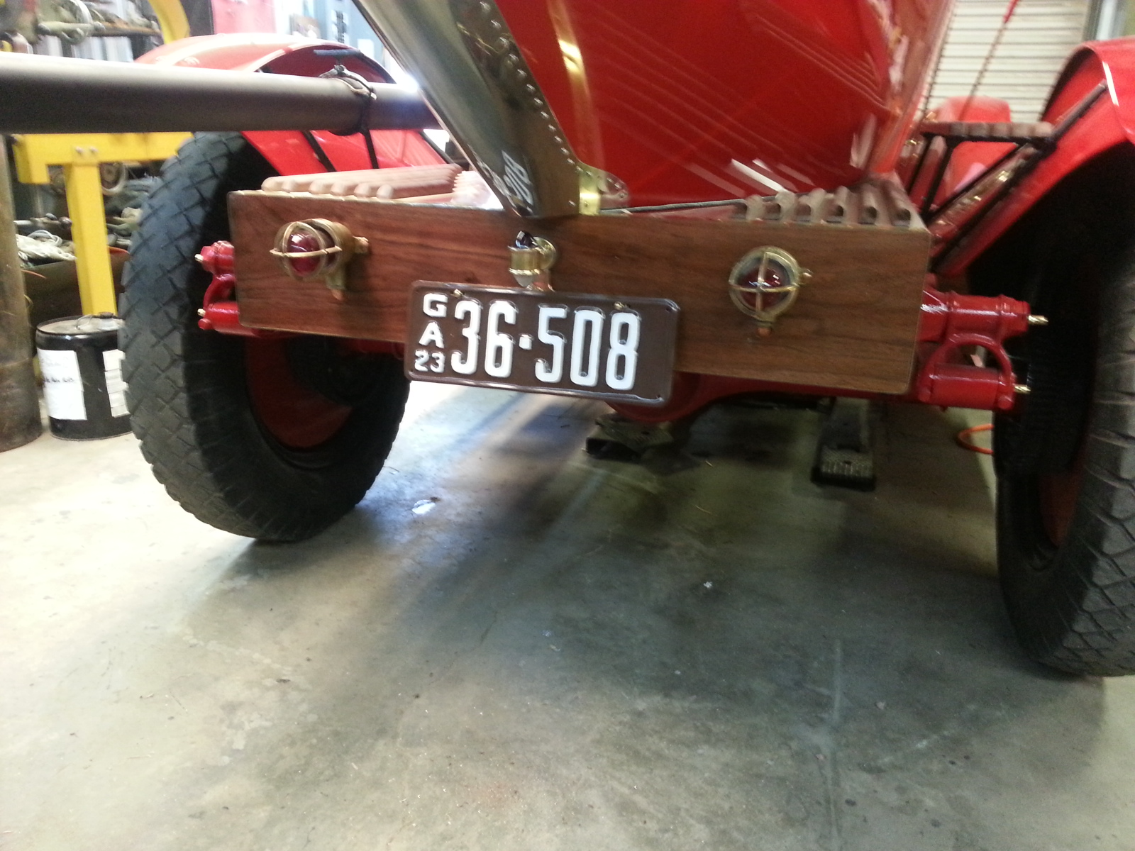

    I tested a bunch of ways to paint the numbers on the plate. You guys had some good suggestions but I was in a hurry so I finally just thinned out some oil paint and brushed it on. I'll hope no one bends down too low to look close. I also mounted the "tag light." I don't know what these lights were used for. I see them on ebay a lot. I thought it'd be a funky tag light. It took some doing to mate it to my br*** tag holder but I guess it's okay. After that I started drilling the holes to mount the wood trim beside the boattail. Hey, check out my cell phone charging station.

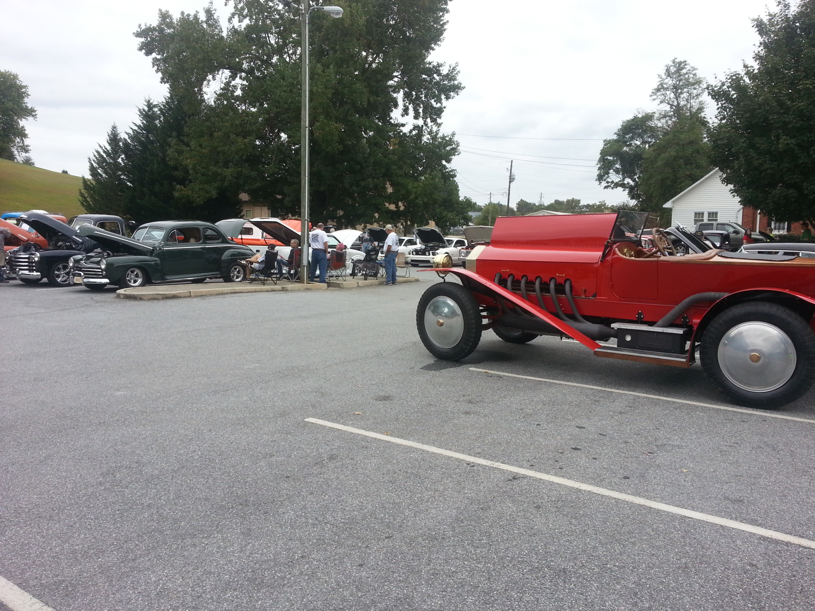

    Nice Rollses! Love the pizza pans. I've been going crazy. And no internet last night! Drove the speedster 12 miles. 6 to the show and 6 back. When we started out the thing had no power. I could barely get up a hill. I thought I'd screwed up the rear ratio. After about a mile I realized I had the timing retarded. I pushed it to full advance and the speedster took off. We were going 55 in seconds. It was exhilarating! The front end was pretty stable with only minor corrections. The advance kept falling back so I had to keep my thumb on it. When I saw the entrance to the car show I put on the brakes but they did little at 55 especially with the engine still engaged. The speedster over shot the entrance by a driveway. Note to self--get better rear brakes. A disc conversion is available but I'd really like some enormous drums about 16 or 18 inches in diameter. Hey, the biscuit warmer got up to 350F.

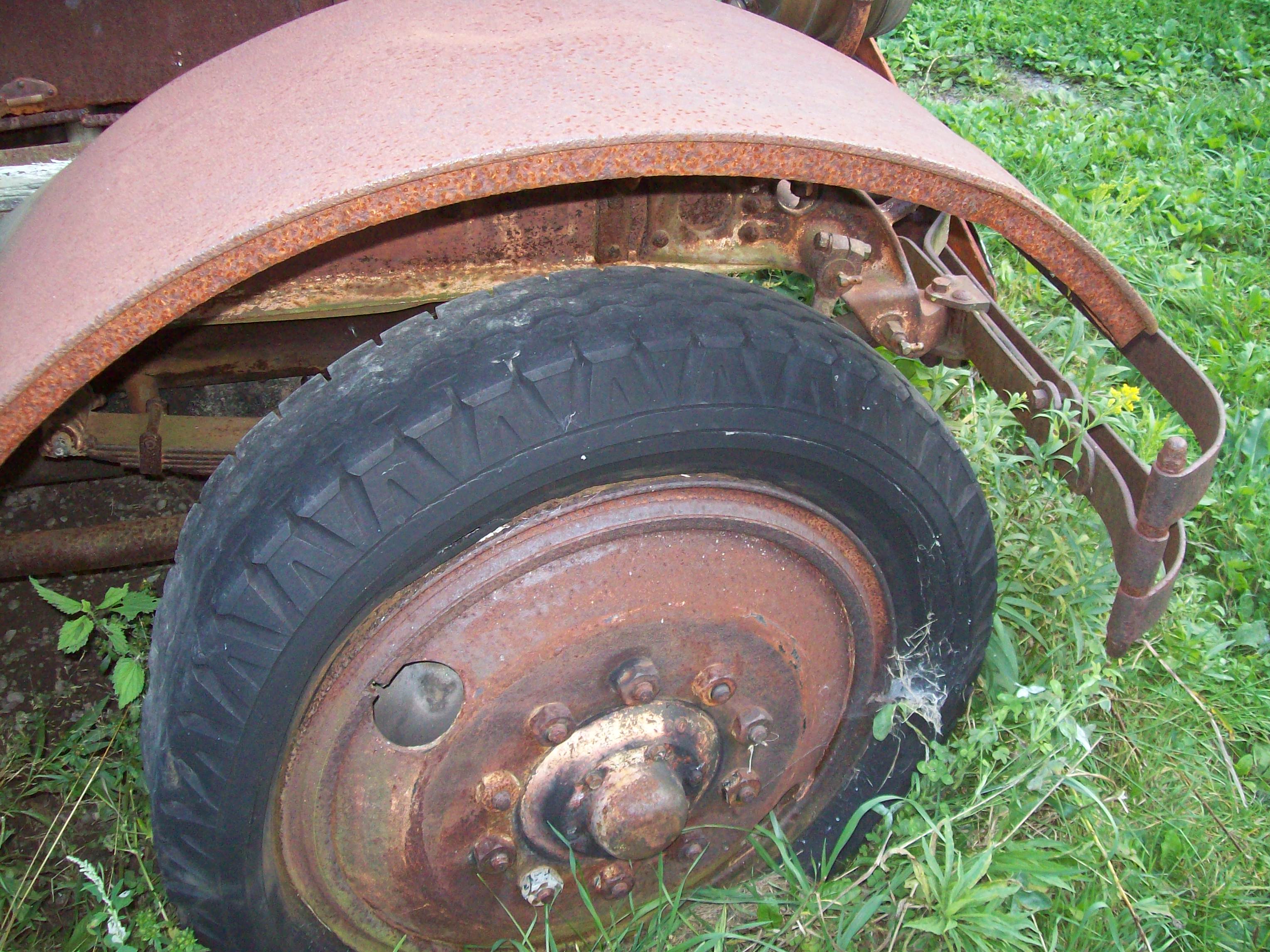

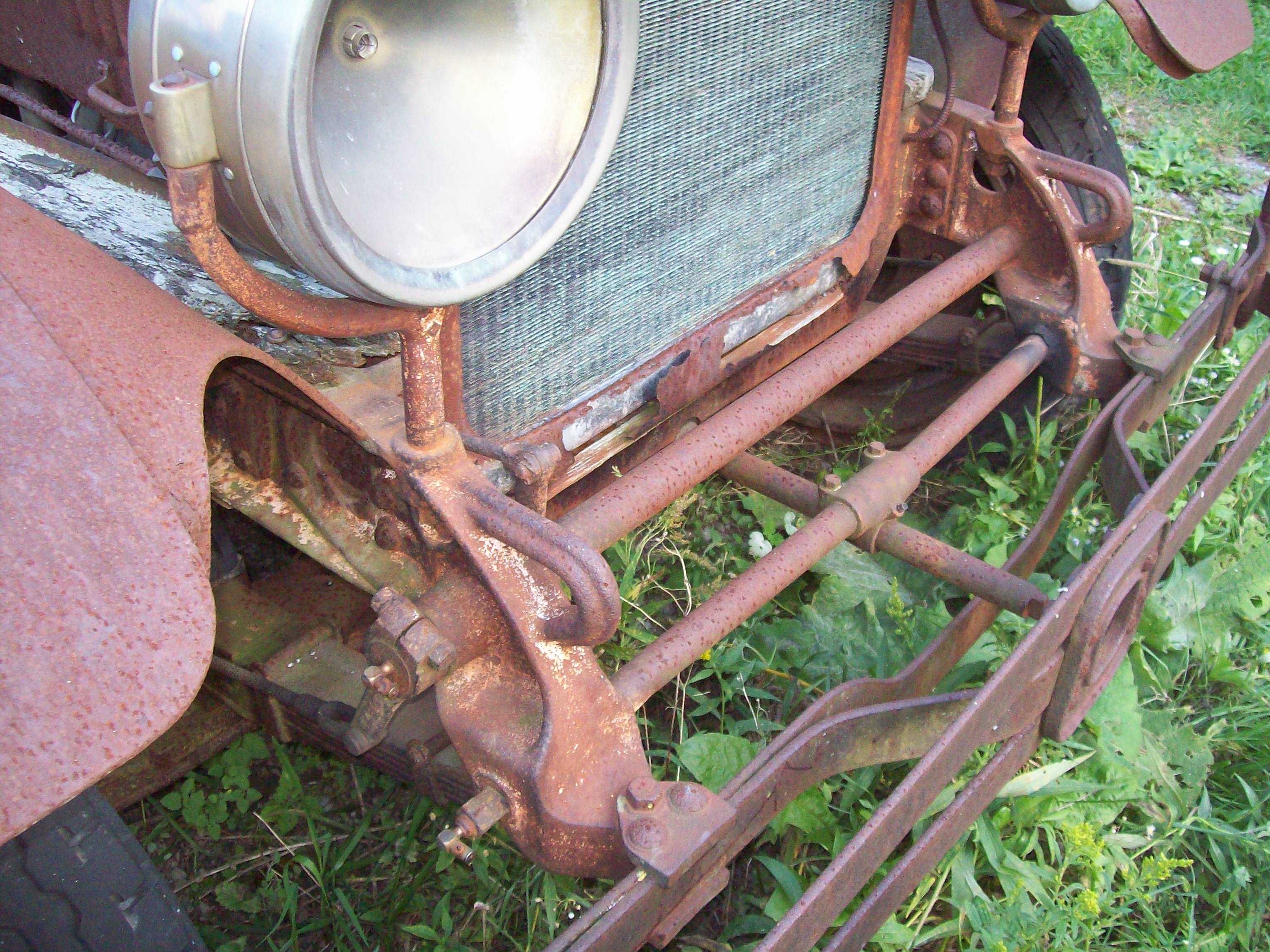

    002.JPG 003.JPG 004.JPG [QUOTE=". We were going 55 in seconds. It was exhilarating! The front end was pretty stable with only minor corrections. The advance kept falling back so I had to keep my thumb on it. When I saw the entrance to the car show I put on the brakes but they did little at 55 especially with the engine still engaged. The speedster over shot the entrance by a driveway. Note to self--get better rear brakes. A disc conversion is available but I'd really like some enormous drums about 16 or 18 inches in diameter. Hey, the biscuit warmer got up to 350F.
    Jerry[/QUOTE]
    Jerry,
    Here is a possible solution to the brake deficiency. You might find a little newer Seagrave front axle or this one is available with a lot of iron attached to it, including a spare 1013 cid engine. The mechanical set up could be adapted or more modern hydraulic parts could be mounted on the backing plates.
