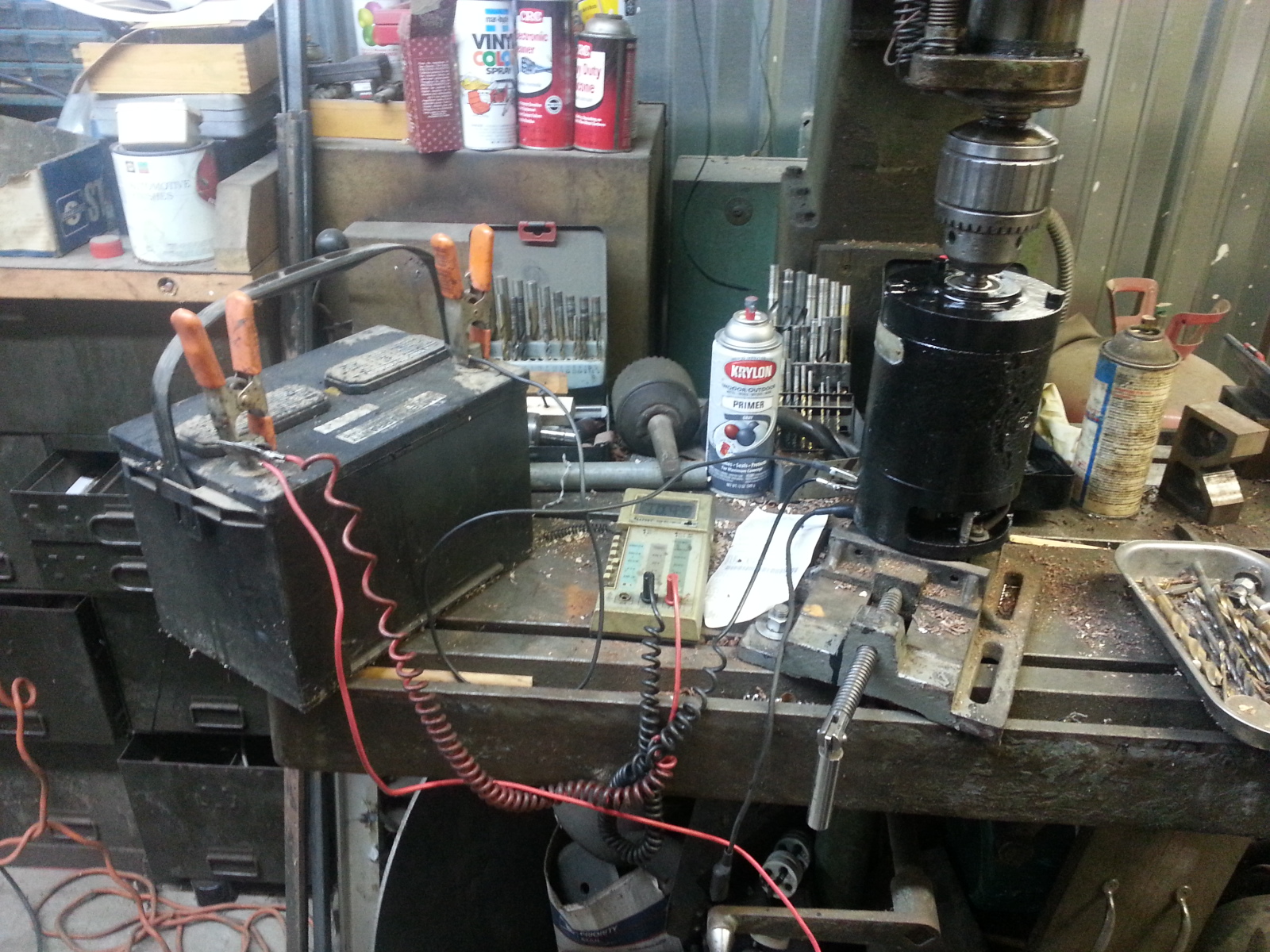

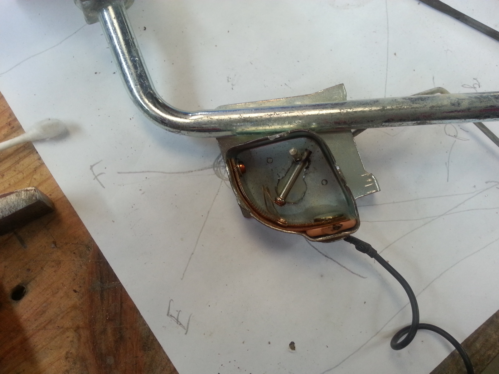

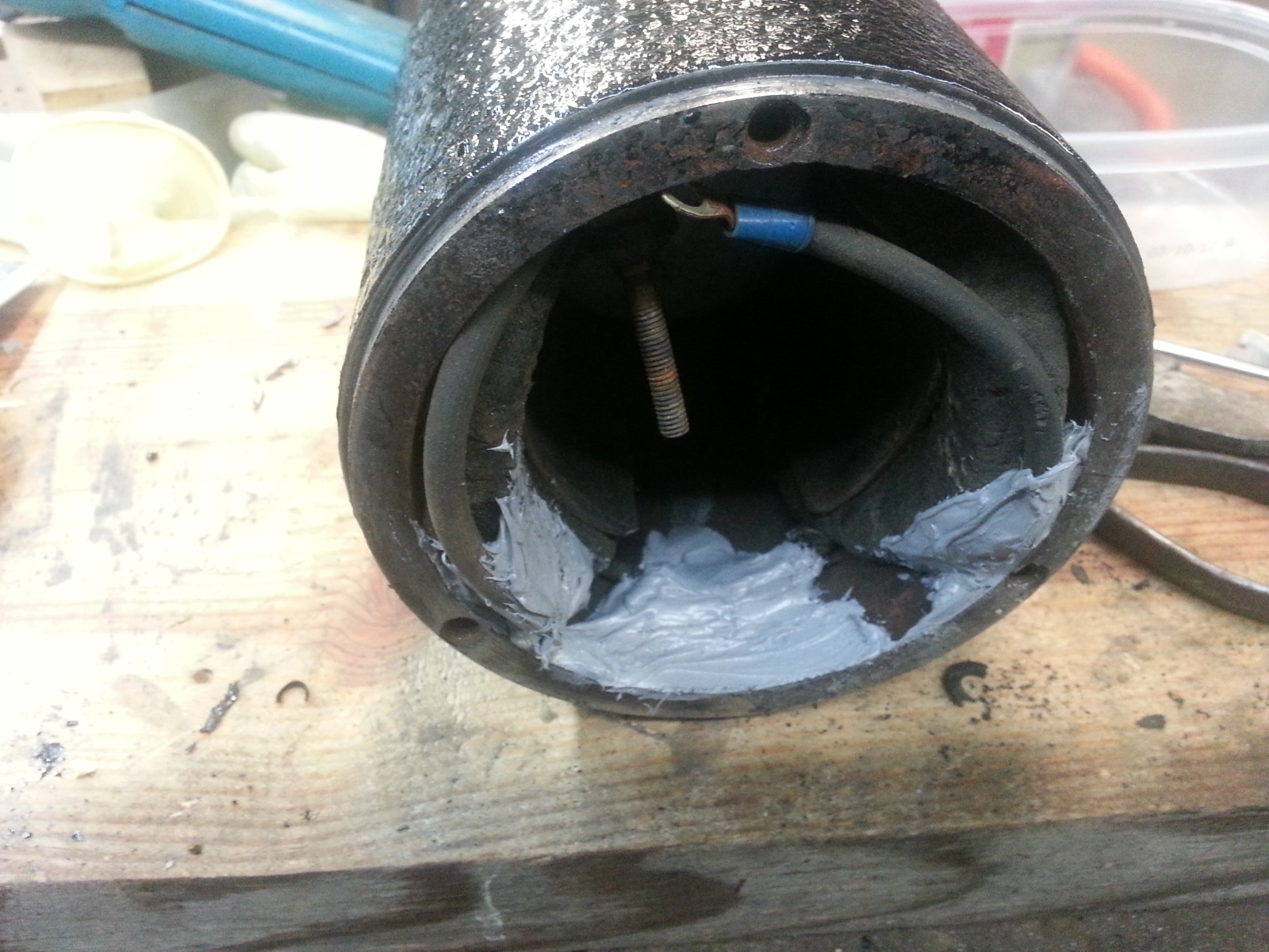

    Sorry for the absence. I've been crawling out and under the speedster about a hundred times. The gas gauge has not worked right. This is critical when you only get 2MPH and your tank is 16 gallons. The sender is a Mustang and the gauge is a Dolphin. The sender that came with the gauge was a big clunky thing and would have never fit in the tank. In typical Jerry fashion I just put it all together and figured I'd make it work somehow. Hah! Well, surprise the two systems--Ford and Dolphin--worked backwards. Had I gotten it to work, it would have made the gauge go from empty to full. I didn't like that, besides it didn't work anyway. So I took off the little can on the sender, turned it around and then drilled a hole for the pivot arm to go through. I bent the arm and finagled and tested and measured with my ohm meter and finally thought I got it right. But when I filled up the tank the gauge moved about a hand's width off the E. Damn! I drained the tank removed the sender and checked the float. When I worked the sender by hand the gauge worked okay but in the tank it didn't work. I drained and refilled about ten times. I even crawled into the boattail and looked down the filler hole to see if the float was moving. Eventually--yesterday--I realized two things. The float was not on the bottom of the tank and the float arm was too long and wasn't allowing the float to go all the way to the top of its stroke. I bent the arm and in effect shortened it about an inch. After I went all over town to find a new o-ring for the sender, I refilled and checked. Yes, it worked. Well good enough. With a full tank the gauge reads 1/2 and at empty it reads E. Perfect!
    Jerry

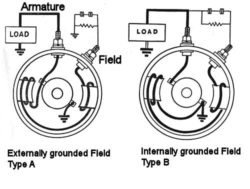

    I worked on the generator today. I put it all together and tried to figure out how to make it charge. I got it to motor, but that doesn't check the armature. I pretty sure the armature is fine, though. I figure I can eliminate the third brush--who needs that thing any way? According to my research it's an externally grounded field type. I don't think I had it wired up correctly on my homemade test platform. I'll try again tomorrow.
    Jerry
