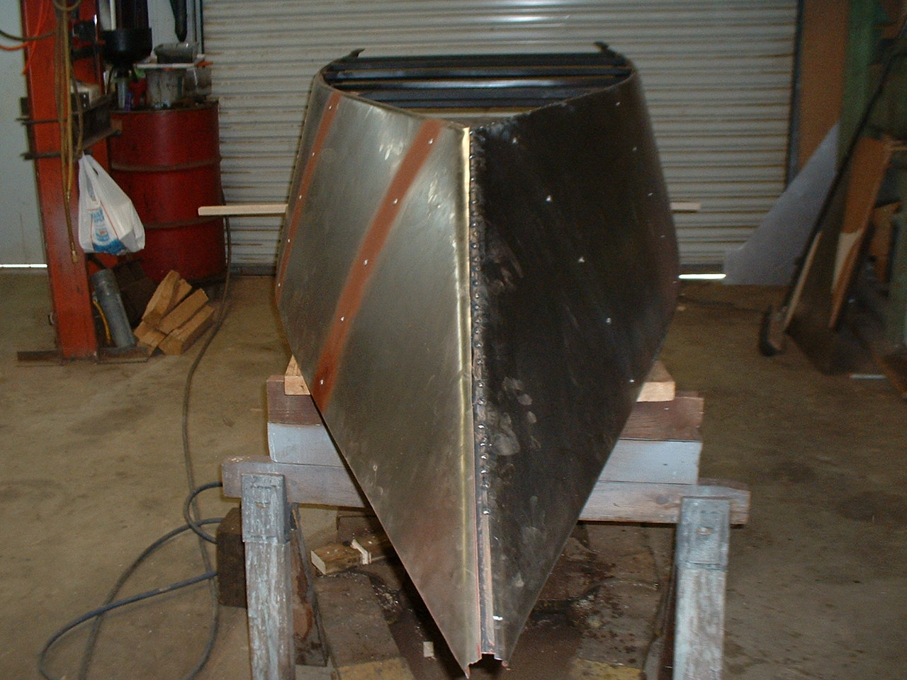

  9. yonahrr
    Joined: Feb 27, 2010
    Posts: 1,348
    yonahrr

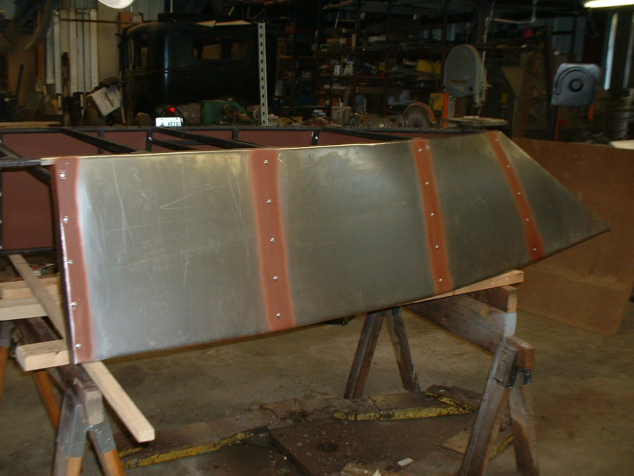

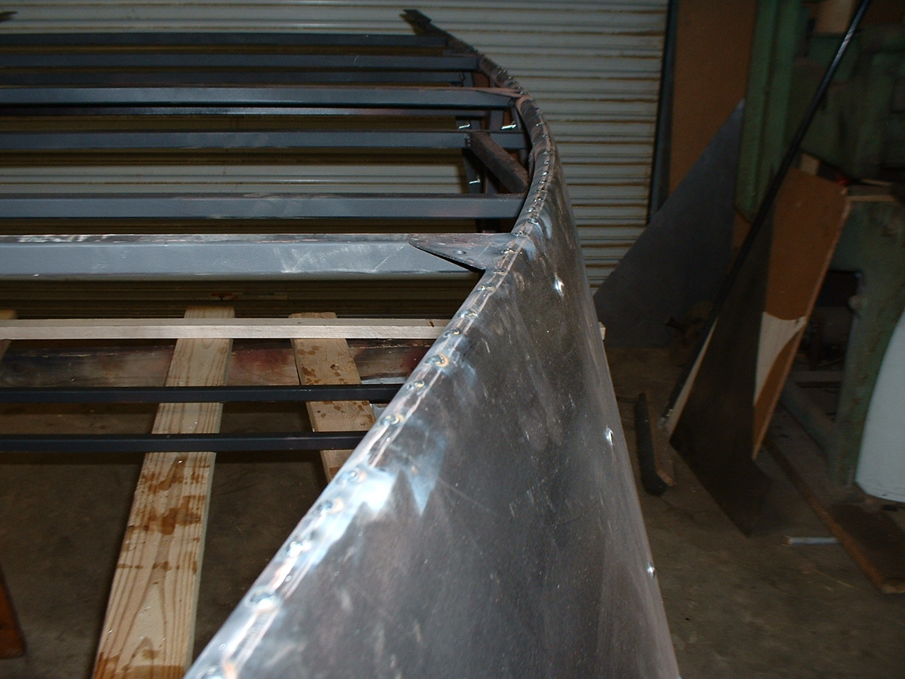

    Body
    I got both sides welded and bolted on. The extreme boattail (stern? reverse bow?) will get a br*** covering to hide the ugly. I've got a few puckers in the sheet metal that want to oil can so I'm going to try and shrink them. If I was smart I'd put the interior in now so I won't have to work hanging upside down through the p***enger's ****pit. The next step will be cutting and bending the sheet metal that covers the frame and wooden body support. Oh yeah, and the brake master cylinder mount.

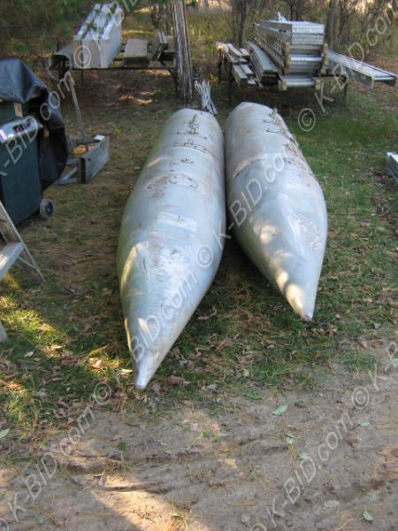

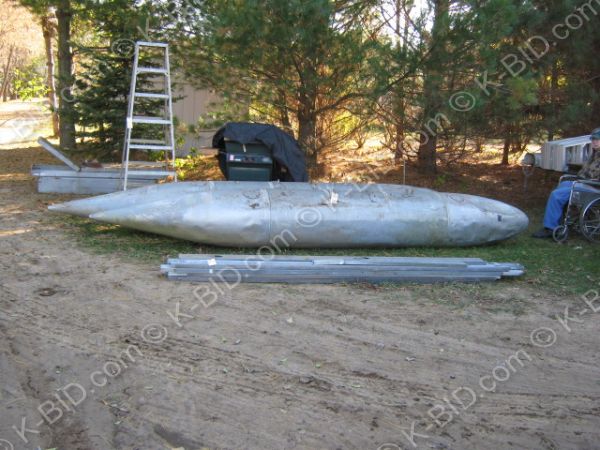

  11. paperdog
    Joined: Mar 26, 2006
    Posts: 5,176
    paperdog
    four of them they are 15 feet long:D

    yonahrr
    WOW! How big around are they? I'm thinking of strange cars.
    Jerry
  13. paperdog
    Posts: 5,176
    paperdog

  14. yonahrr
    Posts: 1,348
    yonahrr
    Those are really cool. I'm thinking really tall wire wheels and a big straight eight sticking out the top.

  15. paperdog
    Posts: 5,176
    paperdog
    i have seen a double tanker racer..(french?).. made with engine on one side driver on the other .. dunno how 3- 4 tanks together would work it would look like a handful of cigars
    reminds me of the newer bat mobile with a center turbine engine ..
    thes units come apart so the nose and tails could be swapped .. two noses or two tails or double the length of the center one for a stream liner
    they would be tight fit for a v8 but inline engines would be kinda natural..

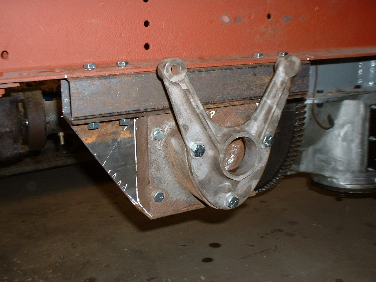

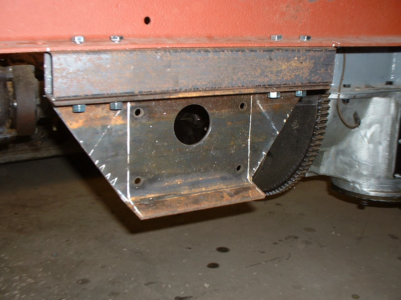

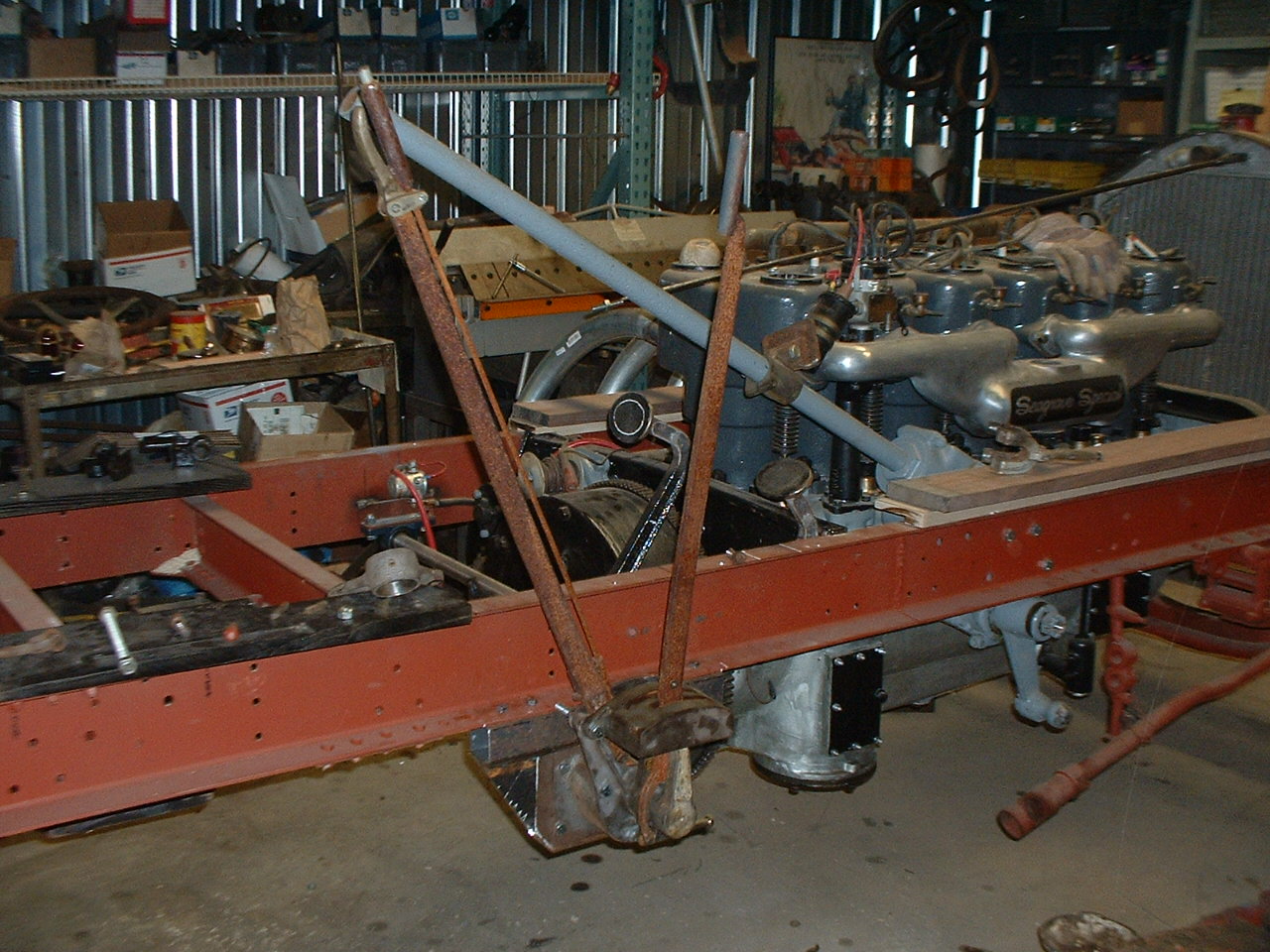

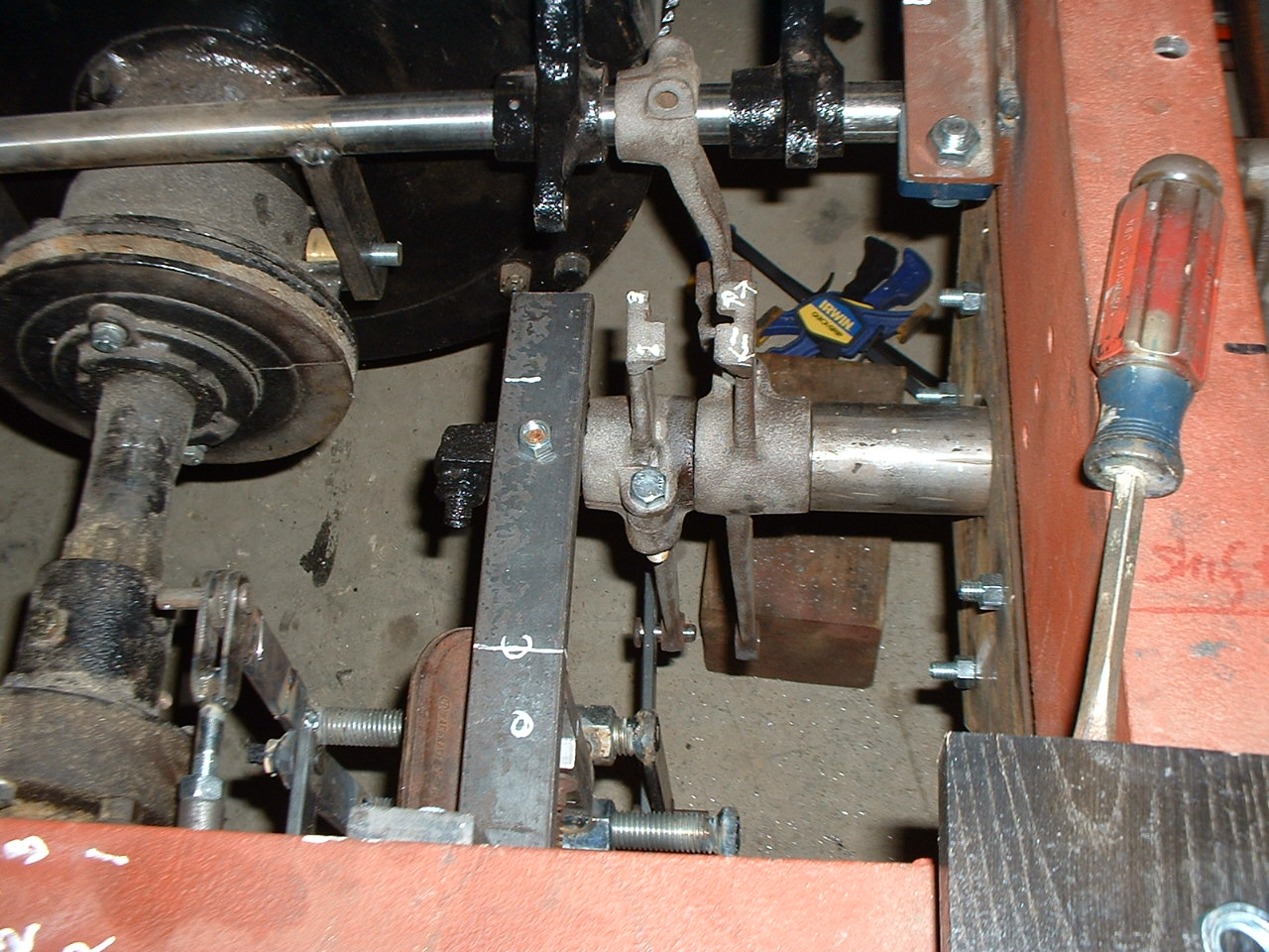

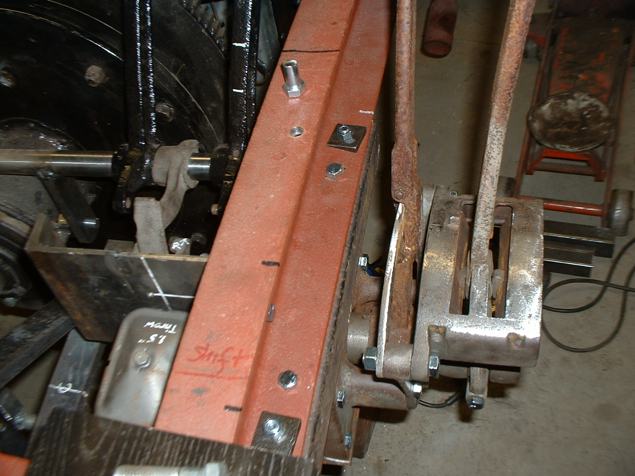

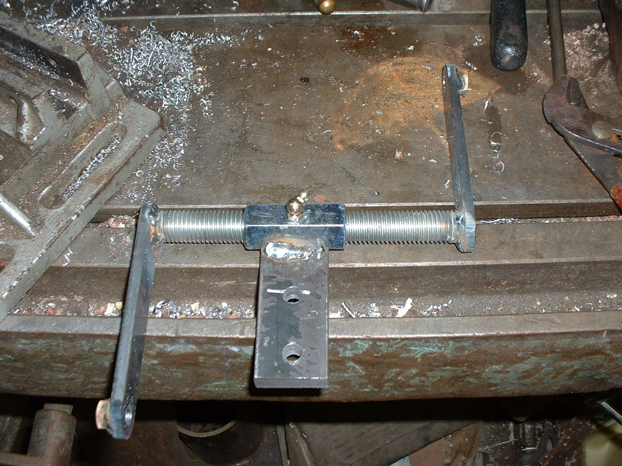

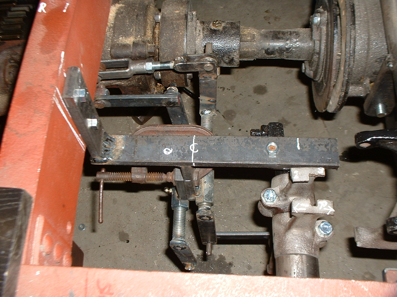

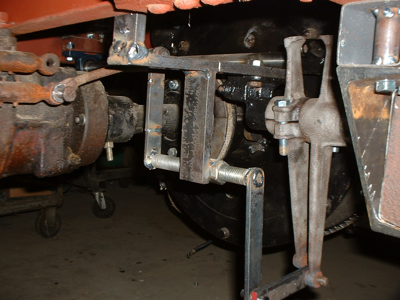

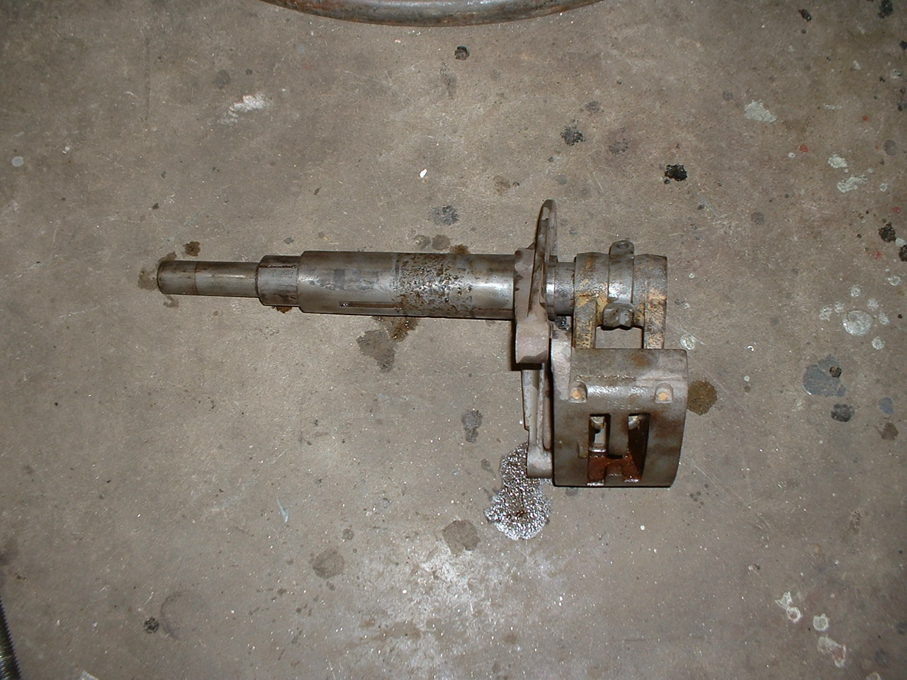

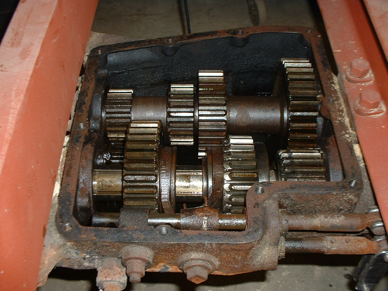

    Shifter/Brake
    Well, I started to make up the brake master cylinder mount but I realized I had to position the shifter ***embly first. The shifter and hand brake levers mount outside the body on the frame. I always loved the look of that set up. Because I had shortened the ch***is and lowered the pedals I knew I'd have to make up a new bracket to mount the shifter/brake. First though, it had to come apart. After upteen years of sitting in the weather the set up--which consists of a shaft in a shaft in a shaft--was rusted together tight. Using a piece of 3/4 all thread and a nut, I welded a makeshift (no pun) puller right on the shaft. After repeated heating and swearing the unit finally came apart. Grinding and bead blasting finished the cleanup.
    Jerry
    <input id="gwProxy" type="hidden"><!--Session data--><input onclick="jsCall();" id="jsProxy" type="hidden">
  18. yonahrr
    Posts: 1,348
    yonahrr

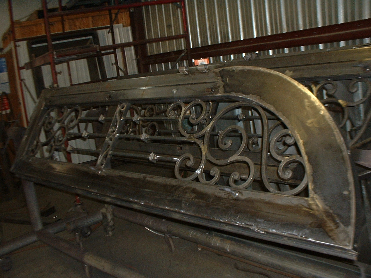

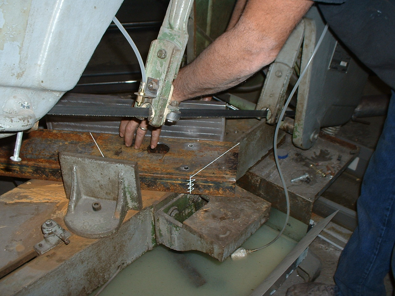

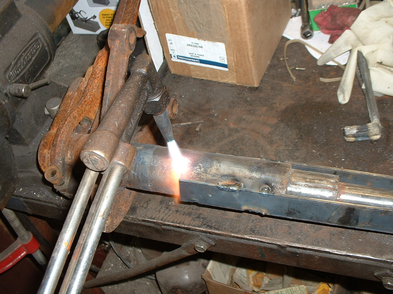

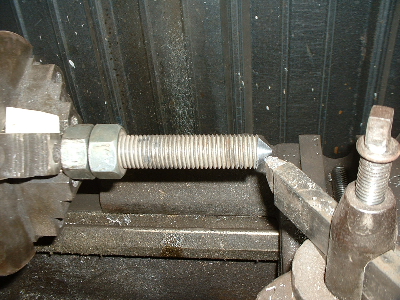

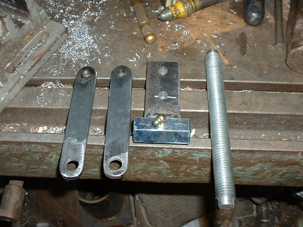

    More shifter
    I needed a bracket for the shifter and my band saw wasn't big enough to cut 6" channel so I went to see my buddy, Israel. He makes custom iron doors. If you appreciate metalwork you should look at his website. <cite>www.[B]IronDoors[/B]ofAtlanta.com </cite> I took the bracket back and mounted it. The linkage is quite elaborate and I won't attempt to explain how it works but suffice it to say that the lockout mechanism is built into the shifter and not the transmission. Since I moved everything from it's original position sorting things out will take a while. <cite> </cite><cite></cite><input id="gwProxy" type="hidden"><!--Session data--><input onclick="jsCall();" id="jsProxy" type="hidden"><input id="gwProxy" type="hidden"><!--Session data--><input onclick="jsCall();" id="jsProxy" type="hidden">

  24. yonahrr
    Posts: 1,348
    yonahrr

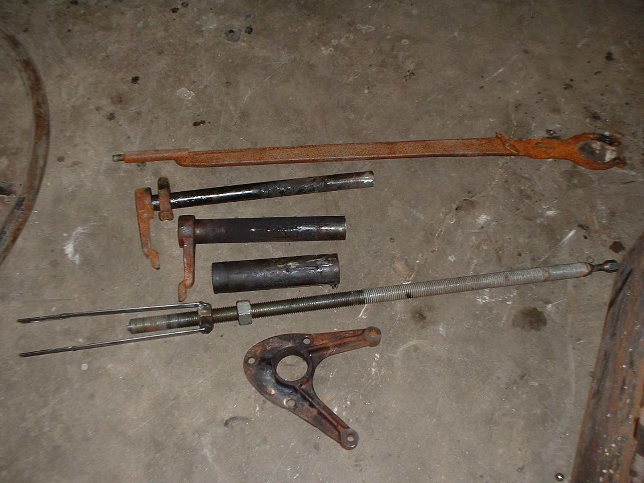

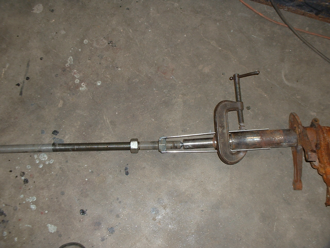

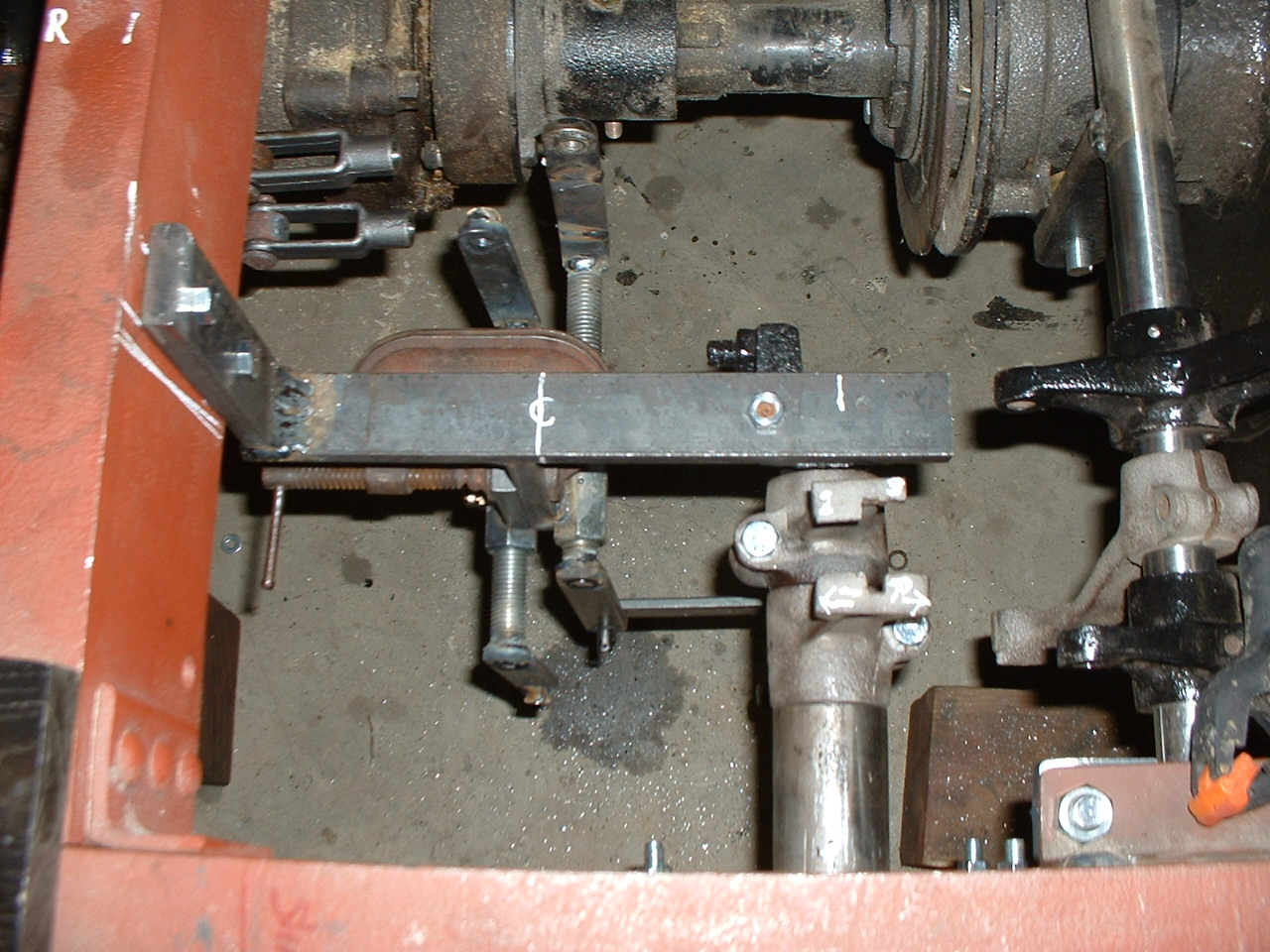

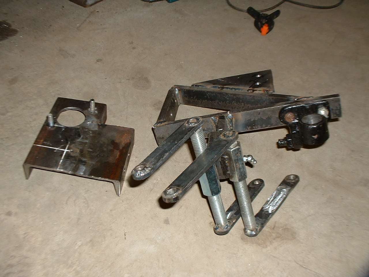

    More shifter
    So everyone is probably getting tired of reading about shifter linkage but I've got to slog through it. All this has to be done before the body can go on. I used 3/4 all thread because it's easy to mount using threaded couplings and the threads make lots of surface area to wear on. I added a grease fitting to keep it lubed. I know it looks Rube Goldbergesque but it shifts smoothly and that's what matters. Only one more part to make (hopefully and then I start on the master cylinder mount. After that cleaning and painting the parts.
    Jerry

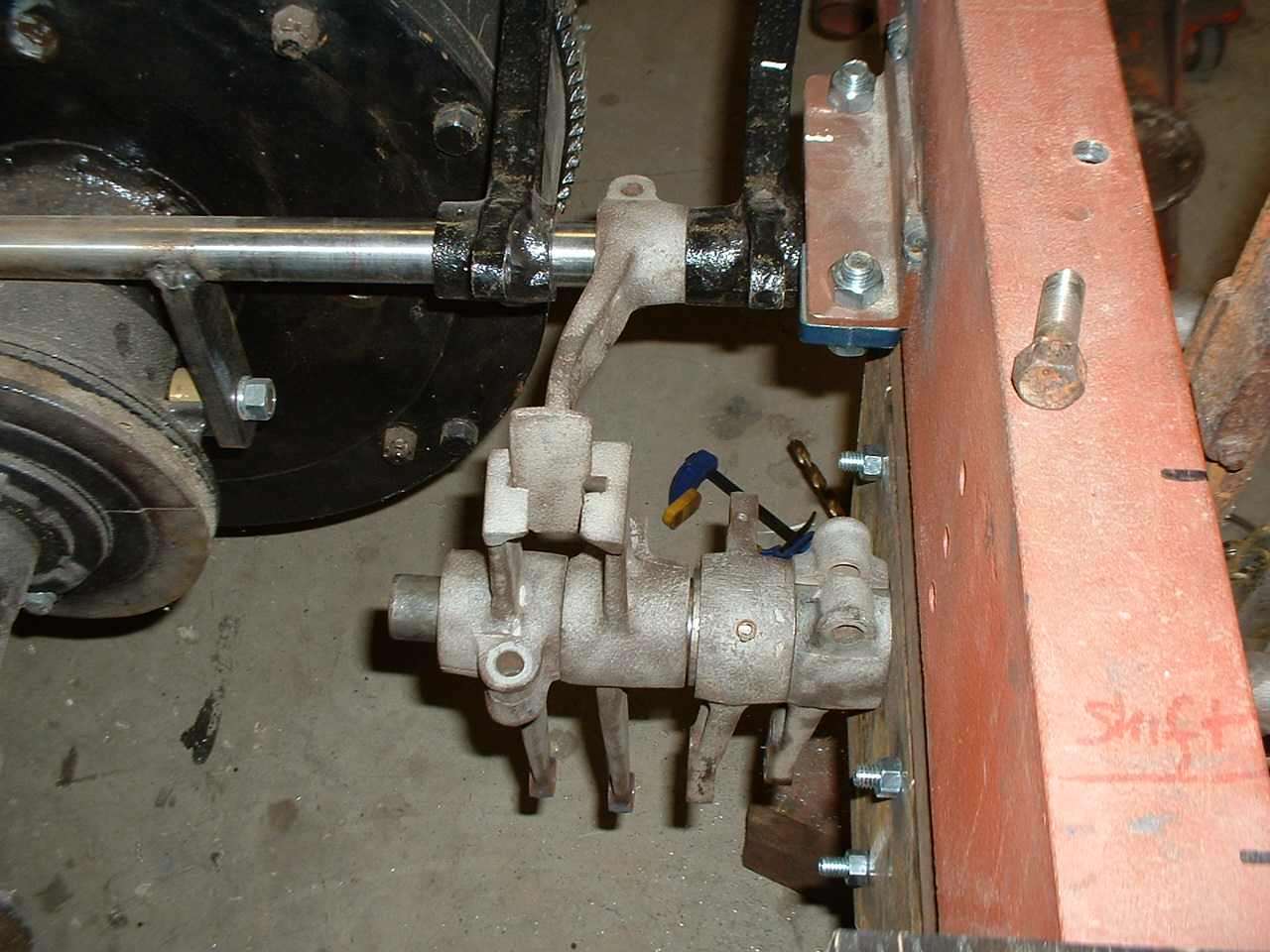

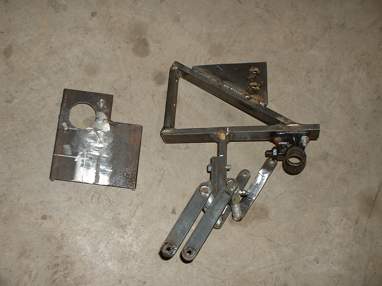

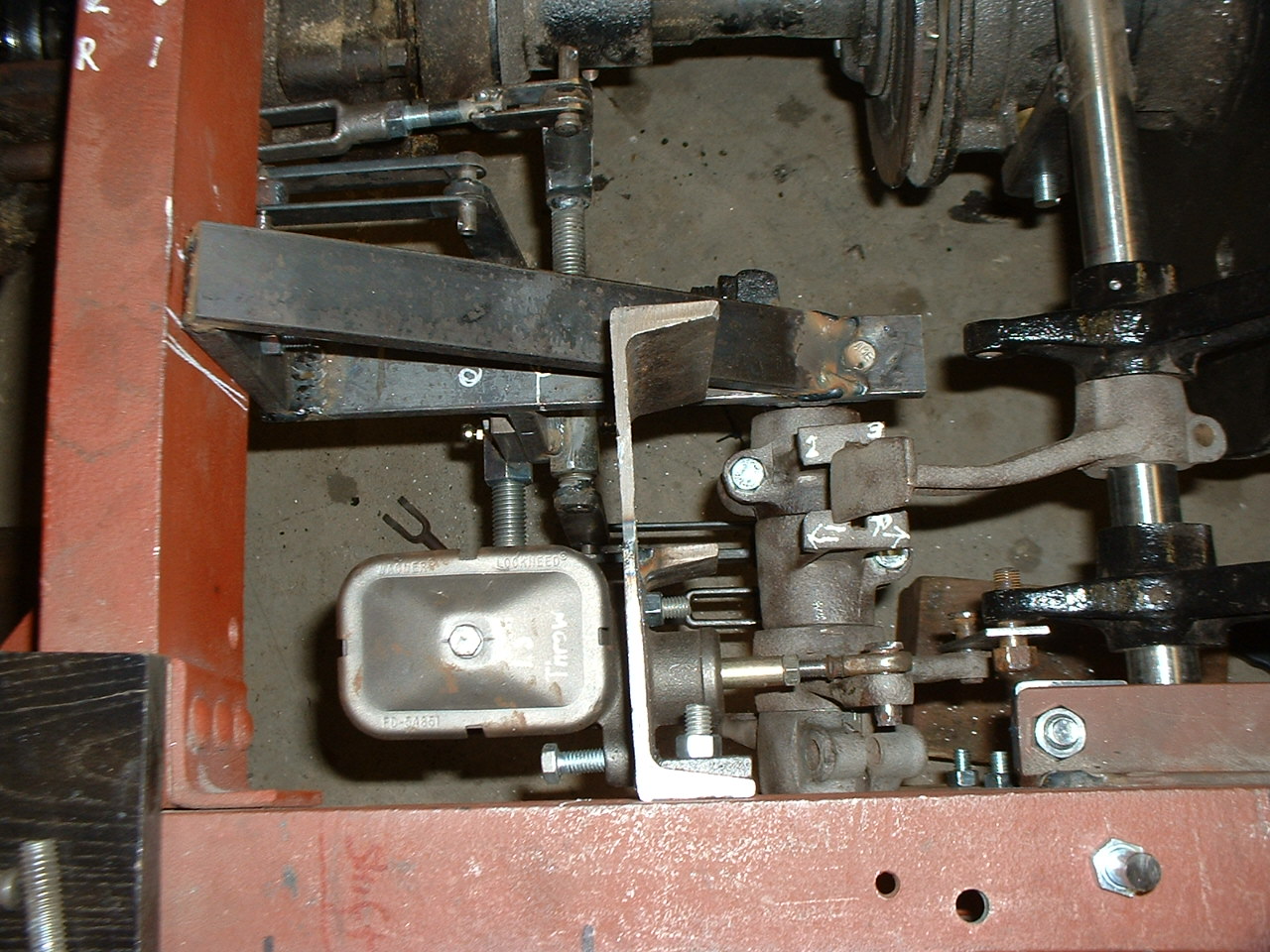

    Finally,
    I've done all I can stand on the shifter and brake setup. This is the most complicated mechanical gadgetry I've ever made. Unbelievably, it all works and shifts properly although the shift pattern is reversed. No matter. I think the master cylinder is off a Chevy truck. I've still got to clean the whole thing up but that can wait.
    Jerry

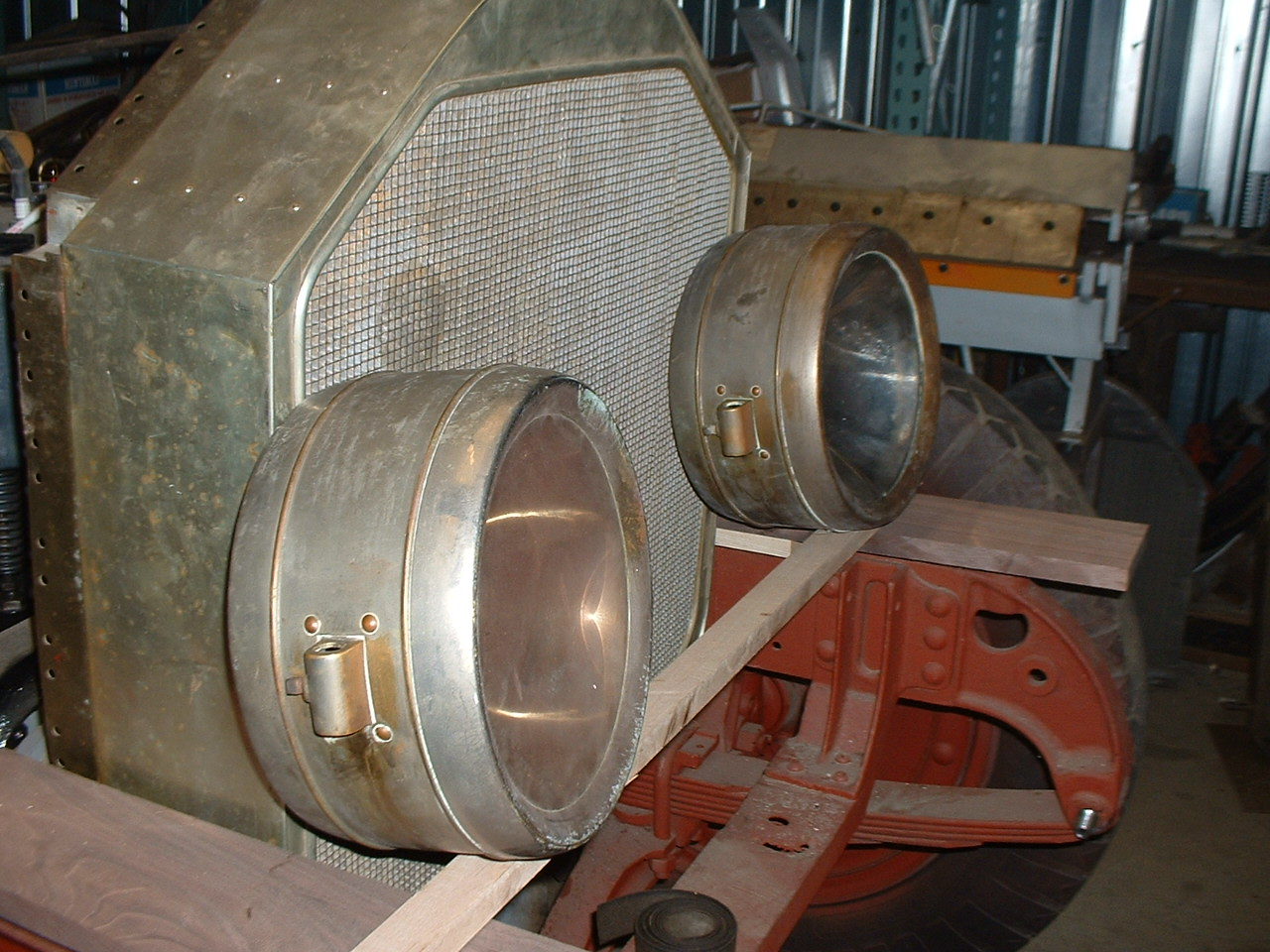

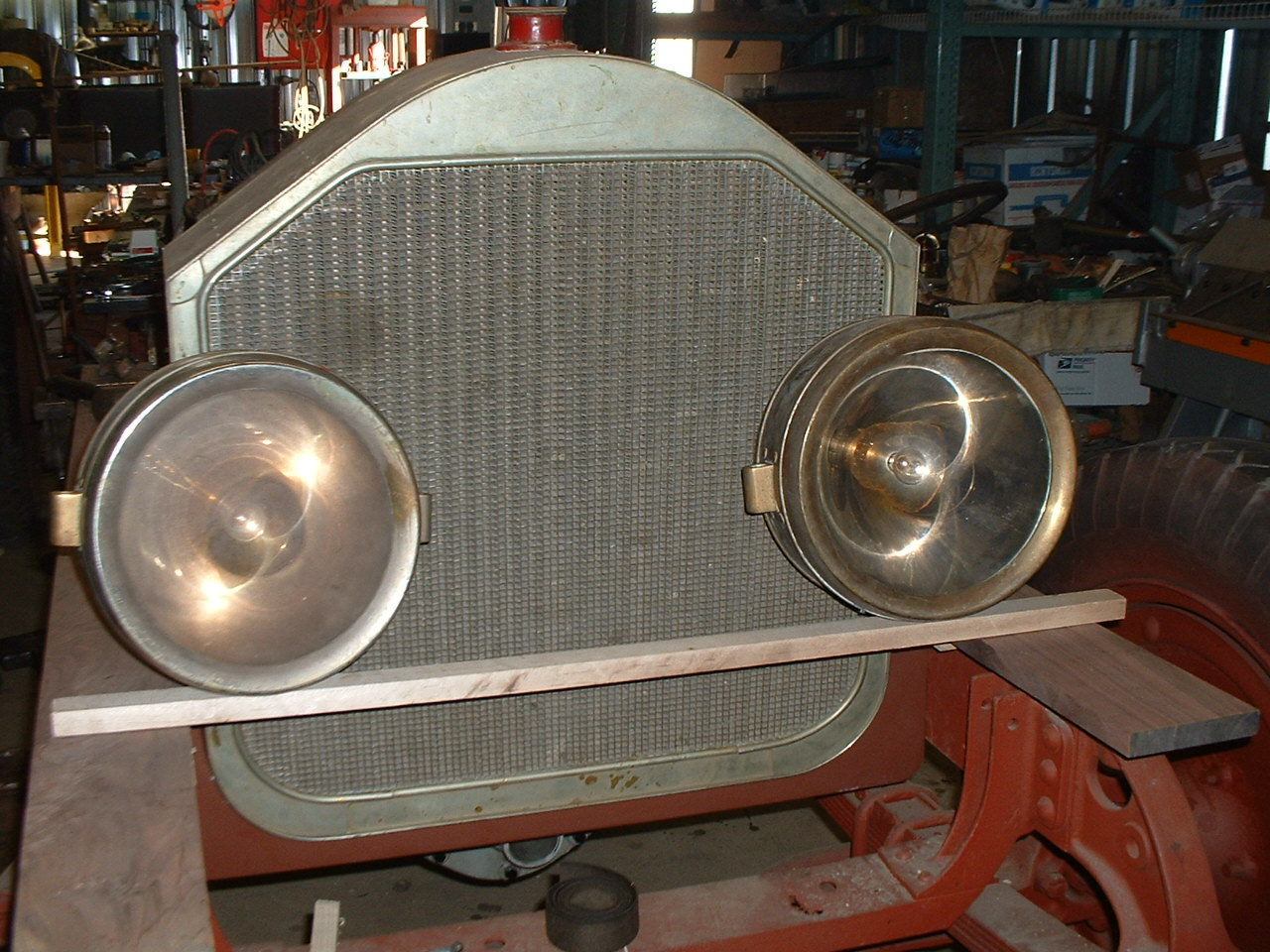

    Another Miracle
    This one is from ebay. I've been looking for some headlights for a long time. A nice big br*** set came up on ebay but they went for over $600.00. I couldn't afford those. Then another br*** pair came up. These were the drum type which is perfect for a 1923. In fact, they looked like the exact set that came on a 1923 Seagrave firetruck. They hovered at $66.00 for six and a half days. I wanted them real bad so I put in an Esnipe bid for $228.00. I thought I'd be well over the next highest bid but I only beat out the guy below me by 3 bucks. He bid $225. That was too close! Don't they look great?
    Jerry

    Cut down copper domestic hot water cylinders can be quite effective grille shells.
