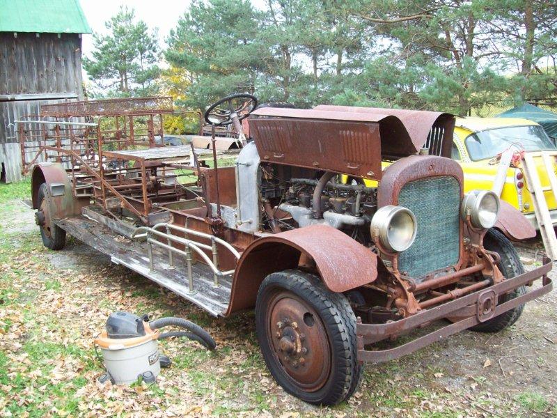

    Check into the Bronco fuel tanks, I had a 1986 it had a 33 gal tank that fit between the rails. You could probably use two of them:D
  2. yonahrr
    Joined: Feb 27, 2010
    Posts: 1,348
    yonahrr
    33 gallons! At $93.00 I couldn't afford to fill it up. Let's see though, if I only get 5 MPG, that'd give me a range of about 70 miles. My 16 gal tank will be about 35 miles. Damn, 35 miles will barely get me to the next town! Too late. I already bought the Mustang tank. I'll be pissed if I run out of gas. LOL

  5. yonahrr
    Posts: 1,348
    yonahrr
    You're the second person to point that out to me this afternoon. Hey, I never said I was any good in math. Thanks. Anyway, I can't even drive a modern car 85 miles. I like to get out and shoot the bull every 20 miles.

  6. gas pumper
    Joined: Aug 13, 2007
    Posts: 2,964
    gas pumper
    16 gal tank, two gallon red can, cell phone. :D
    That's all you need.
    I worked at a place that used to have some big Hall-Scott inline sixes. Before I got there. They thought they were pretty good, being overhead cam hemis. They got 3 mpg.
    Your old technology might not even do that good.

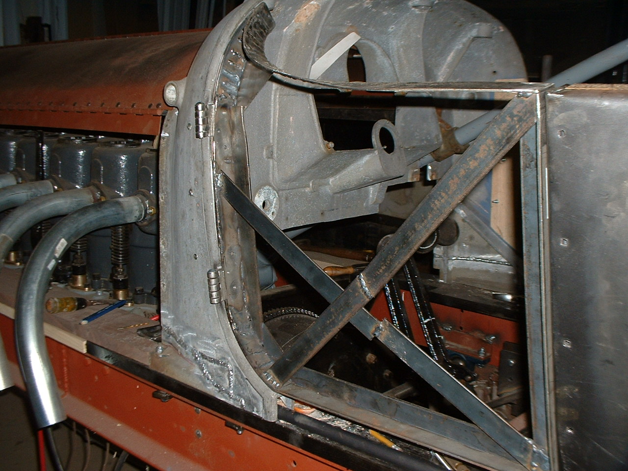

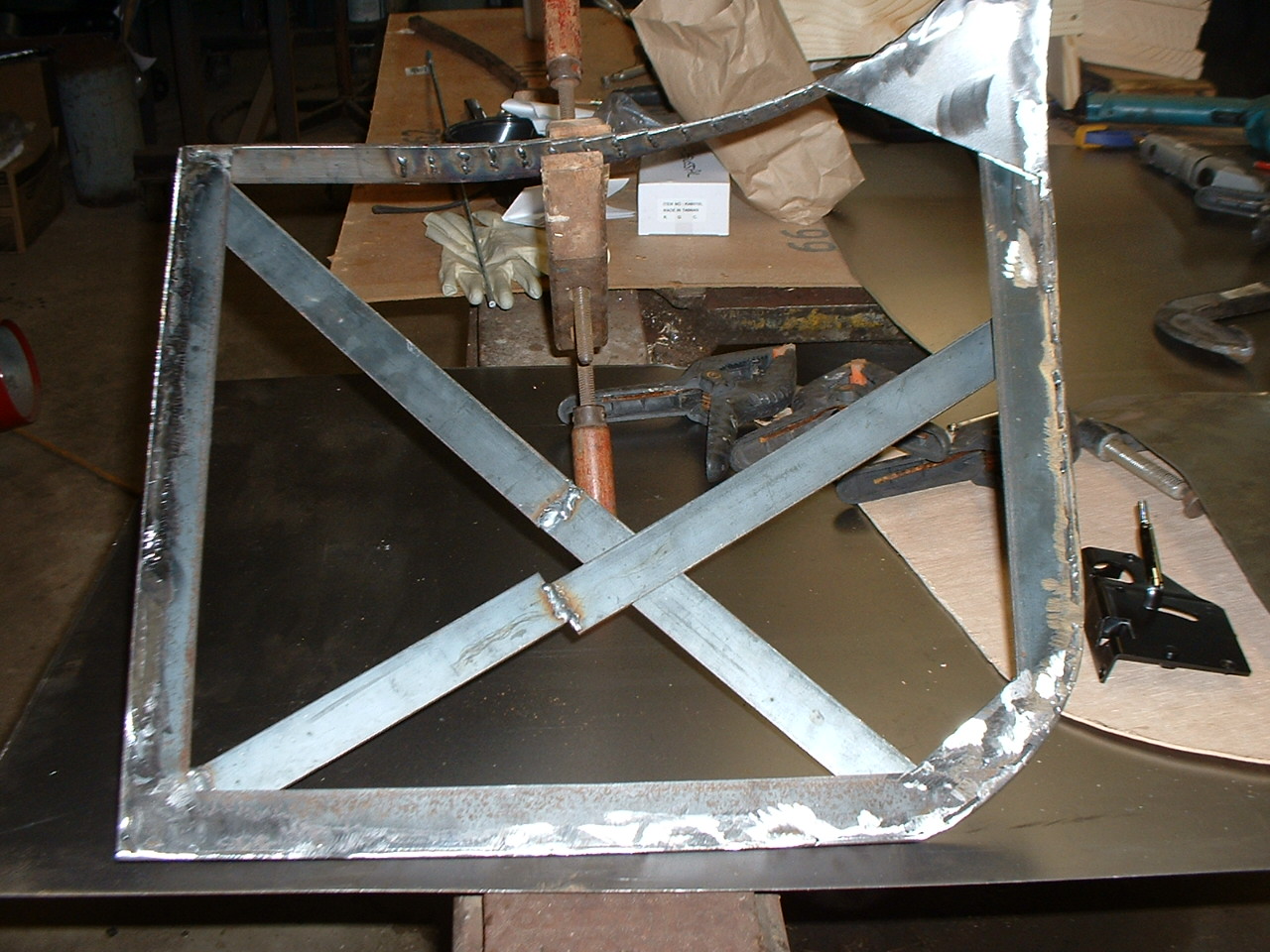

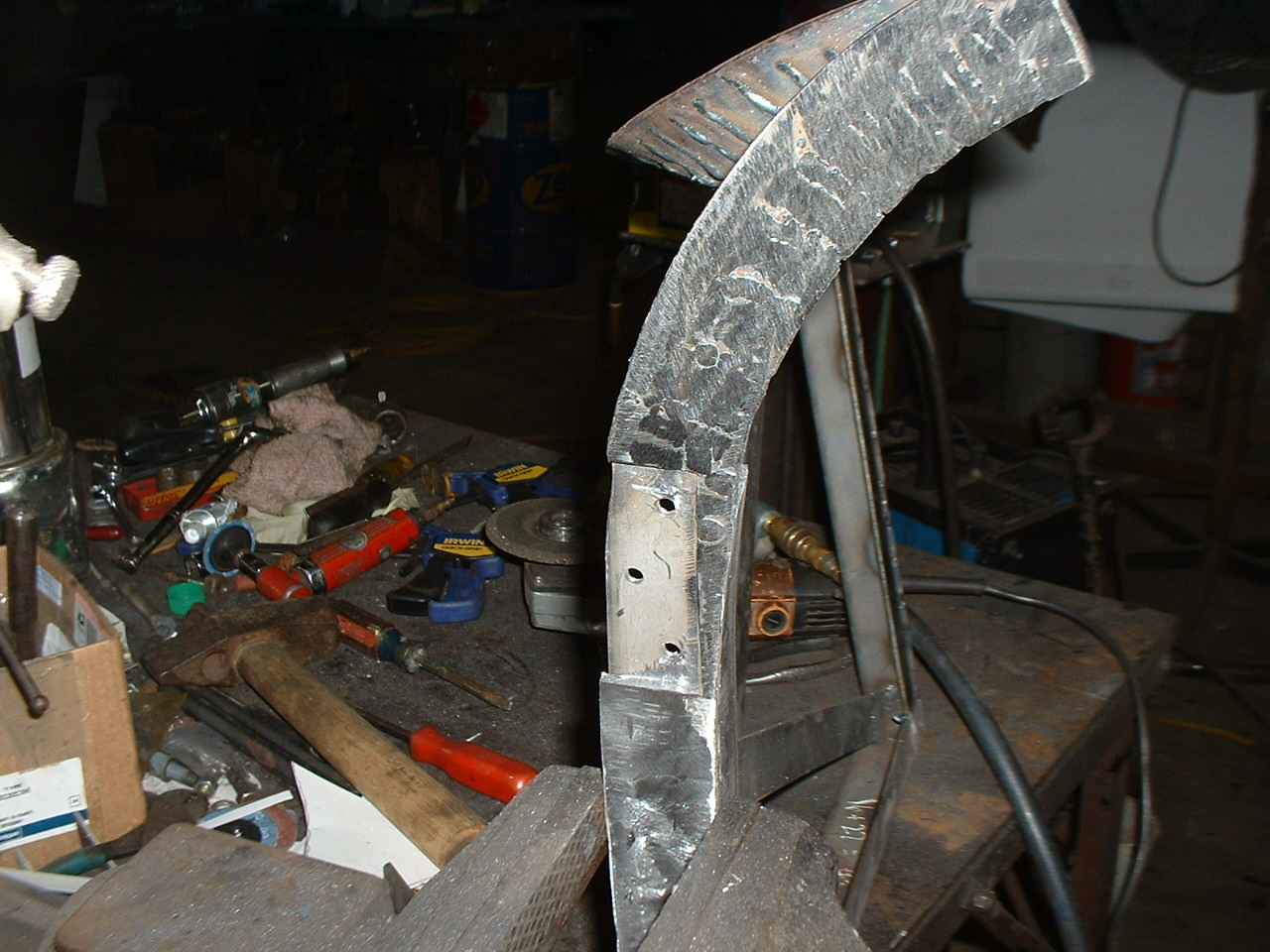

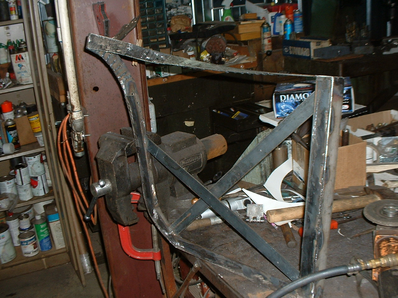

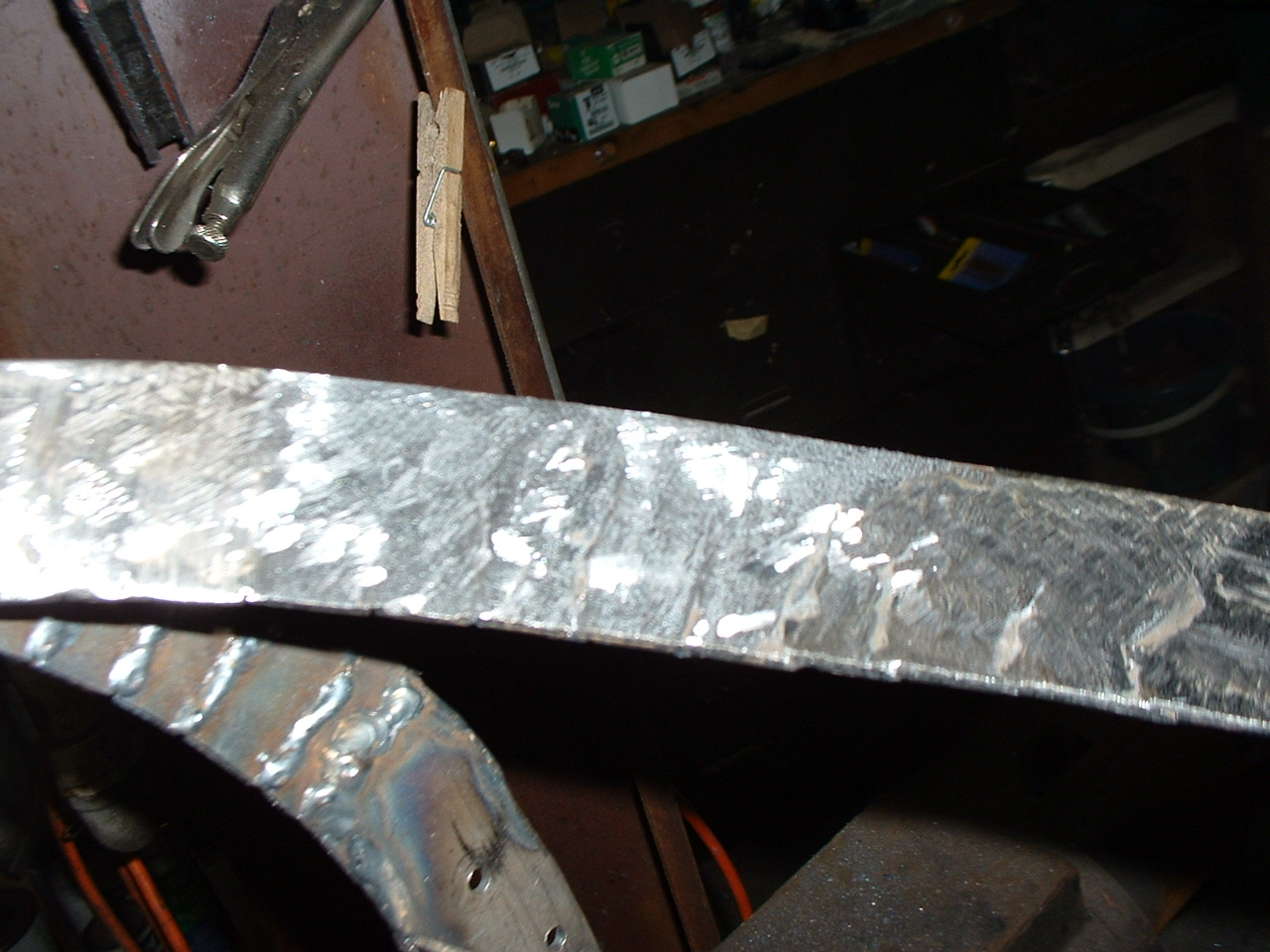

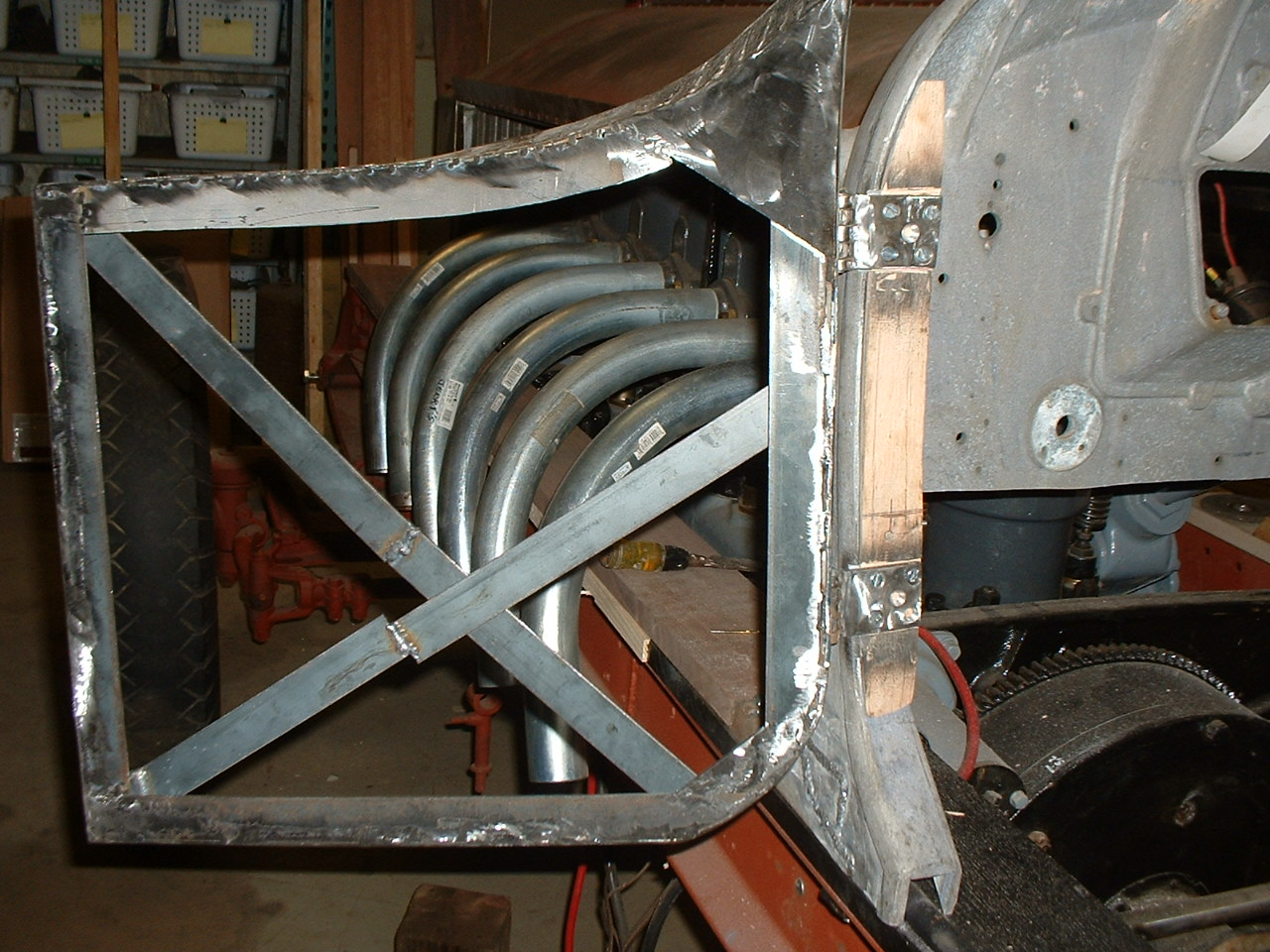

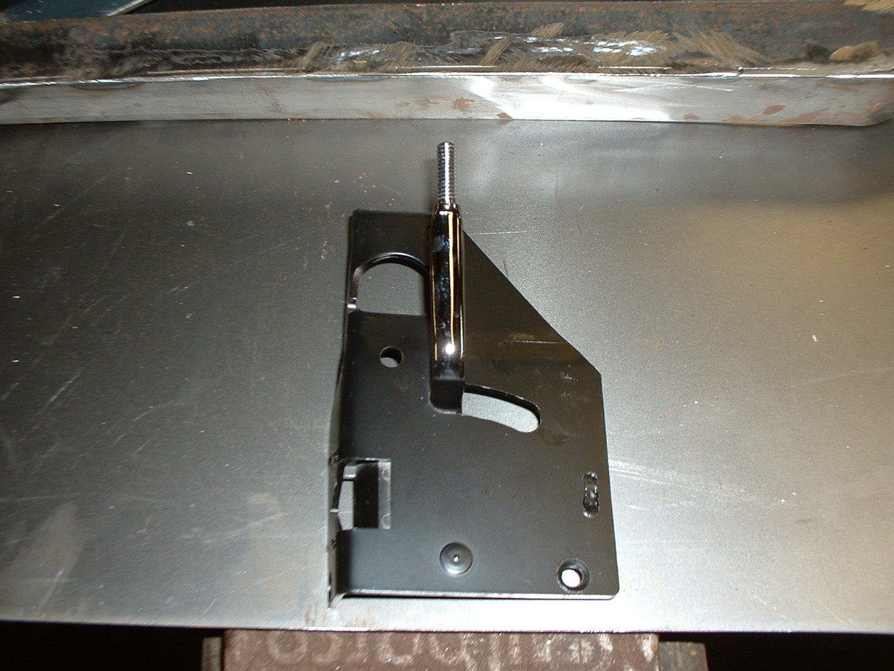

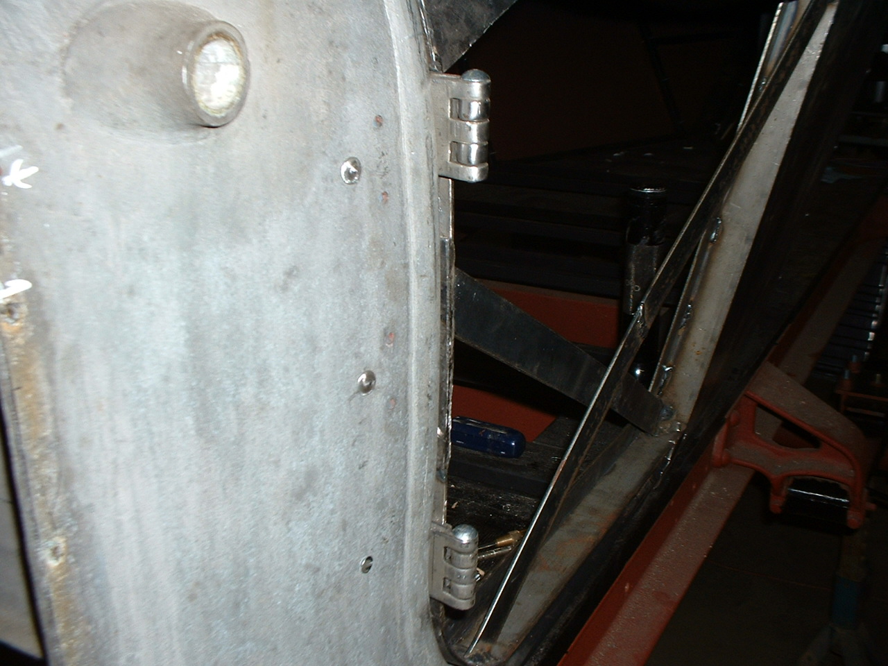

    More door work
    I worked on the left door. It needed to be beefed up and have some supports welded in for the door panel to attach too. I also worked on building a latch but soon realized I'd be better off to buy something. That's where Mike's "A" Ford-able Model A parts came in. http://www.mikes-afordable.com/ The door latches and striker plates from a 1928 open car will work perfectly on the Seagrave doors--and they're reasonably priced thanks to Mike. You can see one in the last picture. I also bought some footman's loops for the door stops. Might use some other parts too. Got to read the catalog.

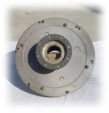

  9. Jack Innes
    Joined: Nov 26, 2010
    Posts: 178
    Jack Innes

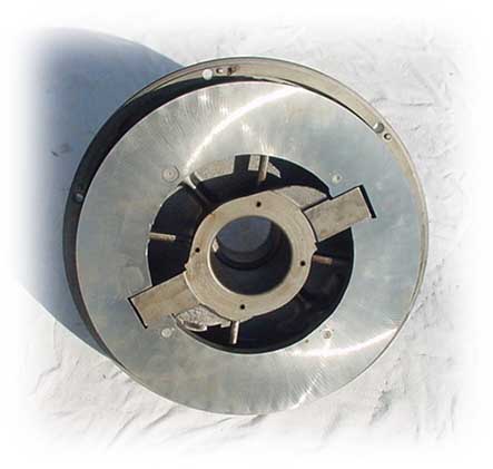

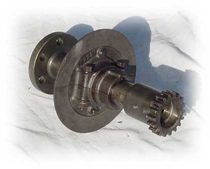

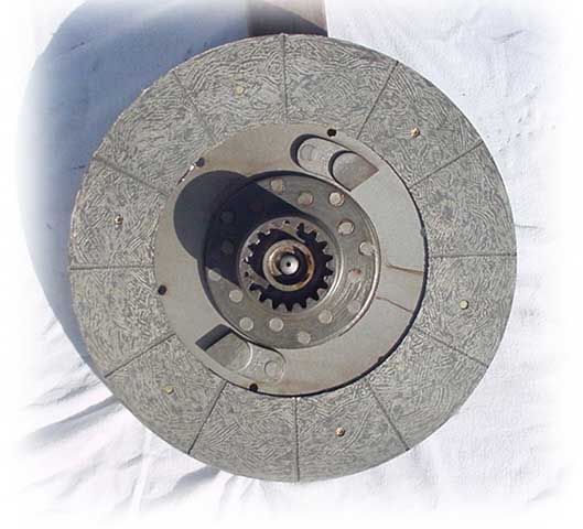

    Quick question for you...with the clutch so darned hard (impossible) to disengage, I have to ask, did you get the clutch-fork and related linkage ratios correct? I imagine you did...just a thought.
    If you have any doubt on this, I have the same power plant still in a Seagrave Hook & Ladder truck. The steel rollers that act on the release cone are larger than your br*** ones but the geometry could still be correct. Pictures & measurements are here for the asking.
    Are the hood & gas tank still around from your engine donor truck?
    Another question - what is the clutch driven disc made of? Mine is stuck & I need to know how to attack dismantling it.
    Thank you,
    Jack

    Thanks for the offer, I may be asking you some questions. I might have changed the geometry of the linkage somewhat but I think the real problem was I changed the seating position. Before you could push down and put all your weight on the pedal. Now you have to push with your back. Regardless without the ladder trailer to pull I think it'll be fine. As you see in my very first pictures of this thread there was very little left of the bodywork The firewall/cowl was about it. I do have the fenders though but they're pretty beat up. Judging by the wheels your truck is later than mine. There is a gas tank and seat and radiator shell on ebay but the guy wants quite a bit for them. He might come down it you take all three. The clutch disc was made of regular clutch material. Probably asbestos!! (Oh Horror) Here are pictures of some reman units. (not mine) The main problem with mine was that in this setup the throw out bearing turns all the time and the race in the bearing was quite rusty. I bought new balls from McMaster Carr and cleaned up the race as best I could but it really needed to be remachined. The bear will be noisy but I guess I can live with that. Have you gotten yours running yet?
    Jerry

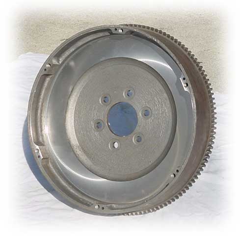

  11. Looks alot like a ginormous version of the early Chevrolet 4 flywheel/clutch- the recommendation I was given was to mill a good bit off (don't have the specifics with me) and use a modern clutch.
    That may also give you a few more blocks between refills :D

  13. Jack Innes
    Posts: 178
    Jack Innes
    Thank you Jimmy for the picture it is of great help.
    Jerry,
    Thank you for the clutch pictures - they really tell me what to do next.
    I studied the clutch release mechanism on my truck today & see what could have caused you some difficulty.
    If you look at the attached picture the following may make sense.
    From the c/l of the arc of the pedal to the c/l of the upper shaft it is 13"; from the c/l of the upper shaft to the c/l of the upper bell crank pin it measures 2.5"; from the c/l of the bottom bell crank pin to the c/l of the throw-out shaft it measures 4.5"; from the c/l of that shaft to the c/l of the rollers it measures 4" (approximately).
    The mechanical advantage given by the different lengths of the bell cranks is about 1.8 to 1 . The clutch travel would also be altered by the same ratio.
    Jack

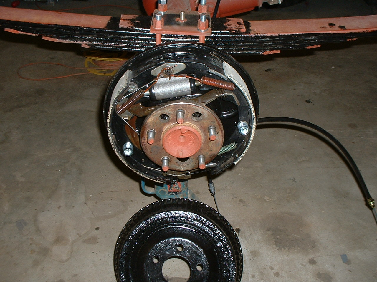

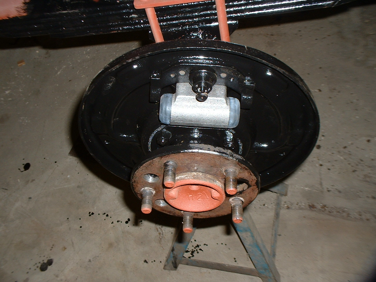

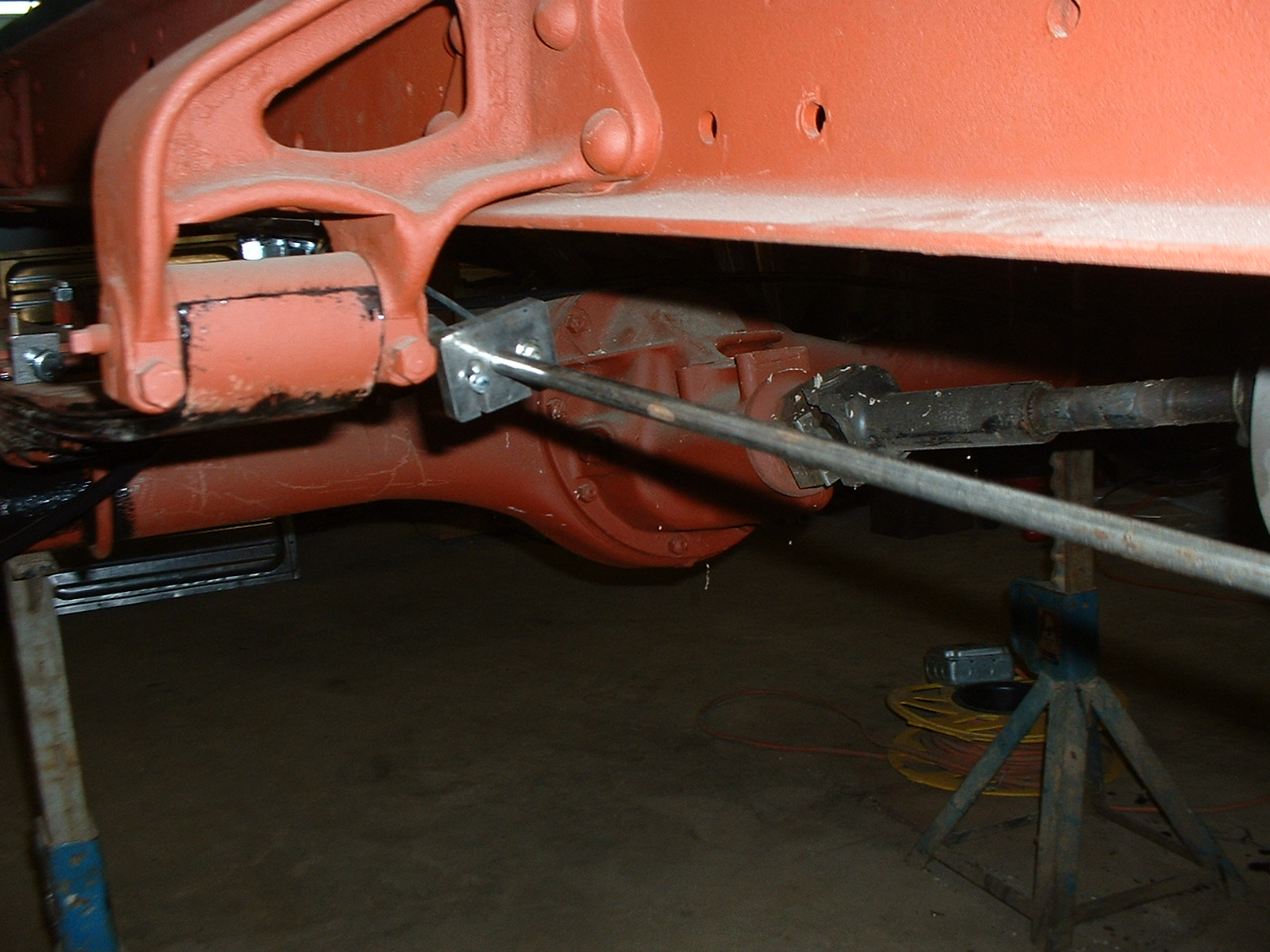

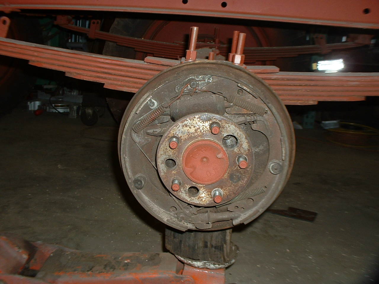

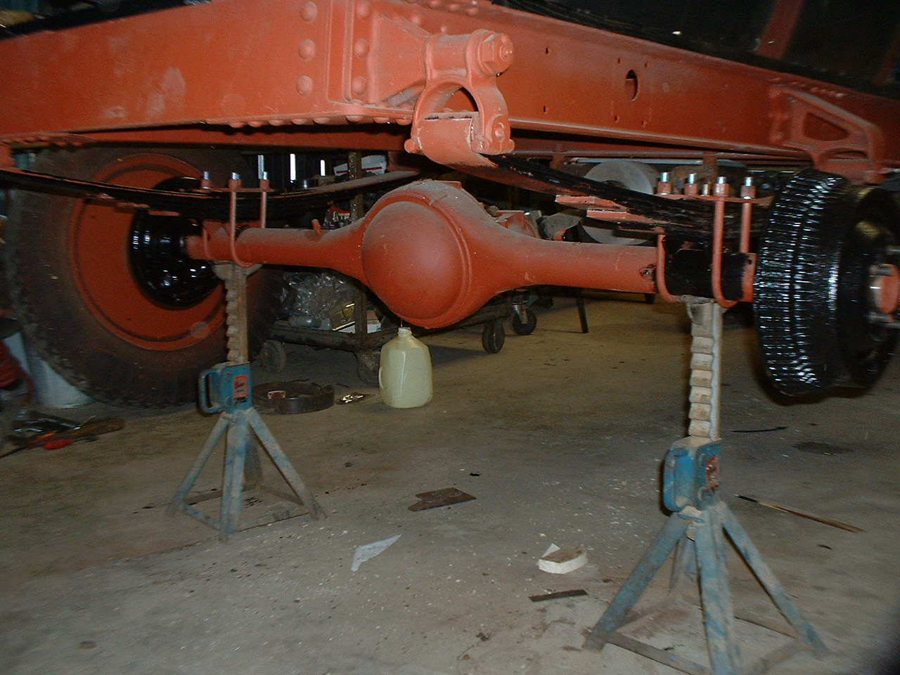

    Brakes
    I know, I know... What is he working on brakes for? Well, I was waiting for a few more door parts to arrive so in the meantime I started to rebuild the brakes. Yes, it's boring, but they've got to be done. I cleaned up the backing plates and the drums and installed some new wheel cylinders. Now, I am waiting again. This time for new E brake cables before I can install the new brake shoes. The last thing I did was take out one more leaf from each rear spring and paint some POR15 between the leaves. I love that stuff. If only it would stay shiny in the sun.
    Jerry

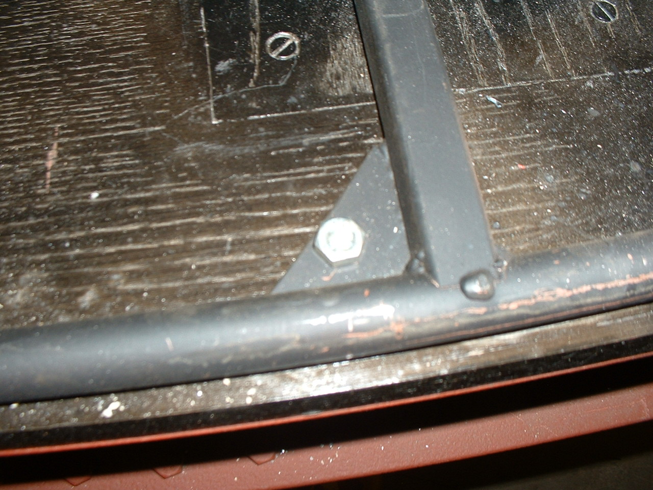

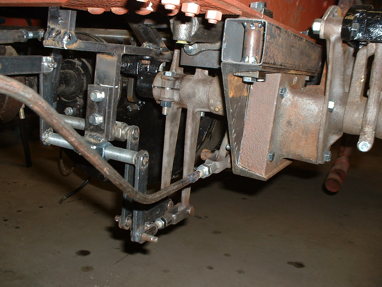

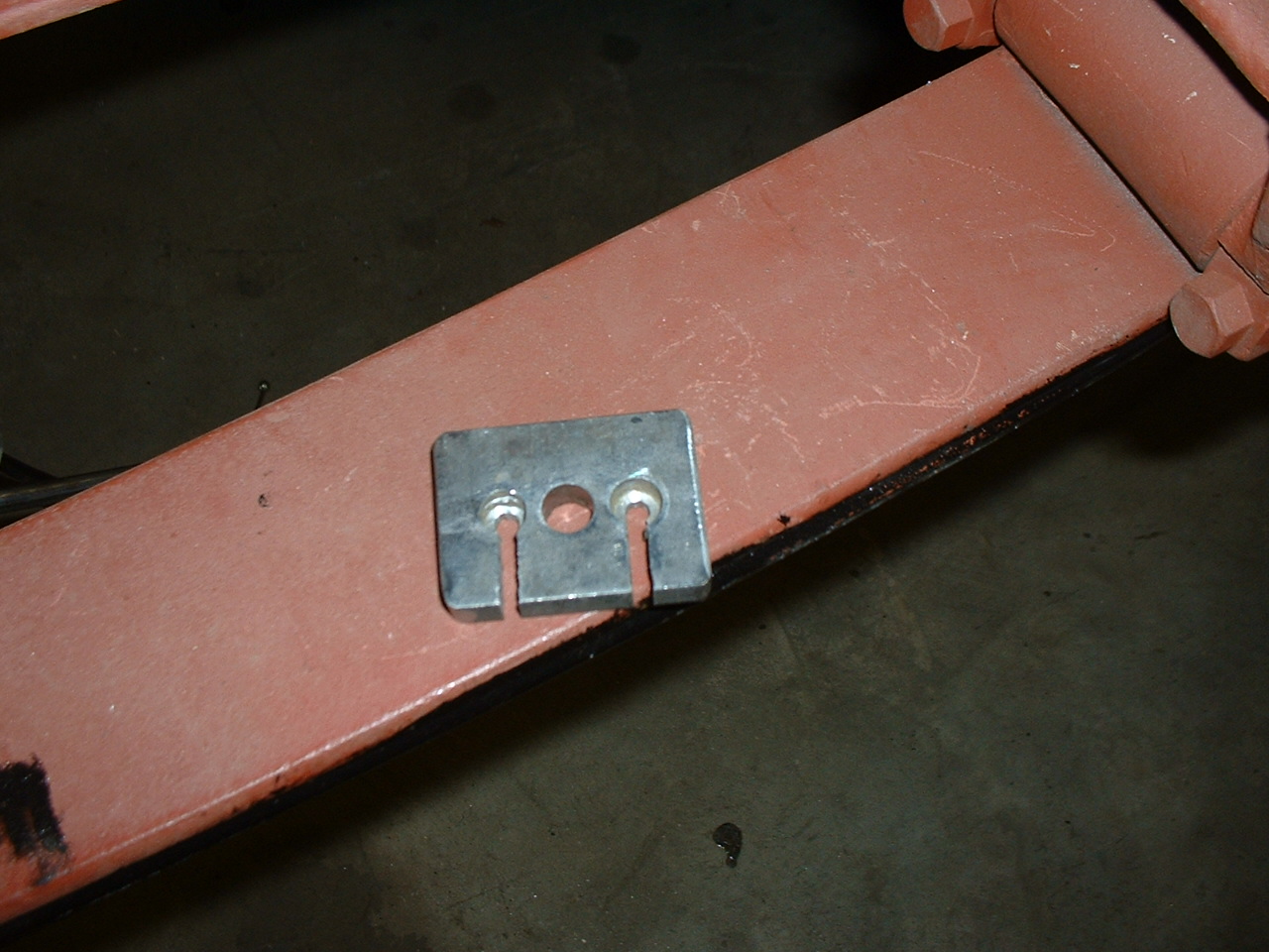

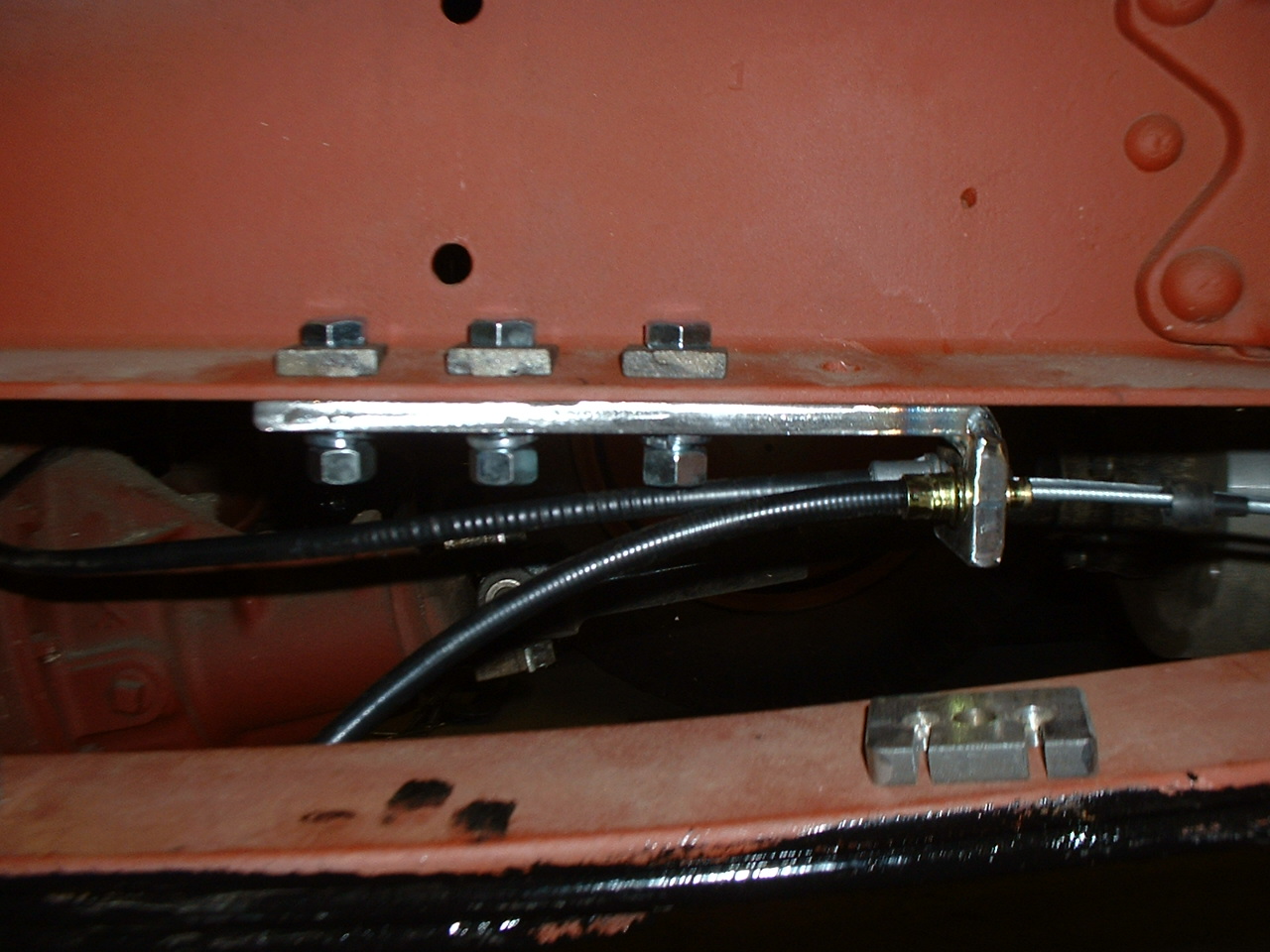

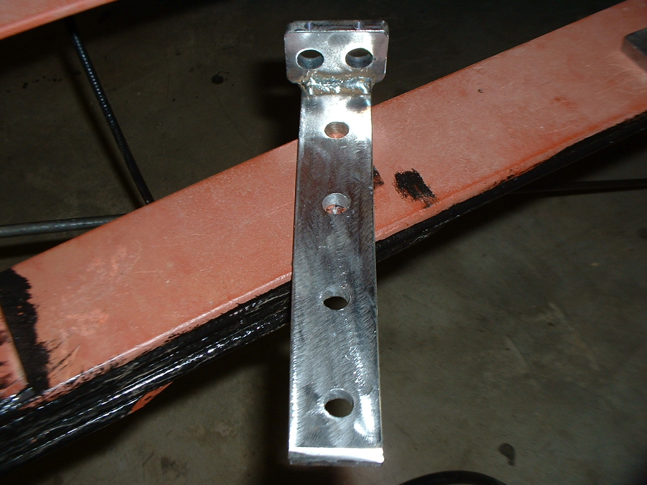

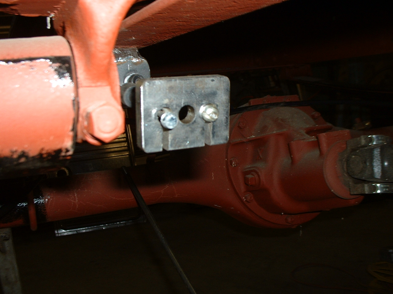

    E brake
    I worked on the e brake. It's over built but what the heck. There were four holes already in the frame so I used all of them to mount the cable bracket I fabricated. A 3/8 rod connects the handle to the cables. All pretty simple stuff.
    Jerry

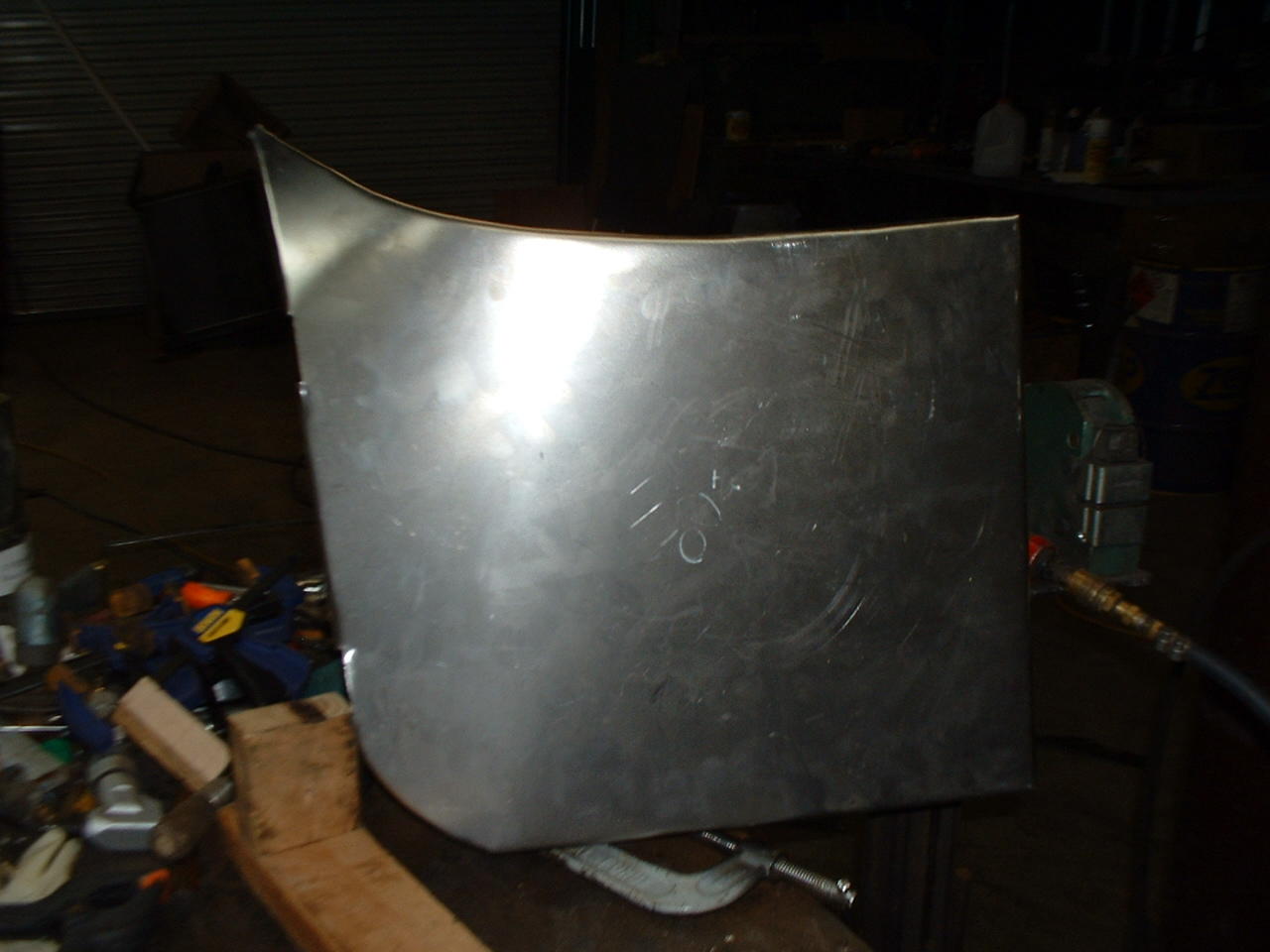

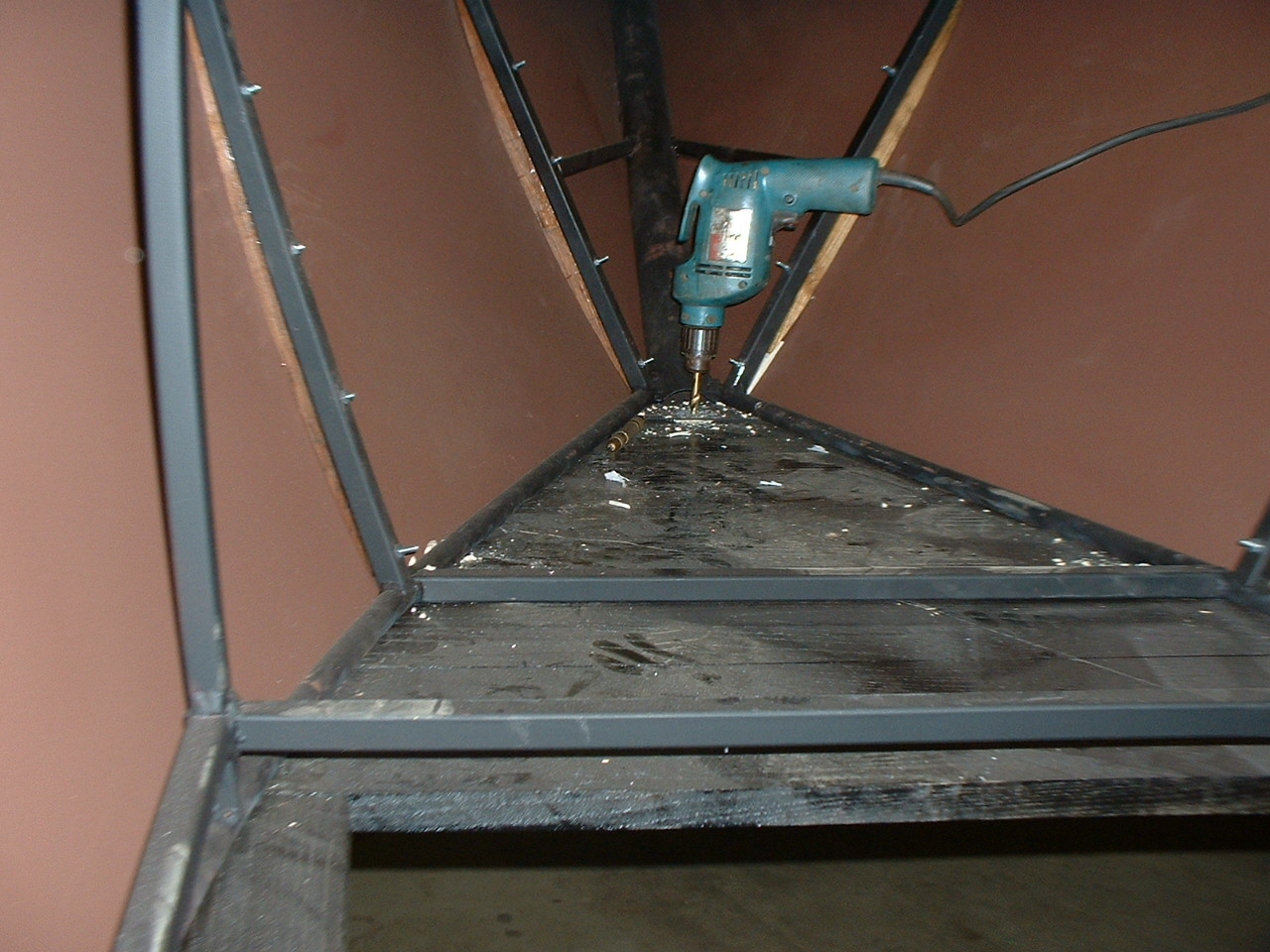

    Doors
    Remember when Jim Morrison got arrested in Miami for indecent exposure? I was at that Doors concert. It was in 1969, my senior year in high school. Just thought I'd throw that out there since I was working on doors today. Well, I never did like the hardware store hinges I had. They were just too weak. The other day I found some real car door hinges that will work perfectly. Unfortunately using them involves modifying the door post. But, better to do it now than later. I worked all day yesterday fitting the p***enger door and today I worked on the driver's door. I also had to weld in some bracing and attachments for the door panel. I'm still waiting for the driver's door lock to show up and both striker plates. I hope you can make out the pictures. Ol' Jimbo skipped bail back then and was just pardoned posthumously a week or so ago. If you're interested I'll tell you what I saw when I visited his grave in Paris.

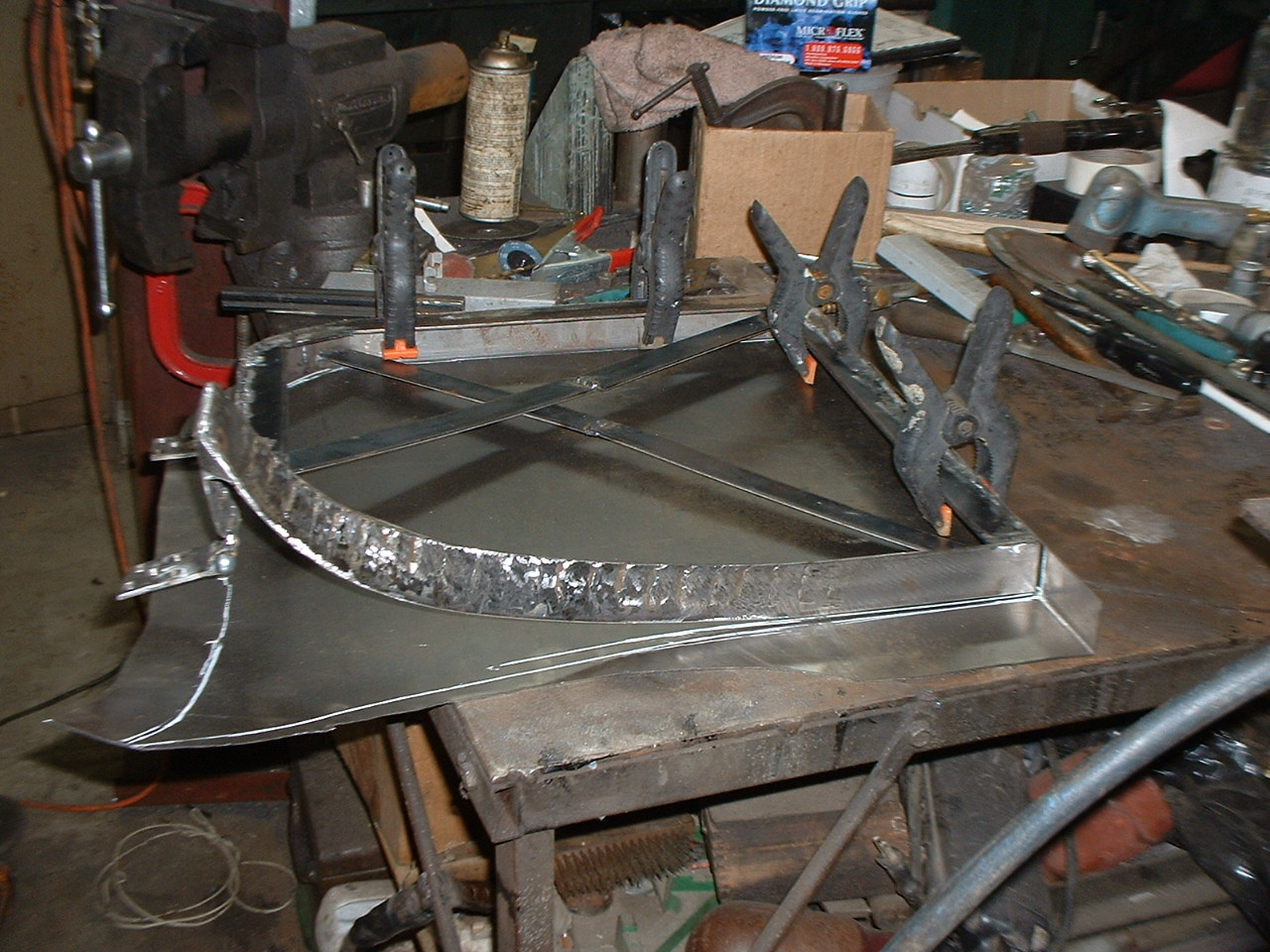

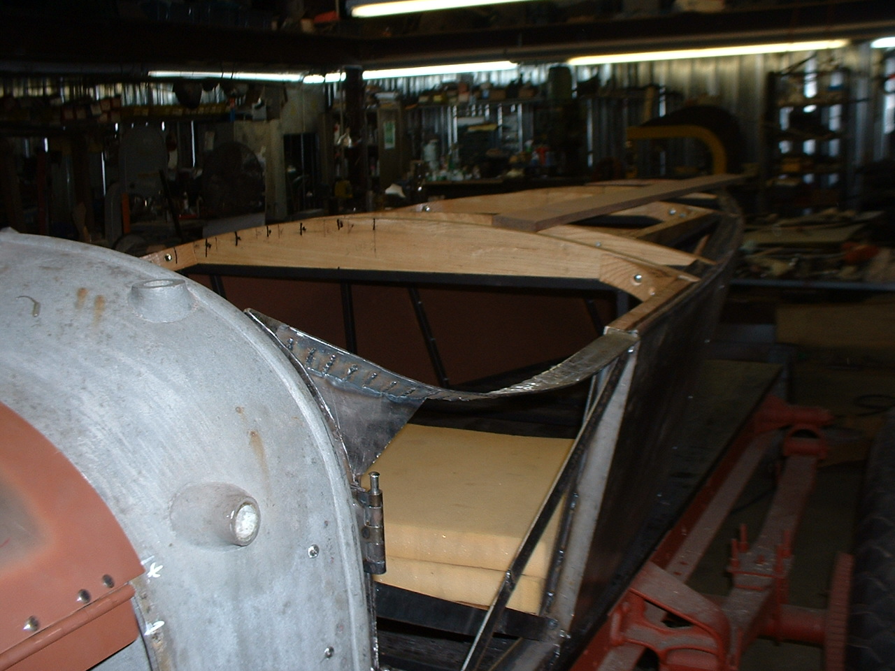

    Doors
    I finished up welding on the p***enger's door and started to fit the door skin. The hardest part was cutting out notches for the hinges to fit through. That required working with a tiny air grinder and then a hand file. Maybe there's an easier way but I don't know about it. Finished with that, I meticulously trimmed off the extra metal then tapped over the perimeter. I can't weld the skin on yet because I've got to fit the door lock. And I can't fit the door lock until the striker plates show up.

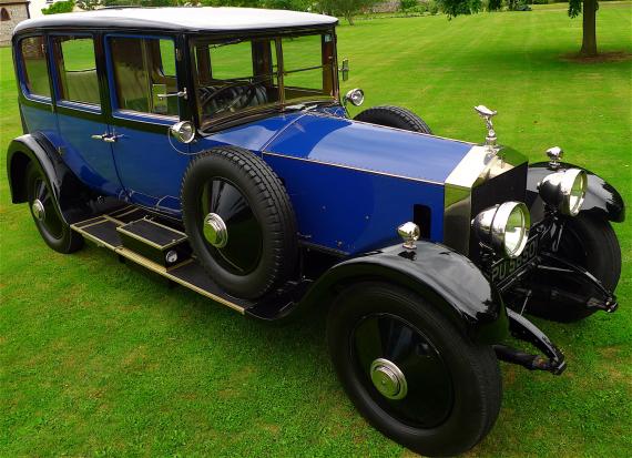

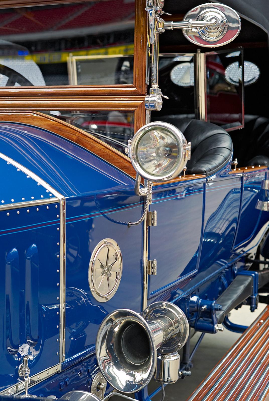

    yonahrr
    Paint
    I found this paint scheme--1913 Rolls Royce. It's dazzling. What color is that blue? Royal blue? How can I find out a paint code?
    Jerry
  28. Jack Innes
    Posts: 178
    Jack Innes
    Go to vintagerollsroycecars.com & look for this 1924 limo. the color is close & the car is for sale by a dealer. He might be persuaded to have his paint people scan tha color & send you a formula. They are referring to this color as a bright blue. It would be a start.
    Royal blue is usually darker - close to navy blue. I am sure Royal Blue is like Checker Yellow; there are 368 different shades of yellow that were used by Checker over the years!
