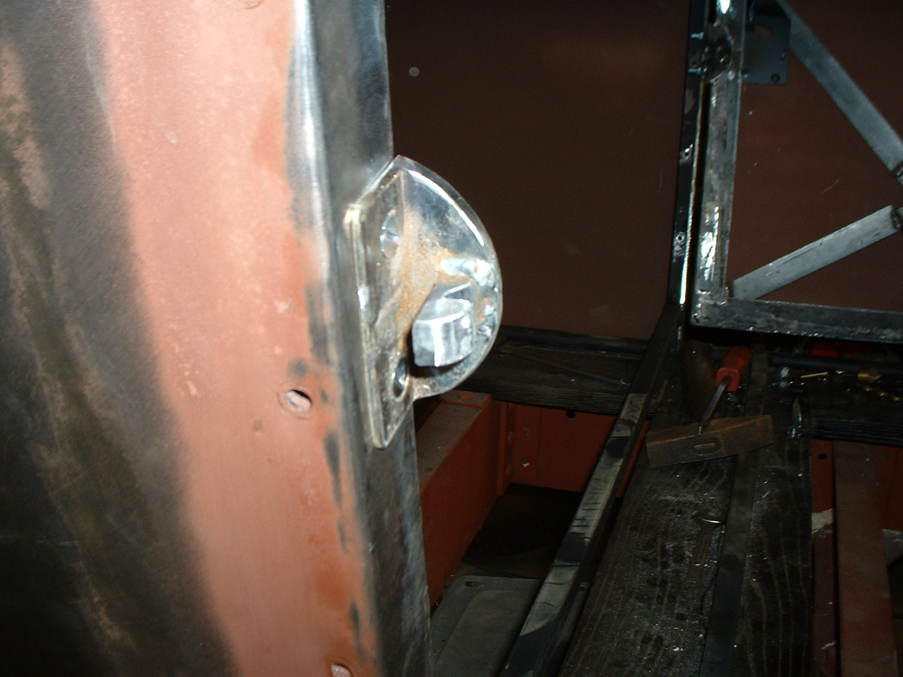

    yonahrr

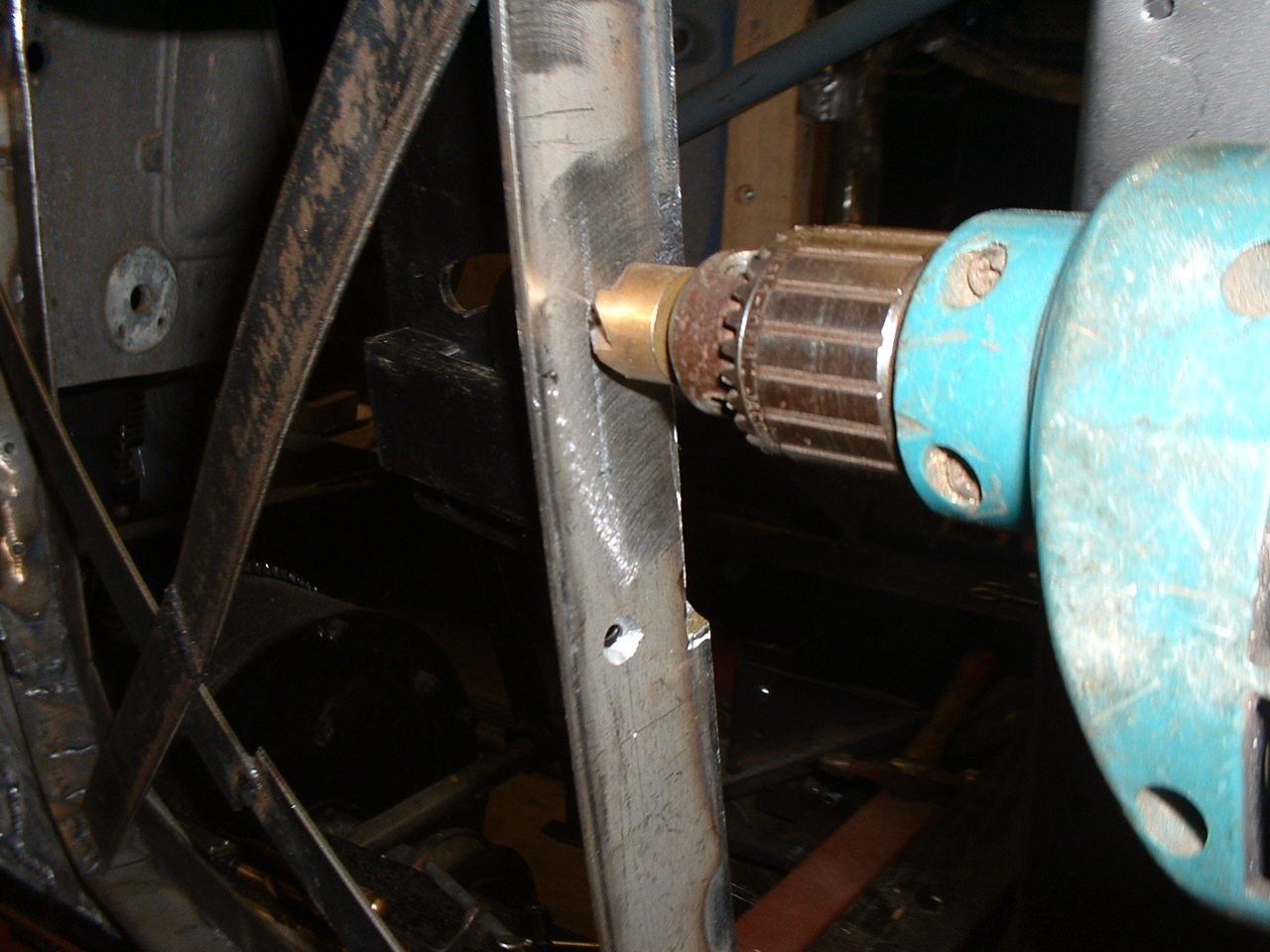

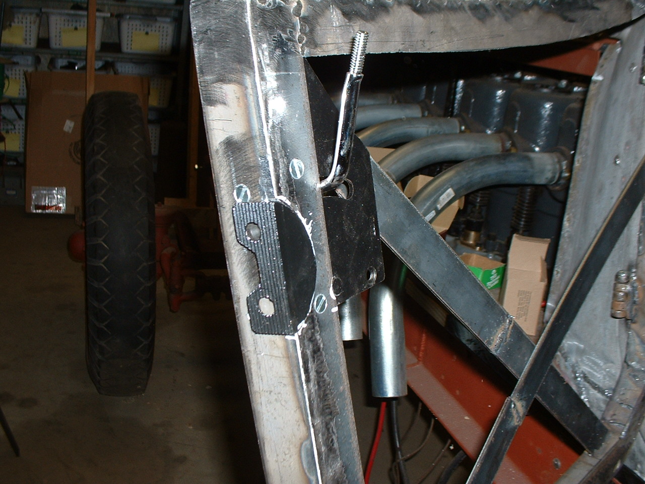

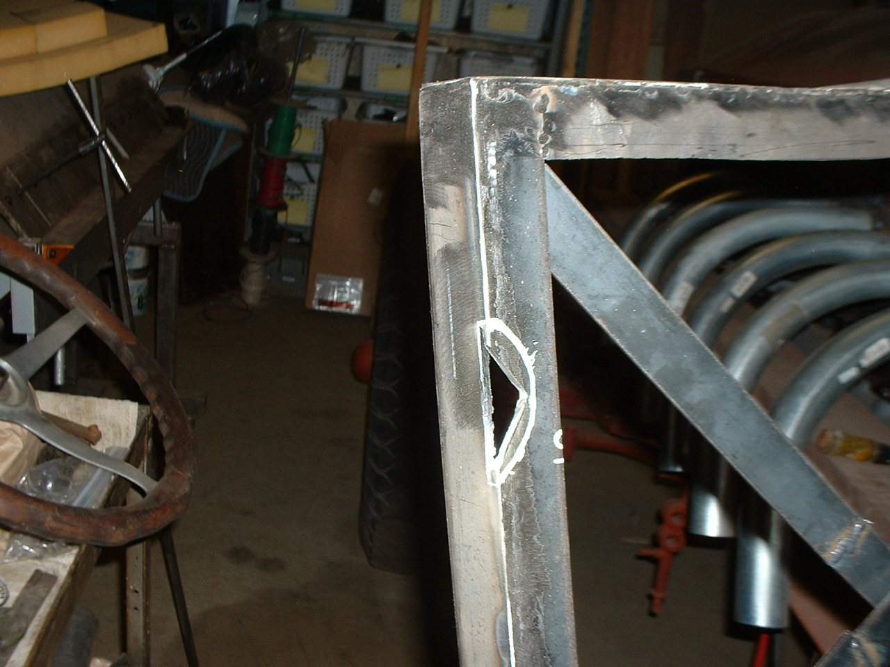

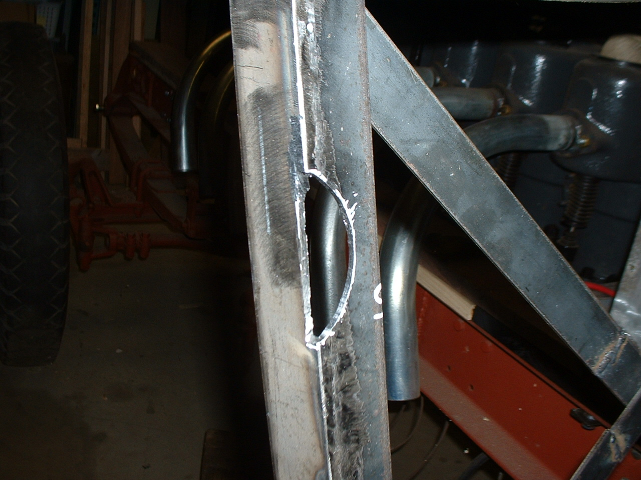

    Door Locks
    Today I set about installing the door locks. To do that I had to cut out some of the door frame. If I was really smart I could have cut out the frame to fit the lock before I welded the door together. Well, here's a little secret. I have no idea what I'm going to do before I do it. I just make up stuff as I go. So I cut out as much metal as I could with a cutting wheel then I trimmed it up with a die grinder. The guy who invented carbide die grinder bits should be given a medal. After a little adjustment the Model A door locks fit pretty well. But I can't really mount the striker plate until I weld on the door skin. Then I can adjust the striker plate to make the door fit better.
    Happy New Year.
    Jerry
    <input id="gwProxy" type="hidden"><!--Session data--><input onclick="jsCall();" id="jsProxy" type="hidden"><input id="gwProxy" type="hidden"><!--Session data--><input onclick="jsCall();" id="jsProxy" type="hidden"><input id="gwProxy" type="hidden"><!--Session data--><input onclick="jsCall();" id="jsProxy" type="hidden">

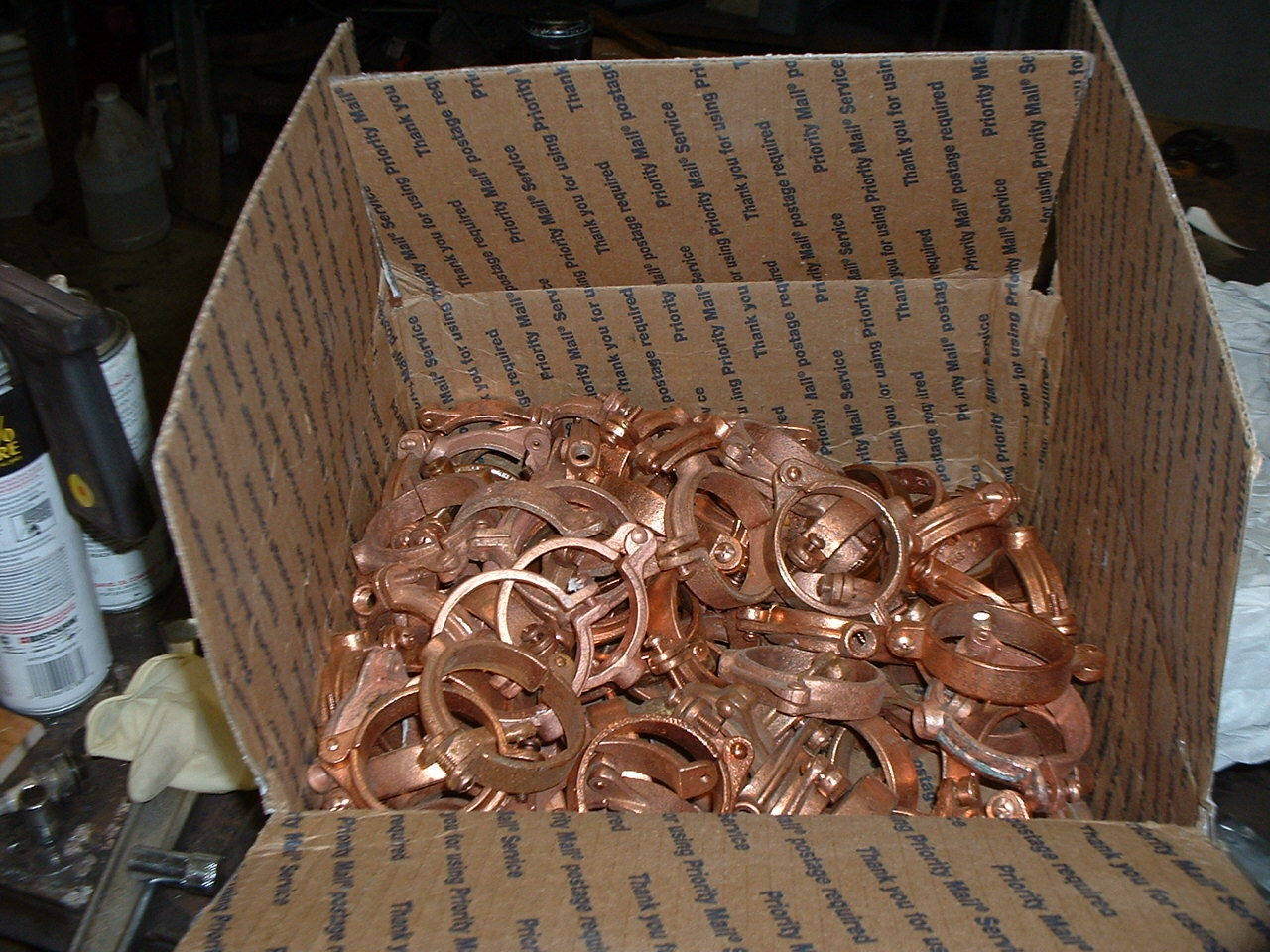

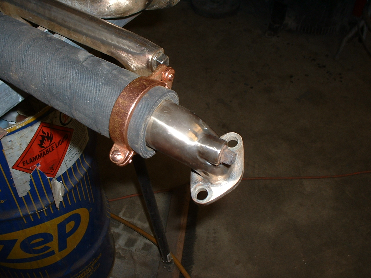

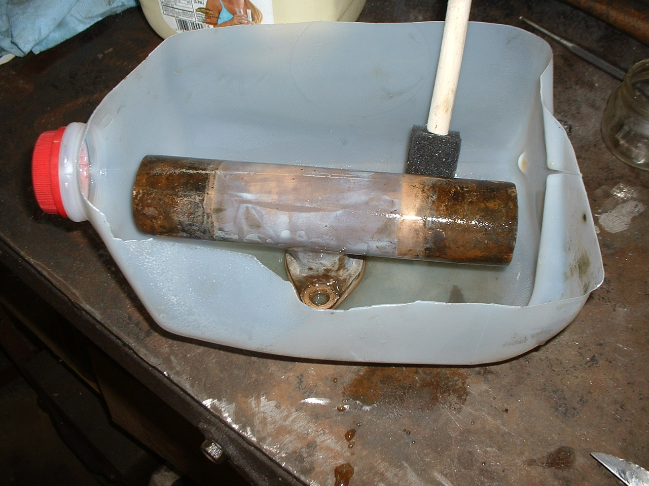

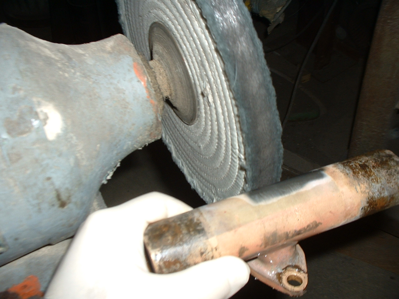

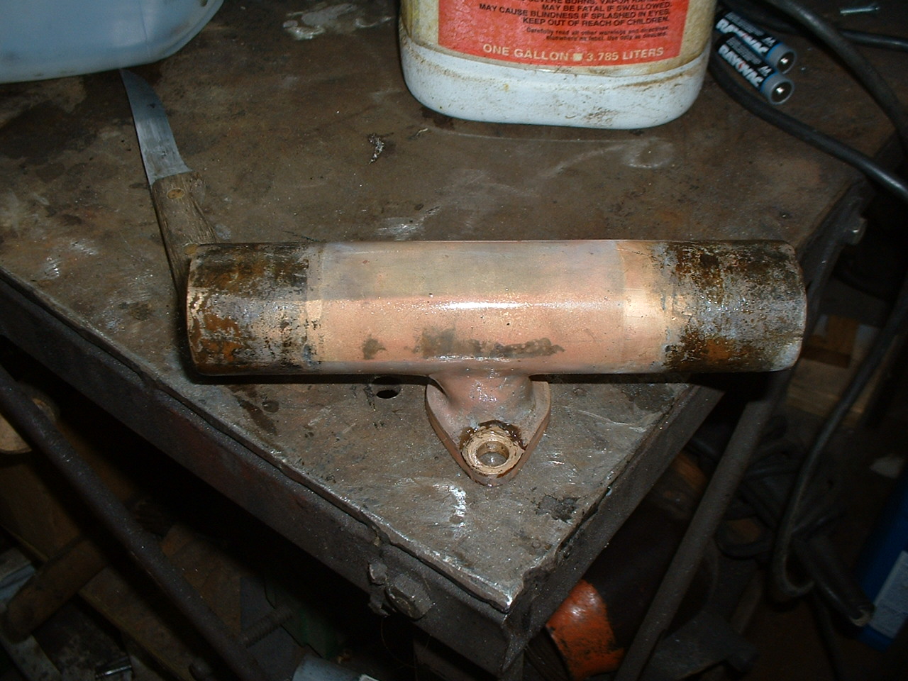

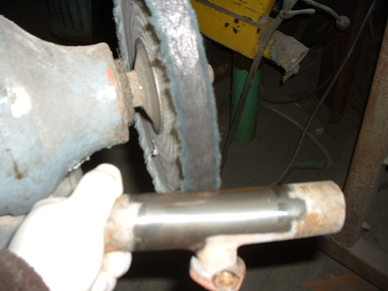

    Br***
    I had to change the air filter and oil in my wife's Dodge Caravan today. I was going to change the fuel filter too but they told me at the parts store it was only available combined with fuel pump and fuel sender. Weird! So I guess you're supposed to wait until the car stops running then drop the tank. Nice. After that I messed around with the br***. I tried to sneak some ketchup out of the house but my wife caught me and made me put it back. She's making meatloaf. So I made up a mild solution using some Sunnyside muriatic acid. Luckily I still remembered that old saying Mr. Mizell taught me in high school chemistry: Do as you oughta, add acid to watta. They say if you do otherwise it might explode. Never tried it. The solution took the corrosion right off except where there was some kind of burned on paint or something. Then I buffed a little bit. The acid trick saved me about half the time. I think I'll use it on all the heavily corroded br***. I even tried a little to see if it would take off some old nickel plating. The answer: not immediately. I've delve deeper into that subject next time.
    Jerry

    I just read this whole thread.
    Really interesting. I will have to try the shellac thing as well.
    A trick for remembering acid to water and not the other way, is the alphabet, A to W, at least it works for me.
    Whats the ketchup trick?

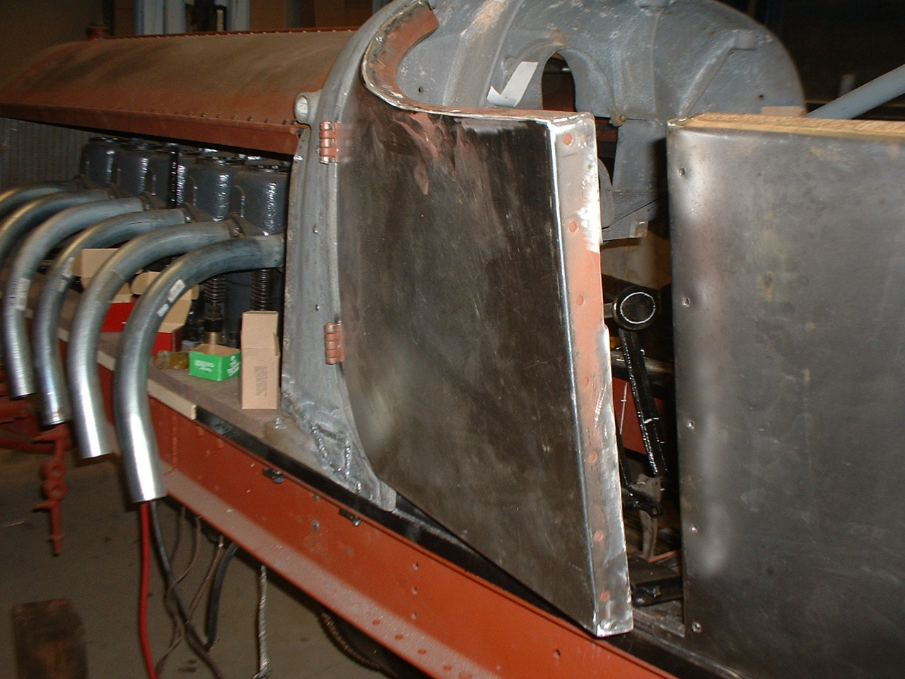

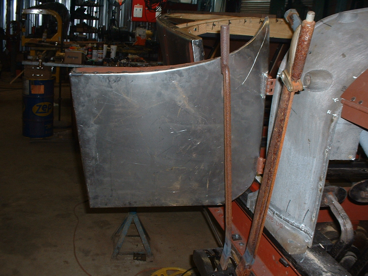

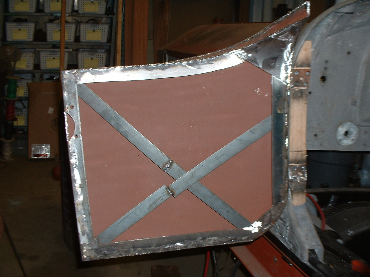

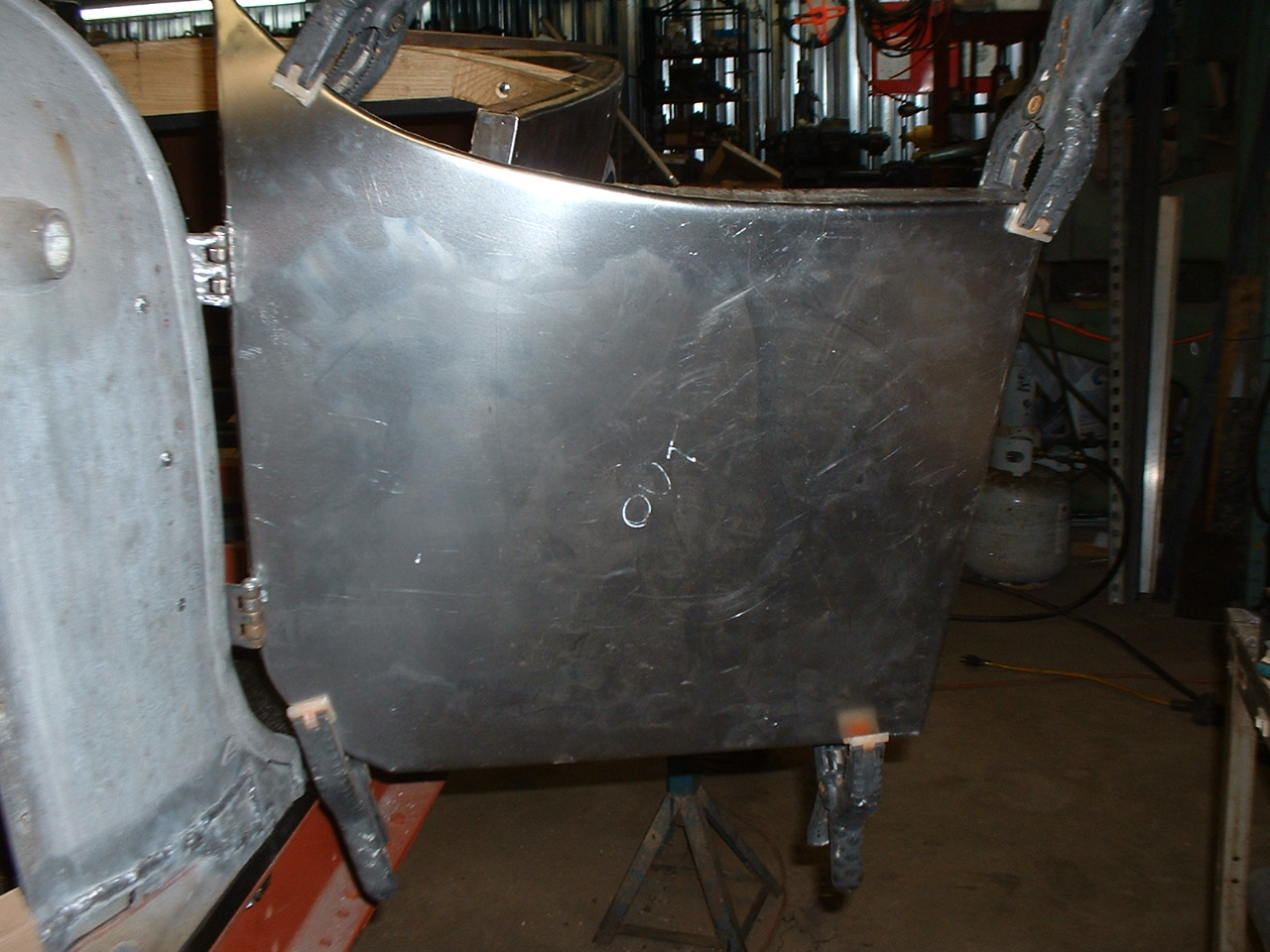

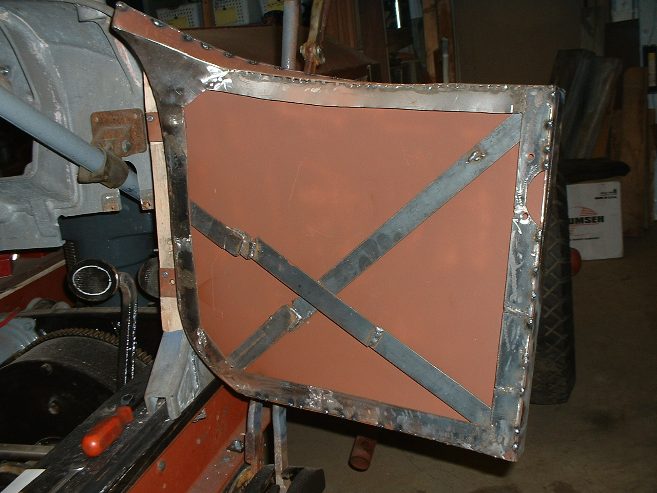

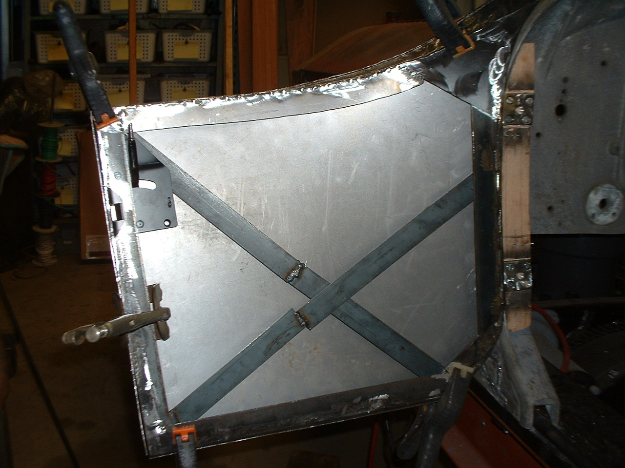

    More Doors
    Well, I finally got one door skin welded on. I managed to paint the inside of the skin and the door then the next day I welded it on. After that I did a lot of grinding. Inventive note: I want to invent a spot light that mounts on the end of my MIG gun that comes on when I hit the trigger. My eyes aren't as good as they once were. One more door to go then I start mounting cooling pipes.
    Jerry

    Nice job, Jerry! How many hours do you have into that door? :D
  20. The door looks great!
    Was thinking about the ch***is- have you considered skinning the outside of the frame rails? It take some of the "industrial" look out of the ch***is. Can't wait to see this one out in the daylight- it is a fantastic build that really needs to be seen to appreciate all you've put into it!!!

    you add acid to water so if anything splashes out, it would be mostly water and very diluted. If you started pouring water into acid and it splashed out, you'd be nailing yourself with almost pure acid! Shouldn't blow up on ya :)

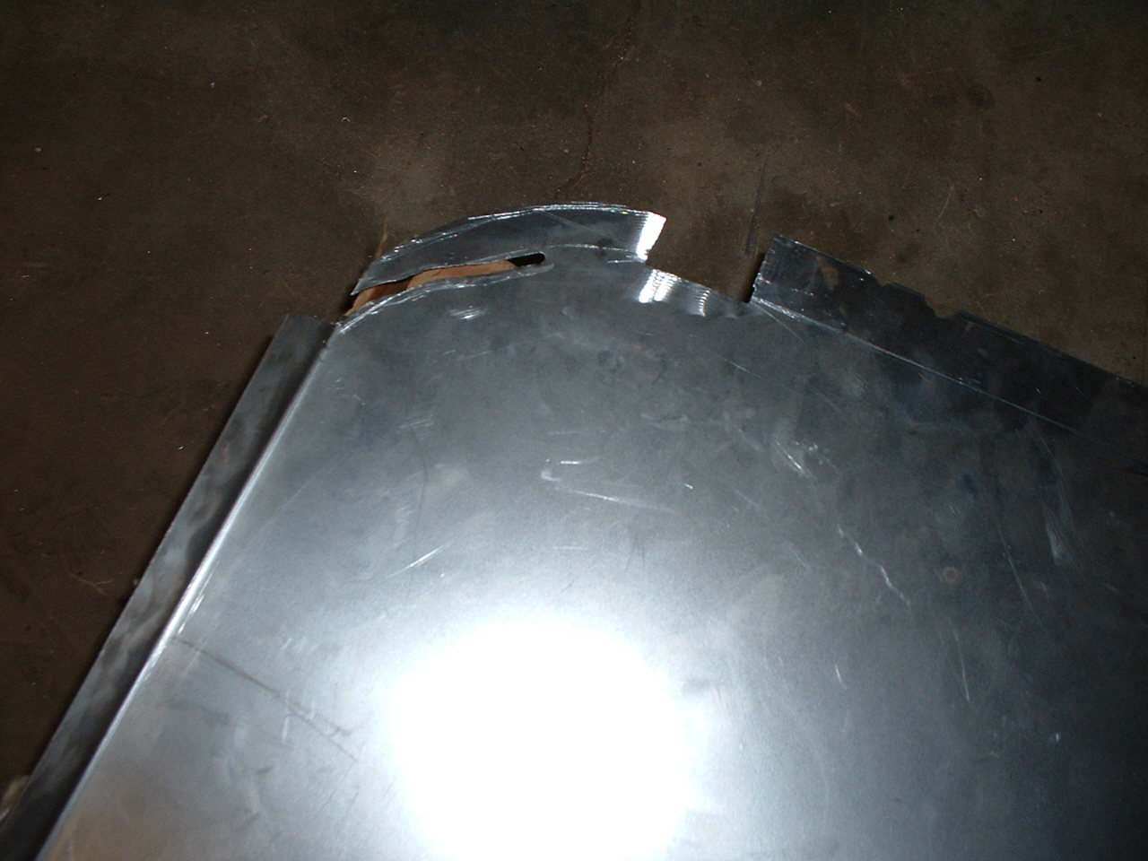

    I plan to put some metal under the body then 90 degrees down over the rails. The problem is back in the old days they'd put a nice one or two inch radius on the bend. Today they just put it in a brake and bend it with with virtually no radius. You can kinda see what I mean in the picture of the Mercer. I may have to settle for an abrupt 90.

    I thought I'd have maybe a week in two doors but I think it's more like a month per door. At least now I can move on. Let's get this monstrosity movin under it's own power!

  25. Jerry,
    You can always roll the bend over a nice length of 2" pipe from Lowes/Home Depot!

    Actually...that's not entirely true, some combinations can blow up on ya. The acid to water thing is to slow the reaction. Acid and water will react. If you pour water into the acid, the tiny amount of water that goes in first will react with a bunch of acid all at once, and *can* cause a very violent reaction depending on what you're working with. The other way around you have a little bit of acid reacting with a bunch of water...which will be a more gradual reaction.
    Whatever way works for you to remember is fine...acid to water is the right way to do it.

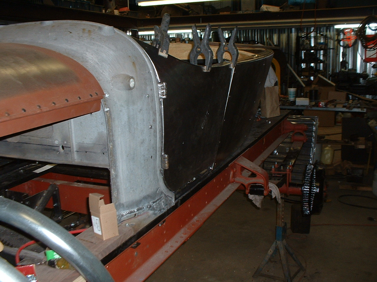

    Last door
    I've thought about trying to make a bender using pipe, but the frame covers are 20 gauge and 10' x 2'. I don't think I have the strength to bend a piece that long let alone keep the whole thing clamped down. I'm sure I could make a bender if I devoted a week to it but right now I'm not willing to spend the time or money. I'll think about it. Maybe I'll bend up a small section in a sharp 90 and see how it looks. Anyway, I spent the day making a driver's door skin and screwing it up. The nibbler got away from me and ruined the piece. Disgusted, I s****ped the door skin and made another. It turned out to be a good thing since I found an easier way to do it and the second one came out way better. I got it tacked on and hopefully I'll do the final welding tomorrow.
    Jerry

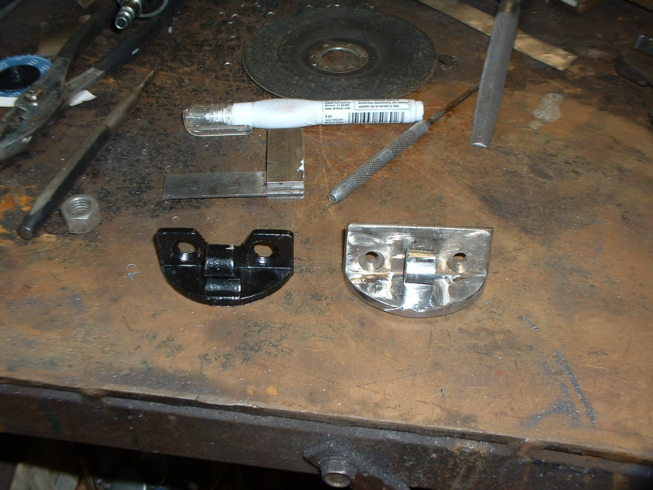

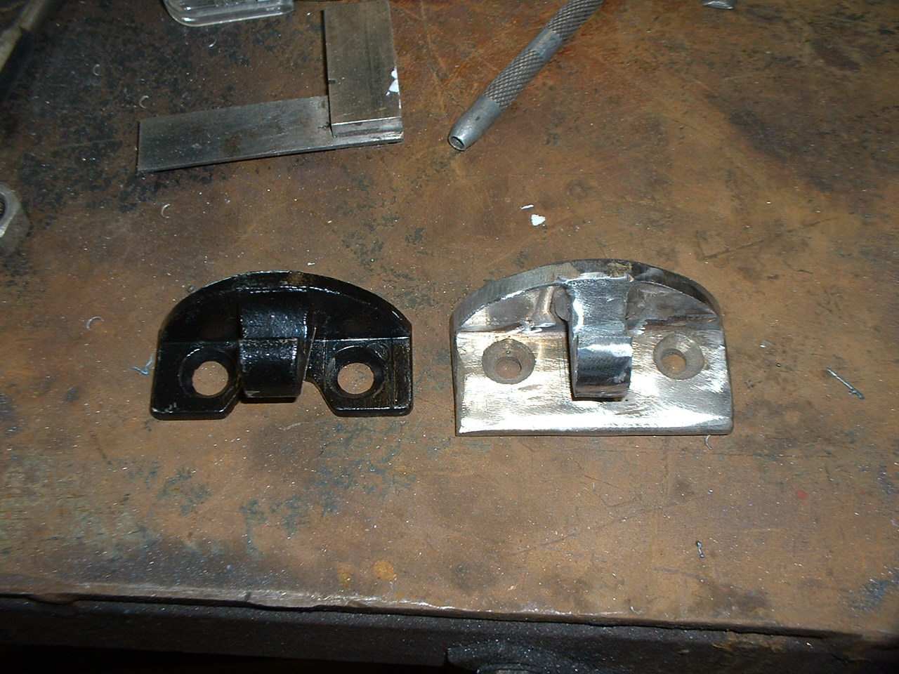

    Misc.
    Yesterday I finished up some new striker plates. The Model A strikers were dandy but they just didn't fit right. I used some 1/4 inch angle and some 1/2 square stock. I forgot my camera the day I cut them out so I can only show you the finished products. Now the doors clang shut like cell bars slamming on Bernie Madoff. I'll add sound deadening later. Next, some clamps I found on ebay arrived. They were cheap and fit my hose perfectly. I couldn't bear to put modern clamps on and I couldn't afford br*** Sherman clamps either. No work going on today. In case you didn't hear we got a real dusting of snow. That's probably nothing for most of you guys but down in Dixie snow is big stuff.
    Jerry
