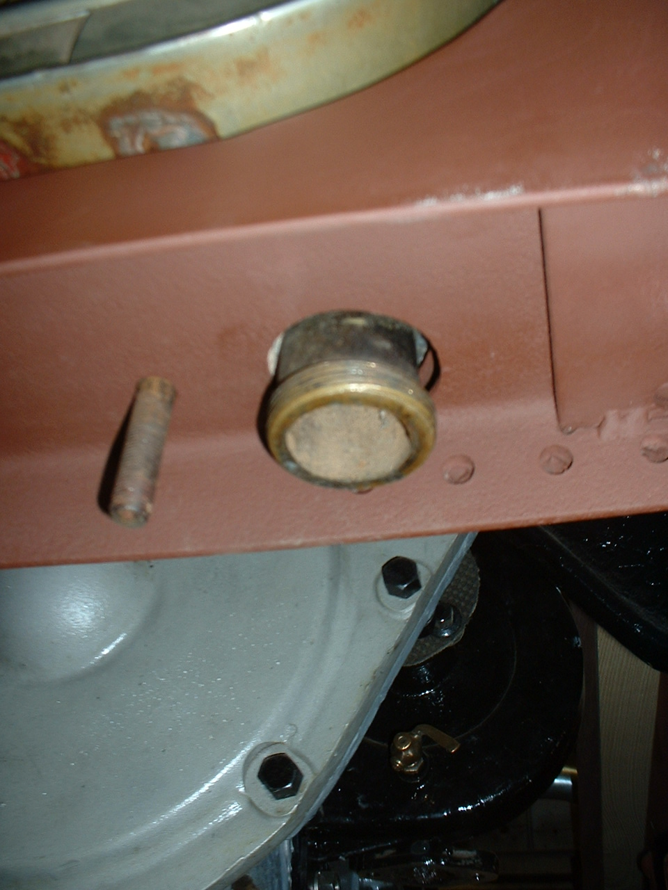

    Cooling
    I'm ready to get the cooling system hooked up so I can fire this baby up and go for a ride. As you recall, in a previous episode I acquired an American Lafrance radiator. Well, the lower outlet is threaded and I've got to come up with a fitting that fits. The outlet measures 2 inches across the threads and the threads are 11.5 threads per inch. The 11.5 threads per inch isn't unusual. Most bigger pipe threads are 11.5 TPI. But the 2.0 across the threads is unusual. Of course pipe threads are tapered too and these are straight. If you look at the second picture you can see what I need--a big nut and an inner pipe. The one pictured is too small. Also, my pipe needs to be curved not straight and it needs to be 1 5/8" in diameter. So that's my problem. I've looked all over the internet and can't find anything. I could attempt to make it myself but the oil in my lathe is so cold the machine won't hardly move. I've got a machine shop buddy who can make this piece for me but I'd rather not bother him if I can do it myself. Who knows, I might really need him for something I can't do. Suggestions?

  17. Giovanni
    Joined: Jan 21, 2010
    Posts: 173
    Giovanni
    I don't know how visible the outlet is, but could you cut off the threads and make your own fitting or tube that would accept standard pipe or hose, and then braze it to the neck?

    I always hate to cut anything on an old part. Who knows, years from now someone may dismantle my creation and need that part. Besides, if I heated up the outlet hot enough to braze it, solder would run out of the radiator like a moonshine out of Grandpappy's still. Those big old radiators are a miracle of solder and br***. And there's only three people left in the world who know how to fix them. I'm going to check some hydraulic fittings today and if there's nothing that will work it's off to Phoenix Machine Shop. Jon owes me a favor, anyway. Let me also say that just because I don't act on all the suggestions and tips I get doesn't mean I don't value them. I do. Keep um coming. Thanks

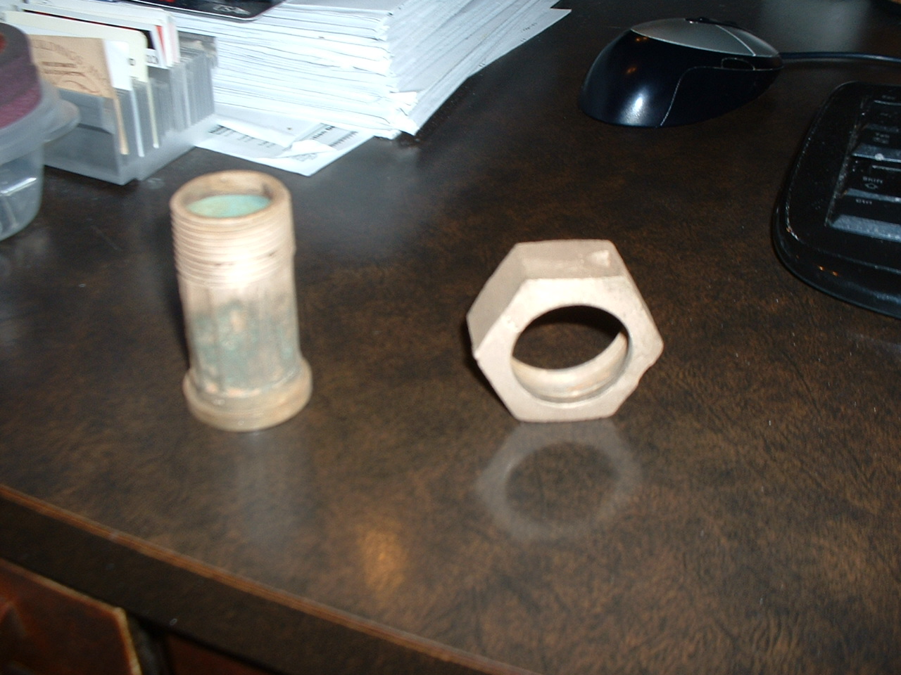

  19. captainjunk#2
    Joined: Mar 13, 2008
    Posts: 4,420
    captainjunk#2
    i wonder if there is a size of br*** water pipe union that would match ? if you found the correct one just use half of it the part that sticks down from the radiator would match the face of half a union then you would have the union to screw a pipe ****** into and plumb where ever you wanted it to go
  20. 64 DODGE 440
    Joined: Sep 2, 2006
    Posts: 4,434
    64 DODGE 440
    from so cal
    Perhaps a fire hose fitting...seems like it would be appropriate and most likely br*** to boot.

  22. Jack Innes
    Joined: Nov 26, 2010
    Posts: 178
    Jack Innes
    Jerry,
    While we are suggesting things, you might try the food industry suppliers or milking machine suppliers. They both use a lot of union type connections for ease of cleaning. The pieces there would likely be stainless steel.

  23. yonahrr
    Joined: Feb 27, 2010
    Posts: 1,348
    yonahrr
    Good suggestions all. After deep thought I have formulated a plan. Since there is only .10 of an inch between the Lafrance radiator outlet and a standard 1.5 pipe thread, and since there is plenty of meat on the outlet, and since both are 11.5 TPI, I'm thinking if I get a 1.5 inch pipe die I can cut the outlet down .10 and a standard br*** pipe fitting will work. This way I'll only be altering the radiator .10 and I will find a ready supply of fittings. The down side: I apply just a little too much force when cutting the outlet and I rip it off the radiator!
    Now to scrounge up a pipe die. Harbor Freight has a set for $60. Can't work tomorrow. MLK have to watch kids.

  24. plym49
    Joined: Aug 9, 2008
    Posts: 2,802
    plym49
    from Earth
    Now i have not seen that rad, so I can't swear as to how hefty it is. Nevertheless I'd be a'scared of twisting the fitting off. You have to exert a lot of force to thread something that big, and it is probably hard br***. Can yo first try to open up the threads on a nut? The nuts are expendable. Hah, that did not come out right; you know what I mean.
  25. Check out NPSH threads
  26. 1oldracer
    Joined: Dec 3, 2010
    Posts: 195
    1oldracer
    You say the threads are straight not tapered. I had a friends that ran across straight threads on sometime he was working on and he was told there is a National Machine Thread, NMT, which is straight threads as well as a National Pipe Thread, NPT. He found a machine shop that had dies for that Thread and made him the piece he needed. He was told that if you use a NPT fitting on a NMT piece you can crack the NMT part. ????? rj

  28. yonahrr
    Posts: 1,348
    yonahrr
    I did some research on the web regarding NPSH thread and I couldn't match any up thread sizes to the radiator outlet. As far as other threads I couldn't match anything up with them either. I'm not sure why Lafrance would use an oddball thread size except that back in history they had their reasons. And I know that br*** is sometimes harder to thread than steel. It likes to grab and won't let go. Maybe I'll stop at the machine shop tomorrow morning and see what they can do. If anyone feels like researching the size, it's 11.5" TPI and 2" across the threads, straight with no taper. I also thought about taking a 1.5" pipe connector (female) and cutting the threads deeper therefore opening up the inside by .10"
