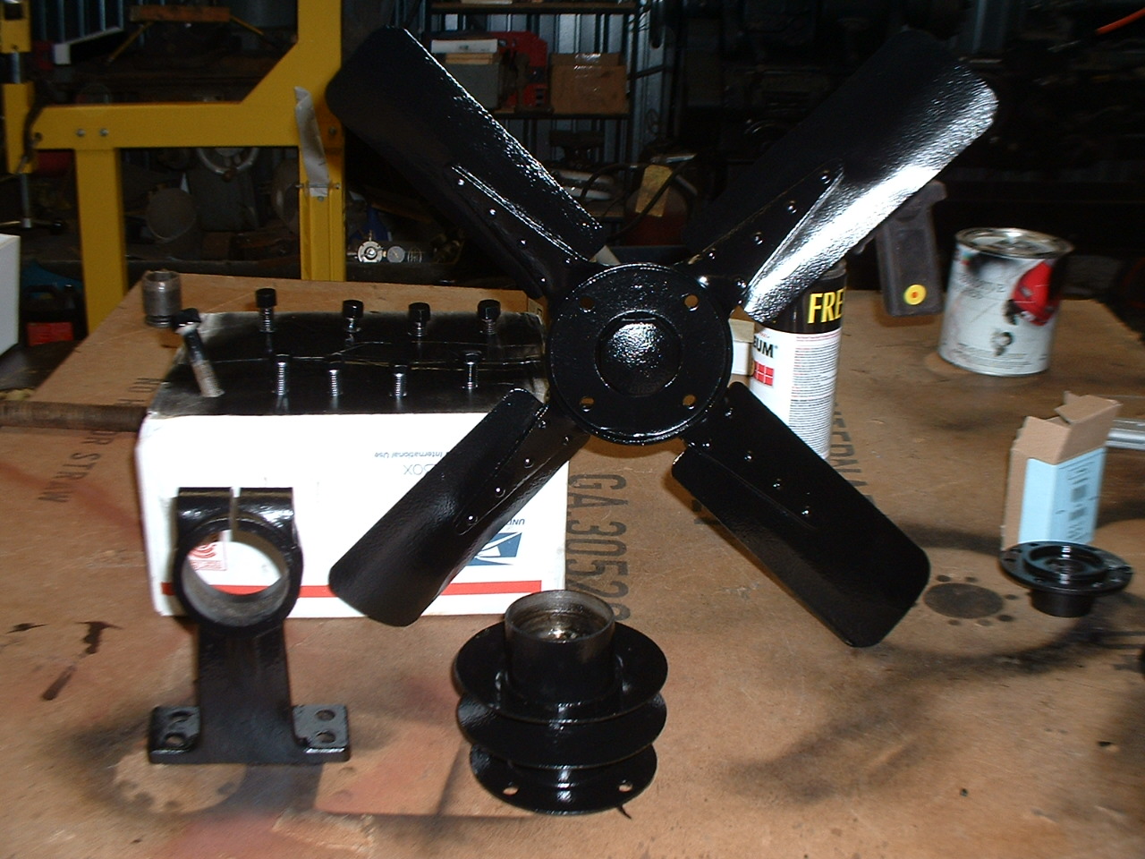

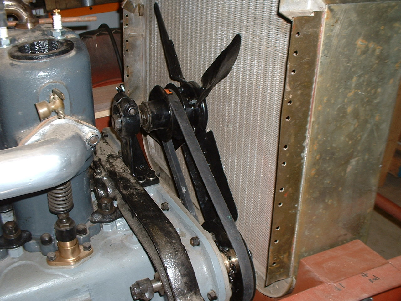

    The radiator smelled like "Old Sheep Dip." :) Try some next time you've got that special thirst. Today I bead blasted and painted the fan pulleys and polished br*** manifold pipes and made more gaskets. I also ordered the fan belt I hope will fit--cl***ic C38. 7/8" wide. 41" long. There was nothing good enough to photograph so I posted a picture that Babyland made using my REO and my kid's REO. Babyland is where the Cabbage Patch Kids come from and Cleveland GA's claim to fame. If you're ever p***ing through, you can drop your wife and daughter off at the Cabbage Patch then head over to my shop and p*** the time while they spend your money. Tomorrow I browse the parts stores for a lower hose.
    Jerry

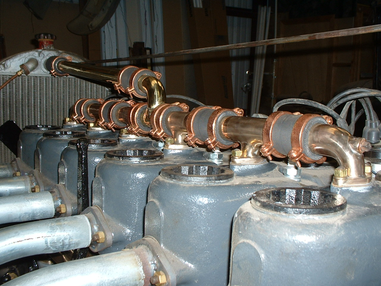

    Cooling

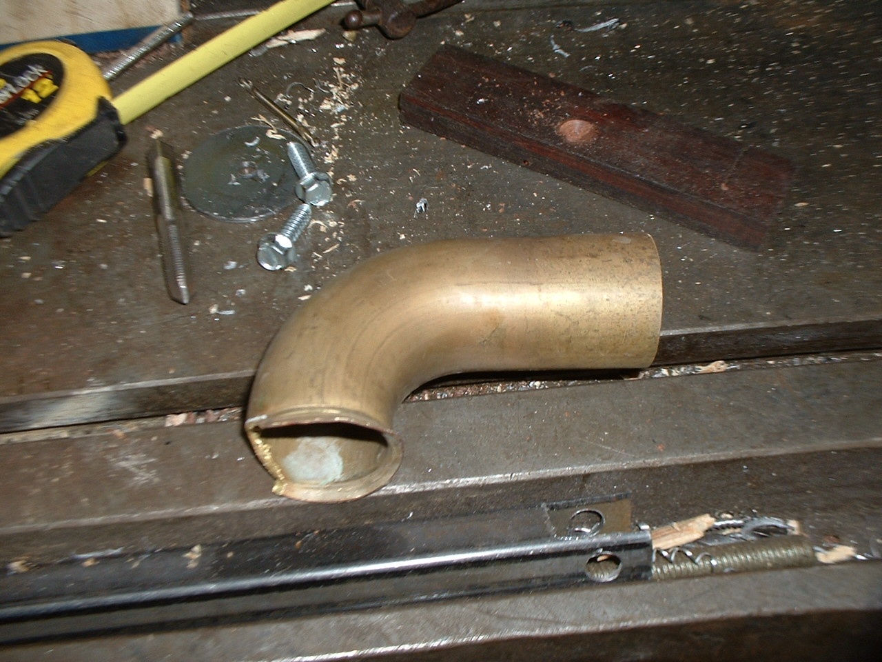

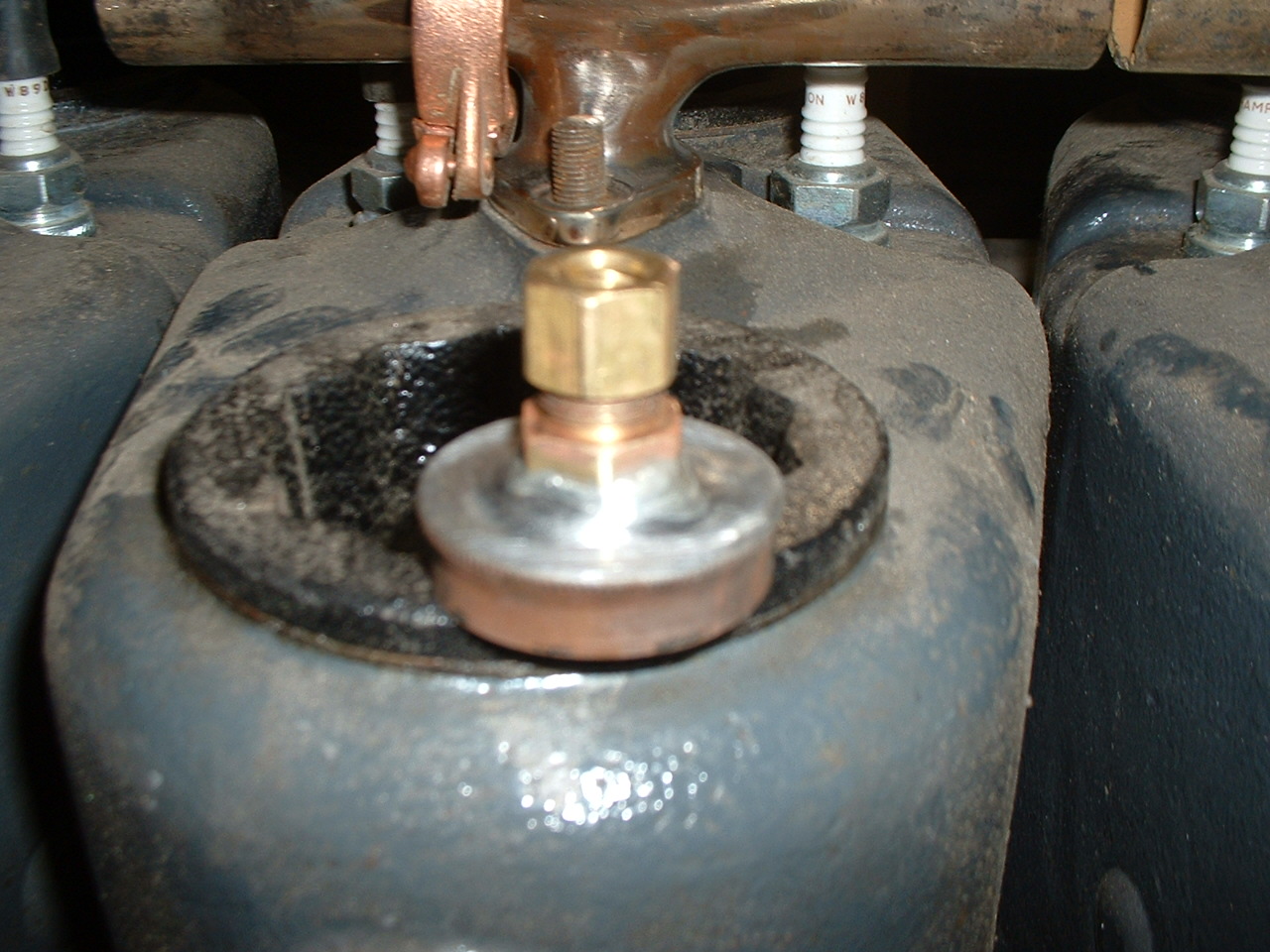

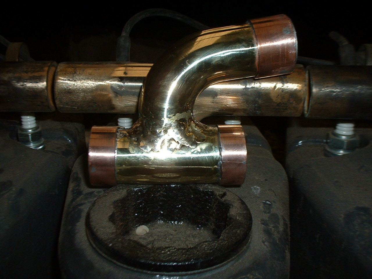

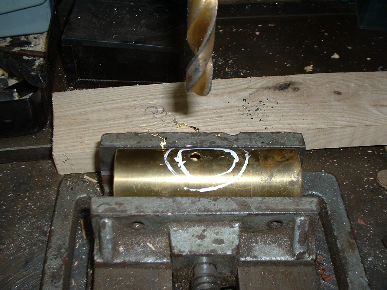

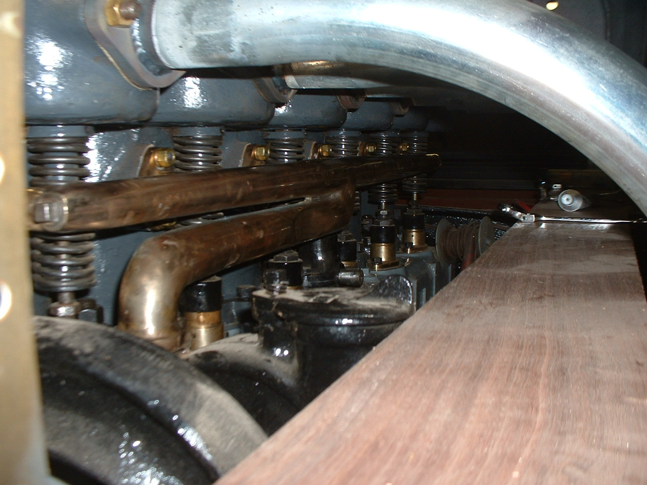

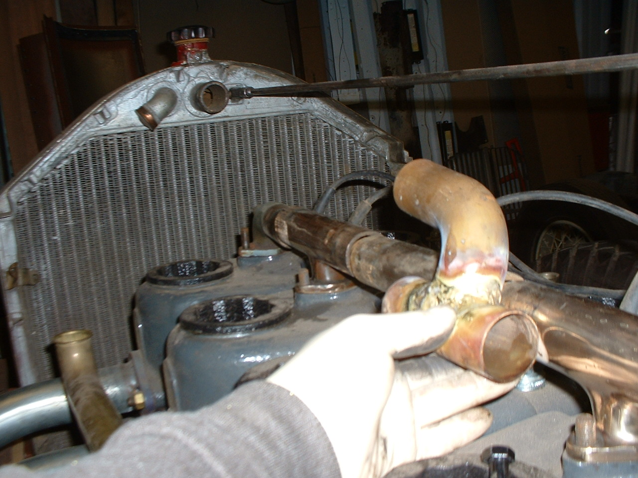

    I got in a little work today. Besides riveting the fan drive pulley together I ***embled the cooling fan. After that I made up a tee to fit into the radiator return line on the top of the engine. Not the prettiest work but it should do the job. Working with br*** is fun. It's soft and easily brazed and polishes up real nice. Tomorrow, if there's no snow and the kids go to school, I'll pressure test my braze job. And if that p***es inspection all I'll need is the fan belt--7/8" wide, 1/2" thick, 42" long and coming from Vbeltsupply.com--to have a complete cooling system. My Monday startup has been pushed back to later in the week. Video to be released.
    Jerry

    Joined: Feb 27, 2010
    Posts: 1,348
    yonahrr
    Cooling

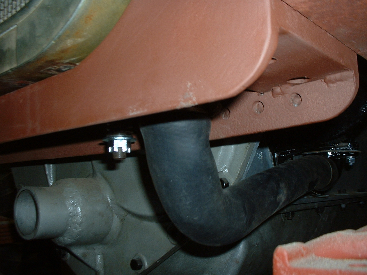

    A lesson on pipes. They come in different diameters and the diameter they are labeled probably has little to do with their actual diameter. The br*** pipe I made the tee out of was labeled 1-1/2 so I never bothered to actually measure it. When I went to put the hose on it I discovered that it was real loose, too loose for a hose clamp to take up. The pipe actually measured 1.48. Luckily, I had some copper pipe too. It was also labeled 1-1/2 but its real size was 1.60 which was the ID of the rubber hose I was using. In a unique twist of fate, the copper pipe exactly fit over the br*** pipe with just enough clearance to sweat in some solder. You see the result. The copper won't be visible. Next problem: For some reason the Lafrance radiator has an enormous overflow pipe--about 1" pipe (more or less--see previous lesson on pipe size.) So, I found a cap that fit the thread and soldered on a fitting for a more conventional overflow pipe. On the doorstep this evening, I found the fan belt I ordered along with a box of bronze lock washers. If everything comes together, I'm thinking Thursday startup.
    Jerry
    <input id="gwProxy" type="hidden"><!--Session data--><input onclick="jsCall();" id="jsProxy" type="hidden">

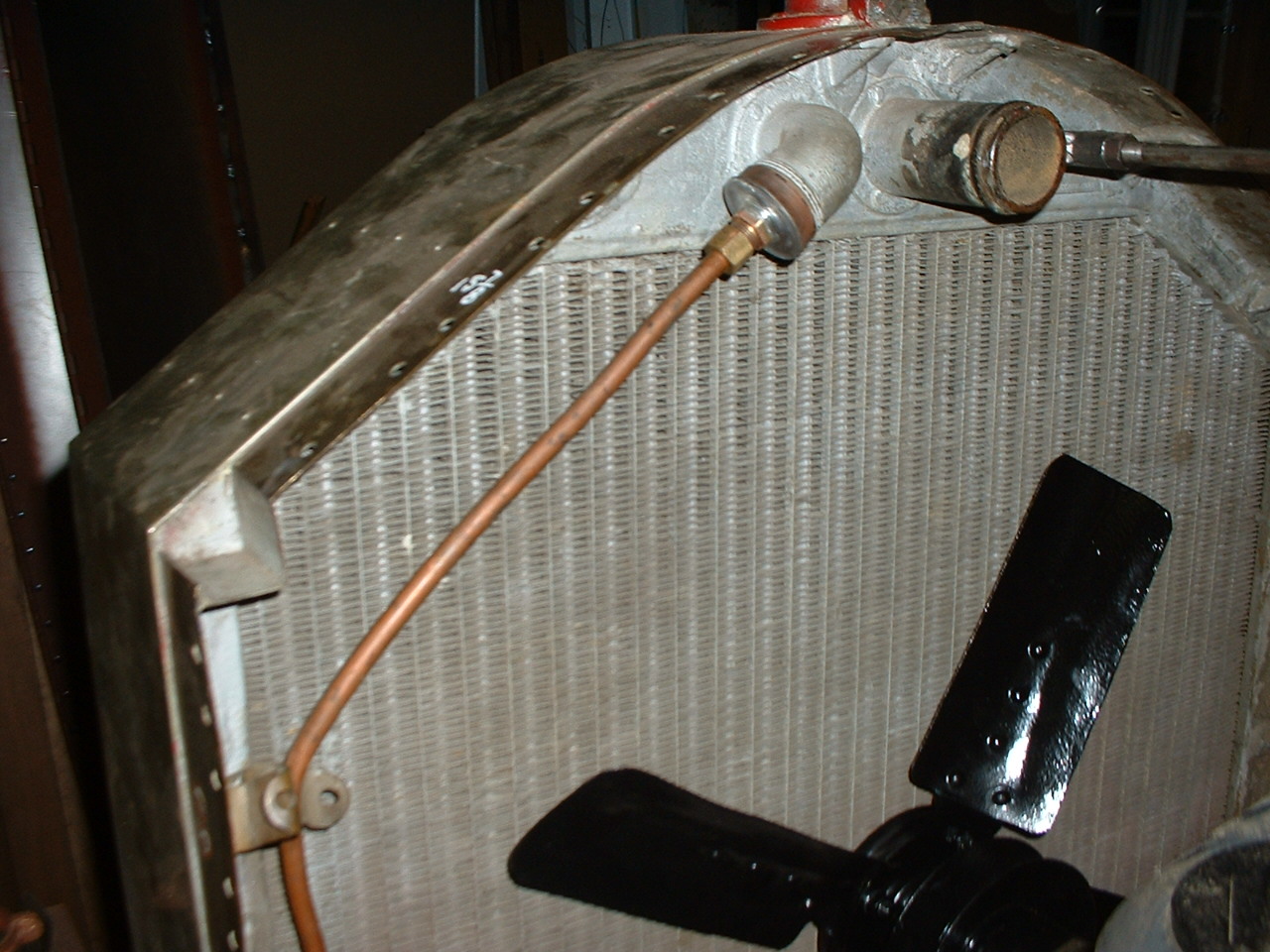

    Why is the overflow at the same level as the return hose from the waterneck?

    i wouldn't worry if the copper shows. It adds character! Very innovative fix.

    Good question! Inside the radiator, just under the cap, is a tube that leads down to that pipe. Water must bubble up to the cap and pour into the overflow tube where it will run down and out the 1" pipe that you see. These old cars have a non pressurized cooling system. They run at a fairly cool temperature. Some old cars don't even have a water pump and rely strictly on the thermosyphon effect. I have a 1950 Singer 9 roadster that has no water pump. I love that car. No water pump and mechanical brakes. It can sit around the garage for years and it's always ready to go.
    Jerry

    I am somewhat involved with a 1926 Arens-Fox pumper with a similar engine to the Seagrave. The pump is in front of the engine on the AF & the rad has some extra large fittings that look like your "overflow" pipe. In actual use the system is plumbed to run water from the fire pump through the extra fittings on the rad so the engine is cooled by new water all of the time - it must be set up like an inboard boat so the engine does not run too cool. If your rad only has the top fitting the other one was probably on the engine somewhere. You have put the surplus opening to good use.
    Jack
  16. HEY
    why would that "overflow tube be so large?
    so the system could re introduce the now cooled -over heated/ pressure back into the 'big system " way back in the water resivior .. ya have one right ?
    that tiny overflow tube needs to be coiled like an old still condensation tube .. for visual and vibration resistance it may need to flow more than you are allowing
    I WOULD LEAVE THAT CAP OFF AND ADD LARGE HOSE UNTIL YOU ARE SURE
    remember the rad is a minumum pressure tank 2-5lbs tops
    or KABLOOEEY
    OR THAT PIPE WENT TO THE HEATER ... FUEL PREHEATER ?
    OR AS ABOVE NEVERMIND...

    I've been told that some Seagraves had an intercooler that was surrounded by pump water to keep the engine cool when stationary and being used to pump water. My truck never had a pump since it was the tractor that pulled a ladder rig. I'm not sure why the overflow was big on an American Lafrance. I'm on a ALF chat group and I'll ask. The tube inside the radiator is still quite large so I don't think there'll be any Kablooeey. I just hope the engine runs cool. Today, I got the fan ***embly hooked up with the fan belt and installed the lower water manifold. I also found a lower hose at the parts store and got it installed. Unfortunately I had to use some modern clamps. The last thing I did was make up the overflow tube. Tomorrow, I'll do the the upper manifold and fill er up to check for leaks.

    Sometimes business interferes with my fun. This morning I had to meet with a new tenant so I got a late start. Despite the setback, I managed to get the top manifold installed. I lack one clamp (which, for the time being will have to be modern) before I can fill the system to check for leaks. If all goes well, tomorrow we make smoke.

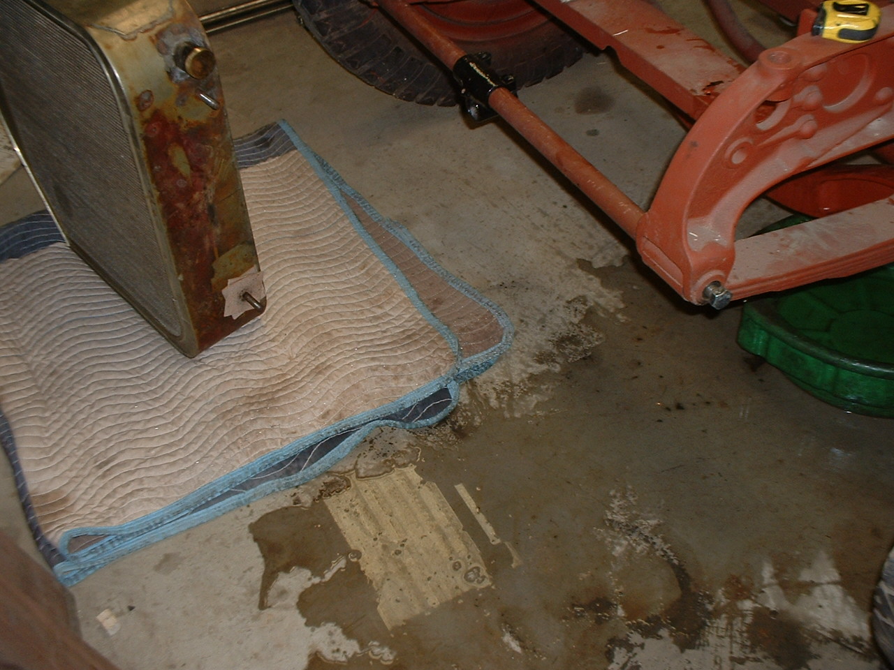

    Leak!!!

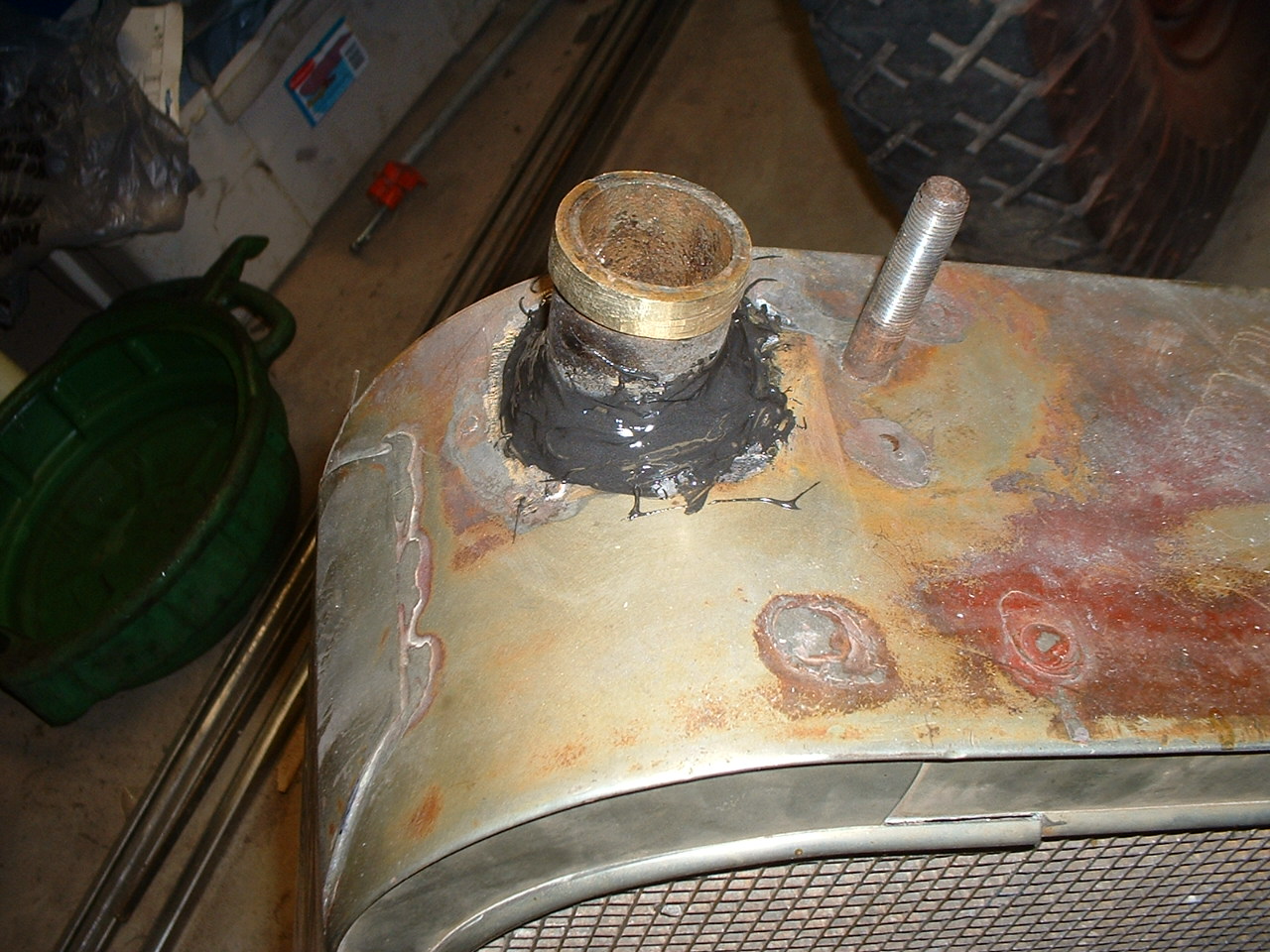

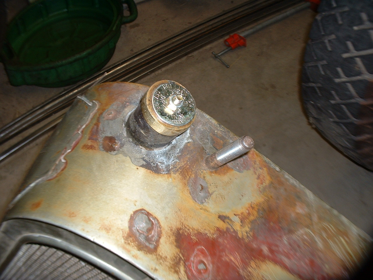

    I started to fill up the radiator and immediately water began pouring out the lower hose. On close inspection I saw it was coming out from the solder joint above the lower spout. When I pulled the radiator it looked almost as if someone may have melted the solder from the joint. The spout was tight but it was leaking. I could have flowed some solder in the joint but I had an overwhelming fear of melting the solder from everywhere else. I've chased leaks on radiators before and it ain't' nice. So I cleaned off all the corrosion then mixed up some MarineTex and gobbed it around the joint. If the joint had been loose I wouldn't have done it, but I felt what was needed was a water tight seal rather than a mechanical attachment. I've had good luck with MarineTex, better than JB weld. We'll see.
    Jerry
