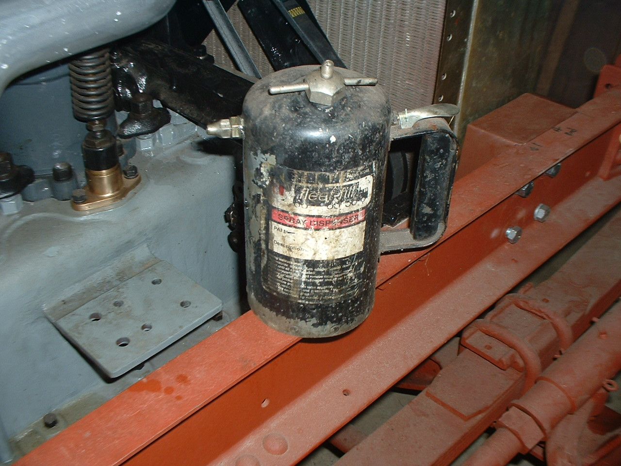

    what if you opened up one of the primer holes and using a spray bottle with some gas in it try to richen it up a little?

    I'm thinking of getting a spray bottle and shooting the gas right into the carb.

    ^^ garden sprayer

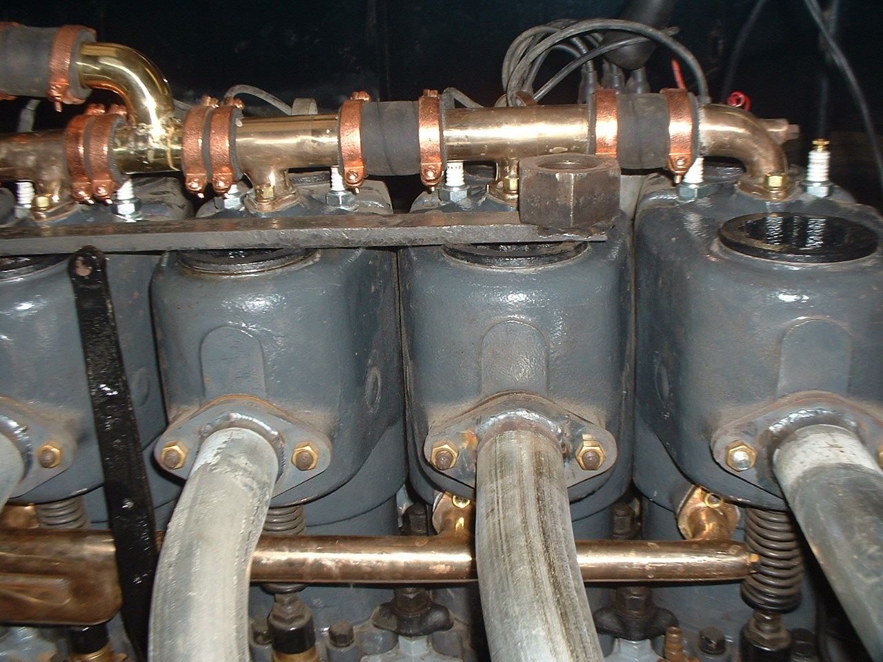

    After hearing it I'm still thinking intake leak, put a little oil in the primer cups above the guilty cylinders and see if it gets ****ed down with them closed.

    The priming cups go right into the combustion chamber so the oil would either get ****ed in or blow out all over you depending on what stroke that cylinder was on.

    Just stick your thumb over the priming cup while it's running...if it's leaking you will know. I'm thinking ignition wires.

    Maybe on to something with those plugs...perhaps a little leak was there? I wonder if snugging them all down and then maybe squirting soapy water around the threads might give up a possible leak?

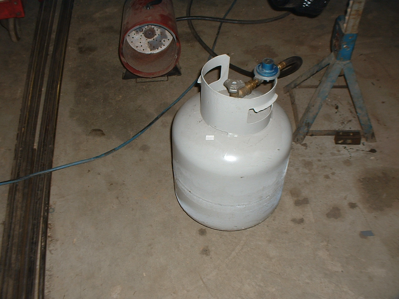

    I also have richened the mixture on a few engines with mysterious trouble with propane. An unlit plumber's torch stuck in the carb inlet has a valve that you can regulate the ammount & it does not have to vaporise in the venturi. Maybe worth a try.

    I'd forgotten about the propane trick. That's a great idea to eliminate a too lean mixture problem. I'll do it tomorrow.

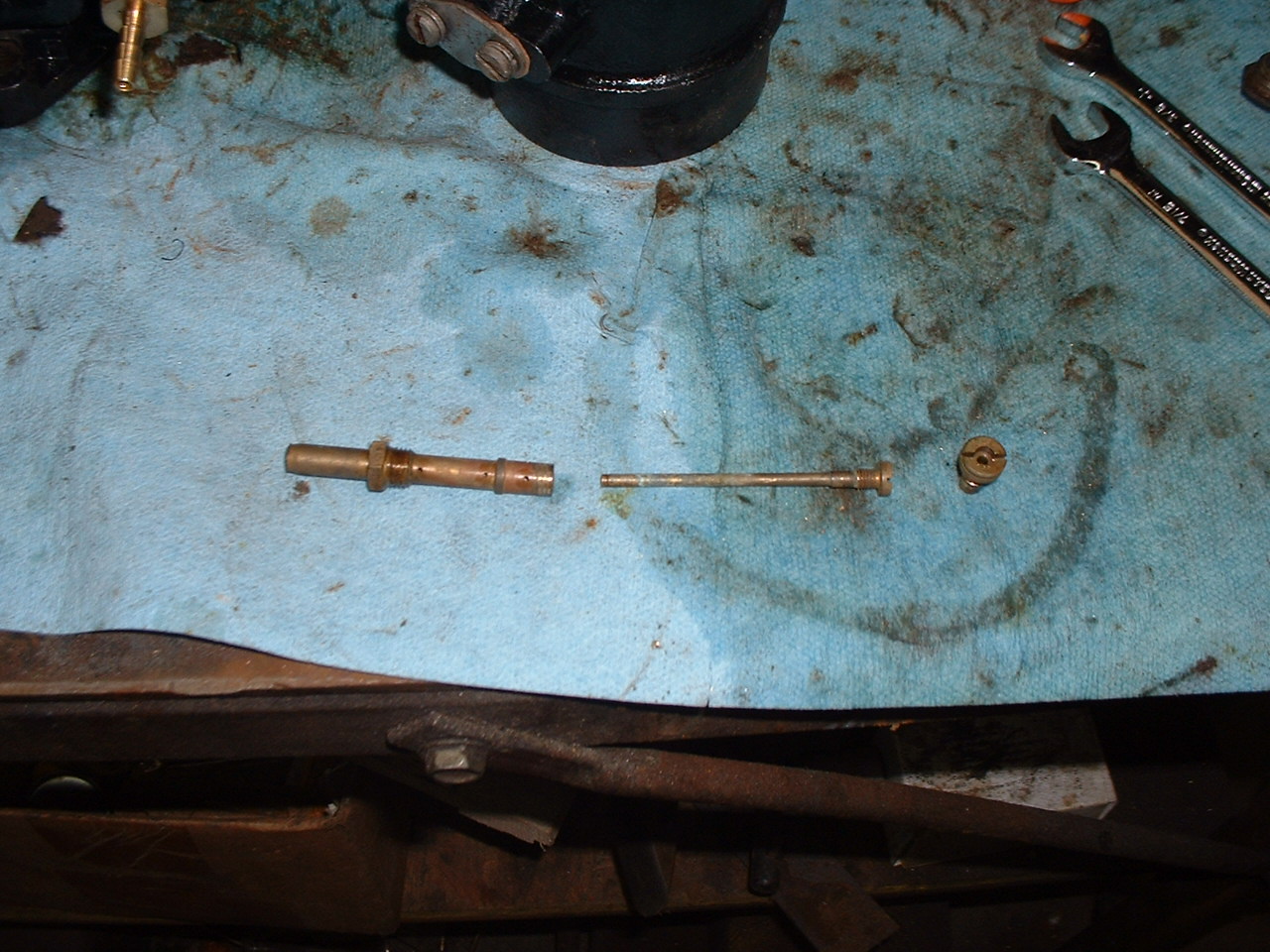

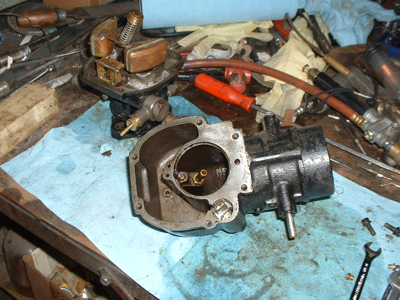

    Backfire solved??
    Jack,
    I took your advice about testing the mixture by richening up the mixture. However I didn't think there was enough gas in a plumber's torch. I use a 20lb propane tank and heater to heat my shop so I thought I'd just stick the hose in the carb and turn on the gas. Surprise, those new fangled tank valves won't let you do that. You've got to have some back pressure. So I got out my little pressurized hand sprayer and filled it with gas. As long as I kept the stream in the carb throat the engine ran smooth. If I stopped spraying, within a ten seconds (when the extra gas burned off) the back firing started again. I never did see any black smoke, nor did the engine ever stumble like it was running too rich. I think it's just running too lean. (You'd probably need a garden hose to make it run rich.)
    The carb came from ebay, but the bore and the flange size were a perfect fit. It's a simple thing, like a gargantuan lawn mower carb. I could hog out the jets but I'd rather make an adjustable main jet. That would save me a lot of trial and error. You can see the main jet set up in the next to last picture. The last picture is the wrench for taking off the plugs over the valves.
