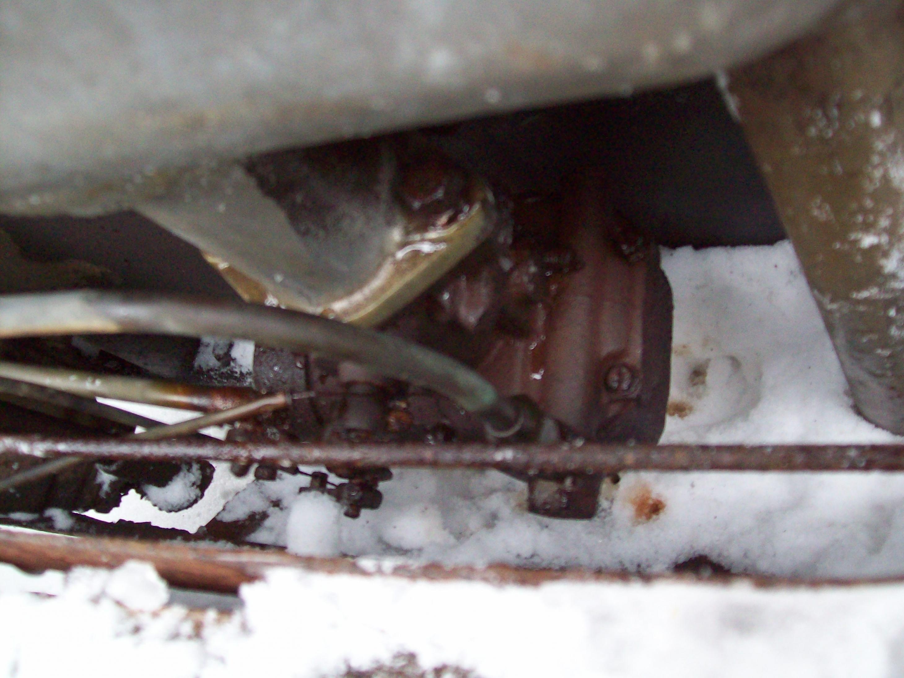

  8. Jack Innes
    Joined: Nov 26, 2010
    Posts: 178
    Jack Innes
    Jerry,
    Here are some pictures of the original carb on my model F engine. It looks like you have the correct one.
    You may be onto something with the size of the fuel line, as you can see the original was quite large .
    Forgive the snow.
    Jack

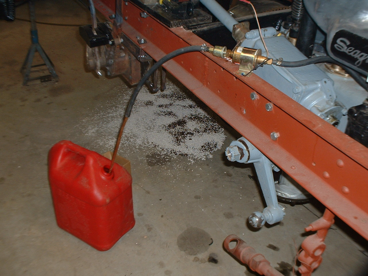

  10. yonahrr
    Joined: Feb 27, 2010
    Posts: 1,348
    yonahrr
    I hooked up a fuel pump and gave cranked it up. No change. I'm back to hogging out the carb jet--although I might wait until my new ebay carb shows up. It might have a bigger jet in it.
    Jerry
    <input id="gwProxy" type="hidden"><!--Session data--><input onclick="jsCall();" id="jsProxy" type="hidden"><input id="gwProxy" type="hidden"><!--Session data--><input onclick="jsCall();" id="jsProxy" type="hidden">

  12. Frank
    Joined: Jul 30, 2004
    Posts: 2,325
    Frank
    Maybe a sum of several things, though I wouldn't doubt the jet size is probably the real key.
    That inlet looks like maybe a 1/4" ****** or smaller? Seems really really small. Maybe you are emptying the bowl?
    You say it just idles when you choke it? Any possible vacuum leaks?

  14. yonahrr
    Posts: 1,348
    yonahrr
    Good thought, but I replaced that fitting with a larger one when I put on the electric pump--no change.

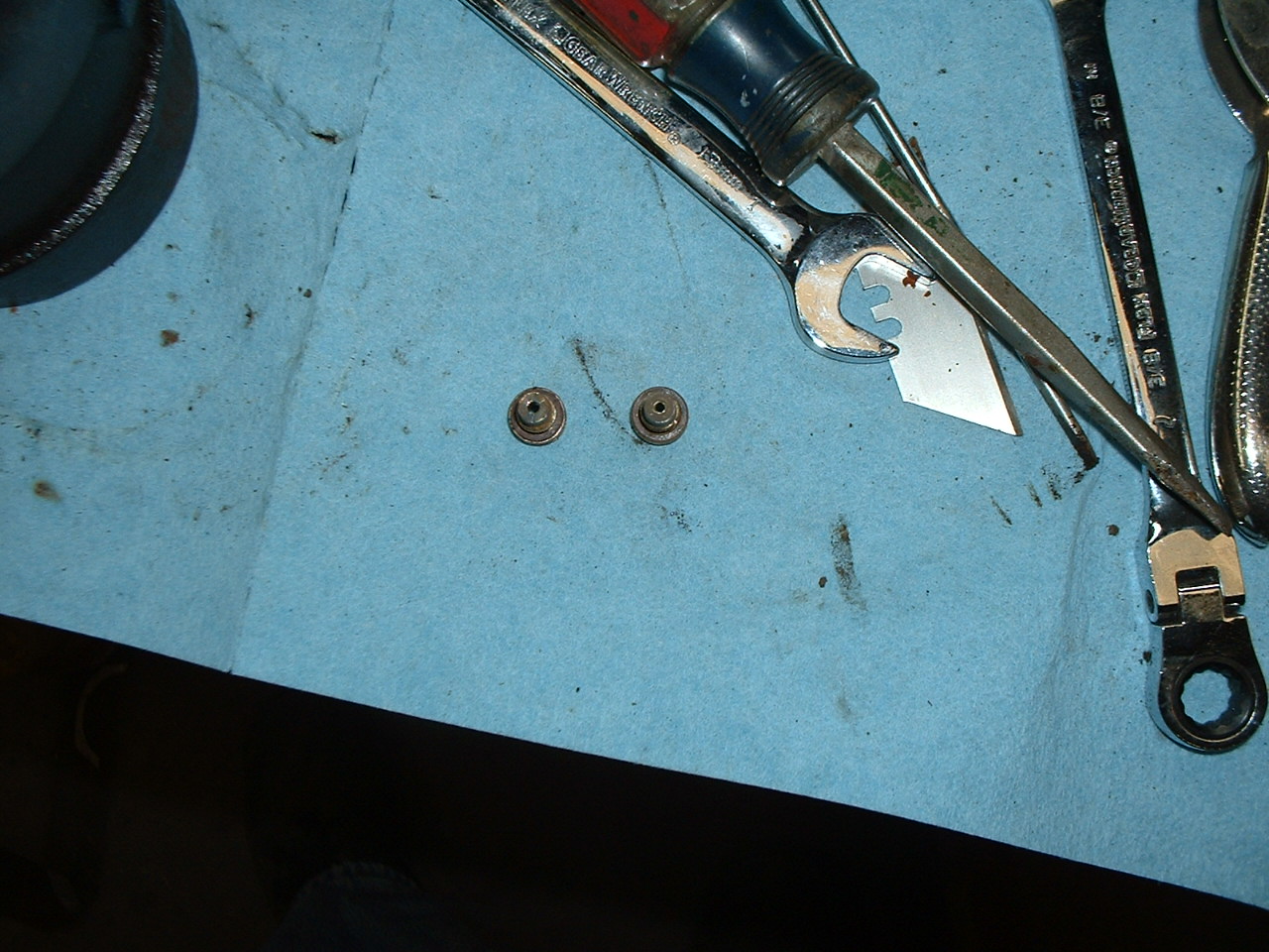

    New Carburetor
    My new ebay carb arrived today. Fast shipping! It looked like the exact model as the old one. I had a lot to do but I found time to dismantle it. Upon examination it looked like a rebuild that someone put on the shelf and forgot about until the roof started leaking. The needle and seat, the floats and all the valves looked perfect. The jets were bigger too. The old main jet was a 25 the new is 39. The idle jet was bigger too. What does all this mean? It means I'm going to give it a quick clean up and bolt-er-up. With a little luck my engine problems may be solved.
    Jerry

    New Carburetor
    I bolted on the new carburetor, hit the starter and lost my spark. Searched around for a new coil, found one, hit the starter again and guess what? No backfiring. Funny how things work out. The idle screw adjustment even worked. But when I jazzed the throttle I got a some black smoke so I think the idle circuit is good but the main jet might be a bit too large. I think I'm going to build an adjustable main. If there's time I'll post a video tomorrow.
    Jerry

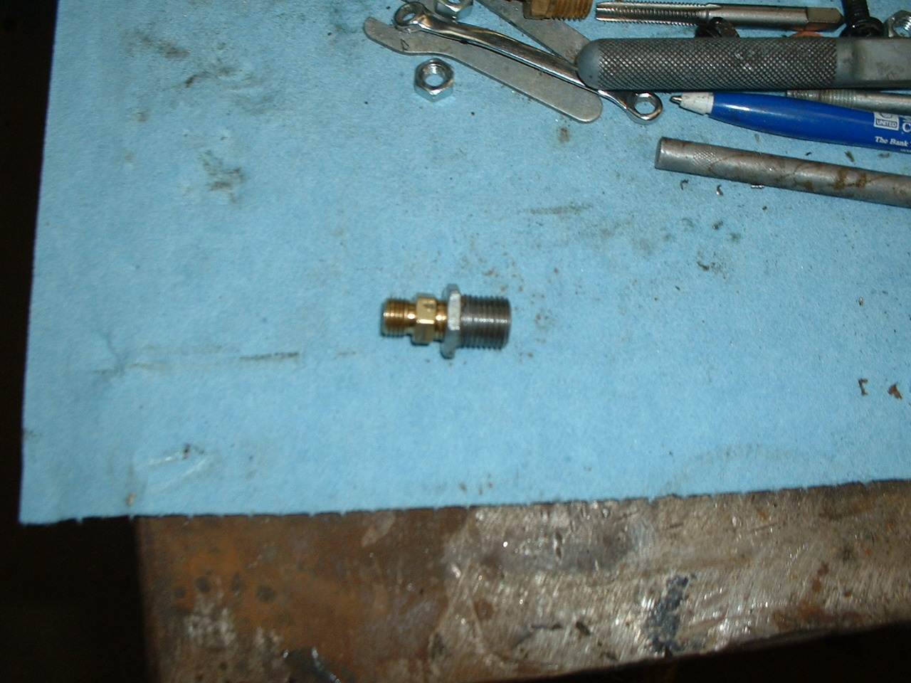

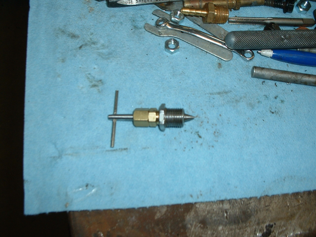

    Adjustable Main Jet
    Since I couldn't find one on the net, I spent the day building an adjustable main jet out of hardware store plumbing. I used a 1/4-1/8 reducer, a 1/8 compression fitting, a phillips screw from an old Honda motorbike and a tiny o-ring. I rethreaded the reducer to 1/2-20 and screwed in the compression fitting. I cut off the phillips screw and ground the end to a point. Then I drilled a hole in the shaft and drove in a small rod. After that I brazed up a wee hole in the br*** cooling tee I made previously. Tomorrow I fill the engine up with water and see if the jet works and the tee quit leaking. My 12 volt non external resister coil should be in at NAPA too. $11.95 MP IC277SB if you need one. Video to follow.
    Jerry

    i have seen a few high speed needles and i would of made mine more needle like.
  28. llonning
    Joined: Nov 17, 2007
    Posts: 681
    llonning
    Funny, that looks like a Briggs setup for the old updraft carbs. They do have more taper to them like budd said. Also looks similar to the Te***seh style.
  29. Ebbsspeed
    Joined: Nov 11, 2005
    Posts: 6,548
    Ebbsspeed
    C'mon guys, don't "needle" him.:D If it doesn't work like it is, it won't take a government initiative to decrease the taper on it. I think he has the skills to accomplish it..........
  30. Piston Farmer
    Joined: Aug 6, 2009
    Posts: 672
    Piston Farmer
    lets not forget this thing requires alot of fuel. It may be perfect in this application, if not easy enough to change
