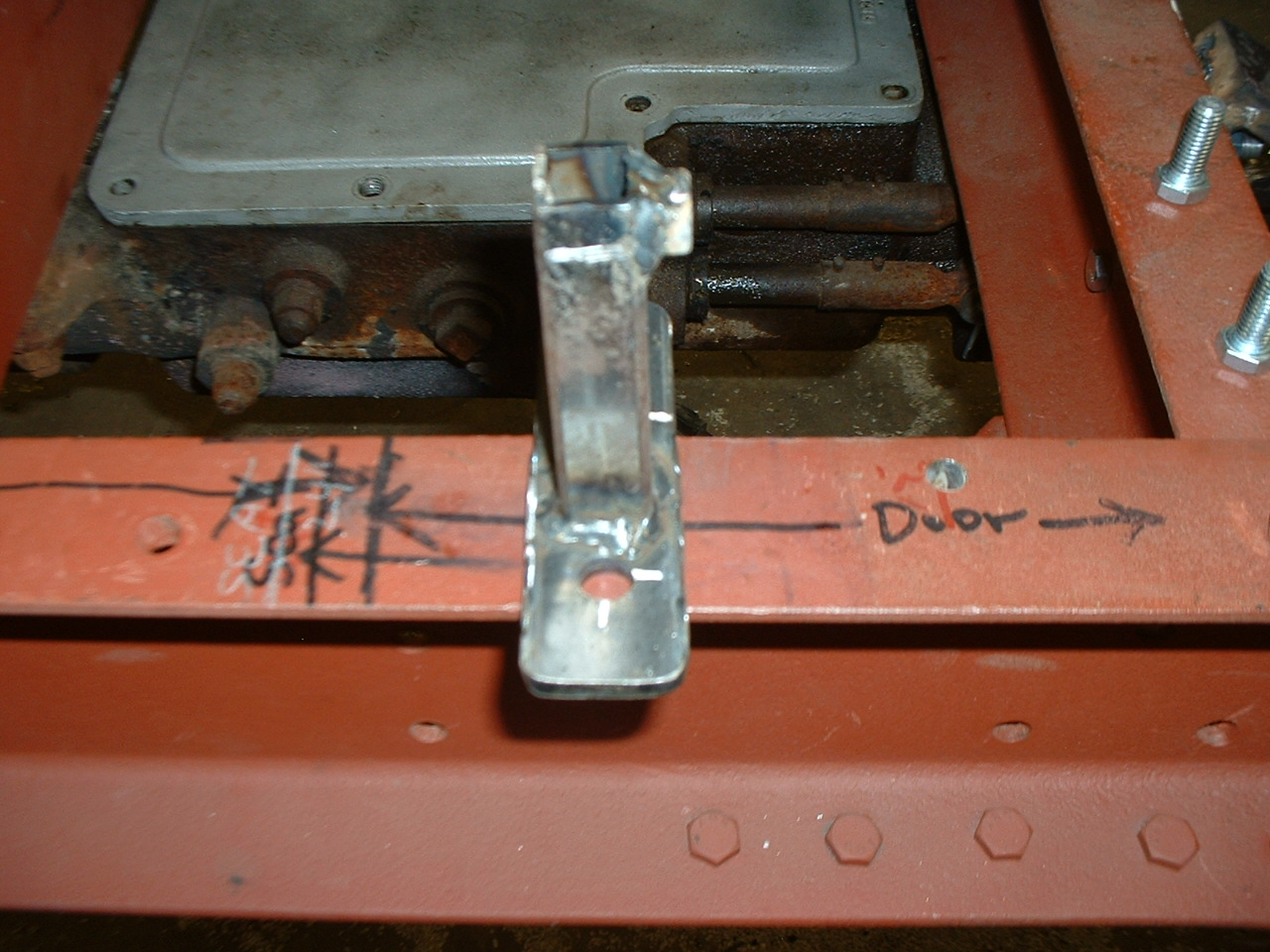

  3. yonahrr
    Joined: Feb 27, 2010
    Posts: 1,348
    yonahrr

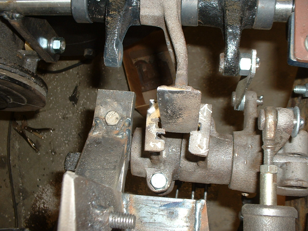

    Details, Details

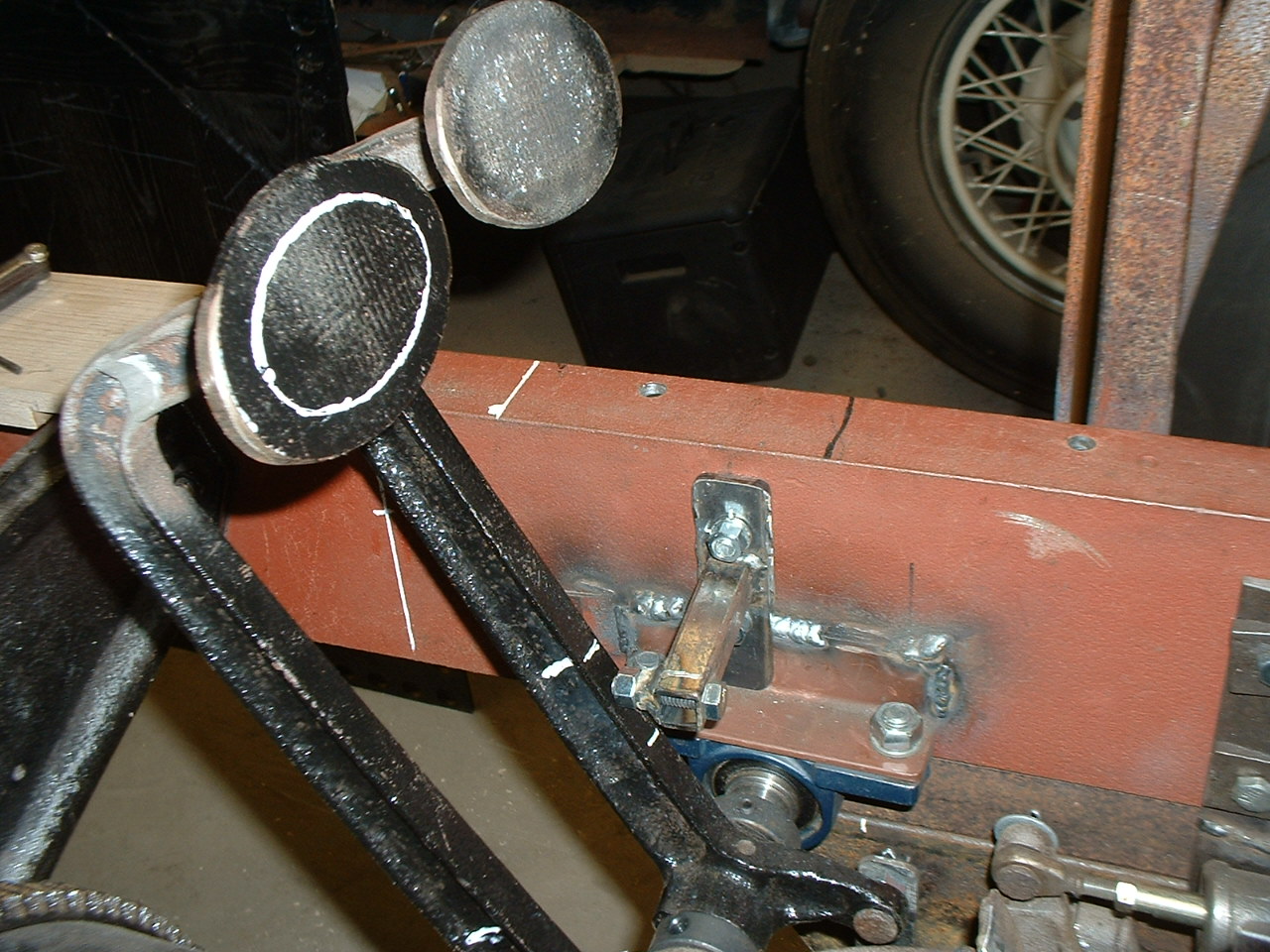

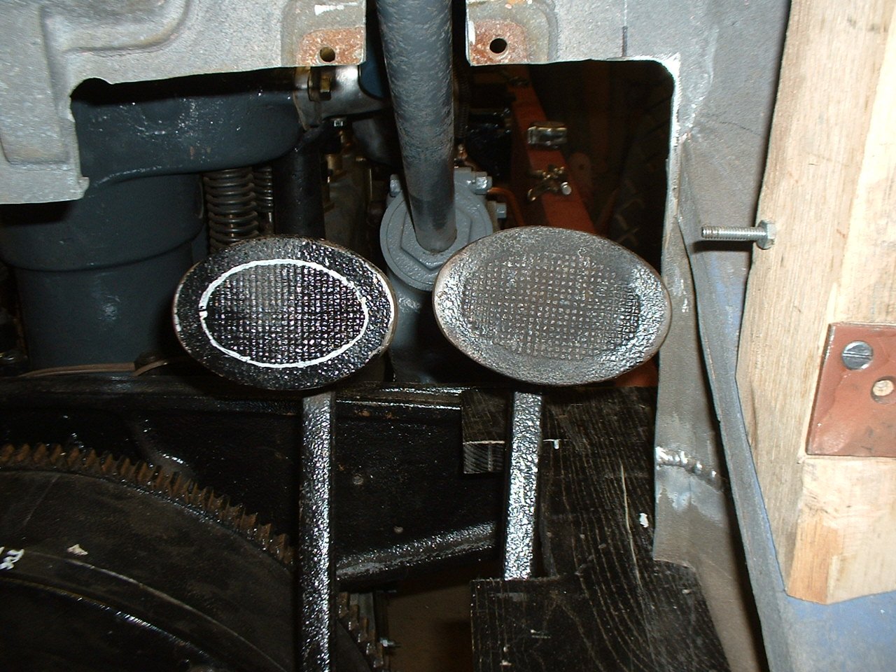

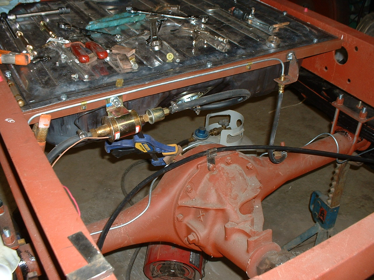

    First off I finished up the shift interlock by welding on a tab and cutting a slot so that each gear will be locked in place when the clutch is released. Then I made up a stop for the brake pedal. After that I began to install the brake lines. This a troublesome task since you have to bend a tube around various obstacles and it has to come out neat. I miscalculated the length of the brake line going to the master cylinder by 24 inches. Mmmm. Back to the parts store. I also began bending up the fuel line but found out I have to drop the steering box to get it fitted properly. That's a two man job. So I took off the drag link instead.

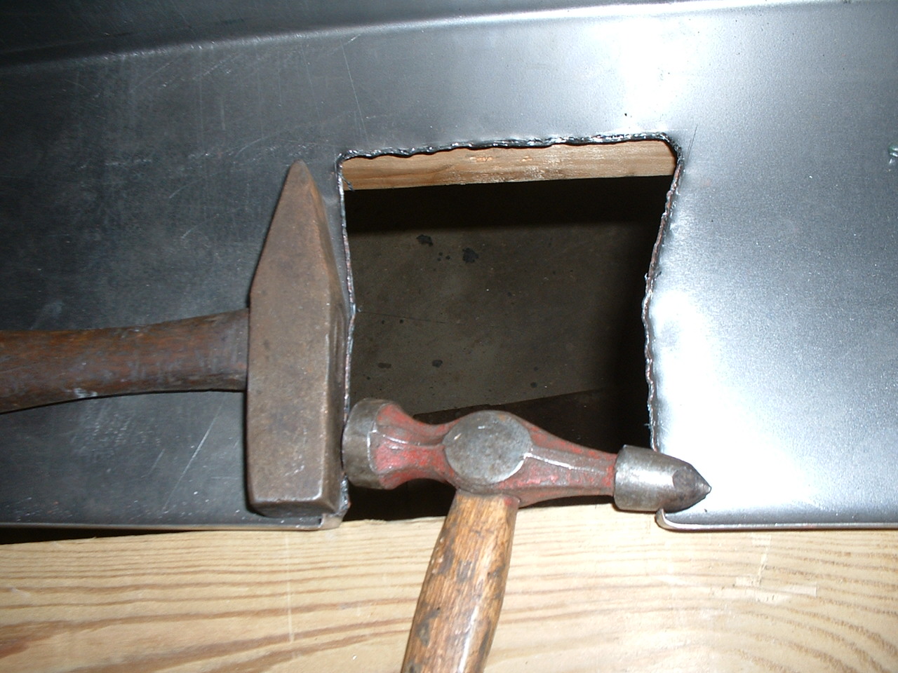

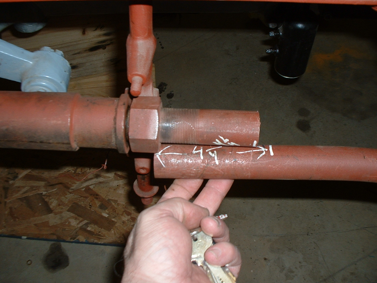

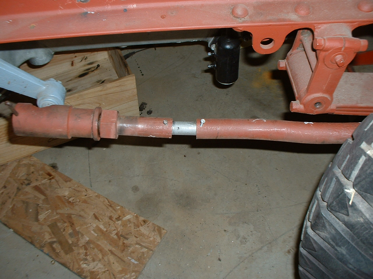

  4. yonahrr
    Posts: 1,348
    yonahrr
    Drag Link

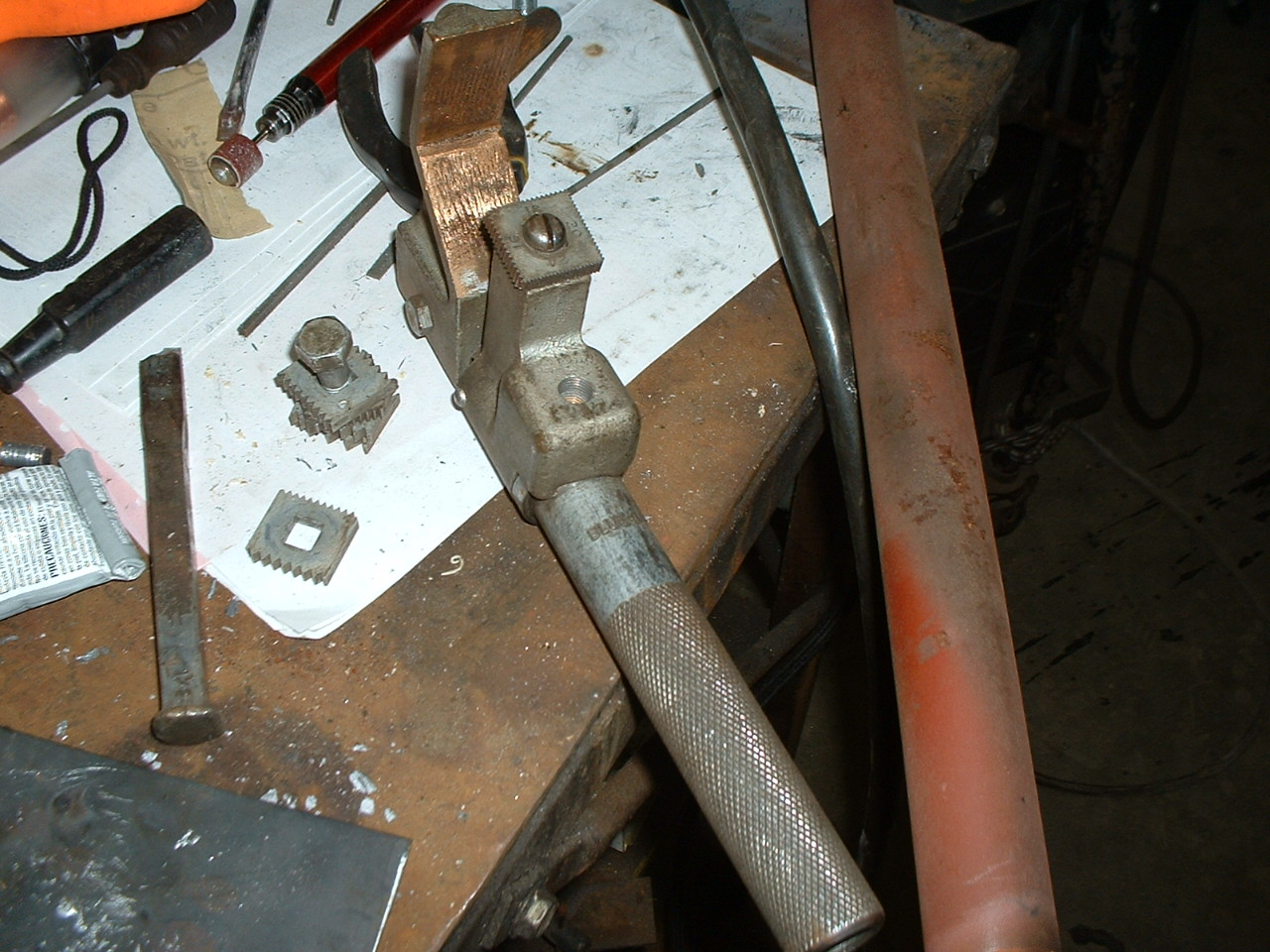

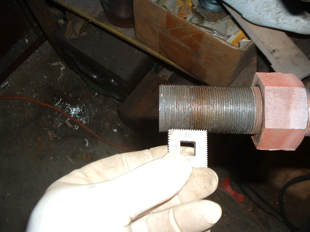

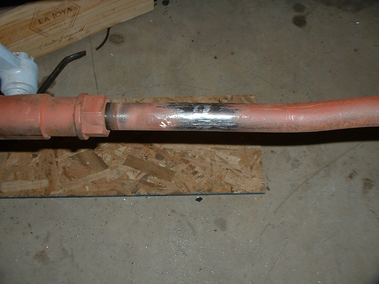

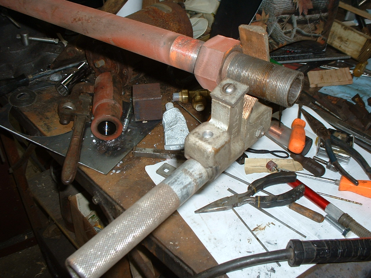

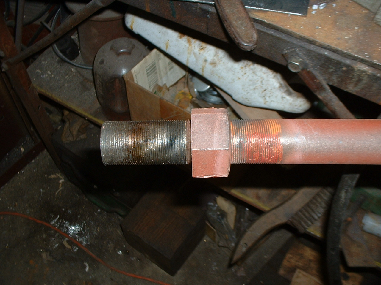

    Because I changed the angle of the steering shaft I'll have to shorten the drag link 4.5". The threads were full of paint but luckily I have this nifty tool I picked up on ebay to clean up spindle threads. The drag link is hollow so after I cut out the 4.5" I'll insert a solid rod and weld the whole thing up.

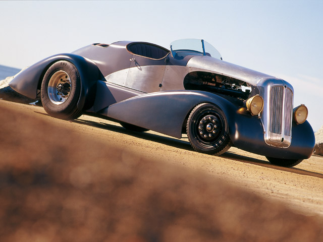

    Didn't get to work much yesterday. Only put on one brake line! Big things today. Hey, here's a giant Seagrave speedster project for someone. V12!
    http://cgi.ebay.com/ebaymotors/1948...5100?pt=Commercial_Trucks&hash=item4cf573179c

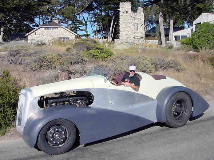

    You can make a car like in the picture below. Question: How does he get into the car without stepping on the paint?

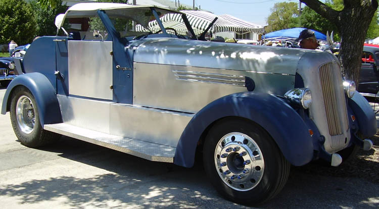

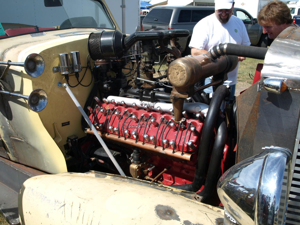

  7. the 48 i had went from this frame
    then i sold it it went into this 38 buick
  8. yonahrr
    Posts: 1,348
    yonahrr

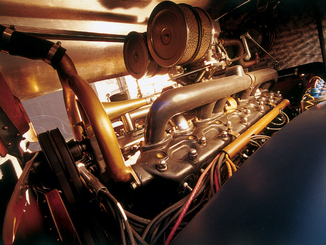

    Awesome engine!

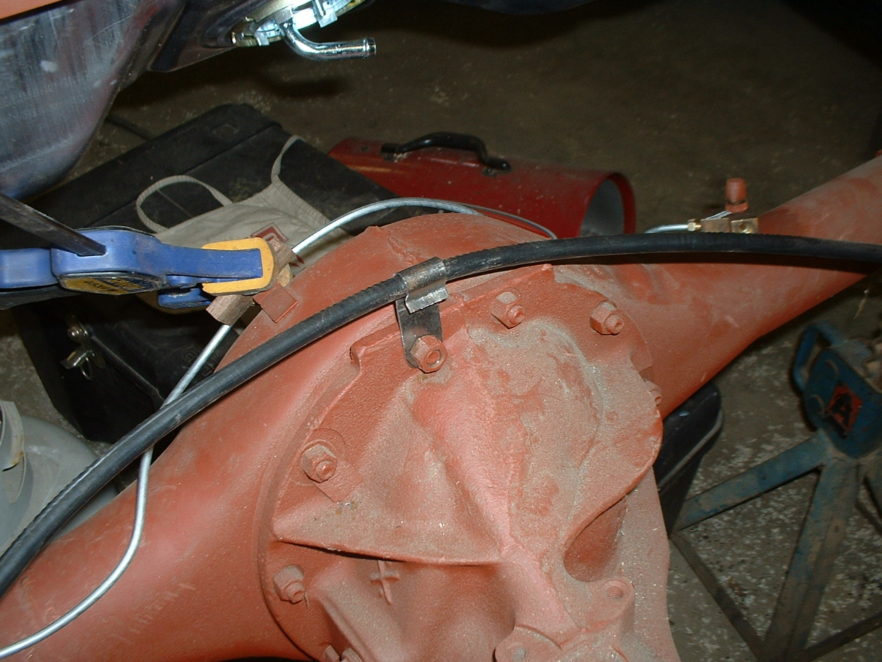

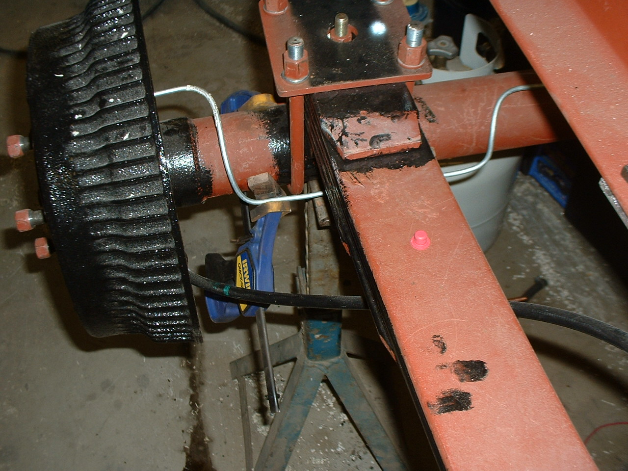

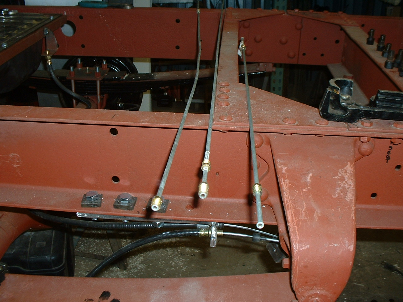

  9. yonahrr
    Posts: 1,348
    yonahrr

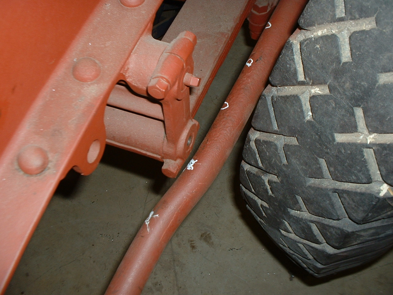

    Brakes
    It's like I'm in Libya around here, my tenants are revolting. Not really, but I have had a series of crisis. Despite that, I found time to finish up the brakes lines and bleed them out. I also finished up the handbrake cables and made them work too. I even got the sheet metal aprons trimmed. So let's see... I still need a gas pedal, a fuel line, shorten the drag link and make something to hold the battery, then put the body back on and go for a ride.

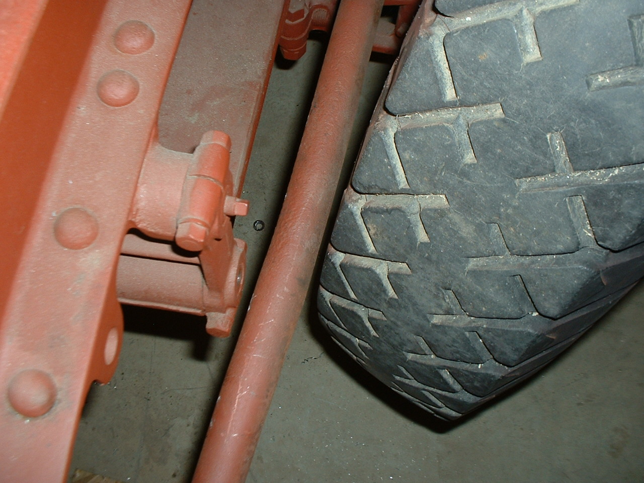

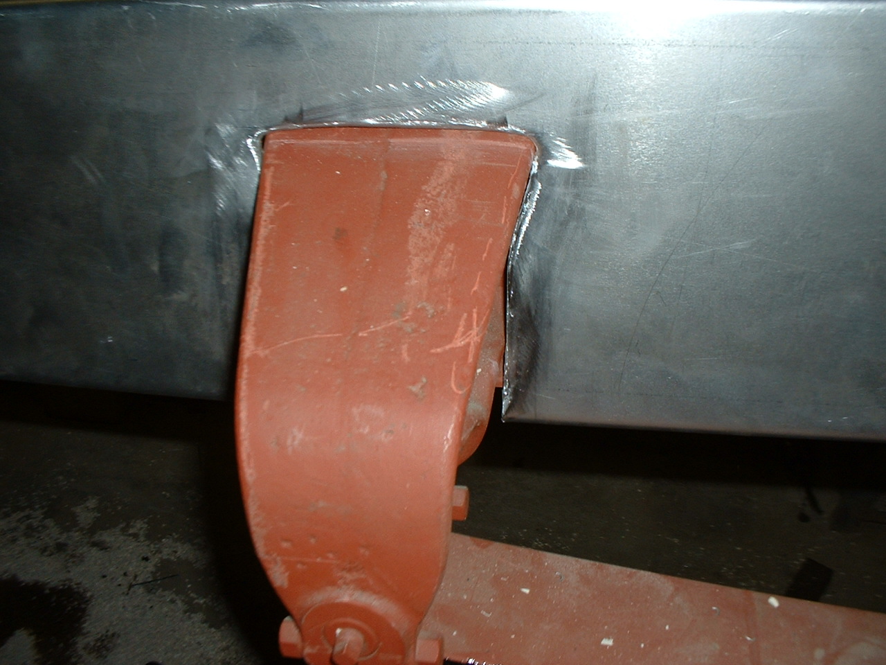

  28. yonahrr
    Posts: 1,348
    yonahrr

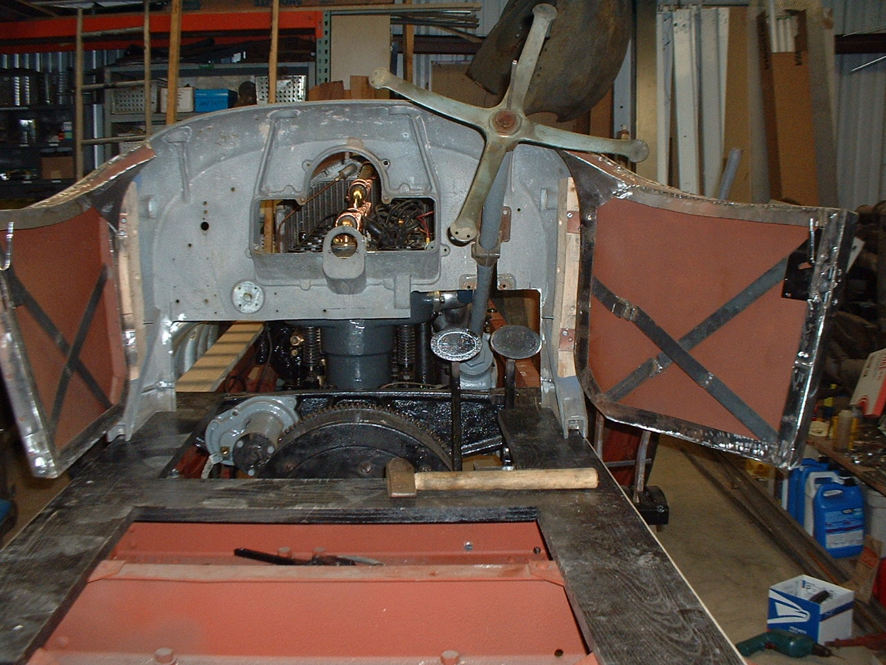

    Tight Squeeze
    I spent most of the day trying to get the steering where I want it. The angle of the steering shaft is critical so I put the cowl back in place. Good thing too because I noticed I have a clearance problem with it and the brake pedal. I cut a piece from the drag link and went to work finding the right spot that gave me the same wheel angle left and right. That meant jacking up the front end and turning the steering wheel back and forth while changing the drag link distance ever so slightly and at the same time measuring the distance from frame to wheel first on the left, then on the right. I also had to hunt up a 7/8 rod to put inside the drag link so I can weld it up. Another detail is the clearance between the tire, the front spring and the drag link. I'll have to put a little bend in the drag link. Lastly, the white lines around the gas tank opening is a piece I've got to cut out so I can put a hose clamp on the gas filler line.
    Jerry

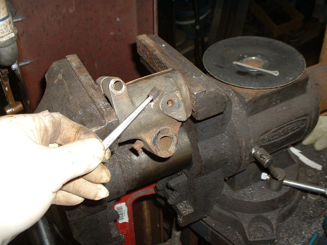

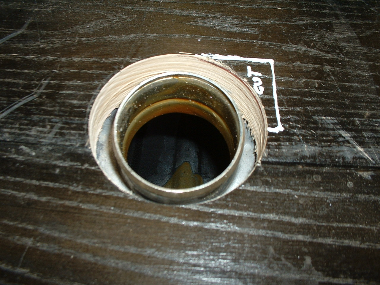

    Misc.

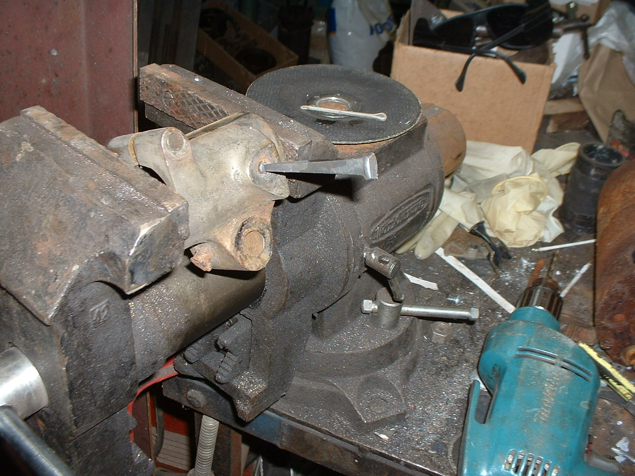

    I welded up the drag link. The clearance is tight but I think it'll fly. Then I worked on a neat br*** casting that holds up the steering shaft. It had a broken screw in it so I used an old mechanic's trick--making a screw extractor out of a cut nail. Try it some time. After that I morphed into a metal man, an amateur metal man, and tapped out a flange on the the splash aprons. Good thing I'm also an amateur bondo man. Still to go: battery box, gas pedal and linkage, two more body mounts. Probably a few other things I can't remember.

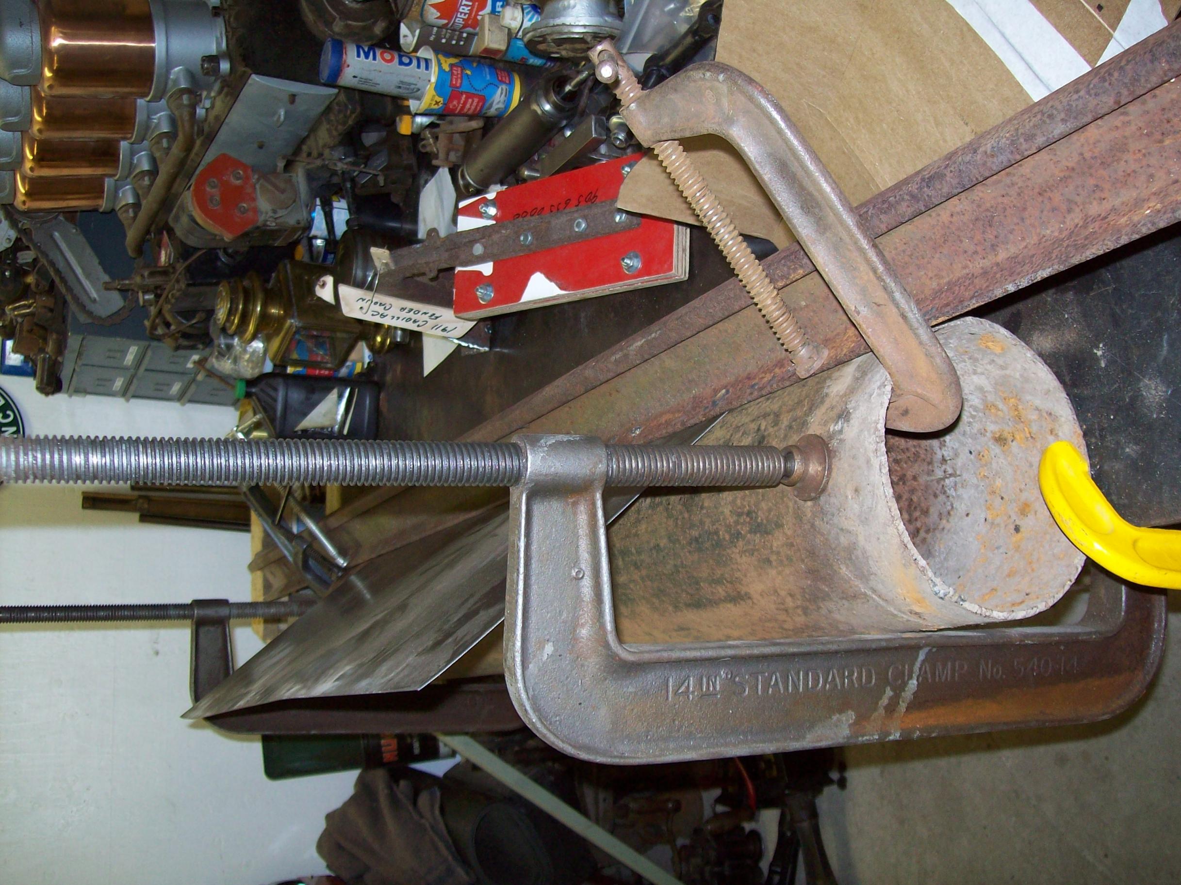

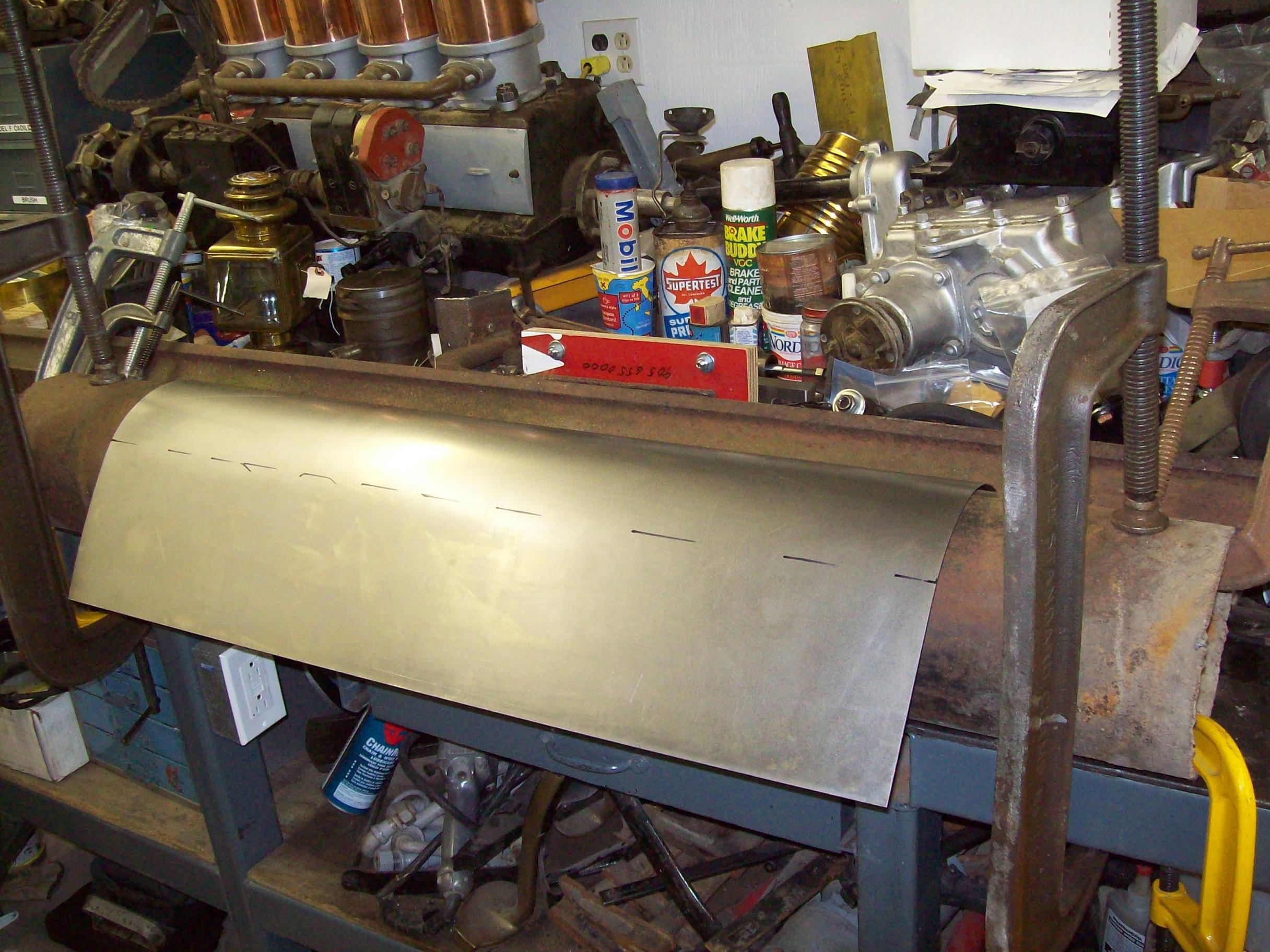

  30. Jack Innes
    Joined: Nov 26, 2010
    Posts: 178
    Jack Innes
    Jerry,

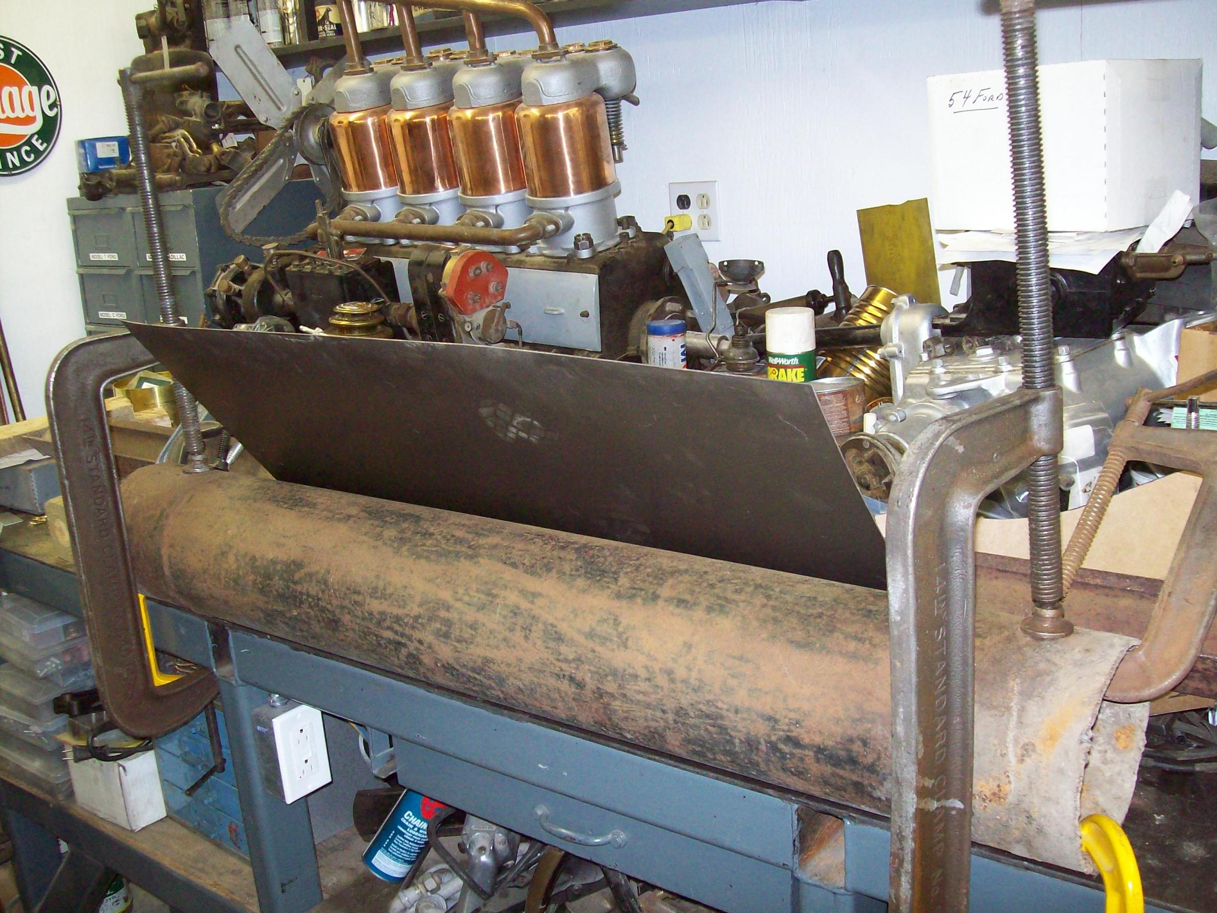

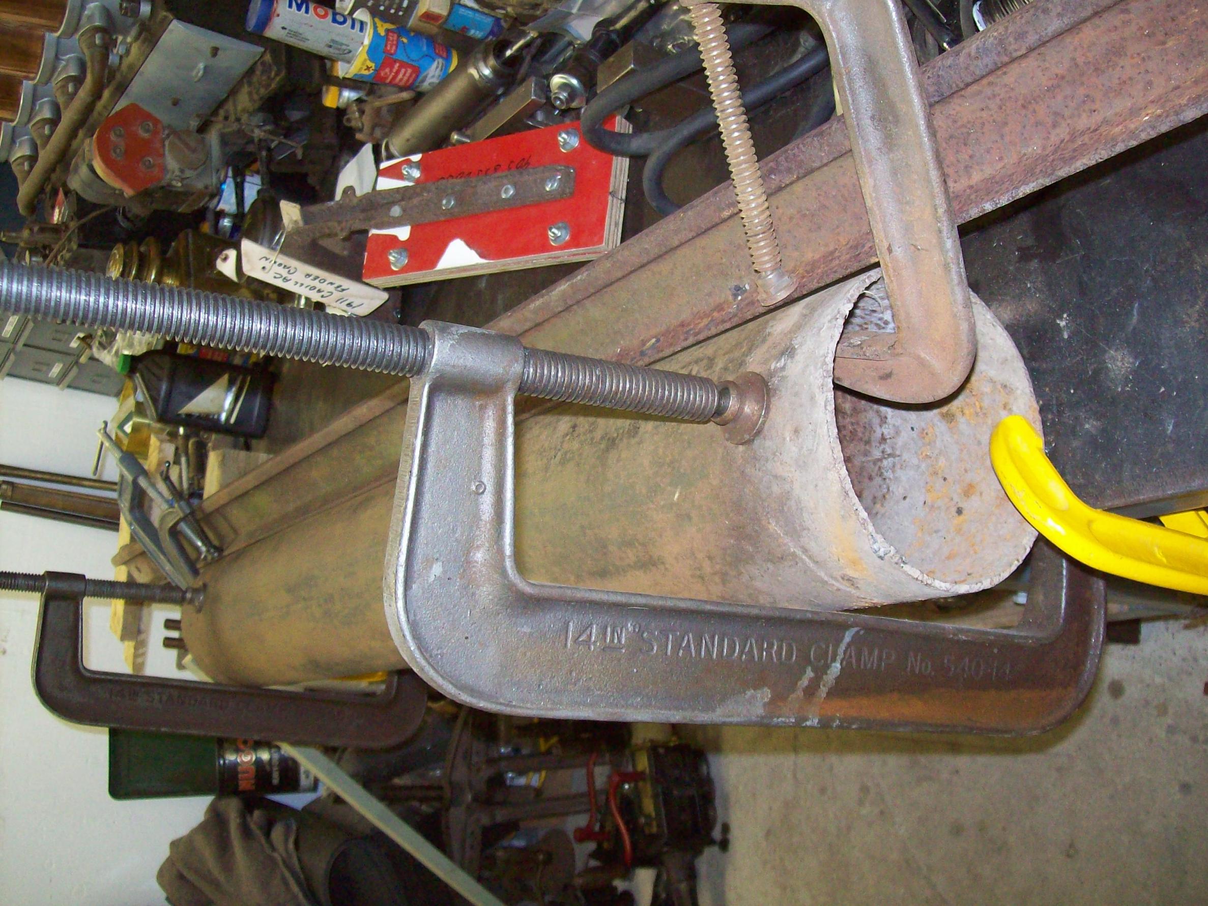

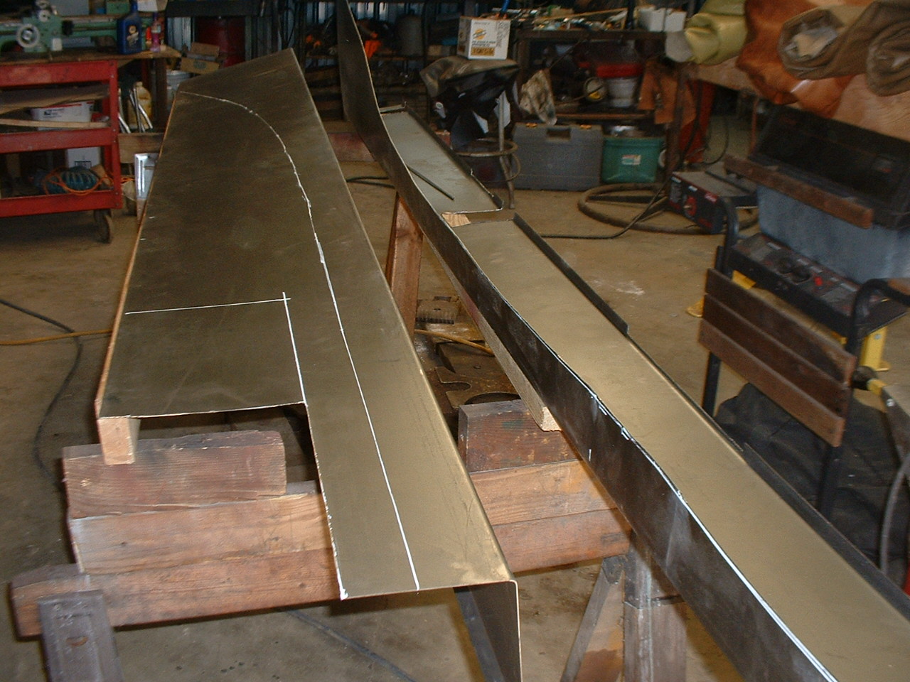

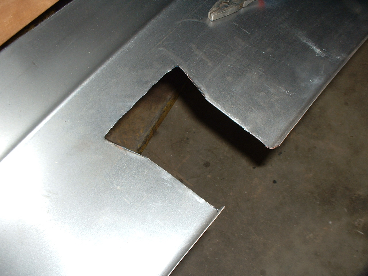

    A while ago you discussed large radius bending for your frame covers. Your square bent ones will look good but I thought you might like to see an easy method of bending large radii.
    These are for the splash shields on the 11 Cadillac. Luckily they are in sections so the longest one is about 3 ft. long. For longer bends you obviously need a longer pipe but it is also wise to clamp the free end of the steel between 2 pieces of angle iron to make it more stable. Too much longer & a helper would be a good idea as well. The steel here is 18 ga. The next step was to cut them to shape & put wire edges on them.
    Jack
