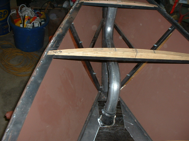

  4. yonahrr
    Joined: Feb 27, 2010
    Posts: 1,348
    yonahrr

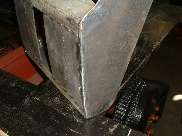

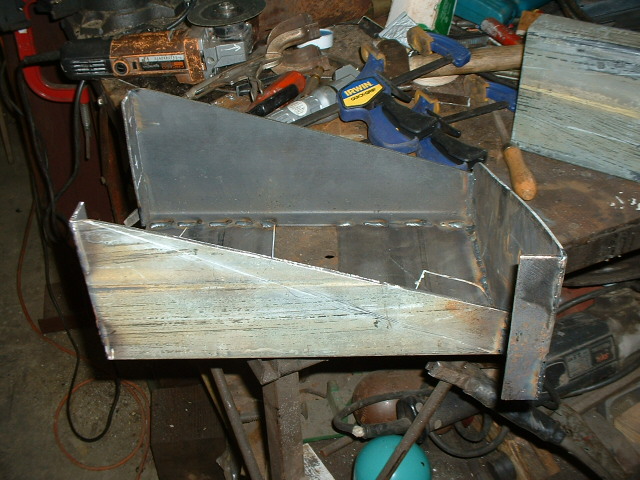

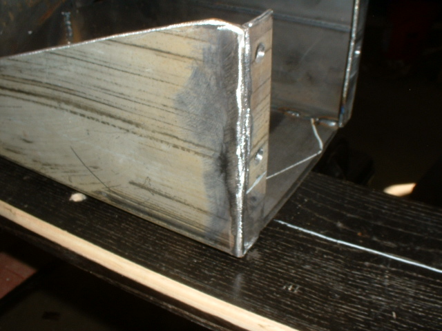

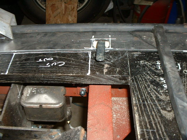

    Forgot my camera
    Dementia? My shop is too far away from my house to have gone back to get it. I cut some slots in the aprons to accommodate the forward body mounts. I also pondered how I will get to the nuts that hold on the cowl as they are under the aprons now. I'll have to get ingenious. A trap door? Weld the nuts to the frame? Trap the nuts in little cages? I played with the gas pedal and realized I'll have to put a little English on the clutch and brake pedals via the blue wrench. While searching the shop for an old gas pedal I had, I found two neat headlight forks. A little torch work and I had them bent to fit my monstrous headlights. Camera tomorrow.
    Jerry

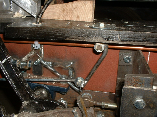

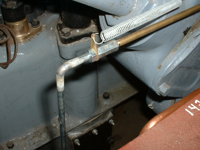

    yonahrr

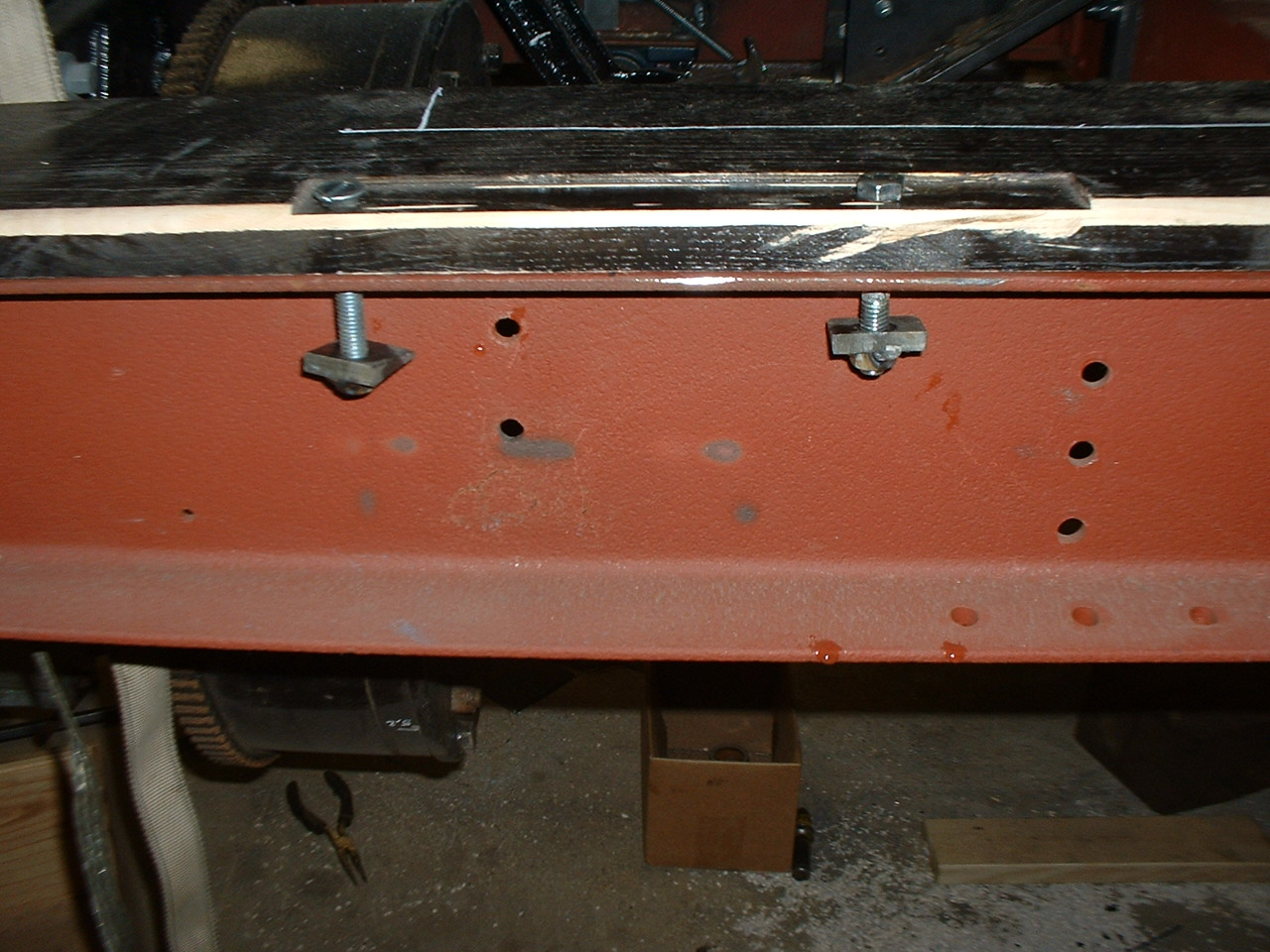

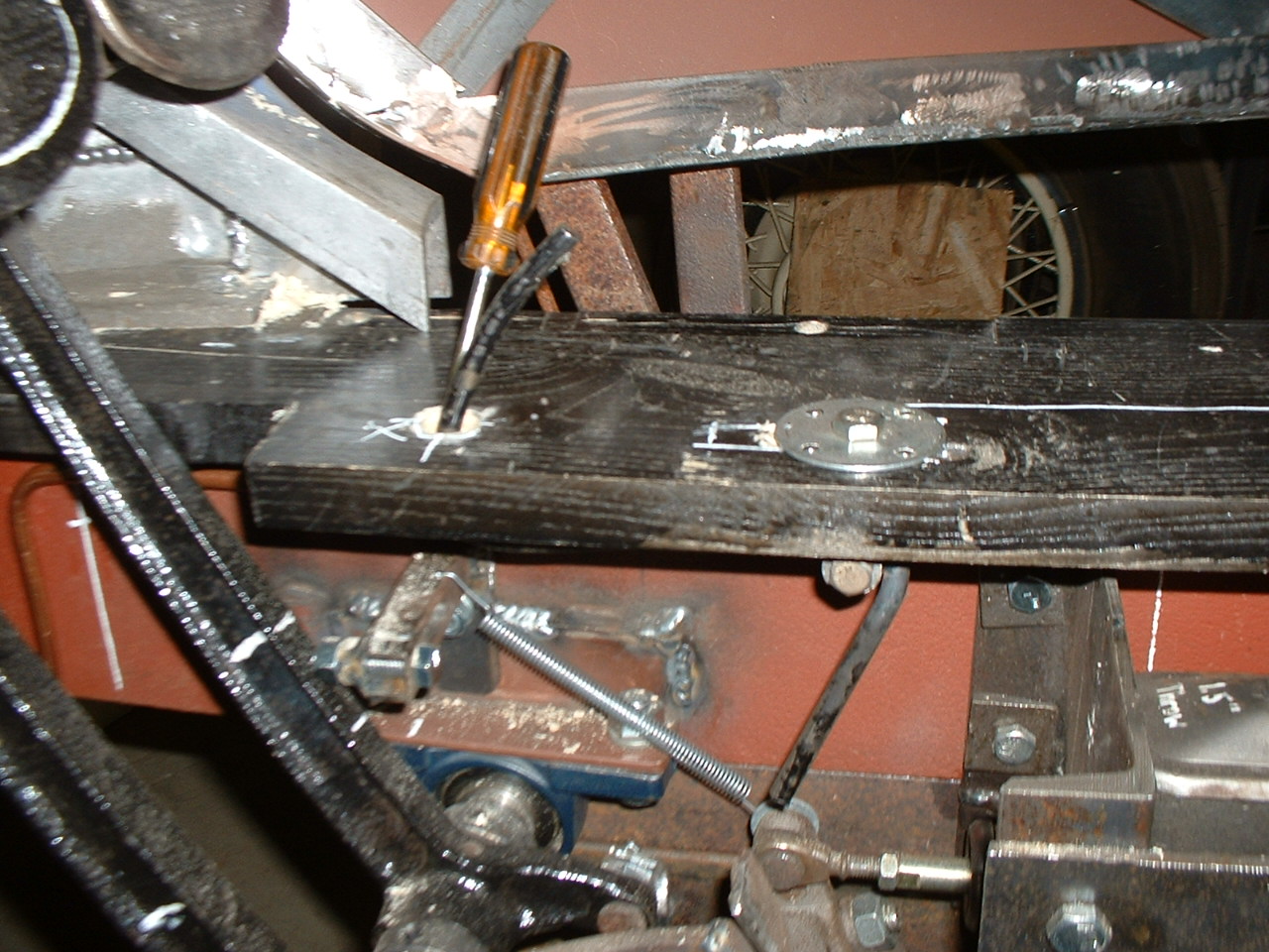

    Gas pedal and other things

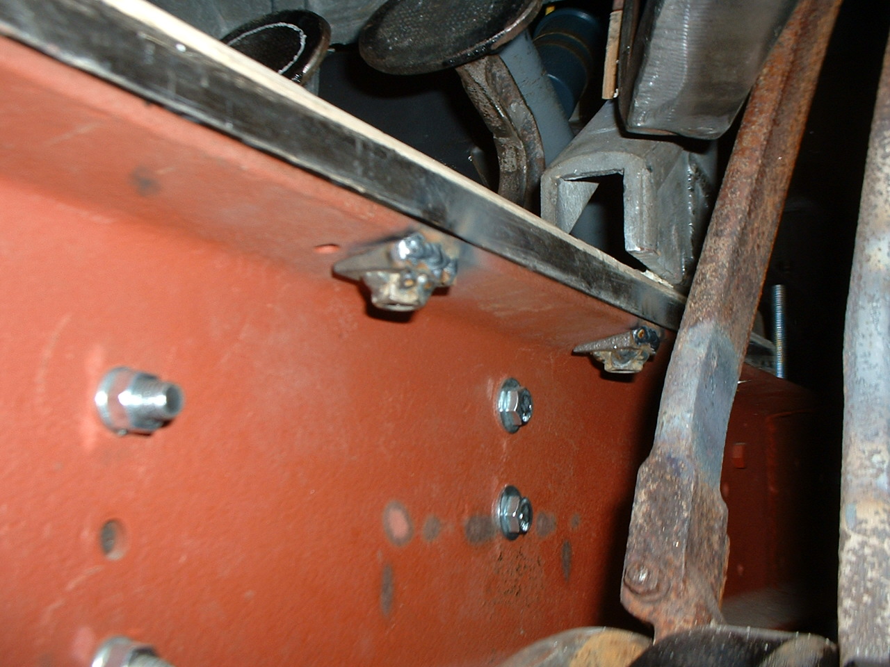

    Been hard to find time to work on the old Seagrave but I managed to get in a couple of hours today. I made up some nut things and welded them to the ch***is. These will allow me to bolt down the cowl with the splash aprons in place. I worked on the gas pedal by bending some 3/8 rod into an S. I added a pivot in the middle and attached it to a mount. I should have taken more pictures but time was precious and I didn't want to stop. Now I need a fancy br*** ****on to screw onto the end and a nice plate to tidy up the hole. Later! Got to get this beast on the road!
    Jerry

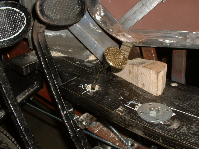

    yonahrr

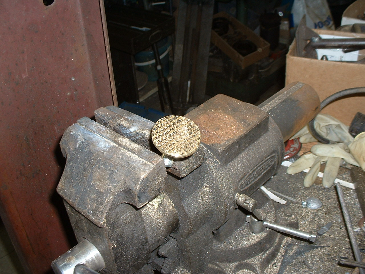

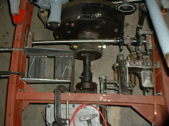

    Gas Pedal
    Last November I sold a 1914 Buick on ebay so I could pay my property taxes. The buyer was in Australia and finally, today, when it was raining cats and dogs, the transport arrived to pick it up. So that took until 11:00 and then I had to fix a tenant's leaky roof, then bring another tenant a table for their grand opening. Anyway, I snuck away to the shop for about an hour. I worked feverishly on a pad for my gas pedal. Made it out of a nice chunk of br***. Filed an interesting crosshatch on it, then ground it into a pleasant circle. All I had left to do was braze on a nut to screw it to the shaft. Well, I was day dreaming or something and got the damned thing too hot. Plop. The whole side melted away. I cussed. Tomorrow, I'm hiding in the shop with the door locked. Don't try to call me. Oh yeah, the guy standing next to the Buick asked me where his regiment got off too. I shrugged and he dissolved into a vapor.
    Jerry

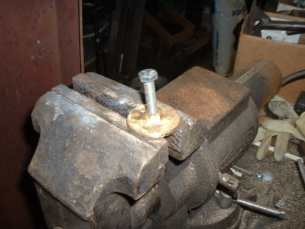

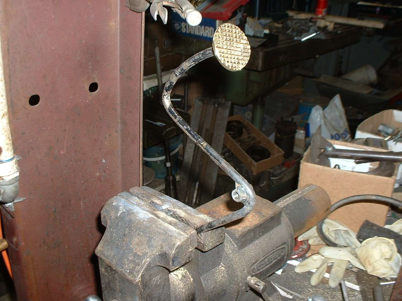

    yonahrr

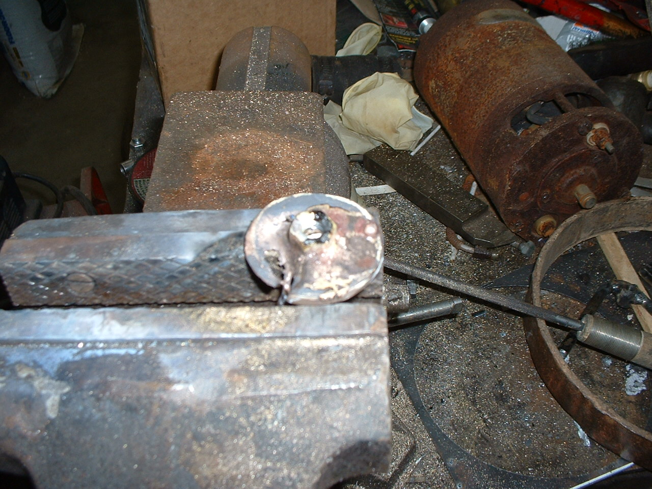

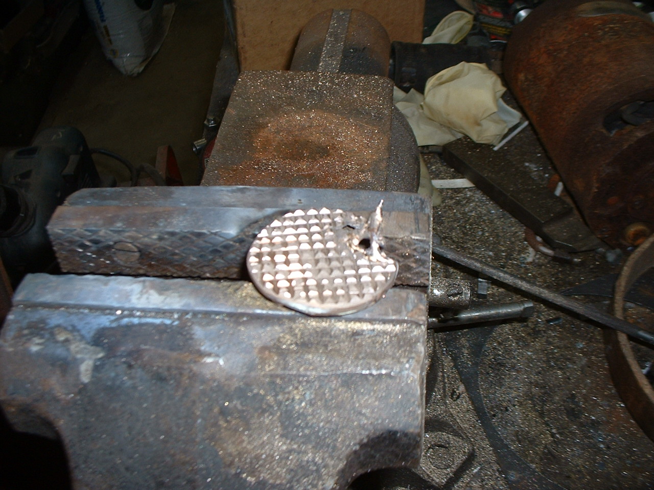

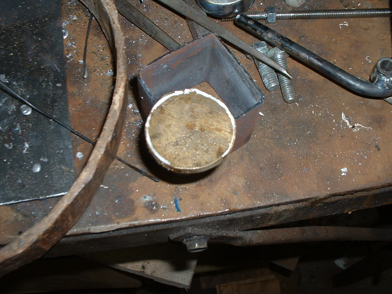

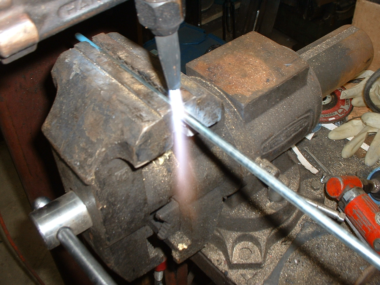

    Gas Pedal

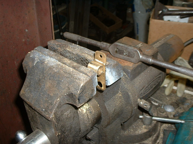

    I got in a pretty good day. Worked on the gas pedal again. I cut a new disc but this time I brazed on the attachment nut before I began the cross hatching. I cut the grooves with a little saw blade attached to the die grinder then finished up with a triangular file. It's not perfect but looks okay. The linkage was next. A 1/4" rod from the hardware store bent here and there and drilled for a cotter pin became the major part of the connection. For ease of dis-***embly I threaded the end and screwed on a br*** rod I had laying around. The thing was a little floppy so I added a guide and a spring holder. The last piece was an adjustable barrel connection at the carburetor. Amazingly, it works well. The pedal is tight near the brake pedal but it's manageable. Who knows? I might bend the brake and clutch pedal slightly. Everything is a compromise.
    Jerry
    <input id="gwProxy" type="hidden"><!--Session data--><input onclick="jsCall();" id="jsProxy" type="hidden"><input id="gwProxy" type="hidden"><!--Session data--><input onclick="jsCall();" id="jsProxy" type="hidden">

    yonahrr

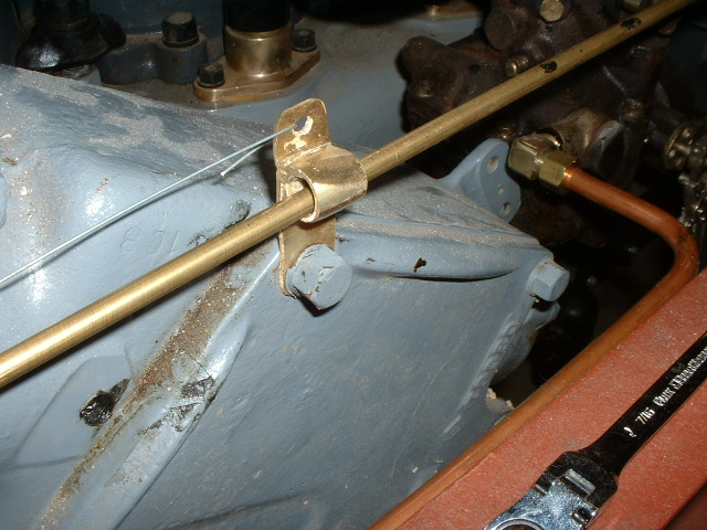

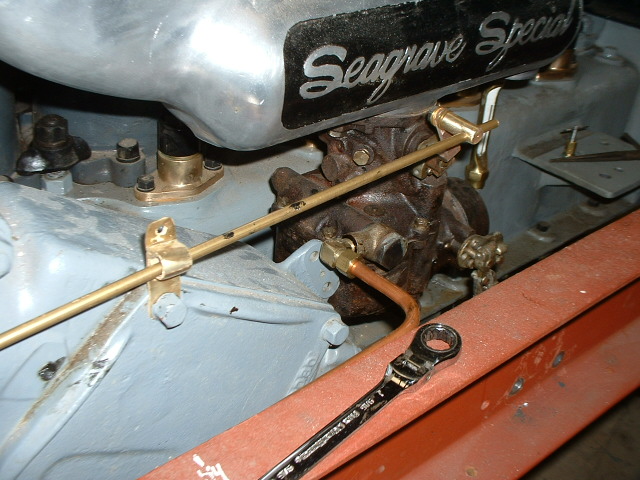

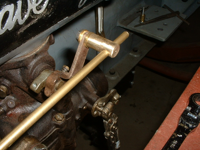

    I found the macro function on my camera. Maybe now my closeups won't be so blurry. Here's some more pictures.
    Jerry

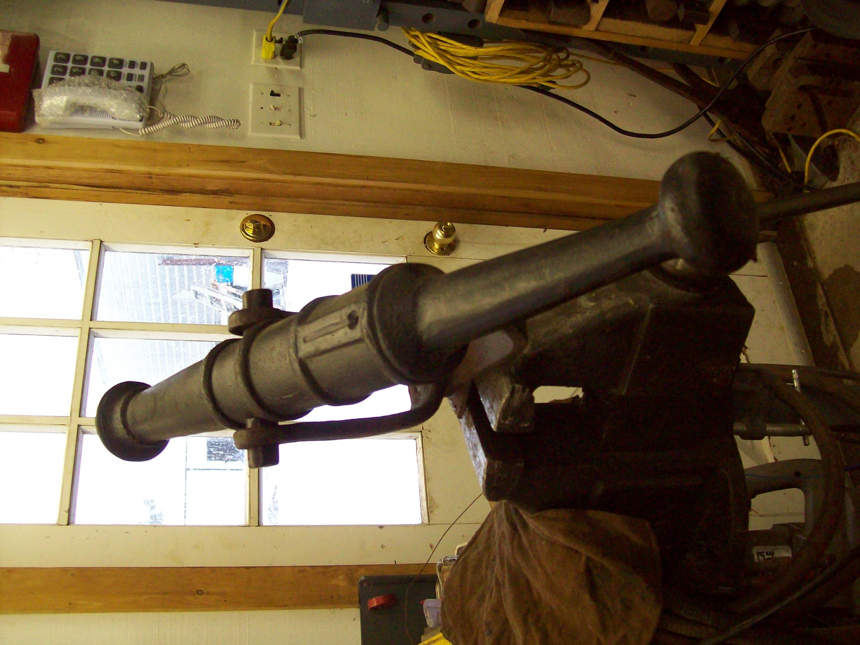

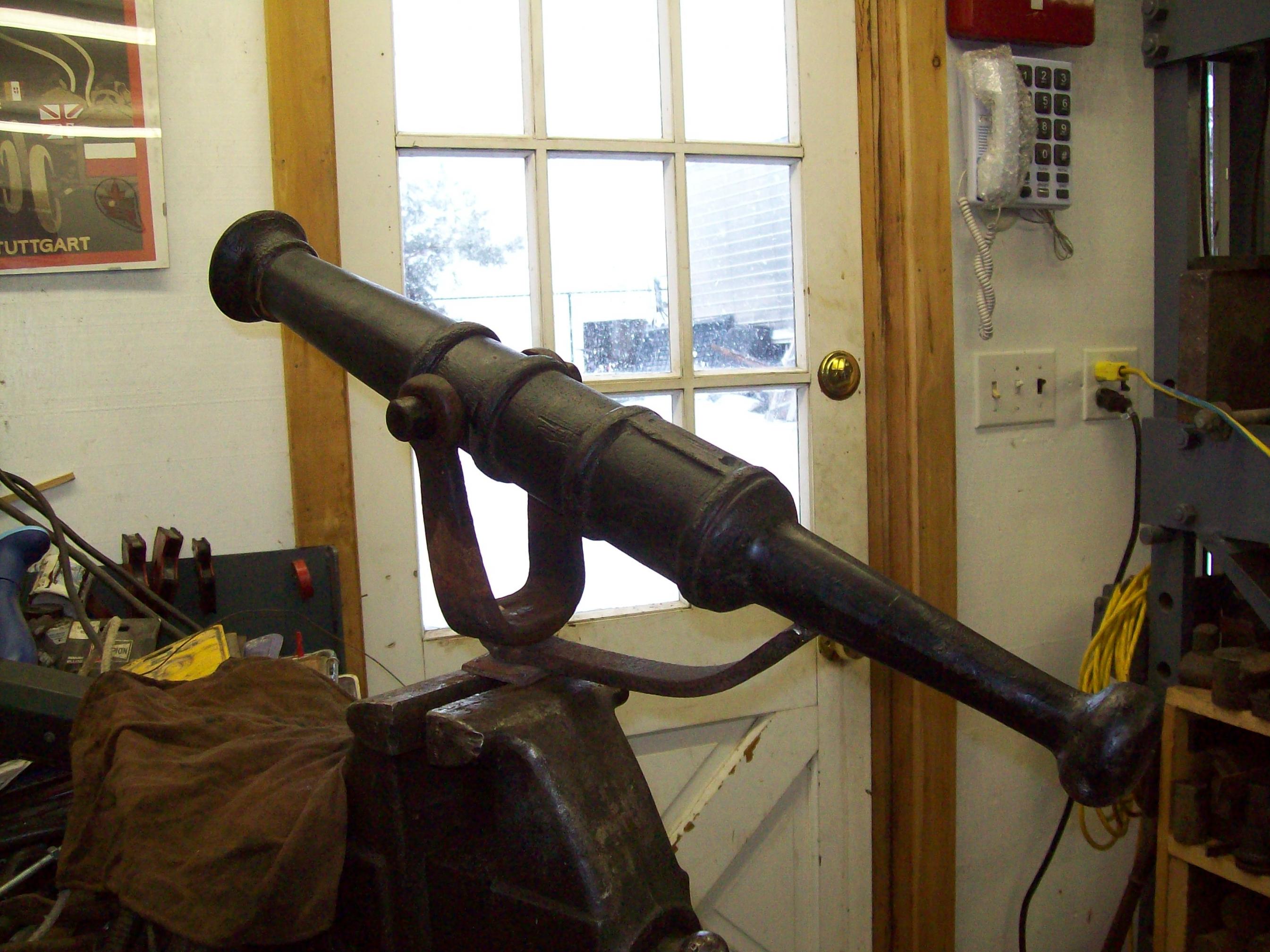

    To revisit accessories for a minute, you may need this to go with the fellow in uniform! It could be interchangeable with the almost necessary running board mounted spot light.
    Jack
    ( Yes it works!!)

    I love it! Or maybe a har**** gun. I've been looking on ebay for two identical period spot lights to use as cowl lights. *** spots look about right.

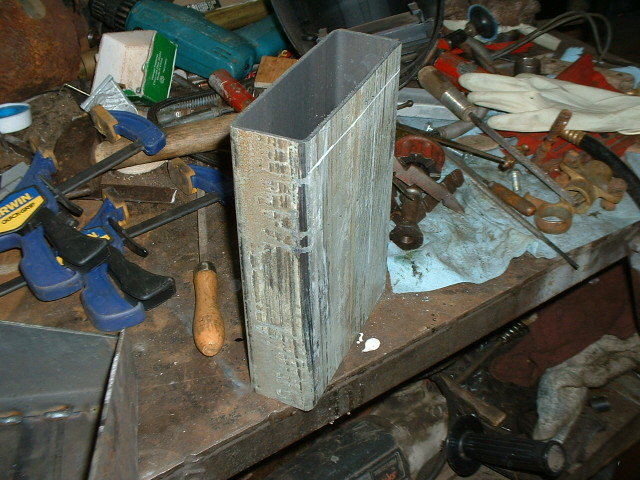

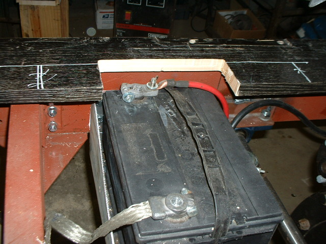

    Battery box
    Everyone wanted an outside box for the battery but in the interest of expediency I decided to put the battery under the front floorboards. The car will still have outside boxes but the battery won't be in one. I got one of those diesel truck batteries, they're about the right size and amperage. Since I didn't have any 1/8 plate I cut the pieces out of some 2X6 tubing I had lying around. The box had to fit between the frame and the drive shaft. I forgot my camera so there's no pictures of the actual construction. But I just cut the pieces out on the band saw then welded them up. I had to come back to town later so I snapped some pictures. The box will bolt in. After I finish the box and a little wiring I'll only have the fuel line to finish--plus a few things I've probably forgotten.
    Jerry

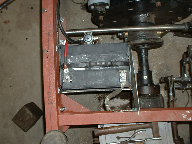

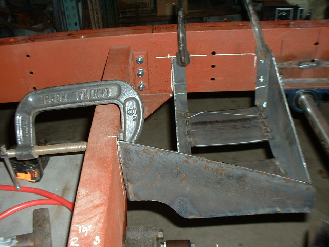

    Battery Box
    I tidied up the welds on the battery box then welded two mounting screws for the solenoid, drilled holes in the frame and bolted it up. I made up some wires and gave the starting system a test. All I lack now it the fuel line and re***embly. This is beginning to get exciting! A drive this coming week?
    Jerry

    how will the battry be held down in the box?
    is there clearance where your positive cable goes to the 'noid'
    possible chafe thru spot where it goes over the box edge?
    and your "noid" is in a debri slinging line off the drive shaft protect it accordingly

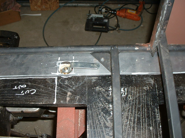

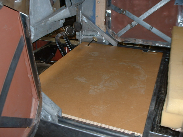

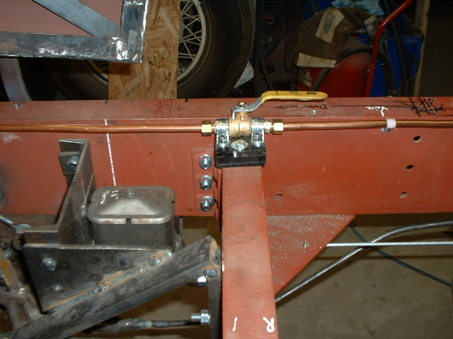

    Fuel line
    Hooking up the fuel line took a little longer than I thought because I wanted a shut off valve in the ****pit. That meant mounts and brackets and cutting holes. I'll replace the Chinese handle with something more appropriate. I also put the body back on but I'll have to take it off tomorrow because I forgot to make access in the wood body support for the battery and also the master cylinder. We're getting there!
    Jerry

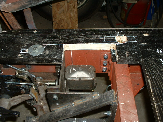

    Misc.
    I did a lot of little but important things today like cut out the access for the battery and master cylinder and gas valve. I also went to my buddy Kent's muffler shop and he bent me up a gas filler neck. After installing the filler neck I poured in some gas and made sure the fuel pump worked. I used a piece of sign board to make a floor board. Sign board is real useful for anything that requires plywood. It's covered on both sides with some sort of paper that is waterproof and takes paint well. The plywood itself is waterproof and very high quality. Lastly, I put the rear wheels back on and lowered the car onto the floor. What's next?
    Jerry
