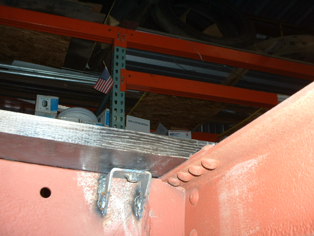

    Forgot

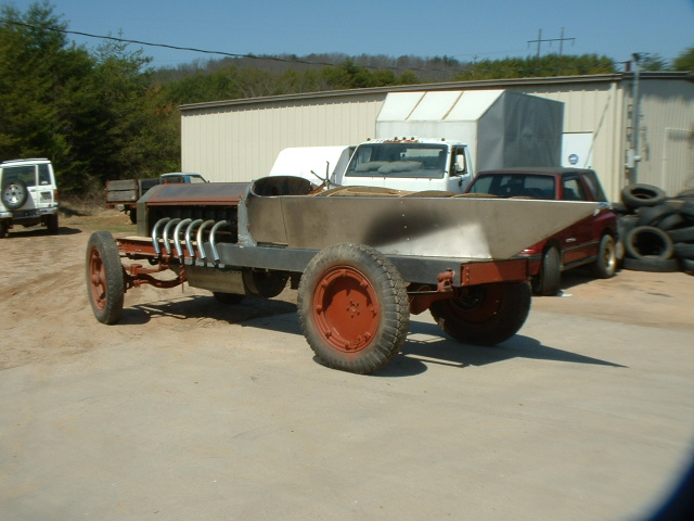

    I forgot to mention I added some body mounts to the frame. Not the prettiest weld but my knee was hurting and I didn't feel like crawling underneath and getting a shower of sparks.

    Yes, using a 1935 Ford flathead I had rebuilt 30 years ago...also have a used V6 that was original to the car, but flathead was easier to throw in and I'm more familiar with it.[​IMG]

    That flathead is way cool. Is your build a personal quest? Are you thinking of promotional possibilities? Seems like the car would be in big demand at shows etc. Could be a good little money maker?

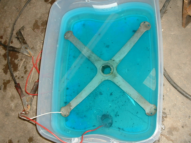

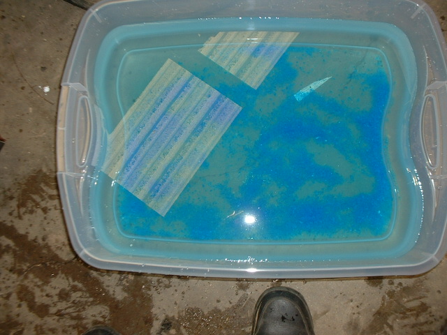

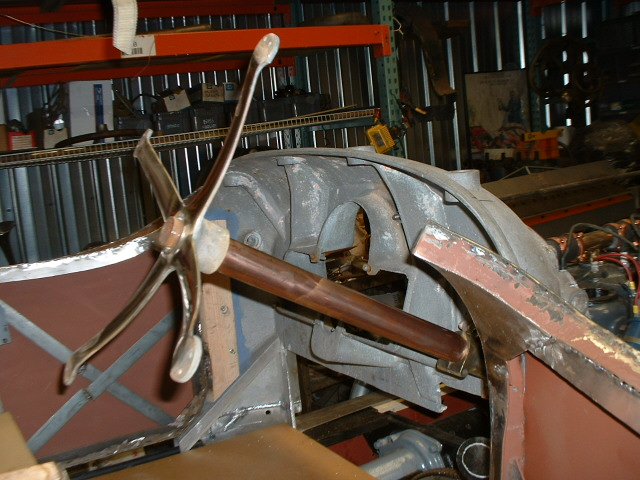

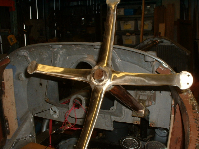

    I guess I'll have to steer the beast on the test drive, but because I didn't want to put a nasty old wheel on, I whipped up some of my home brew de-nickel plating solution. AKA root killer and pool acid. That's copper sulfate and hydrochloric acid to you chemists. Add 6 volts and the nickel flies off. I tried to de-chrome the gas cap but it didn't work so well. Any suggestions? I also made up some custom keys to fit the steering shaft and used a copper pipe to replace the br*** pipe I cut off way back during the dis-***embly. The wooden wheel will come in the future, after I order a finger joint bit for the router.
    Jerry

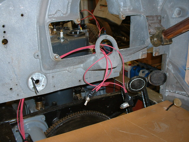

    I also scabbed together a temporary ignition and starter switch. Nice, huh?

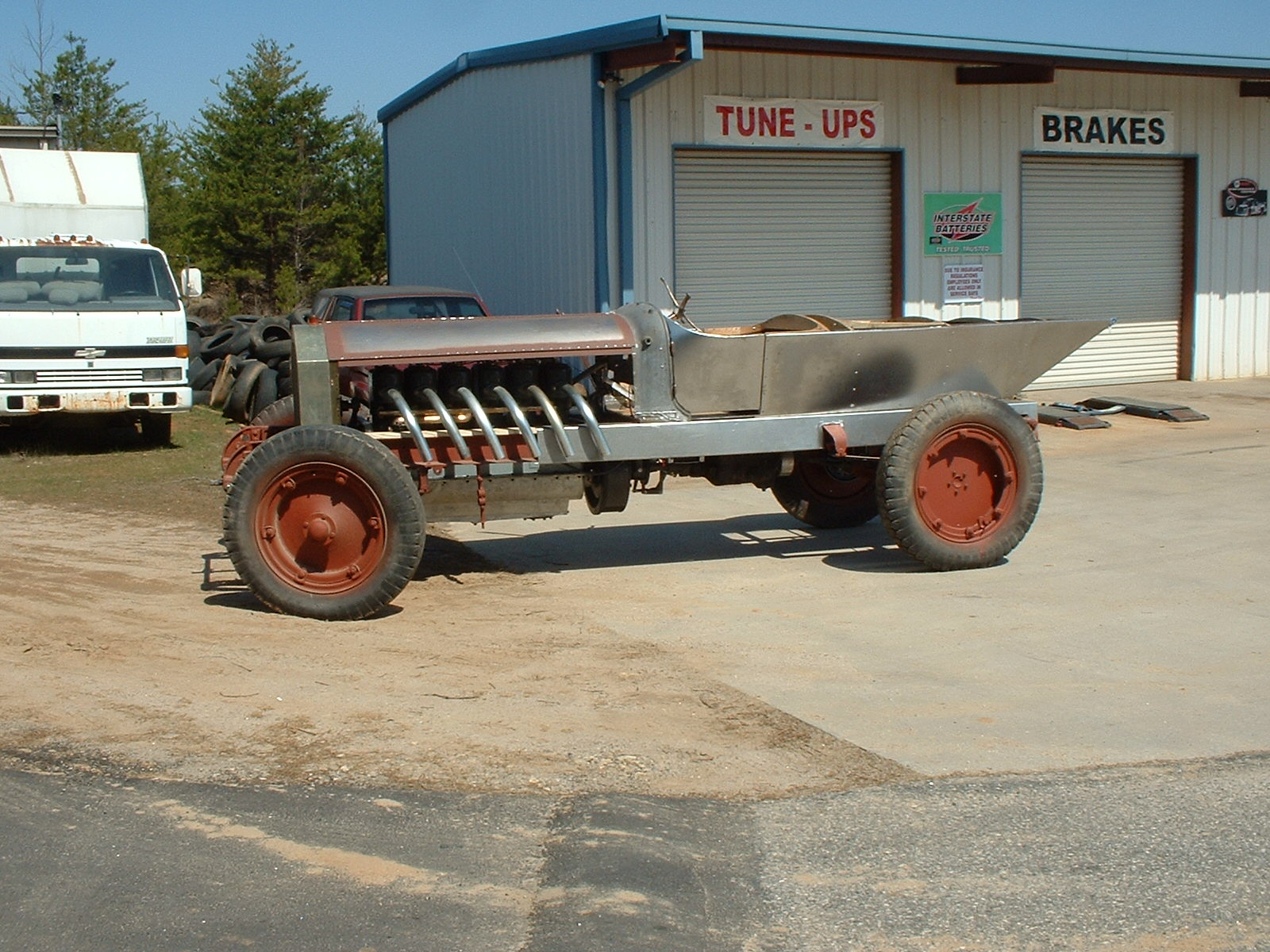

  10. yonahrr
    Joined: Feb 27, 2010
    Posts: 1,348
    yonahrr

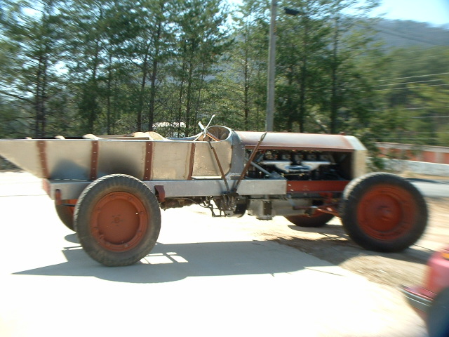

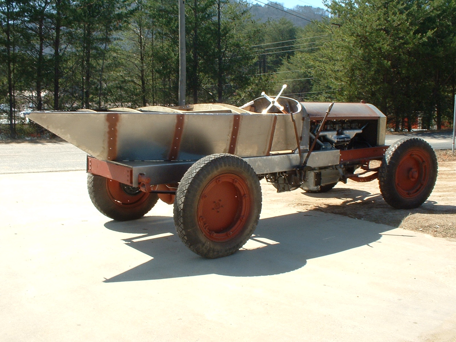

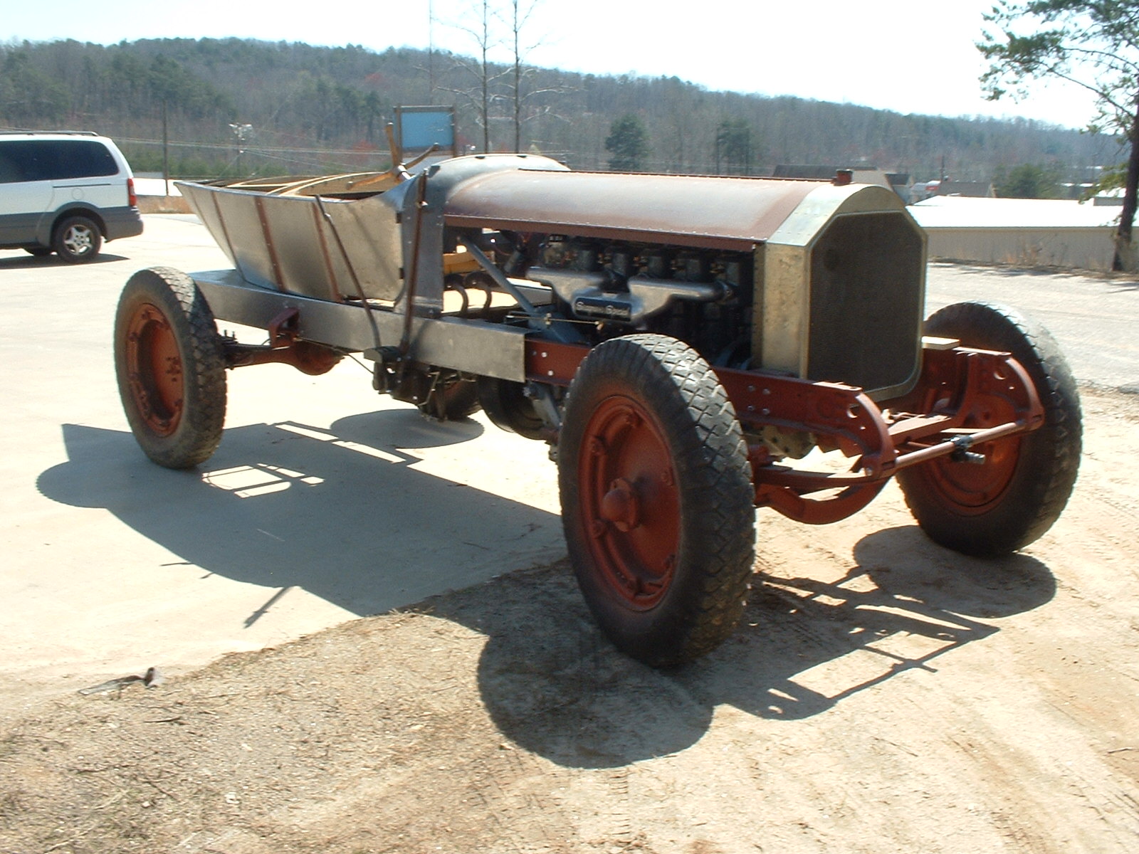

    First Drive
    http://www.youtube.com/watch?v=TaM2iVzFmEo Yes, it finally happened. It took all morning just to get the Seagrave out of the corner of the shop and out in front of the door. Right off the bat I noticed is that I have to adjust the clutch. The second thing is that the brakes ****. I may need a booster or I may need bigger wheel cylinders or I may need front discs. When I got back inside I took off the wheels and saw that the shoes were only touching at the top and the bottom so the first thing is to turn the drums. (Yes, I know I should have done that but...) Everything else seemed to work well, the shifter and trans, etc. So now it's back inside. Maybe someone could please photoshop me some colors.

  11. James D
    Joined: Feb 8, 2007
    Posts: 5,132
    James D
    Is that an original Chitty movie car? Or a replica? :eek:

    James D
    That is so impressive - and so BIG! I had no idea it was that size. Great achievment.

    yonahrr
    That's exactly what my wife said! Couldn't resist.

    captainjunk#2
    i bet you still got the goofy i drove it grin on , awesome project love the engine sound

    Jerry...that is IMPRESSIVE to say the very least! I love watching this thread and your progress, but it is also VERY dangerous for me...every time I do, it makes me want to build my 1914 American LaFrance 9-p***enger Touring car! I don't have the time or SPACE for something that big!
    Glad to see that the Seagrave is running and almost ready to tear up the countryside. What size diameter brakes are you running? Maybe some bigger truck rear brakes? ...With a car of that size and weight, defiantly need to be hydraulic.

    nitrobrother
    Congrats on getting it up and on its feet! Man that thing is loud! :)

    Oh man that is too cool. Love the sound. People will be looking in the sky for an airplane then you'll appear in your wonderful automobile. Colour wise I'd go a dark forest green body with an apple green for the wheels and pin striping(coach lines). :cool:

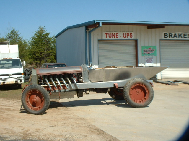

    Is it just me or what. 5 spark plug wires on one side and 4 on the other???
    Looks nice.

  22. ClayMart
    Joined: Oct 26, 2007
    Posts: 8,263
    ClayMart
    LOL! I missed that, good eye. :eek: But that image is made up from two seperate pictures and they aren't spliced together accurately. Look at the hose that's routed along the inner side of the LH head.

  26. ccbb
    Joined: Sep 14, 2007
    Posts: 75
    ccbb
    V9 flathead ...nope. opps, I stood on the frame and shot the whole ch***is, then spliced together. This was cropped section of just the engine, had some overlap in images.
