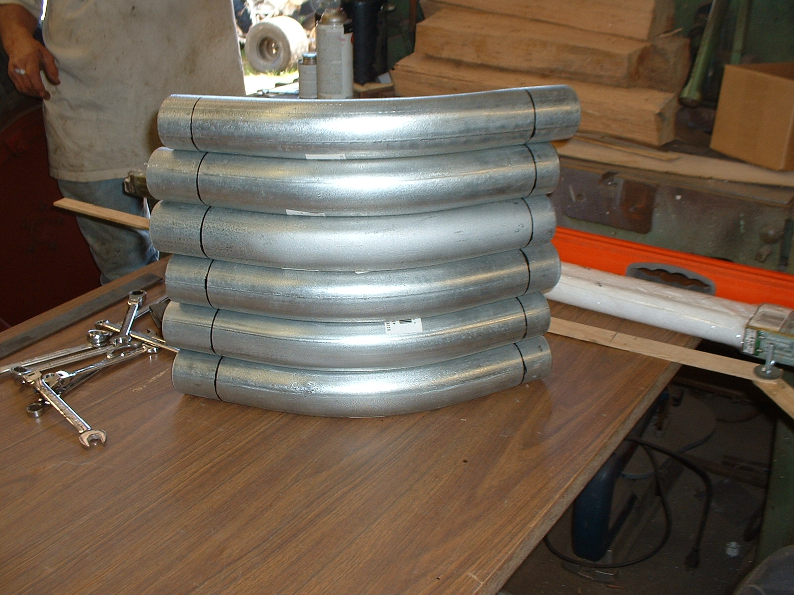

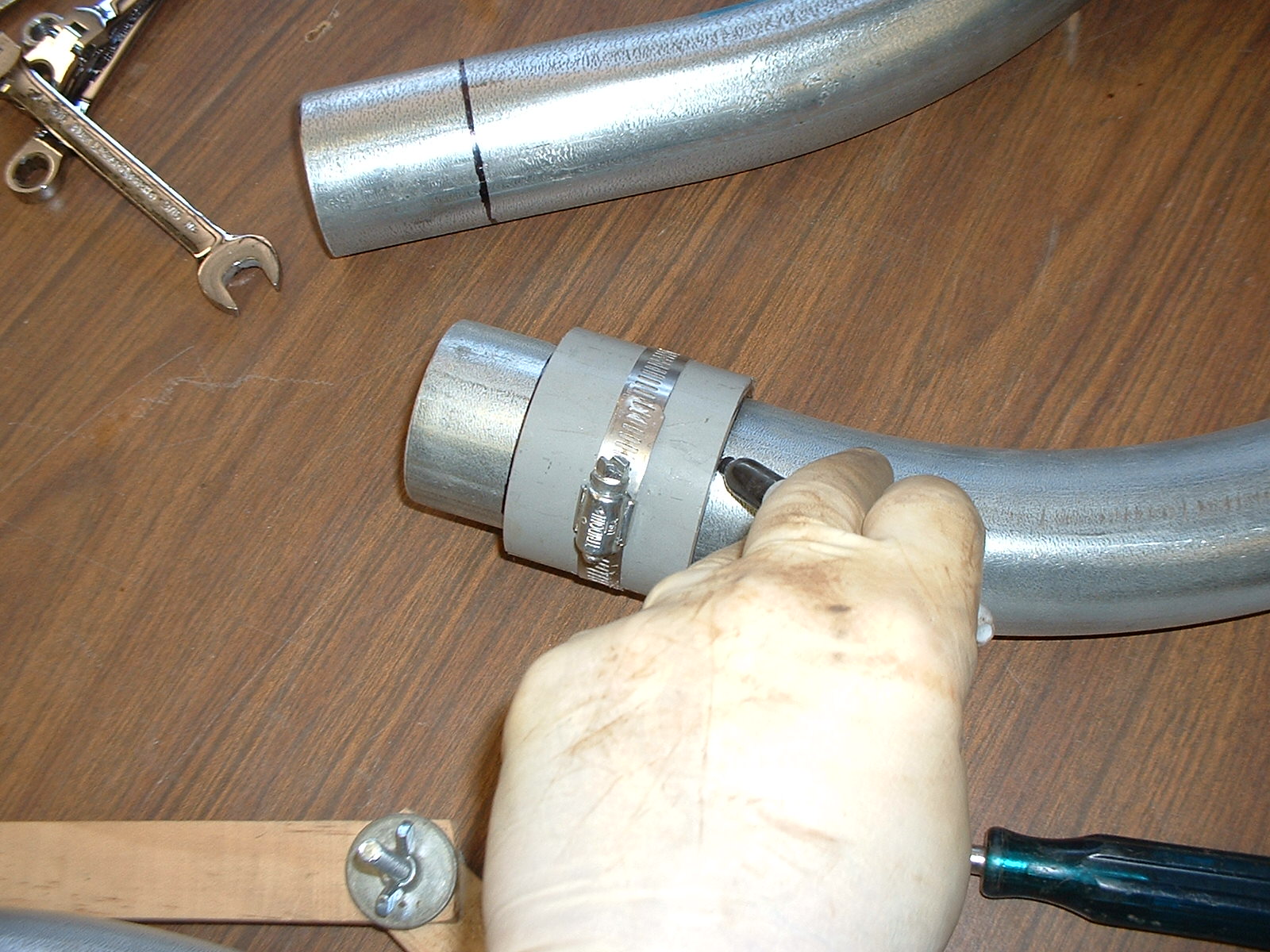

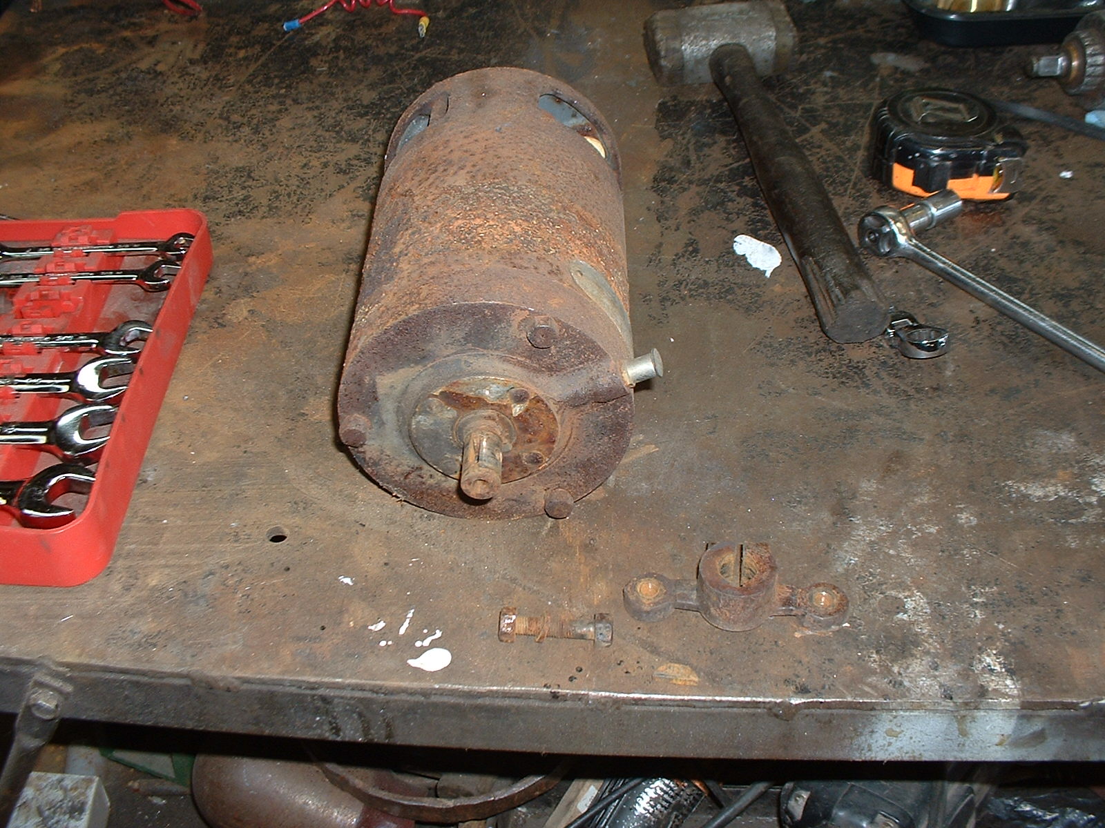

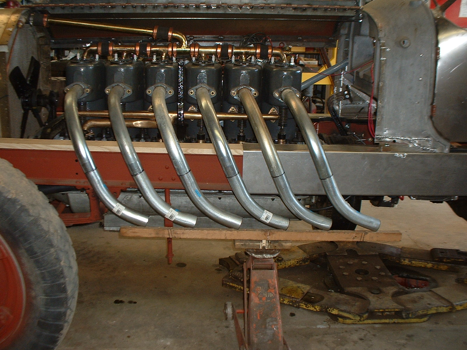

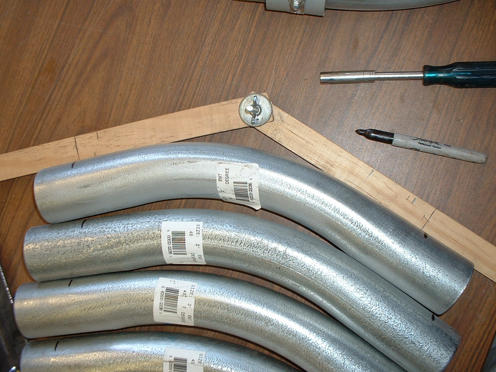

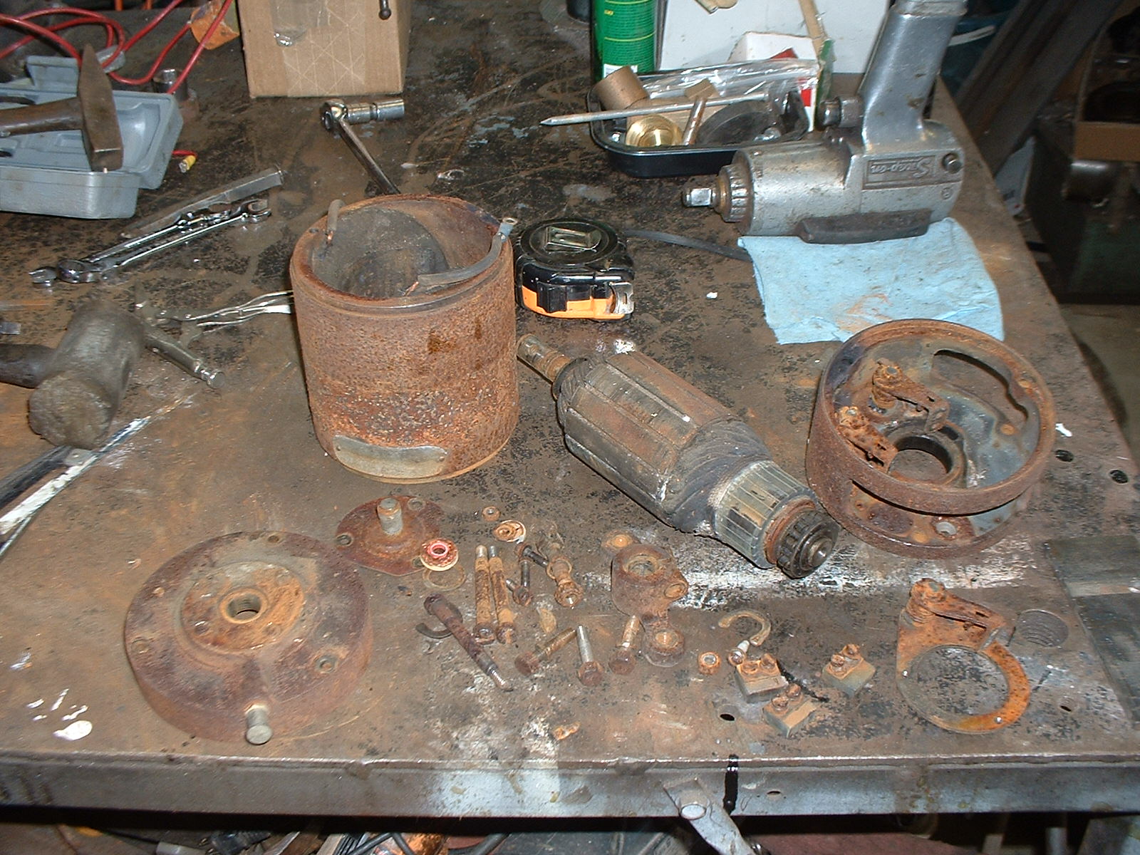

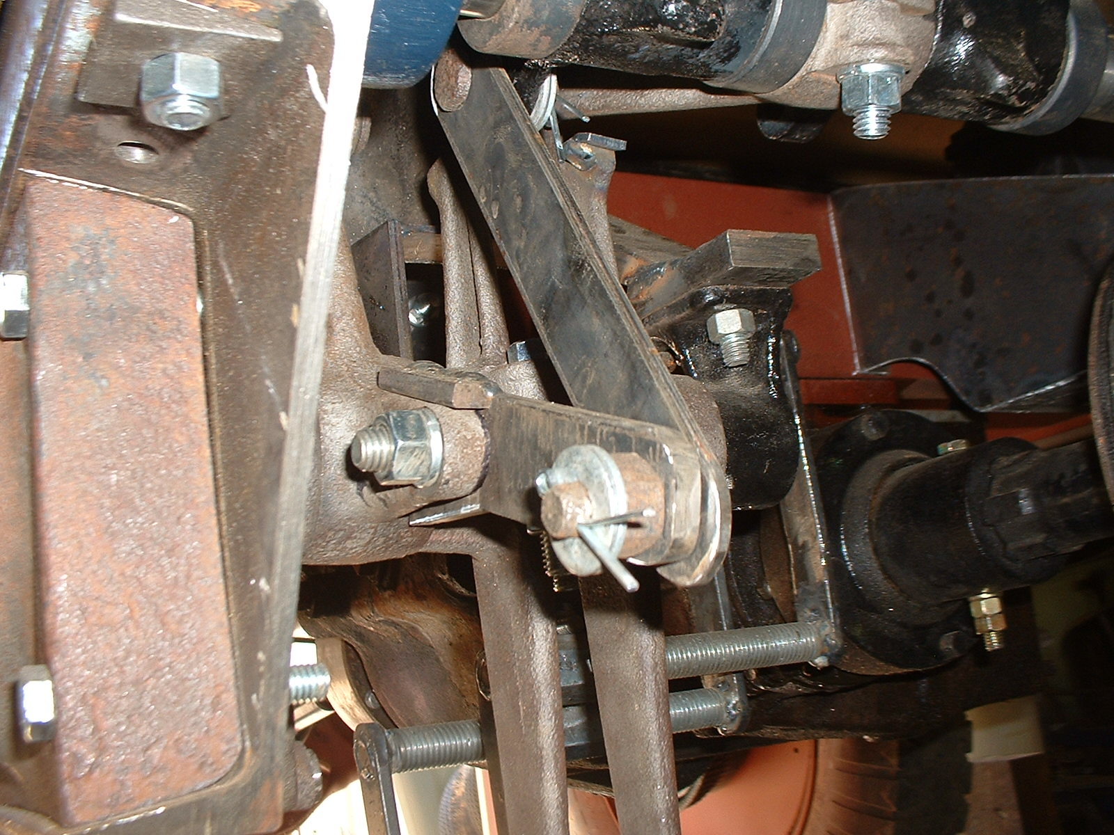

    Now that I have a battery I guess I'll need to keep it charged. From the outside the generator looked pretty bad. Inside looked worse. I'll leave it on the bench in pieces and look at it every now and then until I get inspired. On the big test drive the brakes were useless. I surmised the ratio on the pedal was too little so I lengthened on of the arms. The pedal feels better and when I depress it the rear wheel actually stops turning. Progress. The beast is loud, which is cool, but I can't hear all the little sounds I need to hear to make sure there are no engine problems. The first thing I did was standardize all the bends, then I gave them a fit check with exhaust pipes. Then I went home and saw that ridiculous garbage scow. Too much! :) I gotta pee again.

    Thought: For that larger pipe "Cord" look, they sell this flex pipe. Search Google images.
    May be best to put over standard pipes.

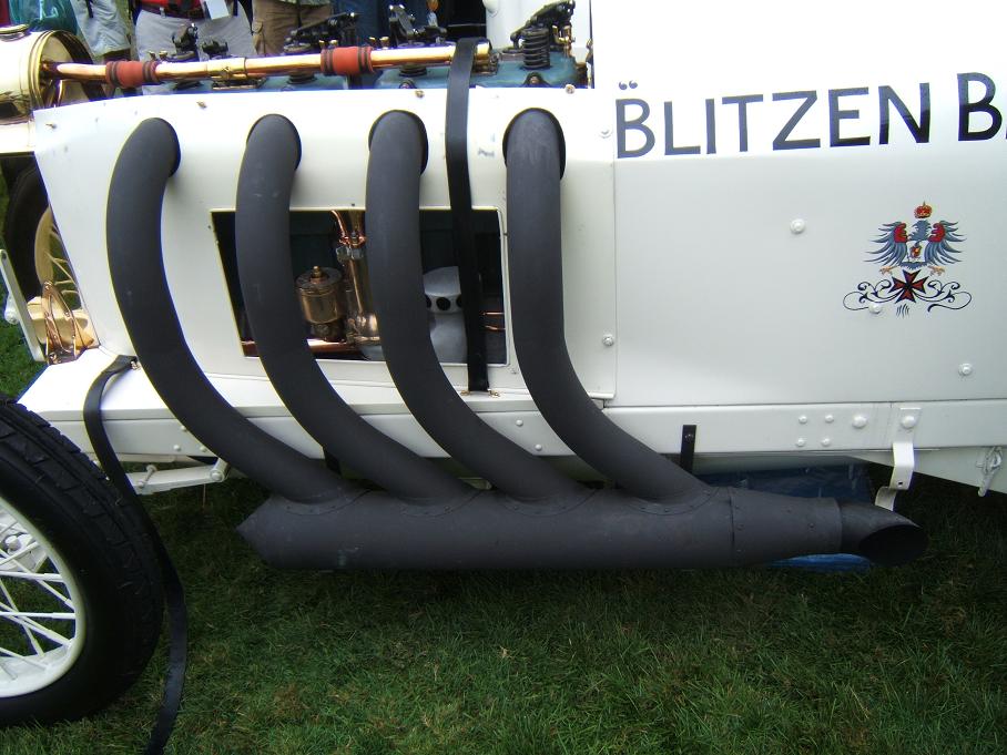

    The exhaust looks great...now all you need is to feed all six pipes into a four or five inch collector with a cone on the front end and run it out the back with a big fish tail. :D A nice long large diameter pipe should give a great sound.

    That's exactly what I had in mind. I really like the exhaust on the Hall-Scott Special but I don't think I have the room. The Blitzen Benz will will be good, but with a complete pipe to the rear.
