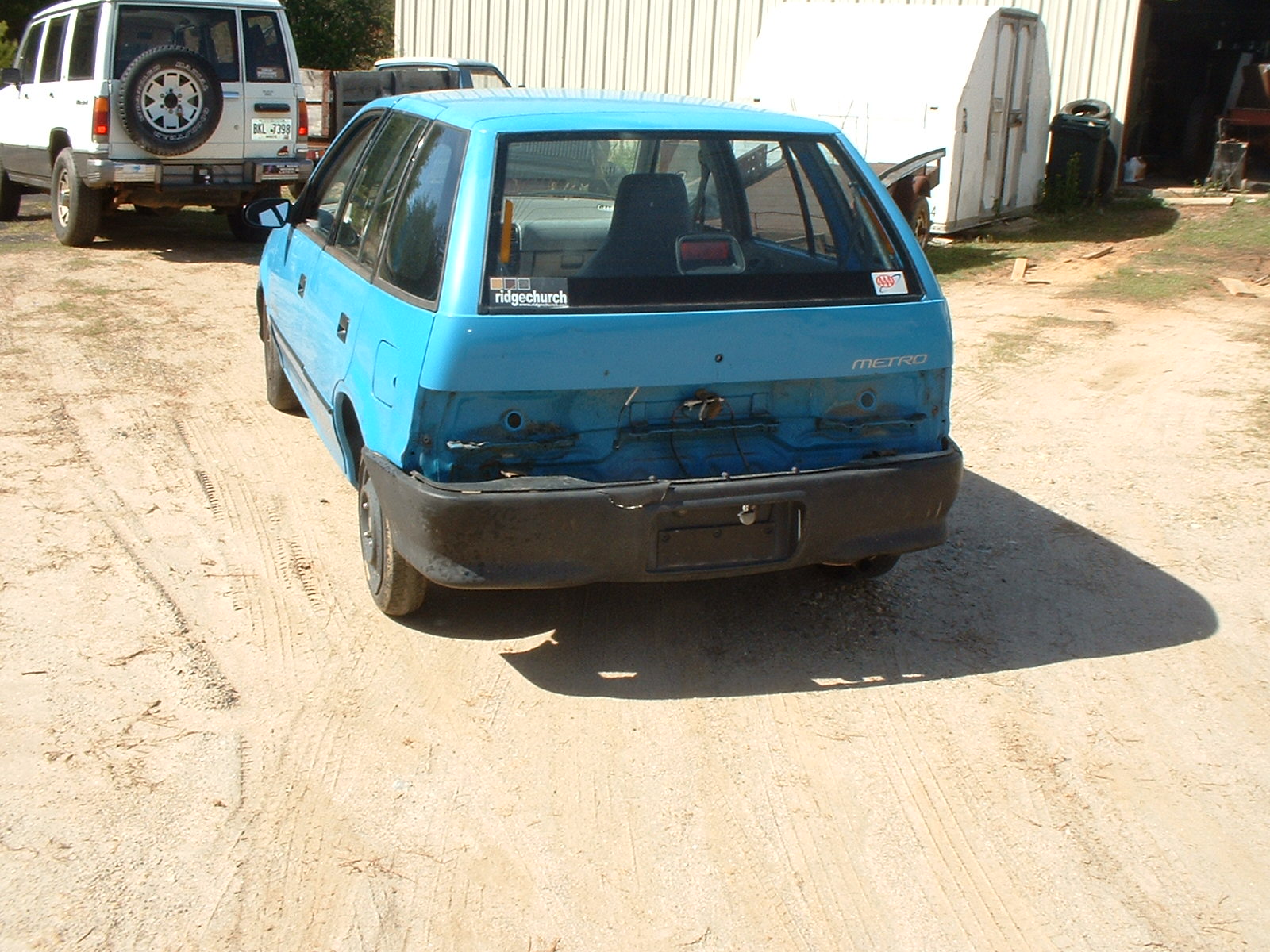

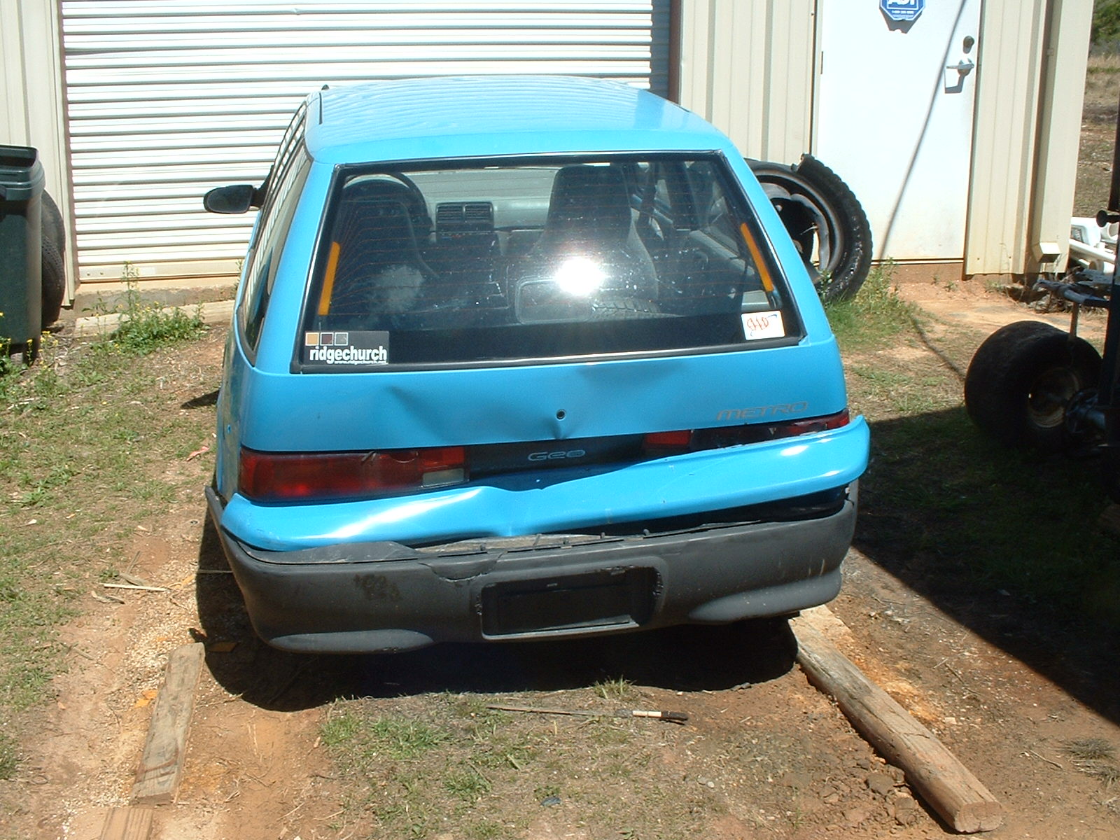

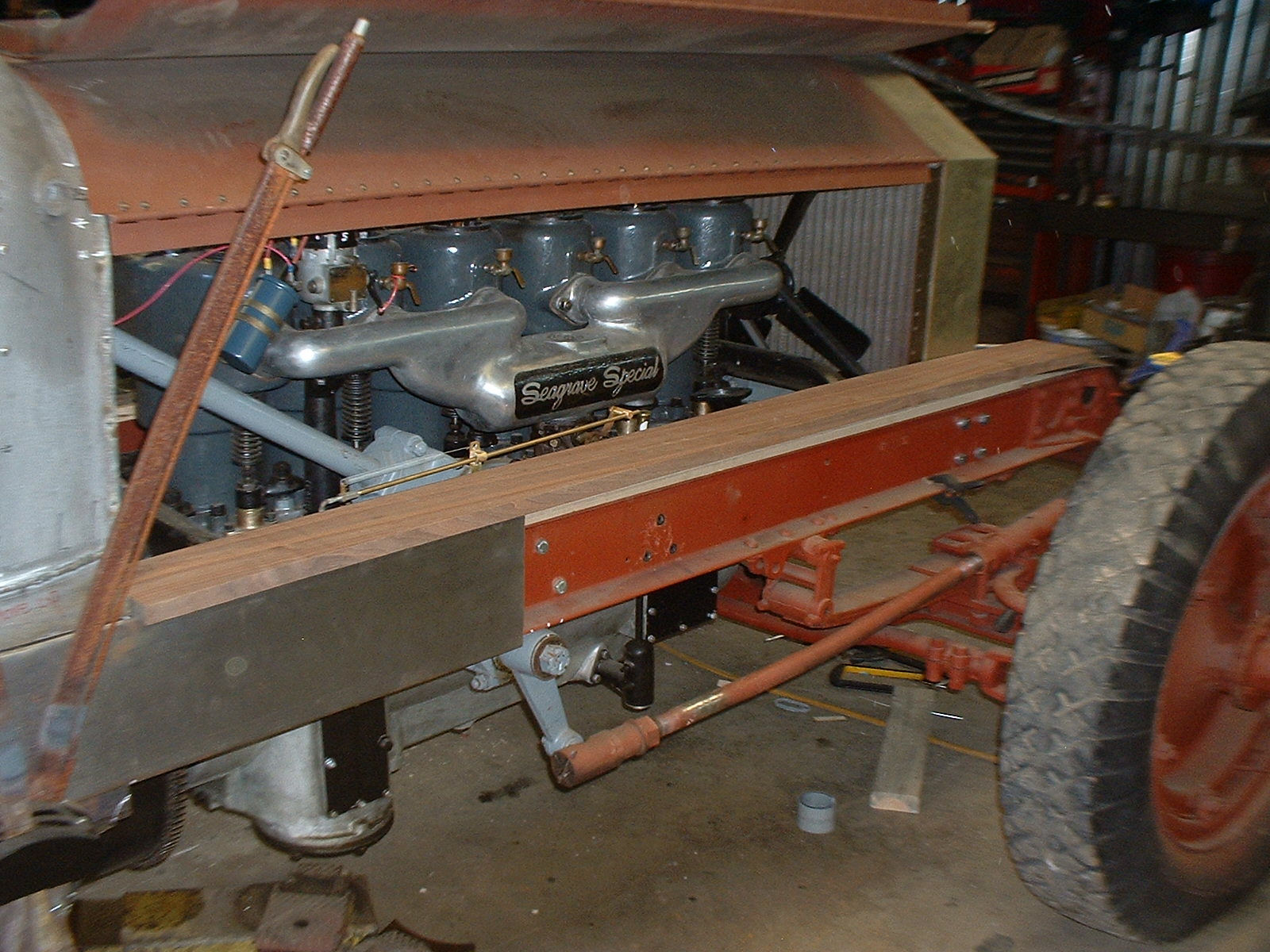

    Frame covers

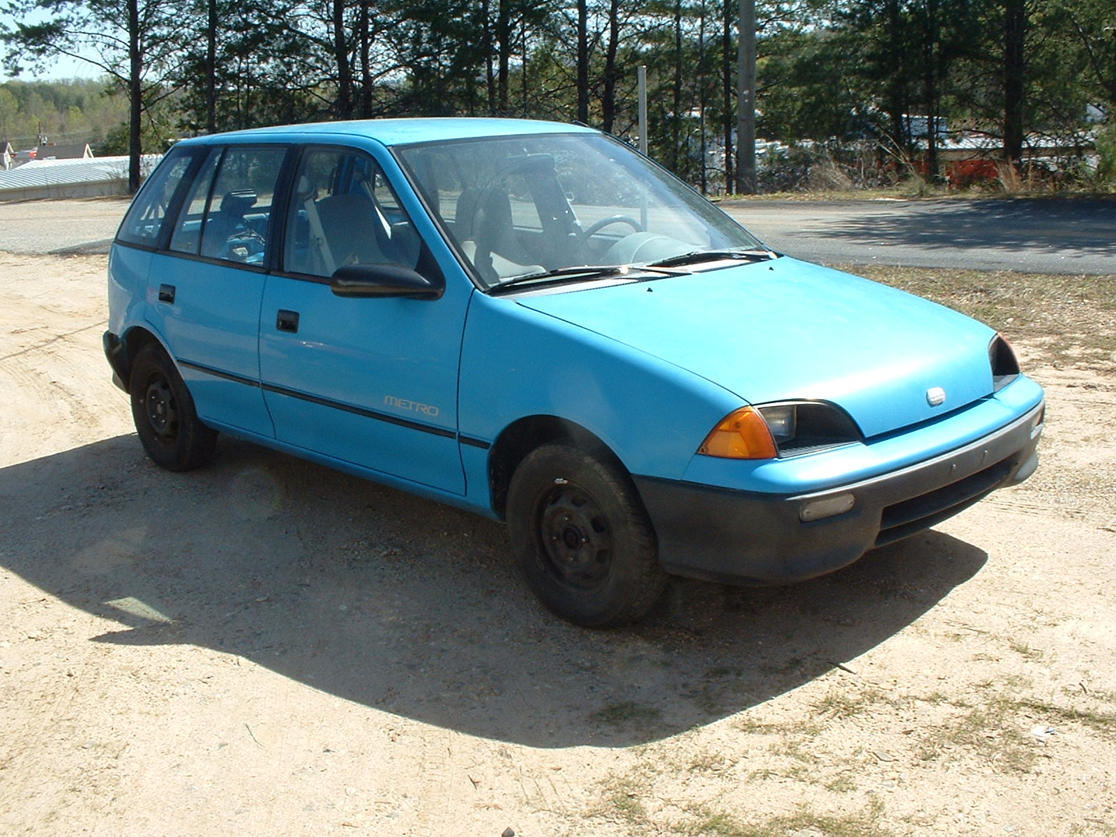

    I only got a little time to work on the Seagrave today, mainly on the frame covers--got one cut and tacked. The rest of the time I worked on my new (to me) GEO Metro--3 cylinder, 4 door, auto with air. I bought it wrecked and pounded out the rear hatch area all morning. So let's see, clicking axles, no reverse, ac won't work. I don't care, they tell me the damned things get 40+ MPG. My Trooper gets 18. I figure I can save $200 a month with this thing. We'll see.

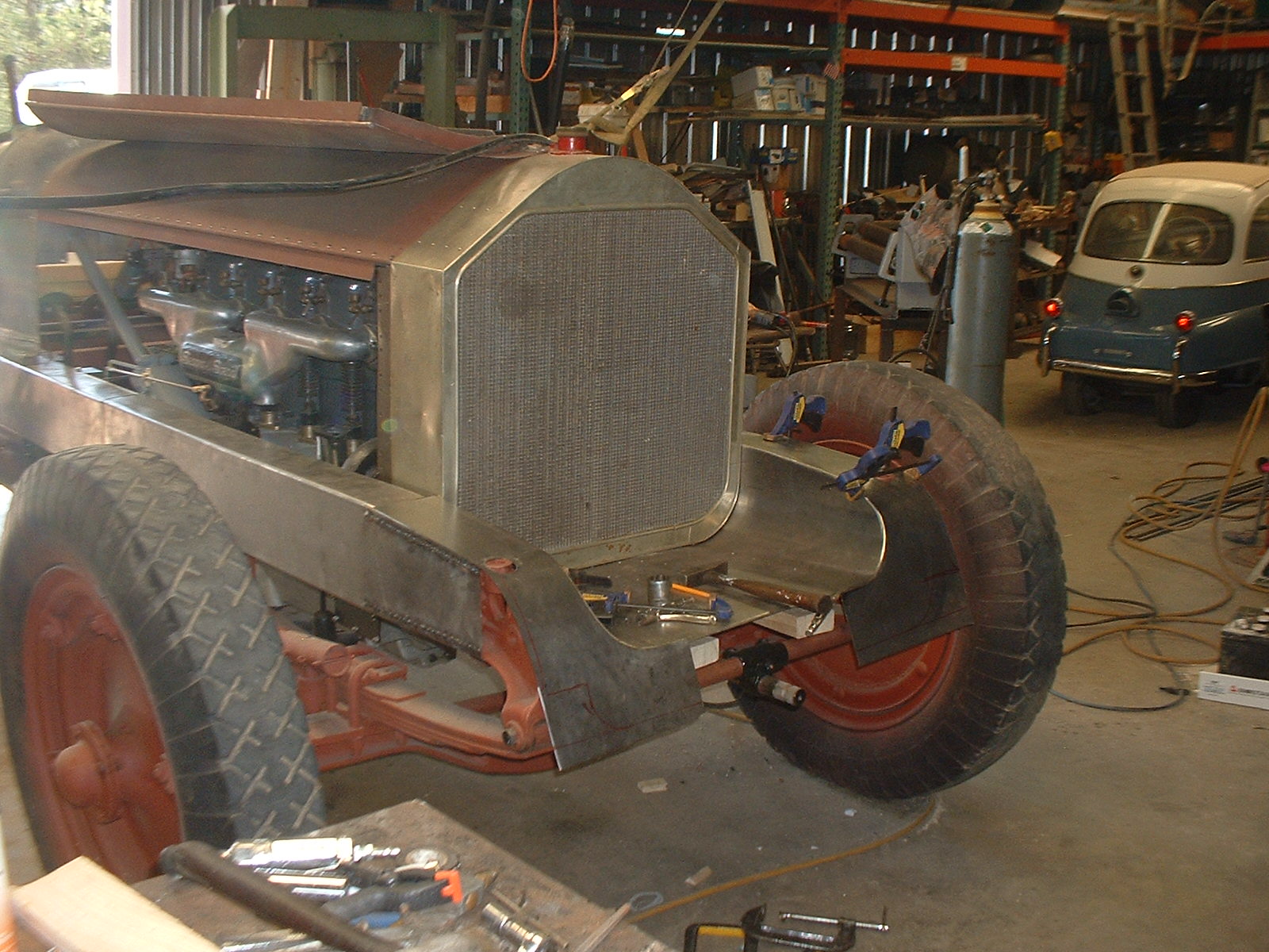

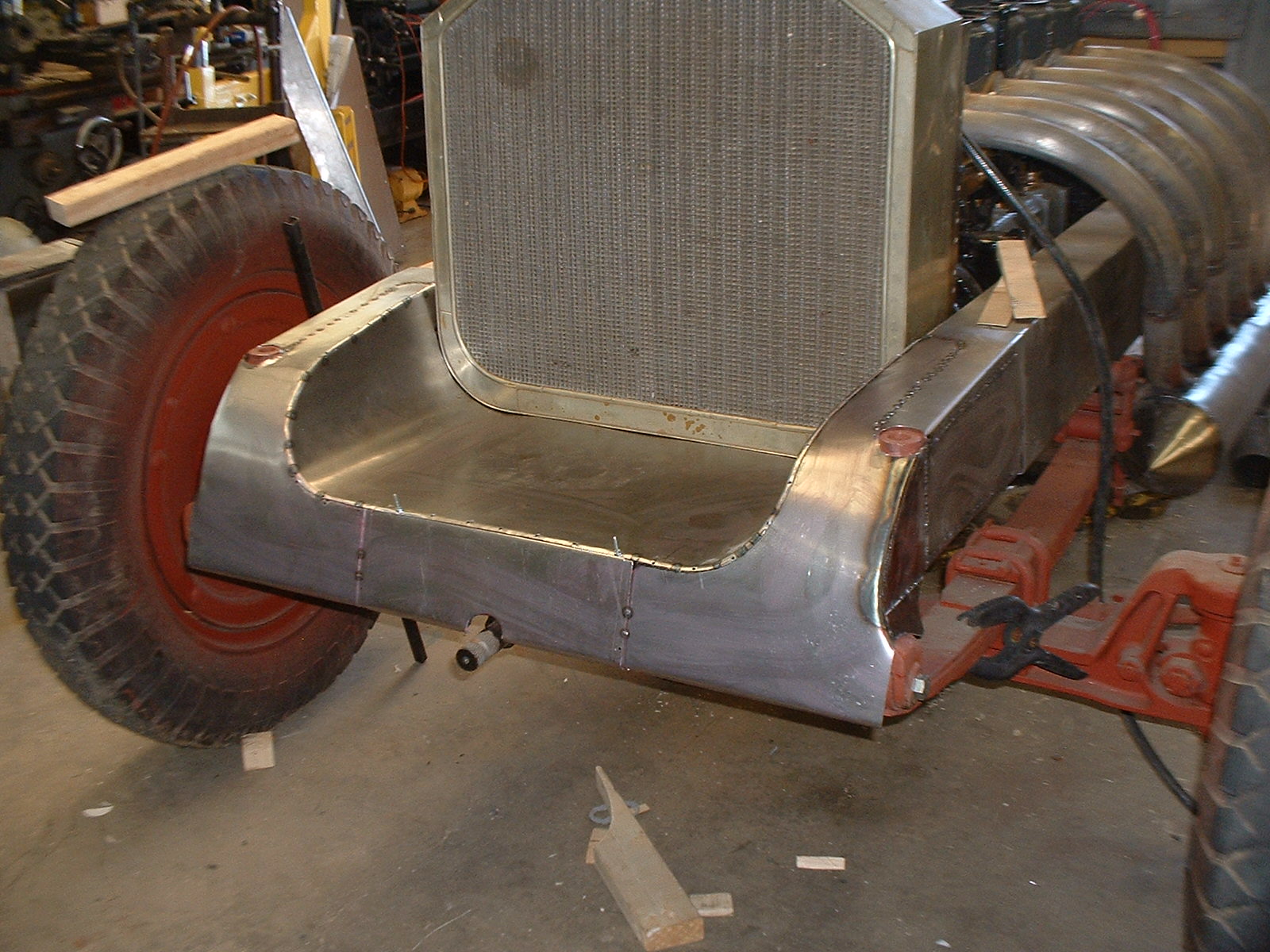

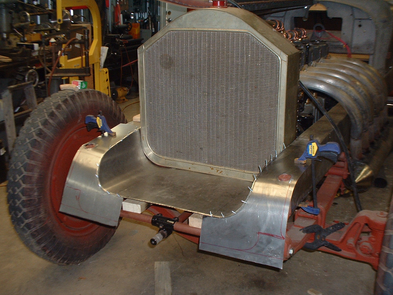

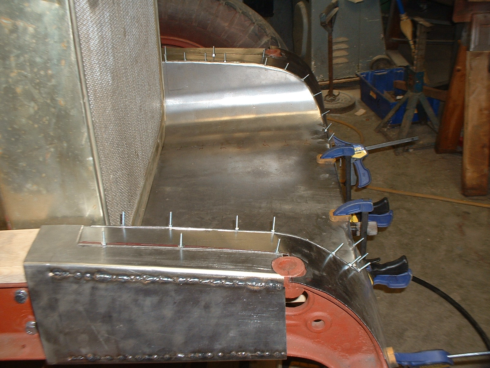

    Apron
    I cut and tacked the left side frame cover then started on the apron. I don't have any Clecos, so I use little screws instead. With screws you can draw the metal up tight before you weld it too. After I got everything tightened down I discovered a few fit problems so I never got to the welding stage.

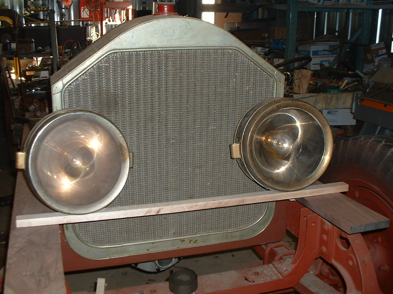

    Headlight selection is going to be fun. How about a big cyclops dead center with smaller 'driving' lights nestled down low in the curve of the apron? Hey, just a thought, you gotta do it your way.

    I like it, one headlight like the famed Sizaire Naudin. Actually, I bought some cool fork mounted "drum" lights. But I thought about mounting them on swivels that turn with the front wheels a la Tucker.

    Those are very nice. I think headlight selection and placement will be a very enjoyable part of the project.
  11. mount those headlites way out in front and low right in front of your new apron

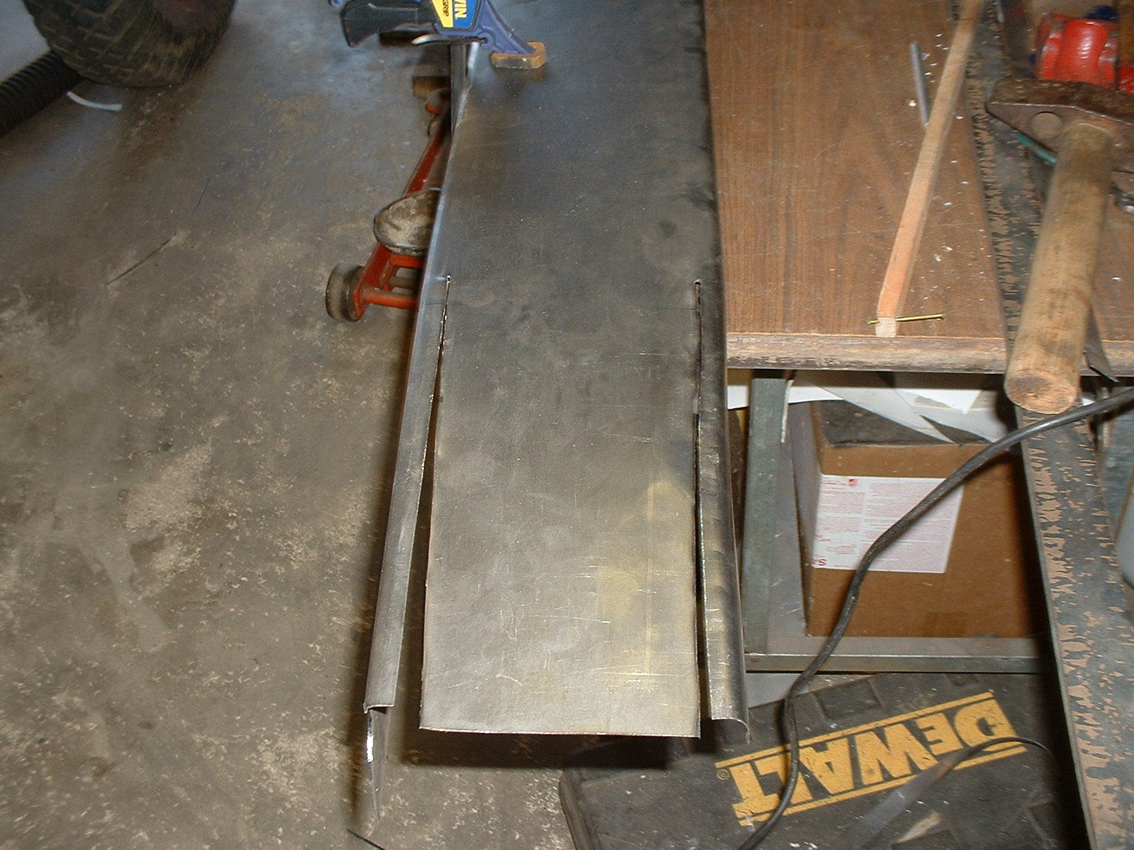

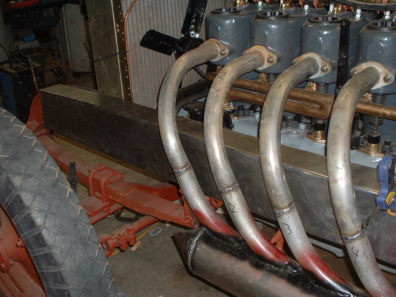

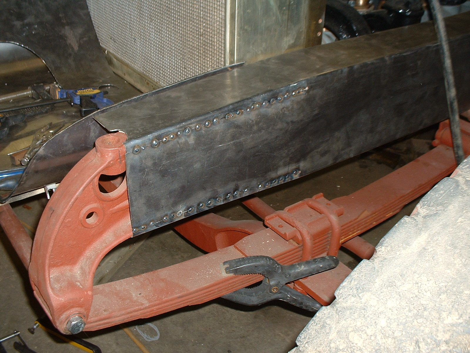

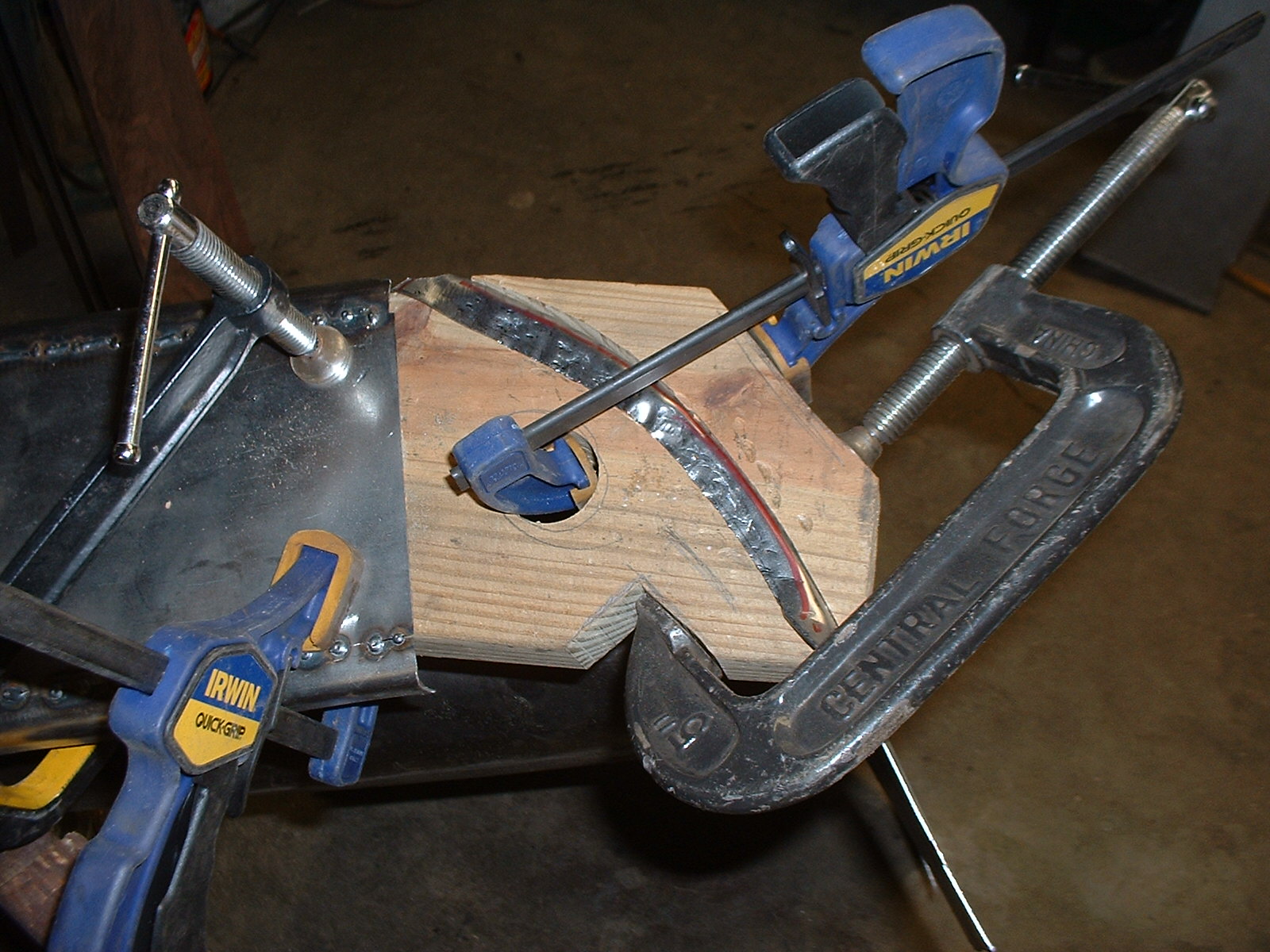

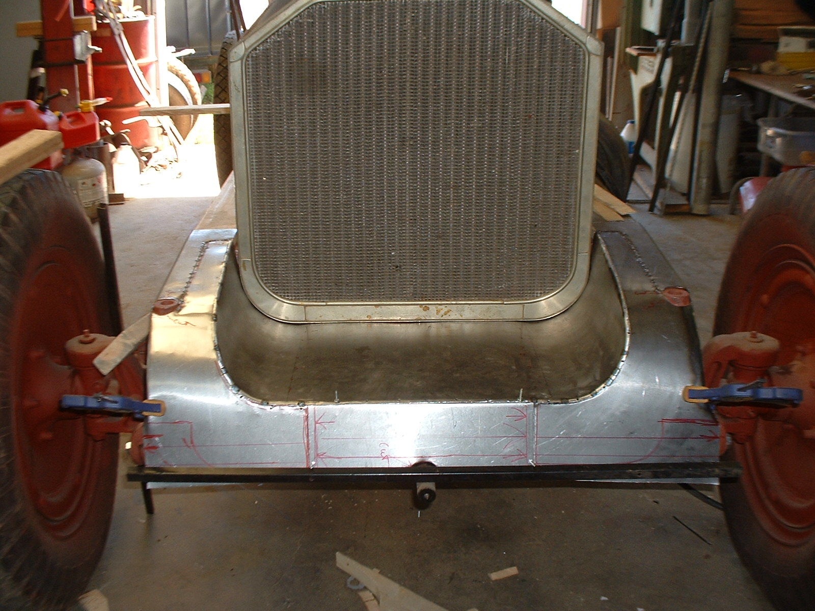

    More apron
    I'm starting to wish the apron was finished. Cutting, t*******, fitting, tacking... The trickiest part was making a wood form for the curve of the frame horn and pounding over the sheet metal. That's it, tomorrow my knee is CAT scanned so I'm not sure if I'll get anything done.

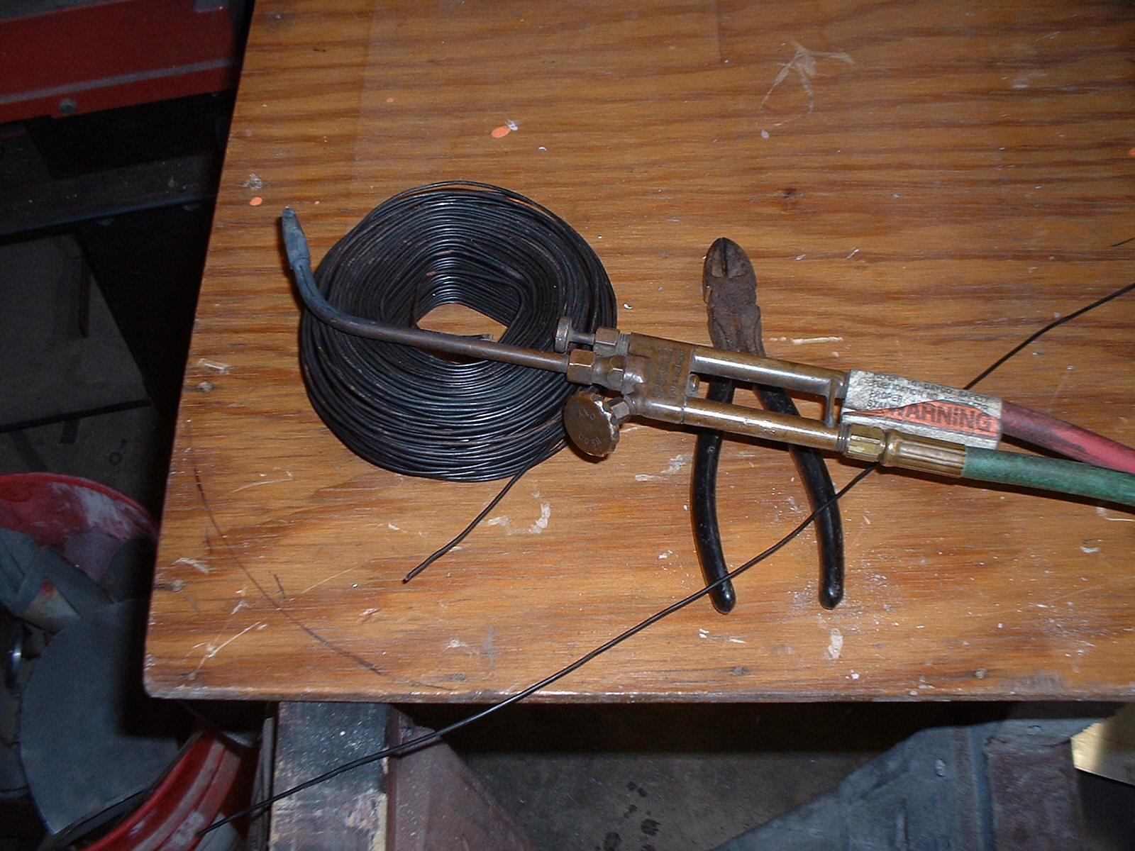

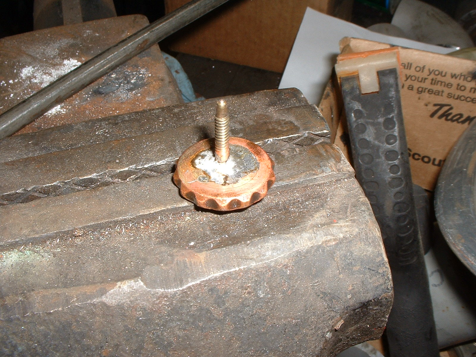

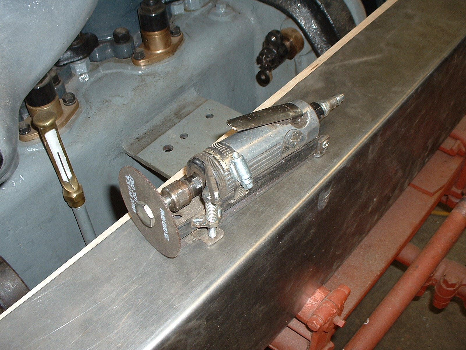

    Apron
    I like to gas weld better than MIG. I use an old out-of-date REGO torch. It's real tiny. My preferred rod is baling wire--very soft and easy to work. People say to use a coat hanger. They've never tried to weld with a coat hanger. Coat hangers are like spring steel. They just start bubbling and burning. Baling wire flows like solder. Try it sometime. As soon as I started welding the knob fell off my trusty REGO. I soldered it back on. After making a short weld I realized I have more metal work to do. So it was back to cutting and bending and fitting. I've got the thing almost done. Just one more tiny piece to make. Then the welding begins, and then the grinding. Check out Jerry's patented grinder plane. I built it a few years ago to cut down welds without hurting the underlying metal. Can I make any money with it?
    Jerry
    <input id="gwProxy" type="hidden"><!--Session data--><input onclick="jsCall();" id="jsProxy" type="hidden"><input id="gwProxy" type="hidden"><!--Session data--><input onclick="jsCall();" id="jsProxy" type="hidden">
  19. -Brent-
    Joined: Nov 20, 2006
    Posts: 7,894
    -Brent-
    I love the 3/4 shot from the front. That piece is pretty neat.
  20. I like it!
  21. CoolHand
    Joined: Aug 31, 2007
    Posts: 1,944
    CoolHand
    Alliance Vendor
    That torch looks like an ancient cousin to the Meco Midget that I use.
    Larger, somewhat more ungainly, but certainly of the same general form and type.
    Neat.
  22. OahuEli
    Joined: Dec 27, 2008
    Posts: 5,243
    OahuEli
    from Hawaii

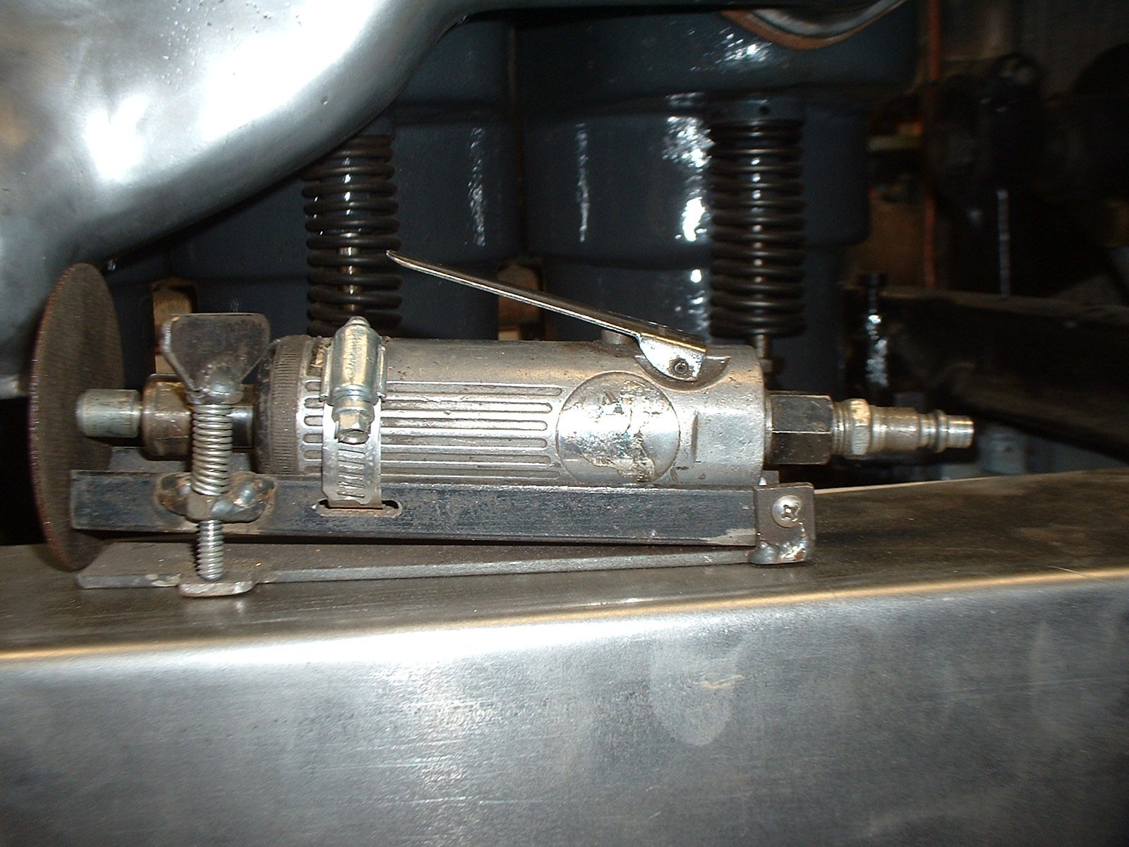

    Nah, we're all gonna steal the idea.:D Seriously, that is a pretty cool trick.
  23. stealthcruiser
    Joined: Dec 24, 2002
    Posts: 3,750
    stealthcruiser
    I like it too, and good to see, that you are using a "thicker" disc with it!!!!!.....Lots of folks, will do a regular "zizz wheel disc", in the grinding capacity, and MANY, are lucky with it!!!!!

  25. 64 DODGE 440
    Joined: Sep 2, 2006
    Posts: 4,434
    64 DODGE 440
    from so cal
    Jerry, love the tool...hope you didn't really patent it, I'm gonna build one for myself!:p

    Jerry Jerry Jerry ...why'd ya hafta go an give away the bailing wire trick. JUst kidding. Coat hangers do **** oh and don't use galvanized tie wire, very bad. The grinder plane is smart.You are one clever fella!
