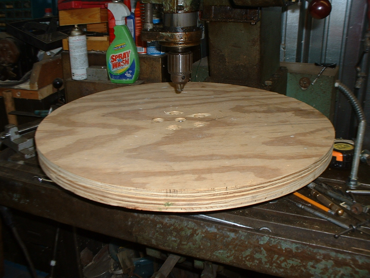

    Wheel covers
    I was going to work on the fenders but when I got to my shop a little voice commanded me to work on the wheel covers. This operation will be complicated. I'll have to do some metal spinning and that requires a pattern or form. Since I've never done any metal spinning I'll have to make everything up. I did watch a bunch of movies on youtube, though. Also I'm only trying to make a large shallow cone about 2 or 3 inches in height and 24 inches in diameter. How hard can it be? I started today by cutting 2 plywood discs as a base for my cone like form. Then I began building a turntable for the drill press. My lathe only has about a 9 inch swing and I need 12. I tried to take a few picture but my camera ****ped out. I hope it's just the batteries.

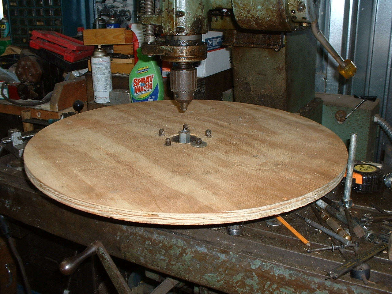

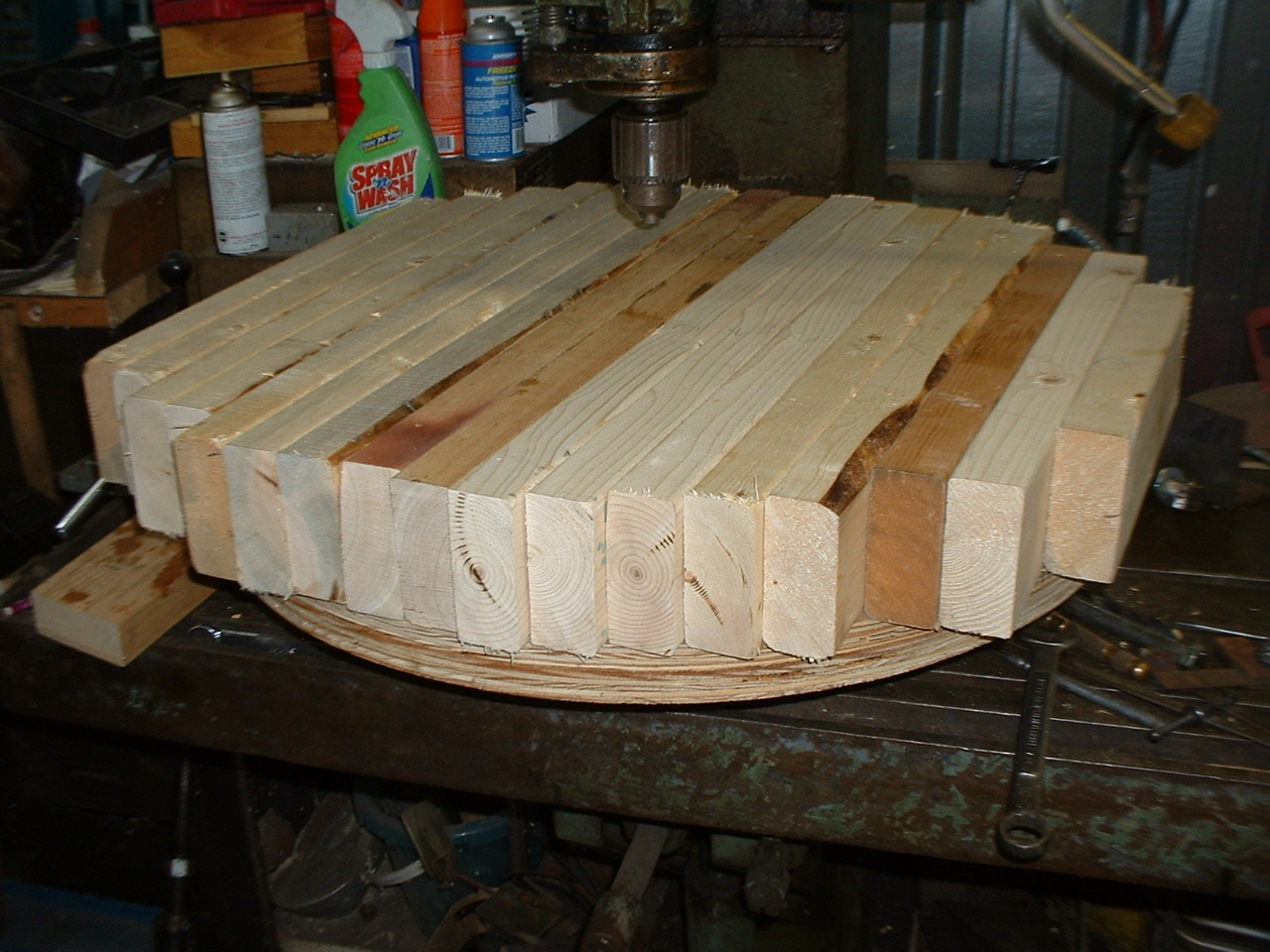

    Wheelcovers

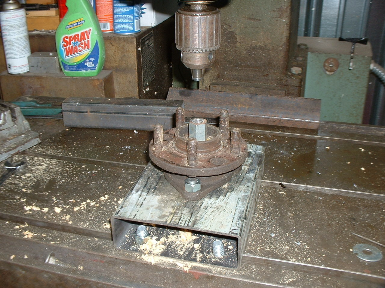

    I started by taking an old front wheel drive hub--from what car I don't know--and mounting it on a 2 x 6 piece of steel. The discs I cut out the other day using a router I mounted on the hub. Then I cut up some 2 x 4s and set them on the disc. Tomorrow, I'll smear glue all over the the 2 x 4s and put them in the press. When dry they'll be mounted on the disc. The theory is that I'll make up a guide and use the router to cut the 2 x 4s into a shallow cone as a form for the aluminum discs. I'm making this up as I go so the whole thing might be an epic failure.

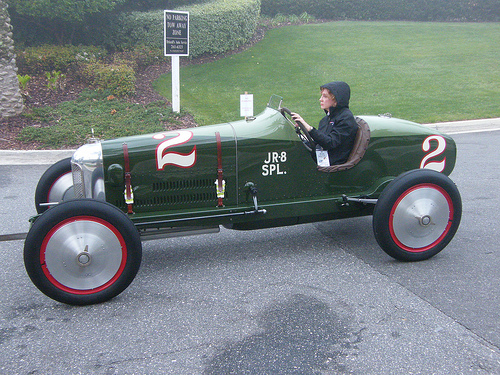

    These pictures will give you an idea of what I'm shooting for.

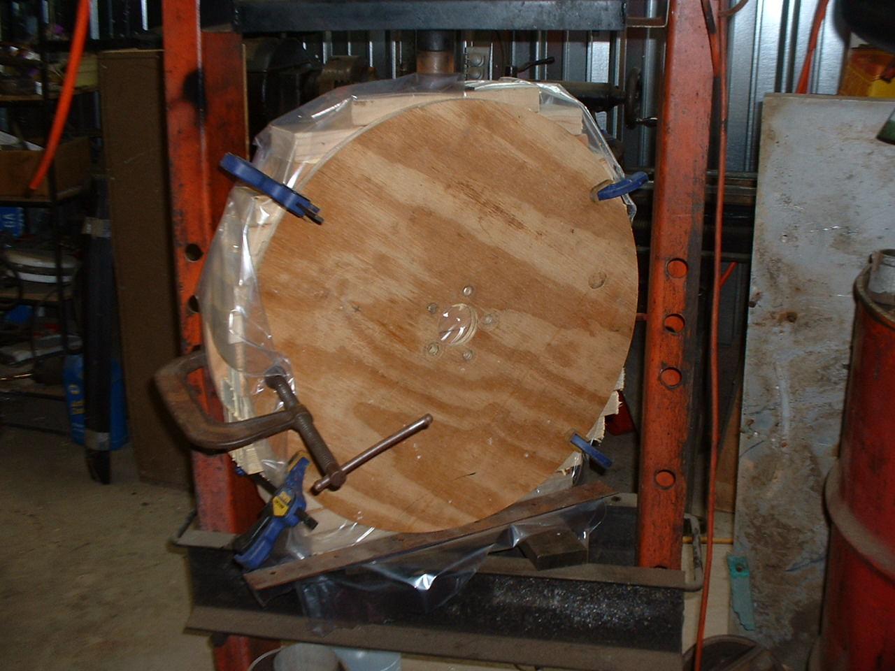

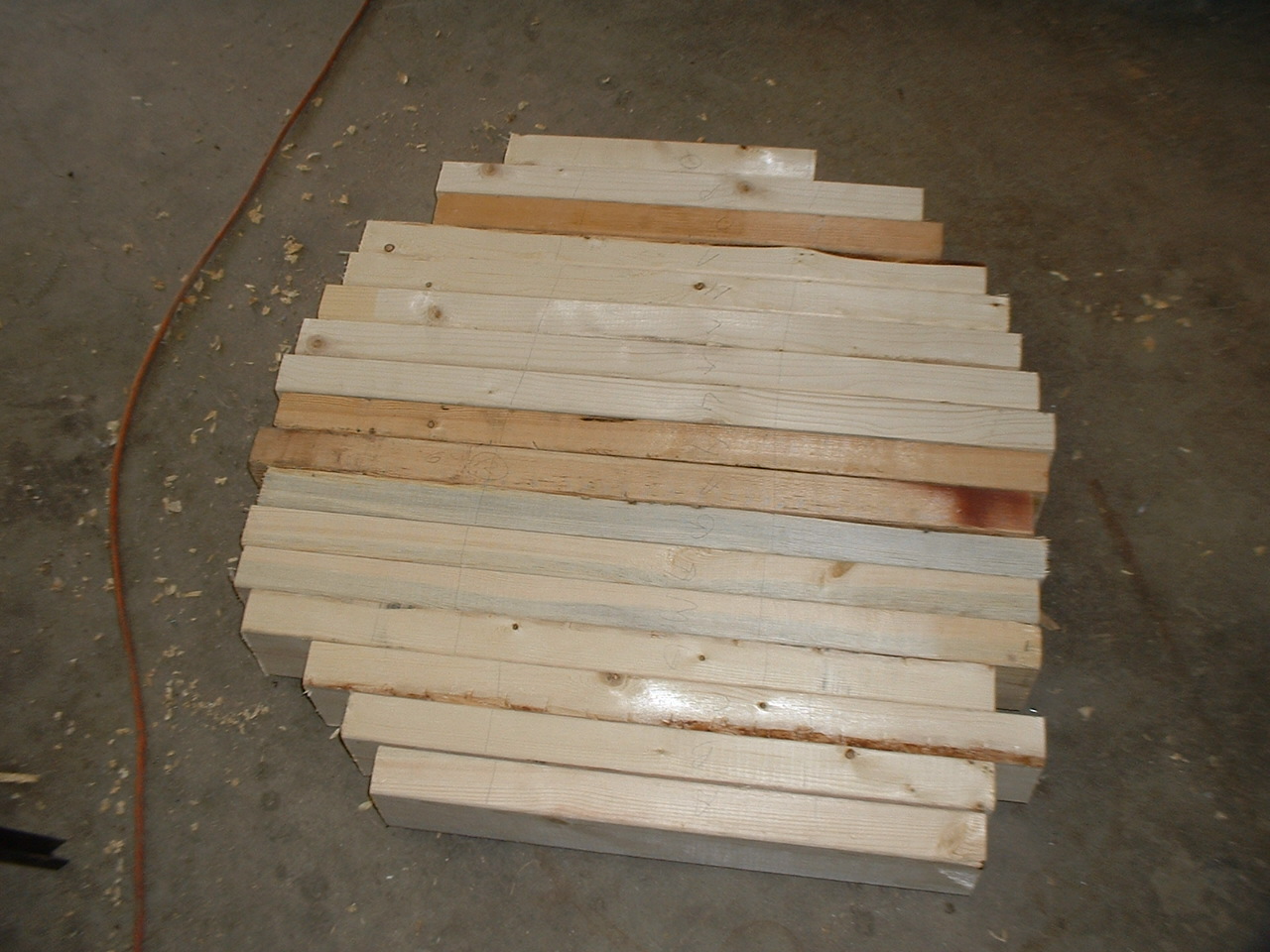

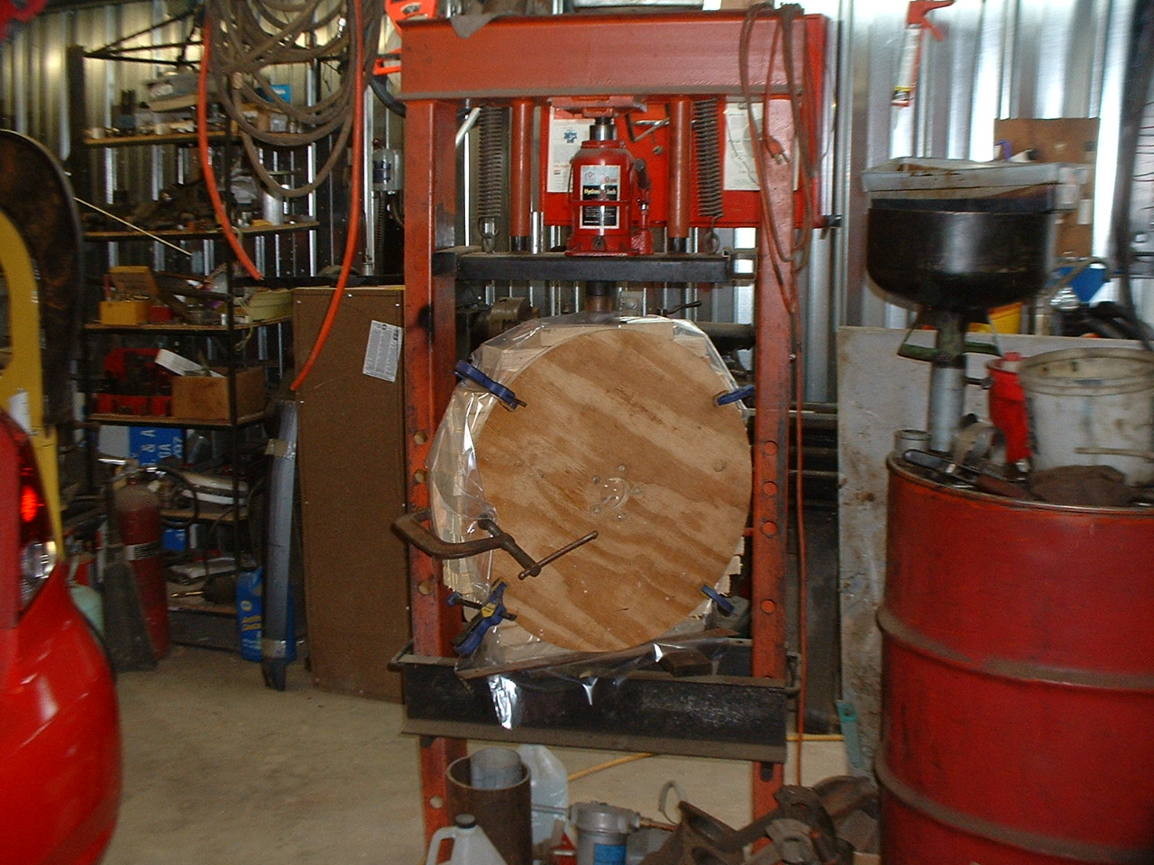

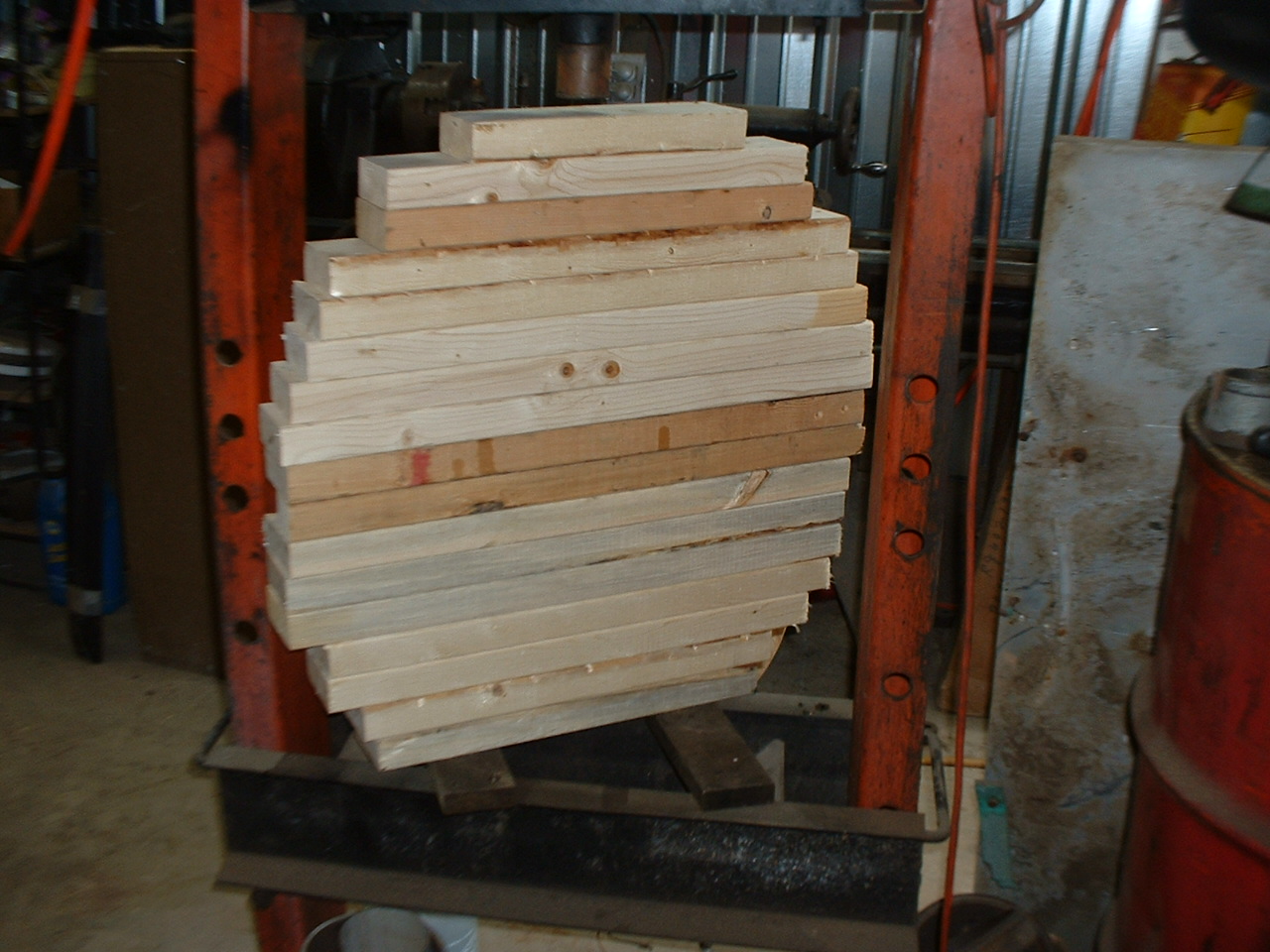

    Wheel covers
    I didn't have much time to work on the Seagrave today but I did get to the hardware store and buy some ***ebond wood glue. After smearing glue everywhere I stacked up the wood, d****d it in plastic and sandwiched it between my two wooden discs. The hydraulic press seemed like a good way to compress the blocks. Tomorrow it should be dry. Then the shaping can begin!

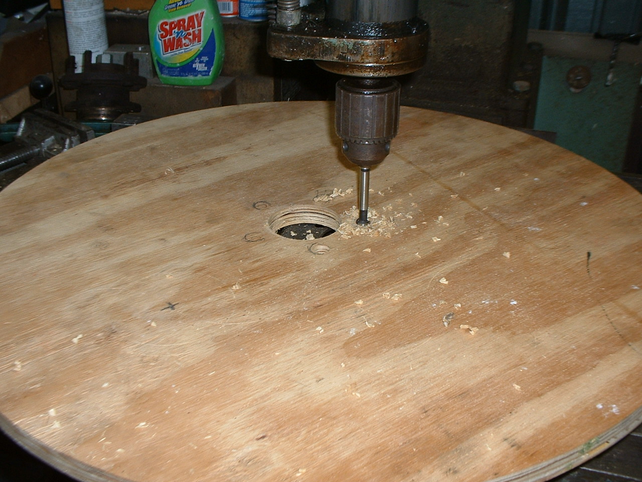

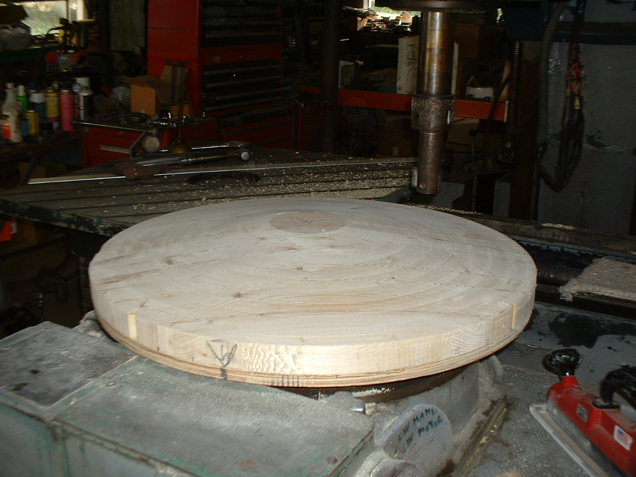

  22. yonahrr
    Joined: Feb 27, 2010
    Posts: 1,348
    yonahrr

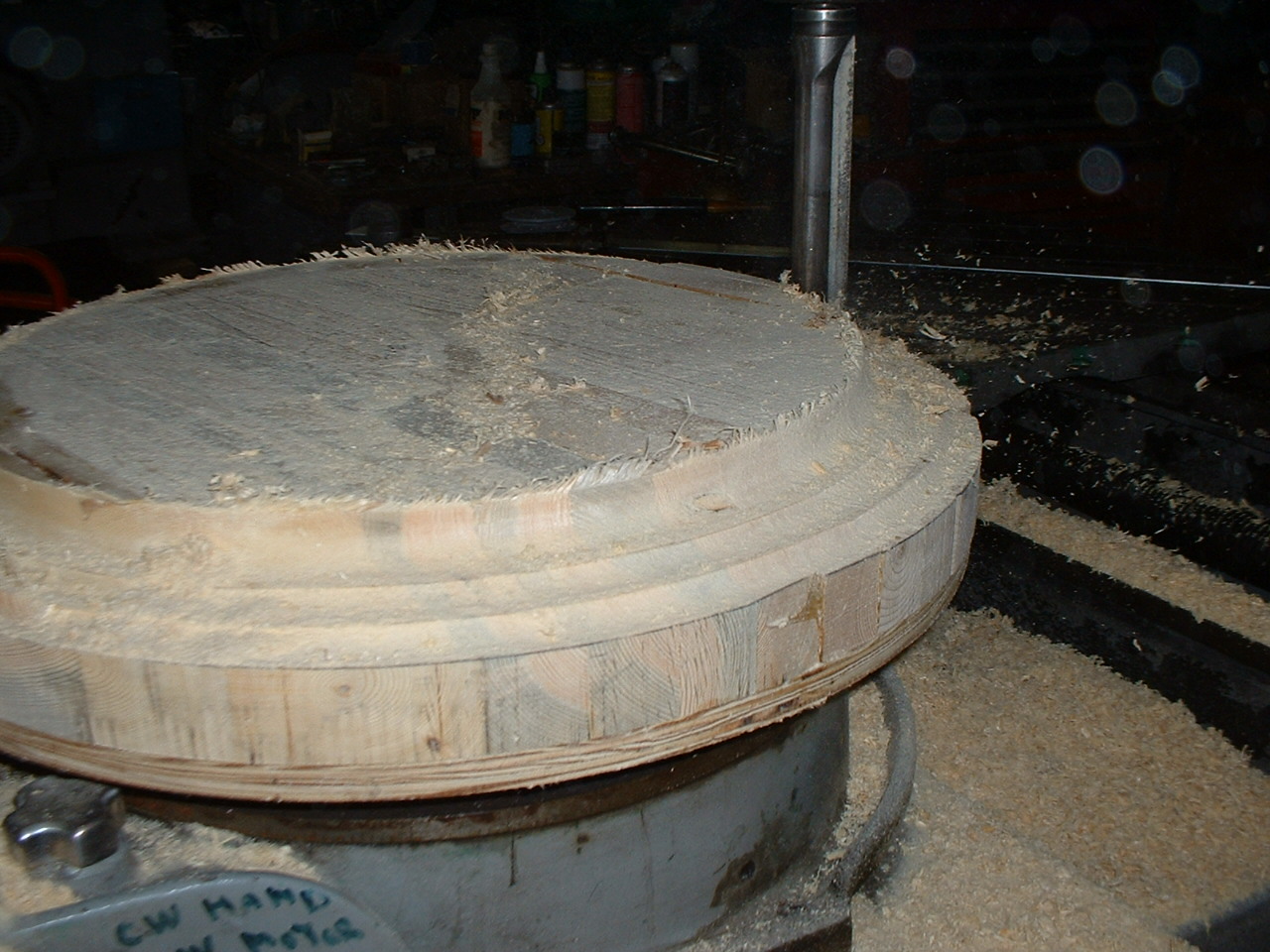

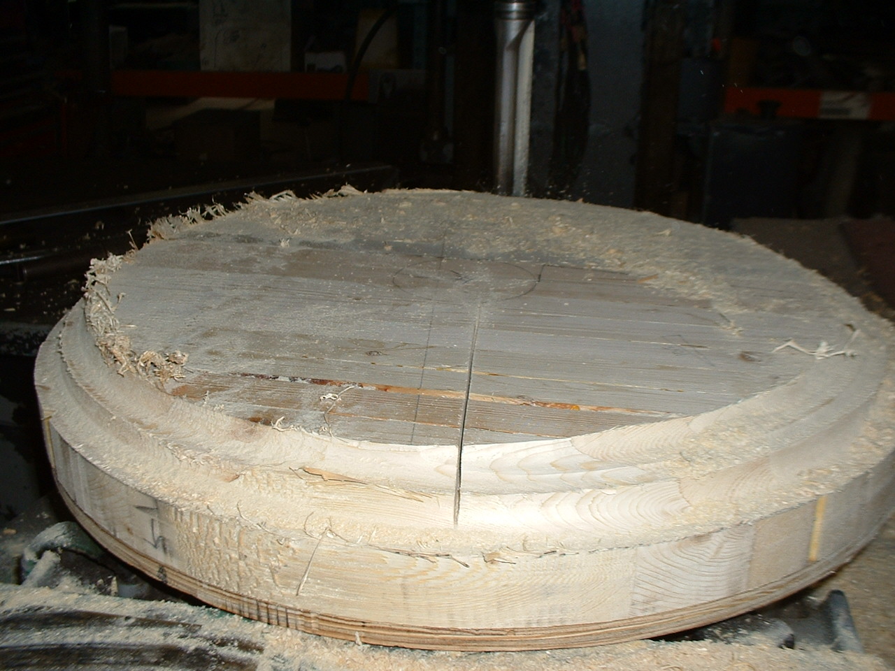

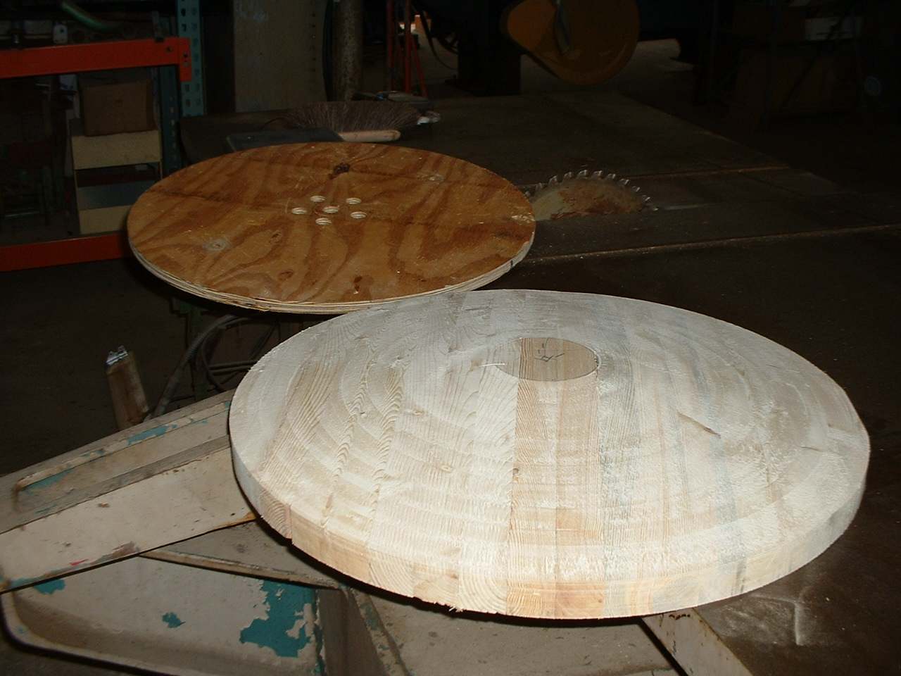

    Wheelcovers

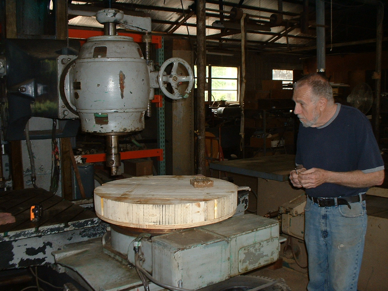

    I made it over to Don's. The first problem was how to mount the big hunk of wood on the mill. We solved that by bolting one of my plywood discs to the turn table then screwing the big disc to the plywood. I was hoping we could turn the cutter head at an angle and just skim the wood creating a perfect cone. Unfortunately, the machine wasn't capable of doing that. We ended up making multiple cuts. It's a very slow process. That's probably why these machines aren't so popular any more, given way to cnc three axis routers. Well, you use what you got. Tomorrow, we'll cut some more.

    if you find a lathe large enough to spin it, wait you can build a wood lathe i bet..
  24. barnbikes
    Joined: Oct 28, 2009
    Posts: 96
    barnbikes
    from MN
    If you mounted the wood block to the head of the mill you would have a upside down vertical wood lathe. My back already hurts thinking of bending over trying to see what you are turning.

    Spinning is one of those things that looks easy, takes ten minutes to learn, but ten years to get right. It is largely done by "feel", however these should be fairly straightforward. Hate to tell you this now, but it would be better to make the form out of discs of plywood that are screwed and glued together rather than two by fours. There are several reasons for this:
    1. If that is ordinary pine it is rather soft and will collapse slightly when pressure to form the wheel cover is applied. This is a problem because the wood will collapse more when you press on the sides of the pieces than when you are pressing on the end as the form rotates, hard to explain clearly but if you imagine the form spinning then there will be with each rotation: end grain-side grain-end grain-side grain, or hard-soft-hard-soft etc, so your end result is a form that is not even. Also each spinning you do will collapse it more so the shape of your first piece will be different to the last.
    2. The Glue will leave hard spots between the pieces which don't collapse at the same rate when either spinning or shaping/sanding the form, which can leave visible stripes in the finished pieces. Its easier to combat this problem if the harder glue goes around the form, and it's lots less prevalent if you use plywood.
    3. If you store the form for any time and go to use it again you will find it is oval shaped, due to expansion and contraction of the wood.
    4. THERE IS A CHANCE THAT SOMETHING MIGHT GET CAUGHT ON ONE OF THE JOINTS WHEN ITS SPINNING AND CAUSE IT TO COME APART. Yes it's a small chance but I've seen it happen and it's not pretty. Most likely to happen when shaping the form.
    For something that size I would recommend to spin down gradually. Do the outside couple if inches first (all the covers), then cut the form down some more and do the next couple of inches etc. If you put a large disc like that on and start from the centre it will tend to "waffle" at the edge. Use as large a backcentre as you can at each stage, and most important, make sure the metal is spun tight to the chuck where you start.
    If you need any other help then either put it up here or pm, and I'll get back to you.
  26. gas pumper
    Joined: Aug 13, 2007
    Posts: 2,964
    gas pumper
    Can't you use the pattern as a hammer form?
    and the mill, I think, is a better choice than a lathe. Turning pine is very problematic as to tearout. The mill is acting as a router and the revolving cutter is less likely to split out chunks.

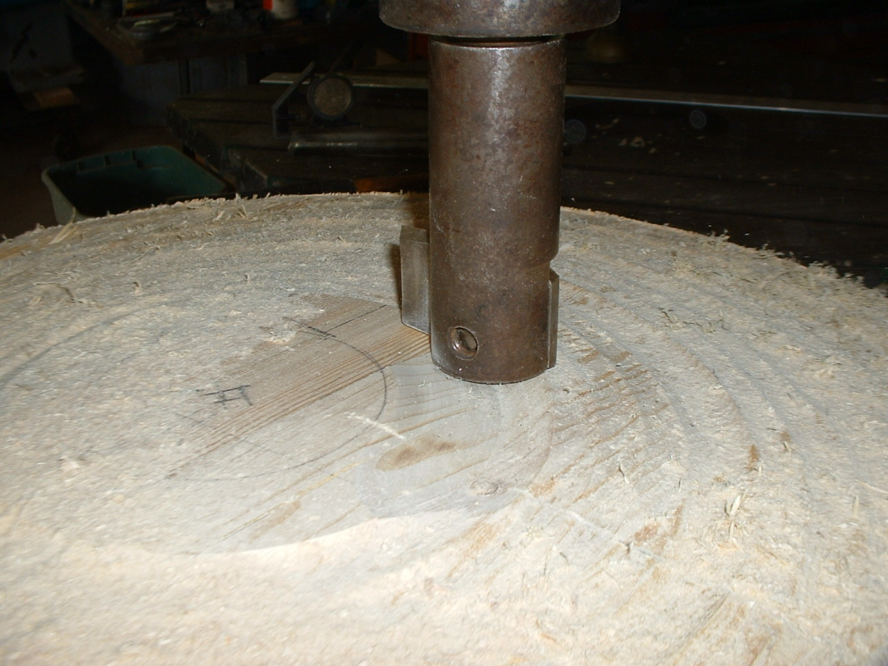

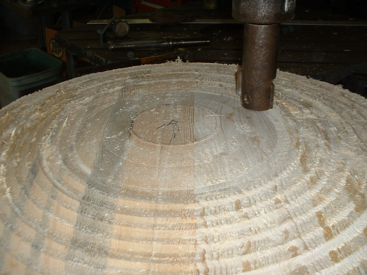

  30. yonahrr
    Posts: 1,348
    yonahrr

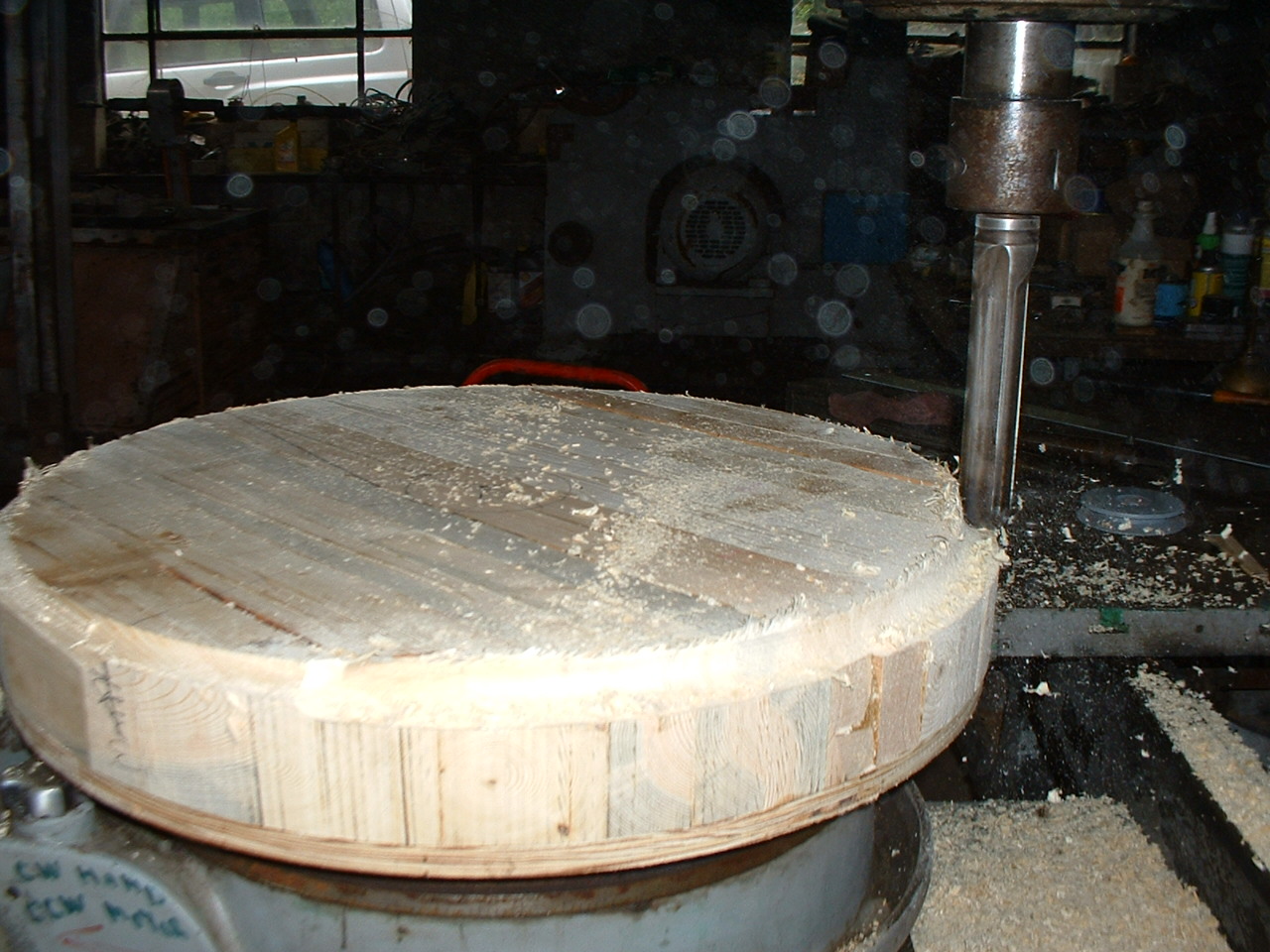

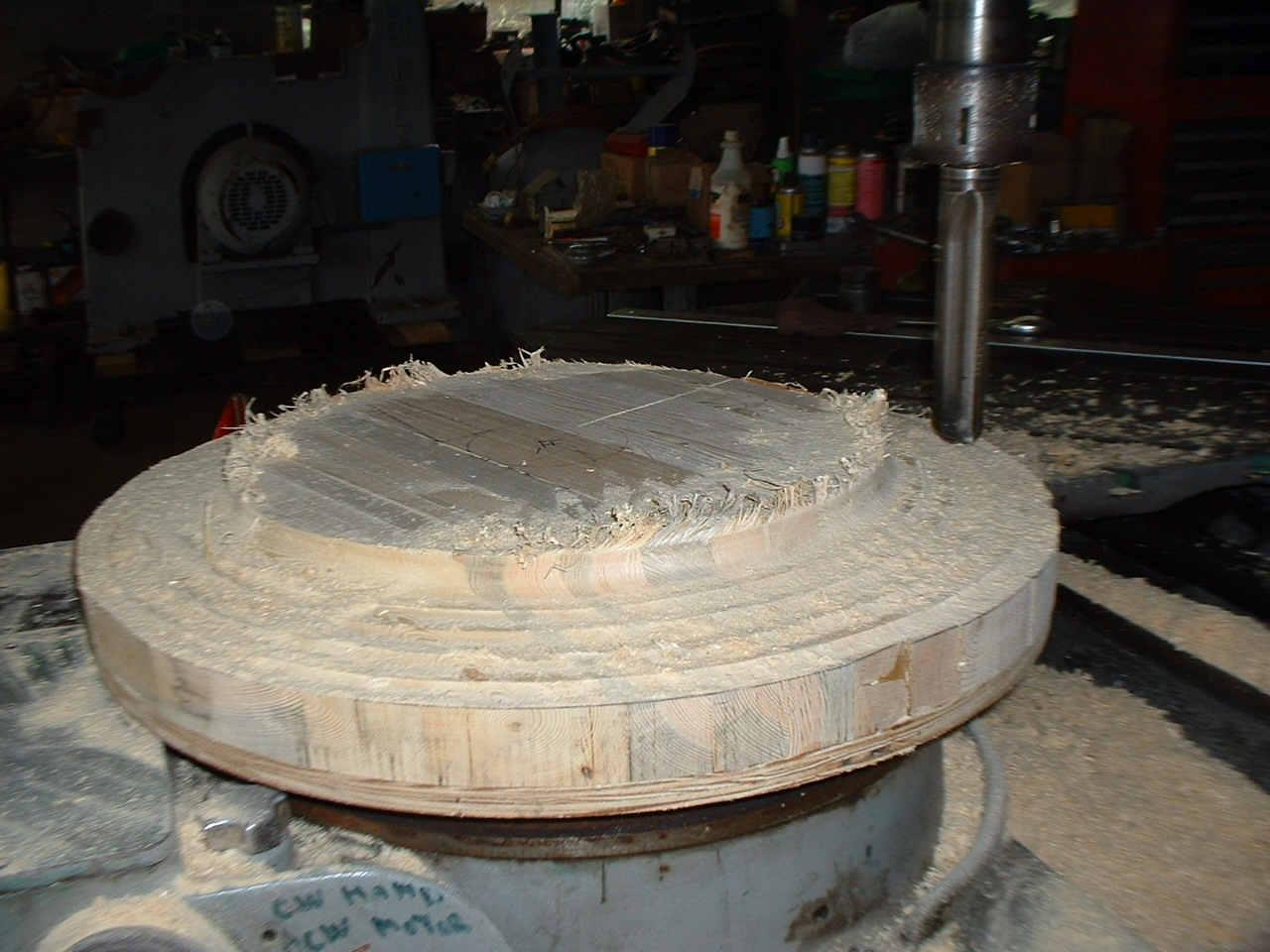

    Wheelcovers

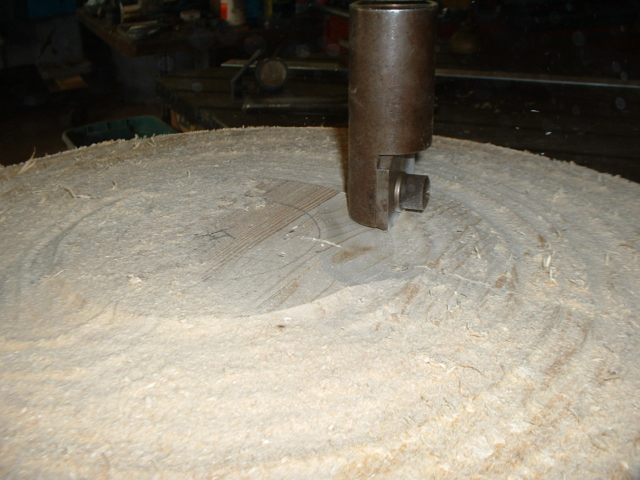

    Back at MorganFab. After we roughed out the shape, Don came up with an angled cutter bit. This did a real nice job smoothing out the form. When it was done I sanded the wood a bit. Actually, the thing came out better than Don and I expected. Now the fun starts--mount the form on my drill press, bolt down some aluminum, rig up a wheel on a stick and see if I can shape a spinning disc into a wheelcover.
