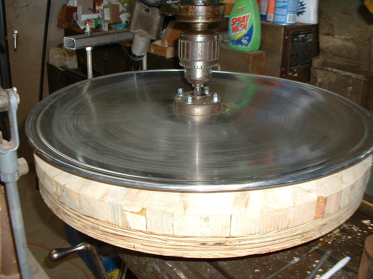

    Wheelcovers

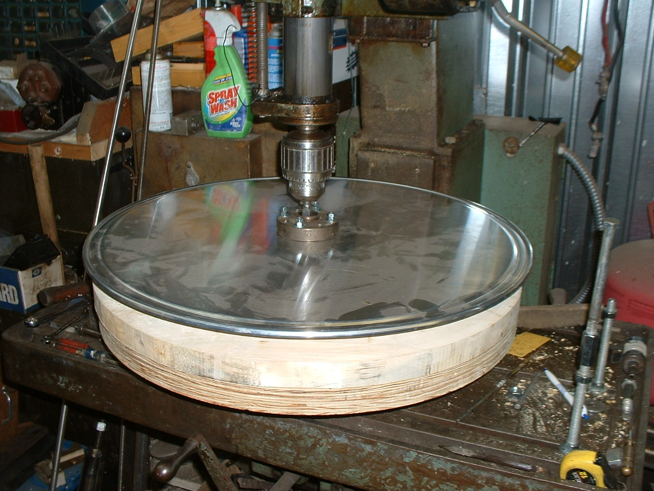

    I got the wooden form mounted on my front wheel drive hub with the aluminum disc on it, in the drill press. I spun it up to speed and it's kind of scary, probably fly off and eviscerate me. Interesting. I'll keep the cell phone close. I left my camera at the shop so no pictures tonight. Picture the whole thing as some kind of horizontal lathe. My drill press is a monster. It looks more like a milling machine. The good news is I only need to deflect the aluminum about 2 inches. How hard can that be? Results tomorrow.

    You'd better hope the glue joints are all good in that buck! That's a lot of m*** spinning around there.

    you could always clamp a band of steel around the edge, or shrink a band like used to be done on wagon wheels.

    Lessons on metal spinning

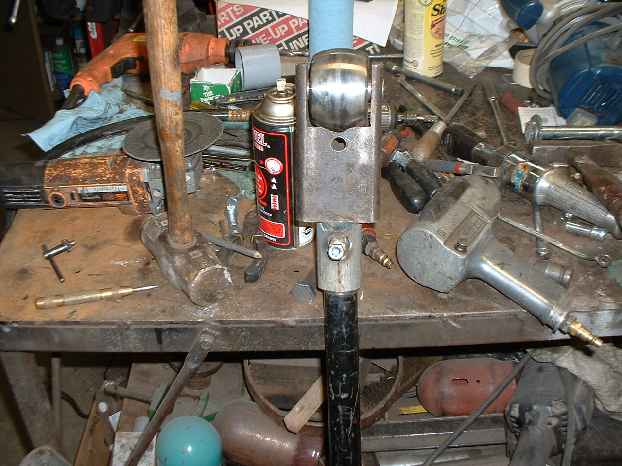

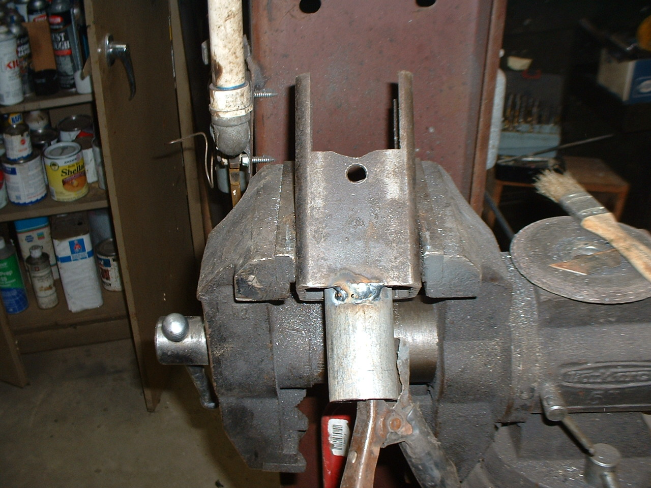

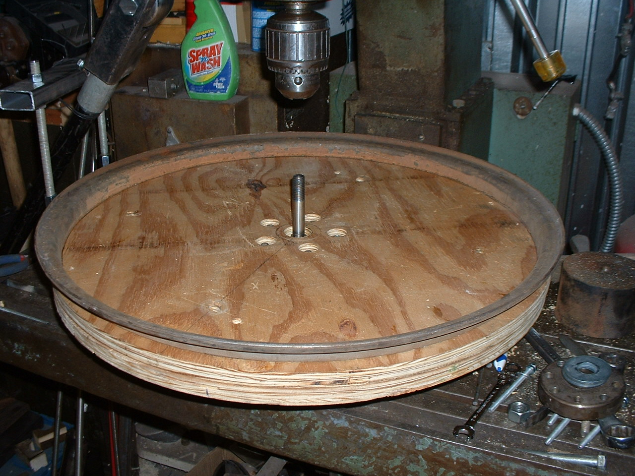

    Ah, the lessons you can learn when you dive into a new discipline. After I got the disc mounted I set about making my spinning stick--that's a technical term. The lower wheel from my English wheel looked about right. A suitable holder wasn't too hard to make which I mounted to the handle off my floor jack. With spinning stick in hand I girded my loins for the task ahead. Following a thorough girding, I spun up the drill press and leaned into the disc. Amazingly the metal actually started taking shape. A few leanings later I realized something important I hadn't foreseen. Because my disc had a hard edge, the more I stretched the inner part of the disc the more the outer part wanted to curl up. My form, I realized, should been a bowl or negative of the shape I wanted. Then I could have secured the perimeter of the disc and stretched the center into the bowl. With that in mind, I secured part of a 24" rim to the turntable and mounted the disc. I had no form to work with but what the hell. The piece didn't actually come out half bad. But without a pattern, the problem is making 3 more of uniform shape. I hate to go through all that work of making another pattern.

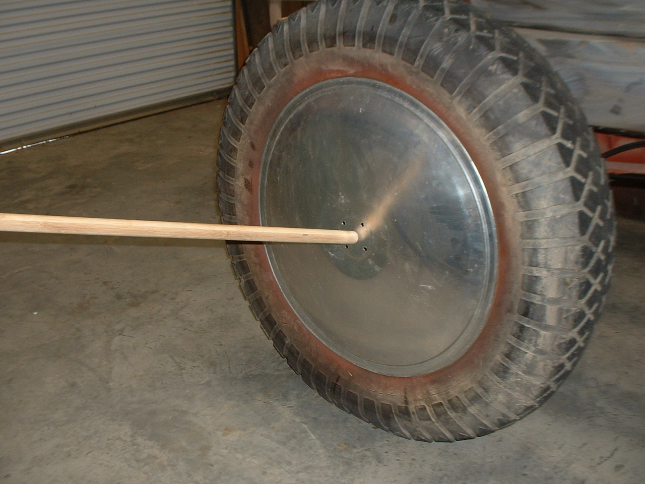

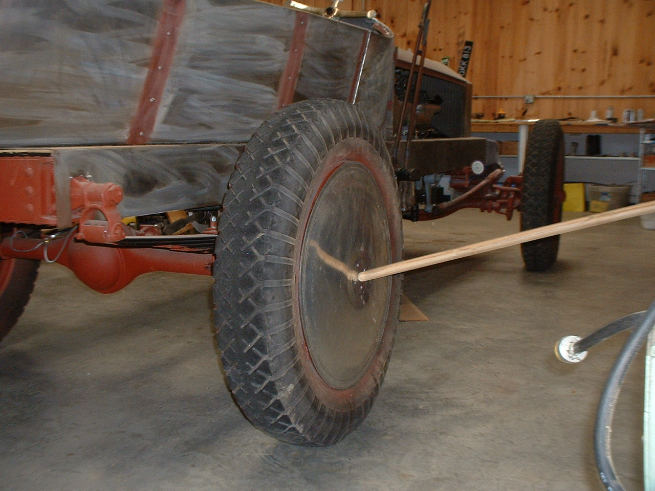

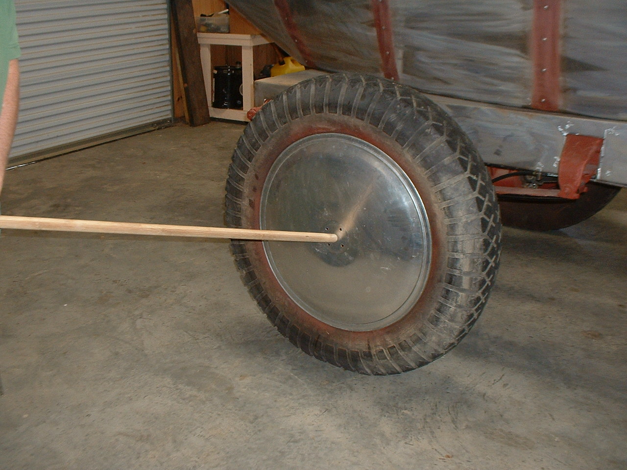

    Here's some pictures of the wheel cover in place. The rim needs an adjustment to the bolts and wheel locks. Also I need to make up the hubcap stuff that will hold the wheelcover in place.

  10. You could bake a pizza on one of those. Ha!

    Way cool...now you need some kind of crest/badge/emblem thingy to bolt in the middle and hide all the ugly mounting thangs.

    Was that a pizza pan you started with?

    Don't let it disembowel, dismember or eviscerate you. Could a wider rolling wheel work on your stick, to stop the curl-up? The one looks good, and if they are the same fore-and-aft but a little different left-to-right, no one will notice.
    Also there is indeed a 24" pizza size, often called UFO, so an aluminum pizza pan that size might be a good starting point? Probably not as good as yours but maybe more uniform.

    I agree the look like pizza pans, they need a step or two some where to break up the look

    Hah, I was waiting for someone to discover the pizza pan secret! :) The cat is out of the bag. 24" $24.00 The beaded edge is perfect. The early wheelcovers are all smooth as far as I can tell. Steps came later.

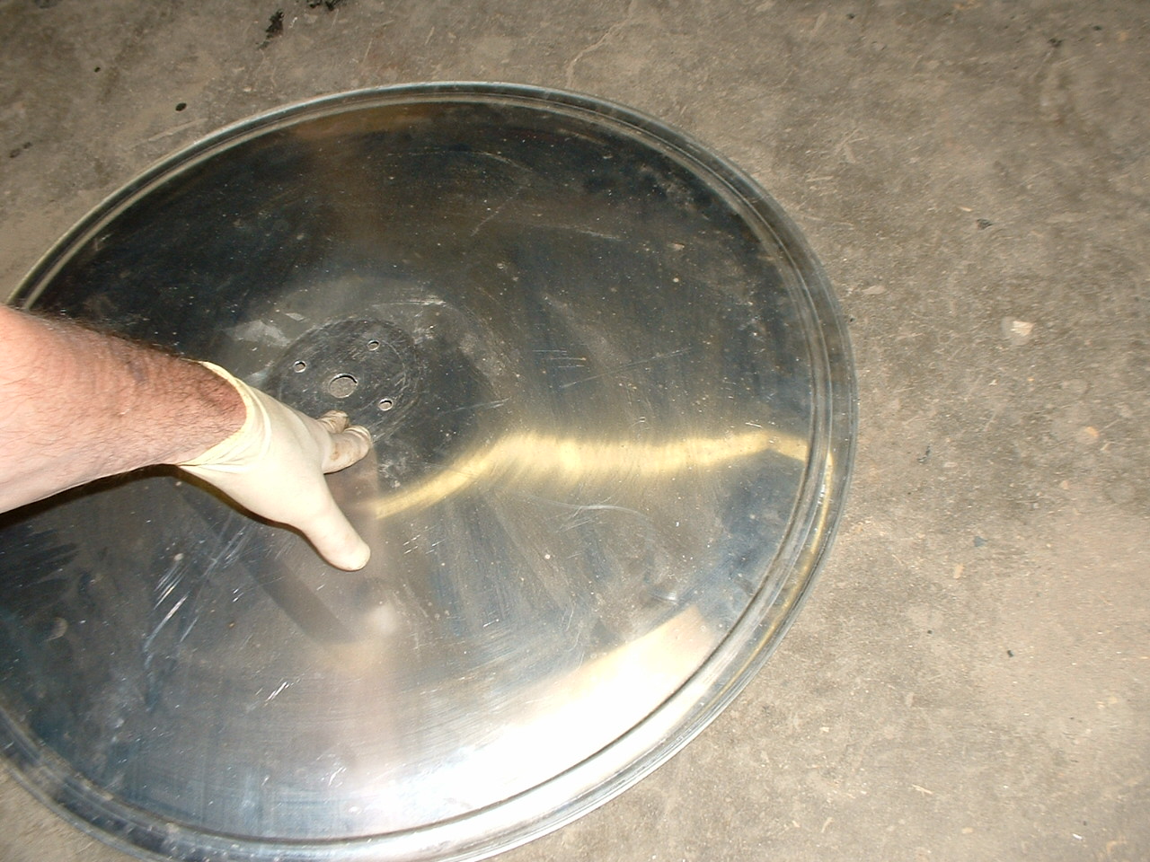

    Today I finished up the Aveo and it's on the road. I also managed to completely finish one wheelcover as you can see in the picture.

    Great wheelcover. Particularly like the "flipper bar" in the center. :D

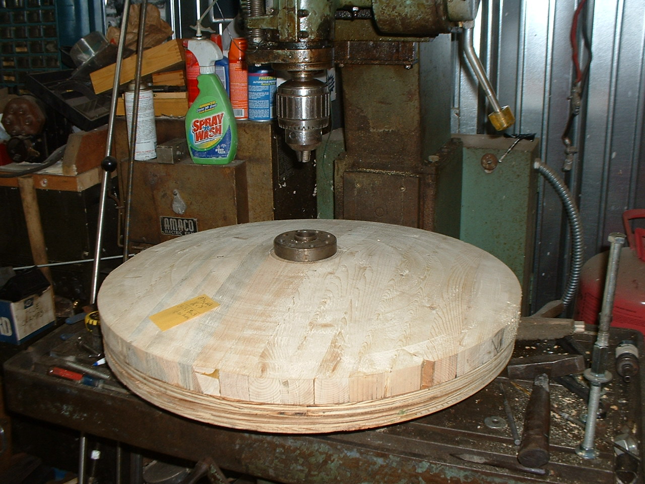

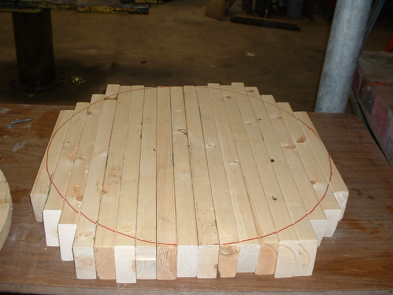

    The Seagrave is still over at Oscar's and with nothing in my shop I thought I'd take advantage of the extra space. I'm not happy with the wheelcover I made. I want each wheelcover to be uniform. So back to the lumber yard for some more 2 X 4's. I cut them into lengths, glued them and put them in the press. I took pictures of all this but for some reason only one of the pictures is in my camera. Tomorrow, I'm going to try and build a jig to shape the wood into a sort of bowl using my router. I think it'll be faster than Don's pattern mill. We'll see.
