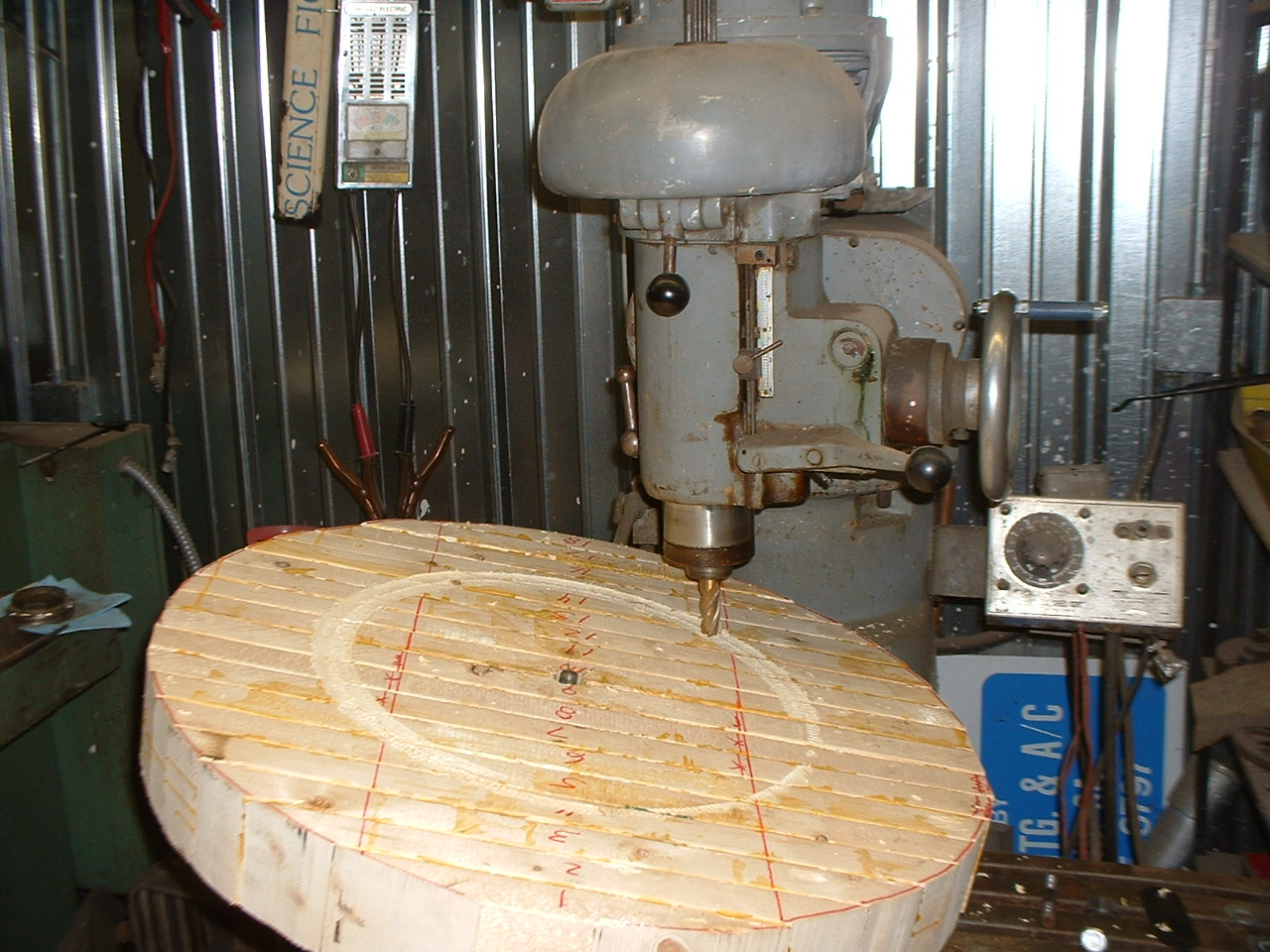

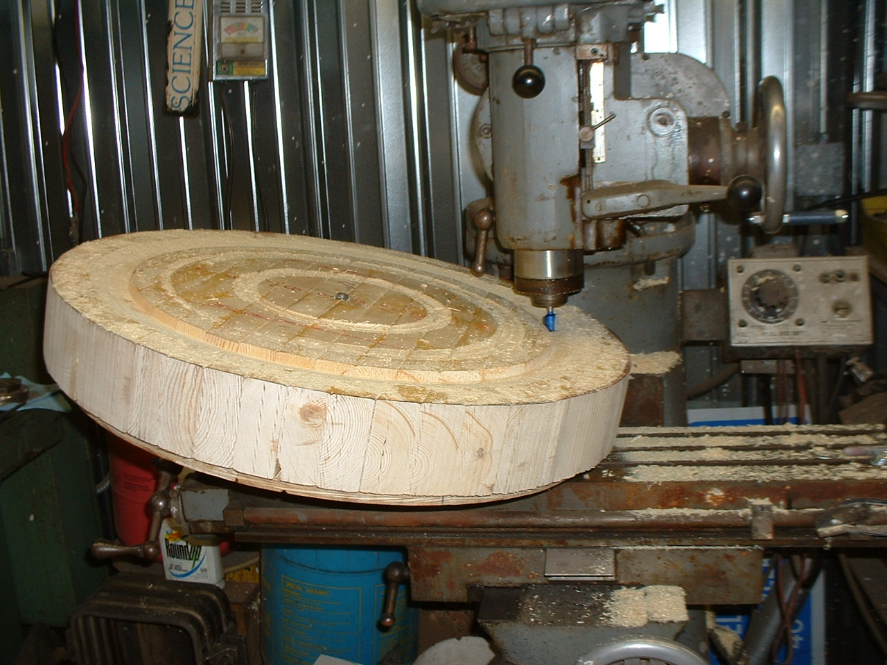

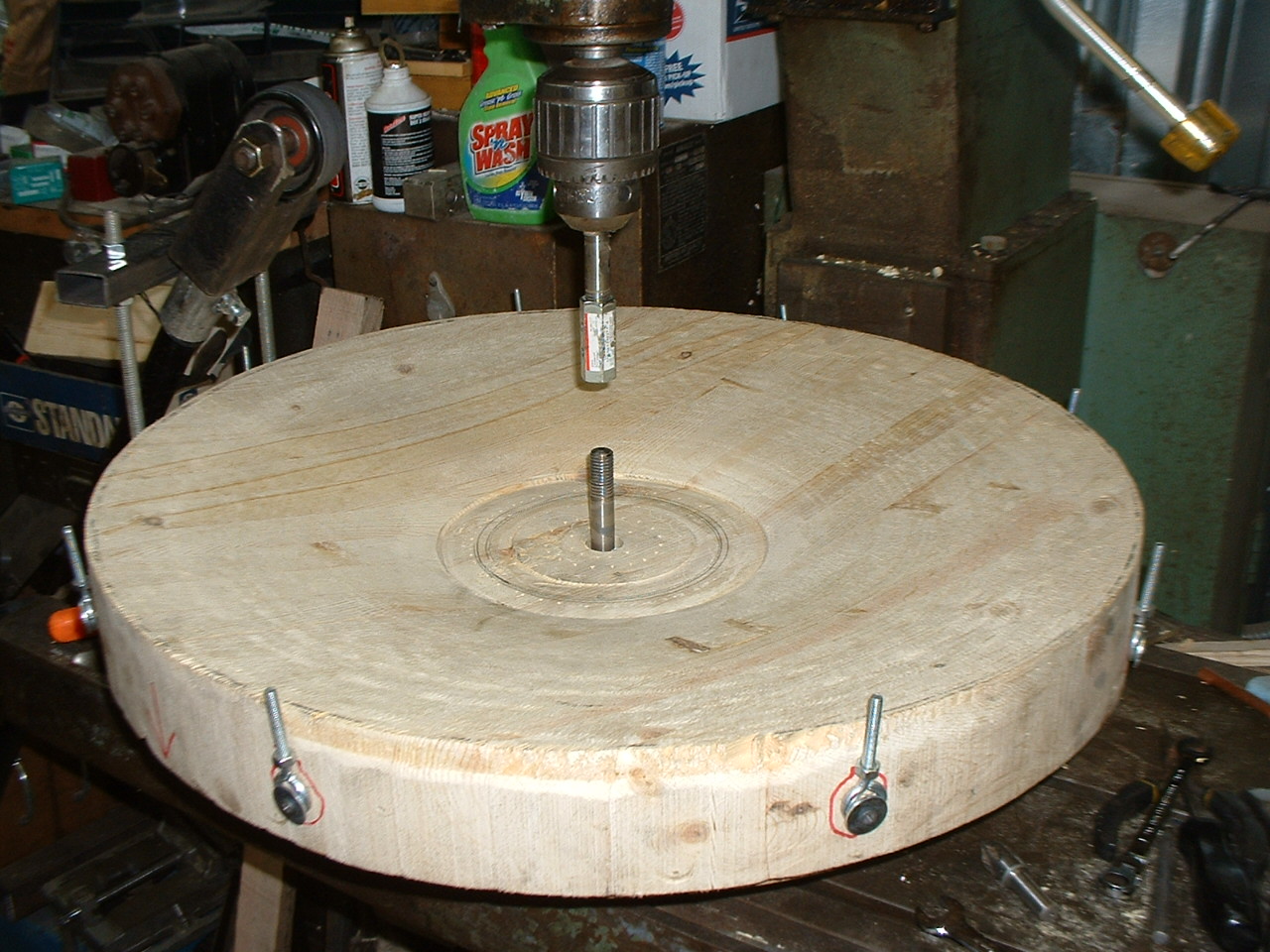

    Something is wrong with my camera. Pictures I deleted are showing up. Pictures I took are disappearing. Who knows? I trimmed up the big rough form on the bandsaw. Three inches from the end the blade broke. I finished up on the metal bandsaw. I didn't feel like driving to Don's. Besides, his pattern mill is too slow. He told me I'd never be able to shape the form without his big machine. But I love a challenge so I mounted the hulk in my milling machine. I tried using a mill bit but it didn't cut so good. Not to be defeated I chucked up a router bit. I upped the machine's speed and it cut pretty good. Unfortunately, 3/4 of the way into the job the bit broke. I went back to the mill bit. With the increased speed it cut pretty good. I had to turn the form by hand and advance the table one turn at a time. After the basic dish was cut I mounted the setup on the drill press to cut out the center. Didn't quite finish before quitting time. Maybe I get to spin some metal tomorrow.

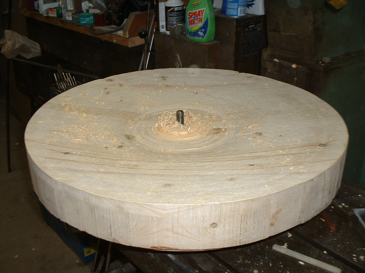

  5. yonahrr
    Joined: Feb 27, 2010
    Posts: 1,348
    yonahrr
    Wheelcovers
    These wheelcovers are eviscerating my ***. I made a second one based on the new form and I'm just not happy with it. I may have to take a break, do something I'm capable of and come back to them later. Either that or I need a vacation to the beach. Hawaii maybe. Damn! No money! Tomorrow, I drive the Seagrave back to my shop. Having it in there will re-girdeth my loins. They've been de-girthethed too long. It'll be like reformatting my brain while I reformat my camera. Besides, my finger joint router bit came in. Maybe I'll have better luck making a steering wheel.

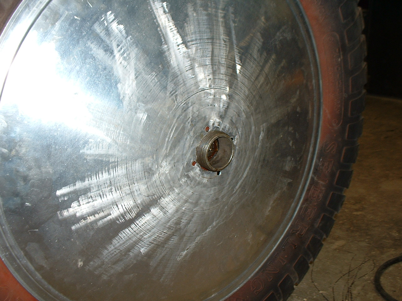

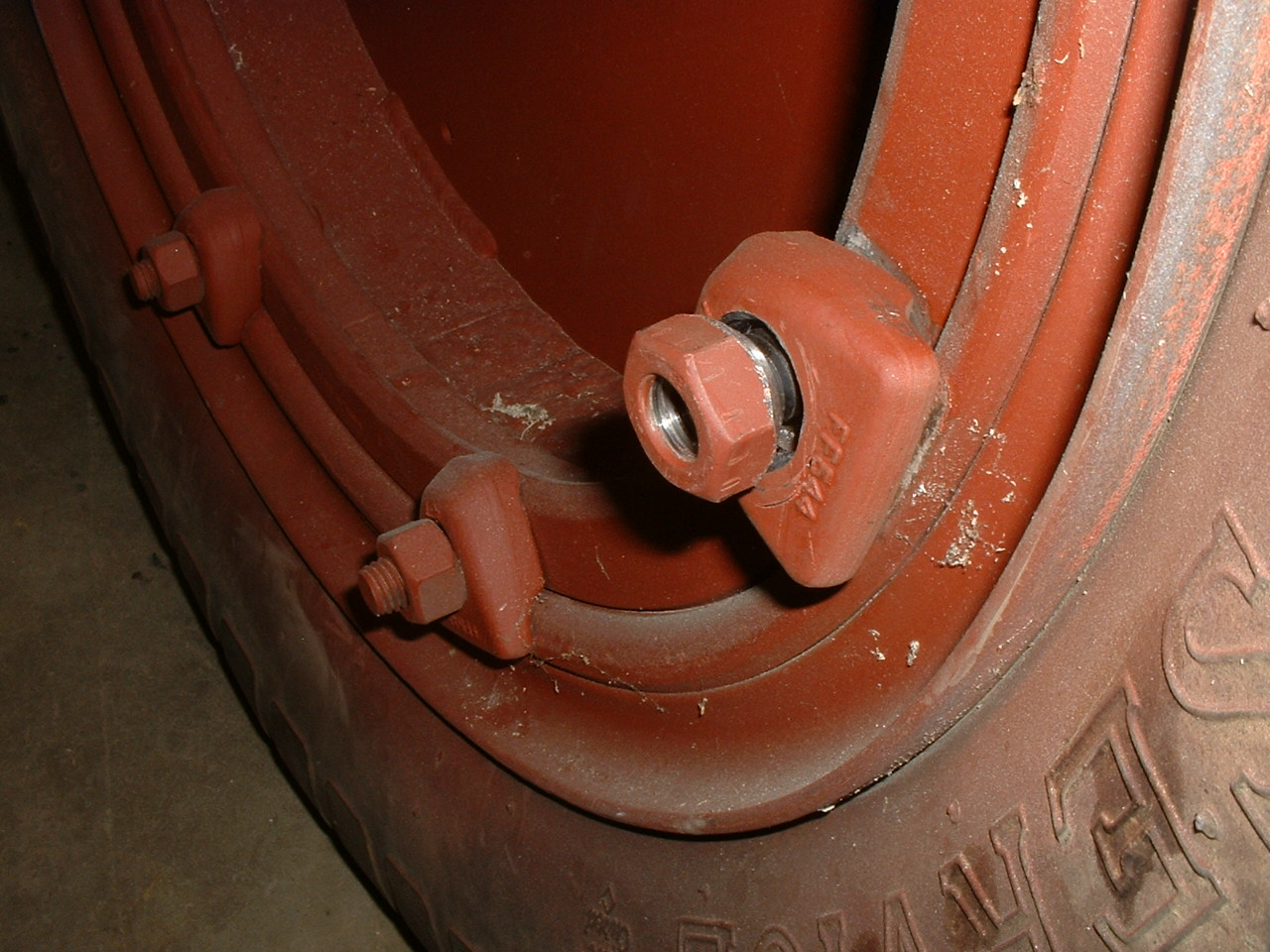

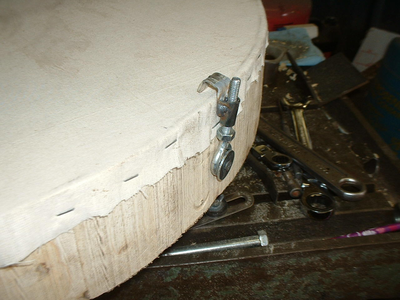

  7. yonahrr
    Posts: 1,348
    yonahrr
    Drive!

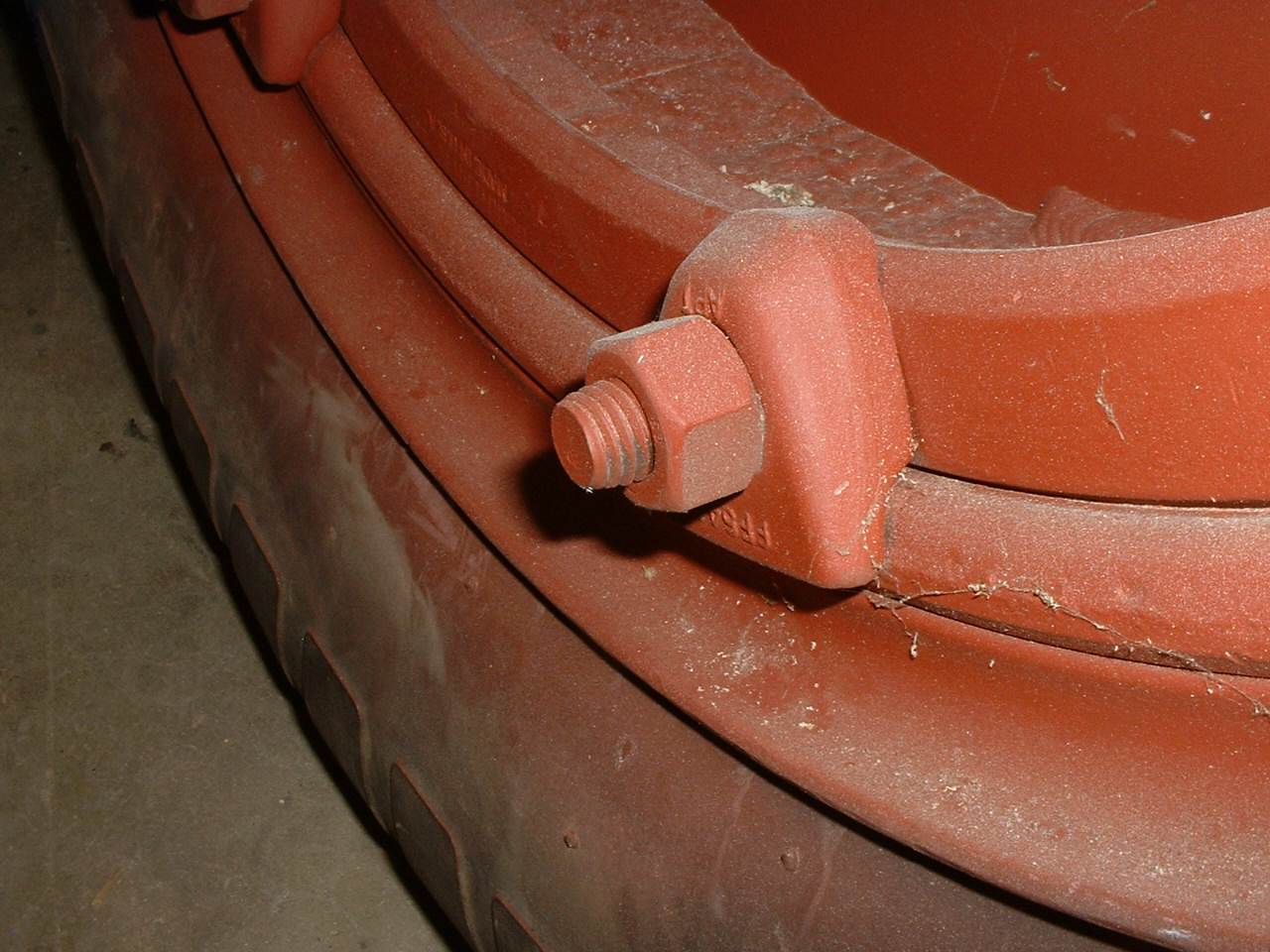

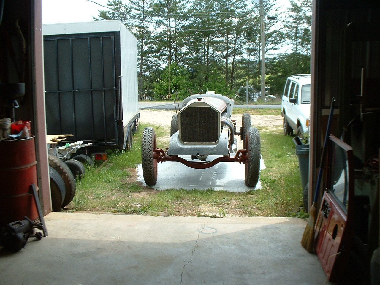

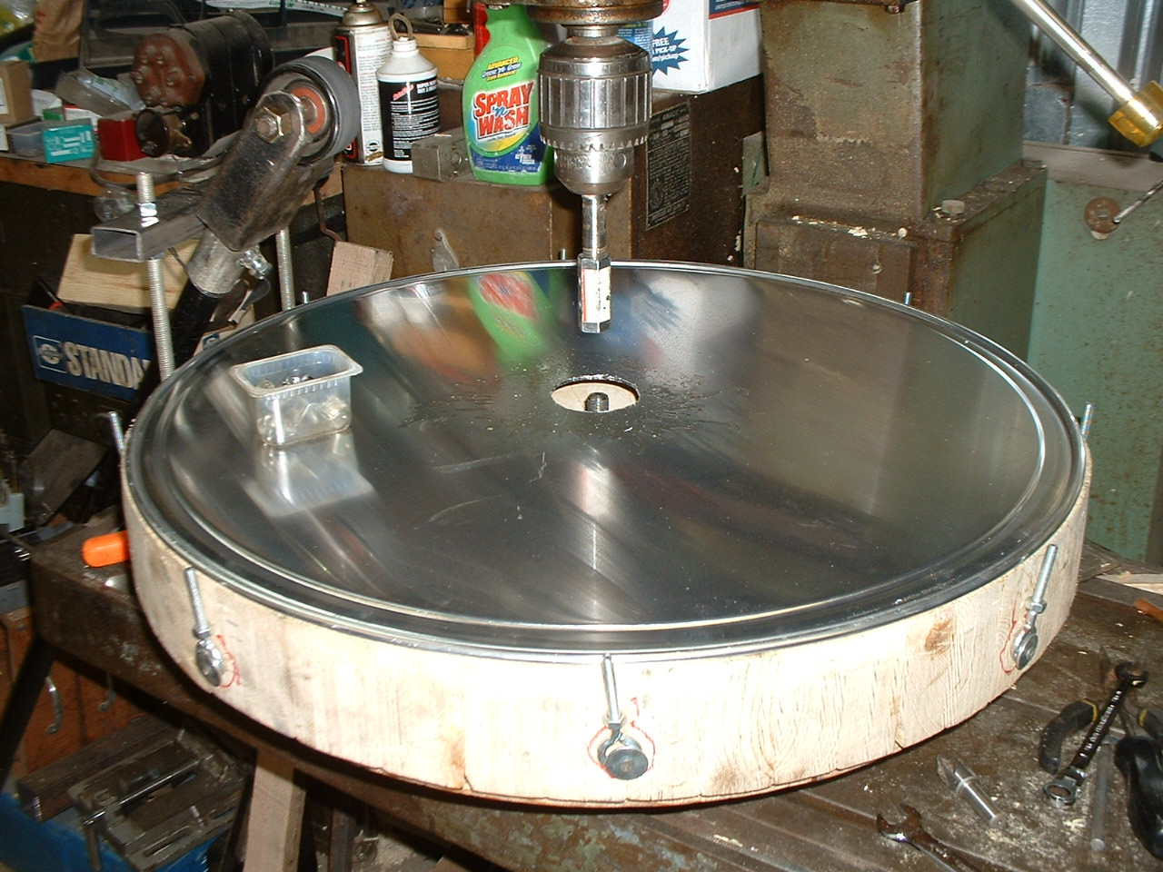

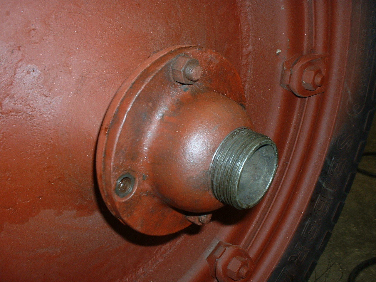

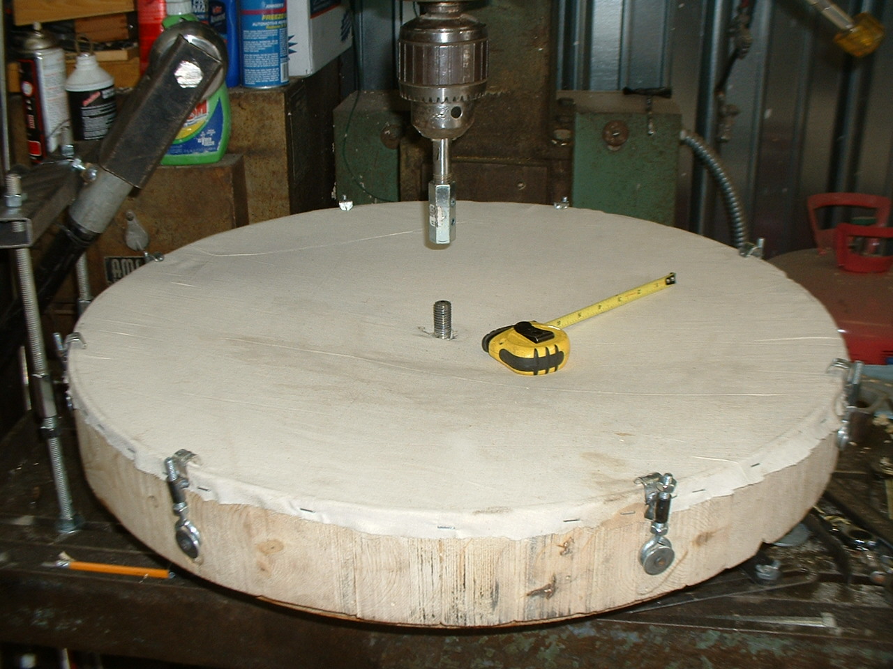

    The Seagrave is back! Before I put it in the shop I drove it around the area and stopped at a nearby repair shop. I love the awe and wonder it evokes. Charges my batteries. Here's some pictures of the new wheelcover metal spinning setup. I think it'll be okay. I just need to fine tune the thing. In the wheel picture you can see that the rim retaining nuts stick out a little too far. I'm putting a taper on the nuts and relieving the retainers. That Chinese grinder comes in handy. When I get all the nuts where I want them I can fit the wheelcover, and when I get the wheelcover where I want it, I can build the piece that holds the knock off.
    Jerry
    <input id="gwProxy" type="hidden"><!--Session data--><input onclick="jsCall();" id="jsProxy" type="hidden"><input id="gwProxy" type="hidden"><!--Session data--><input onclick="jsCall();" id="jsProxy" type="hidden">
  8. paperdog
    Joined: Mar 26, 2006
    Posts: 5,176
    paperdog
    careful with them wheel retainers
    as wheels are splosive when let partially loose
    good luck
  9. yonahrr
    Posts: 1,348

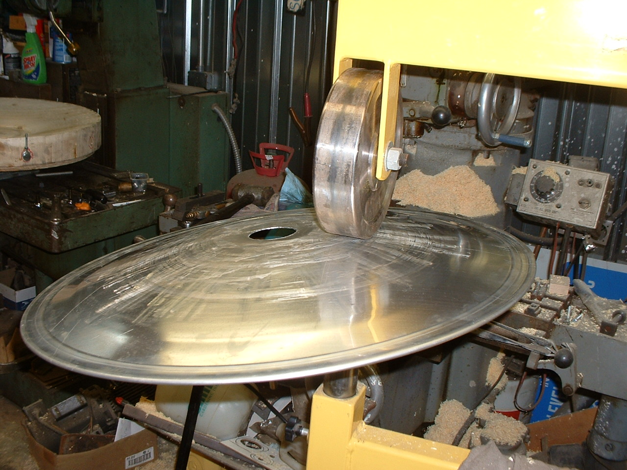

  14. yonahrr
    Posts: 1,348
    yonahrr
    Wheelcovers!

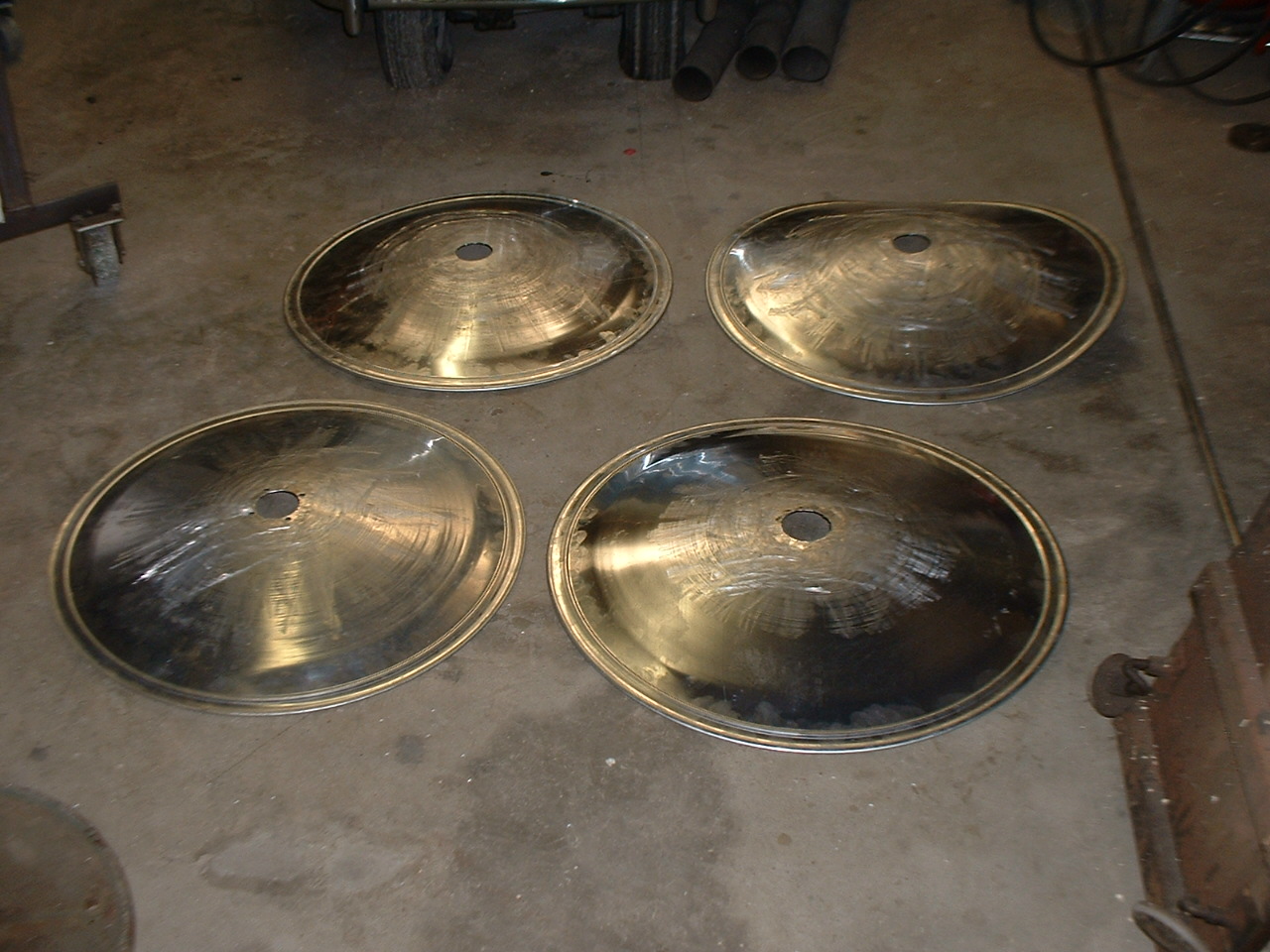

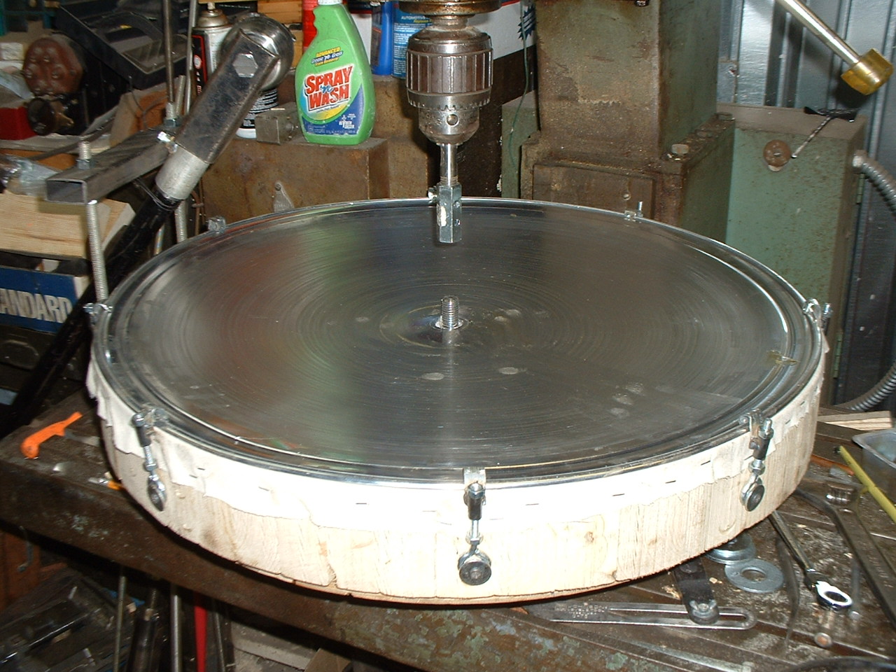

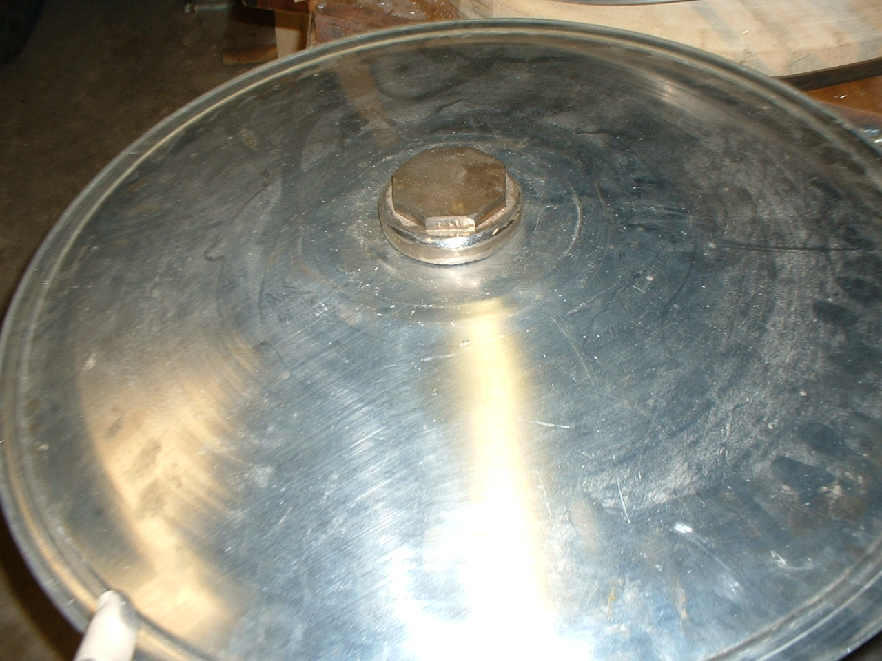

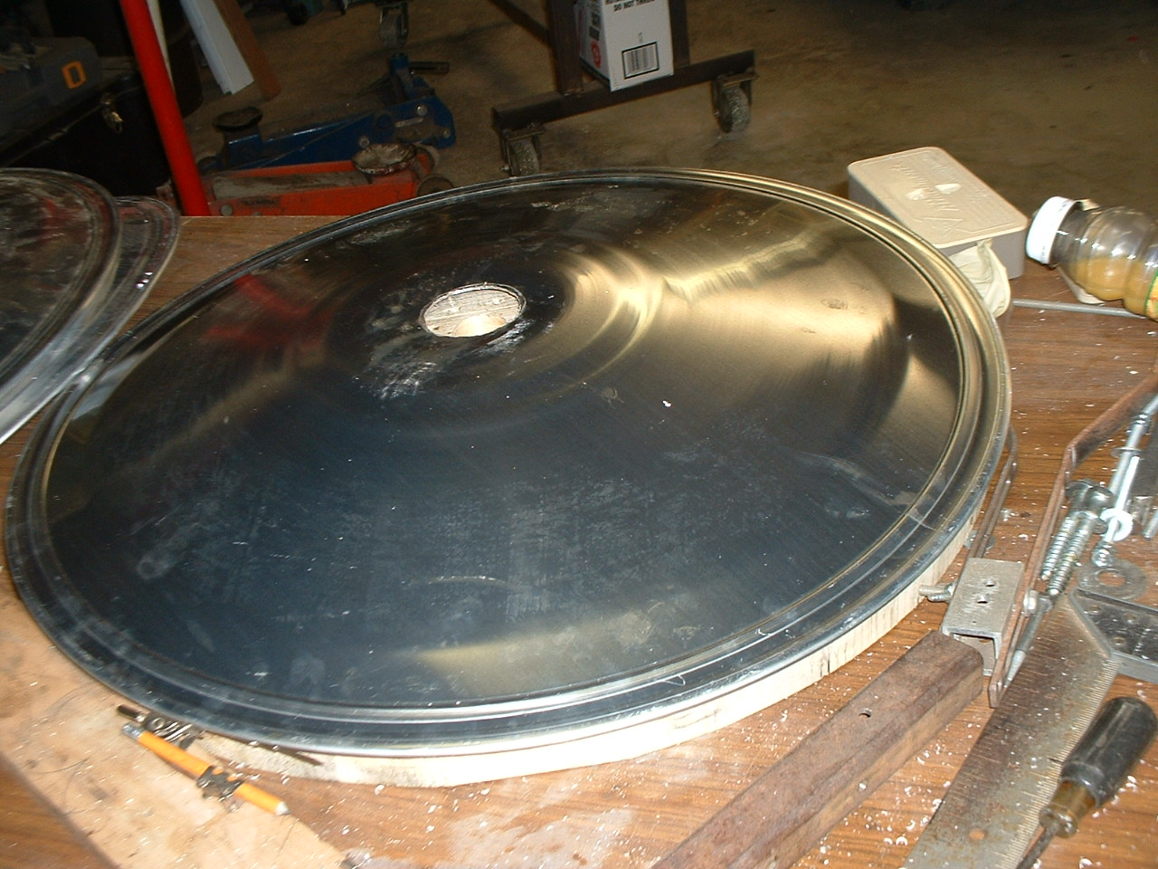

    I hadn't been spinning long today when disaster hit. Before the disaster my only problem had been making the discs come out uniform. Some had grooves here, some had grooves there... But as I was spinning a disc today the whole rig started vibrating real bad. When I turned it off and it wound down I saw the problem. The disc had wrinkled up. Bummer! I had visions of ordering a new set of pizza pans. With nothing to lose I put the disc in the English wheel and started smoothing out the bumps. Well, the more I smoothed, the better the disc looked. When I got through the disc looked better than all the others. So, I gave them the English treatment as well. Except for a polishing, I'm going to call them finished. One still has a pucker but when installed that should go away. Tomorrow I start on the the mounting.
    Jerry
  15. patman
    Joined: Apr 30, 2007
    Posts: 645
    patman
    Remember when they used to call skinny center line rims 'pizza cutters'?
    I think you've got 'em beat with those...
  16. budd
    Joined: Oct 31, 2006
    Posts: 3,477
    budd
    i have half an idea an english wheel would do a better job, or maybe smoth the ones you have out some.

    Wheel discs on early RR cars were fastened by a large nut in the center. In the attached picture you will see what looks like a hub cap in the center of the disc. The nut is at the outside inch of the "hub cap" It screws to a ring that is actually bolted to an inner ring through the spokes. (Yes they are covering up a beautiful set of wire wheels!) There is usually a little tension created by the dish in the cover & nothing but friction holds it to the outside rim of the wheel.
    I can dismantle one & send pictures if that is of any interest.

    The wheel disc are looking good. How long before they go on??
  22. paperdog
    Posts: 5,176
    paperdog
    at what speed did the pizza fly off...
    will rotating the unit backwards undo the warp?
    slingshot star trek style

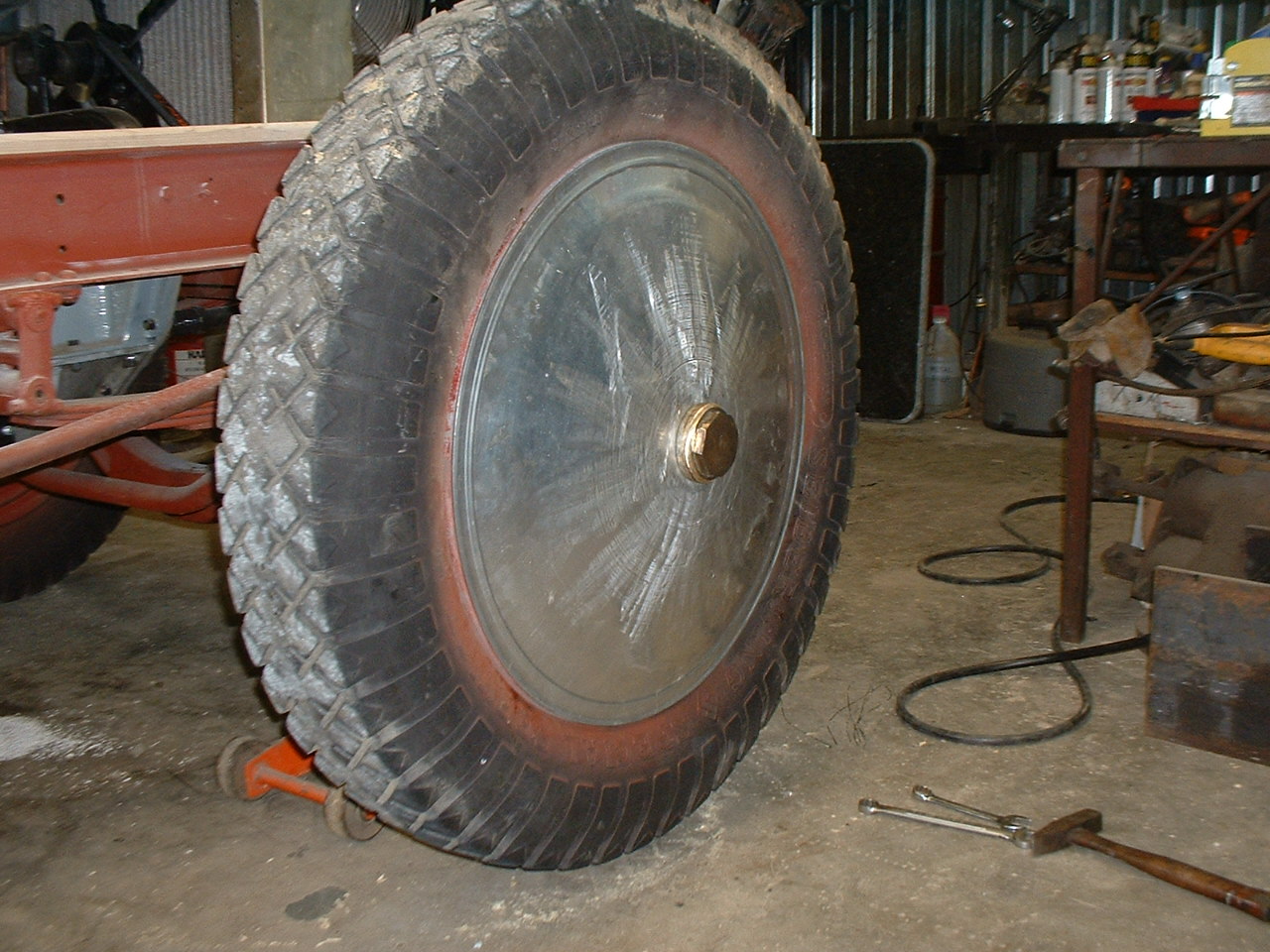

  23. yonahrr
    Posts: 1,348
    yonahrr
    Hubs

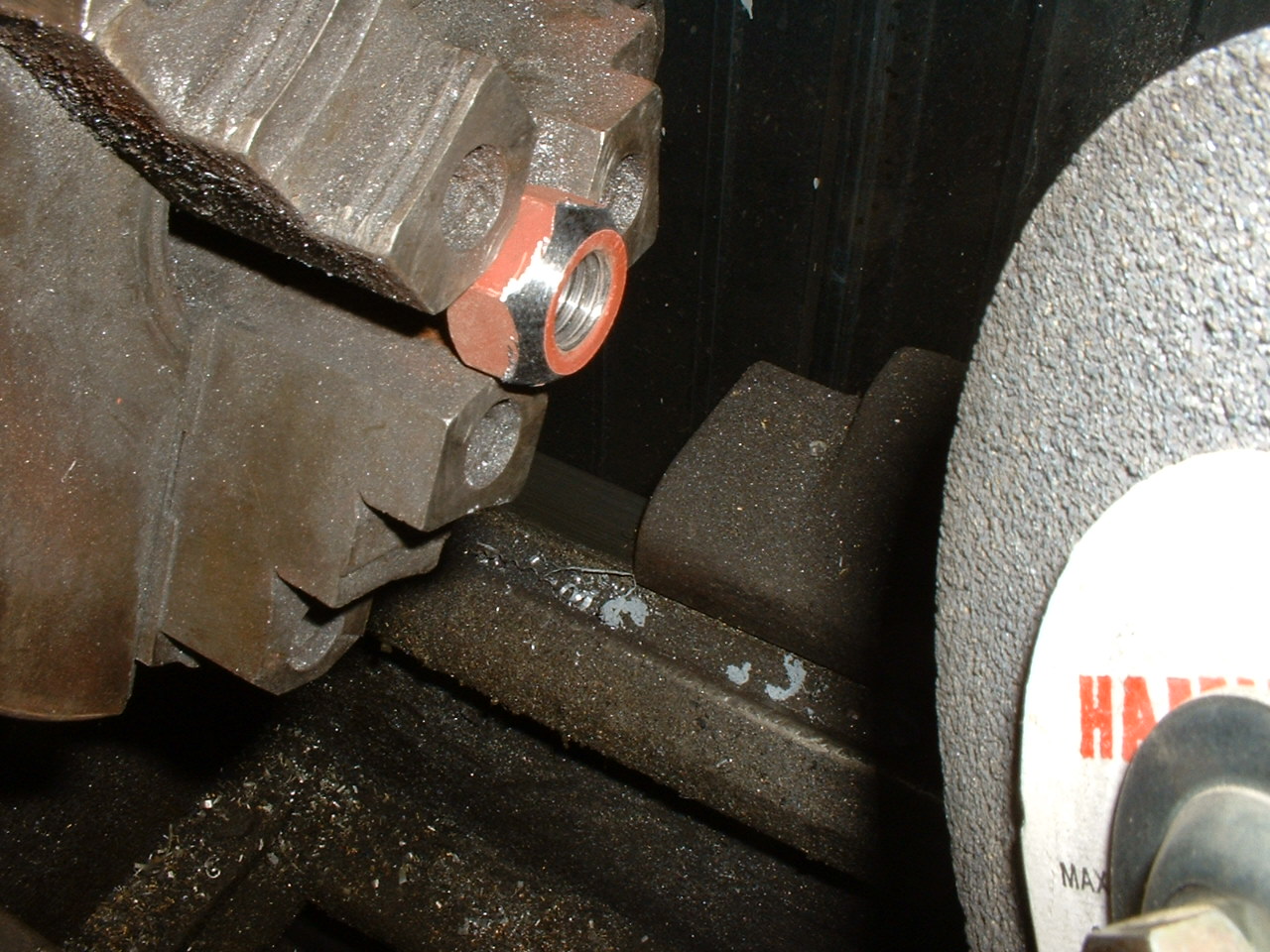

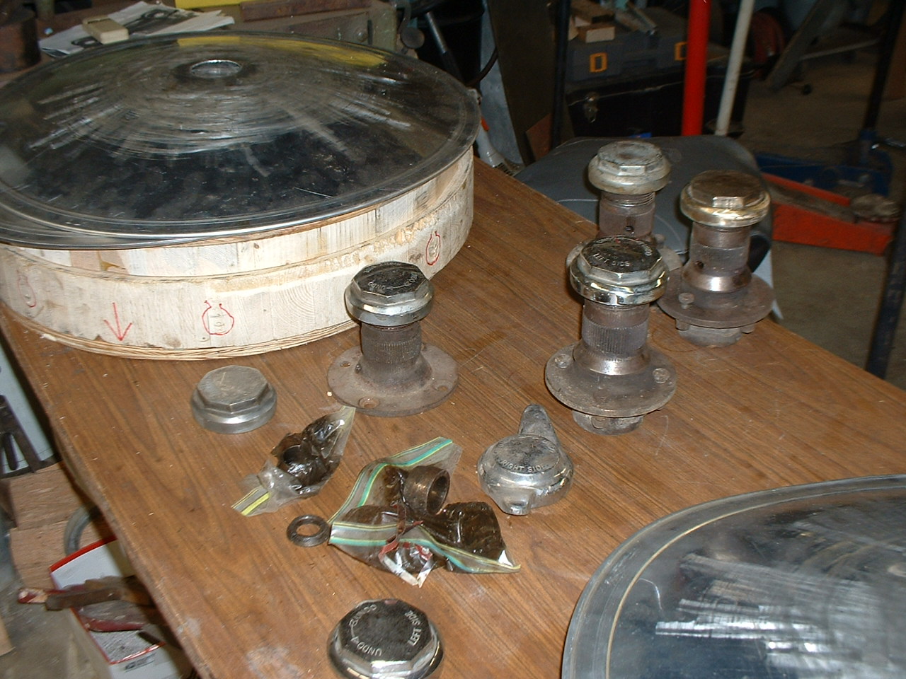

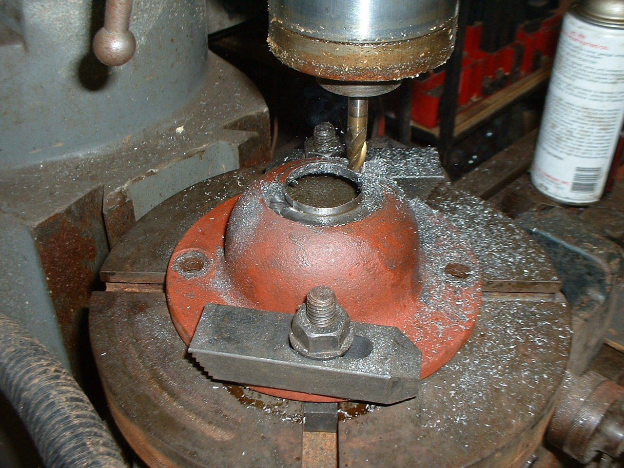

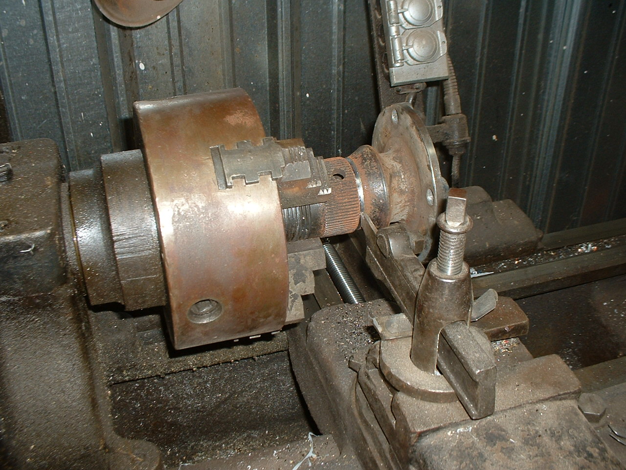

    I worked all day cutting off British wire wheel hubs and making holes in Seagrave bearing covers. I only got one front wheel semi done. No welding yet. The effect isn't too bad. I've still got to machine the chrome and lettering off the other knock offs (wrench offs?) and splice the threaded part of the hubs onto the Seagrave wheels. I think I'll electro-etch something in the br*** center cap--SS or Seagrave Special or Seagrave Fire Apparatus Co. or ???
    Jerry
  24. That's gonna look great! Are you going to polish the wheel discs or paint them?
    You must know someone at the MG junkyard! :D
  25. yonahrr
    Posts: 1,348
    yonahrr
    I'm gonna polish them, maybe put some clear on. I got the hubs and knock offs from ebay. I think they where about $35.00.
    Jerry

  29. paperdog
    Posts: 5,176
    paperdog
    Great
    hope that the size of these covers does not have the inertia to unscrew themselves on panic(best you can) stops
    gls = girded loin speedster
    emas= eviserated my *** special
  30. yonahrr
    Posts: 1,348
    yonahrr
    The right side has left hand threads and vice versa. Supposed to keep that from happening. Hate to read "Man killed by flying pizza pan."
