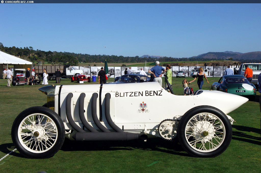

    I like the Benz exhaust as well. In fact, because it is not flowing smoothly into a cone makes it all the more interesting. As stated, somewhat more rudimentary, simple, functional.

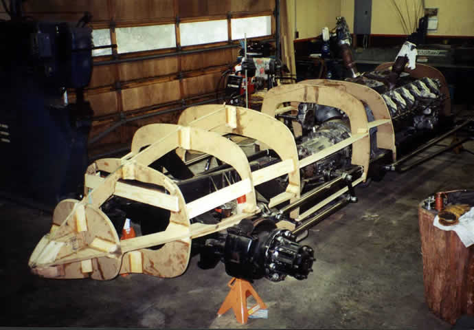

    Allan Tromblay Metalshaping did the body on Leno's car. He's retired now, and I bought some equipment from him.
    Cool Pics of the frame with the Buck on the ch***is.

  6. lakes style header with a cap and a take off to a single pipe ending in a fishtail....just to add a nod to hotrodding!!..IMHO...fantastic work by the way!!

    I am glad you had posted that pic McKee. I was envisioning heat sheilds on the exhaust, similar to a MC, but could not find a traditional reference. Flogging was sure to ensue. Not sure about the mesh, but perhaps solid stainless rod curved around the outside with runners down the center.

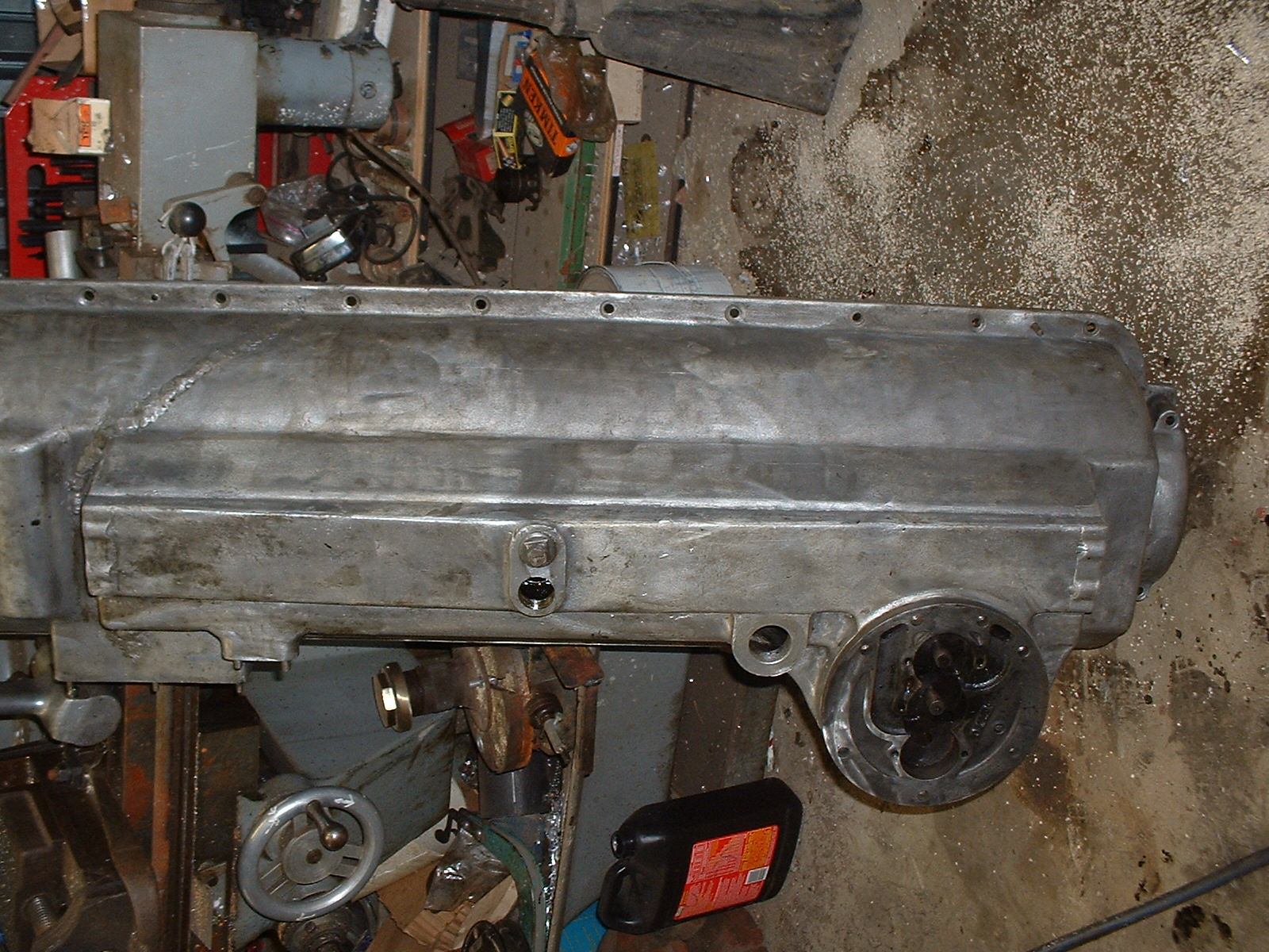

    Oil pan
    I spent Sunday cleaning the oil pan. This thing measures about 52 inches long. It was a nasty, filthy mess. When I pressure washed it black 40 or 50 year old sludge went everywhere and it was still dirty. I went through 3 cans of oven cleaner hosing it down in between. That got rid of the loose crud. Then I went over it with a wire brush on a die grinder. I've still got to clean it one more time with mag cleaner and water. Anyway, you can see the oil pump is built into the pan. The pump fills the dipper troughs with oil through a hole in the bottom of the trough. The tubes sticking up fit directly into the main bearings. A small spring loaded leather washer seals the tubes. That's the oiling system.

    I pondered my exhaust all weekend. The ready made mandrel bends have too small a radius to suit me. They are very expensive also. Then I remembered that thinwall electrical EMT--2 inch--has ready made bends (very close to mandrel bent) so I went to Home Depot and bought one for examination. It's galvanized, so that's bad, but I think I can grind that off to weld it. Other than that I think they'll be perfect. Imagine 6 pipes like the one in the picture going down to an 5 foot long, 8 inch diameter muffler somewhere below the frame. What do you think?

    I went to Home Depot and they only had one bend. I suppose there's not much demand for these things. Tomorrow I head to the electrical supply about 30 miles away. I live in a small town. I may even buy some 45's. I was thinking about the exhaust on the Blitzen Benz. One thing for sure--the muffler's got to hang off the frame and I've got to put a conical front on the muffler. Wait, that's two things.
