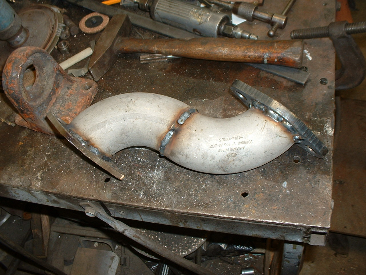

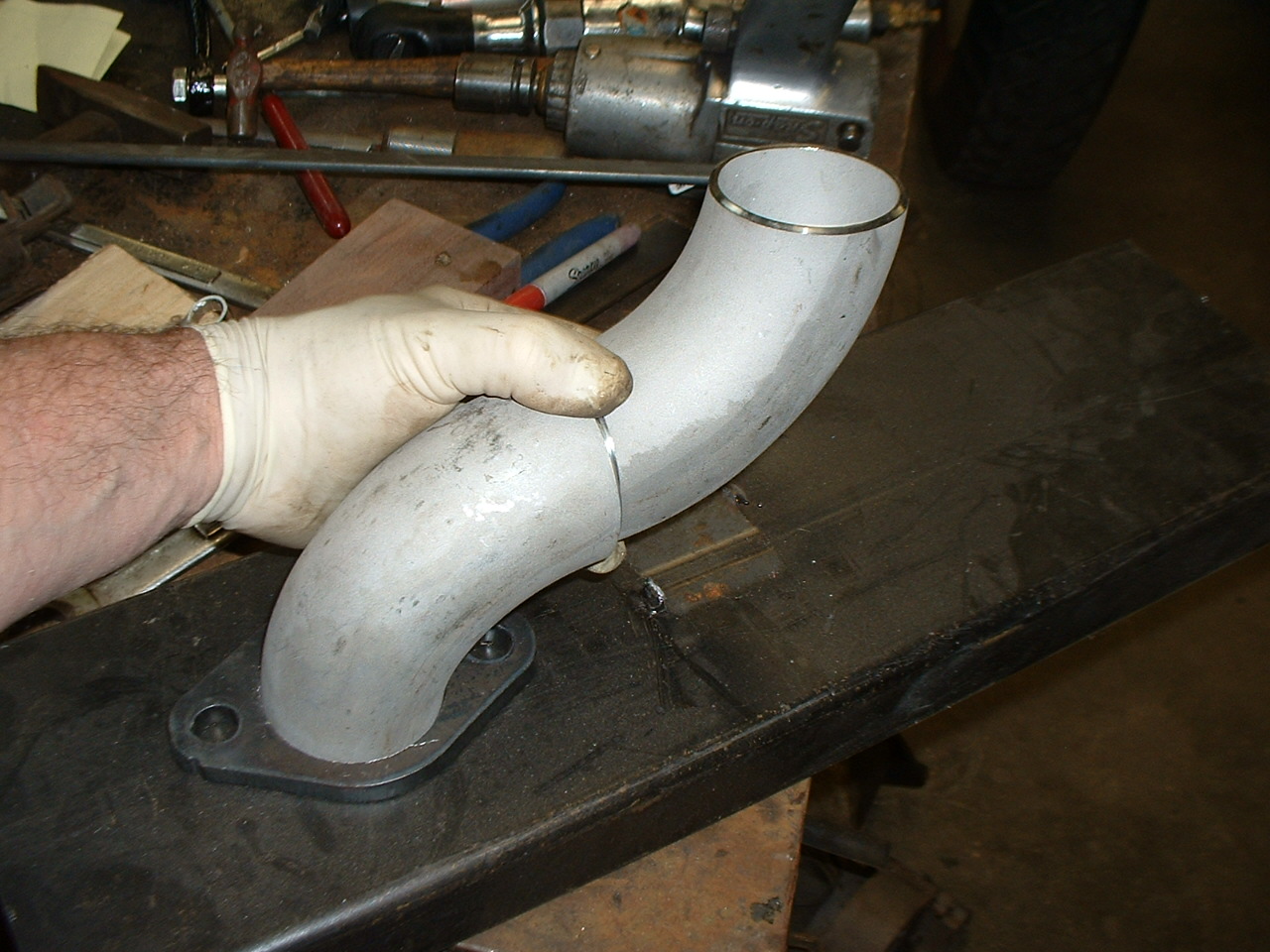

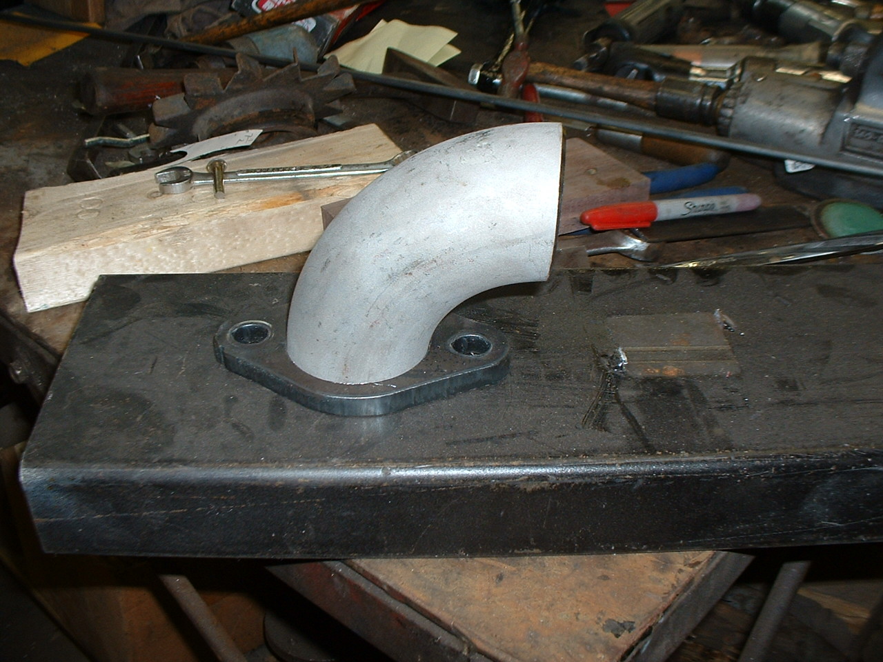

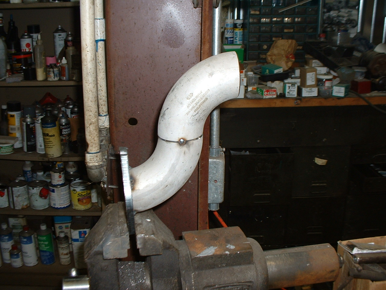

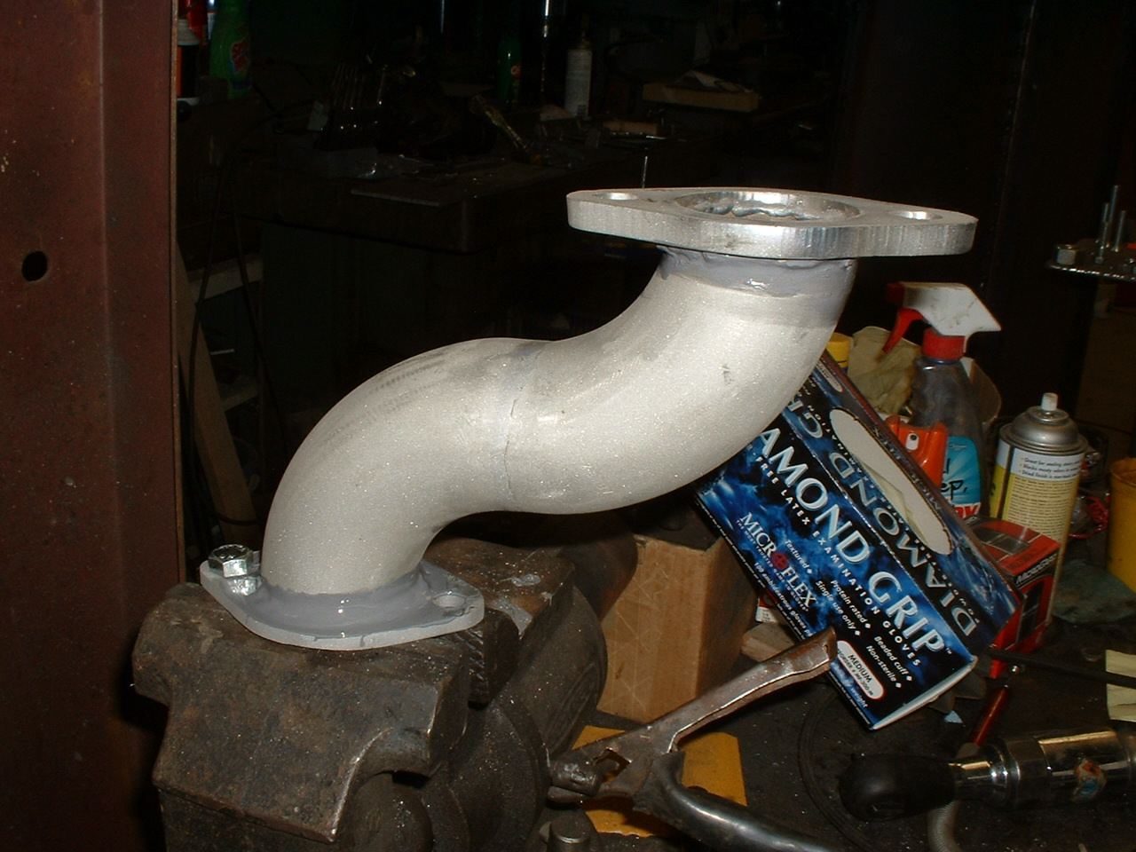

    I worked on different things today. One was a new mounting pipe for the carb. I had it attached directly to the intake, which worked fine but made the carb interefer with the throttle and advance controls at the bottom of the steering box. There a neat set of levers and gear that attach through the steering box and shaft to controls in the middle of the steering wheel. I would have taken a picture but my card was full. That's another thing. Like my son, my computer has been down with a virus. He's recovered but the computer has not. TDSS Google Redirect. A nasty bit if work. So I've forced to use the wife's computer. Jack, if you get a chance could you post a picture of the steering wheel controls as well as the setup on the bottom of the steering wheel. Some of my pieces are missing. Thanks.
    Jerry

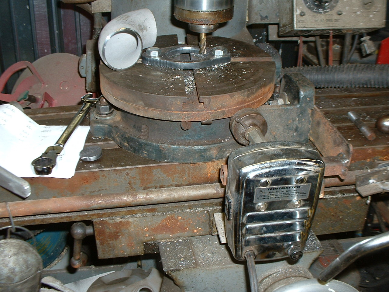

  13. I love the redneck rotary table
  14. yonahrr
    Joined: Feb 27, 2010
    Posts: 1,348
    yonahrr
    Toastmaster comes though. Goes with the pizza pans, no?

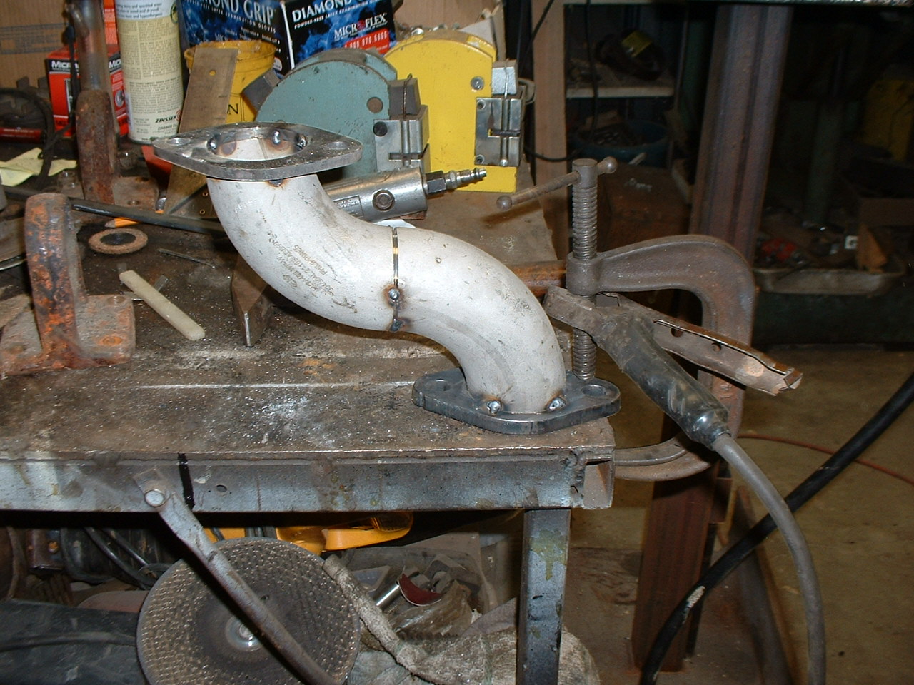

    Carb Mount
    I cleaned up the shop most of the day. The only progress on the Seagrave was welding up the new carb mount and going to the store for two 7/16 studs. Well, I did cut down my son's Red Ryder BB gun because a rusty BB got stuck in the barrel, but that doesn't count. He liked it though.
    Jerry

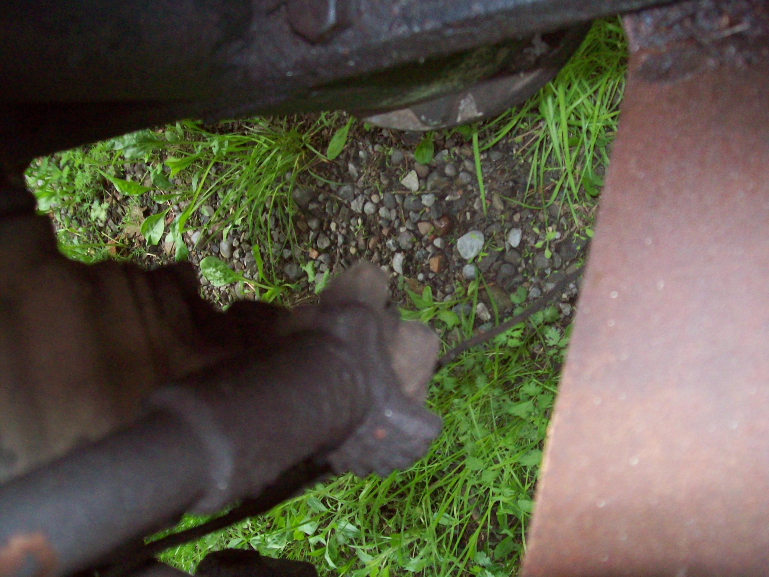

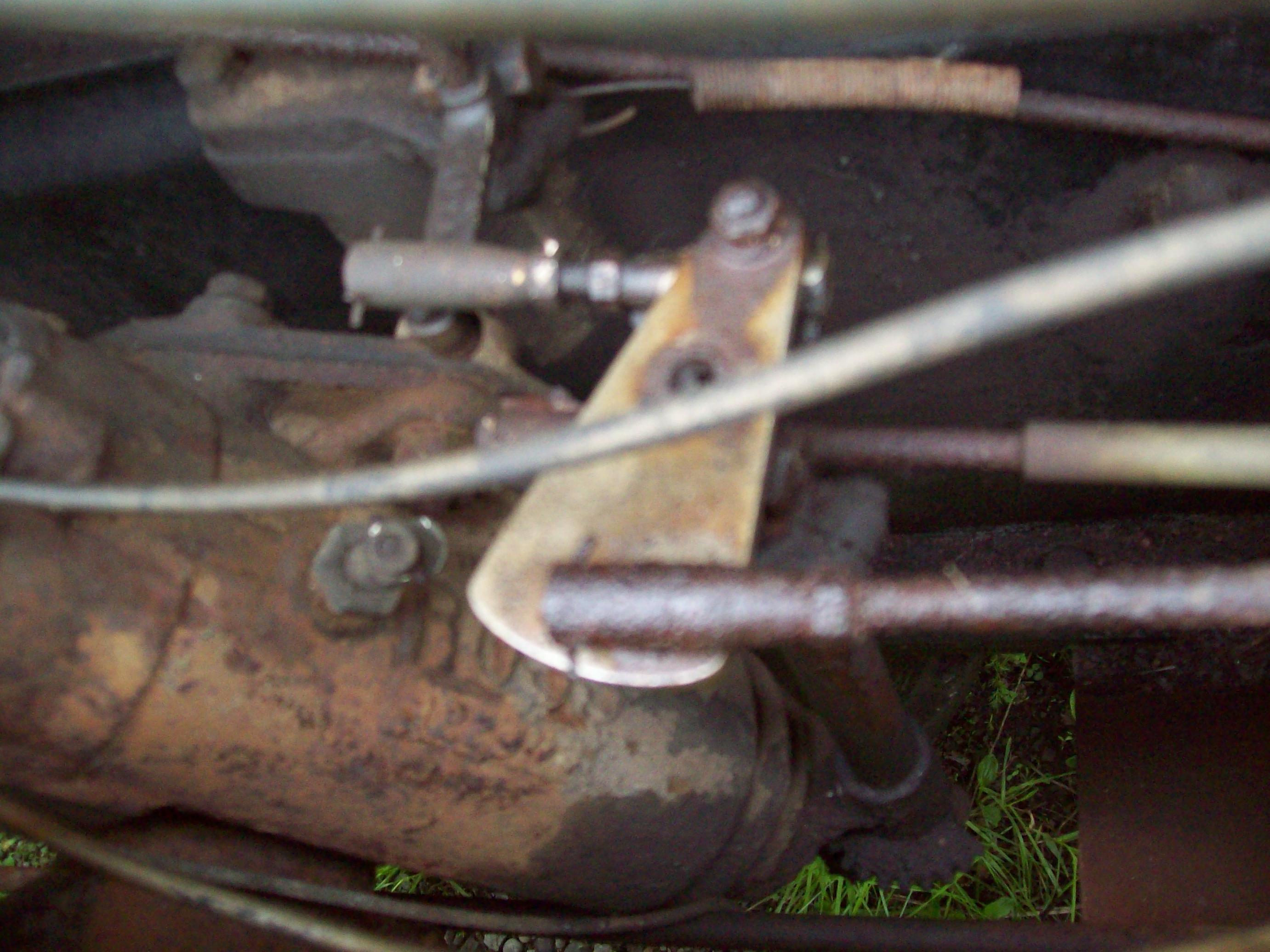

  17. Jack Innes
    Joined: Nov 26, 2010
    Posts: 178
    Jack Innes

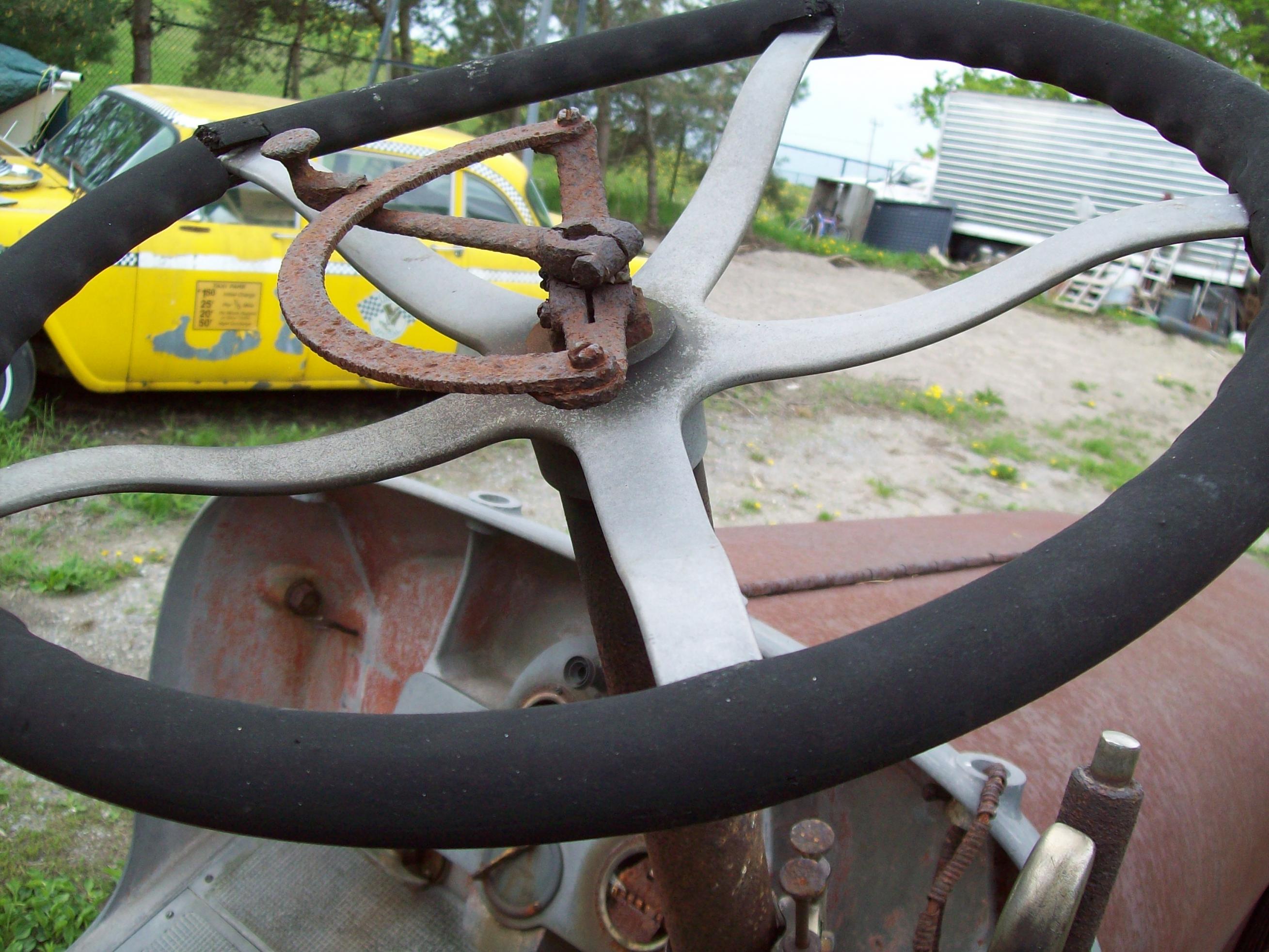

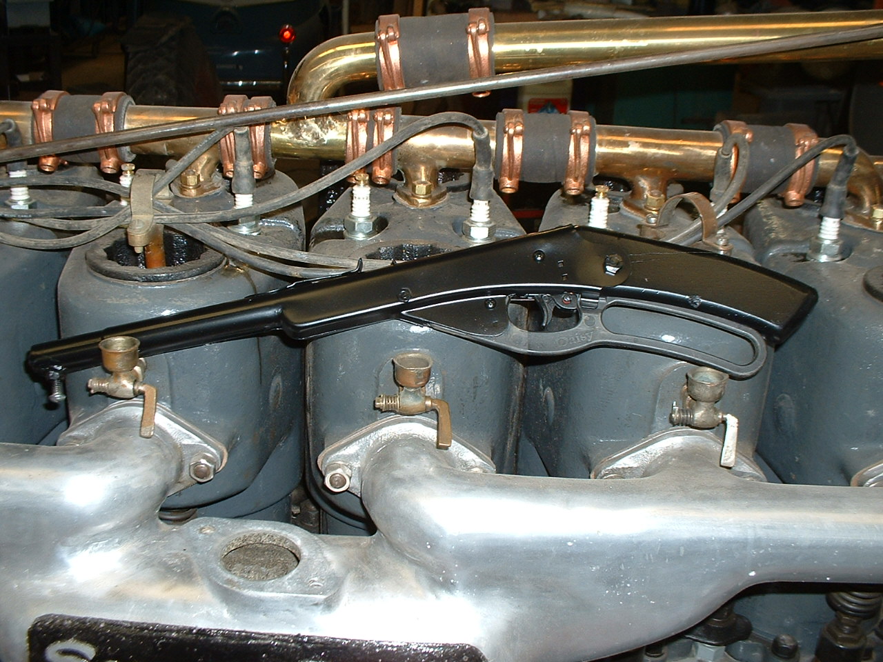

    Jerry,
    Here are some pictures of the steering column controls. The lever in the wheel controls the spark only. Both the magneto & the distributor are connected to it.
    The hand throttle & the choke are controlled by cables with knobs half way down the steering column.
    If the pictures are not enough I can go under the vehicle & try to get better shots -- when it stops raining!
    Jack

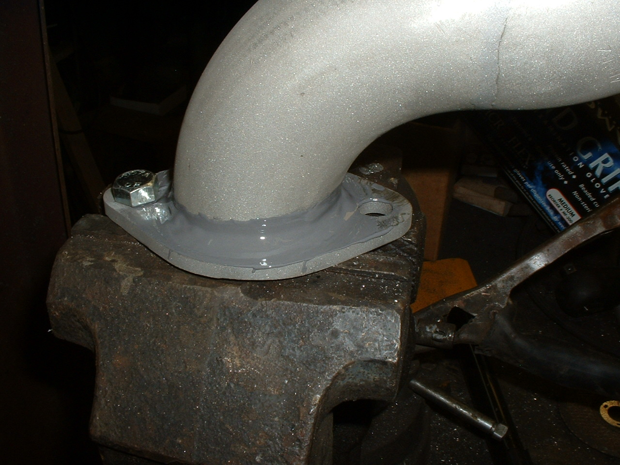

    I ground off the welds on the carb mount then bead blasted the whole thing and put some JB Weld on it to make it pretty and seal off any pin holes.

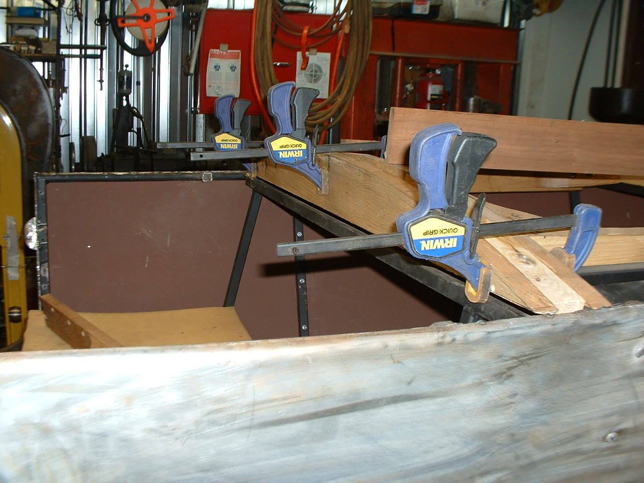

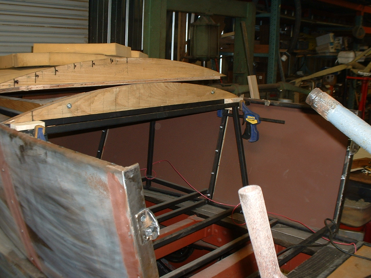

    After that I modified the seat back to give me a bit more room. I've still got to redo the wood. Also the traveling paint guy is coming tomorrow to show me his wares. I'm thinking epoxy primer on the body then begin the bondo work.
    Jack, thanks for the pictures. Your steering set up is a bit different from mine. Mine has two controls on the steering wheel, but it also has two cable controls on the steering shaft. Hey, what are you going to do with your Seagrave? It's looking like speedster material. :)

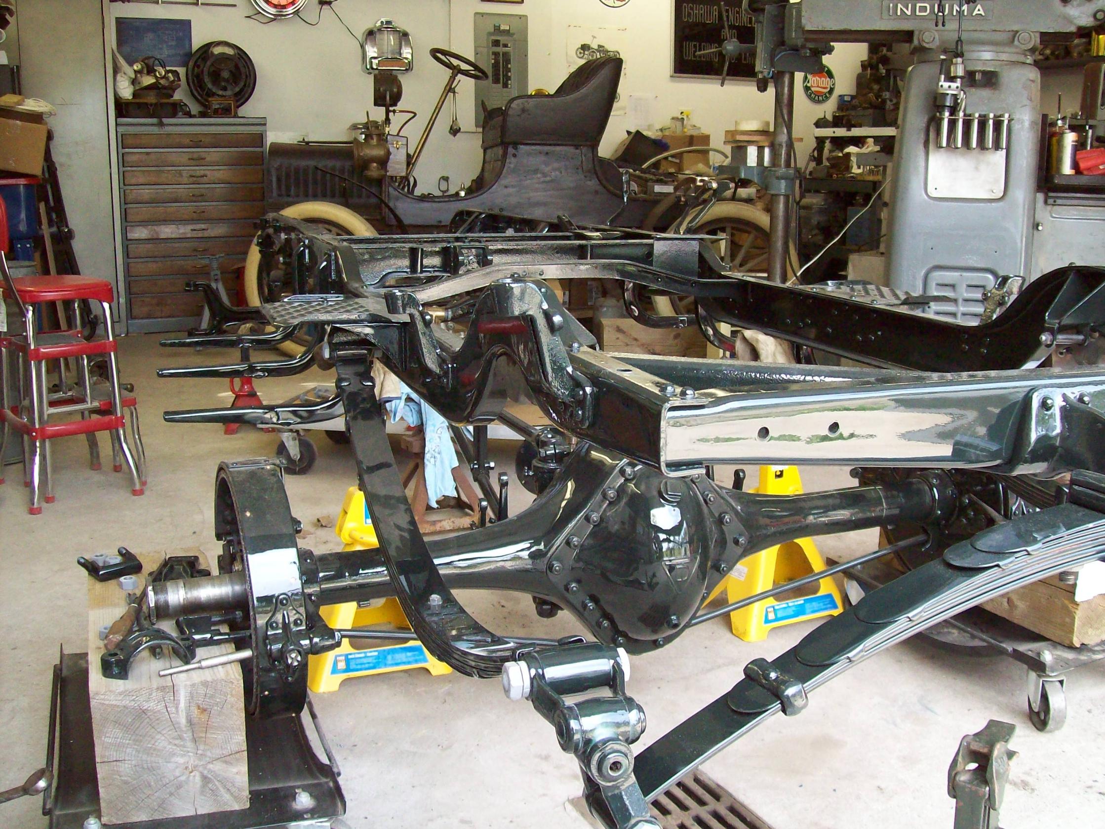

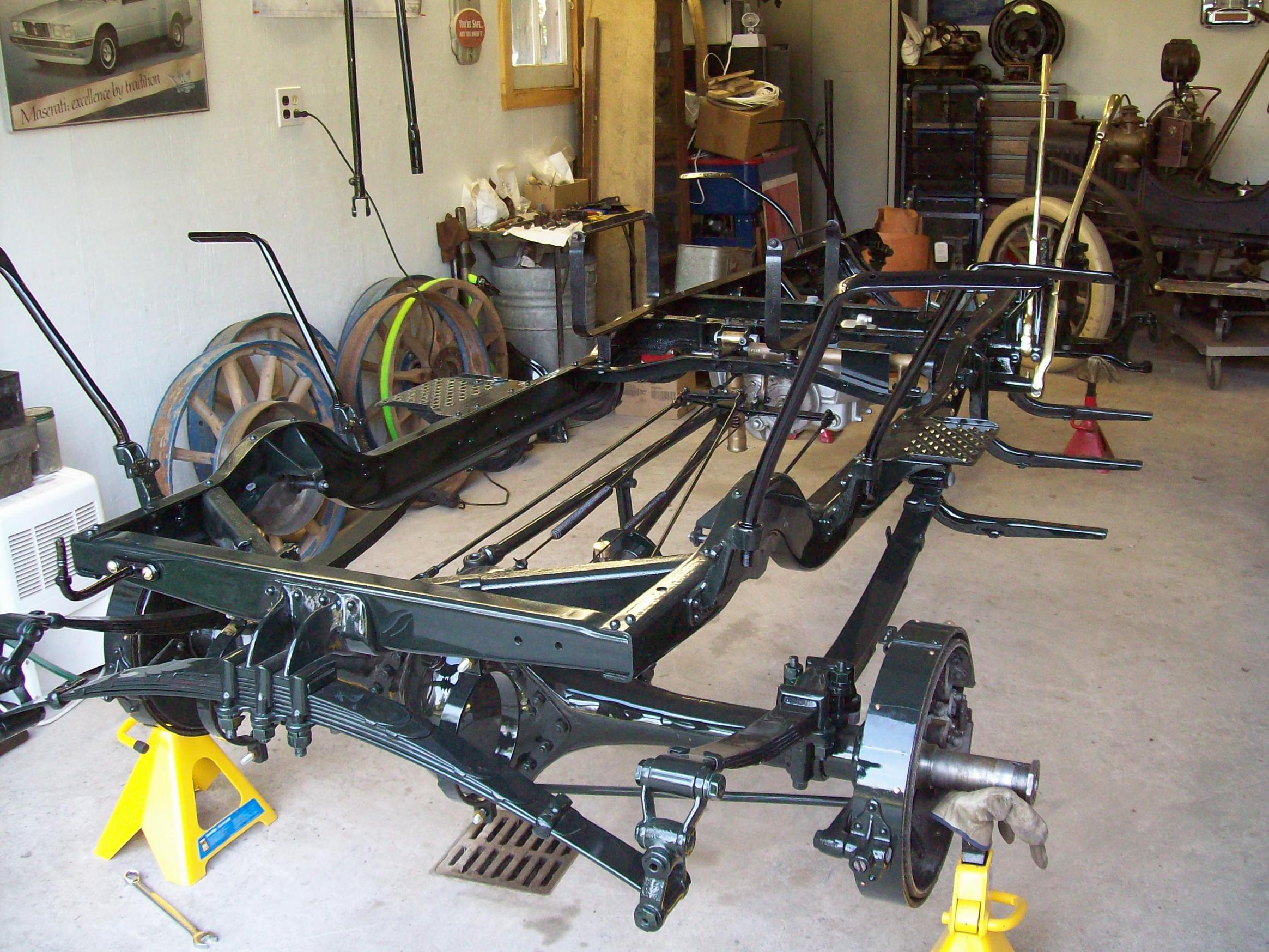

    I am not sure what to do with the Seagrave. I bought it because the engine was so neat but being a hook & ladder truck it is a really interesting unit as a whole. Restoration would be fairly easy since there is no tin work beyond 4 fenders & the hood. Everything else is heavy iron. It is not near the top of the list of projects. Its future depends a lot on me being able to pry a load of the correct wooden ladders out of the Toronto Fire Department warehouse.
    I just had the frame & ch***is parts painted for the 1911 Cadillac. It was all sand blasted then primed with epoxy primer then several times with "Feather fill" primer which is a high build primer that sort of foams up as it dries. The top coat is RM polyurethane enamel. This paint can be buffed & ends up just like laquer & does not look "milkey" like buffed base-clear. Two men spent the better part of 2 weeks at the body shop preparing it for paint. Every nut, bolt & part was painted separately (including all 35 spring leaves). I am now in the process of putting it all back together --- again.
    Jack

    Jack, that ch***is looks beautiful. You have to tell me the secret of how to put the nuts and bolts together so the paint doesn't chip or crack. I always have problems with that.
    Jerry
  21. Jack Innes
    Posts: 178
    Jack Innes
    Jerry,
    There is a secret to the nuts & bolts. Look carefully at the left picture & you will see the shackle bolts etc. are in primer. On the right, a later picture, they are green. Epoxy primer will take quite a bit of abuse in ***embly, then you (very carefully) paint the fasteners with a brush once everything is tight.
    Riveting the brake linings to the painted bands was a little traumatic though - the rivets are solid copper as the originals were.

    Beautiful work, and nice 'stuff' in your shop. Now that is a suspension that can articulate. What prevents those shackles from collapsing, for example if you were to lift the ch***is by the center of the rear buggy spring?
  29. Jack Innes
    Posts: 178
    Jack Innes
    There are two heavy leather straps that go around the axle & go through a fitting on each side of the frame to prevent too much travel downward if the car was picked up as you described or if you go over a dip in the road too fast. Shock absorbers do this function in newer cars. The shackles do not collapse but there is a real danger of breaking the springs in such a situation.
    The new straps will be ready at a harness maker's shop next week.
    Jerry, you might consider shocks or rebound straps on the speedster now that the springs have been lightened up.
    Below is the axle on a 1911 Cadillac near Chicago;
