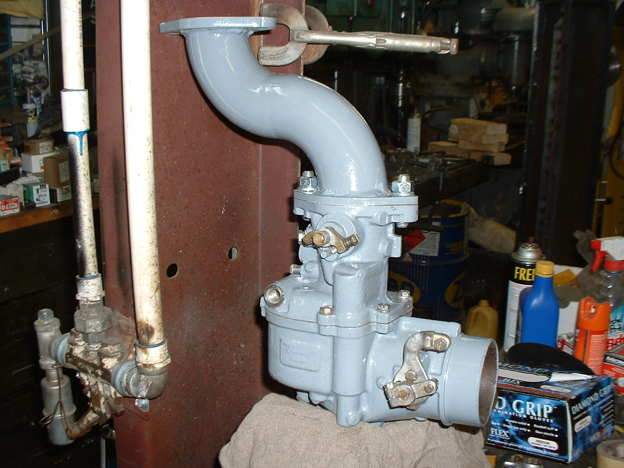

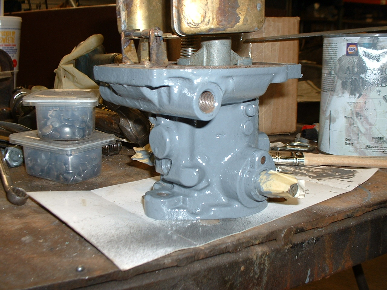

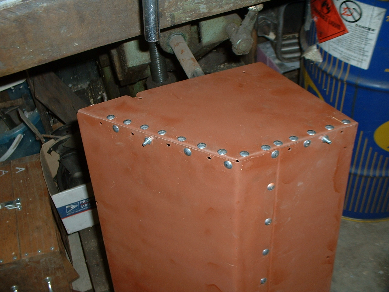

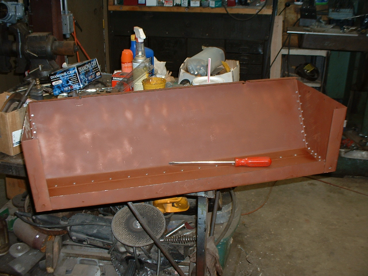

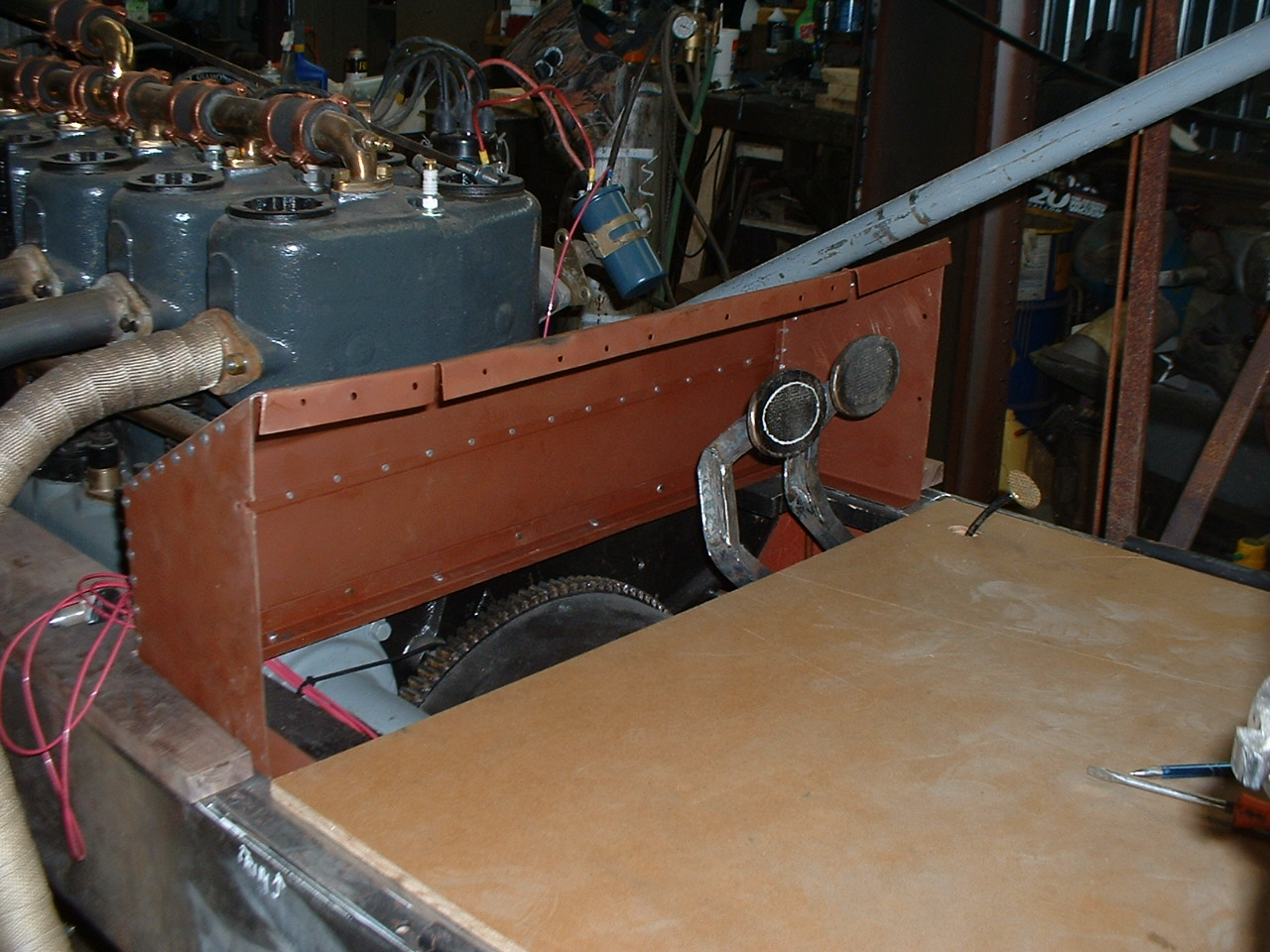

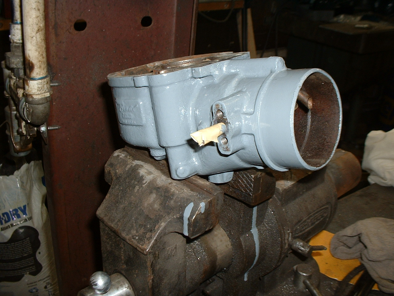

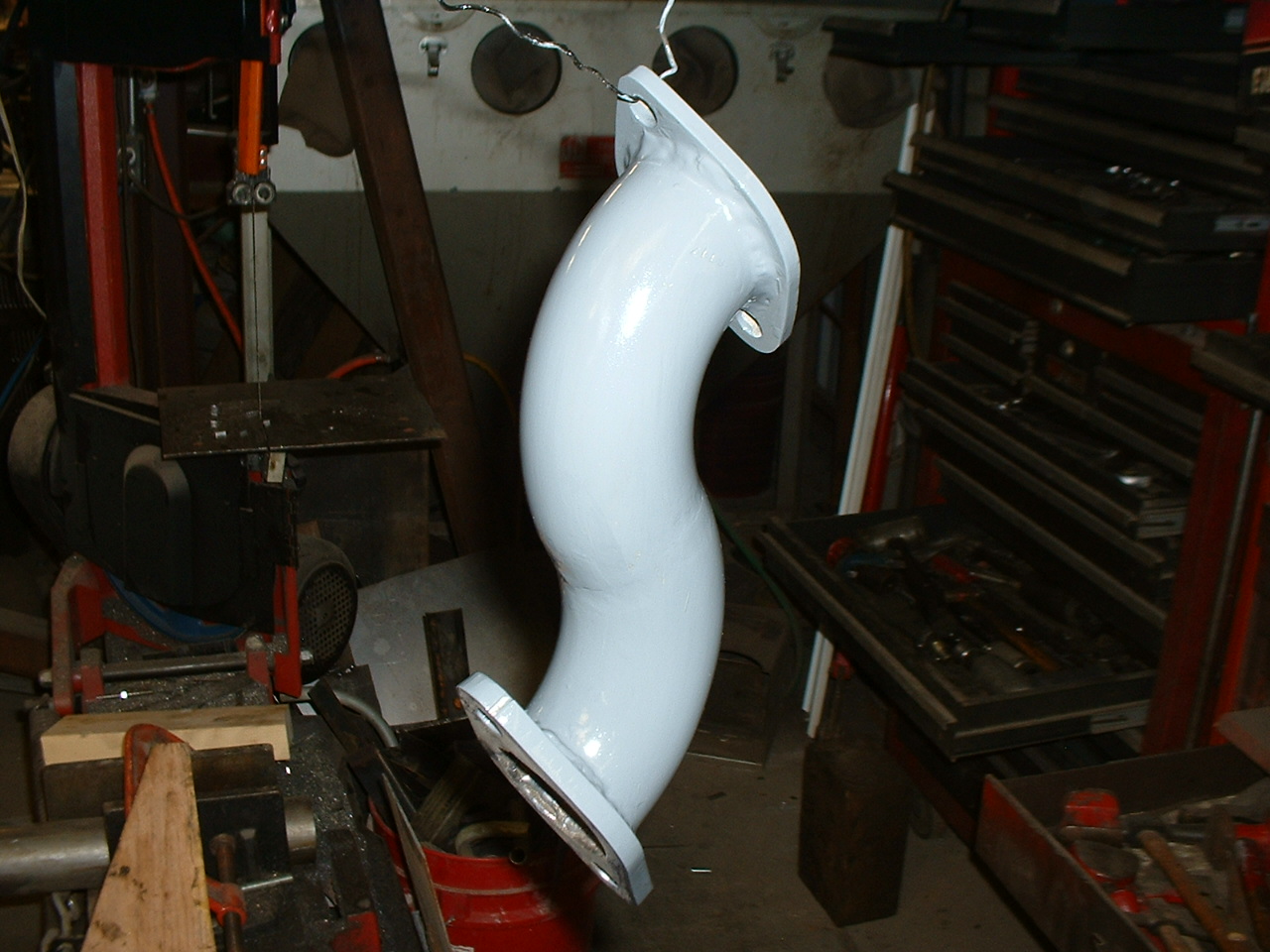

    More Misc.
    I partially dismantled and painted the carb and mounting pipe. Next, I began riveting the foot well together. I like rivets. There's something about such elementary fasteners. Just one step up from a nail. Aluminum and copper rivets are especially gratifying to bash with a hammer. I'll hang the carb and pipe tomorrow. Then I'll have to rework the linkage and fuel line.
    Jerry
  2. Are you leaving the exhaust wrap just on #6 pipe just to annoy me?:D
  3. yonahrr
    Joined: Feb 27, 2010
    Posts: 1,348
    yonahrr
    Muahhh!! My plan is working!

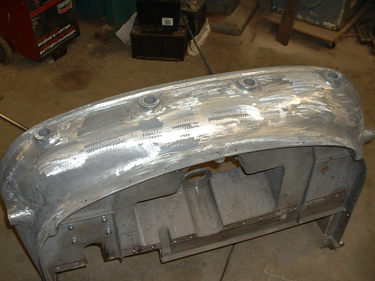

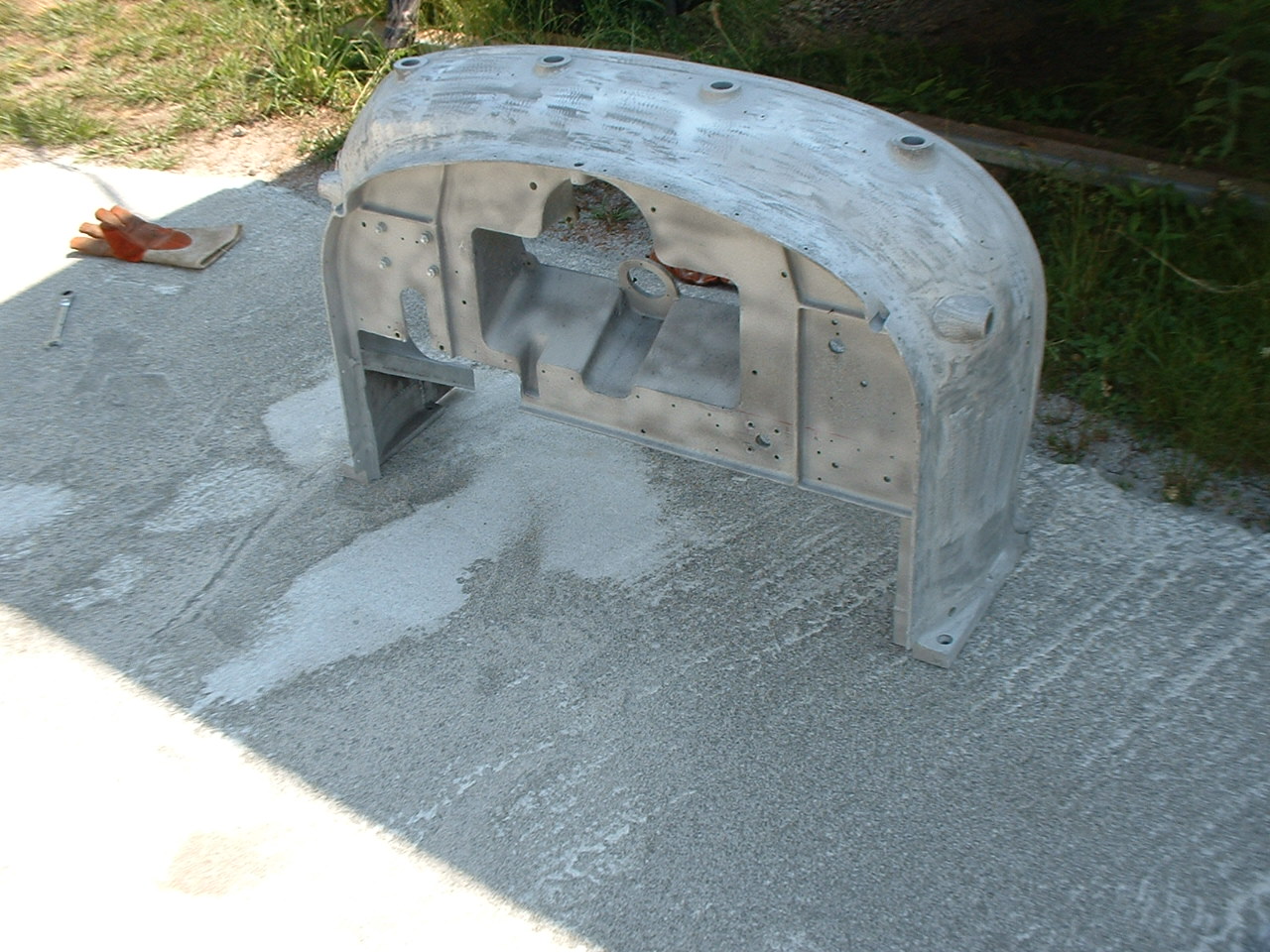

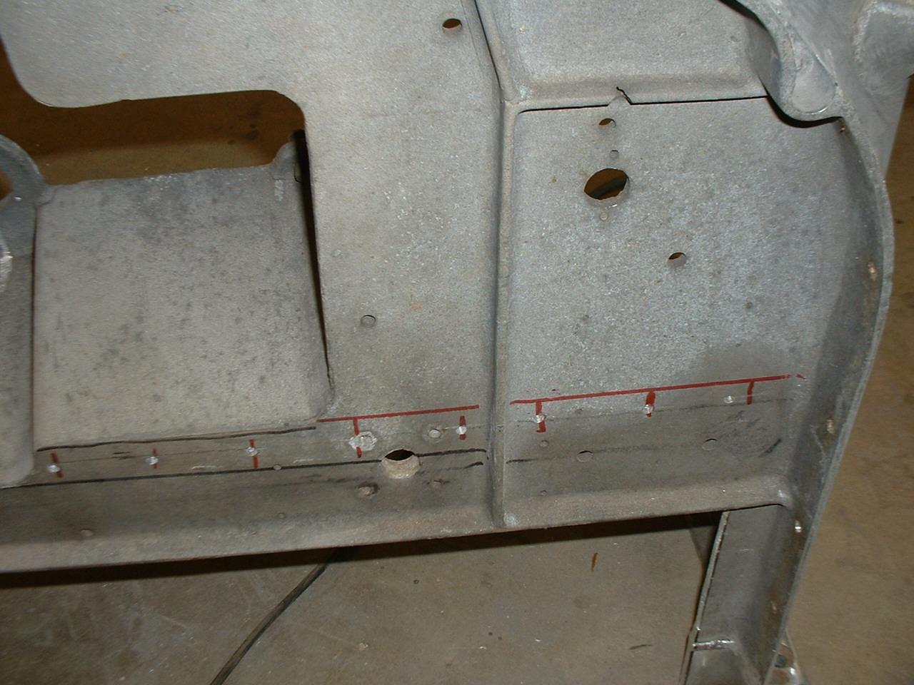

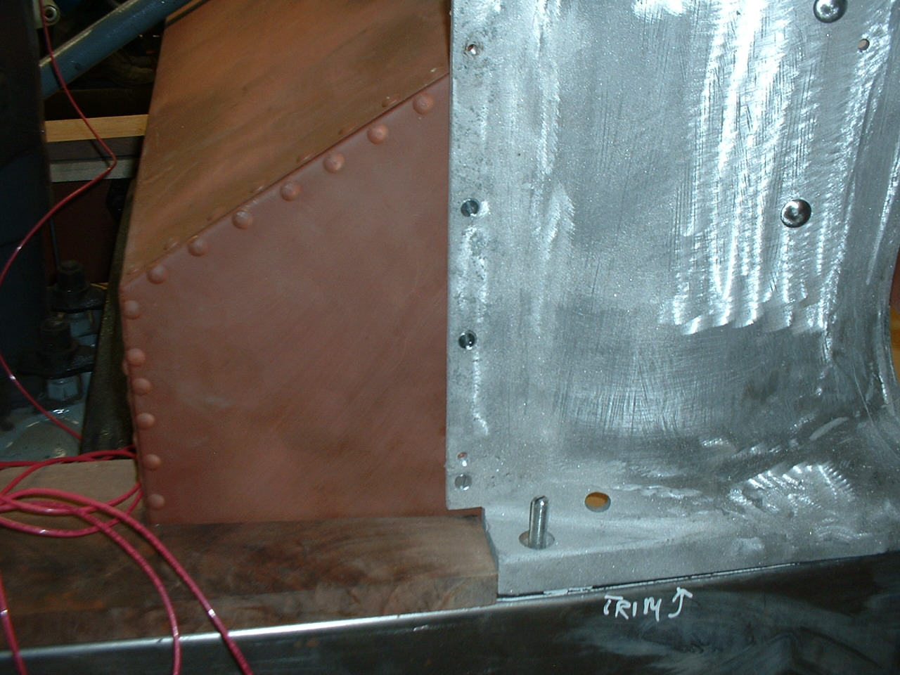

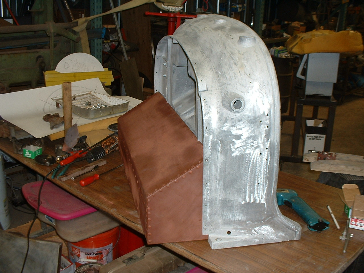

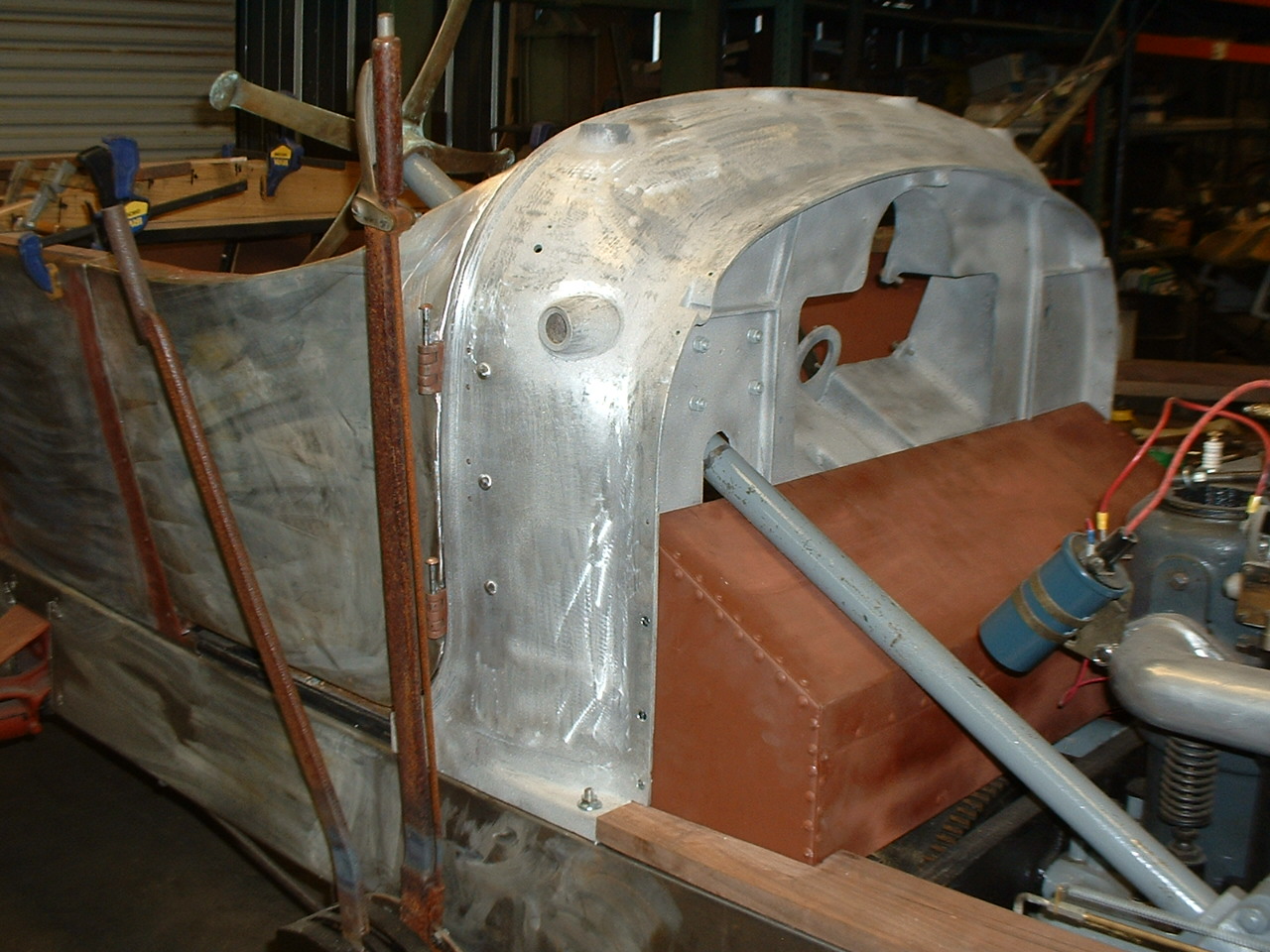

    Cowl
    I bolted the carb back together but I was missing some 3/8 NF nuts so I began on the cowl. I started by grinding off the welds where I lowered the cowl then I began on the corrosion. The corrosion came right off but it was tedious work. After I finished the outside, I looked inside. No way I could grind that off. Then I remembered the $35 dollar Chinese sand blaster I bought last year at a flea market. Now to track down some sand.

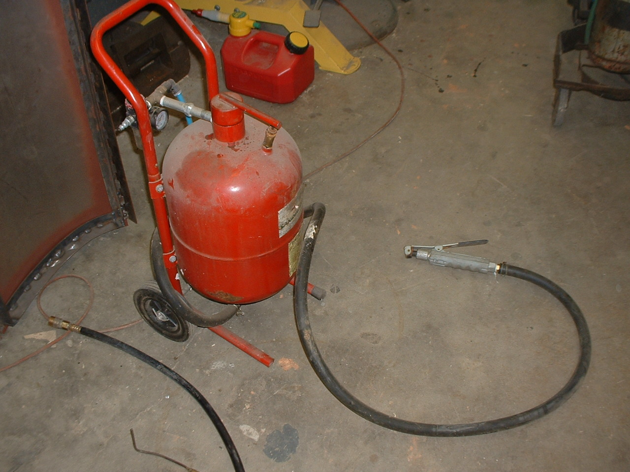

    Sandblasting
    We swam, we cooked out, we said a prayer for our fallen comrades and now it's time to get back to work. Over the holidays they had another flood at the Yonah Station. A woman sat on the toilet, the toilet tipped, the feed pipe snapped off inside the wall and water came gushing out all over the floor. Luckily there was a plumber there and he shut off the water outside. So I had to cut short work at my shop to fix plumbing. I did manage to get the cowl sandblasted. The traveling paint guy sold me some epoxy primer. In my day you ground the sheet metal with 60 grit, wiped on and smoothed the bondo, then you sprayed everything with lacquer primer. No more, they tell me. DA with 80 grit, spray with epoxy primer, THEN wipe on the bondo. Okay! So I had to get the corrosion off the cowl--hence the sandblasting. I learned a lot about sandblasting too. Don't do it when it's 90 out. I was sweating like a pig. Took two large Mcdonald's sweet teas to rehydrate. (Cheap @ $1.07 each) Next project, remove all the sheet metal for sanding and painting.

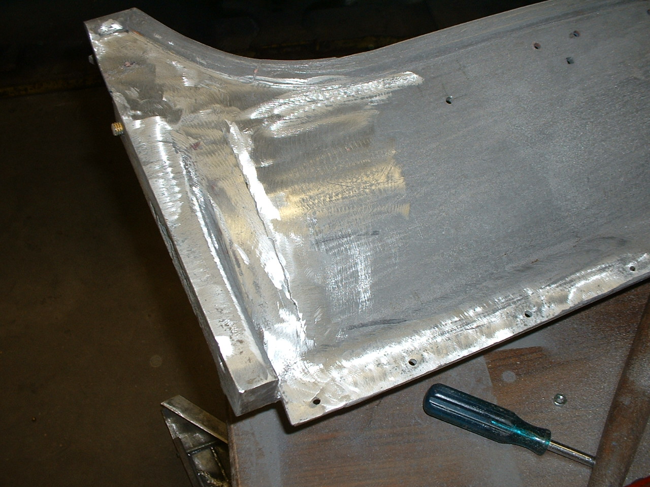

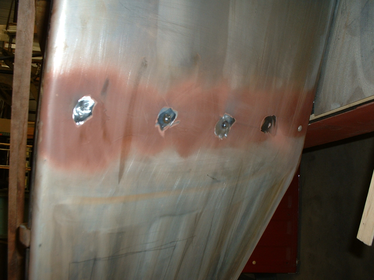

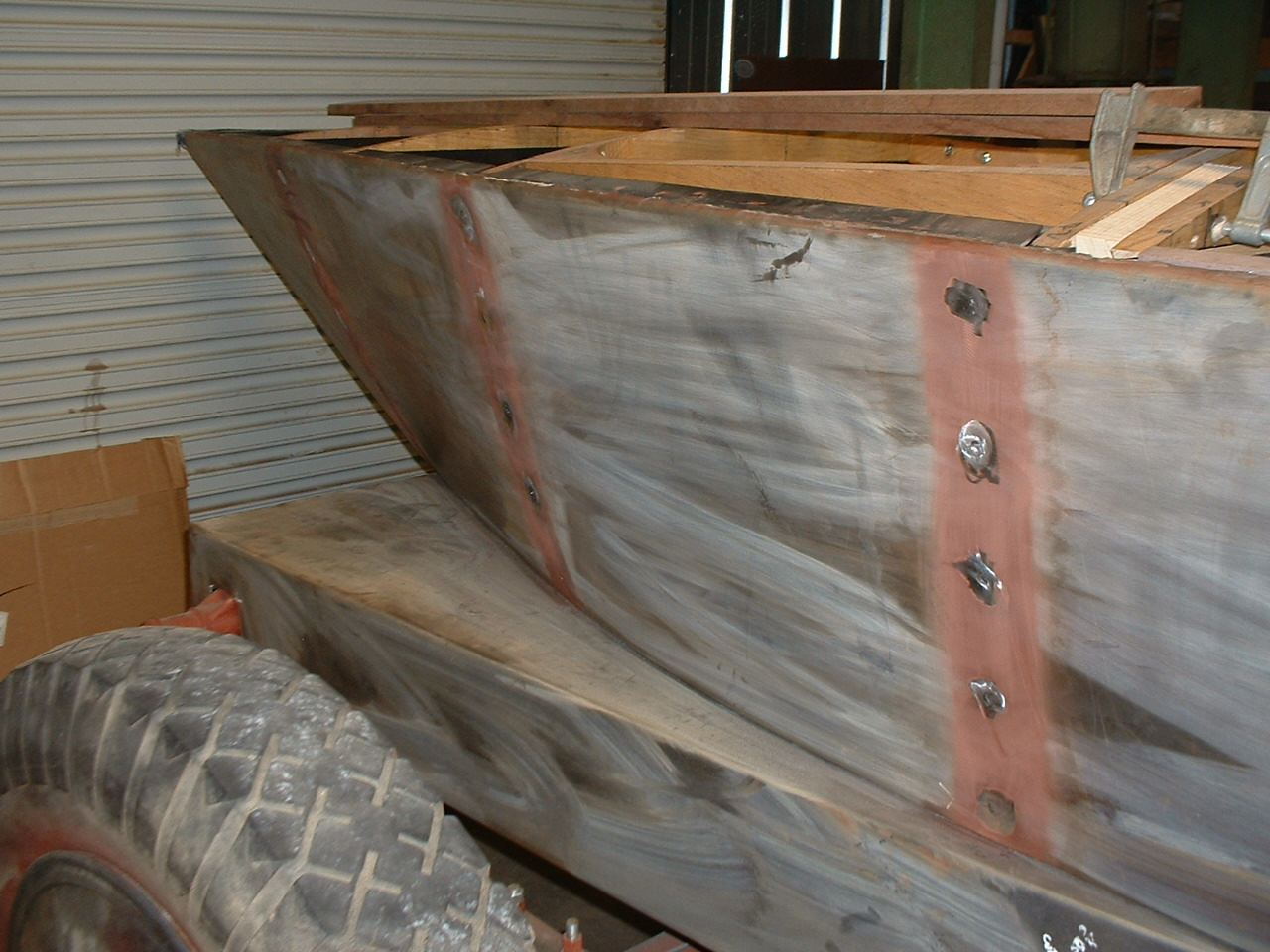

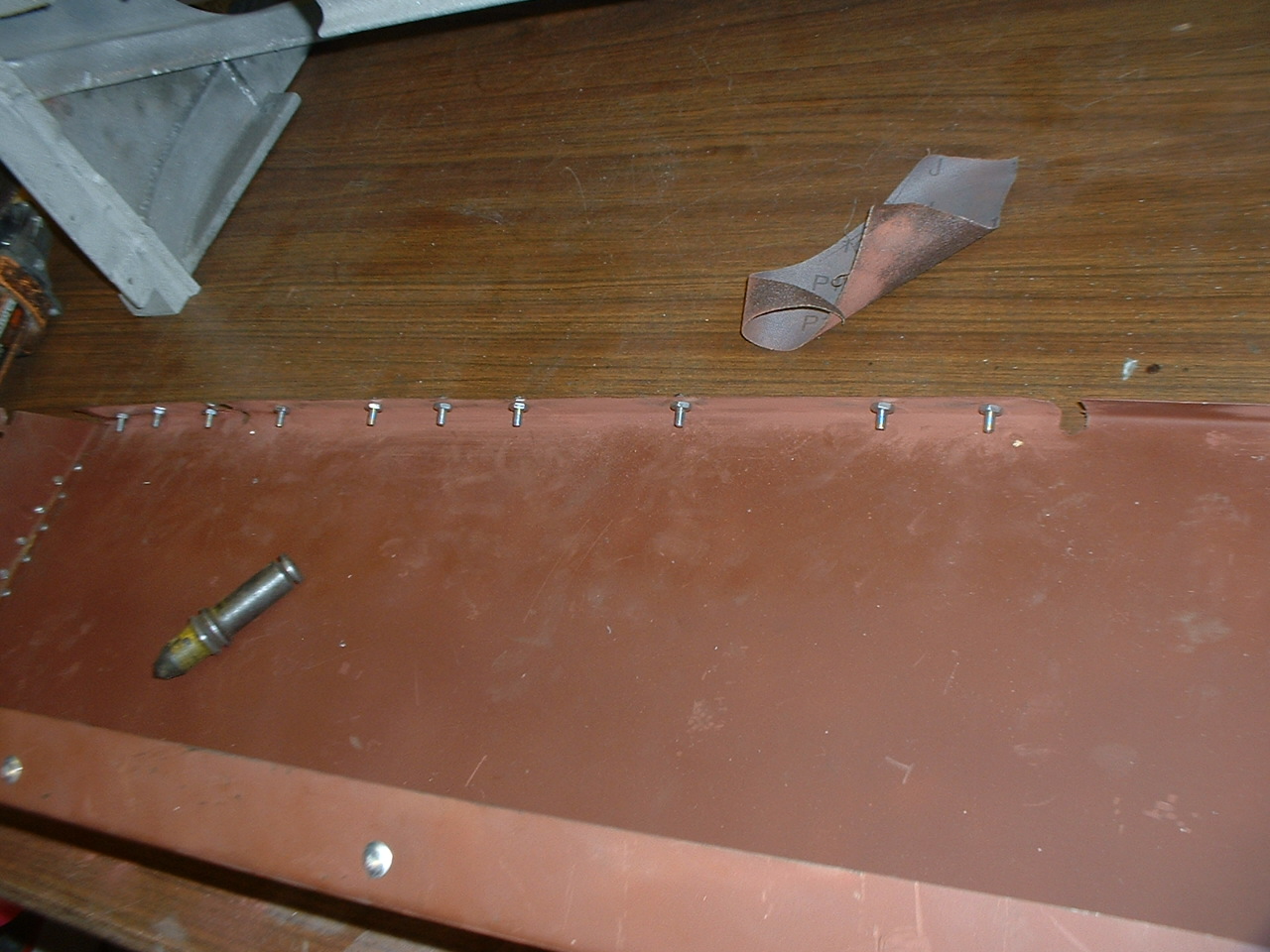

    Away with the rivets.
    I like rivets. I thought they'd look neat on the side of the body, and they did. But they're going to be a pain when it comes to body work. The body didn't turn out as smooth as I'd hoped. And one thing for sure, you can't put rivets over bondo. So I took them all out by welding threaded rods to the outer skin. Is that unconventional? I told you, I make it up as I go. It took most of the day, but I think it'll make the body work easier. I worked a little on the footwell too by welding nuts to the sheet metal so it'll be easier to attach to the cowl. Easier is gooder. I'm getting close to priming the sheet metal so I've got to clean up a bunch of loose ends. You don't want to be welding on expensive epoxy primer. That's what traveling paint guy told me.
    Jerry

    Leaving stuff raw/unfinishedwhere rivits and materials meet is swell... Just hilites your cleverness
  10. Jack Innes
    Joined: Nov 26, 2010
    Posts: 178
    Jack Innes
    Jerry,
    I have found that you can turn the heads of hex bolts to look like rivets & use them where you are going through bondo or where distortion is going to be a problem. They usually tighten up without turning if the threads are clean.
    It is easy to grind a cutting bit the right shape if you need to make a lot of "rivets".
    Jack
  11. yonahrr
    Posts: 1,348
    yonahrr
    I usually polish up a carriage bolt head, but I like your thinking.

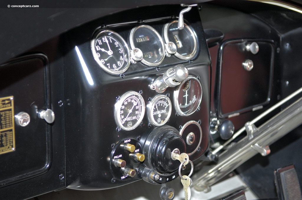

  14. Jack Innes
    Posts: 178
    Jack Innes
    Jerry,
    Have you ever looked at the dash in a teens Pierce Arrow? Lots of instruments & a couple of glove boxes. The shape of the cowl is almost like yours - even made of cast aluminum.
    I am sure you need an altimeter, turn & Bank indicator, comp***, etc.!

  18. 64 DODGE 440
    Joined: Sep 2, 2006
    Posts: 4,436
    64 DODGE 440
    from so cal
    Love the br*** on the first one, but the second one's contours are better. Looks more vintage having the panel with different levels.

  20. Jack Innes
    Posts: 178
    Jack Innes
    Jerry,
    I would agree on both the br*** & the contoured dash. I bet you could find that shape in the sump of an oil pan at your local big truck wreckers.

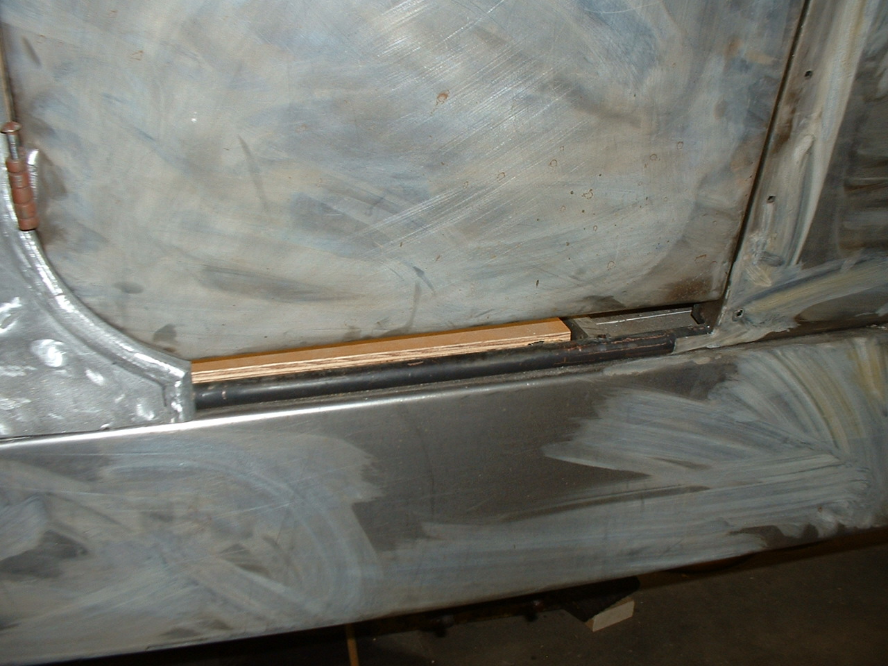

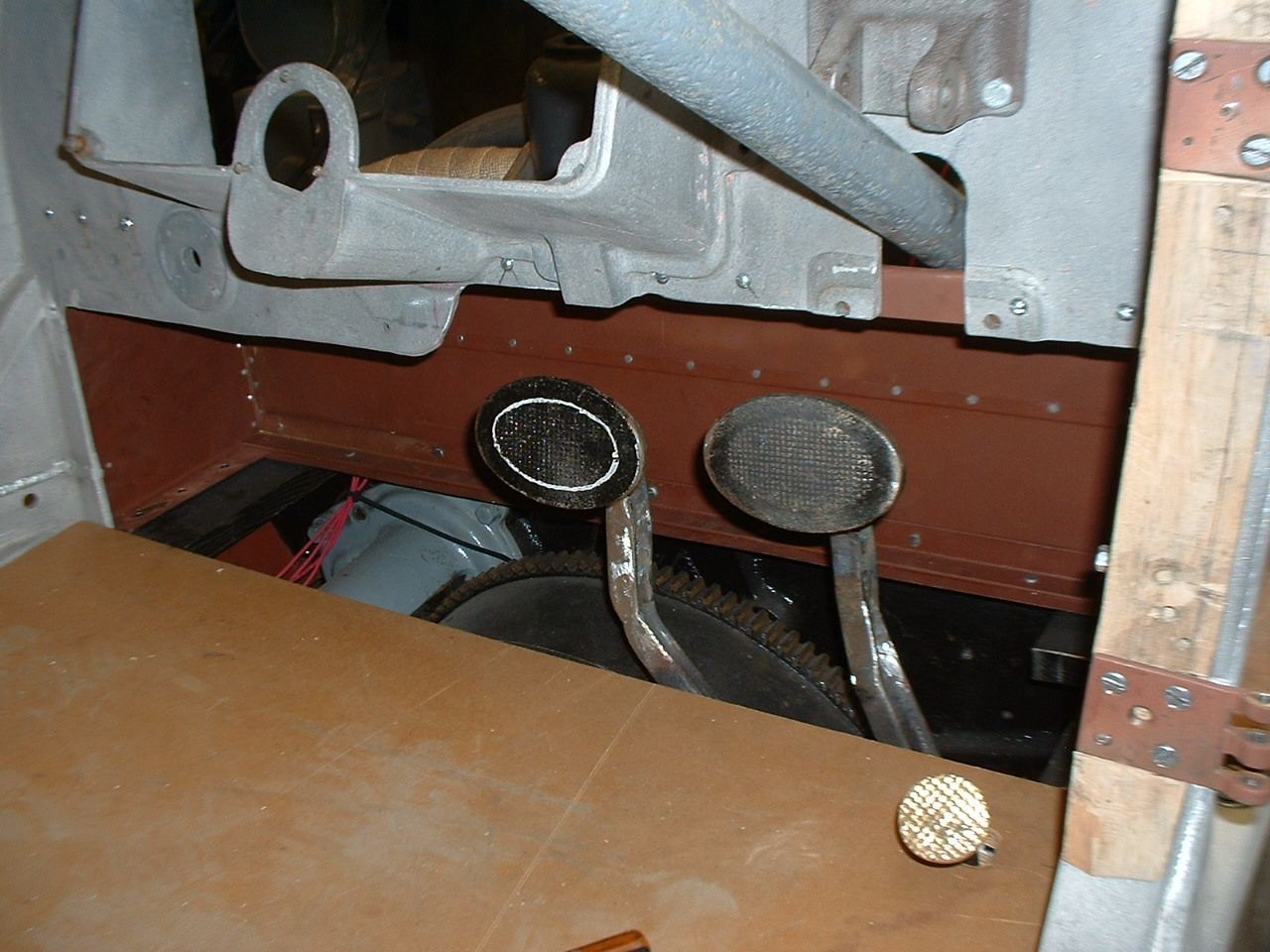

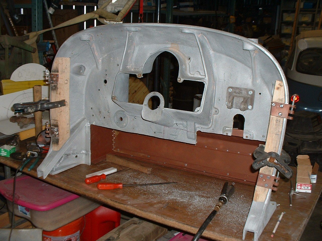

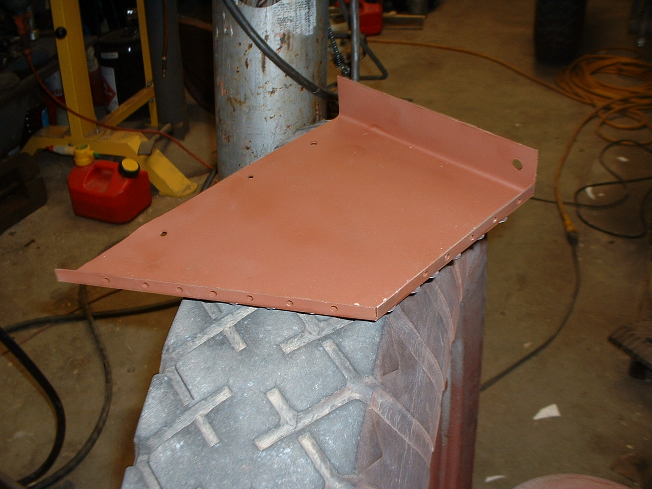

    Loose ends.
    I'm dreaming of paint and there's quite a few loose ends to clean up. The cowl had to be opened up on the side of the clutch pedal. Also the footwell needed to be fastened to the sides of the cowl. The next item is the gap under the doors. I need to make the door sills. But school is out and the kids are starting VBS, a long time tradition here in the south--elsewhere too I suspect. That means I have to pick them up at 12:00. How am I going to get anything done. Maybe I'll start work at 5 AM. BTW, according to the Seagrave archives the speedster was originally painted maroon over coach painters red (whatever that is.) What do you guys think about me reversing the colors. Maroon or dark red ch***is etc and red coachwork?
    Jerry
