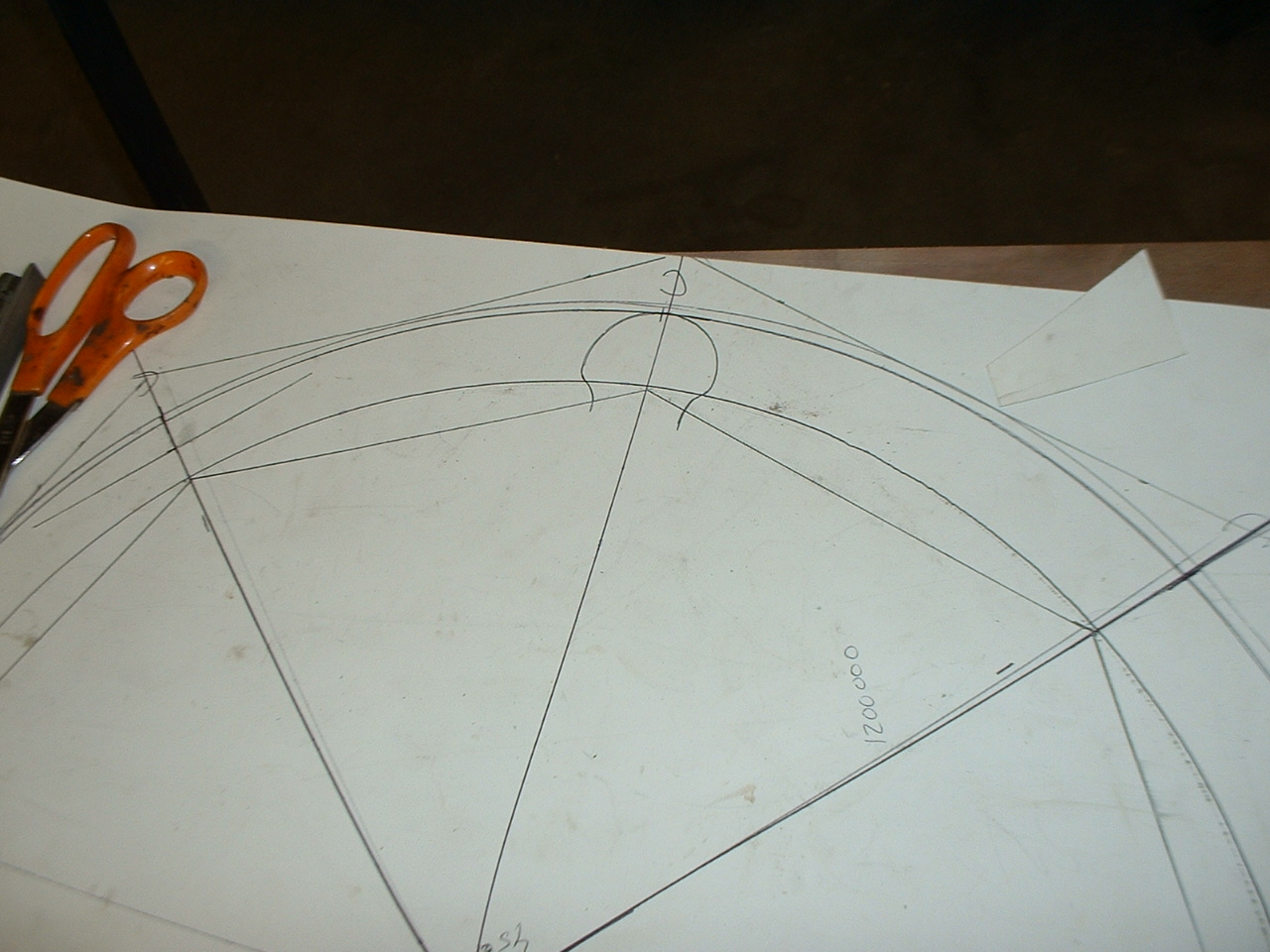

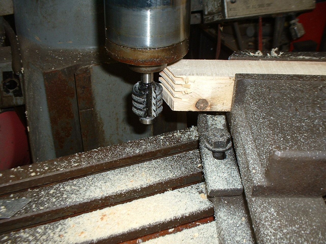

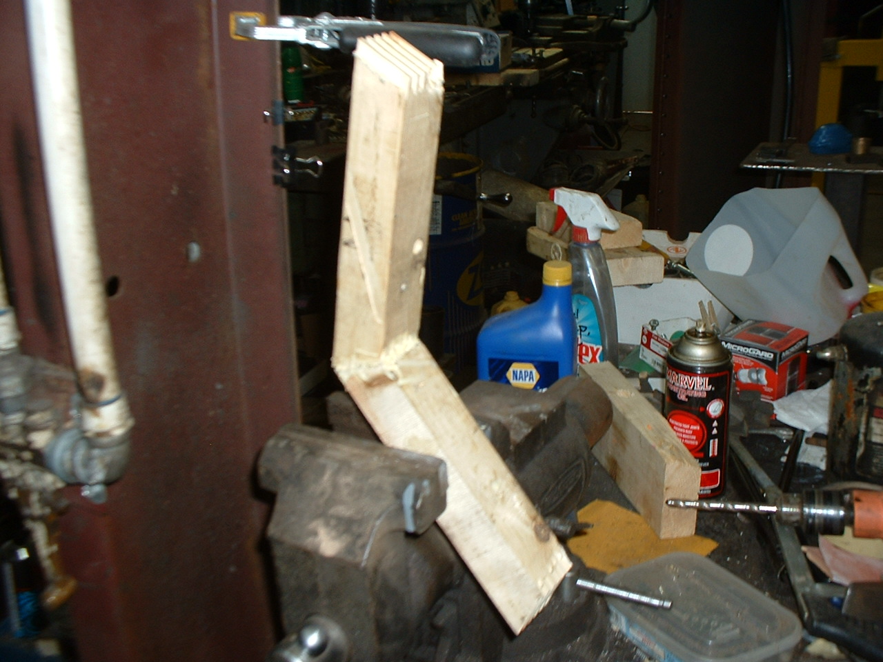

    I got out my new finger joint router bit and experimented with joining wood. A while back I drew up a pattern for a steering wheel. I figured 22.5 degrees on each joint. One problem is the router bit only cuts about an inch so I've got to index it. I glued 2 segments of pine together as a test. Next I welded up some steel channel I had in order to experiment with windshield shapes. The final frame will be made of br*** and attached to the cowl with some custom brackets that will fit the round castings on the cowl top. You can vote on which windscreen you like best. Or offer other suggestions. I'm not that taken with what I've come up with so far.

    Not sure it'd be any easier, but safer: make a 1" wide metal circle of the right diameter, and attach it to the spokes. Then attach your shaped (half-round) wood to the front and back of the circle. That way the wood isn't a structural piece, and if one of the glue joints fails, you've still got something to hang on to.

    On old style boat wheels, the wood was made up in three layers, offset, so the middle joint fell under the outer pieces, and then all three layers were screwed together. a similar method may have been used on the early auto wheels. If I find any good close up photos of early wheels I'll try to figure out how to post them. I tried to pull a wheel today for my own project, but had no luck. so I'm going to watch your' progress closely because I think I might build by own wheel as well.

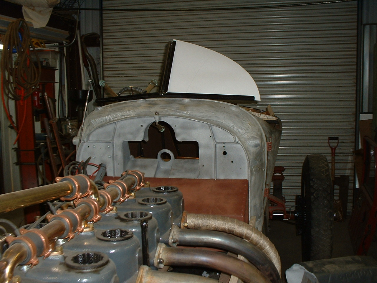

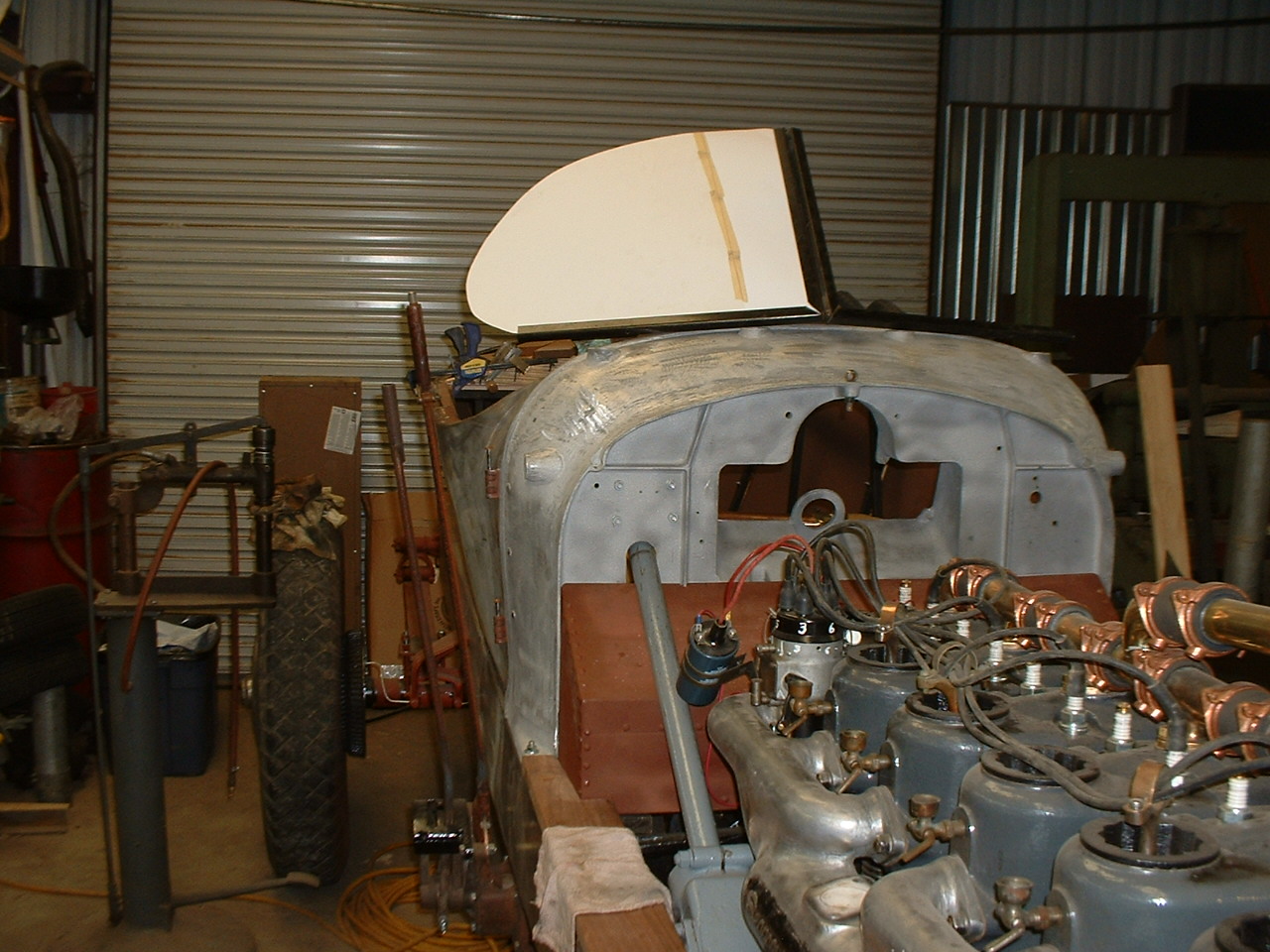

    I love split vee windshields, but a pair of Brooklands windscreens would look very appropriate on an early special. They were required by the Brooklands track and very common on performance cars of the day. You could even attach them to the four holes in the cowl if you don't already have plans to mount something else there. What ever you decide, I am always amazed by your' aesthetic.

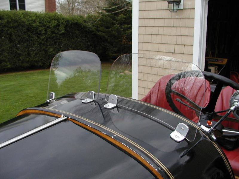

    If you don't want to go the full windshield route here is a picture of the Brooklands-style windscreens I made from lexan and aluminum stock.

    Great input you guys! I think I need to simplify the wheel construction. I was looking at some old wheels I have and they have only two joints in them. A couple only have one joint. Steam bent? The windscreen definitely needs some more pondering. I've always liked Brooklands screens but I wanted to do something unconventional. A buddy suggested two monocles. Never seen that before. But maybe that's a bit too old. The kids went to camp yesterday so I should get some quality time with the speedster.

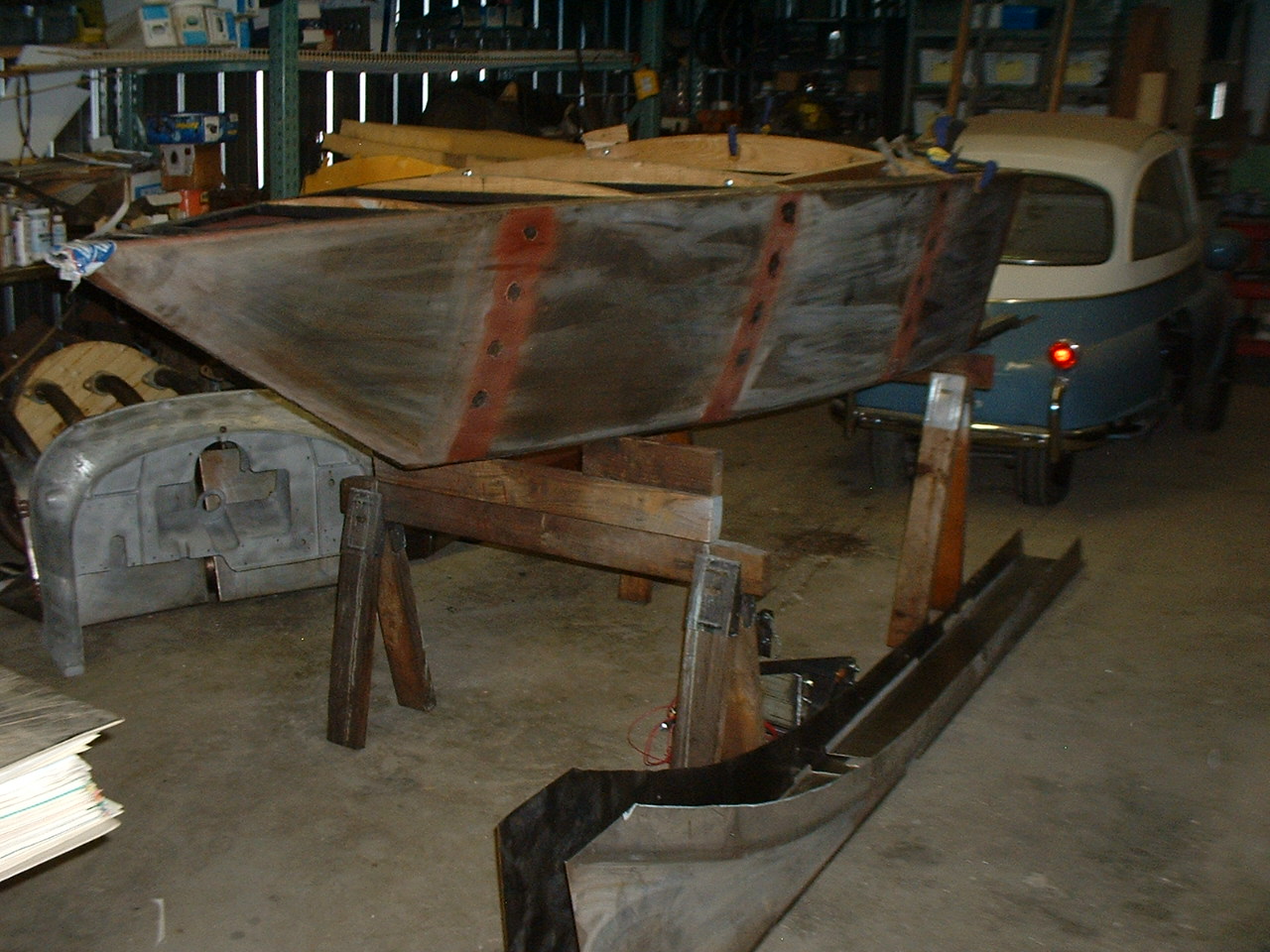

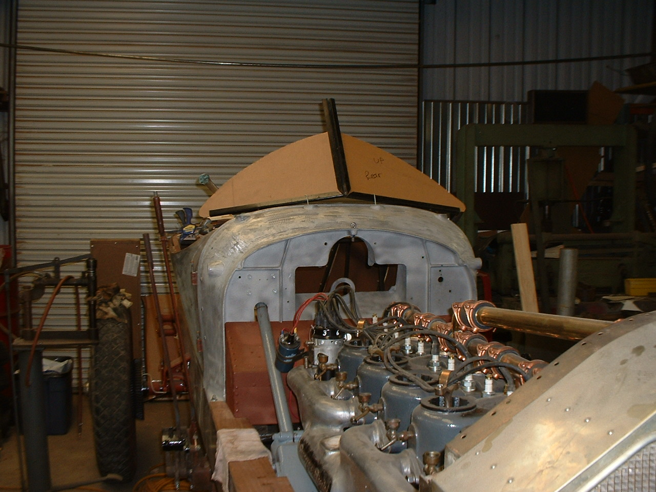

    Paint

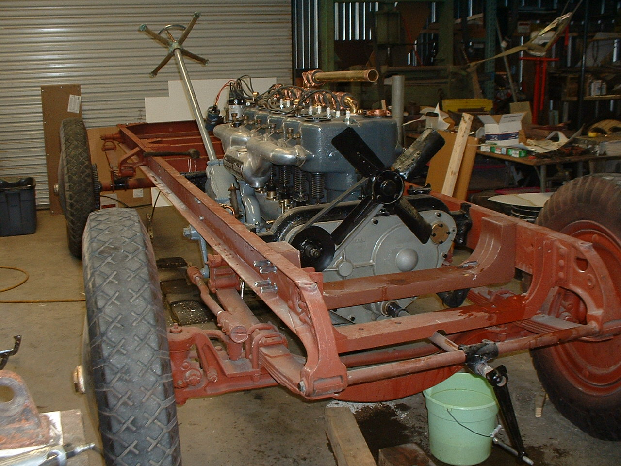

    I couldn't stand it anymore. I need to start ***embling the speedster for real! I began by taking the whole thing apart. I got all the sheet metal off and some of the shifter mechanism and battery box. Before I paint though, I've got to take out the transmission and replace the front seal or whatever p***es for a front seal. The thing leaks oil everywhere. Paintwise, it's going to be difficult to spray the inner frame side because I'm not stripping the engine and various other parts out. I think I'll brush paint the inner frame black. That'll make it easier to mask off the rest. No one will see the black anyway unless they lift the floor boards. Everything else on the ch***is will be deep red. But what exact color...
    Jerry

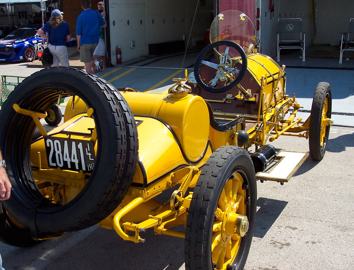

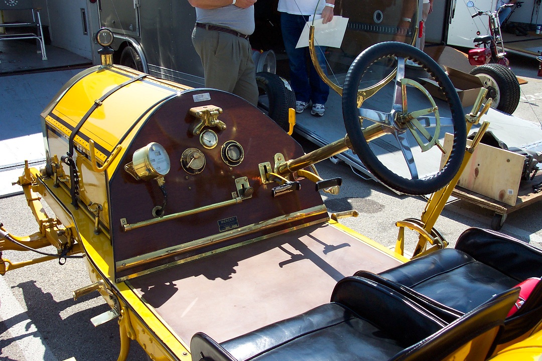

    A little earlier than the period you are working in, but this Mercer has an interesting round "monocle" windshield.

    You might try steam bending the wood for the rim. I've only seen monocles on open bodywork cars myself, but try a mock up, it might work.

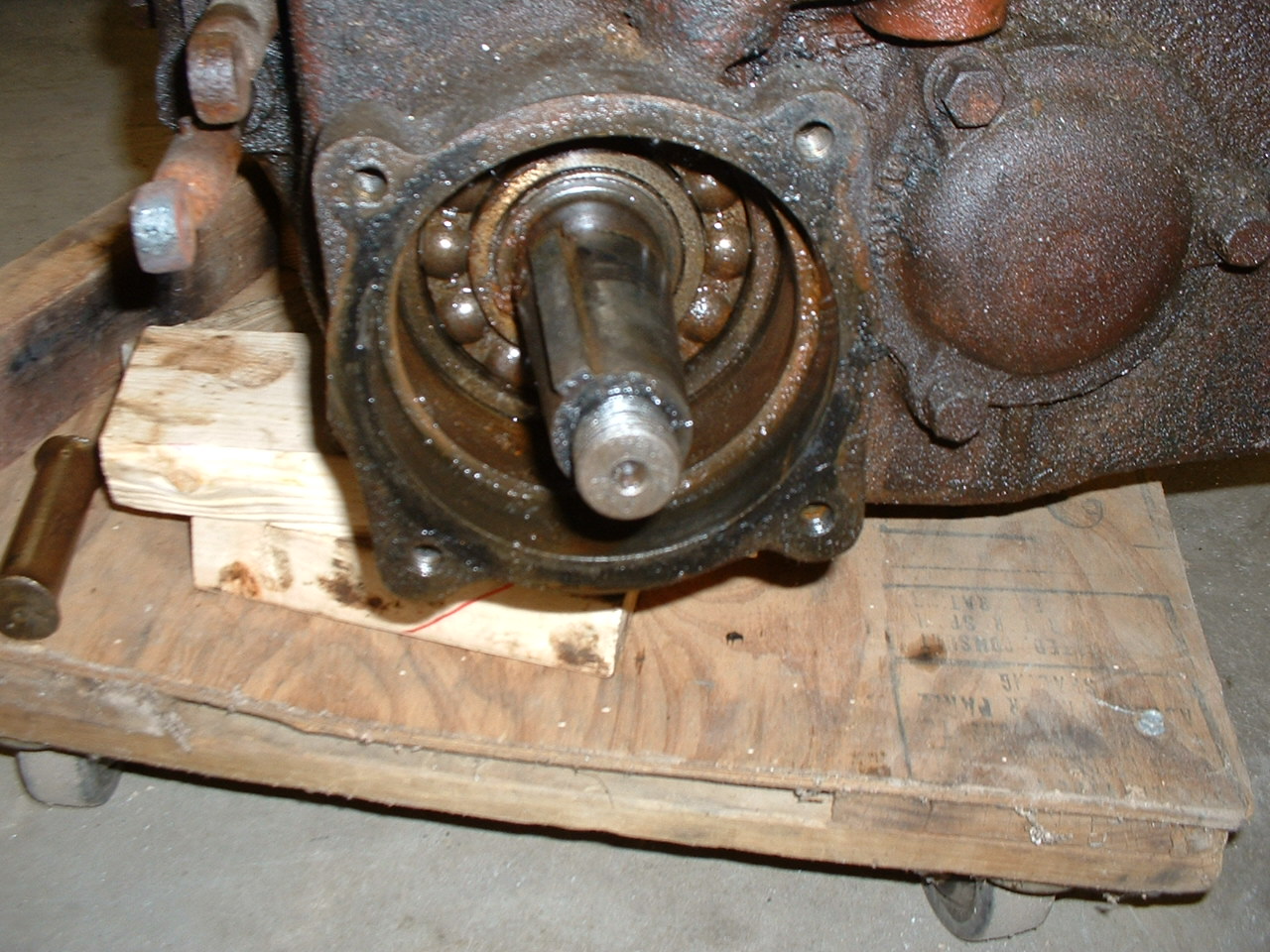

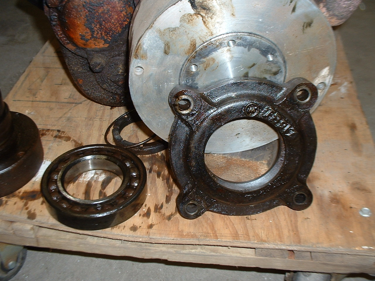

    I forgot my camera today. I took out the transmission and dismantled the front flange and seal. It was a felt affair and had disintegrated long long ago. I believe I can put in a modern seal 100x80x10 with very little machining. The front bearing is pretty noisy. There again, I might find a modern replacement. Meanwhile, I going to finish dismantling so I can paint the ch***is. I'd like to get it taped up and on jack stands by this weekend.
    Jerry
  23. yonahrr

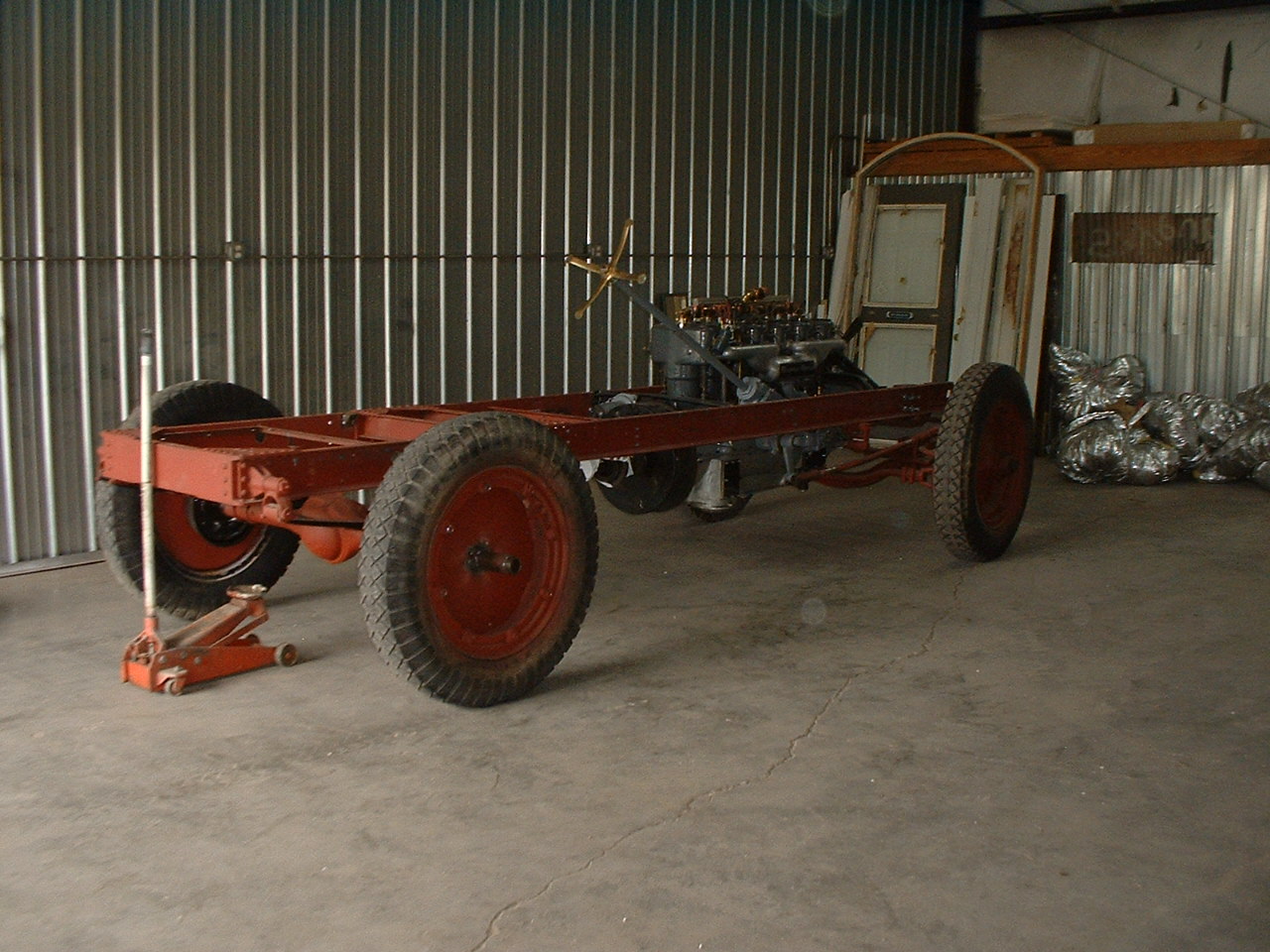

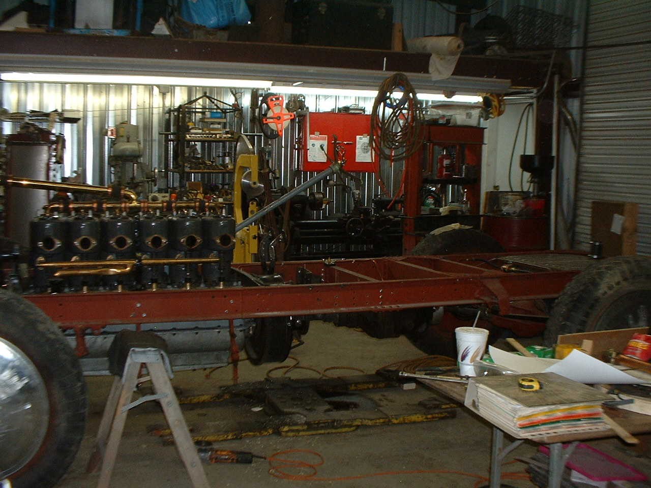

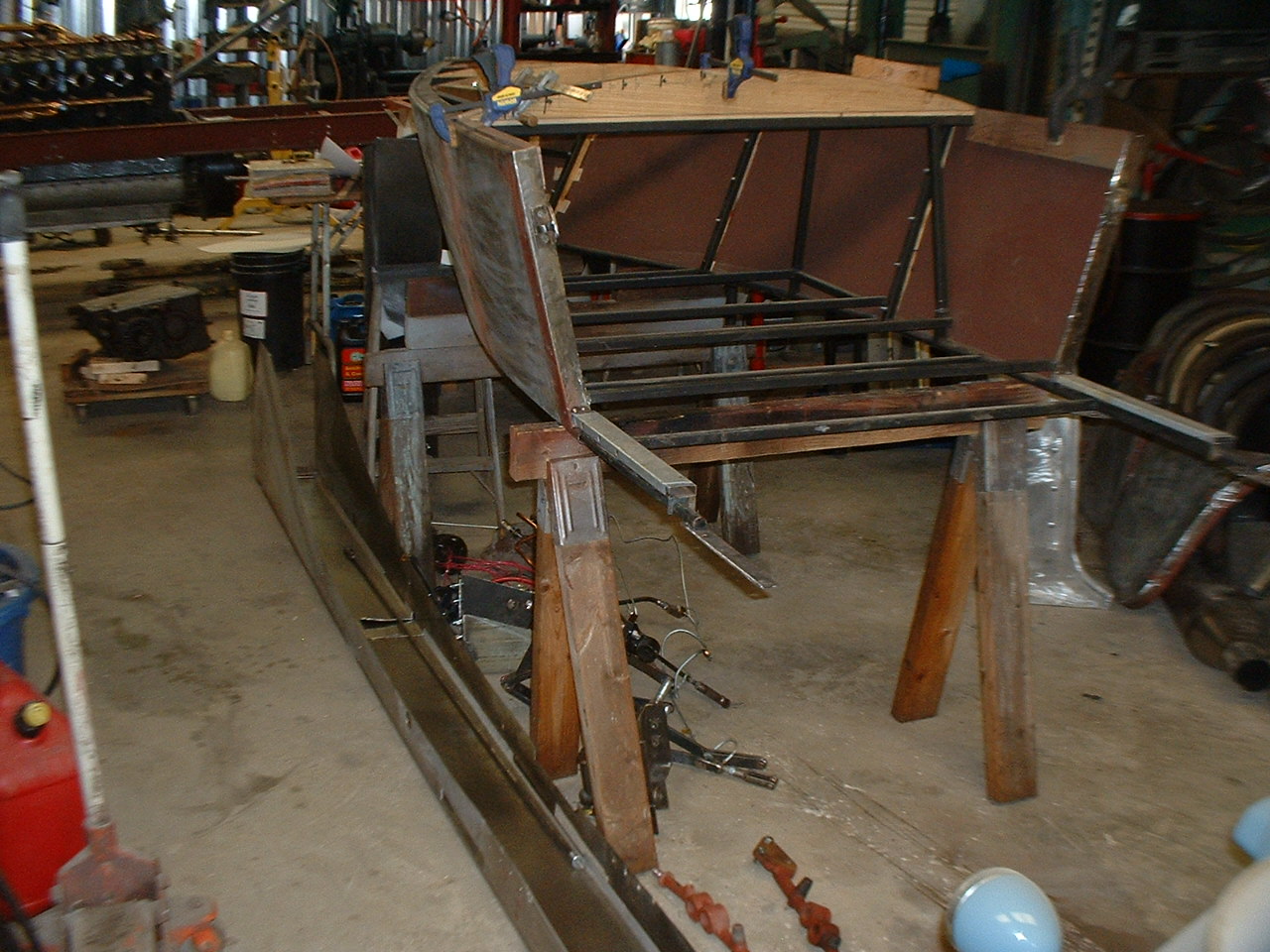

    No I'm not talking about A. Weiner. The Seagrave is stripped off. I had to finish up a few loose ends like drilling holes and installing bolts in cross members. I'm going to move the ch***is to an empty rental shop I have and get it ready for painting. That'll also give me room to do the bondo work on the body. The flange with the four little holes and the one big hole is the part that holds the front transmission seal. The bearing is next to it. I found a bearing that'll fit for $57 and the seal is around $15.
    Jerry

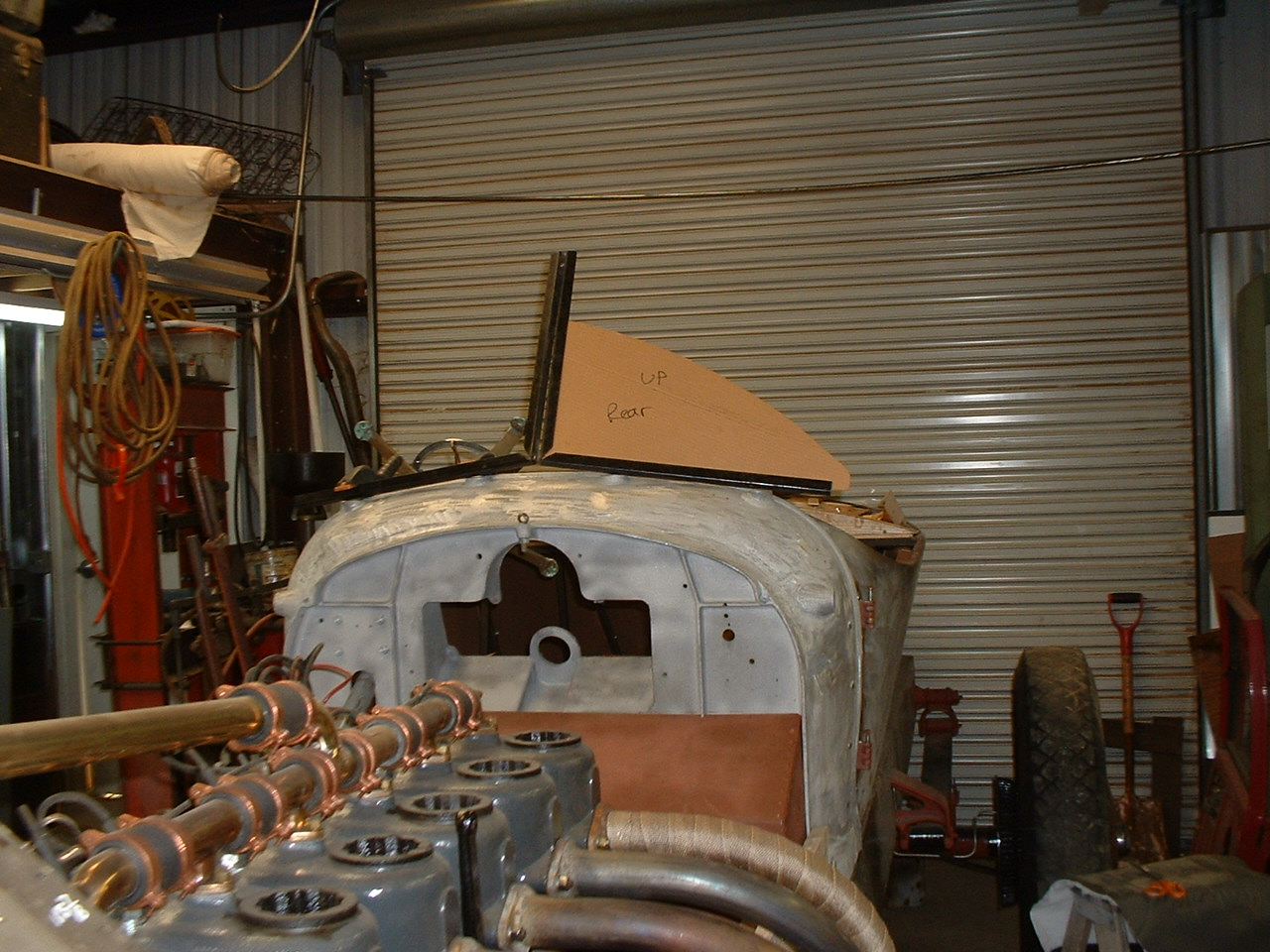

    Are you going to make the space under the boat tail section accessible for storage? Flip forward seat or hatch door on the side?
    Jon
  26. yonahrr
    Joined: Feb 27, 2010
    Posts: 1,348
    yonahrr
    Storage, yes. I thought about a side (golf?) door and still may do one. Flip seat? Actually, the p***engers face backwards. There's no leg room if they face forward. Also with all the noise, their heads will be close to the driver for communication. I'm going to line the inside with longitudinal battens.

    Moving day

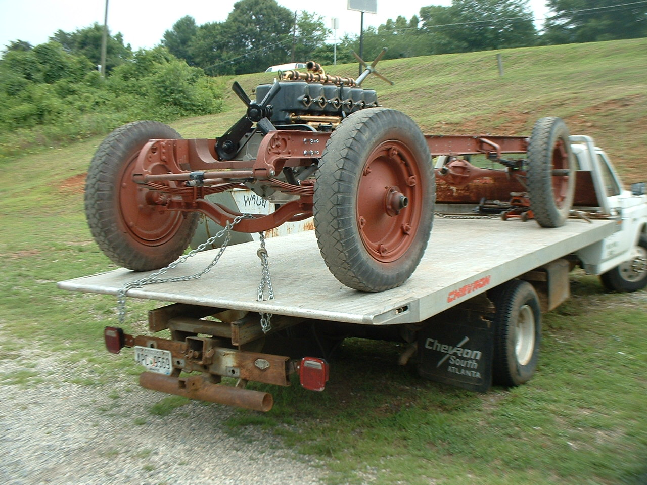

    I finished a few details then loaded the speedster up for a trip across town--about 5 minutes. We've only got 4 street lights in the county. Now the Seagrave is back were it started when I first got it. Instead of painting the inside of the ch***is black as I thought, it'll be just as easy to brush paint it whatever shade of red I decide--dark, dark I think, almost maroon. I'm working on that now. The NAPA store had a real nice paint color display with great colors but they wanted $400/gal. That's a little steep for me. Lots of other alternatives.
    Jerry

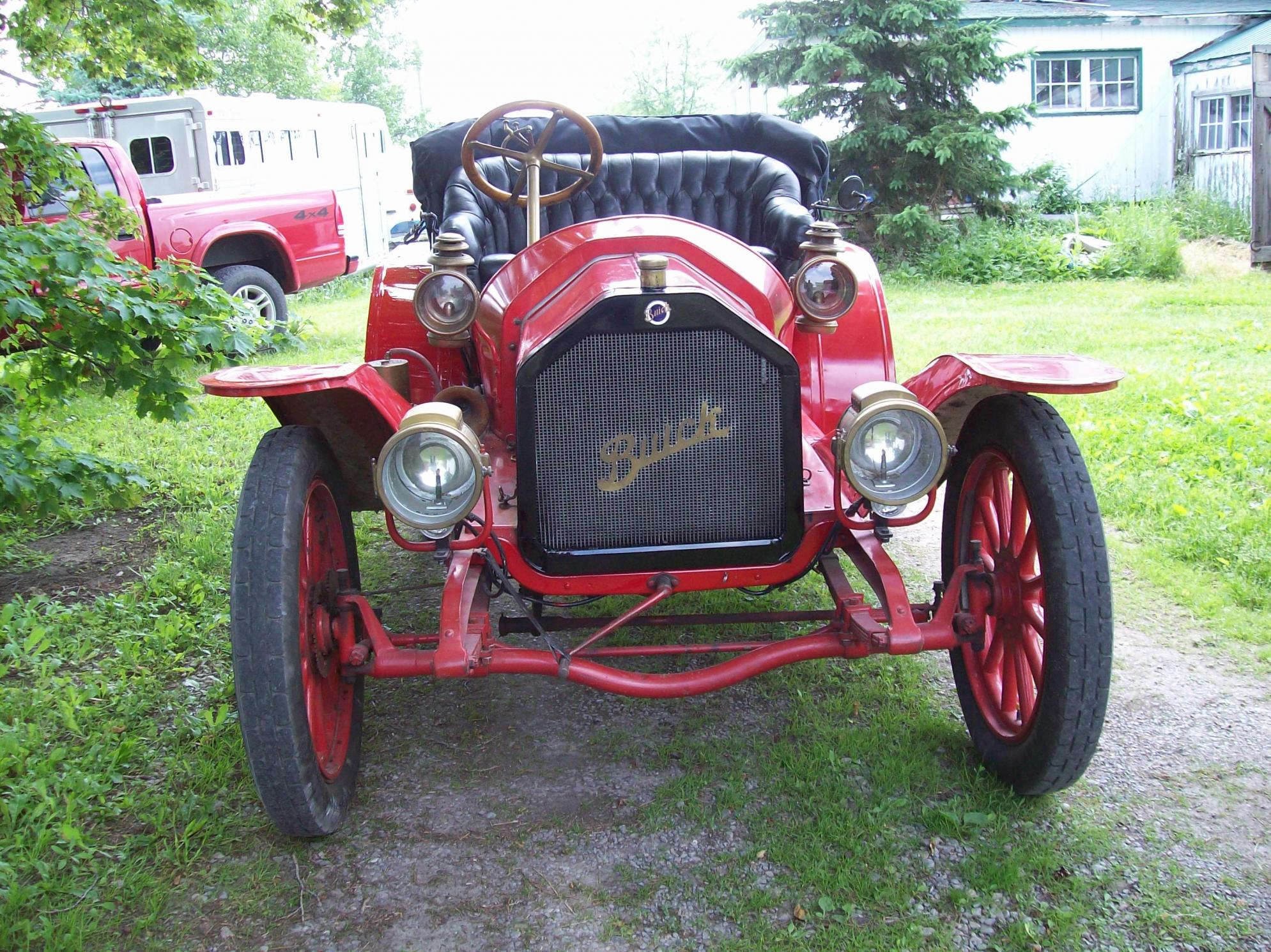

    Here are some pictures of my 1911 Model 32 Buick. I just had the back half of the body & gas tank re-painted & thought you might like to see a real cherry red sans photoshop & airbrushing.
    The color is very close to some of the original paint on the frame under the seat. These cars were painted exactly as this one with no pinstripe & the only black is the rad shell. This car has never been apart & restored totally.
    The paint code for the 2004 Dodge Dakota in the background is an exact match. Easy to find if you wanted to try it.
