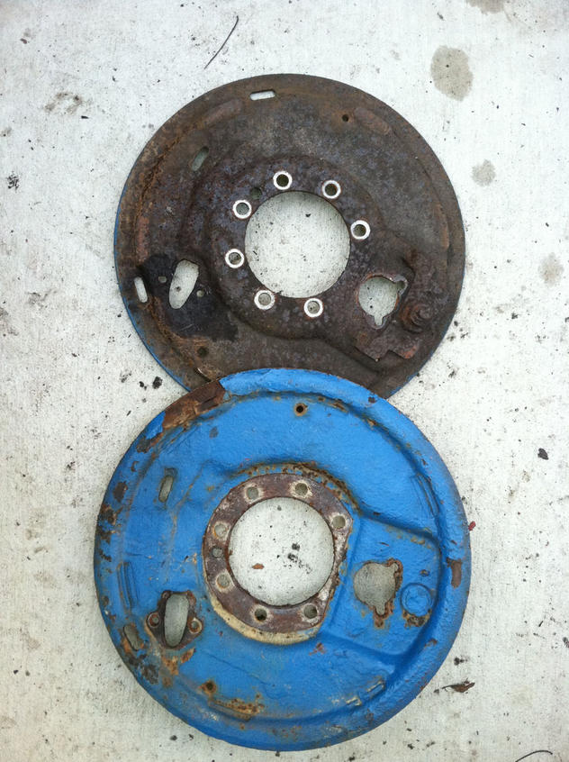

    Dana 60, at least some, backing plates will fit 8 3/4 axles. They have a 12" plate for the 60, and I found this drum NAPA # 4401125, 12" with 4.5 bolt circle. It would be a mutt but might work. photo-1.jpg

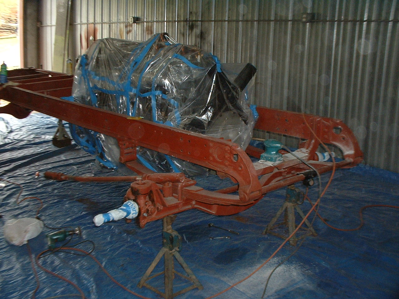

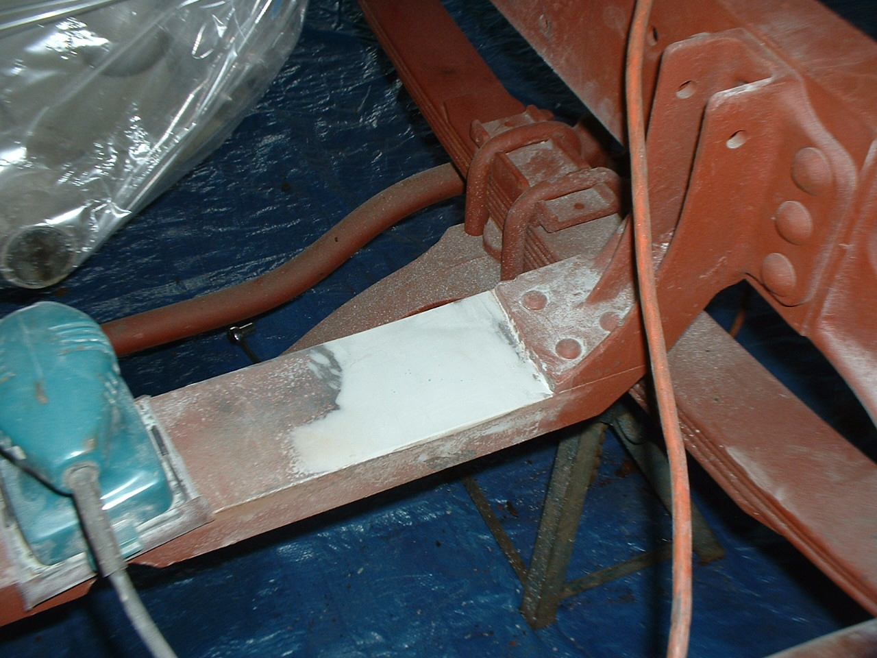

    Sanding/filling
    I only got a few hours today to work on the speedster. Sanded and filled and ground some casting flashing off the diff. Maybe I'm getting carried away. I'm gonna see if I can get the ch***is painted this weekend. That would be da bomb! (Does anyone say that any more?)

    I found a set of five hole plates listed for "Dana 60 or Chrysler 8 3/4" with 11" drums, then I found those for a G.M. Dana 60 with a 12" drum; I don't know if the pattern is completely different, or if it just has extra holes added between the five yours have.

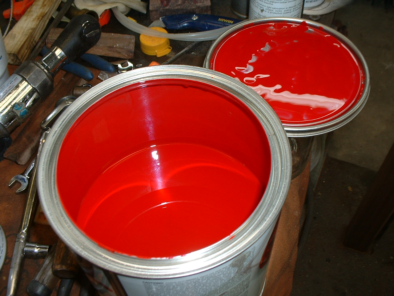

    I finally bought the paint. You guys are gonna say I should have bought Dupont concept, there's just no way I can afford that. I probably can't do bodywork equal to that anyway. Besides Napa is one of my tenants so I gotta support them. PR4 Here it is. It looks darker in real life.

    I'd say that's fine. Fancy paint really isn't appropriate to the style of the car. In its era it'd have been brush-painted with a linseed-oil-based paint that'd take several weeks to dry.

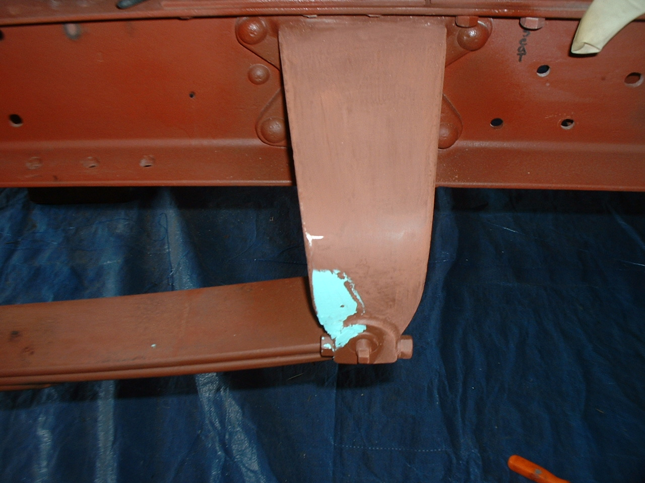

    Hey. That means "hi" down here in peanut country. Actually, peanut country is a little further south. I live in moonshine country. In fact, for many years, the tagline (byline?) of our local paper was--Cleveland Courier, Covers the Mountains Like Moonshine. But I digress. What does digress actually mean anyhow. I'm out of my element when it comes to paint. I don't know exactly what paper to sand with. I'm not sure what paint will stick to what. Do I use this primer with that paint? should I use a sealer? Believe it or not I owned a body shop once. But my guys handled everything and I just lost money like most body shop owners. So here's the low down. I think the ch***is is almost ready to paint. At some point you just throw up your hands and say to hell with it. After you paint, and you wish you'd dealt more with prep, you figure out how to hide all the screw ups. That's my theory anyway. The good news is I think I'll video the painting. That should be interesting. 20% chance tomorrow is the day.
