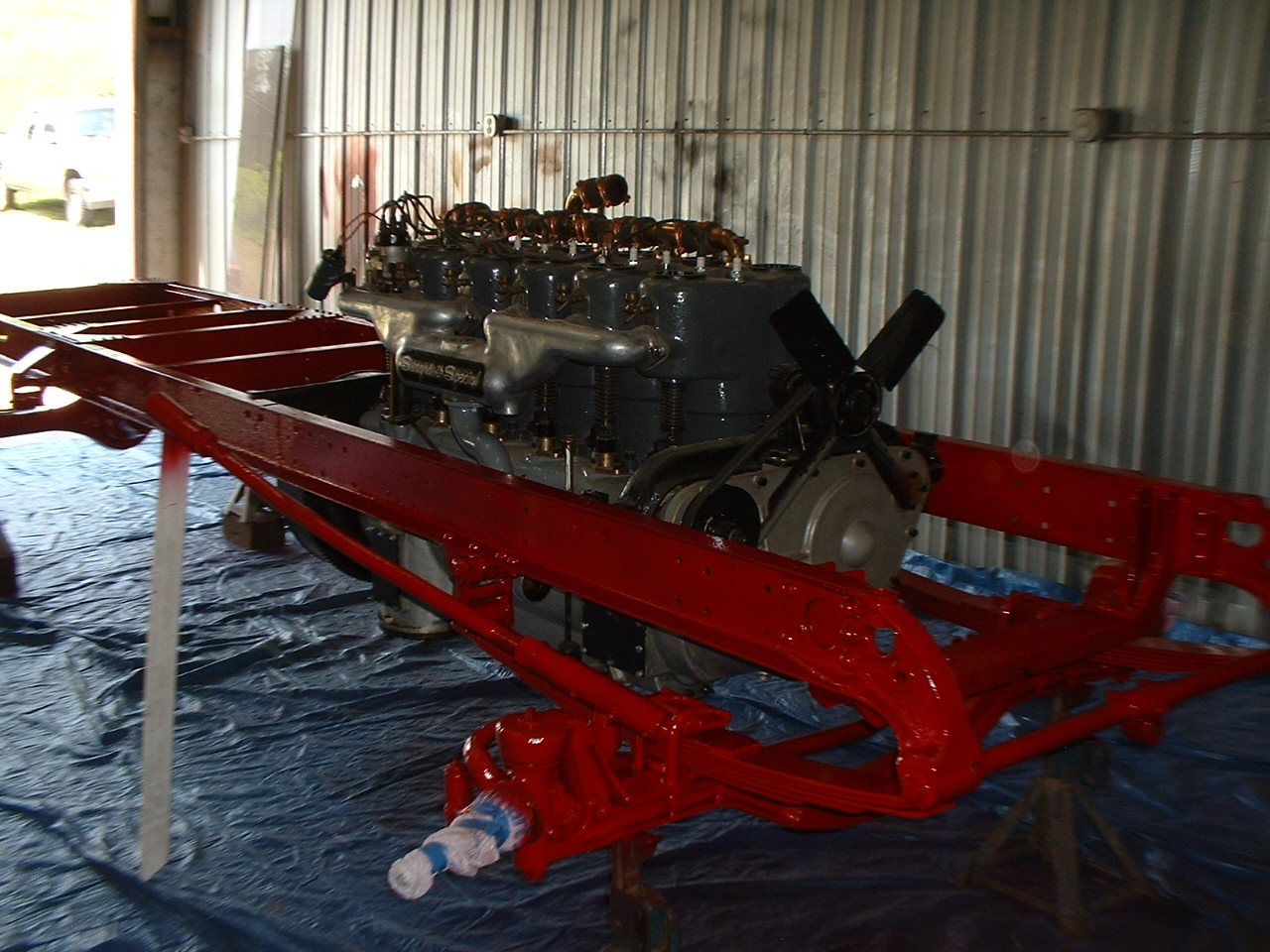

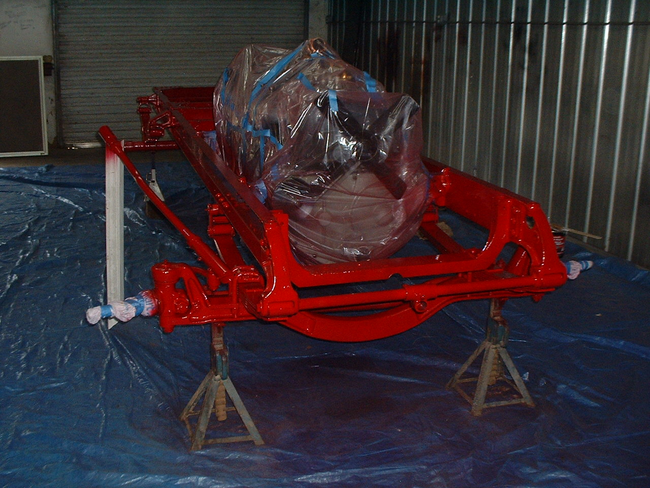

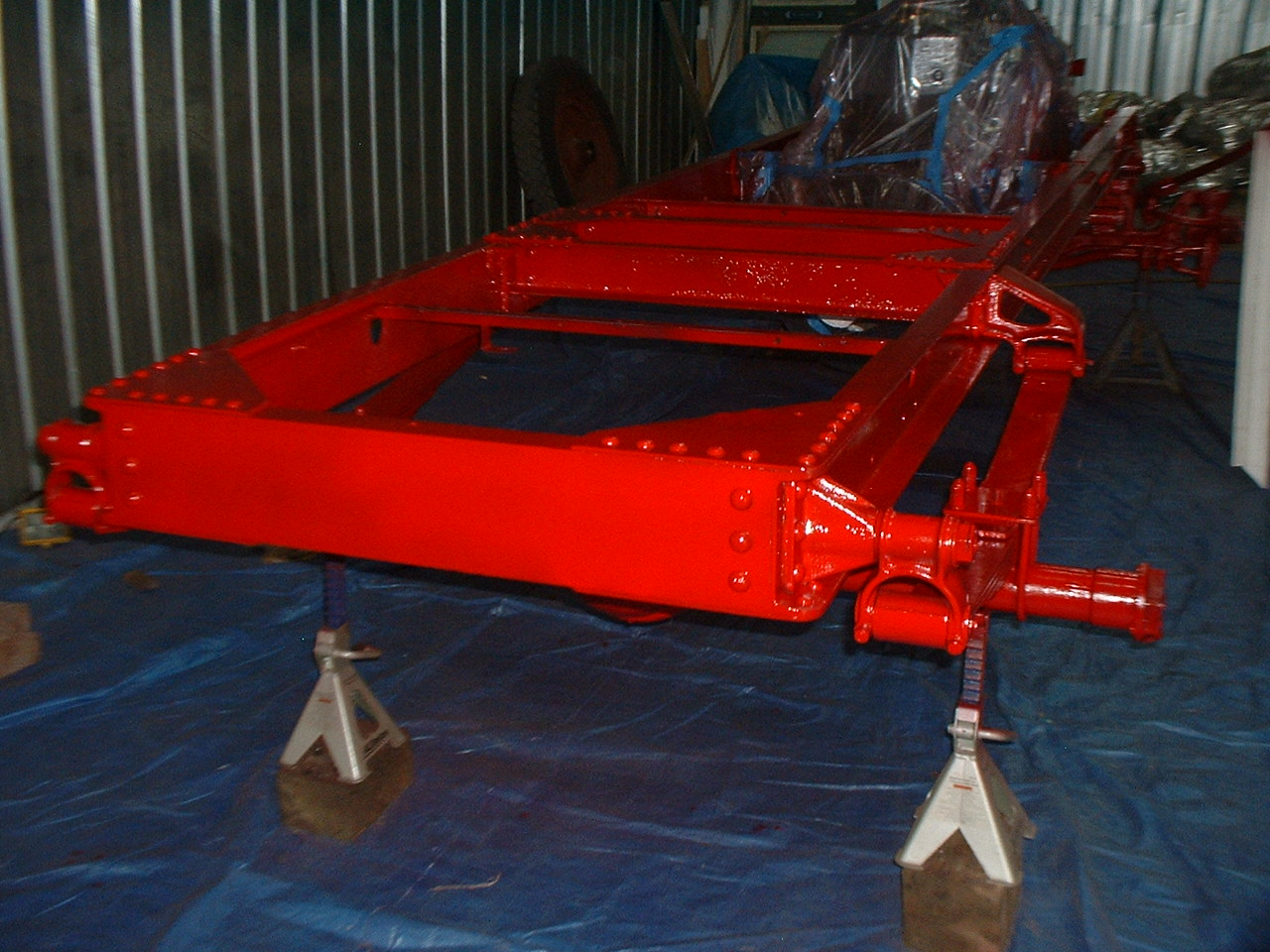

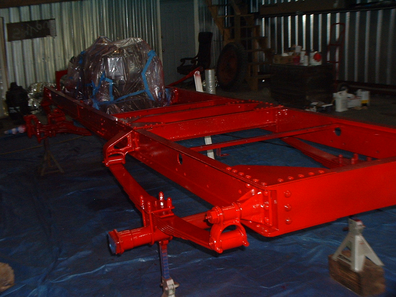

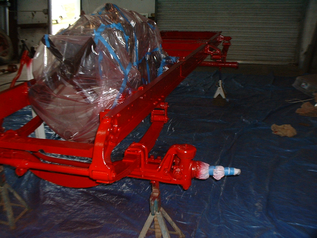

    Ch***is Paint part 2

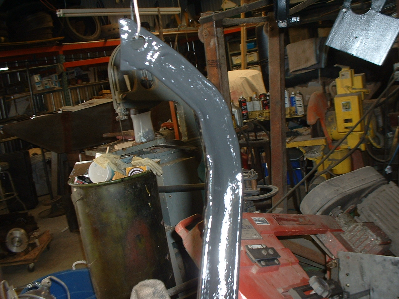

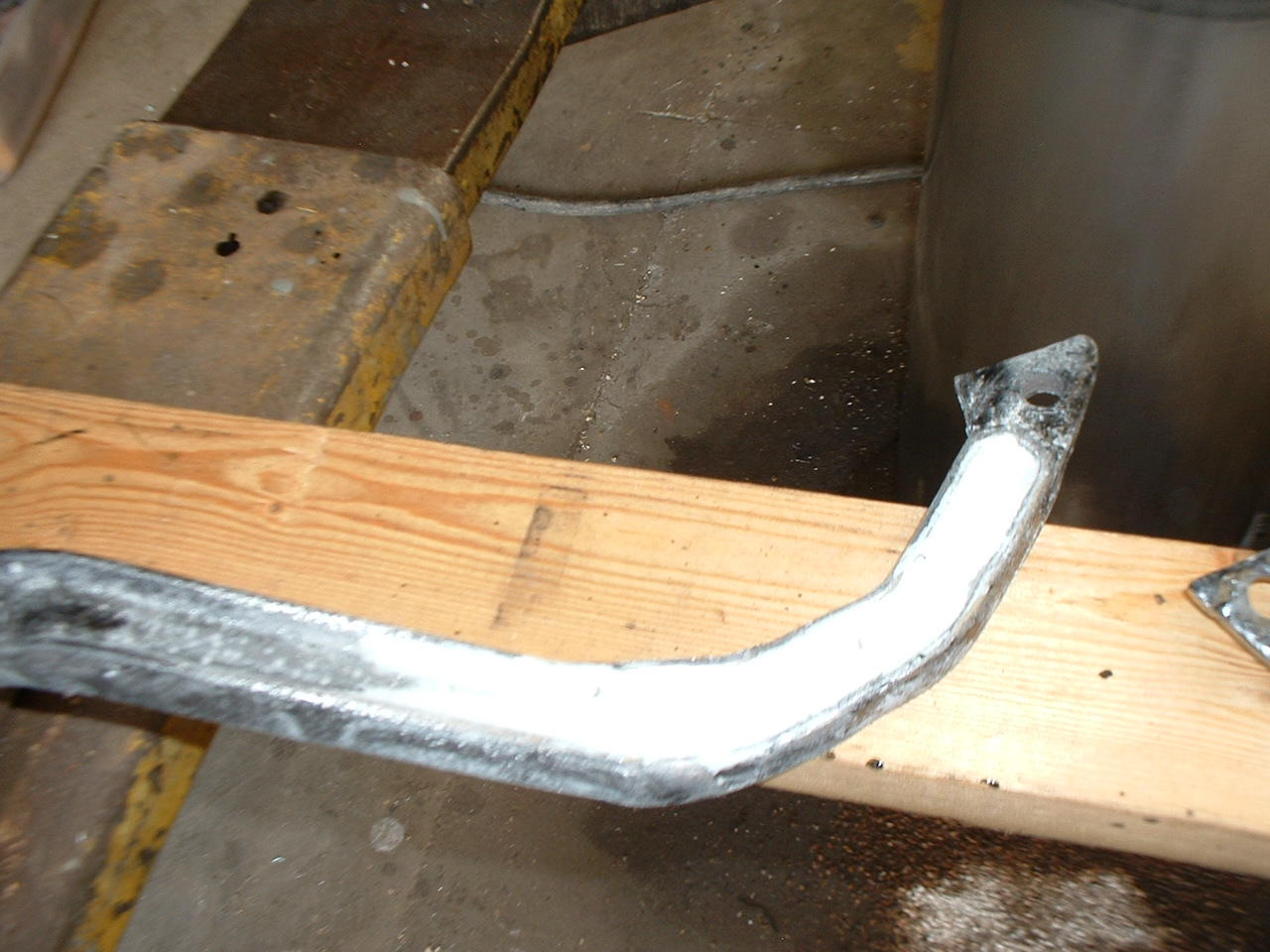

    As you recall, in our last episode, Jerry and Israel gave up painting after being dulled by overwork and fatigue. The question I faced was can I spray over the new paint after it dries or do I have to scuff it. The tech line lady said I could repaint without scuffing after 16 hours but not after 24 hours. This left a window that fell last night between 11PM and 7 AM. In a way this was good because A, it would be cool and B, I wouldn't blow overspray on anyone's car. The bad news is that I arrived at 11PM and it took me until 3AM to finish the job. Near the end I was a zombie, spray gun in one hand and a spotlight in the other. So it's done. Yeah, I had a few runs but they were on the inside of the frame where no one would see them. The color in the pics is not right. It's actually a very dark red. Next question: The wheels have aluminum wheel covers but what color to paint the back side. Black? Aluminum? Red?

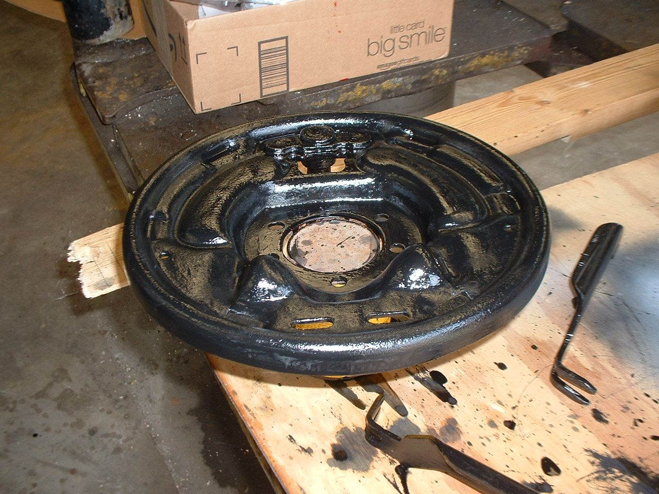

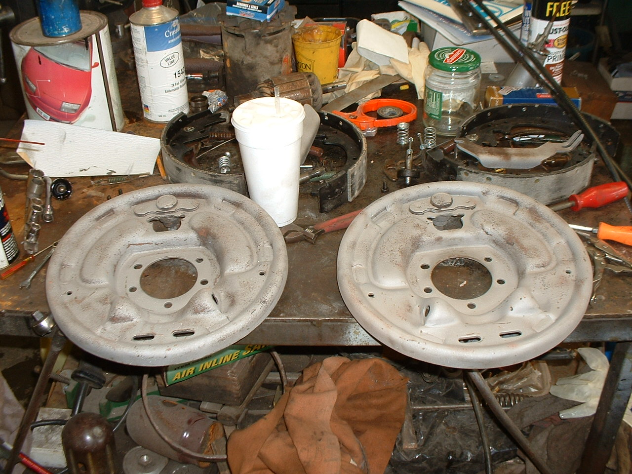

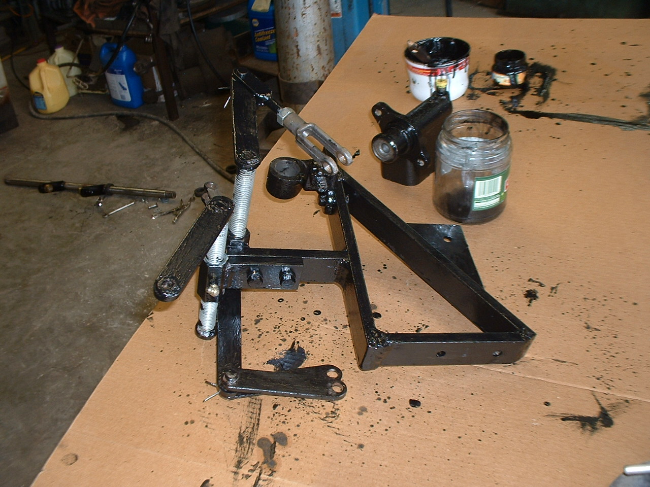

    Brake fluid

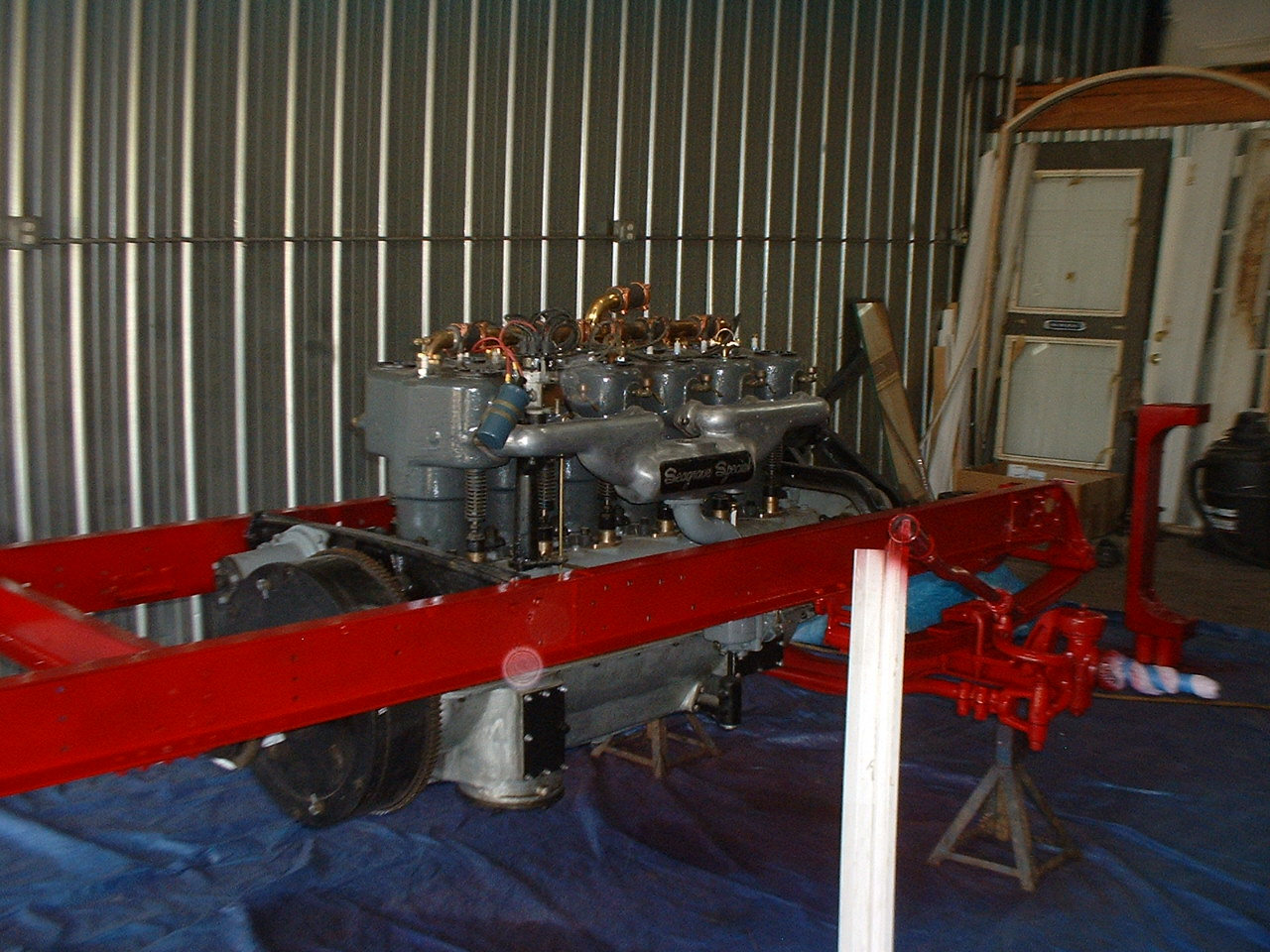

    I tore the plastic off the engine to get the overall effect. Pretty cool! Back when I stripped the ch***is, I got some brake fluid on the backing plate that I had painted with POR 15. The brake fluid took off the POR 15! I thought that stuff was impervious to everything. Wrong! So today I bead blasted the backing plates and repainted them with epoxy paint. I hope brake fluid won't effect epoxy. I'm switching to silicone fluid anyway. Then I got carried away and beadblasted everything and painted it with epoxy. BTW I'm leaving on vacation Friday so you guys may have to keep up the conversation without me--unless they have internet on the ship and they don't charge for it.

    For a guy who don't know nuthin' about colors, the red, black and light and dark gray sure look good. The br*** is icing on the cake.

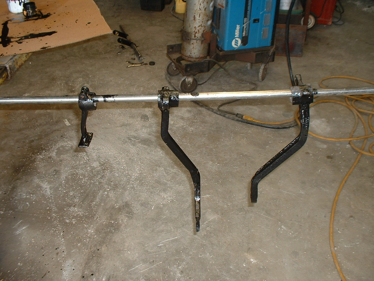

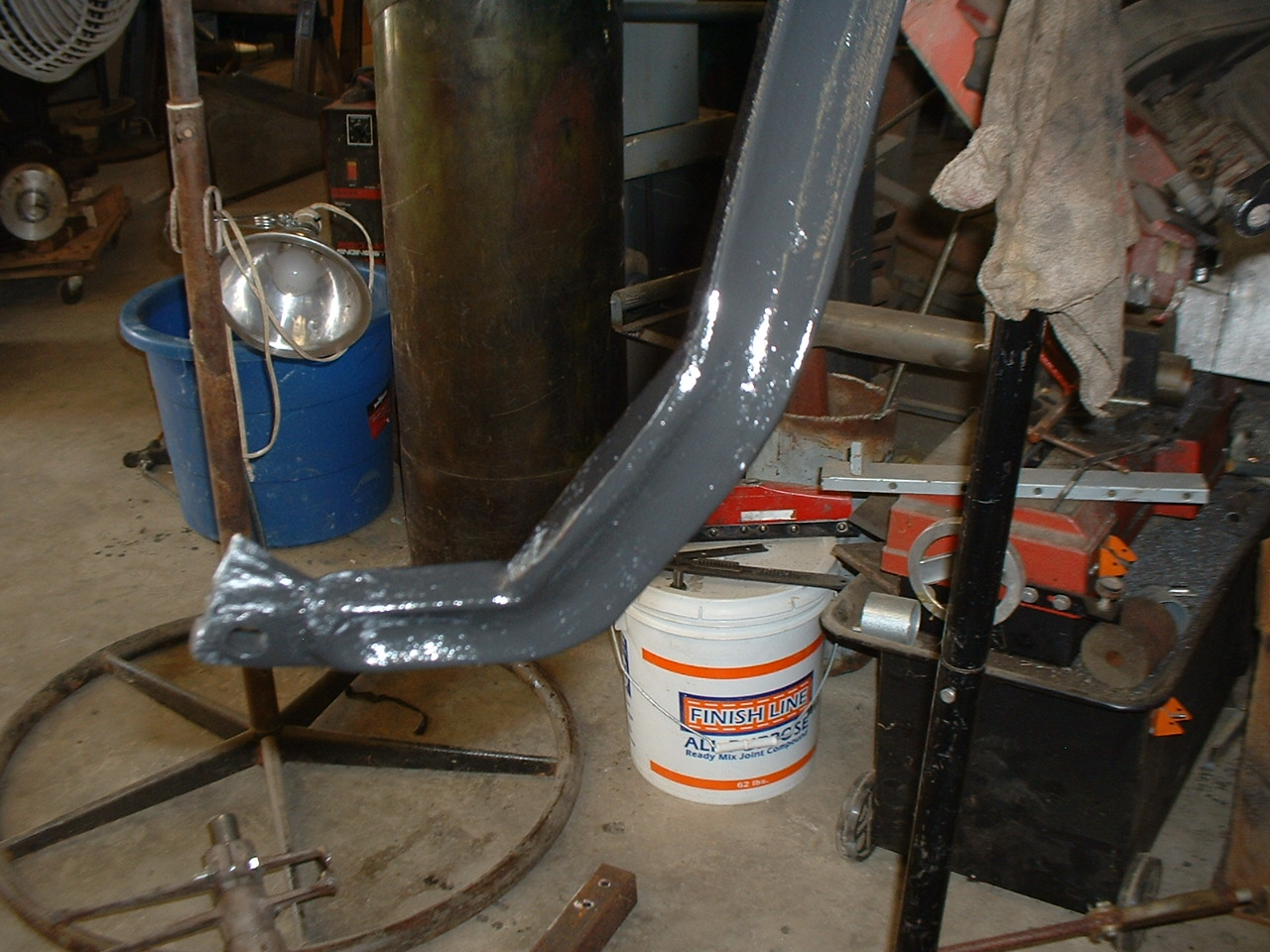

    Pedal arms

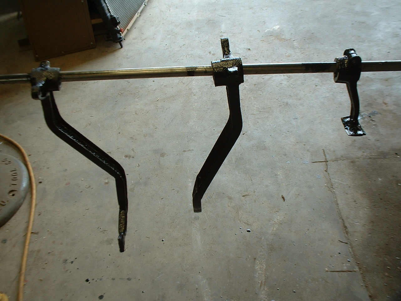

    I only had a few hours to work since we are getting ready to leave tomorrow morning. I had to rework the pedal arms and the welds weren't all that pretty. Lucky for me Mr. Bondo showed up and prettied everything up. Pics aren't that great. And speaking of pics, maybe I can catch some pics of Brazilian girls at the pool for you guys.
    Jerry
