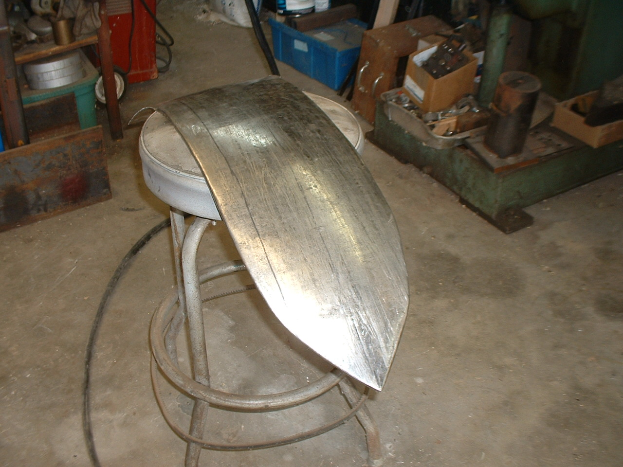

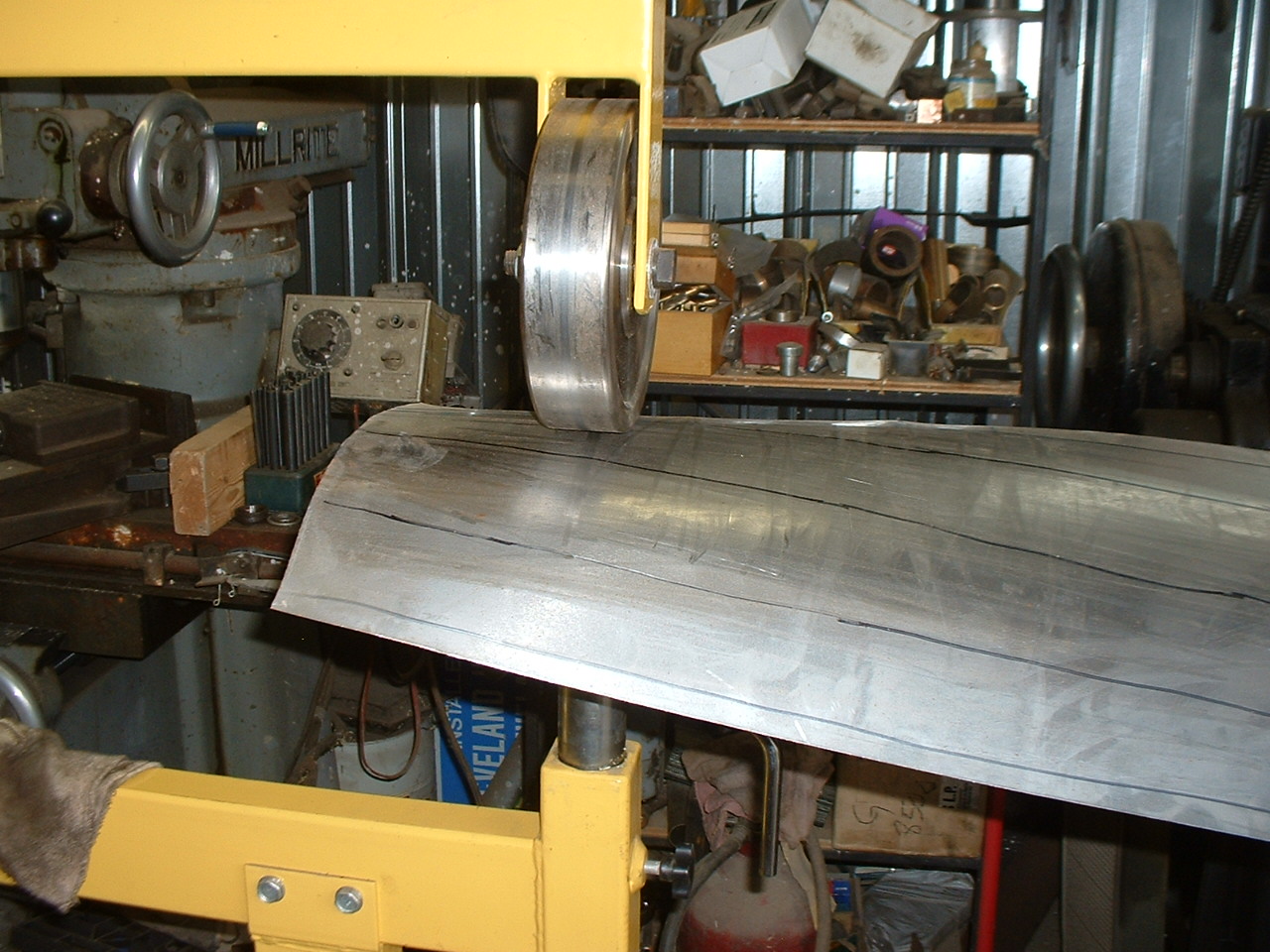

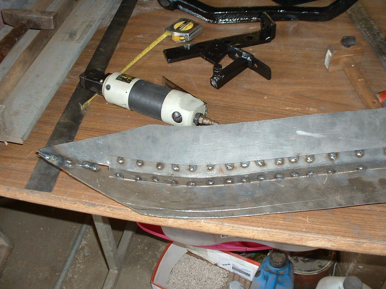

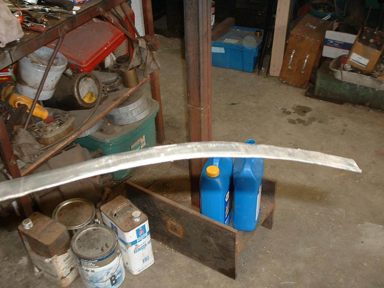

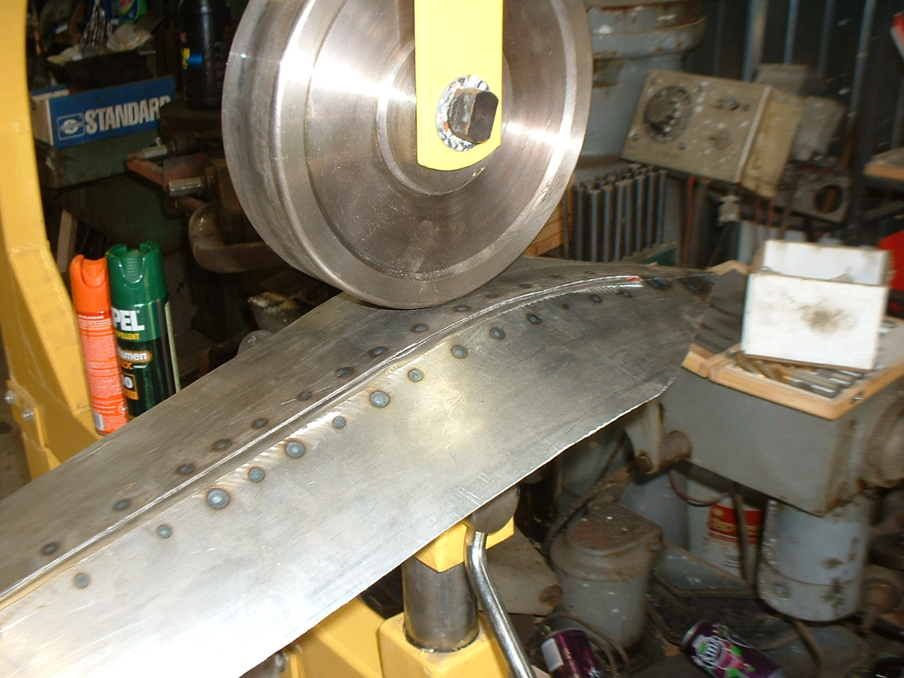

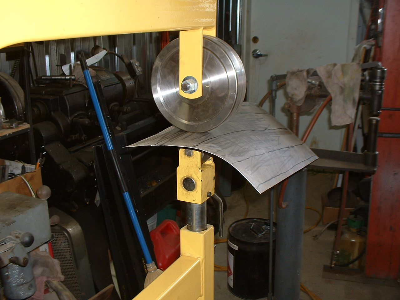

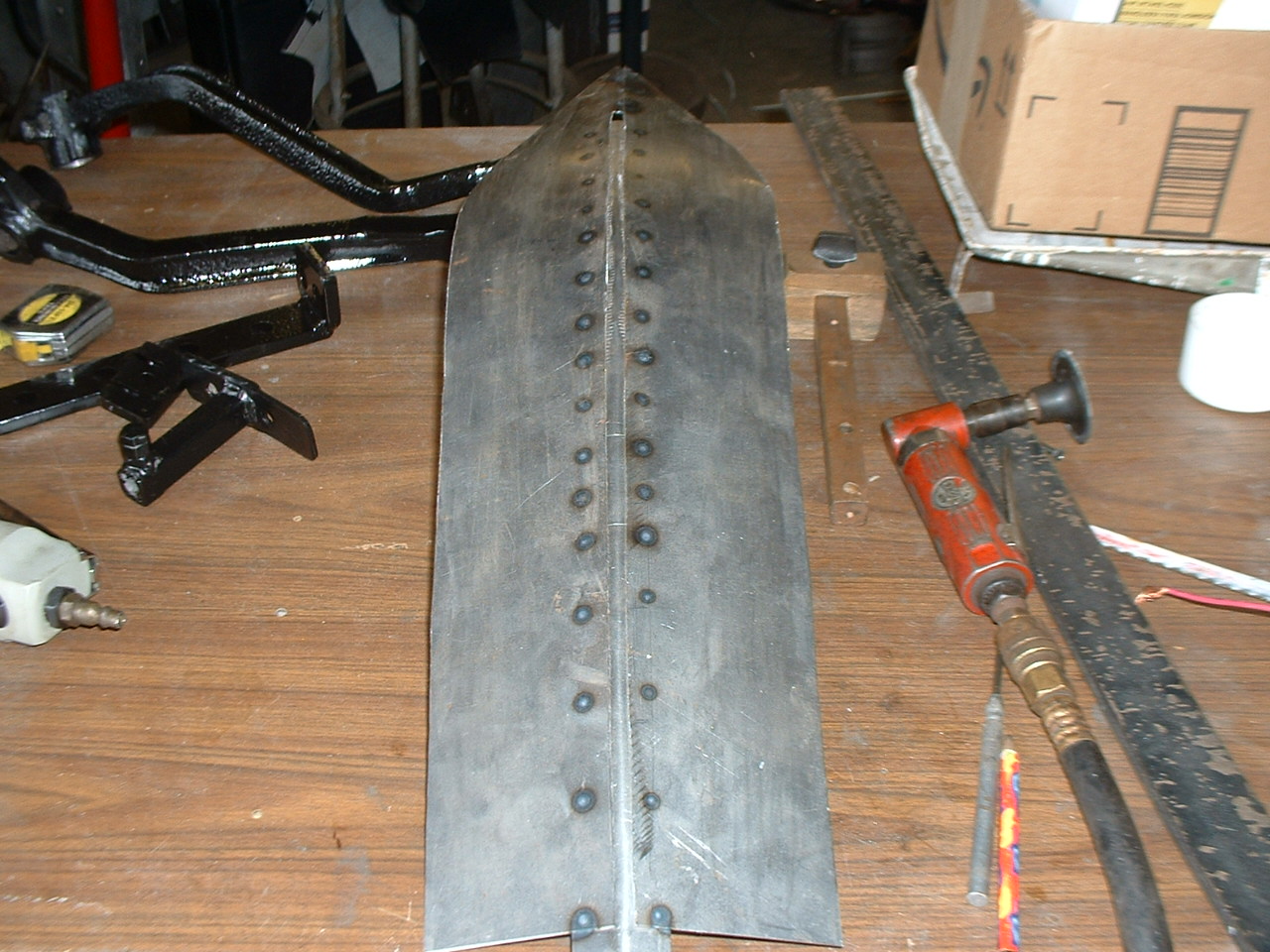

    After I got the transmission painted and ****oned up I started fooling around with the fender idea. I cut a strip, gave a slight bend then put it in the shrinker and curved it. Then I cut two strips and tacked them to the sides of the strip. It looked interesting so I ran it through the English wheel to put a little English on it. (bad joke) It was an interesting experiment and it got me thinking whether I could do the same thing without the center strip. Next time I'm going to try to make one using just the English wheel.

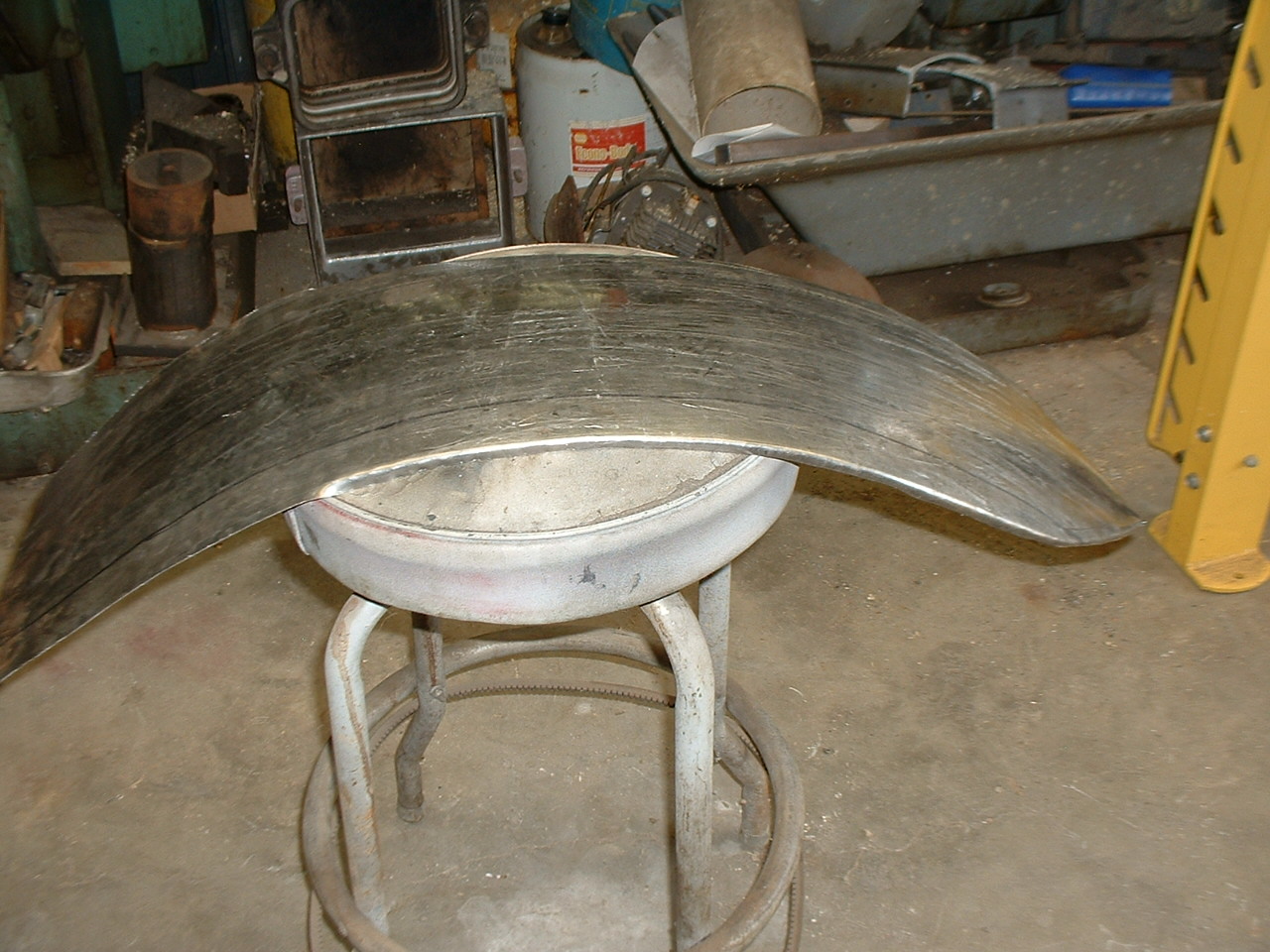

    Fender II

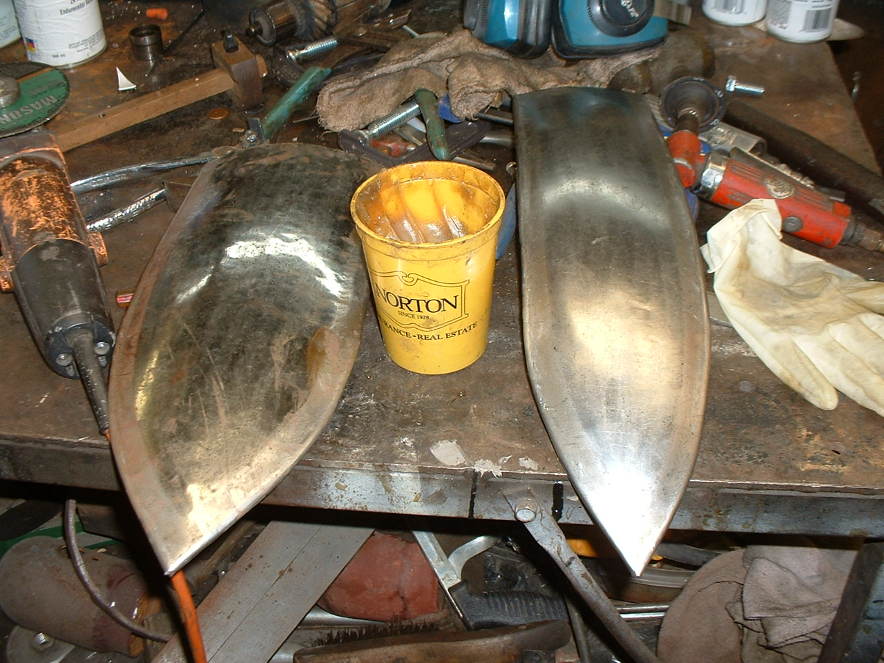

    Here's the final pics.

    Looks cool...Make them three piece like that out of aluminum and rivet them together!

    3 pc with copper / br*** center alum riveted sides

    That would look good--especially with a br*** fin in the middle. Built in running light?

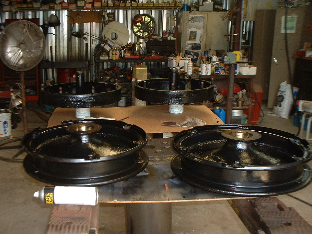

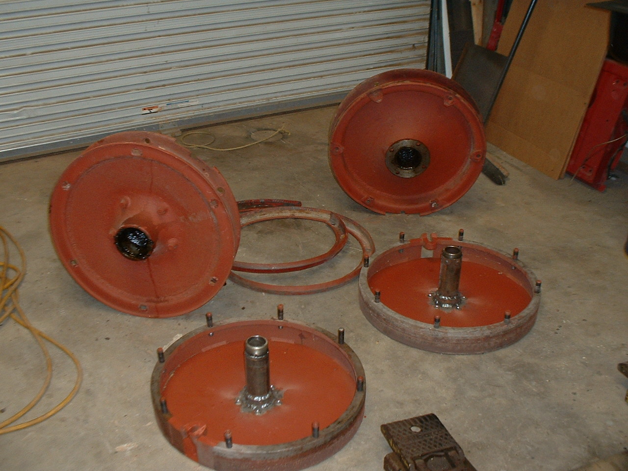

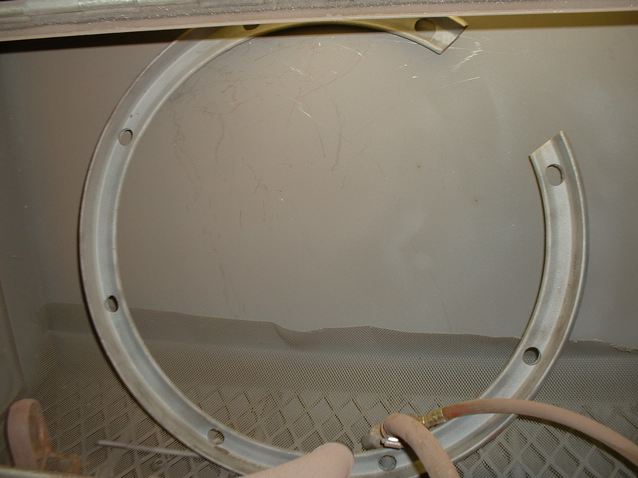

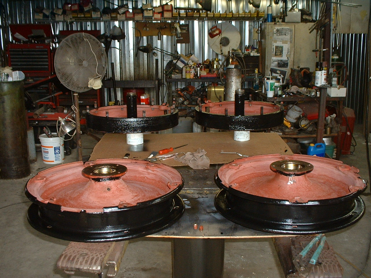

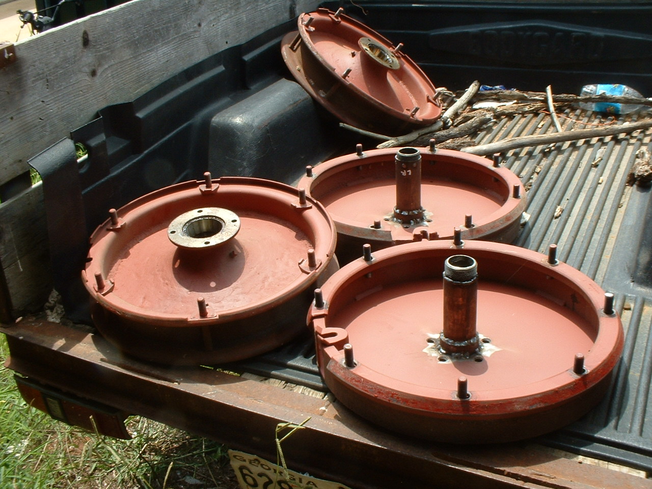

    Wheels
    Too hot to do much. I got the tires of the rims and brought them over to my shop for painting. School starts back on Wednesday. Yay! Maybe I can make a little more progress.
    Jerry
  11. yonahrr
    Joined: Feb 27, 2010
    Posts: 1,348
    yonahrr

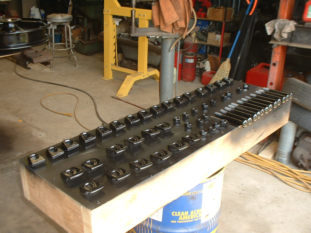

    Wheels
    Today I bead blasted a bunch of wheel parts then I painted the non showing part of the rims. Boring but necessary. While it was drying I started playing with fender metal.

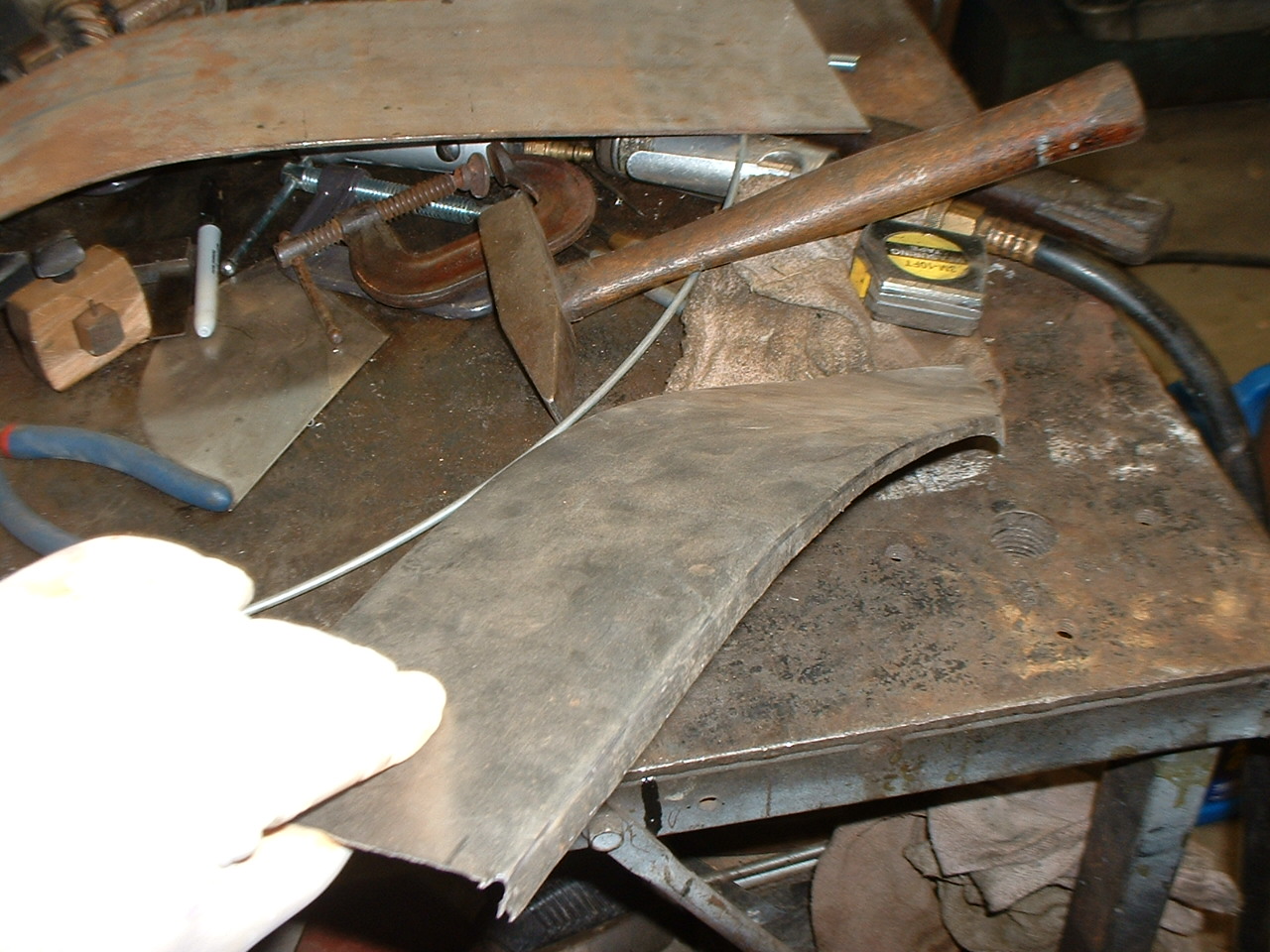

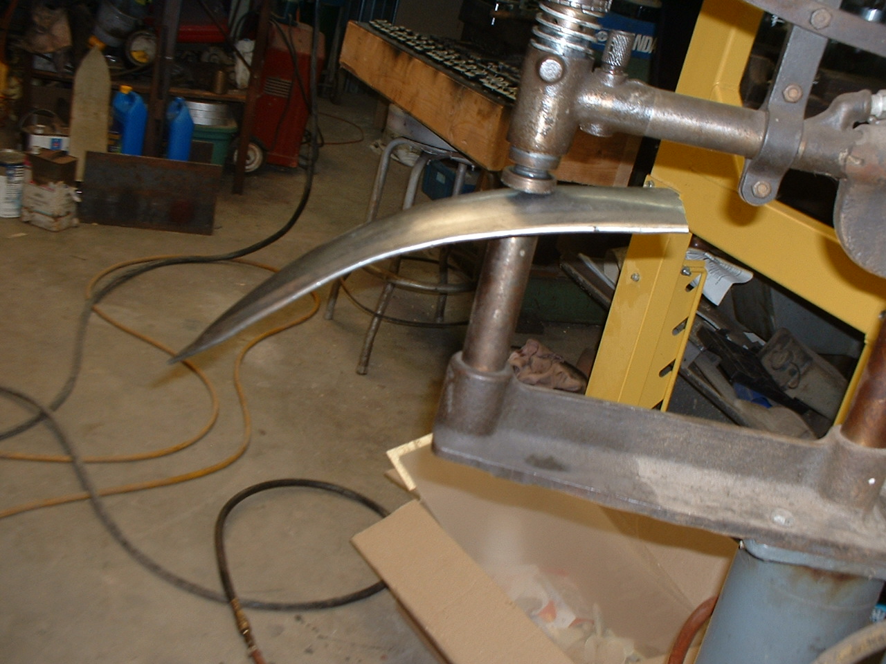

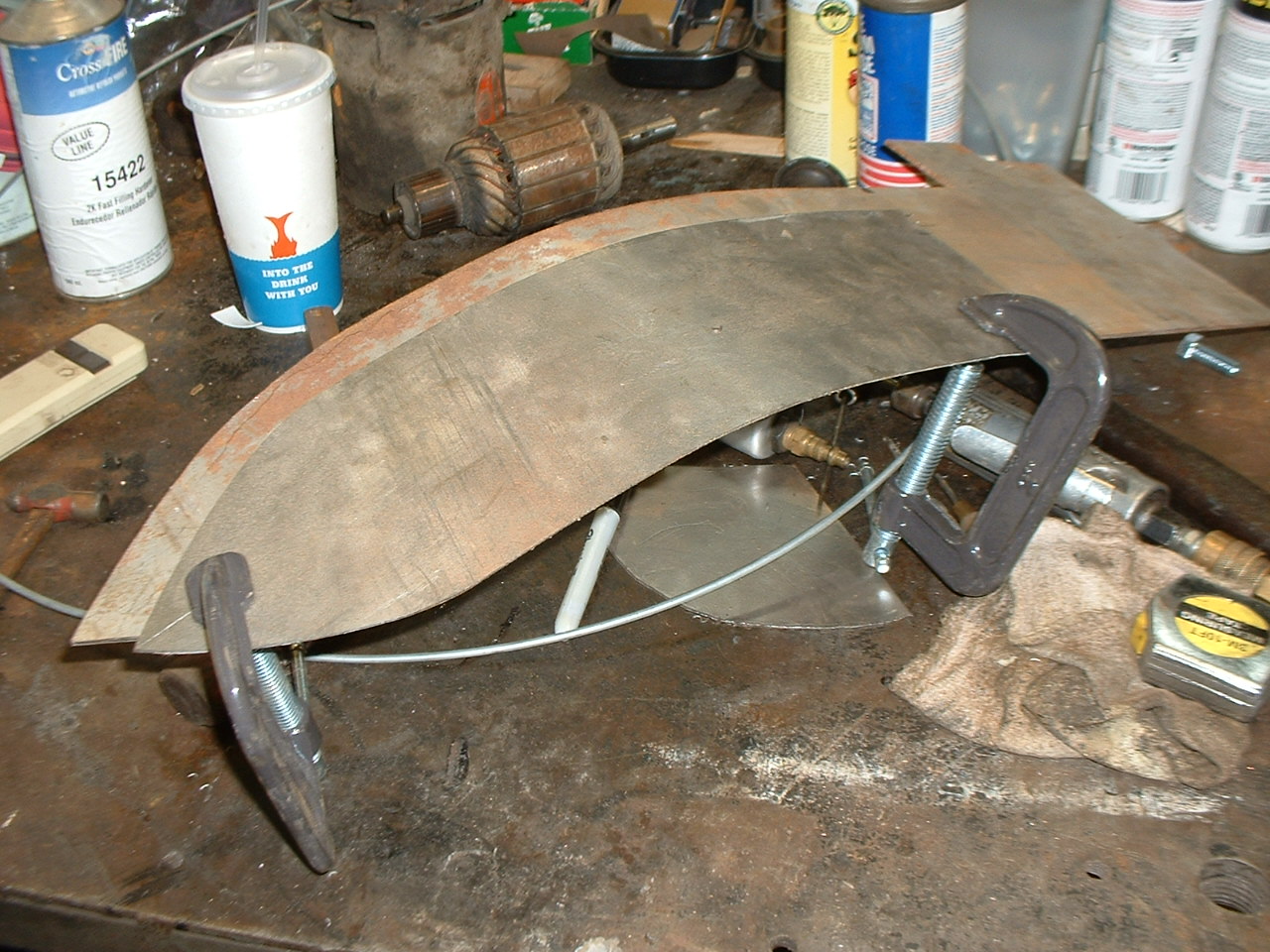

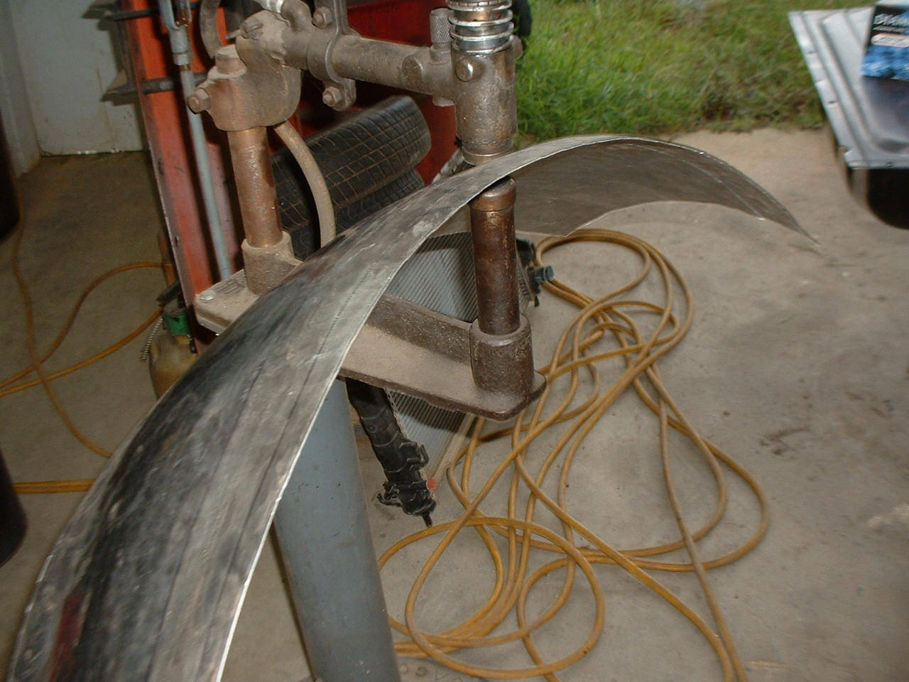

    Fenders

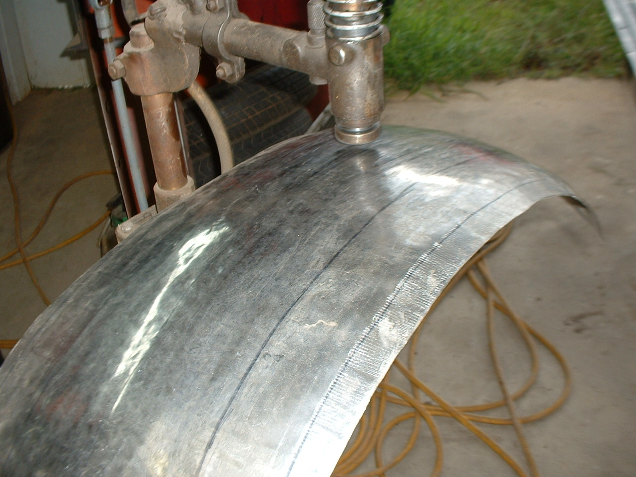

    I started out using the English wheel to try and make a compound curve like I need in a fender. Progress was slow so I turned to an old planishing hammer (WWII) I bought years ago. I thought I'd play around and see what I could do with it. I discovered that it's certainly possible to make a compound curve. If you're not careful you can make a helluva dent in your work. Then you've got to run it through the English wheel to smooth it out. So I guess I need to decide exactly what kind of fender I want then work toward building it.

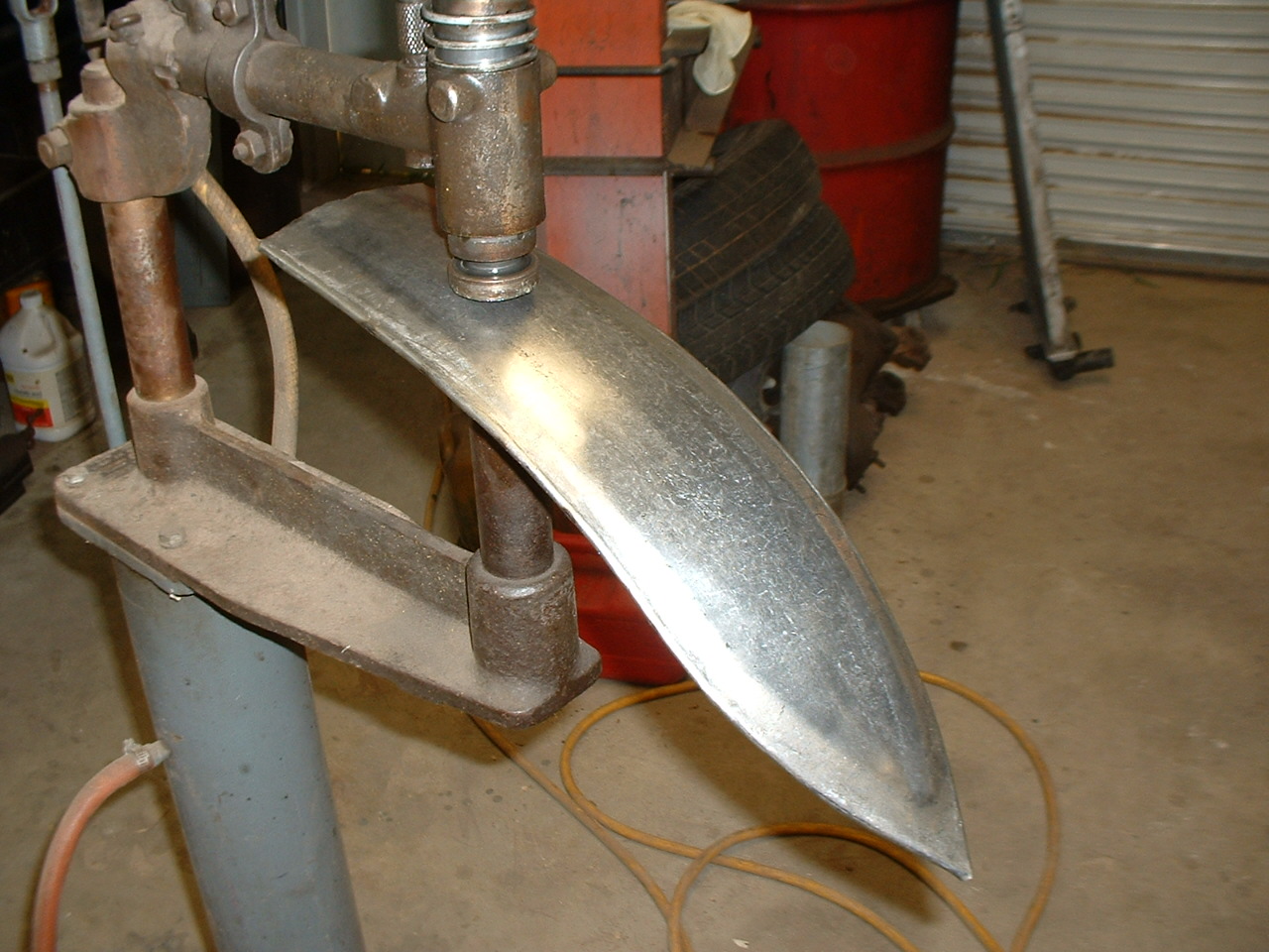

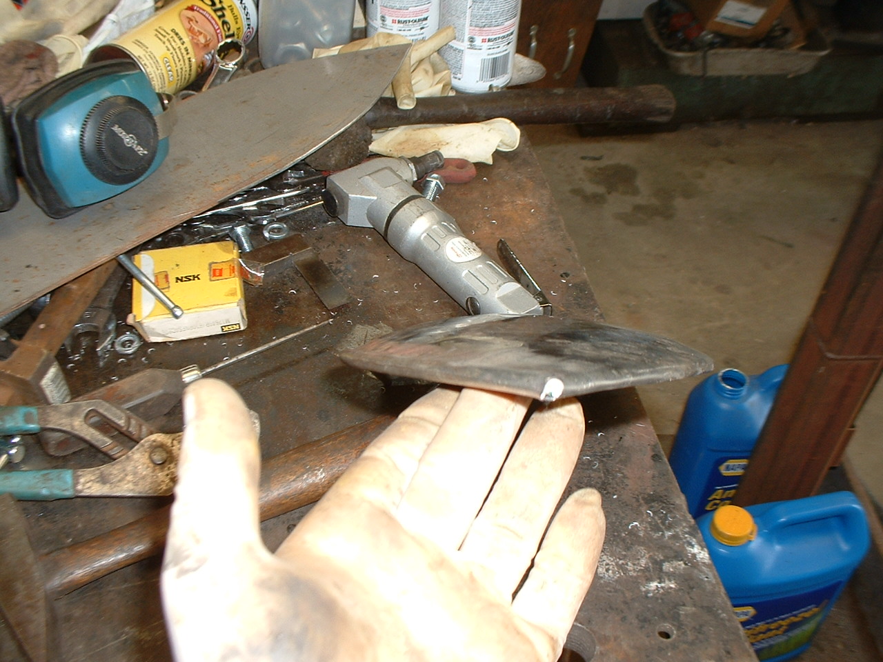

    More wheel paint--plus
    A little more wheel painting today. Tomorrow, I flip them over and decide whether to paint them red as they are--which is rough (that's stock), or spend two days bondoing and sanding to make them smooth.
    I also spent some time on my experimental fenders putting on a point and bending the lip down. Whadya think?
    Jerry

    Those fenders are nice. They are flat and pointy enough too complement your (I mean the Speedster's) angular and pointy body, while still being round enough to look like fenders.
    Keep the wheels rough. You can always smooth them out. They are only original once.

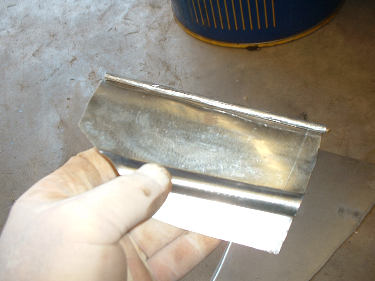

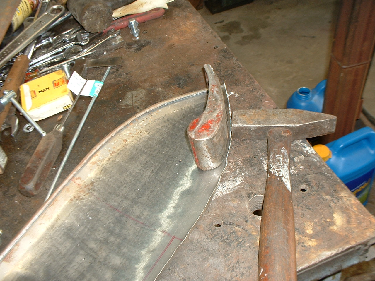

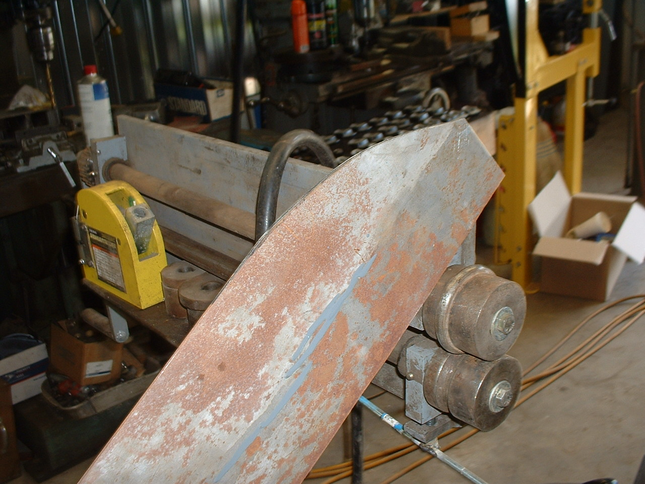

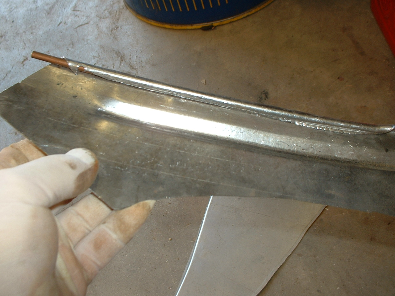

    Fender version 1.5

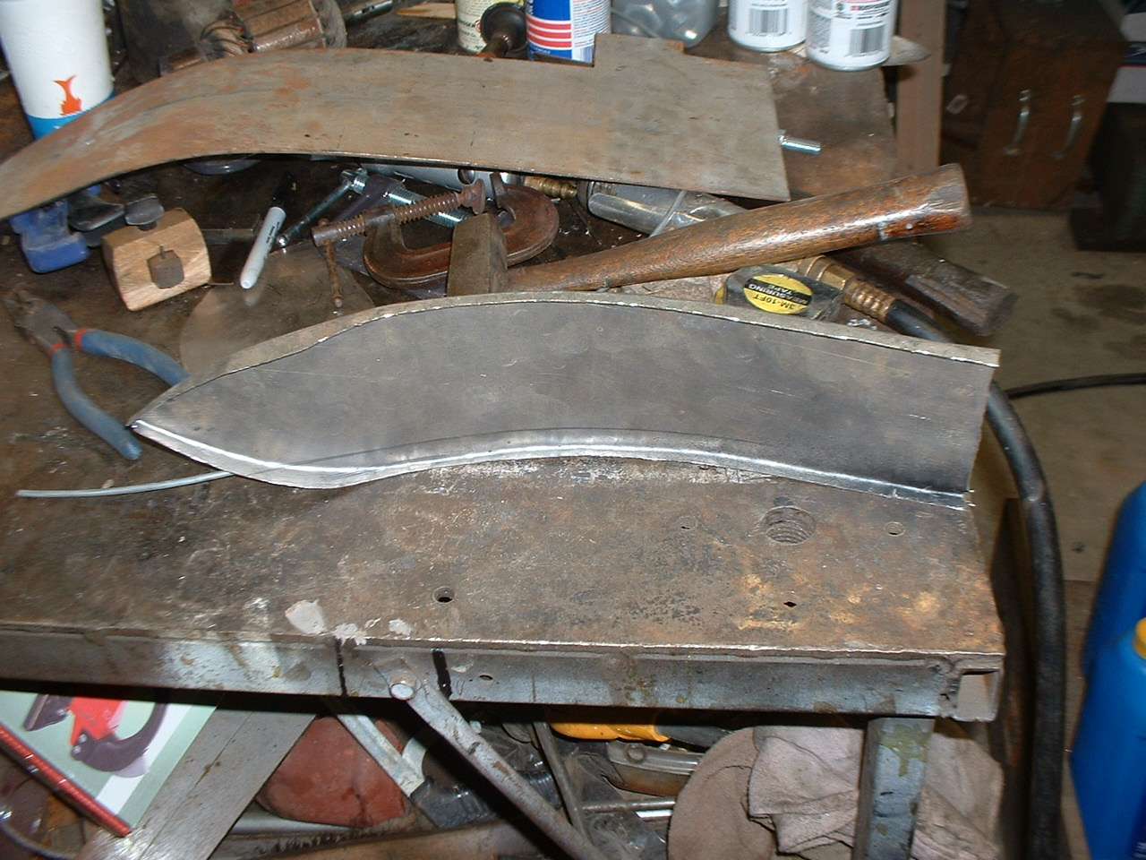

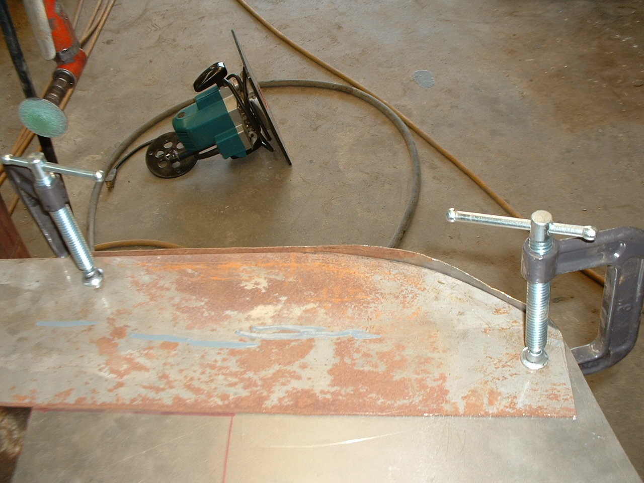

    Ha! You thought I ran off on another cruise. I'll be paying this one off for the next 3 years. Actually, I've been experimenting with a bead roller I've had for about ten years. What did I find out? I don't have the time to develop the skill to make what I want. And what I want is a wired edge. So, I've developed my own way. Well really I stole the idea from someone else. But never mind that. I cut a piece of 1/8 steel into the curve I want then I beat the edge over with a hammer. It comes out perfect. I still haven't figured out exactly how much excess material to leave, that will come later. Then I take away the 1/8 flat, lay in the wire and beat some more.
    Jerry

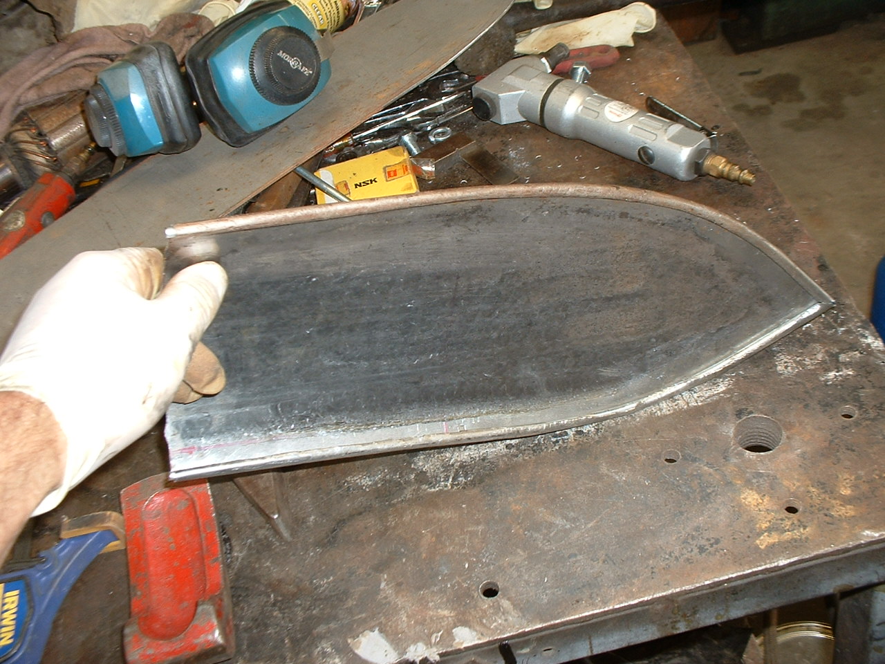

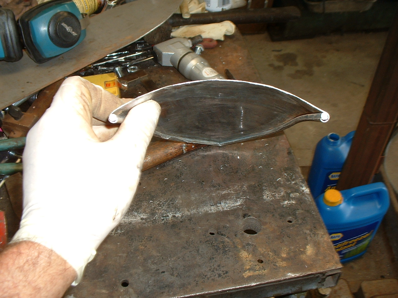

    Fender version 1.6

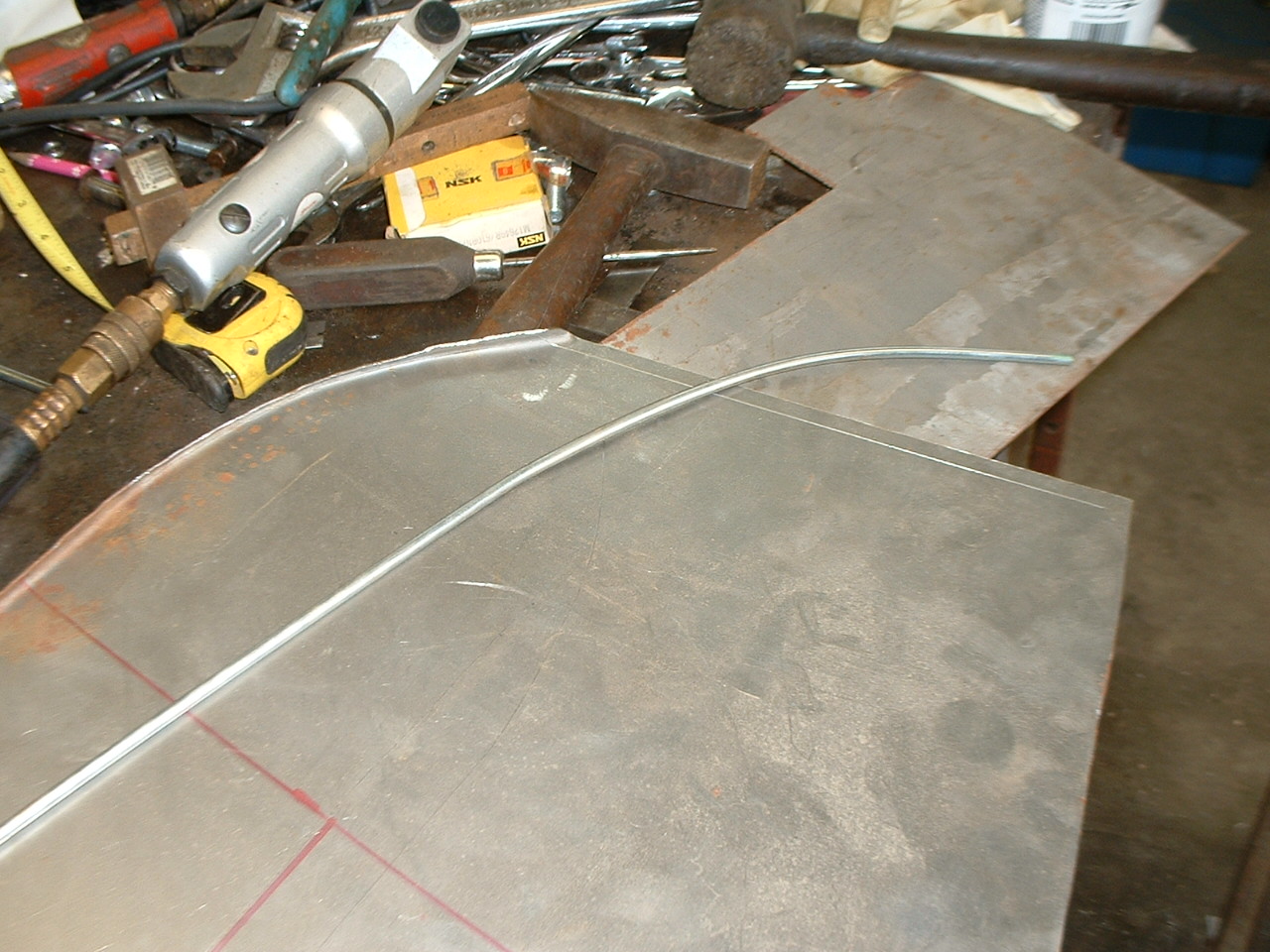

    Now I have a piece of sheet metal with a wired edge on both sides. Next I run it through the planishing hammer until it has a nice curve. I like it! What you see is a smaller version of the real thing. The next trick will be making a making the big curve where it swoops down to the running board. If that turns out okay everything is go.

    You can figure how much material to leave by using a little trigonometry (or geometry and a ruler if your trig is rusty).
    The amount you need to create a fully closed wired edge is the length of 270° on the OD of the wire, plus the radius of the wire.
    Example:
    Wrapping an edge using wire that is 1/8" OD.
    Pi * OD = Cir***ference (or the length of the edge of the circle for a complete 360°).
    We want to know the length of the edge for 270° of that circle, so we take the number we know (the whole cir***ference) and multiply it by the ratio between what we want and what we have: (what we want) 270/360 (what we have) = 0.75
    So, for our 1/8" OD wire, we need to add:
    [(pi) 3.14159 * 0.125" * 0.75] + 0.0625" (wire radius) = 0.357" (or just over 11/32" or just under 3/8").
    Mark you panel where you want the wire to lay (where the bottom edge will touch and the curve up and around will start), then add your 3/8", and it'll wrap around and close just fine.

    Lets see. The circ of circ is piD. So using 3/16 wire that's .1875 X 3.14 X.75 (3/4 around) Why do you add in the wire radius?

    To make up the distance from the 3/4 point back down to the panel again.
    You're starting at 6 o'clock, winding the sheet metal around the wire up past three to twelve and then over to nine o'clock, but you're still not back against the flat part of the panel yet (fully closed).
    The distance to get from 9 o'clock straight vertically back down to the flat of the panel is the radius of the wire.

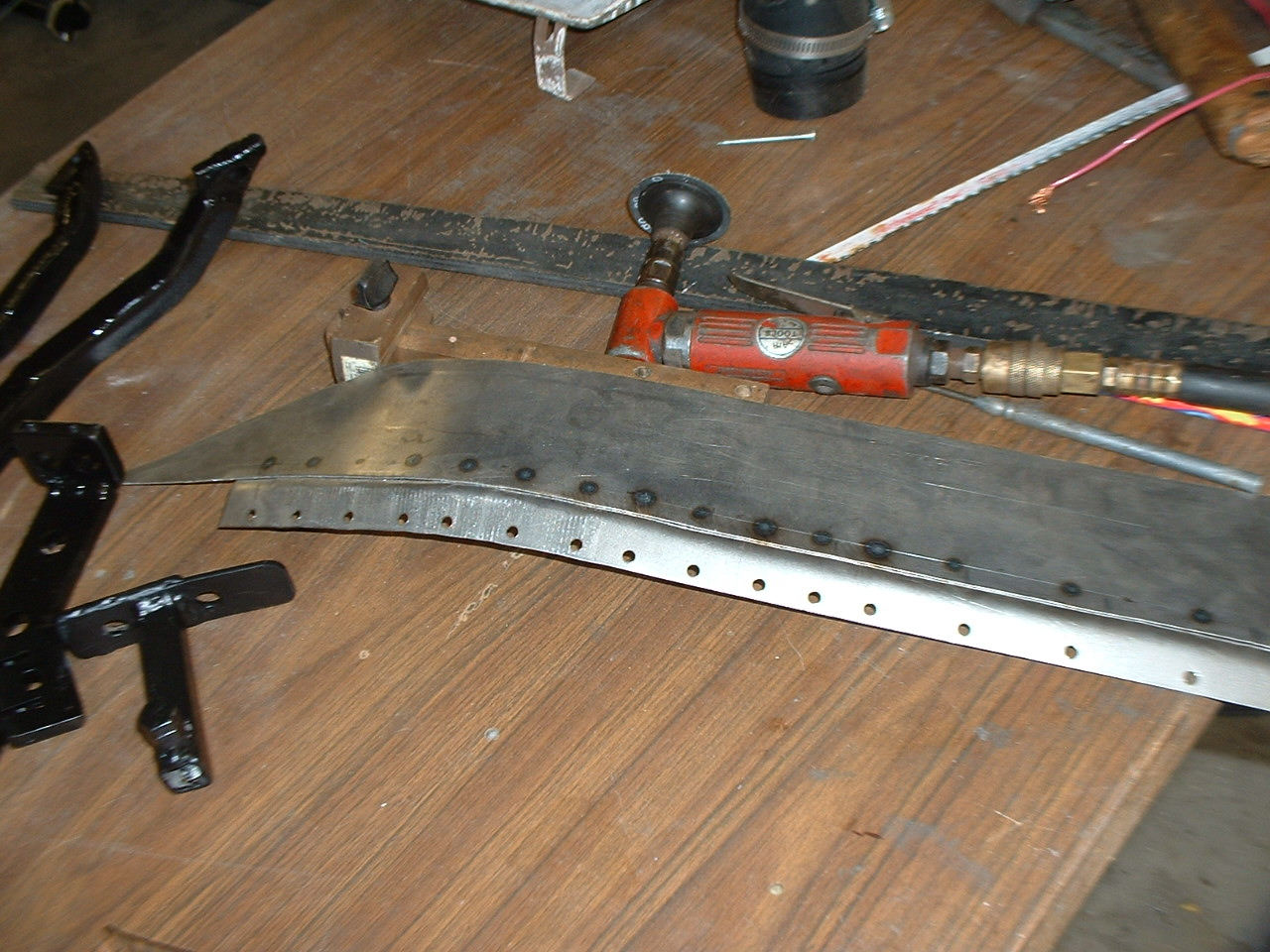

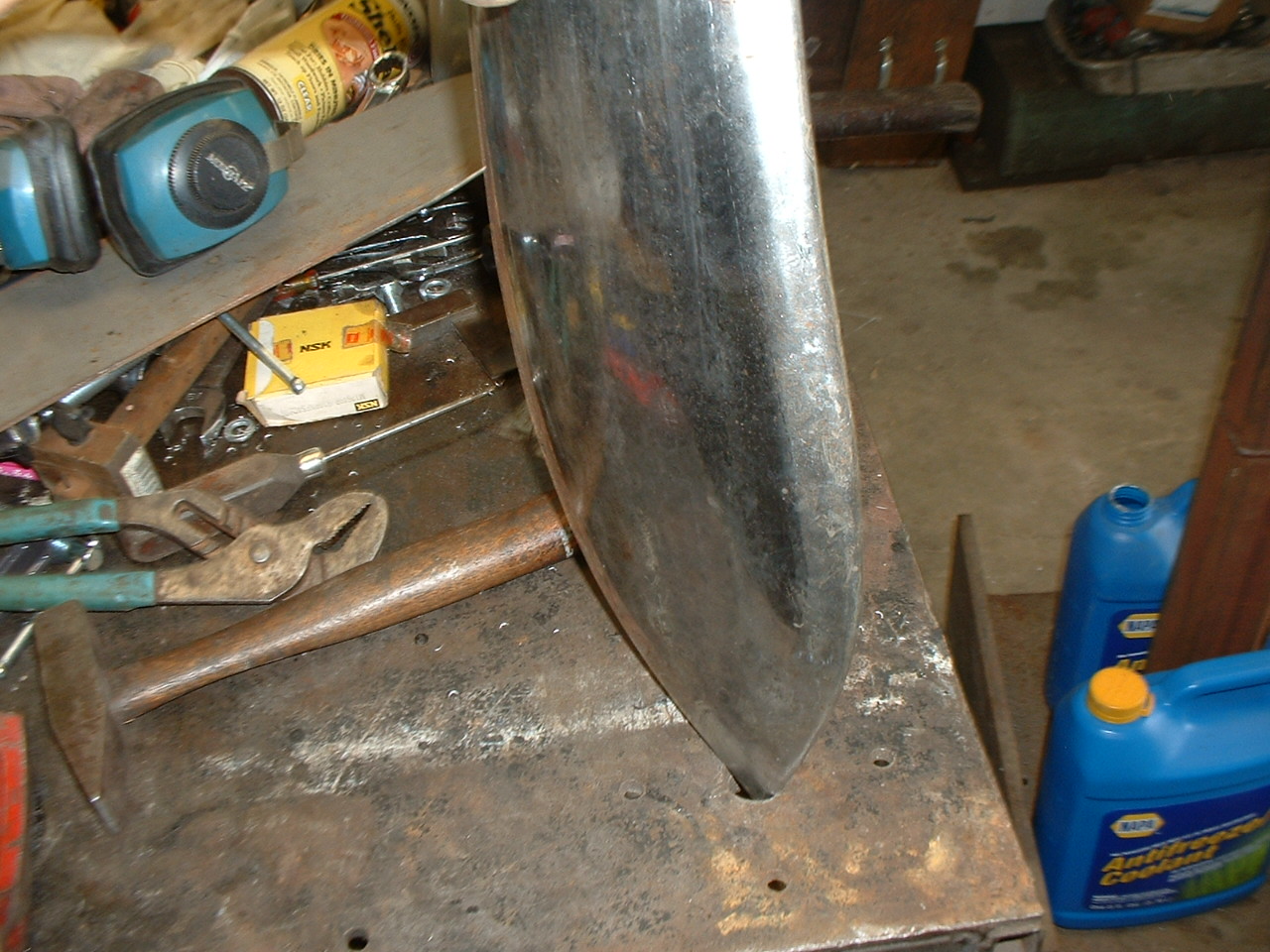

    Fenders version 1.7

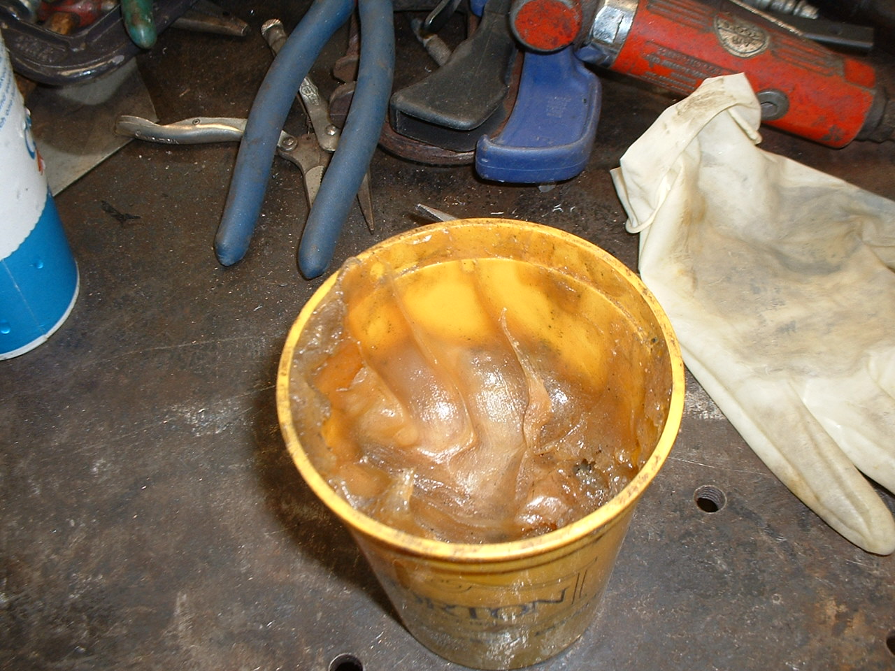

    I was pretty confident I could make a fender top but I needed to know whether I could make the curve that runs down behind the tire. I bent up and wire edged a curved piece of flat metal then ran it through the planishing hammer. It was pretty hard to work back and forth so I thought maybe a little wax would ease things up. I found out a long time ago that the best wax for driving in screws and other shop stuff is toilet ring wax. It's soft and gooey and really makes things slide. I rubbed on a little and found working the metal back and forth was effortless. Cool! My next plan is to make up a jig the shape of the fender that will hold the sheet metal and also the wire in place. Then not only will I be able to beat the edge over and have a clean straight line but also each fender will exactly uniform. I know I should be preparing the body for paint but this fender stuff is fun.
