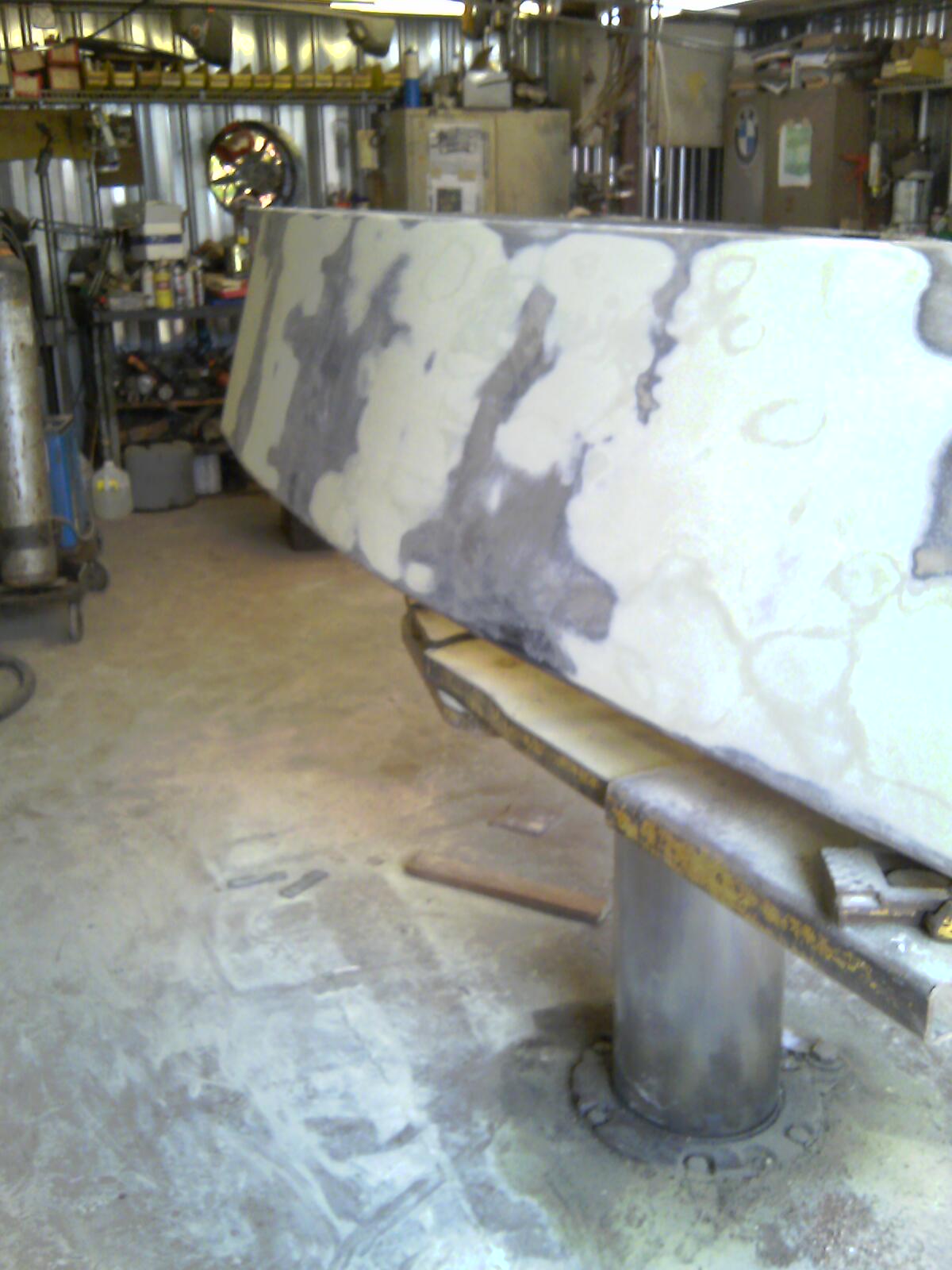

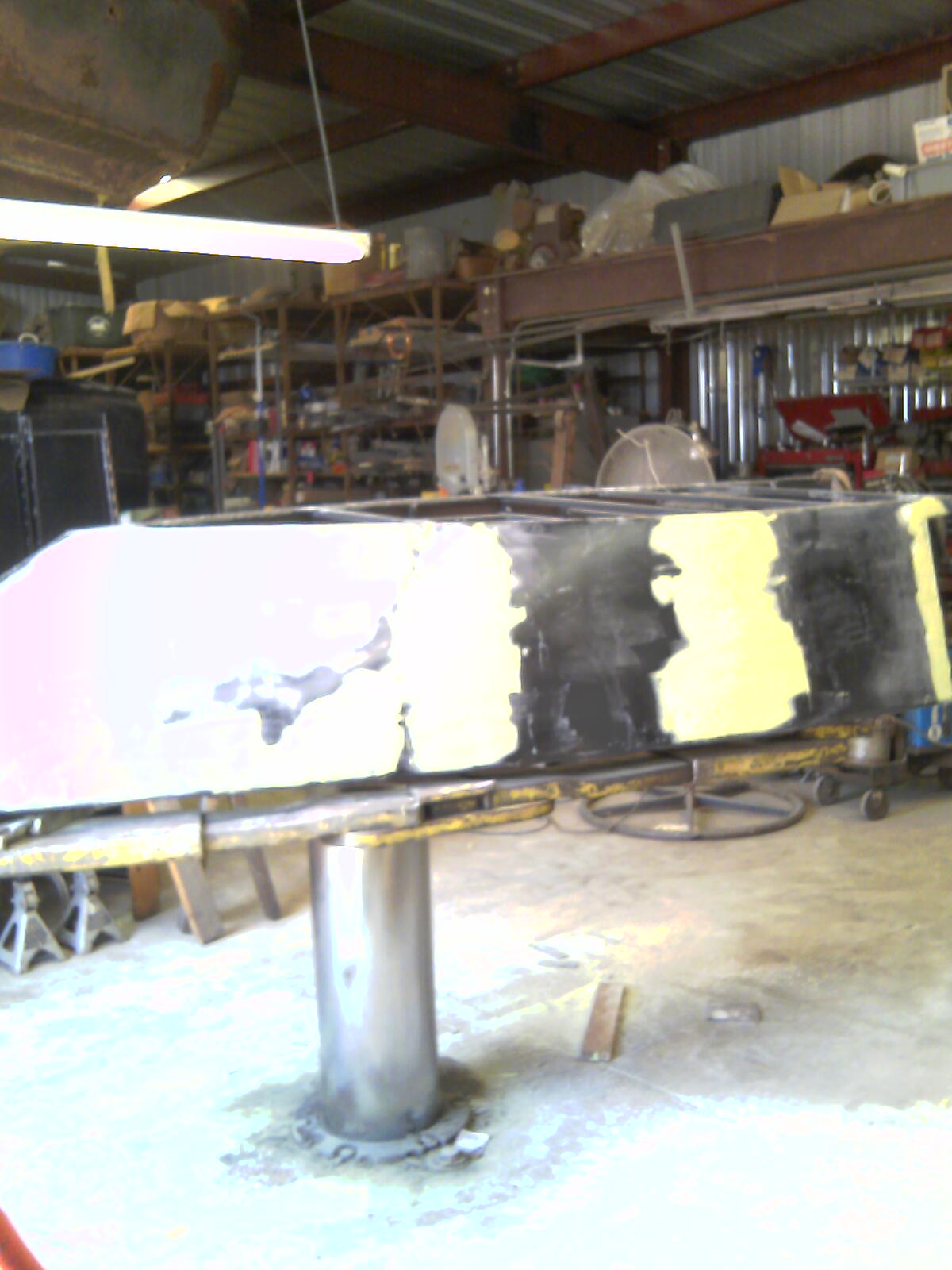

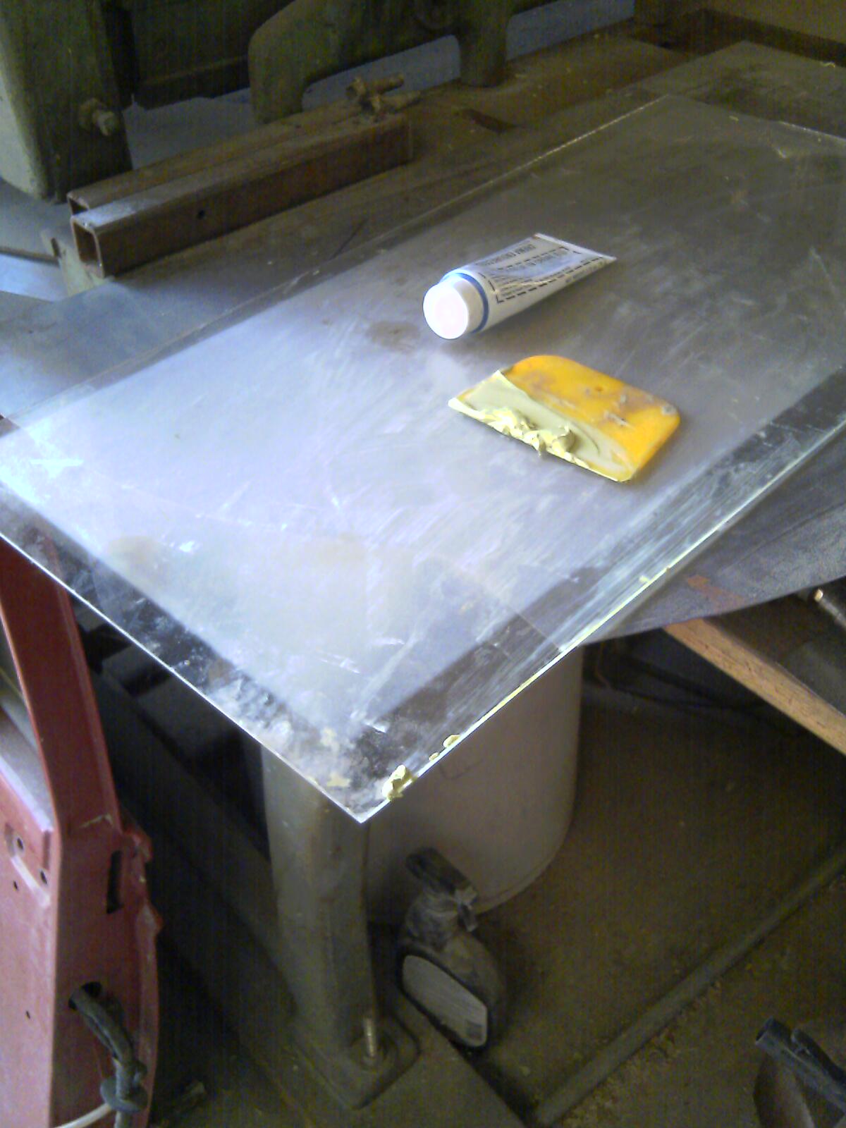

    More Bondo

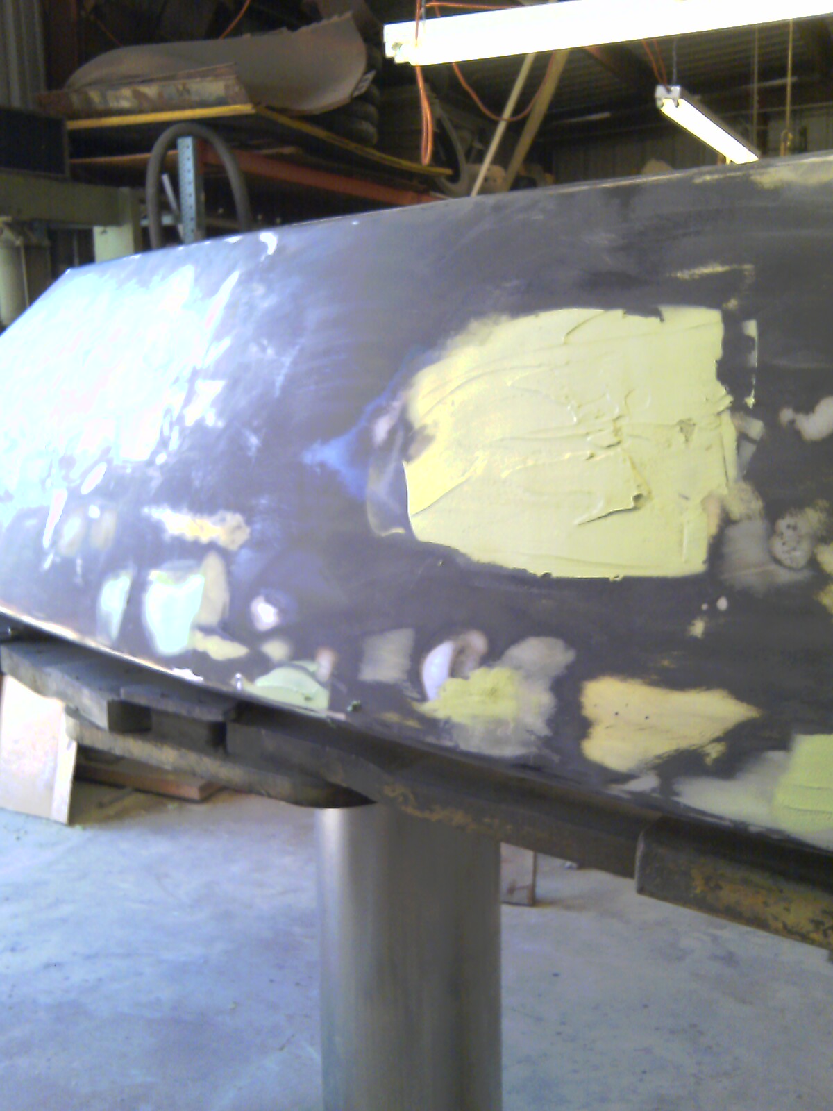

    My camera acted like it had dead batteries but I just changed the batteries. Go figure. I used my cell phone camera but the results are not that spectacular. I used to use a brick layer's mortar board to mix bondo on but over the years I've misplaced the thing. This time I used a worn out gl*** from the bead blaster. It worked very well. Easy to clean. I just applied more bondo and sanded today. The floor is a mess. Maybe I'll be ready for a coat of primer tomorrow. Getting the body ready to paint will be a big step!
    Jerry

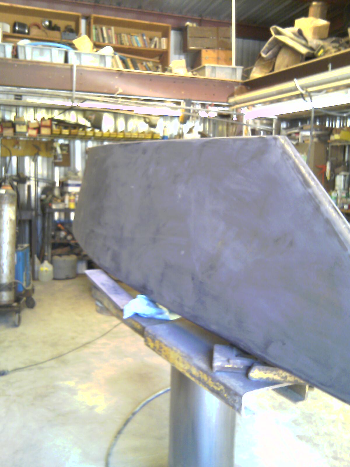

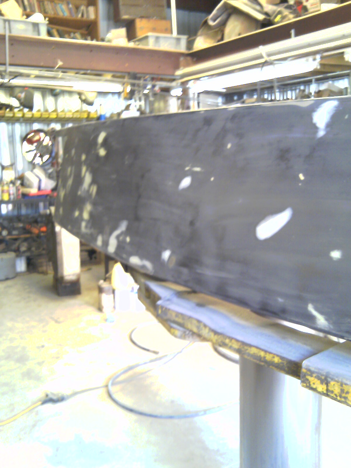

    My camera's gone completely haywire now. I took two pictures before it gave me an error reading. But now they're gone. Not much to see anyway. I finished the rough bodywork and sprayed it over with primer. Now I need some hi build primer and block sanding.
    Jerry

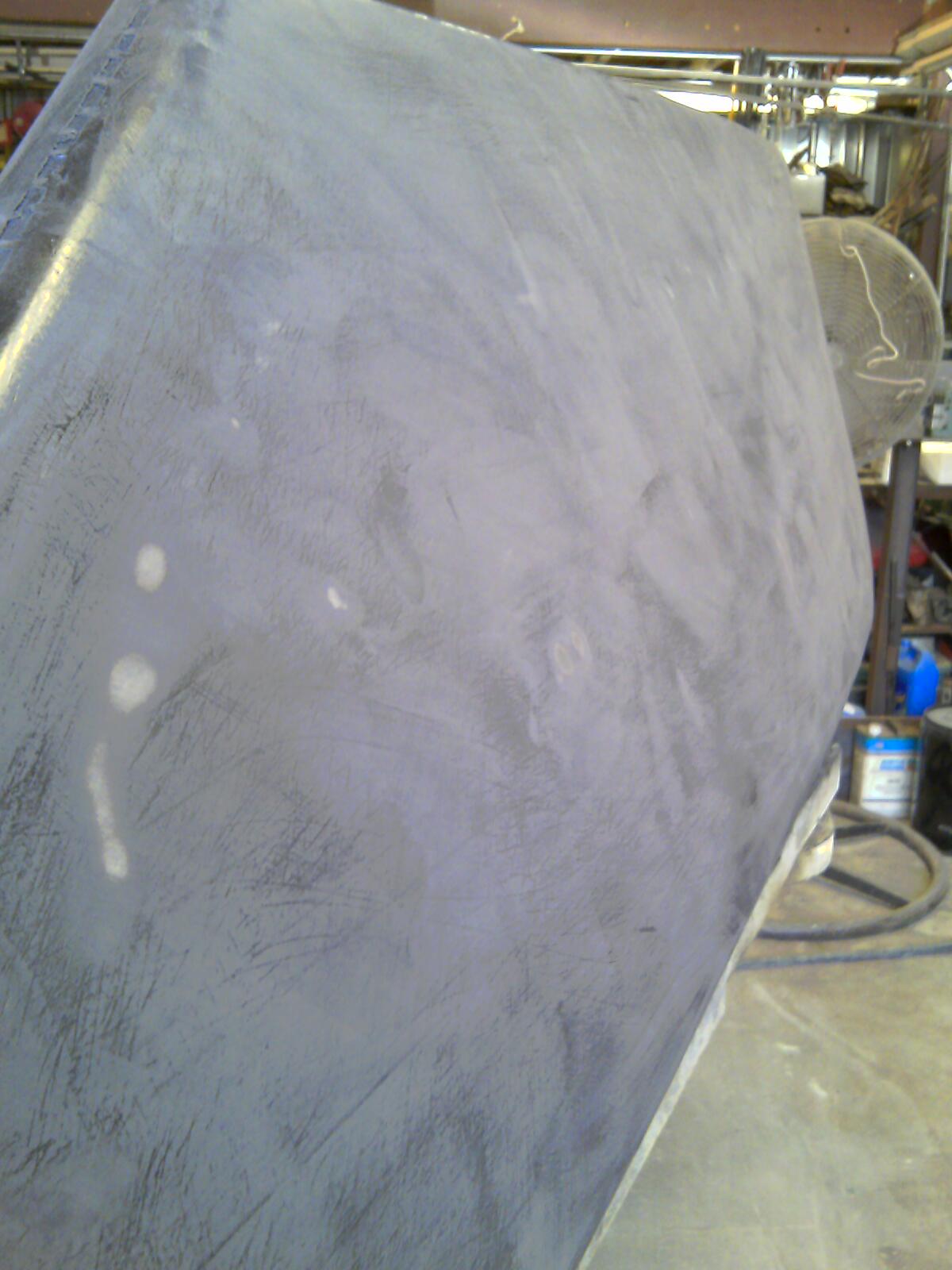

    Blocking

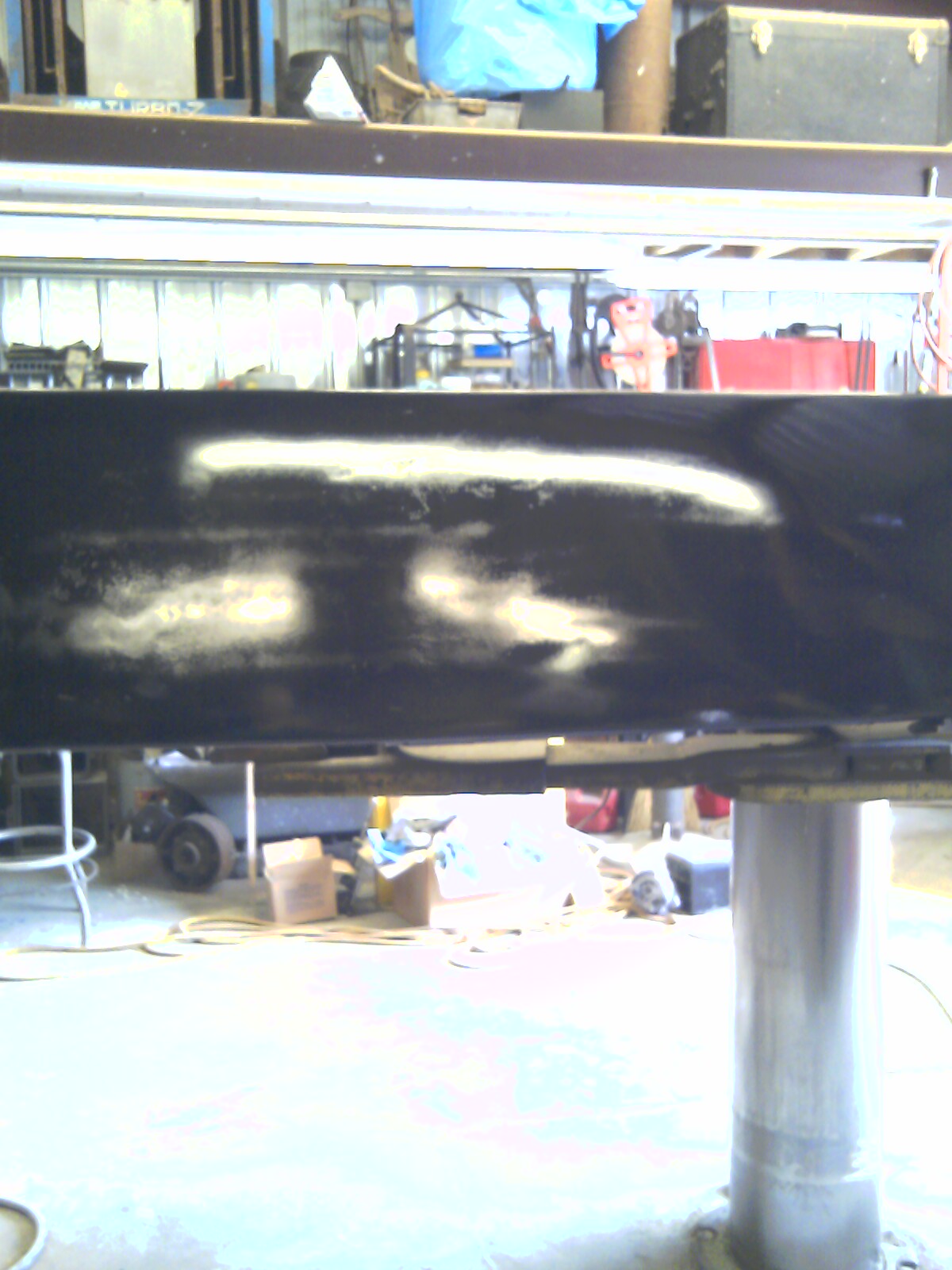

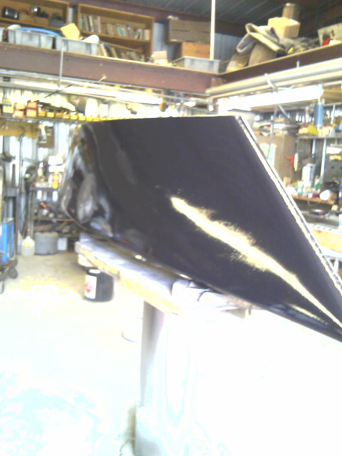

    This is fun. You hand sand a panel until it reveals all the low and high spots. Then you fill them in and repeat the process, repeat the process, repeat the... You get the idea. There's a kind of Zen about it which I think actually means your mind is dulled and you achieve a zombie like state. Actually it's not too bad because you know you're nearing the end of the process. I had to use my cell phone again but I have picked out a camera to buy--GE X500 BK. It's sort of a tween camera but I like the 15X optical zoom. Most importantly it's cheap--$128.
    Jerry

    More blocking

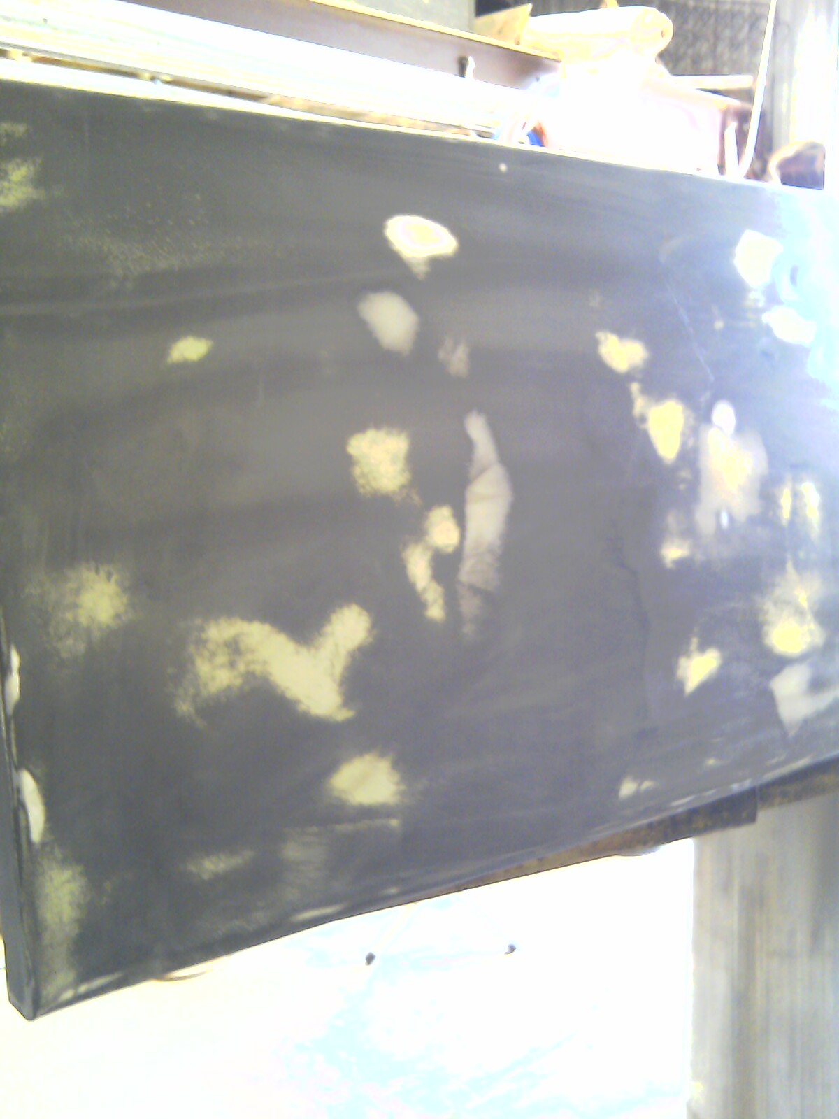

    I know it looks like I'm going backwards--maybe I am--but I don't think so. Mountains and valleys keep showing up so I patiently sand down the mountains and fill in the valleys. Keep going. Keep going. Arms tired. Getting weak. Must--be--kryptonite. Or possibly kryptonite colored bondo.

    Joined: Dec 22, 2008
    Posts: 137
    thirdstreettito
    Are you using a fairly stiff longboard?
  21. yonahrr
    Joined: Feb 27, 2010
    Posts: 1,348
    yonahrr
    Real stiff, the base of an old air-file.
    Jerry
  22. vividlyvintage
    Joined: Aug 17, 2010
    Posts: 671
    vividlyvintage
    Try cross hatch sanding with your long board using 120 grit.
    if that gets it close as it should, then with your rigid long board sand in a circular motion which will blend the surface together. Also depending on your climate your bondo/putty can be shrinking. Maybe allow it to dry for a 8 hour period, that may help.

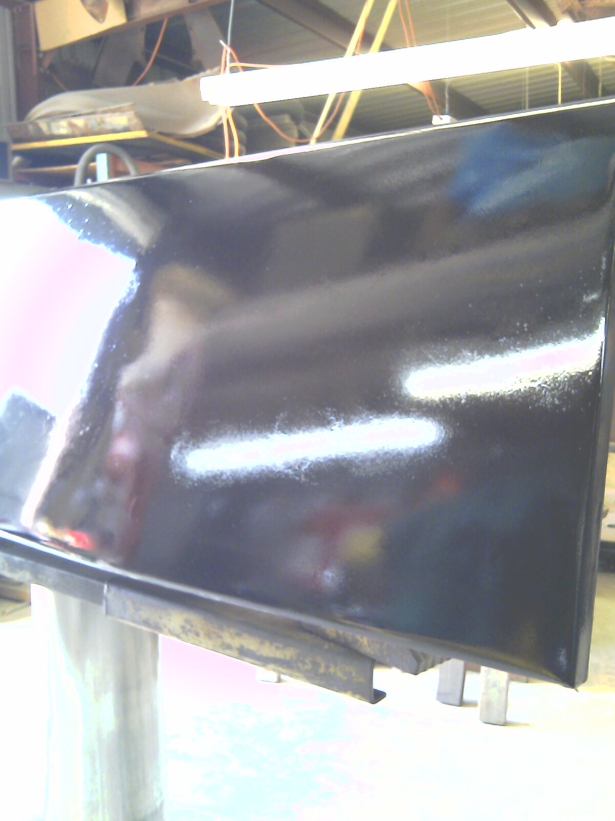

    Primer

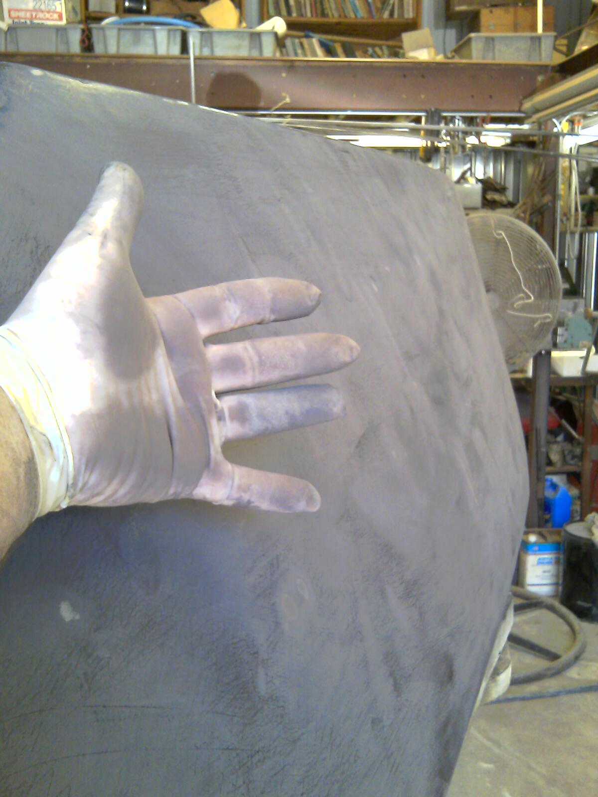

    I've finally got all the heavy body work done so I shot on some more primer. I don't know why I bought black but I'm stuck with it now. Sorry about the phone pics, but my new camera is on the way from Amazon--along with my month's supply of Chinese ******--a one pack. Just kidding about the ******, I use only American made.
    Jerry
