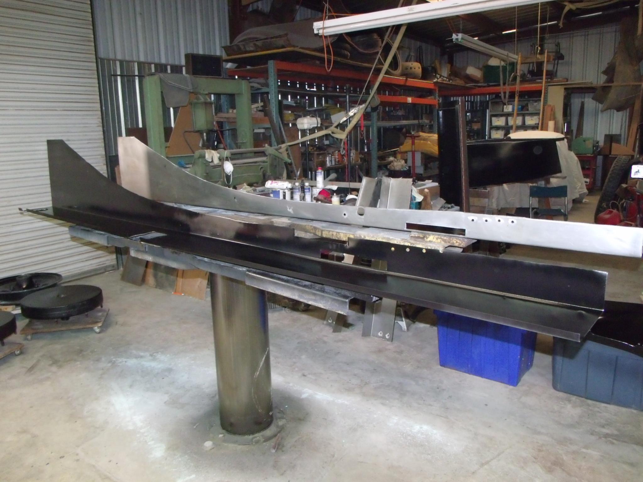

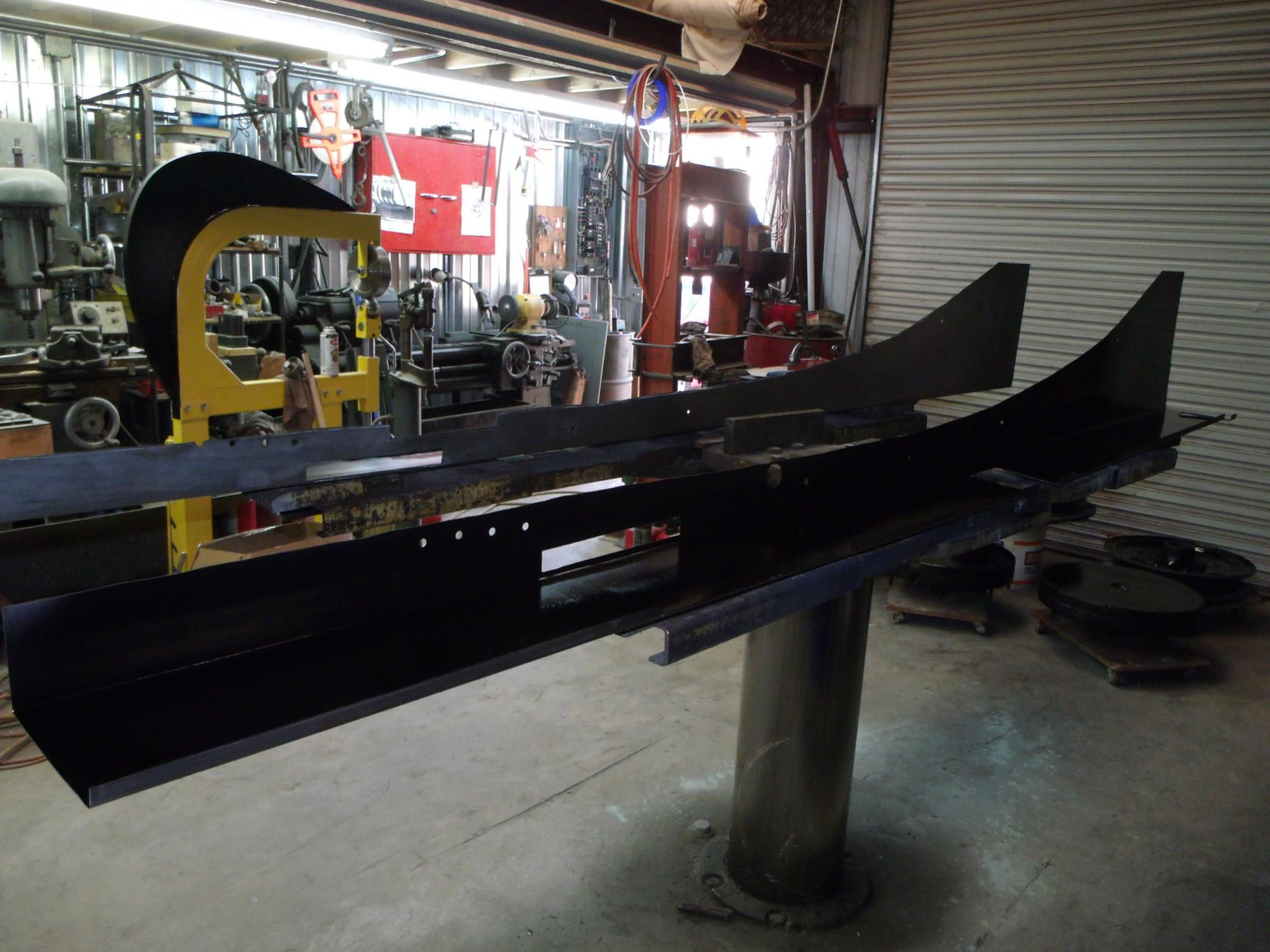

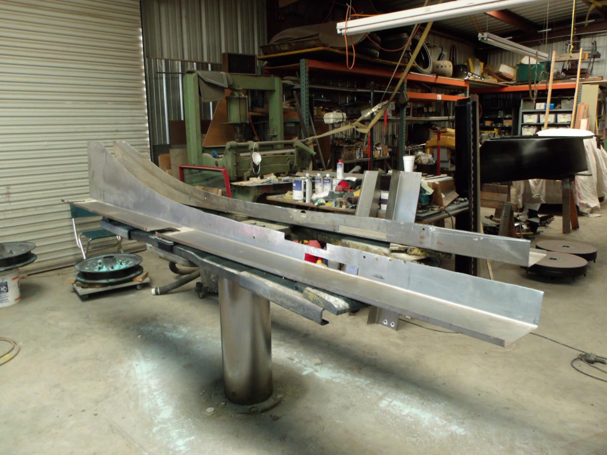

    New bodywork.

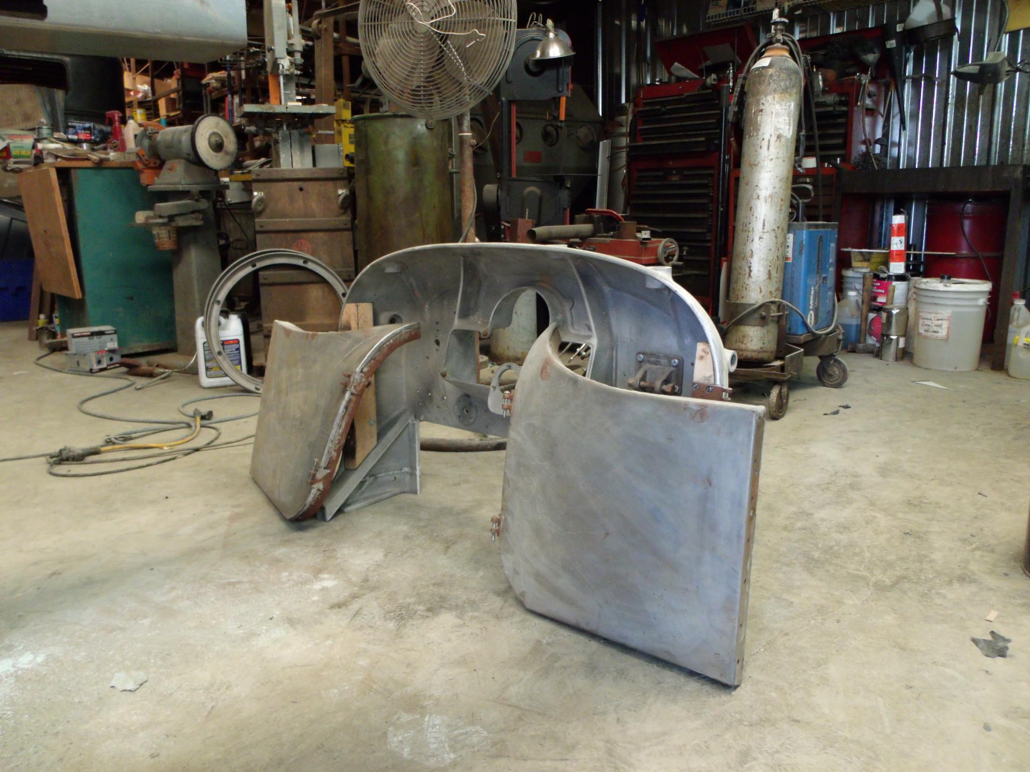

    Well, I'm ready to start on the apron, cowl and doors. I worked a tiny bit cleaning up some metal work but I had to head home. We want to go to a 9/11 ceremony at Habersham High School. The Governor and a military band will be there. Ya'll come!

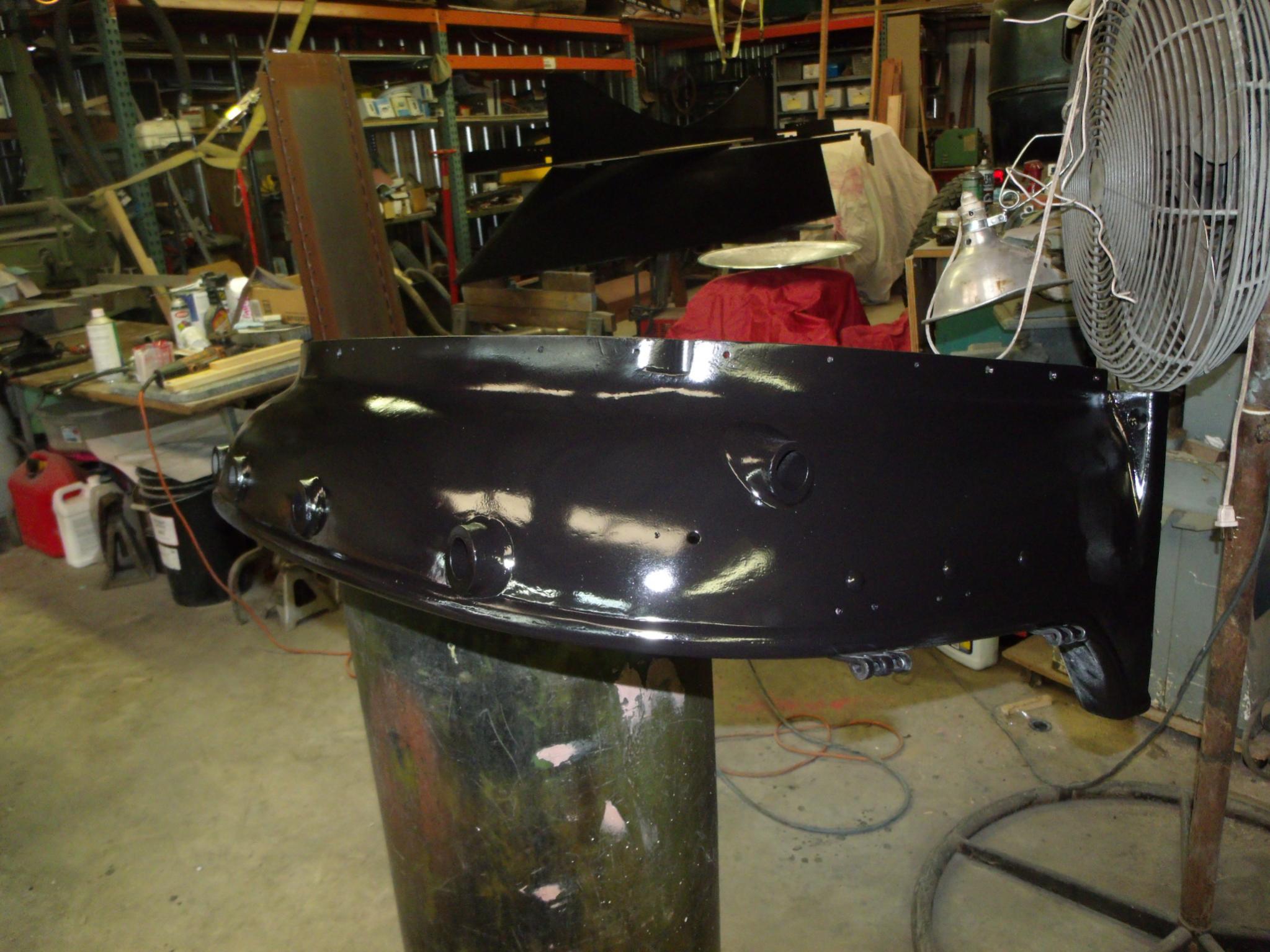

    Primer

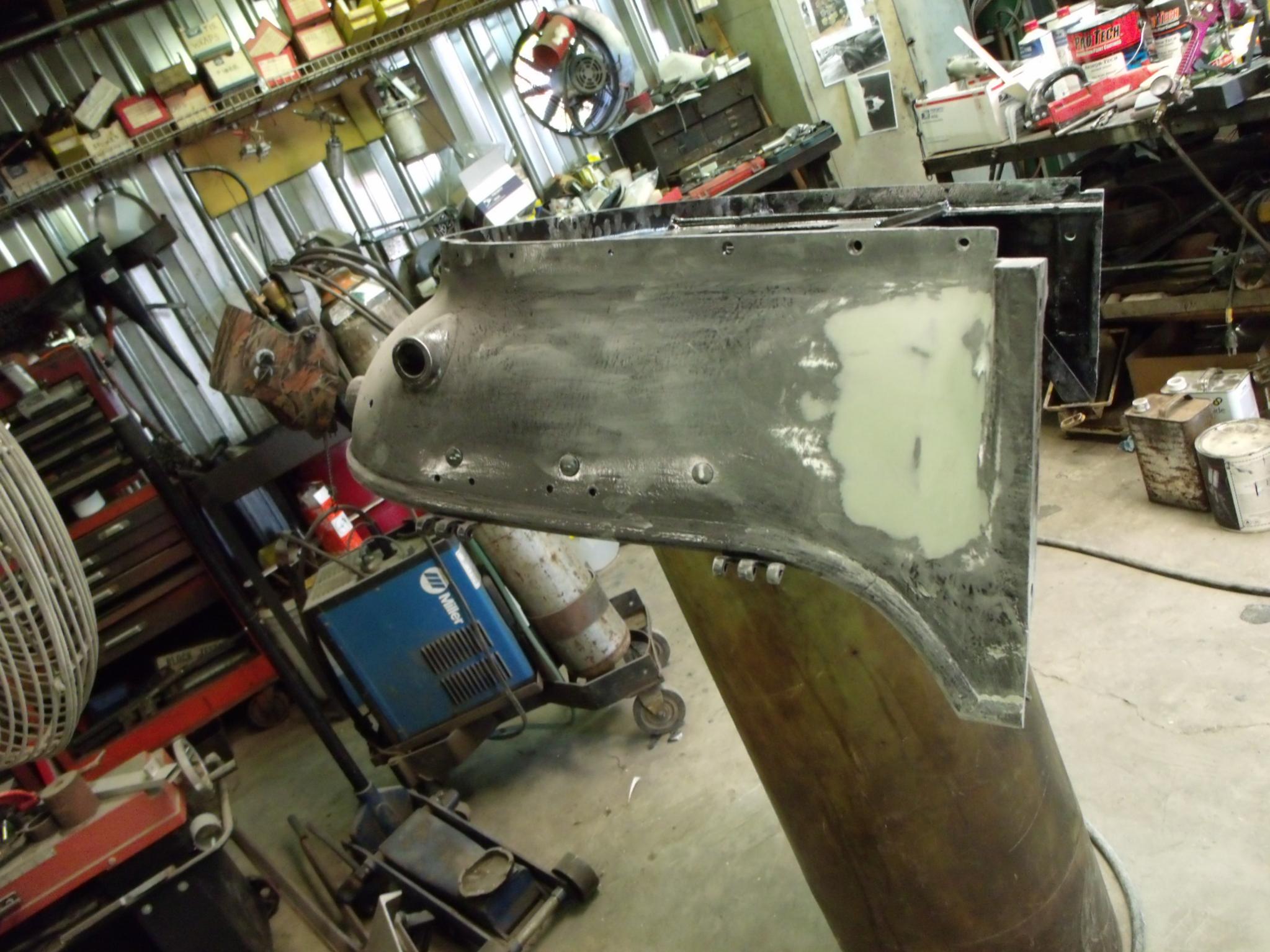

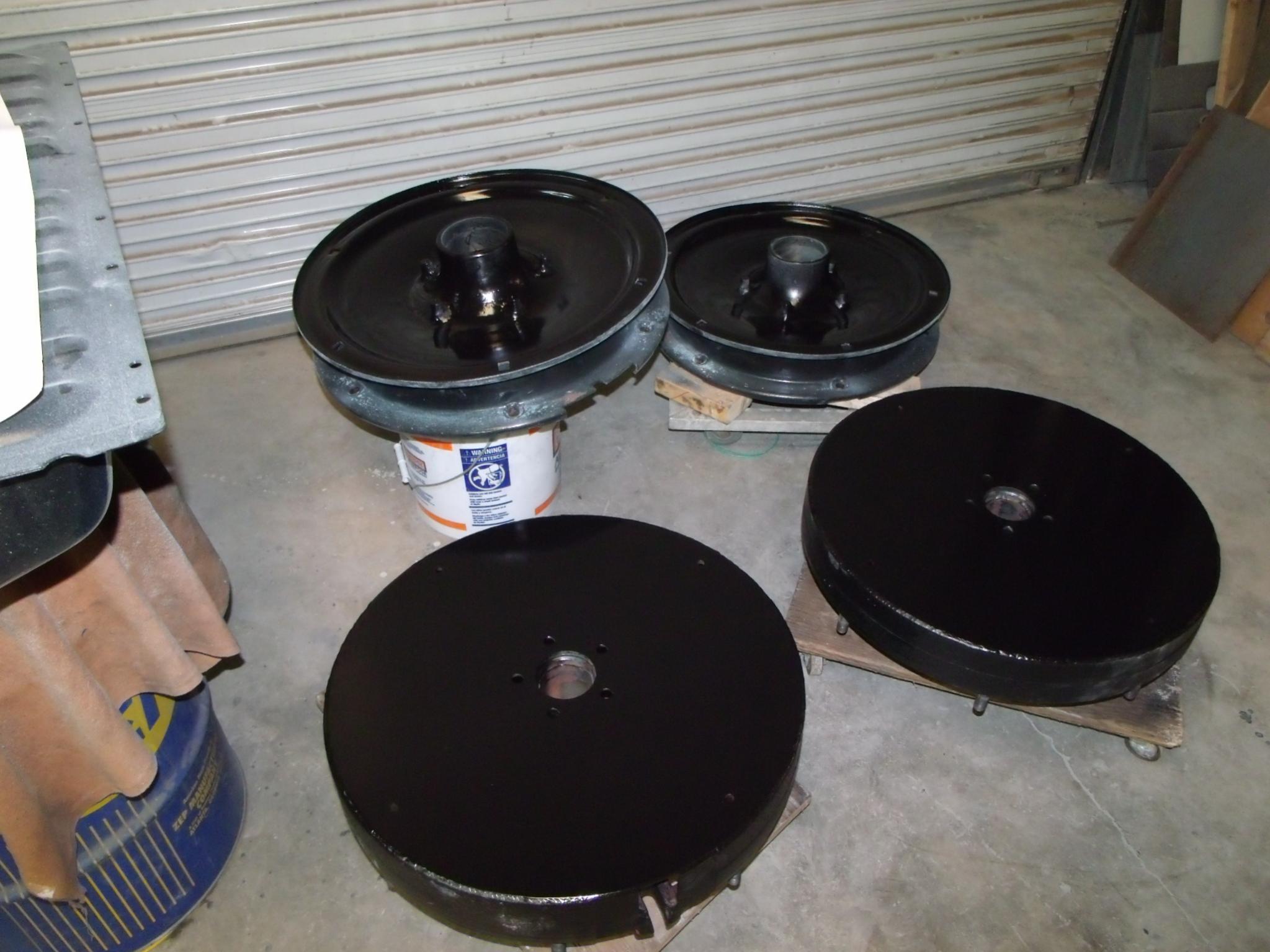

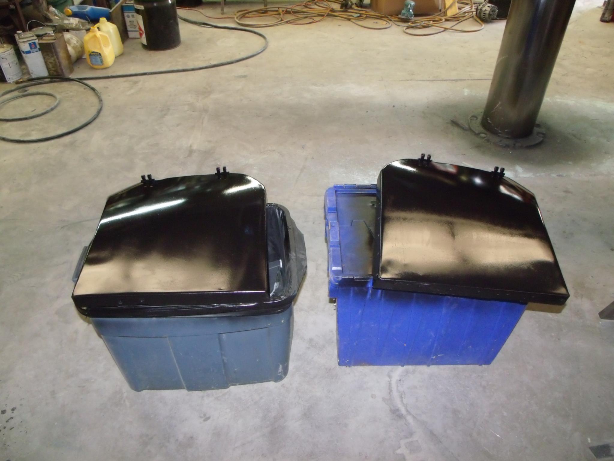

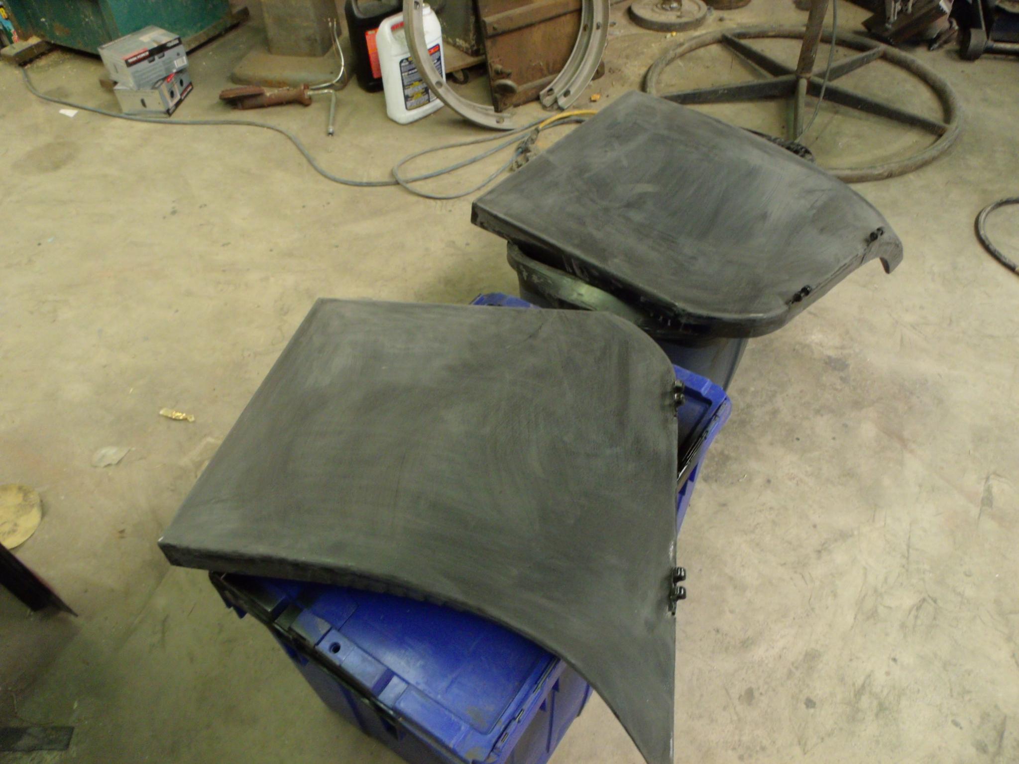

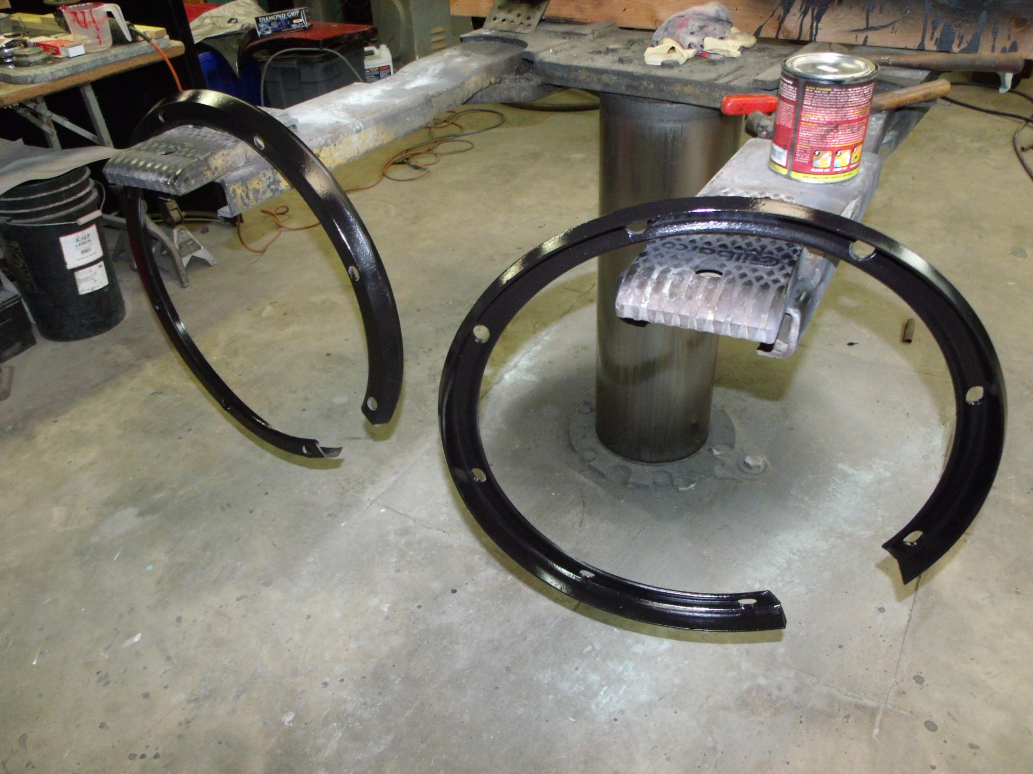

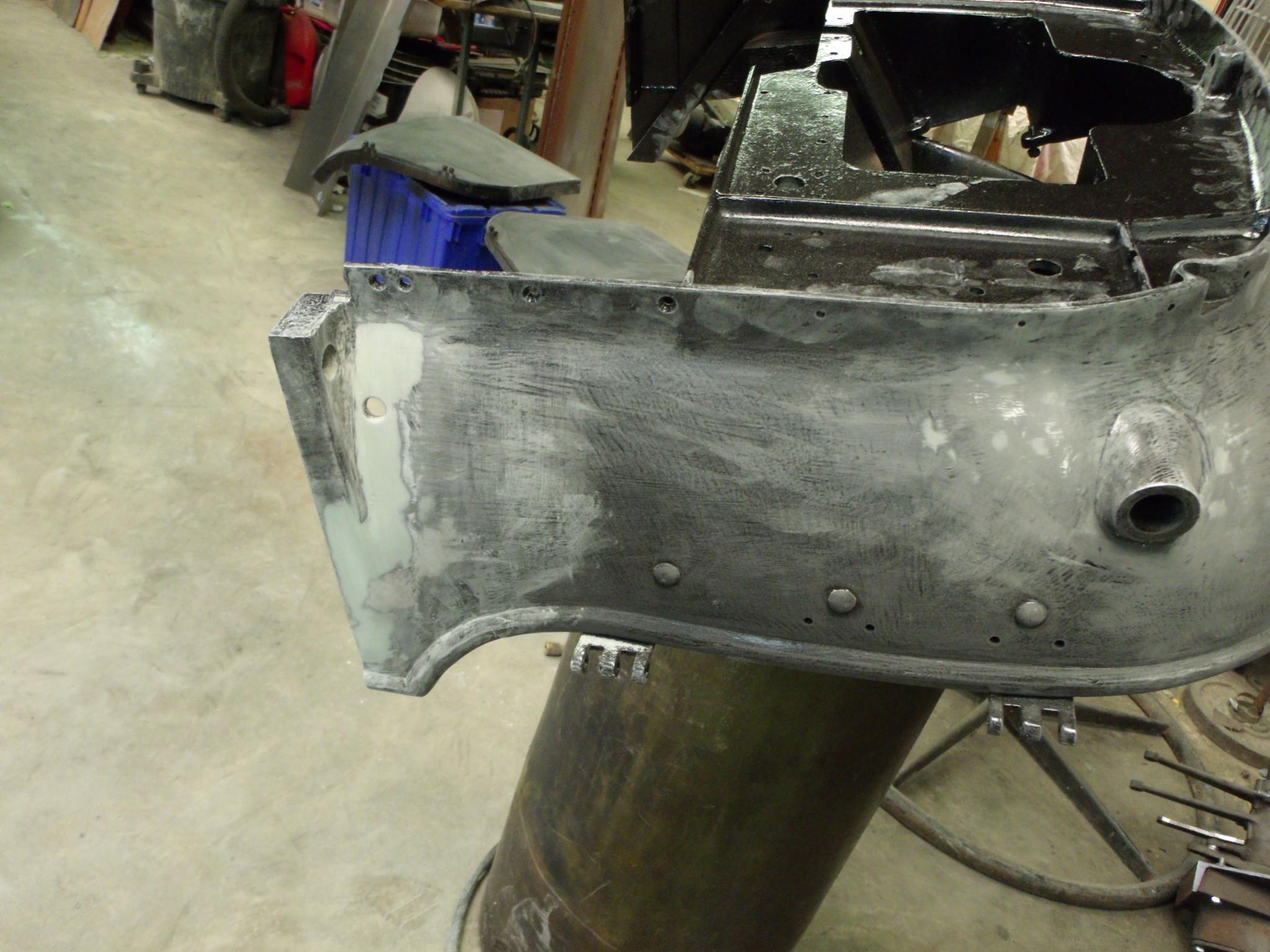

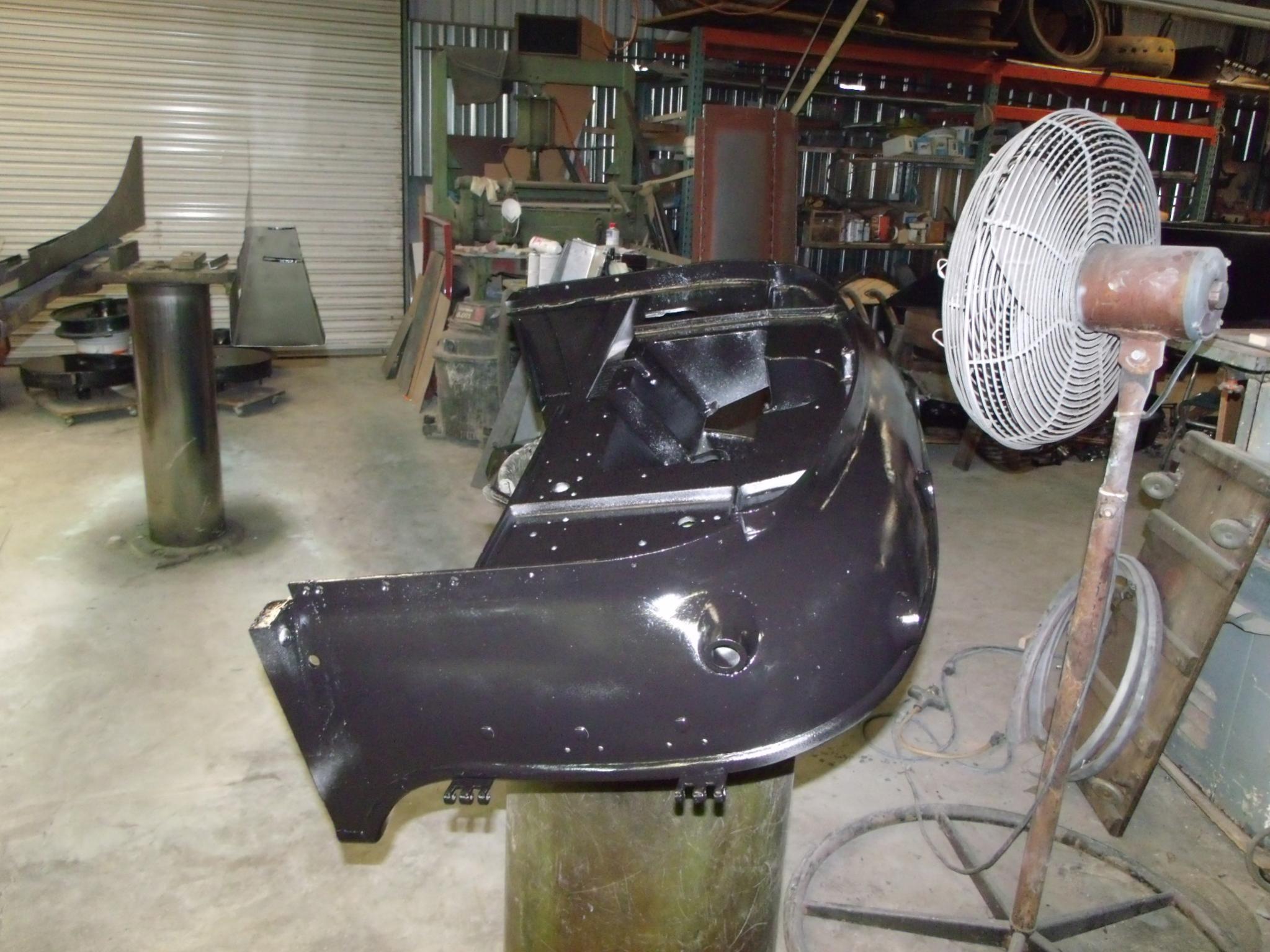

    I prettied up the metal work on the aprons a bit then I sanded and metal prepped and sanded again. I did the same with the doors and the cowl. I finished up the wheels then shot everything with epoxy primer. Next I might paint the wheels red. Then I can reinstall them on the speedster and get it off the jack stands. Anyway you look at it there's more painting and priming to come.

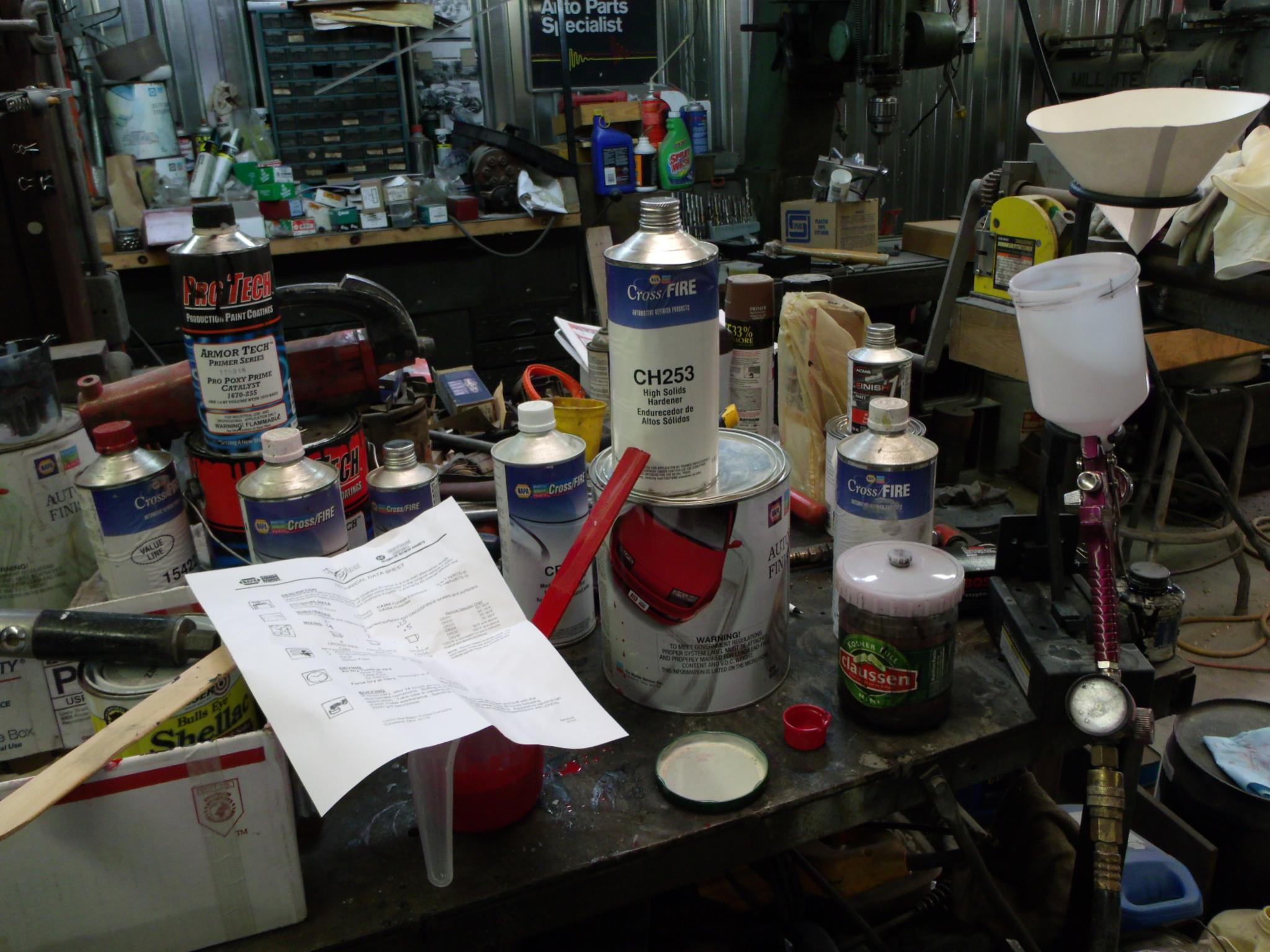

    Now remember I know very little about paint. So I had the wheels all prepped and I thought: I'll practice painting on them because it's only the backside of the wheels and how hard can it be? I got out the instructions which said 4 parts paint, 2 parts reducer, 1 part hardener. I should mention I'm using single stage urethane. So I open the can and right away I notice the paint is way thinner than the acrylic I used to paint the frame. But what do I know? I mix up the paint in the recommended proportions and wow is this stuff really thin. But what do I know? Then I paint. I had to use very very light coats to keep from running and the finished product looked like ****. So here's what I want to know. Is urethane usually that thin? Did they mix it wrong? Do I not know what I'm doing--yes! I'll visit the store tomorrow and ask.

    I checked on a few bulletin boards and guys are saying use it 4:1:1 or even 4:1. I knew something was fishy.

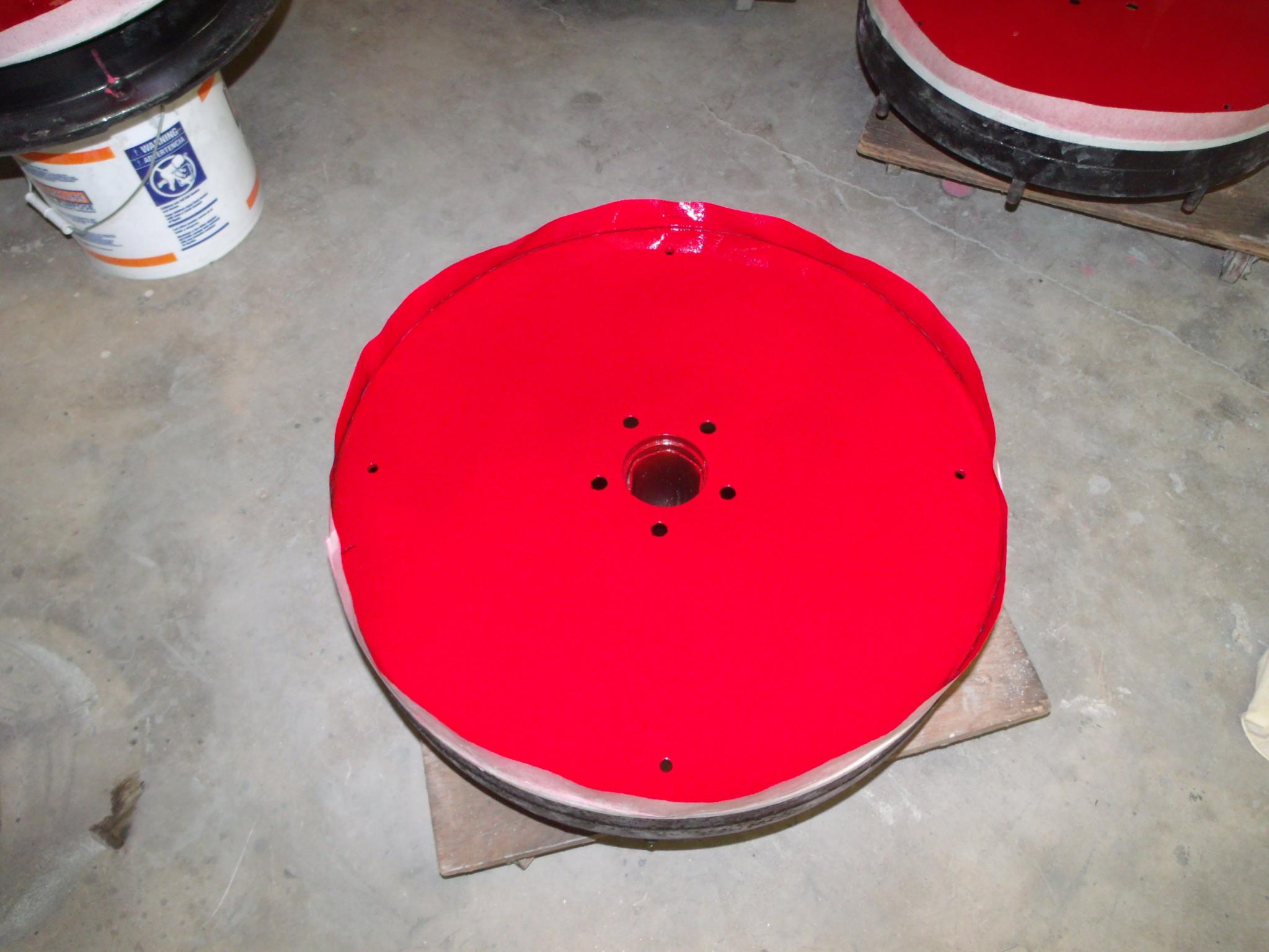

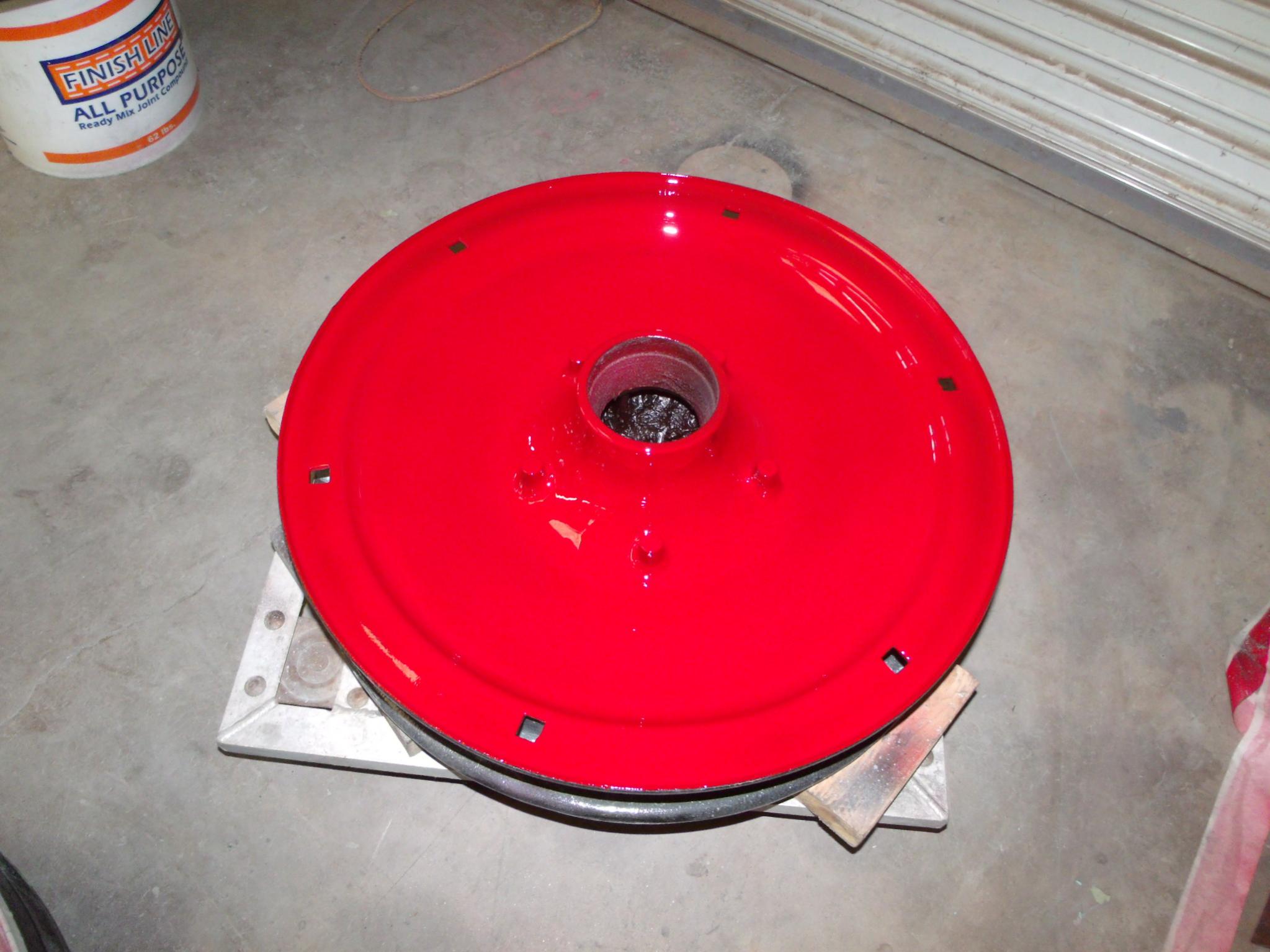

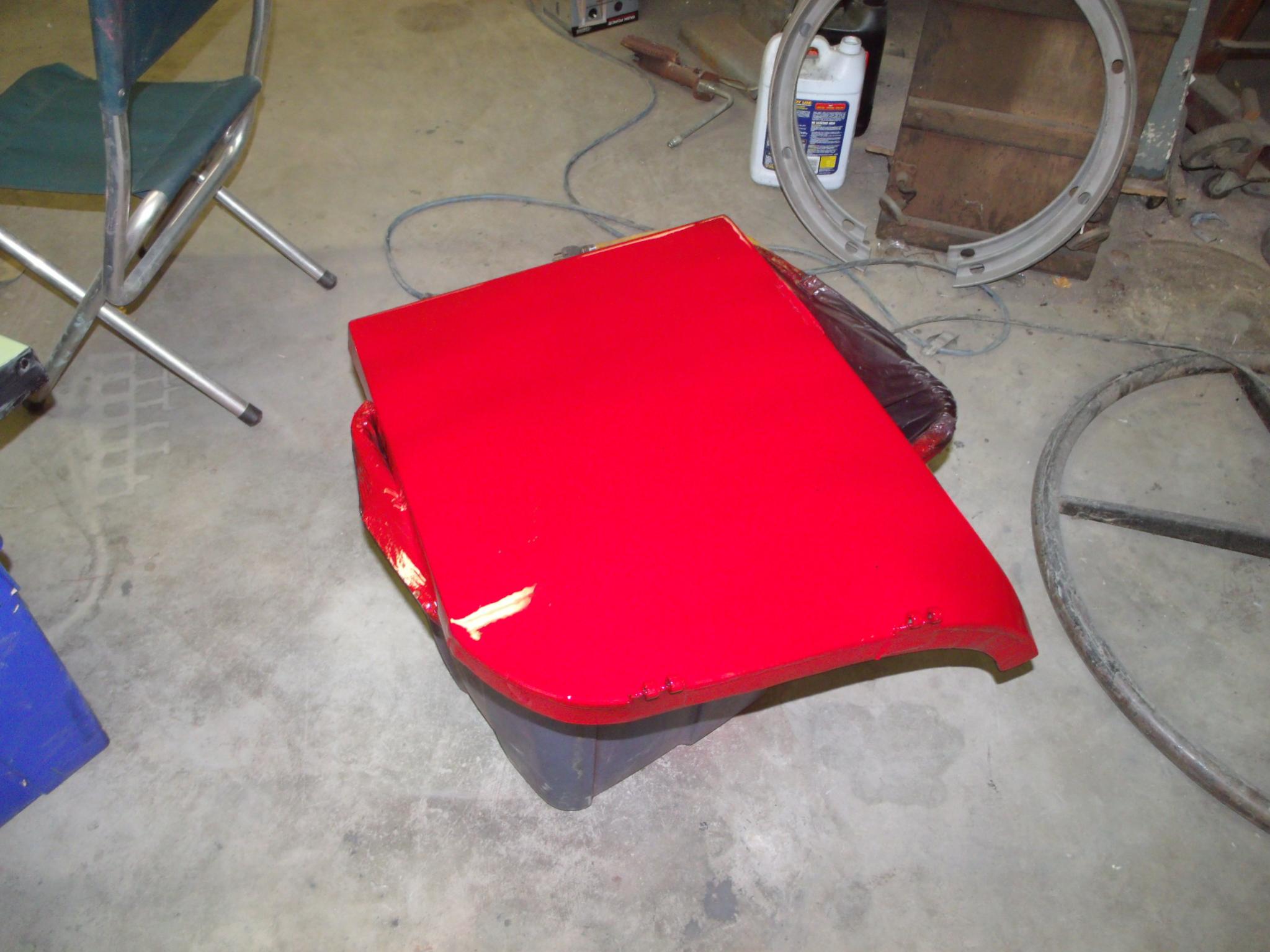

    Red paint

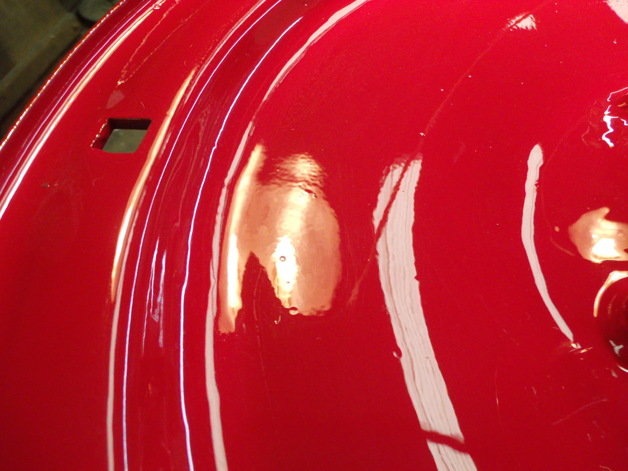

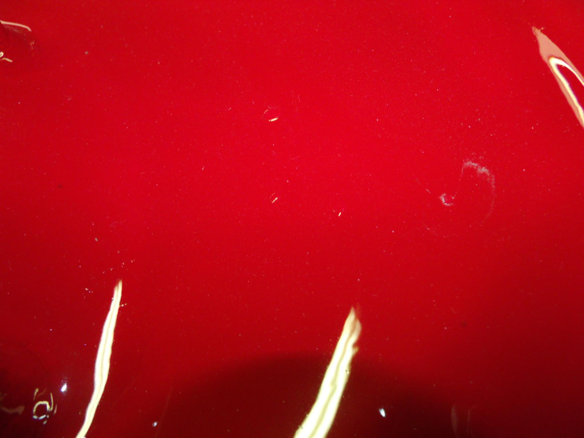

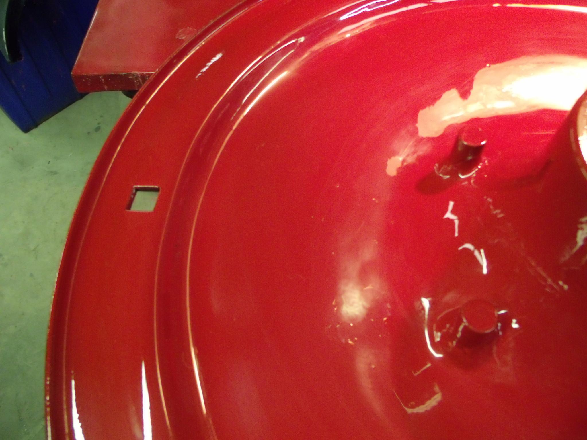

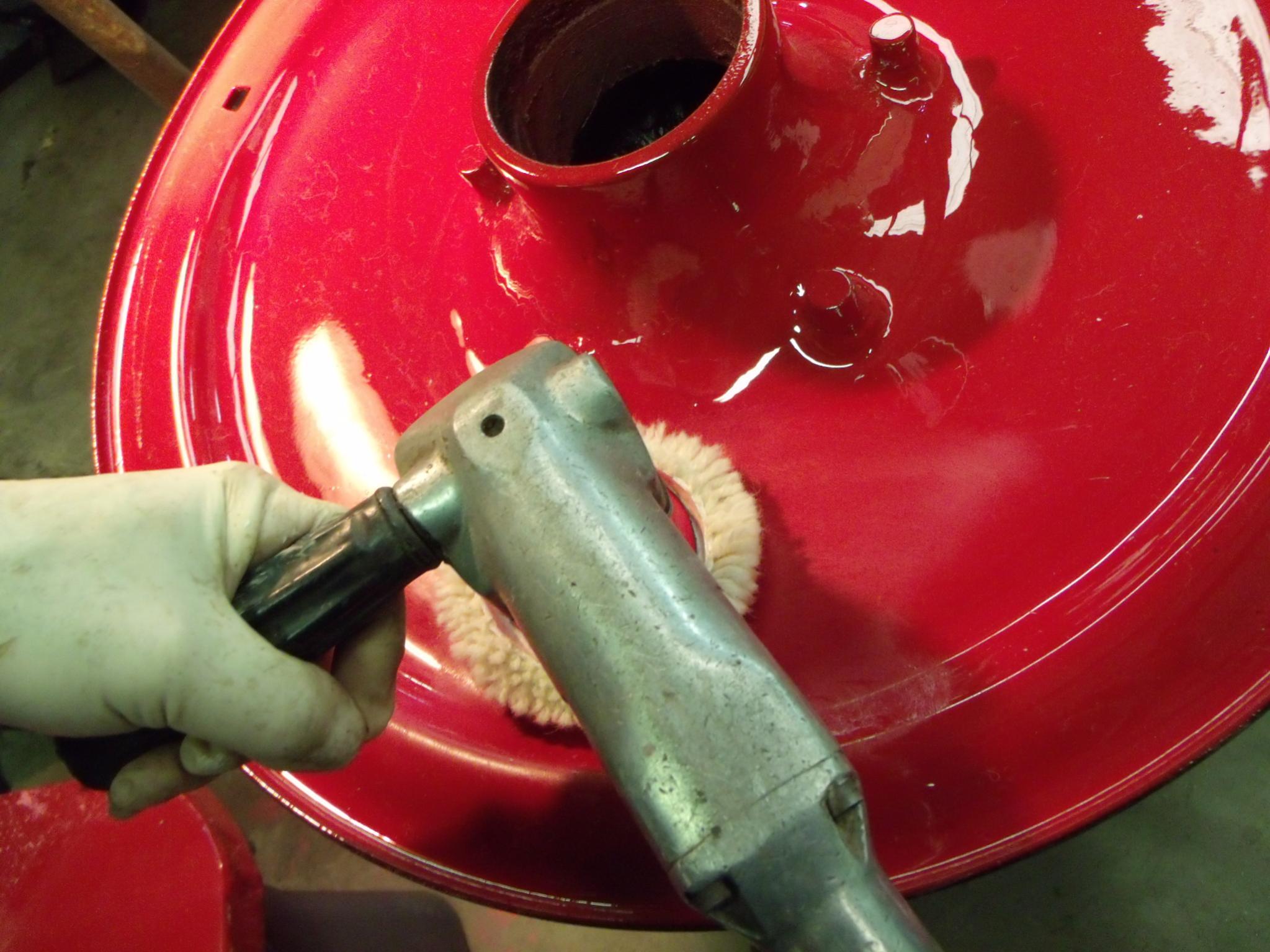

    I sanded away all the runs and re-prepped the wheels. This time I only put a splash of reducer in. My Chinese paint gun was screwing up fan-wise but in spite of that the wheels came out pretty good. Pretty good except I think I got some contaminates from the hose, oil probably. Lesson: put a filter on the gun. I also had a little paint left over so sprayed the extra on one of the doors. When it dries I'll sand it with what? 1200? And give it a buff. If it wasn't for the contaminates and dust the paint would be good to go. This gives me confidence for painting the body.

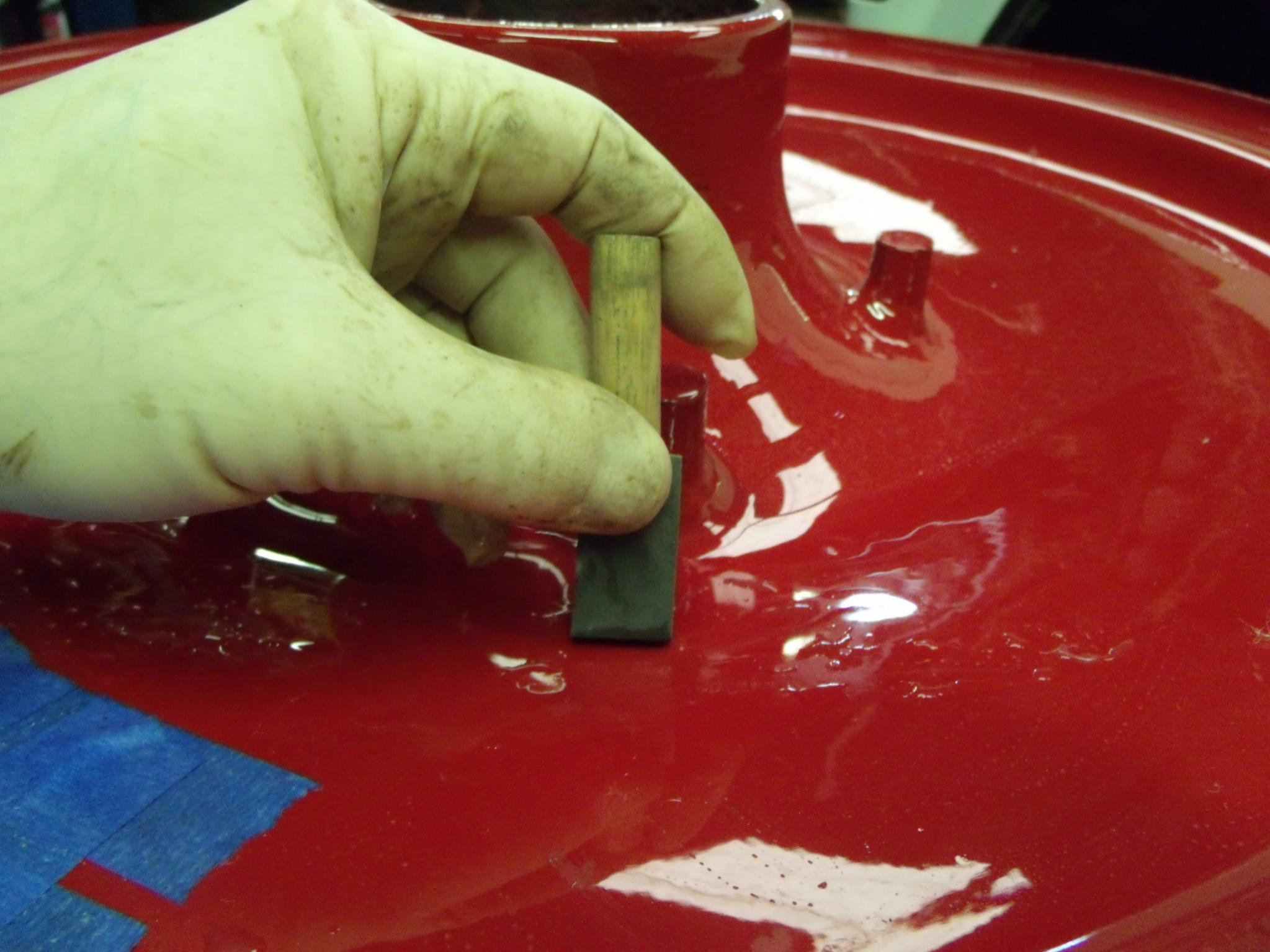

    This photo set looks almost professional.

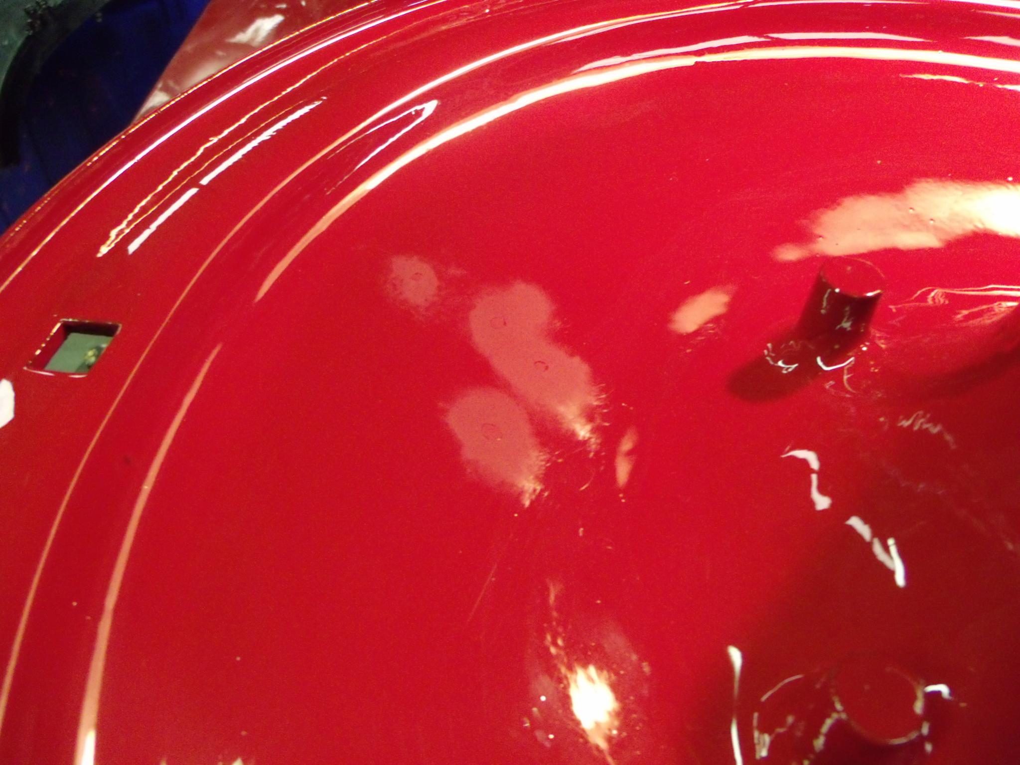

    Well I haven't actually seen the photos up close. They might be out of focus. So I planed down the blobs I dabbed on to cover up the holes in the paint. Then I sanded, then I sanded, then I buffed. then I buffed. I think I actually like the pre buffing finish better but I don't like the dabs. This is a lot of trouble to go through for the back side of the wheels. Really it's practice for the body paint job. **** I got the picture order out of whack. You'll have to figure it out, I'm not reloading. I need a break from bodywork. I think I'm going to start bolting pedals and stuff back on the ch***is.

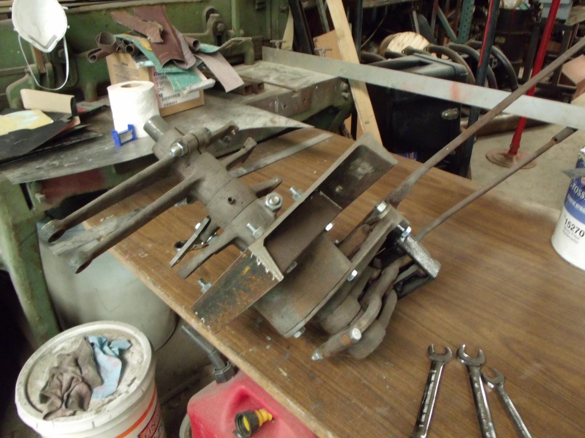

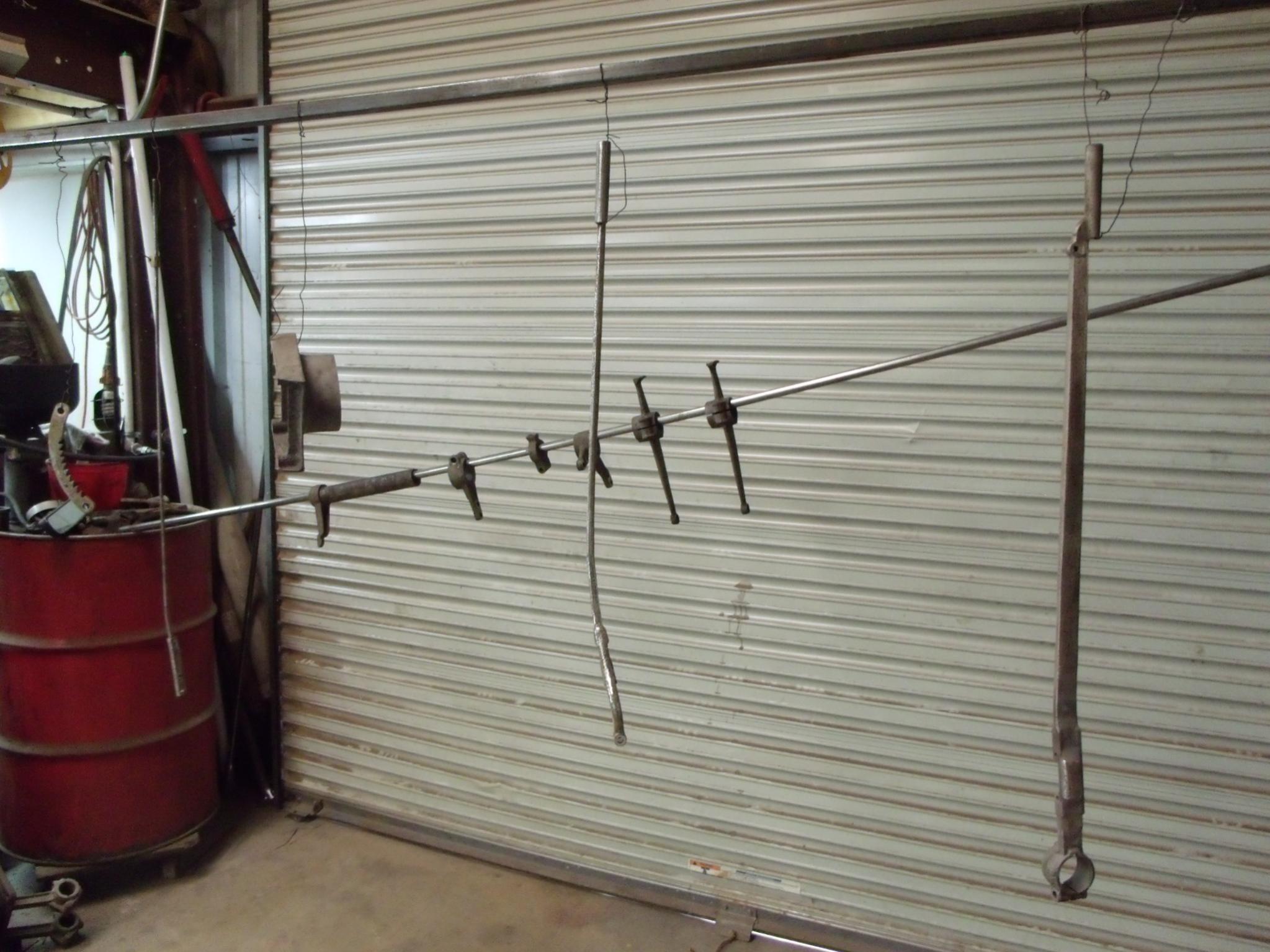

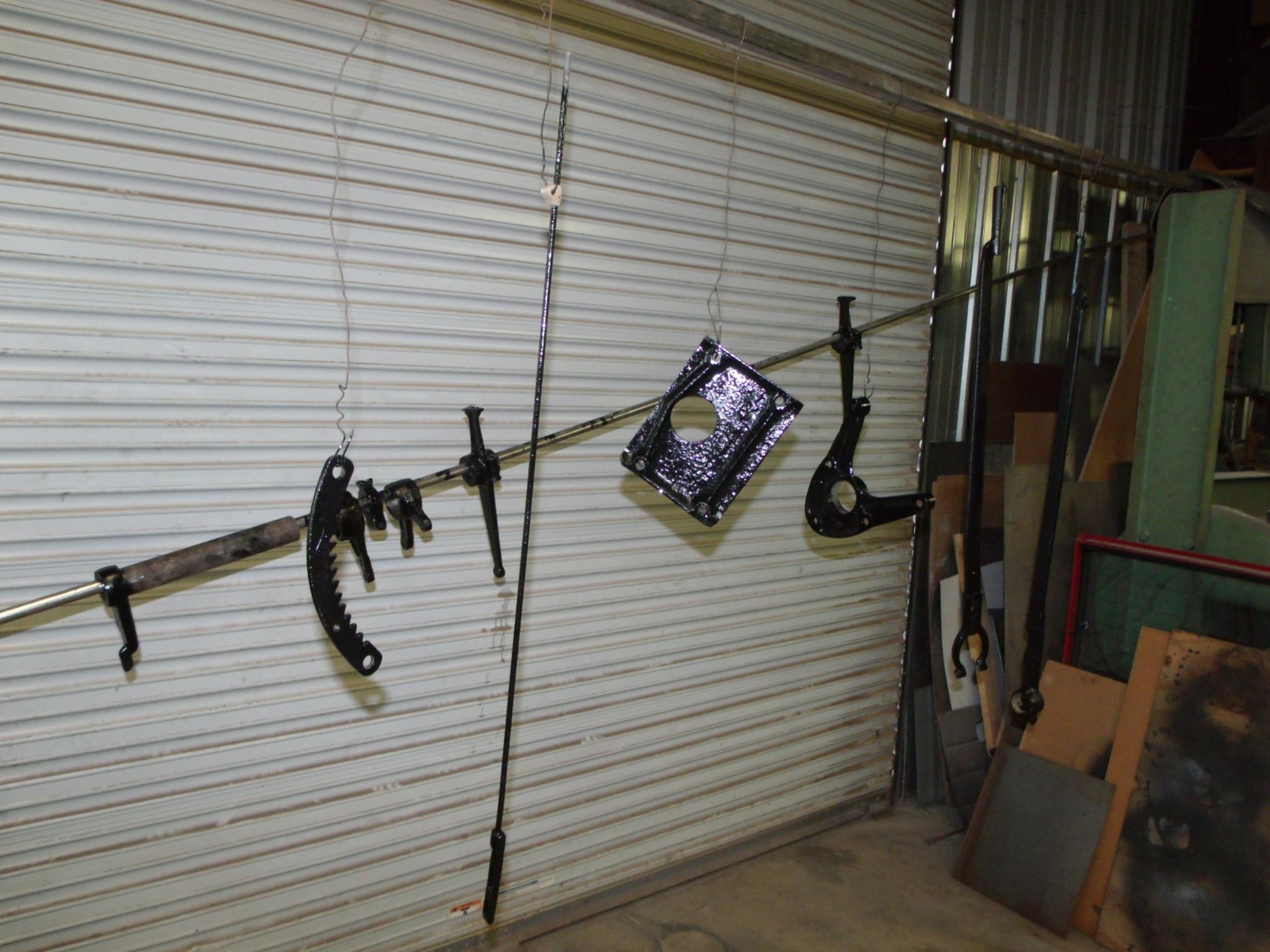

    Before I can start re***embling the ch***is I've got to paint the hand brake and shifter ***embly. I got everything taken apart and found old Mr. rust--who never sleeps-- had chewed on a few pieces. This meant a little rebead blasting. That done I got everything hung up and ready to paint. I also got the wheel hardware ready to paint as well. Tomorrow I paint and then the re***embly starts.

    I painted more stuff today. I need to do some bodywork (if that's the right word) on the brake and shifter handles. I think I should paint them red too. Someone suggested black but I don't think that would be good. They were originally nickel plated but who can afford that? Tomorrow I'll smooth up the handles.
