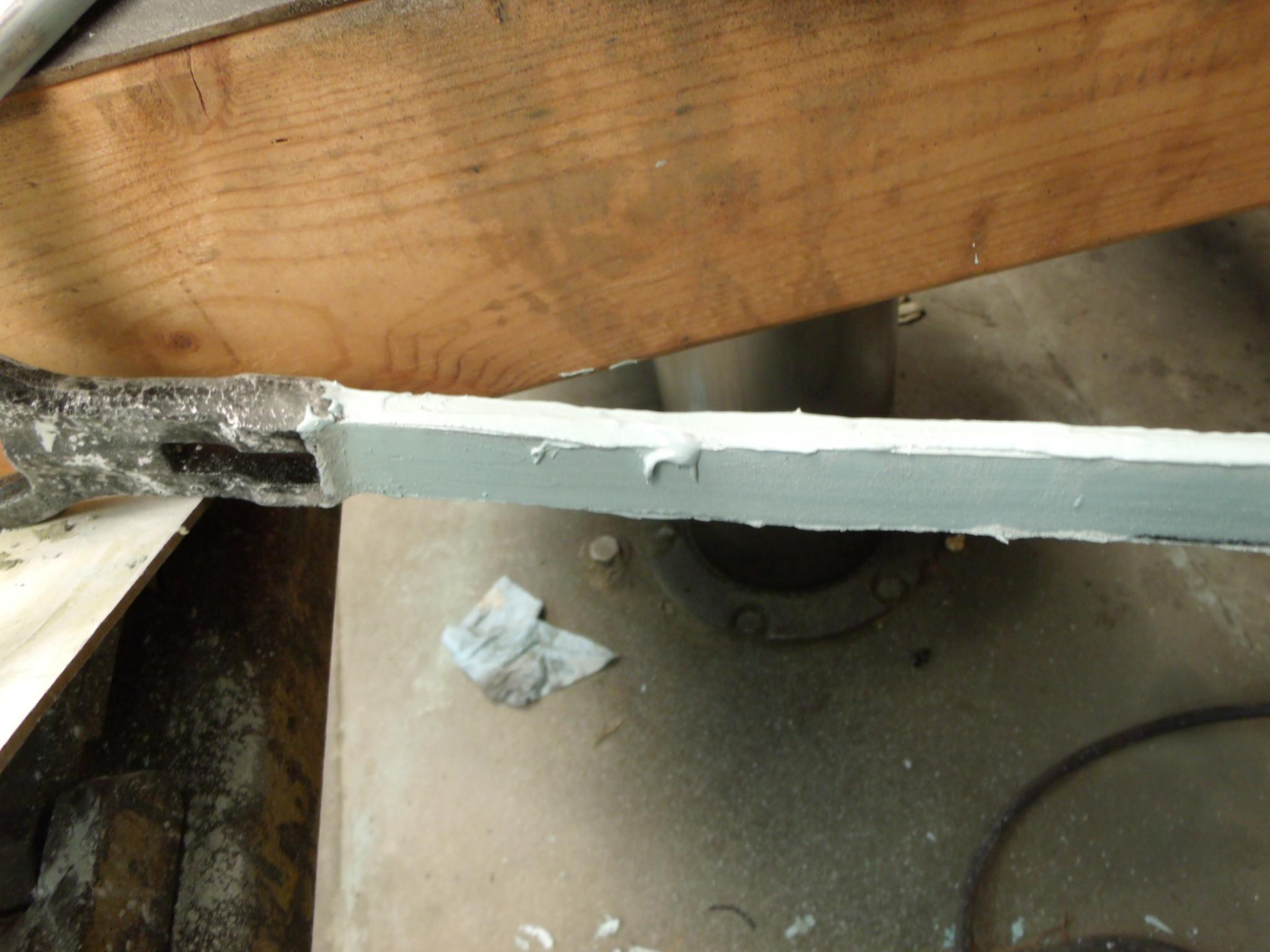

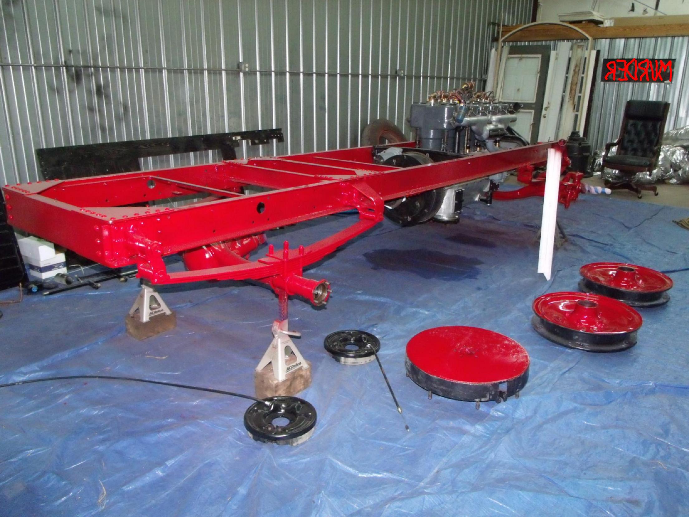

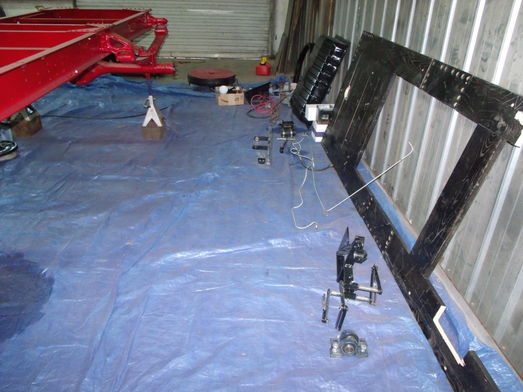

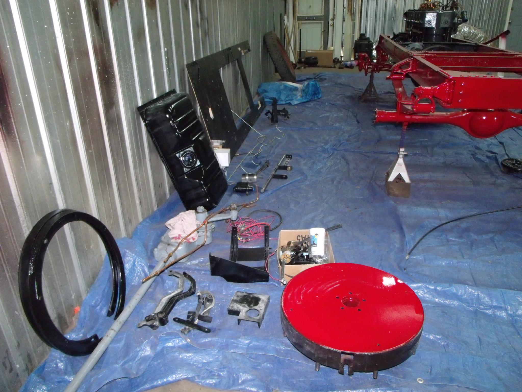

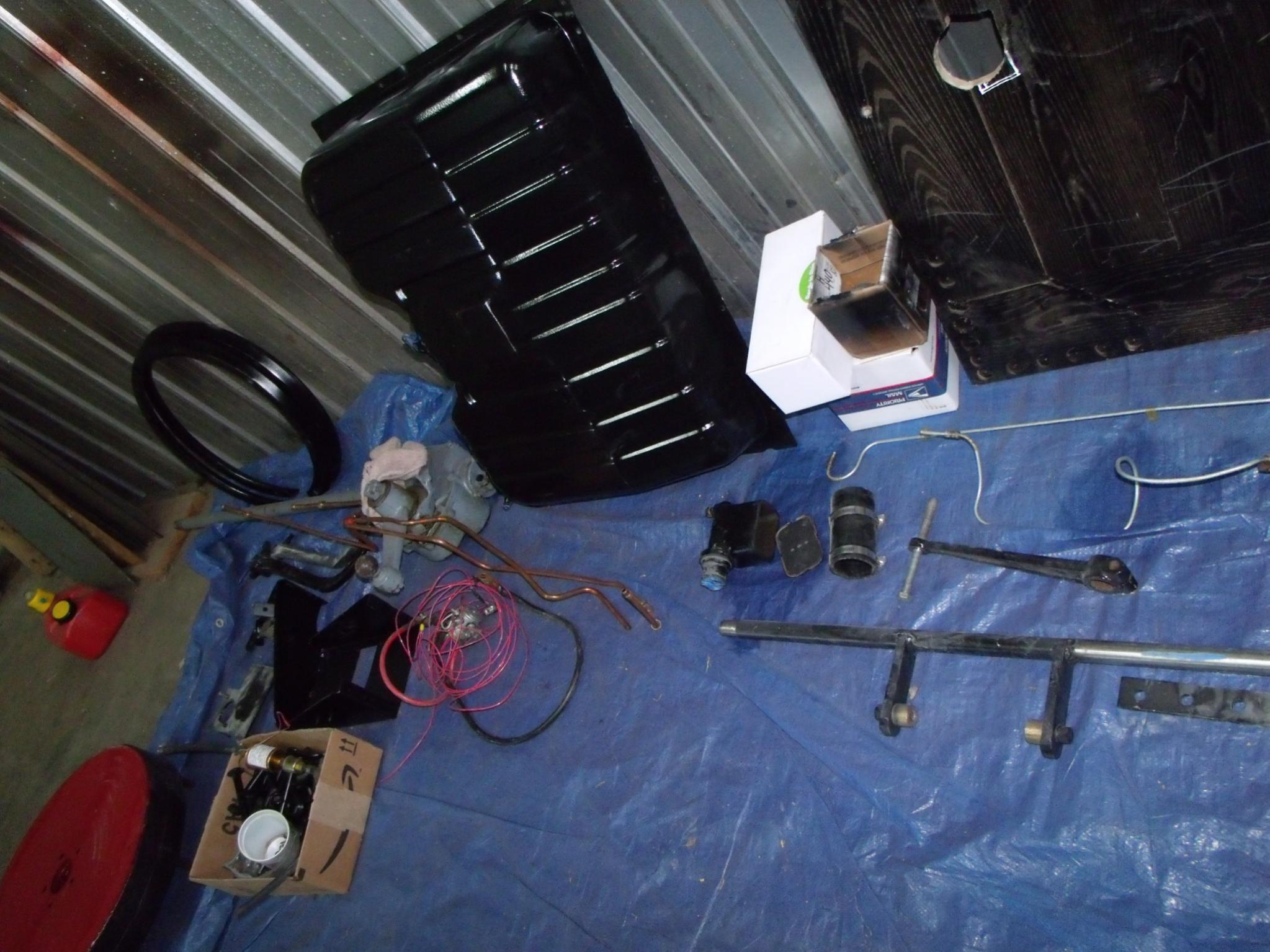

    I brought the wheels and pedals and linkage and gas tank and wood platform and all manner of stuff over to my other shop--a vacant warehouse that I cannot seem to rent--for ***embly. This should happen next week. I'm still working on the shifter/brake ***embly. I wiped the first of several coats of bondo on it today. You all probably forgot what the ch***is/engine looked like so here's some pictures with the parts spread around it.

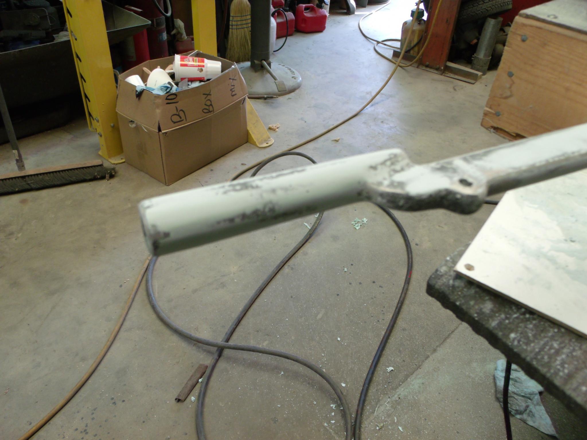

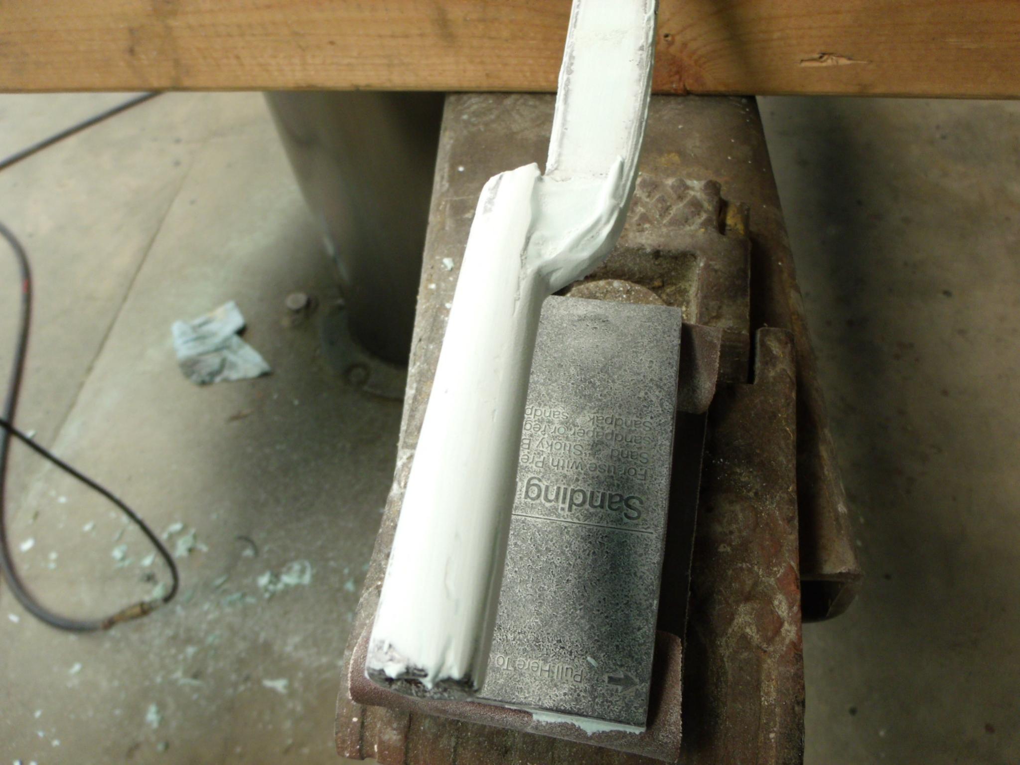

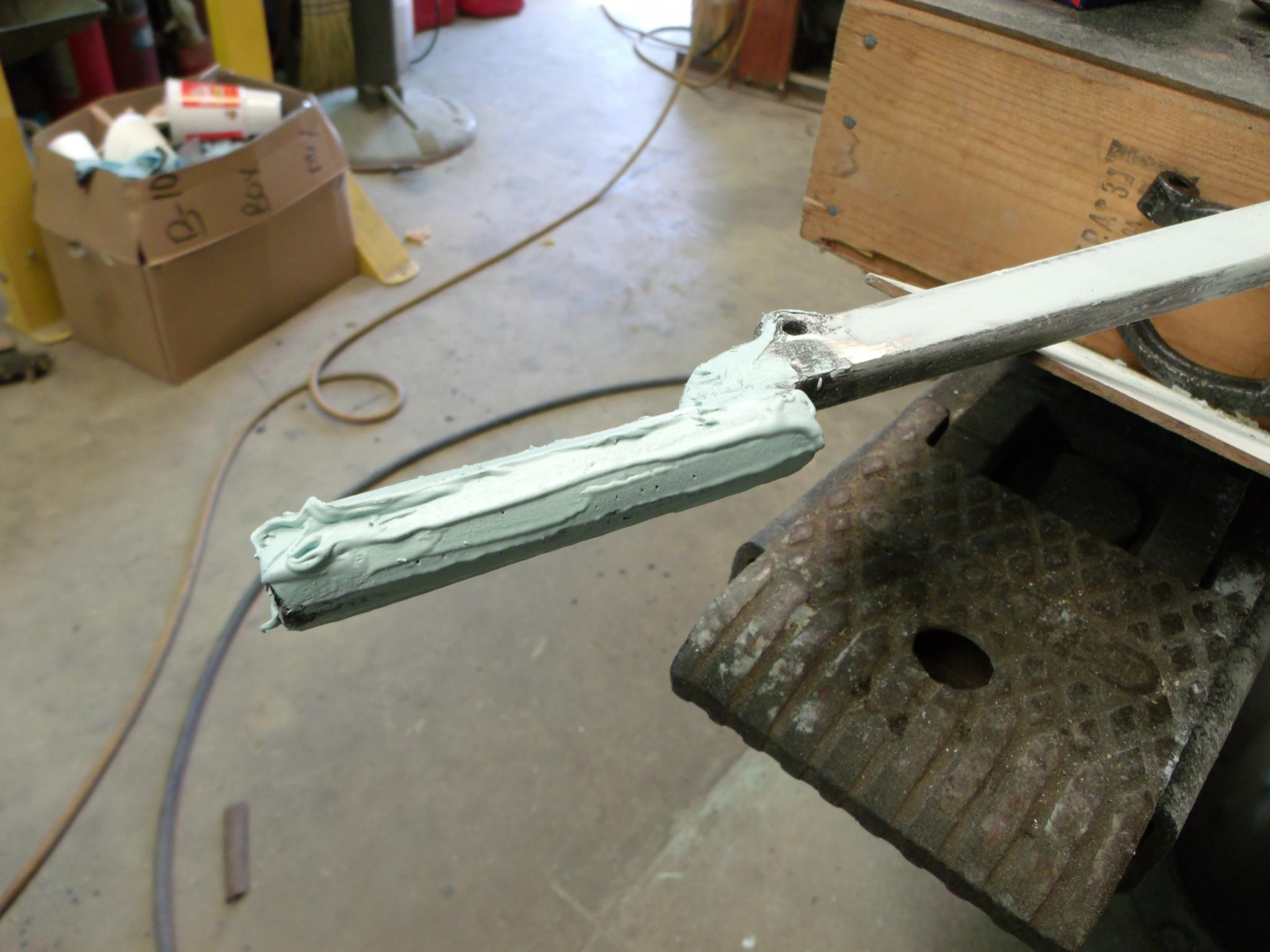

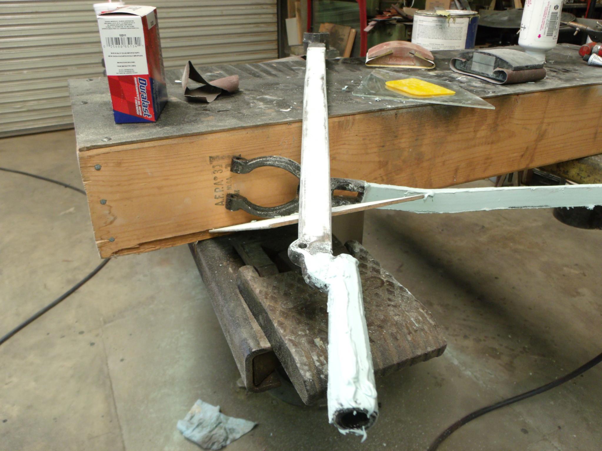

    This is really exciting!
    Restoring an old car is really just two things: Cleaning and Painting. Well, then there's also straightening. Okay, three things: Cleaning, painting, straightening--and also rebuilding. Four things! Cleaning, painting, straightening and rebuilding. Not to mention, finding lost parts. Finding lost parts? Damn it, I told you not to mentions lost parts!
    Well, I can tell you filling in rust pits on brake and shifter handles can drive you a bit crazy. You might end up talking to yourself. The nice thing is that because these are cast parts you can leave a few pits. if you don't, they come out too perfect and nobody ever accused me of making a part too perfect.

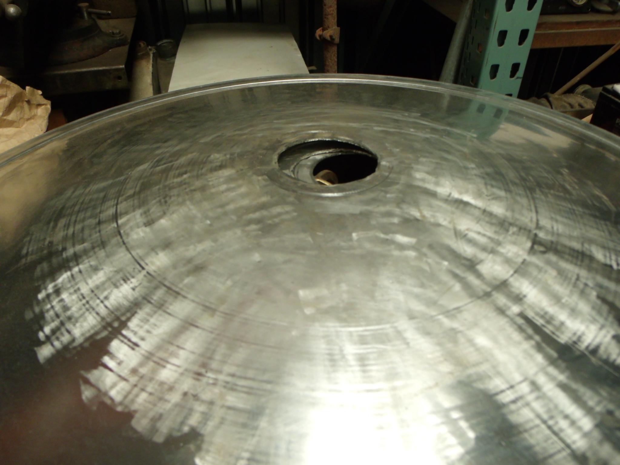

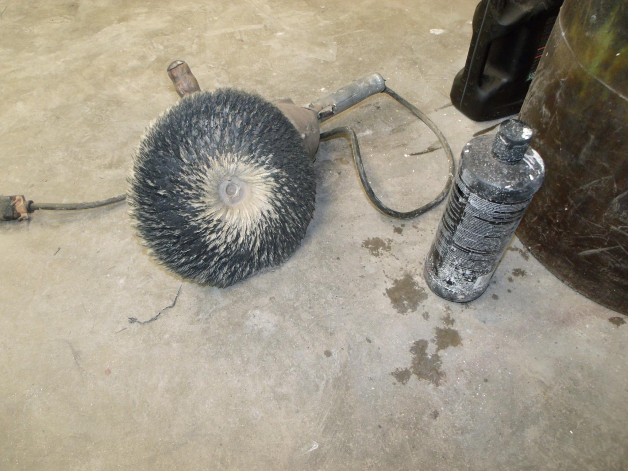

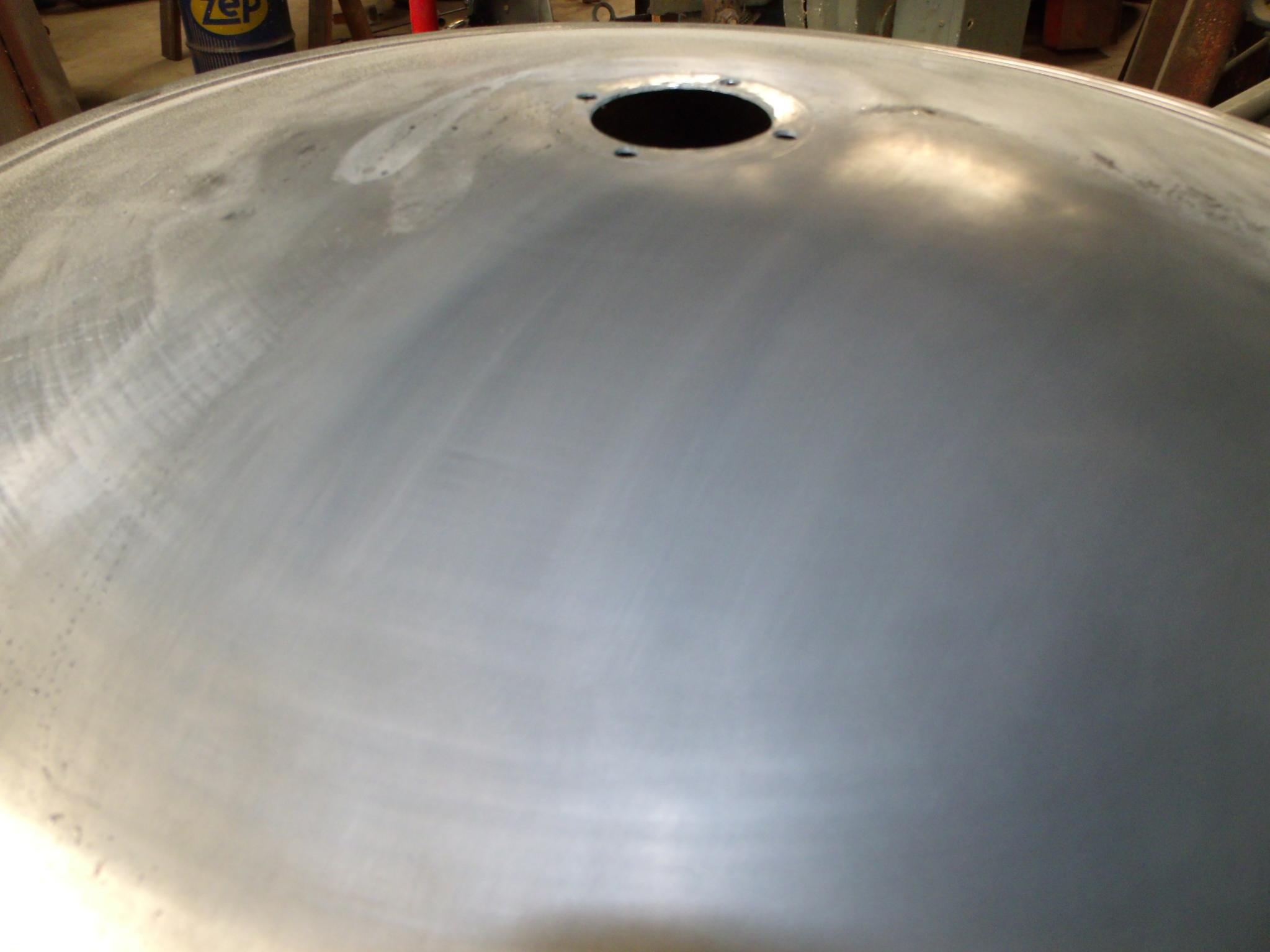

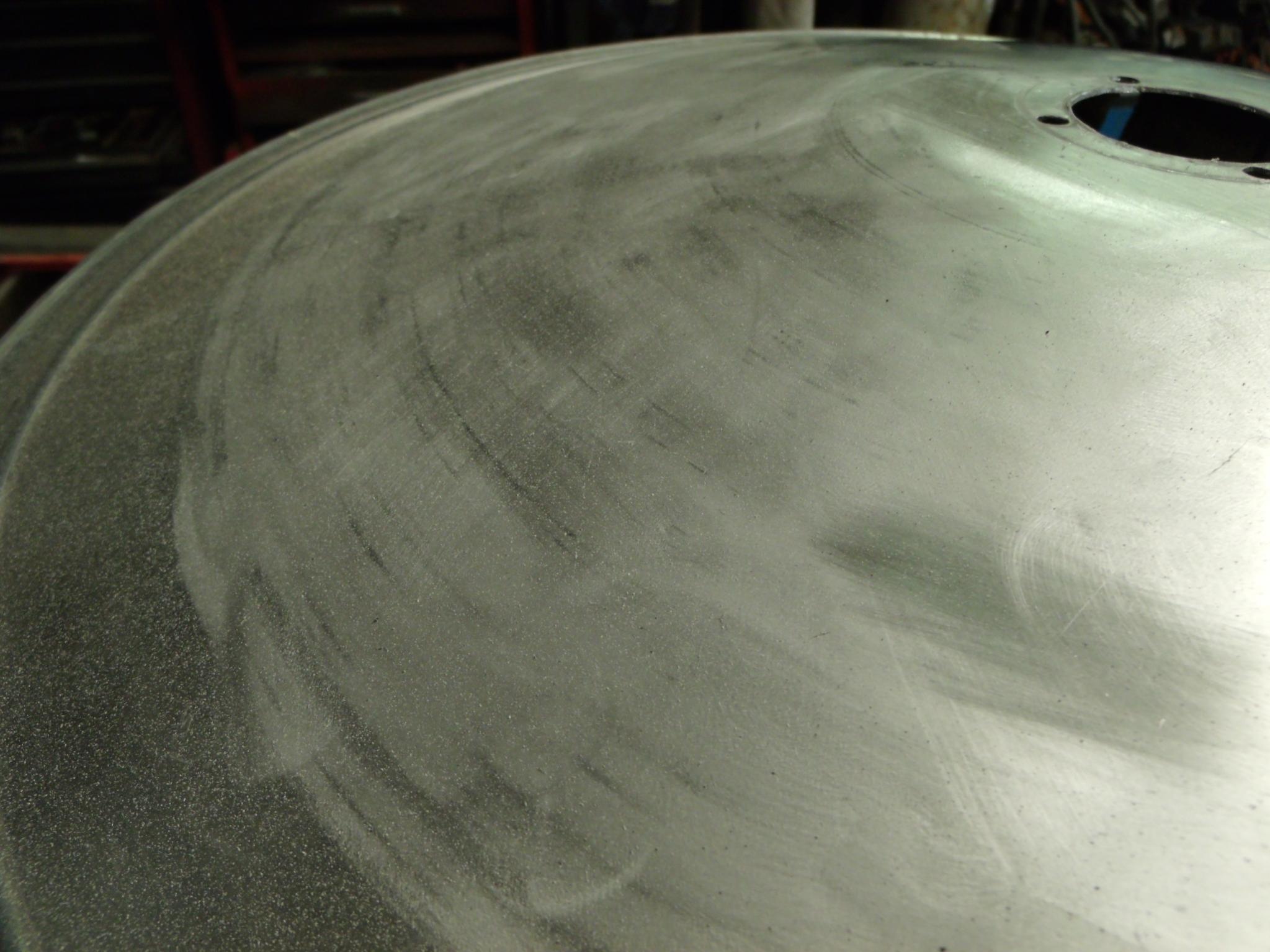

    Today I had to change out a septic pump and afterward pick up my son from an 11 mile hike on the Appalachian Trail--cool stuff when you're 11. I only stopped by my shop for an instant to sand on one of the wheel covers. I sanded it down with some #600 paper then buffed it a little. I think I need some different buffing compound as it came out dark. As I recall you buff aluminum with a white compound.
