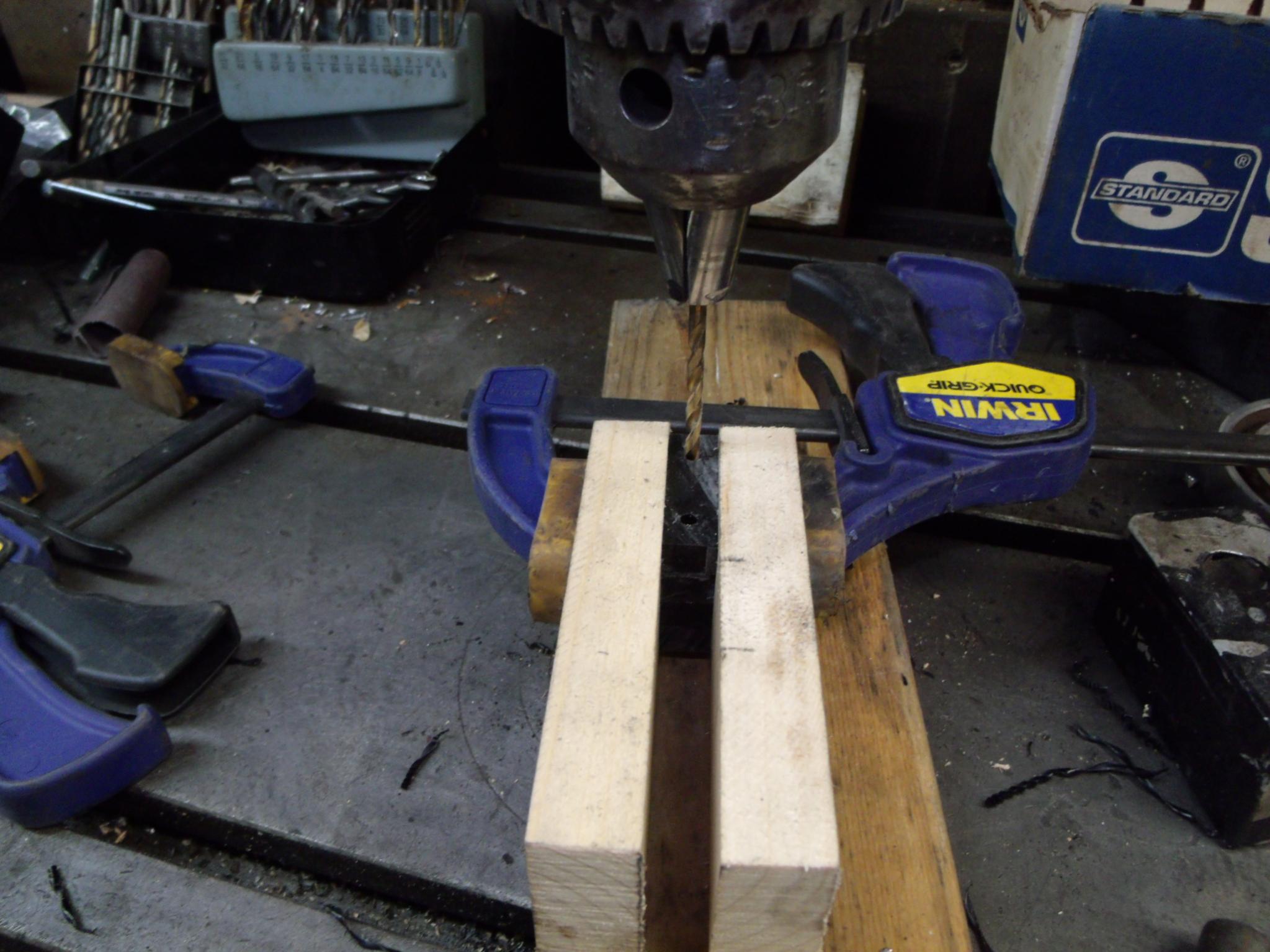

    I made up a jig to hold the Delrin when it got too small to hold. Then I drilled and tapped it. I don't usually use the drill press to tap but being Delrin is soft and I set the speed to very slow, I saved a bunch of time. Next I positioned the Delrin on the disc, center punched it and drilled. I found some neat SS screws at the hardware store to hold the pieces in place. They're not really period but they were convenient. Two more discs to go and I can move on to bigger things. Hey, how'd I get two of the same picture in there?
