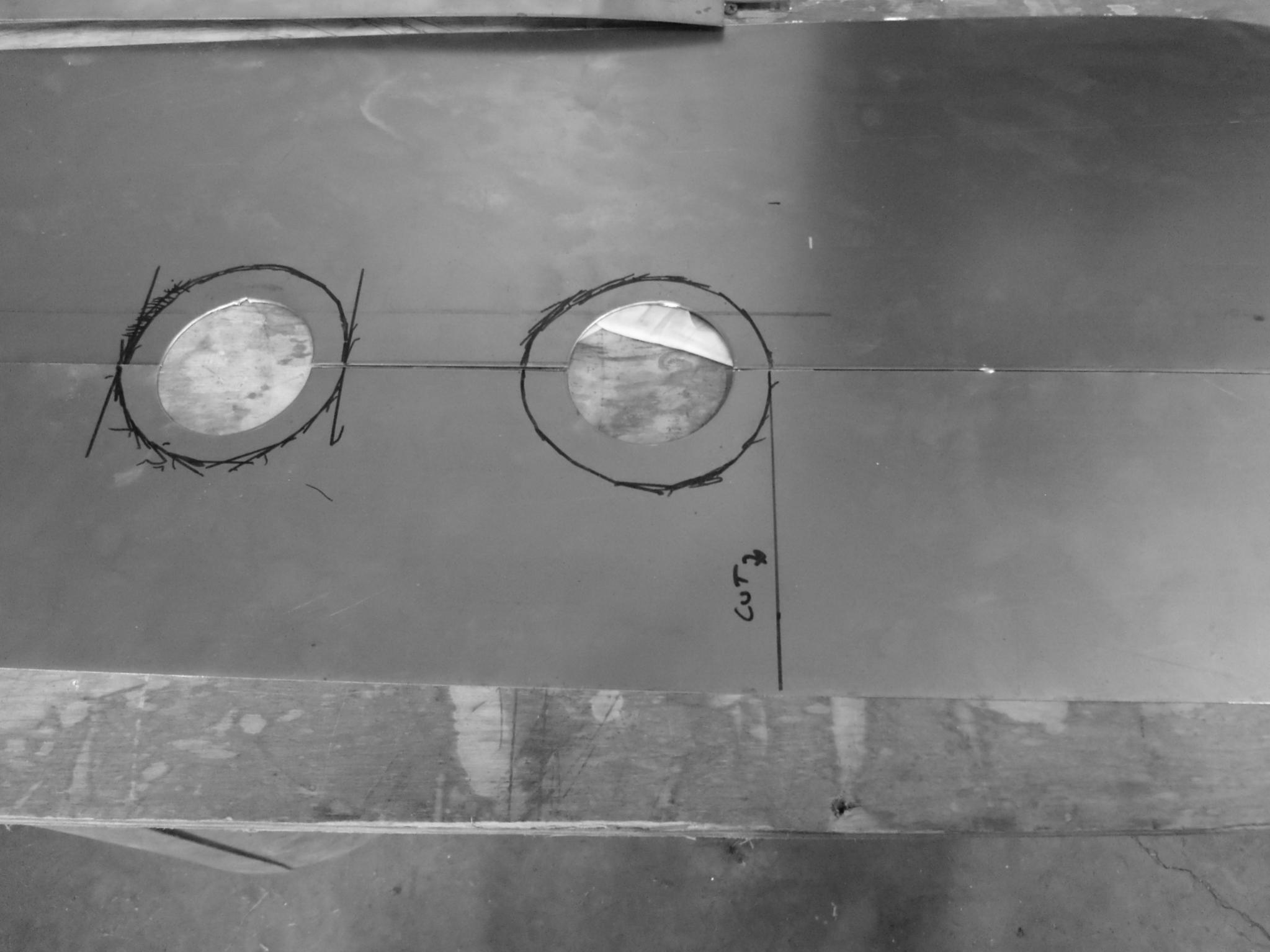

    I finally got to the shop for an hour or so. I used my Greenlee knock out punches to make holes for the exhaust pipes in the hood side. Then I put the piece back into the shear and cut it down the middle through the holes. That's where I screwed up. I had two lines on the metal and in my haste I lined up the right side on one line and the left side on the other line. Always x out a line if you're not going to use it. Still I learned something good. It's going to be real hard to slide a piece of metal under the exhaust pipes. I think I'm going to make the piece under the pipes semi permanent. Also I'm going to make the top part of the hood side extend down to the wood on the front and rear of the pipes. this leaves only the middle semi permanent piece under the pipes when I lift the hood. I'm still not settled about the hole around the pipes--whether it will be individual holes or one long one.

    Holes
    Ever see that movie? Pretty good. Okay, I carefully traced around the pipes to get a real accurate picture of where the pipes are in relation to the sheet metal. I'm using this messed up hood side for a template. The idea is to make a new hood side and leave the front and rear of the side while cutting out directly below the pipes. I'm going to semi-permanently fasten the piece directly below the pipes to the wooden shelf. As to how big to make the holes around the pipes--I'm not sure. Right now I'm going to start with the holes as described by the black circles and see what it looks like. Two of them have gone a little off the reservation but I'll just take an average and I don't think it'll be too noticeable.
    Jerry

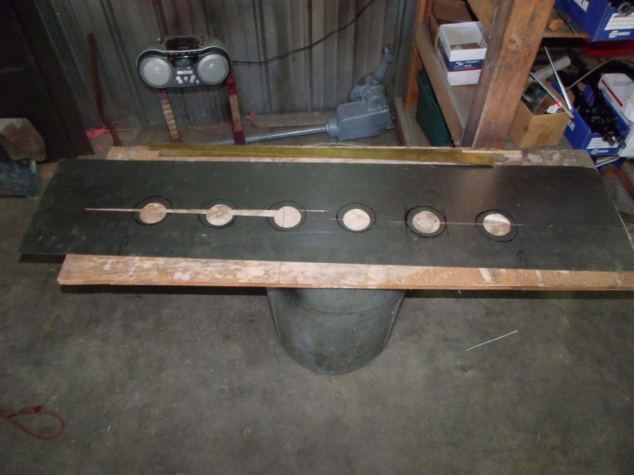

    Hood side redo
    Got to sneak away today. I've gotten my fill of building walls and moving garage doors. But there's still more work. Anyway, I laid out a new hood side and punched new holes--this time bigger. On the first hole I noticed the metal distorting slightly so I sharpened the cutter and put some wax on it. That helped. The other difficult thing was cutting out the piece under the pipes. Luckily the shear blade fit between the holes. I didn't have time to try the piece on the car. Maybe tomorrow.

    Holes II
    I ran by and gave the hood side a fit check. Looked good. I'm thinking wrapped exhaust now. I loved all the br*** mesh suggestions but time and money are against me. The next part is making up some guides so the upper and lower pieces will fit together. I'm pondering br*** trim too.
