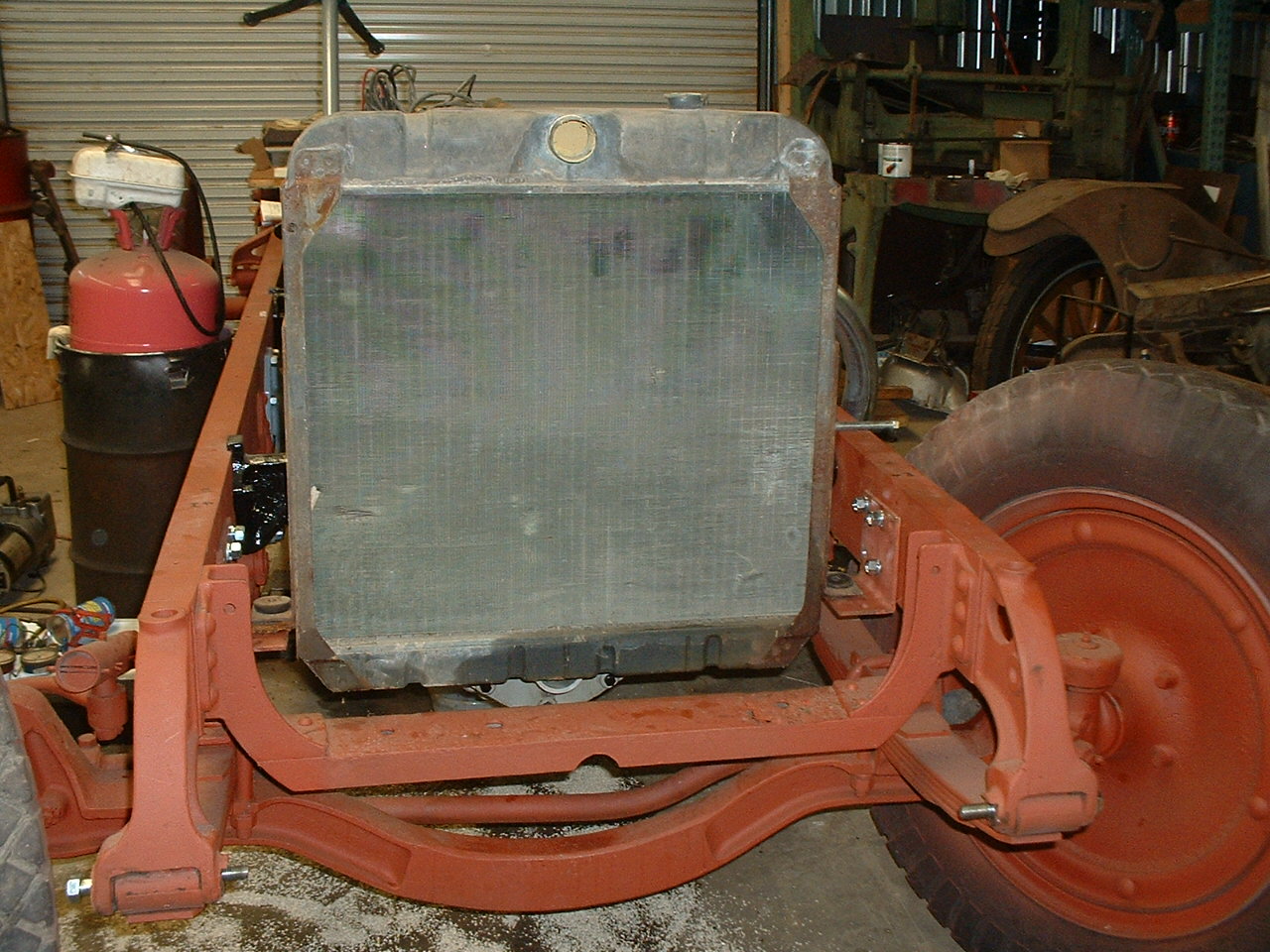

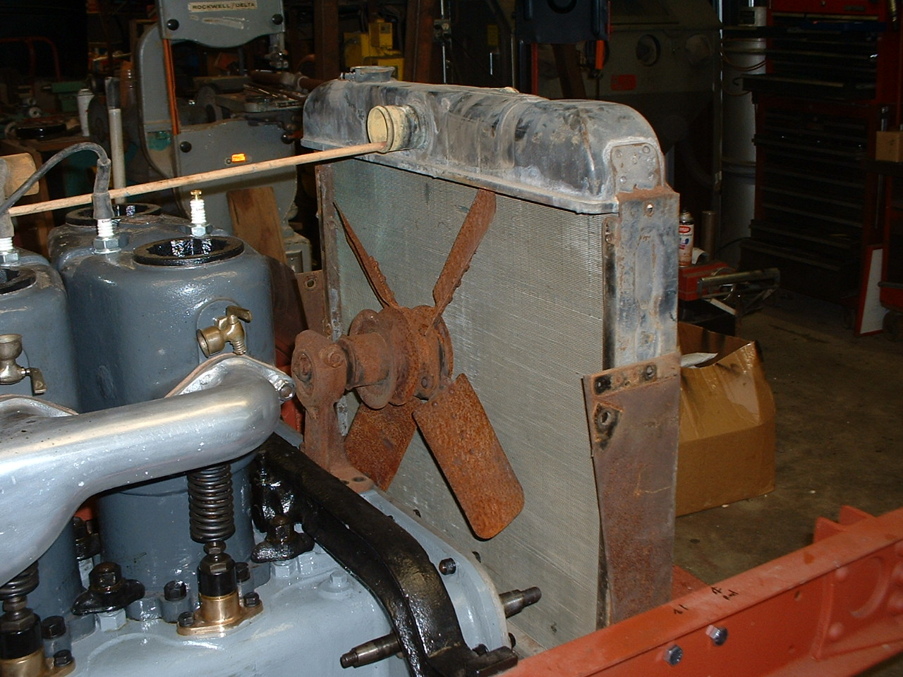

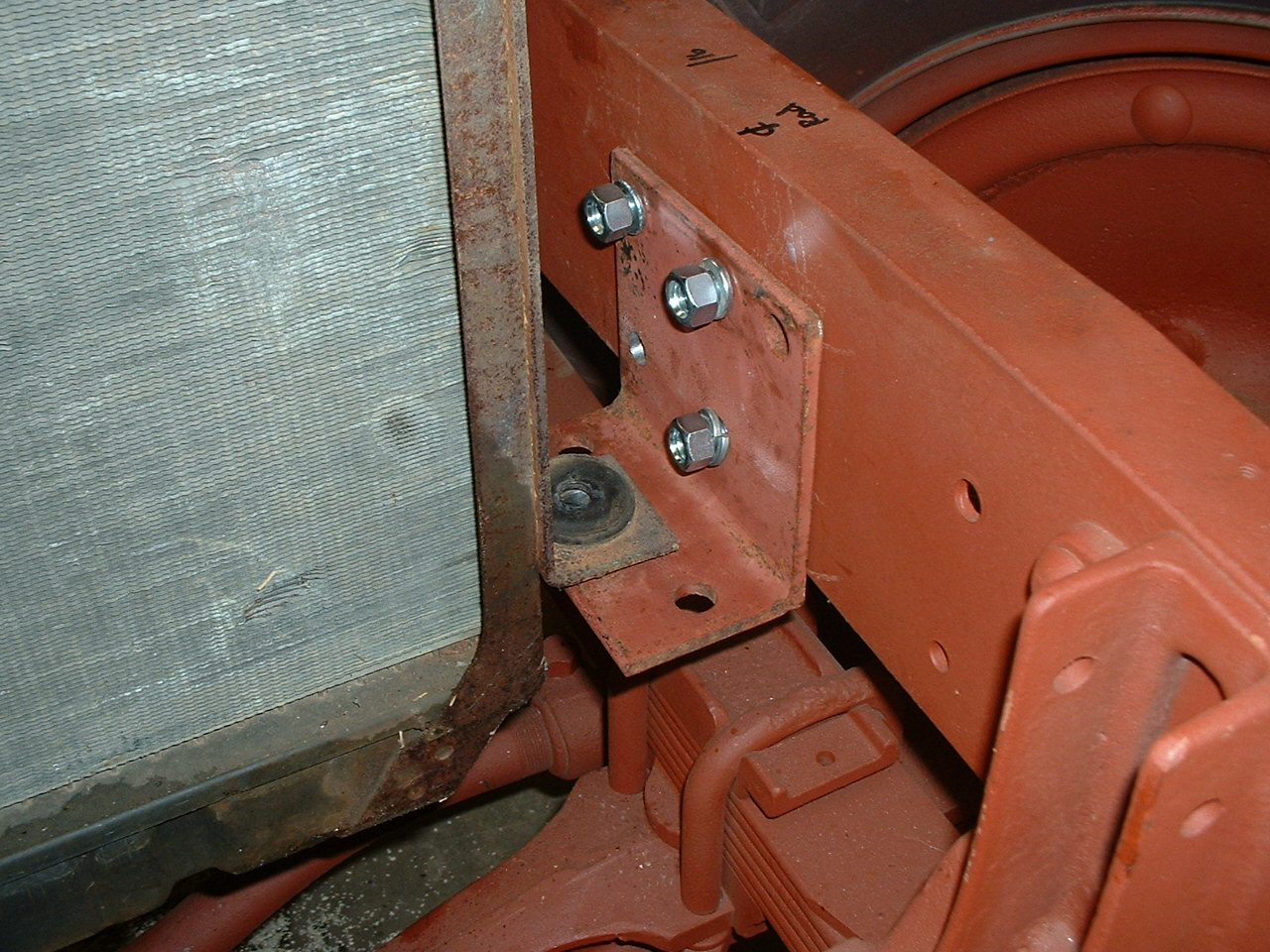

    Radiator
    Last week the kids were in VBS and had to be picked up at 12:00. I got nothing done and I gained 10 lbs. This week I got out a radiator I'd been saving from a motorhome I junked out. I think it'll handle the heat since it was designed to cool a big V8 pulling a house up Pike's Peak. I made up some brackets to hold the thing up while I checked out the fit and size.
    Jerry
